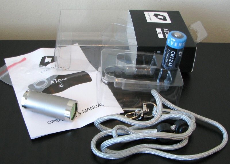

    Foursevens packaging has been updated, and the Atom AL comes in their new trademark clear plastic display case. Along with the light, you get a Foursevens CR123A battery, extra o-rings, a good quality wrist lanyard with split ring, and manual. There is also an overview of specs on the bottom and back of the packaging.

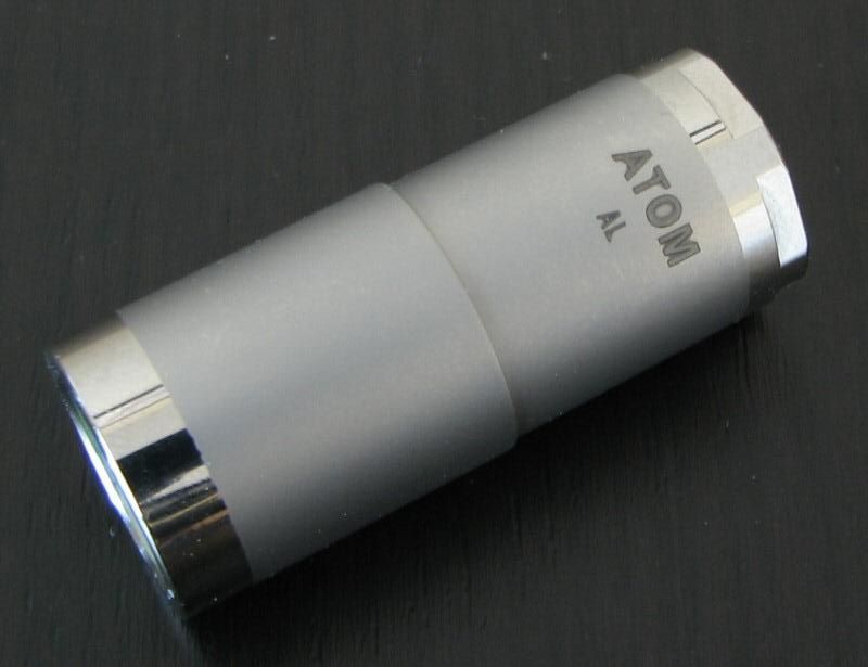

    As you can see, the Atom AL is the smallest 1xCR123A light I've tested to date. It is the first CR123A light that I could actually see dangling from a keychain.

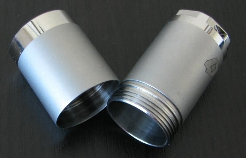

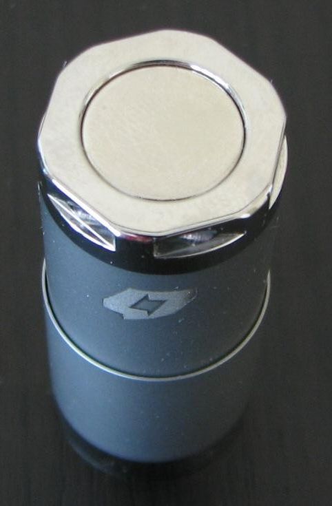

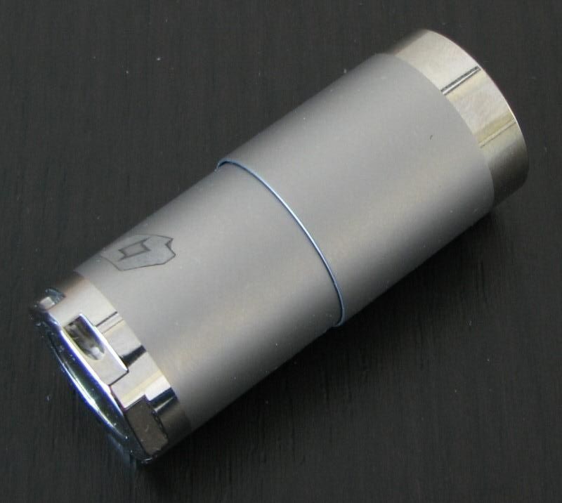

    Build is very similar to the Preon P0 that I have reviewed previously – only adapted to fit a single CR123A. Stainless construction feels reasonably sturdy. As before, the light doesn't have knurling, but the brushed finish over most of the light helps with grip.
    Screw threads are fairly fine, but larger than the P0. There is a fair bit of play on my sample (i.e., the head can rattle against the body, unless fully tight).
    Light works by tightening the head against the body. There is no spring in the tailcap – the light relies instead on a small raised post. There is a plastic disc around the positive contact button in the head.
    Like the P0, the Atom AL has a built-in split-ring attachment point on the tail of the light, which allows both tailstanding and hanging straight. There is an integrated magnet on the tail, which is strong enough to hold the light horizontally off any metal surface. In fact, it is so strong that it holds the battery inside the light – you have to carefully grab the exposed end and pull to dislodge an inserted battery.

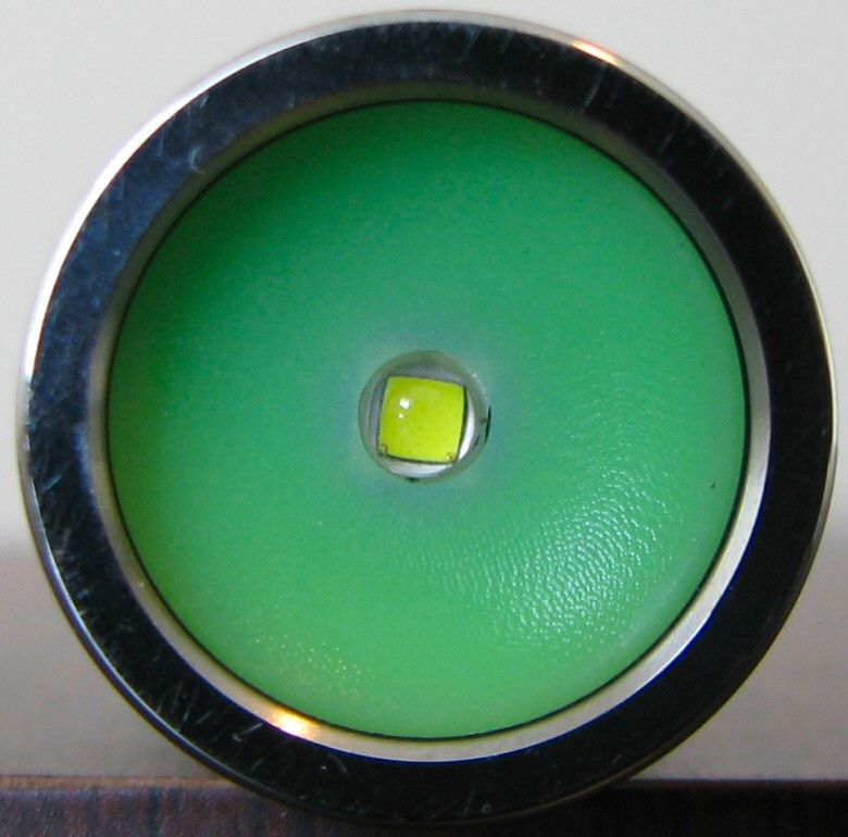

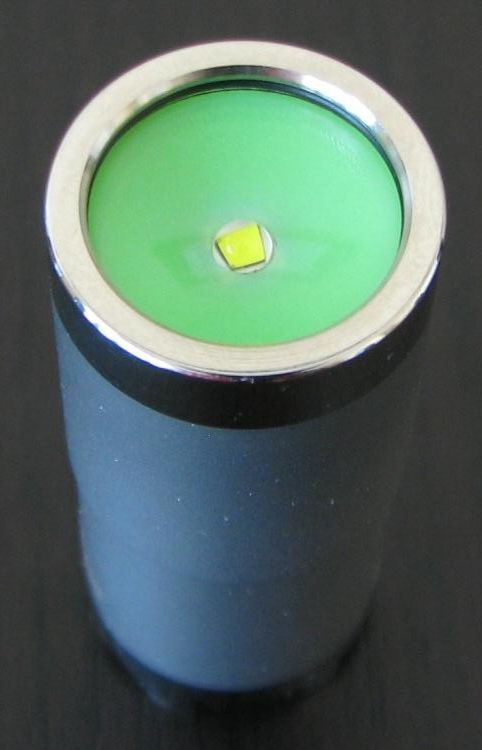

    Like with the P0, the "reflector" is actually conical-shaped piece of GITD plastic. It is not really designed to collect the light and focus it – it seems to be used mainly for its glow-in-the-dark properties. You can therefore expect a full flood beam, with little defined hotspot. Scroll down for my beamshots.

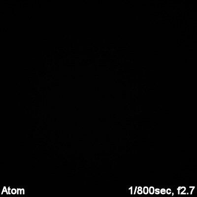

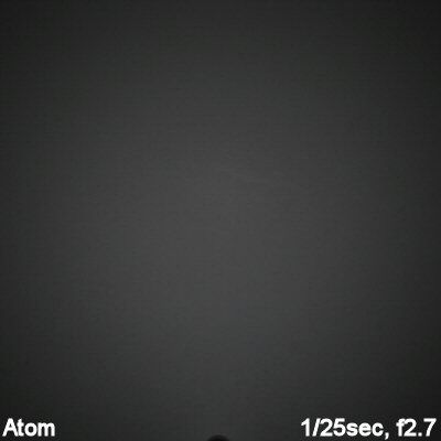

    For white-wall beamshots below, all lights are on Max output on a primary CR123A battery. Lights are about ~0.75 meter from a white wall (with the camera ~1.25 meters back from the wall). Automatic white balance on the camera, to minimize tint differences.
    Ok, so my standard white wall test bed really doesn't show you much. Part of the issue is the lower output of the Atom AL (i.e., only 110 reported lumens on Hi). But the main reason you can't see anything is the camera's limited field – the Atom AL puts out a much wider (and more even) spillbeam than any of the other lights shown above. It really looks like a giant spot beam in real life.
    Unfortunately, you can really compare the beam profile using these standard distances. I recommend you check out my video overview for a discussion.

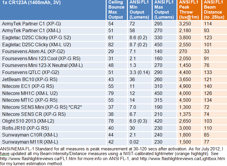

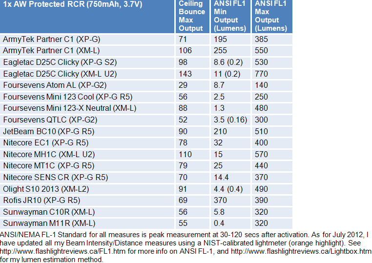

    Max output in my testing is a little higher than the Foursevens specs (which is common), although the extremely wide floodbeam makes the light a little hard to compare to those with traditional beam profiles (i.e., the consistency of my measurement method may be a little off).
    Output on 1xRCR is indistinguishable from 1xCR123A on Hi, with just a small increase in output on Lo.

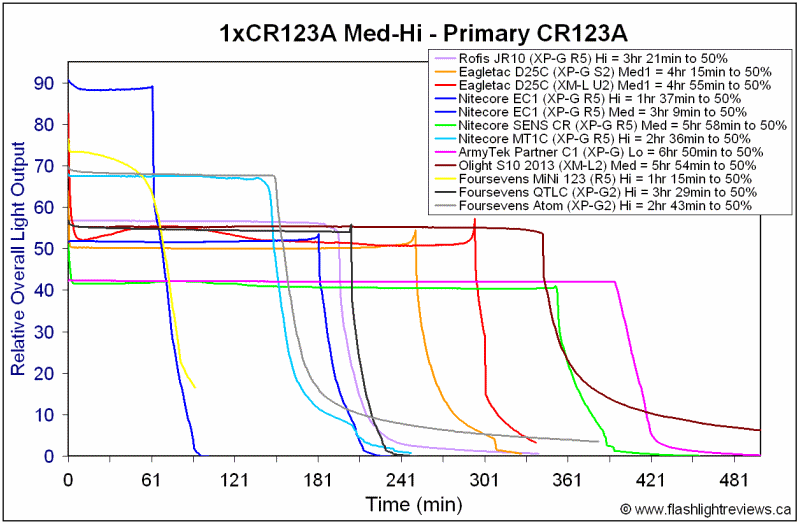

    Output/Runtime Graphs:
    Performance is as you would expect for a current-controlled Foursevens light at these levels (i.e., comparable efficiency to the Foursevens QTLC XP-G2). The light shows full regulation on both CR123A and RCR Li-ion sources.

    The beam is very distinctive on these small Foursevens lights with the plastic GITD surround (it is not an actual reflector, because it doesn't really shape the light beam). Just like the P0, the Atom AL has one of the floodiest beams I've come across. There is however a fairly sharp demarcation along its outside spillbeam edge, due to the bezel (i.e., the beam doesn't just gradually fade away like most lights). Those who want true "flood" should find what they want here.
    The GITD surround provides a fair amount of glow after the light has been on awhile. I find it also introduces a slightly greenish tinge to the edge of the spillbeam.
