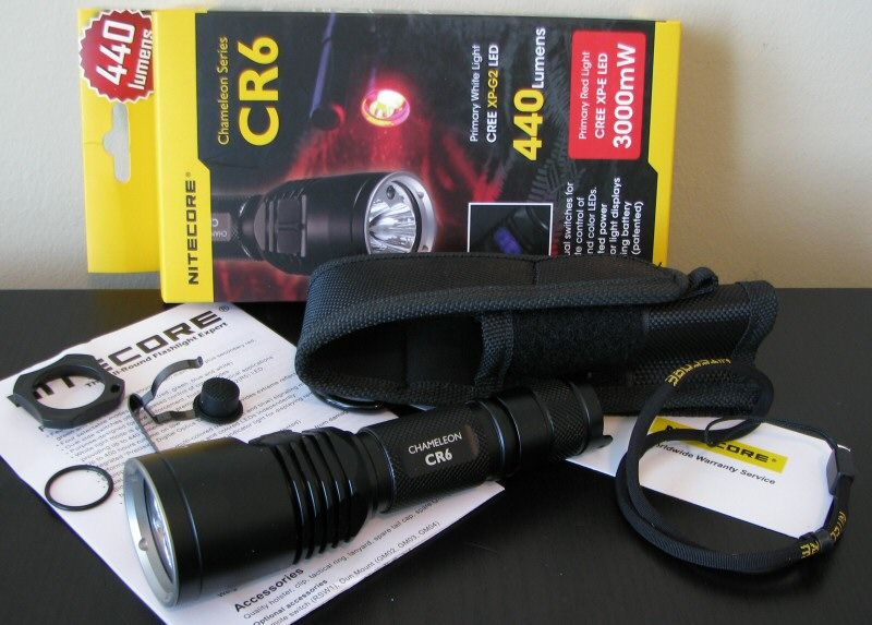

    Packaging is consistent across the line, although I note they have adjusted the colors a bit to try and make it clearer which dedicated color model you are getting. Clear specs are printed on the outside of the boxes. Inside, included with the light are spare O-rings, extra switch boot cover, basic lanyard, holster with Velcro flap, pocket clip, grip ring, warranty card and manual. The manual is common to the RGB series (i.e., gives stats for all three models).

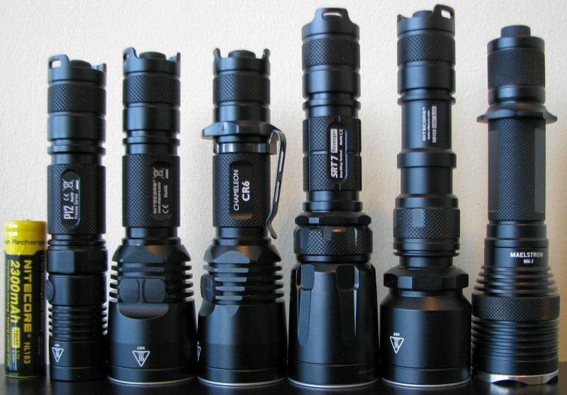

    From left to right: Nitecore Protected 18650 2300mAh; Nitecore P12, Chameleon CG6, CR6 (with clip), SRT7, MH25; Foursevens MMX Burst.

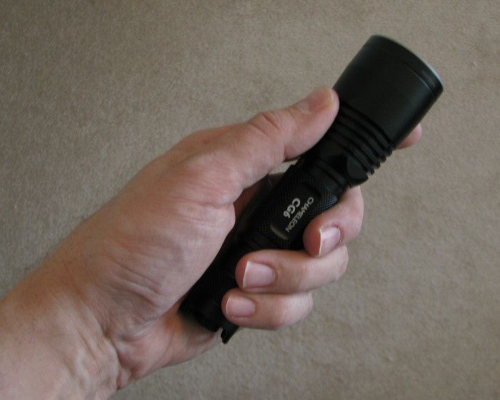

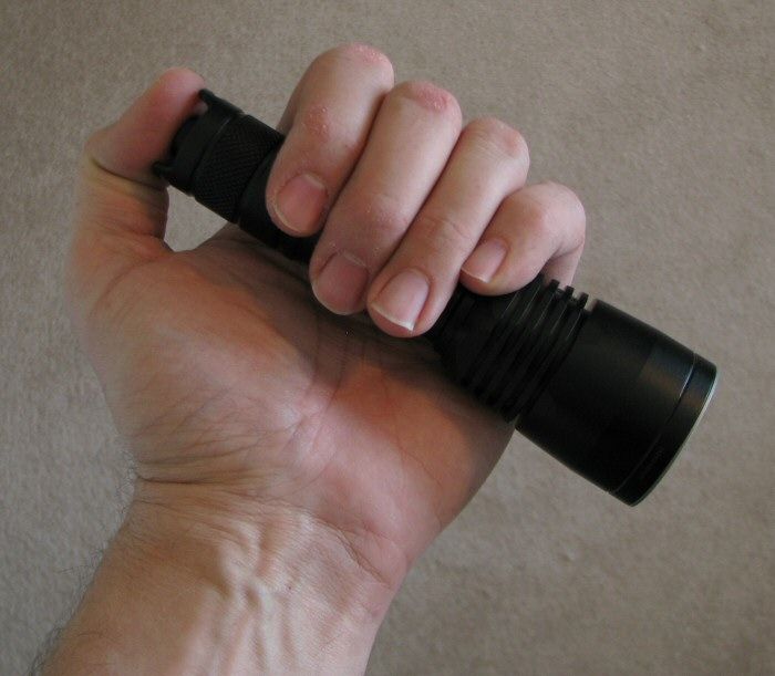

    Nitecore Chameleon CR6/CG6/CB6: Weight: 156.3g, Length: 143.4mm, Width (bezel): 40.1mm
    Sunwayman V25C: Weight: 117.3g, Length: 134.9mm, Width (bezel): 32.1mm
    Foursevens MMX: Weight 145.8g, Length: 153.3mm, Width (bezel): 38.7mm Skilhunt S2: Weight: 133.0g, Length 153.0mm, Width: 36.0mm
    Olight M22: Weight: 148.4g, Length: 144.8mm, Width: 41.2mm (bezel)
    Olight M21: Weight 119.5g, Length 145.2mm, Width 38.5mm (bezel)
    Flashlight anodizing is a matte black, like most recent Nitecore lights. No anodizing chips on my samples, quality looks good. Labels are bright white, clearly legible against the dark background. All models have identical styling with knurling across the tailcap and the body. Note that knurling is not particularly aggressive, and doesn't provide that much extra grip. But with the various styling elements, I would say grip is pretty good.

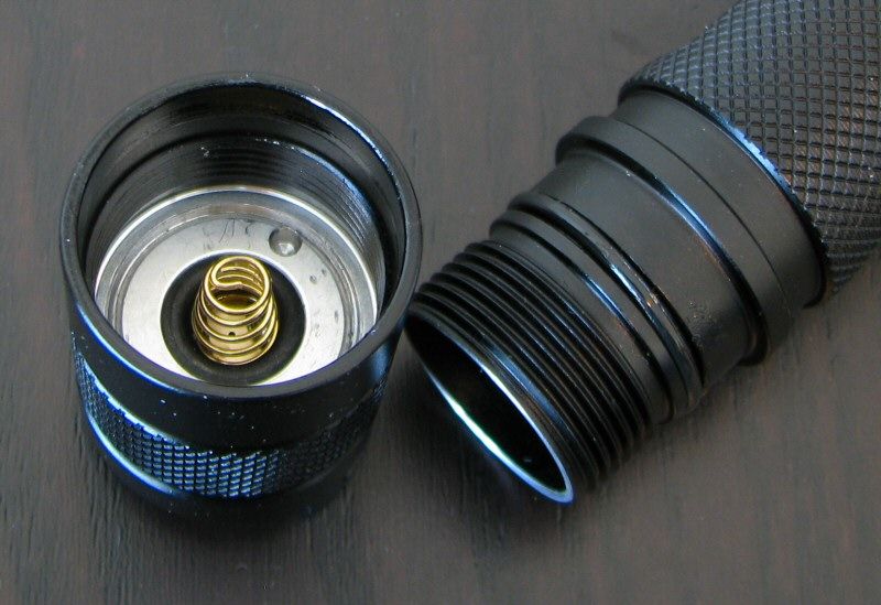

    All models have a spring-mounted contact plate in the head, with a physical reverse polarity feature. This means that flat-top cells can't be used in the light, only those with small button tops. The extra spring should make for pretty good recoil resistance (i.e., contact shouldn't cut-out under rapid shifts).

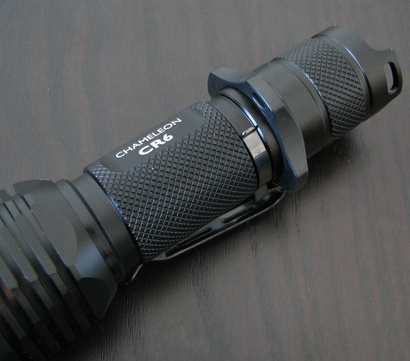

    All lights come with the same removable pocket clip, which is of a fairly standard clip-on variety (i.e., similar to the earlier Nitecore lights). One comment here is that it may be a hard to clip unto a belt in the head-down orientation (due to the relatively wide head compared to the body). But you can install the clip in a head-up orientation as well.
    The removable grip ring is made of plastic, and spins freely on the light. It is only when you have the tailcap fully screwed down that it is held in place.
    Screw threads are standard triangular cut, and seem of good quality. They are also anodized at the tail region for lock-out. Rear tail switch is a forward clicky, with traditional feel.
    Lights can tailstand, but may be a bit wobbly (due to the partial raised areas for the lanyard attachment on the tailcap).

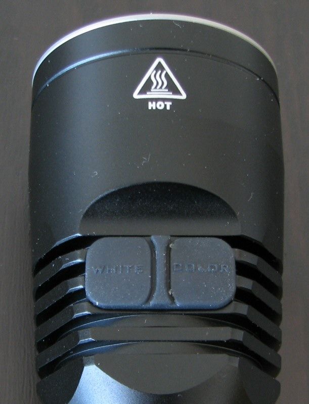

    There are two secondary electronic control switches in the head, labeled "WHITE" and "COLOR". These allow independent control of the white and colored emitters, respectively (see my User Interface section below for more info). Note that similar to some other Nitecore lights, there is blue LED under the switches that will illuminate to warn you when the batteries are running low (located in the middle, between the switches).

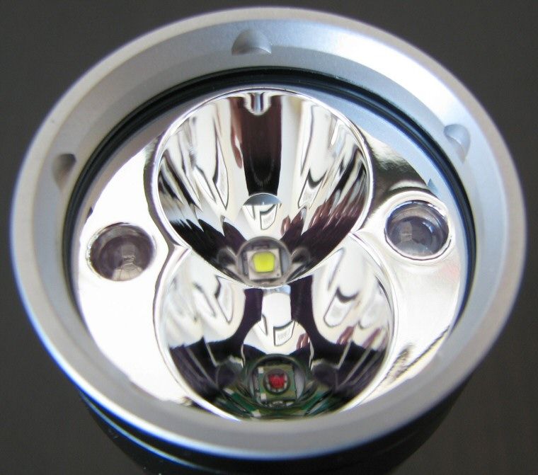

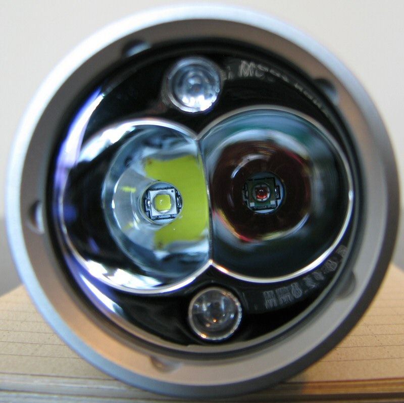

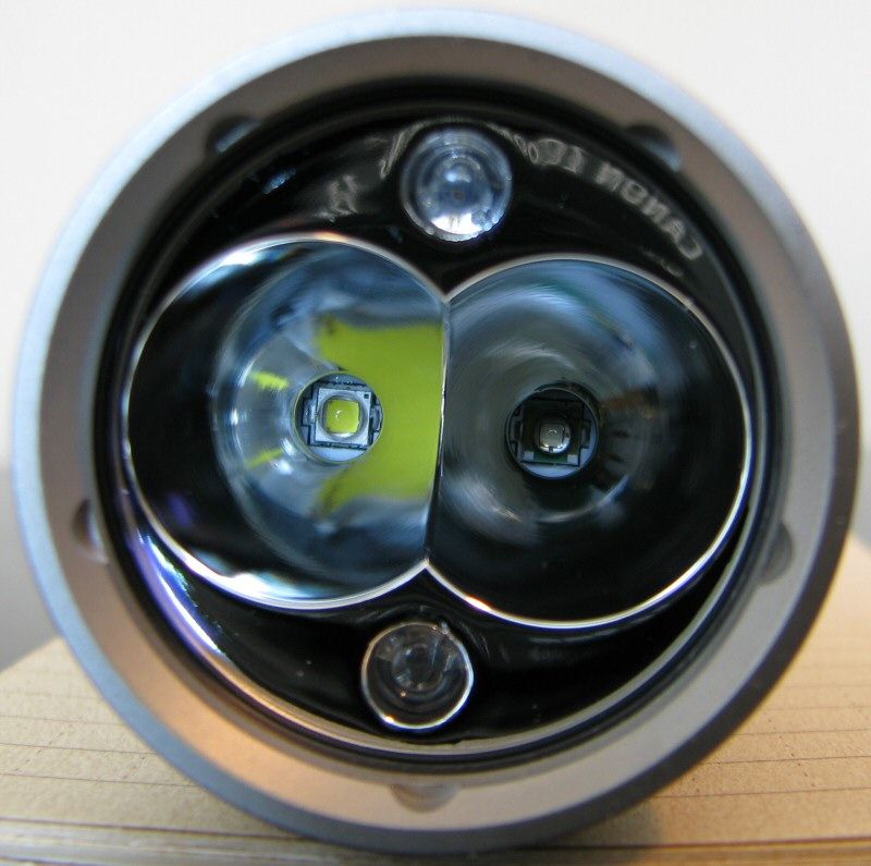

    Let's take a look at the emitters …
    CR6:
    CG6/CB6:

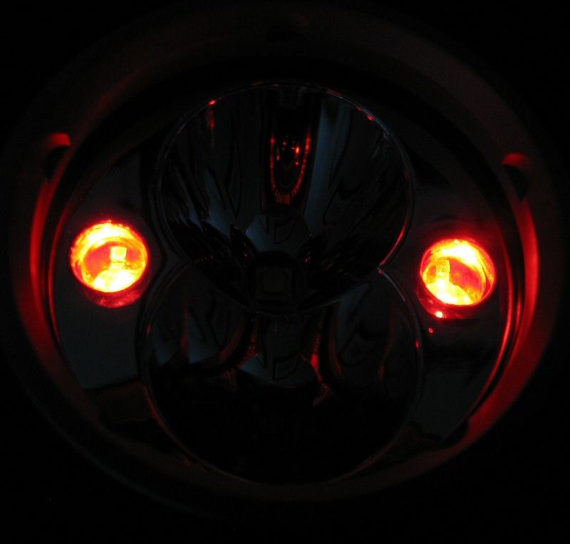

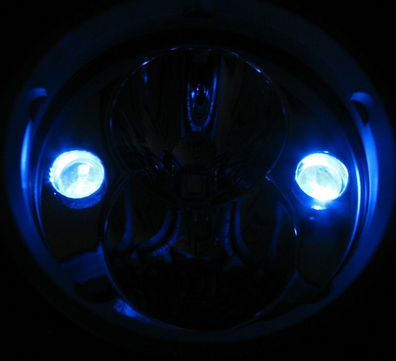

    The main emitters sit it two over-lapping wells (both smooth finish, and fairly shallow). On one side is the main XP-G2 white emitter, on the other is the dedicated colored XP-E emitter. The CB6/CG6 look the same, as these colored XP-Es don't look visibly different when the power is off. The red XP-E on the CR6 has a noticeable red dome.

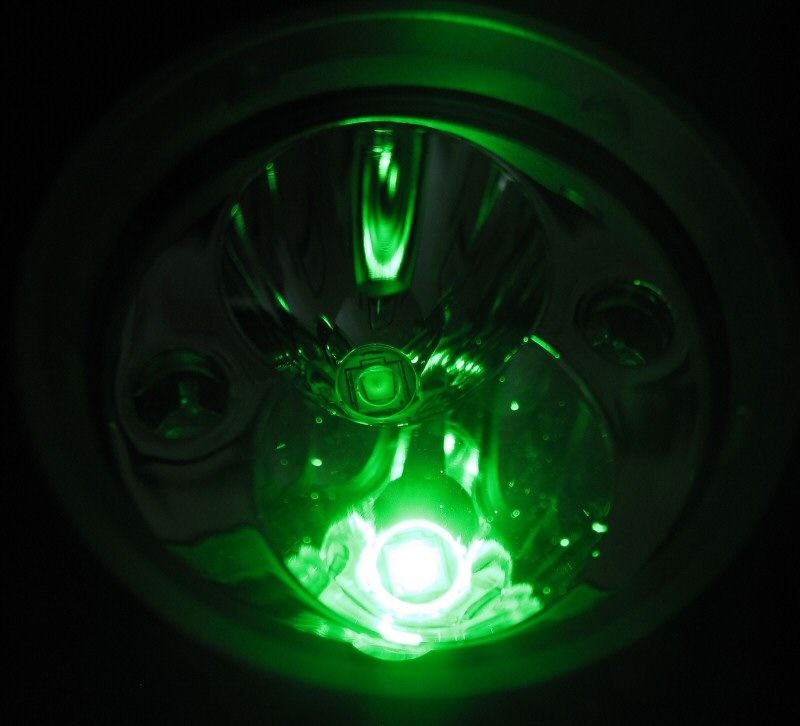

    Outside of the main emitter wells, there are two secondary 5mm LED. These are capable of producing red, green, and blue light (although at a single, much lower output than the single dedicated colored emitter). Expect to see considerable beam artifacts on these 5mm LEDs, as usual.
    As you might expect, the overlapping wells for the two primary emitters should have an interesting effect on the beam profile. Scroll down for beamshots and a discussion.

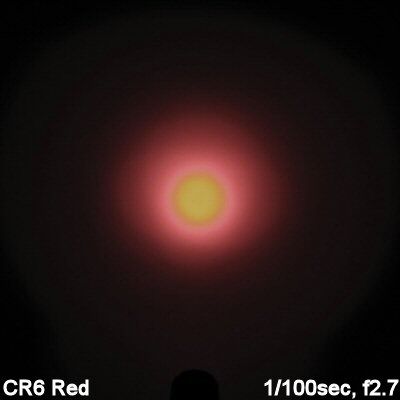

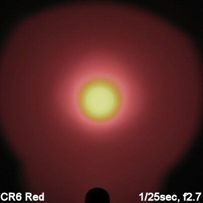

    CR6 Red XP-E:

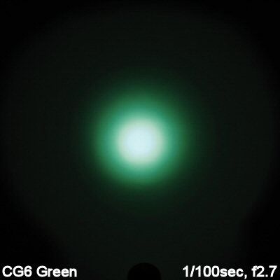

    CG6 Green XP-E:

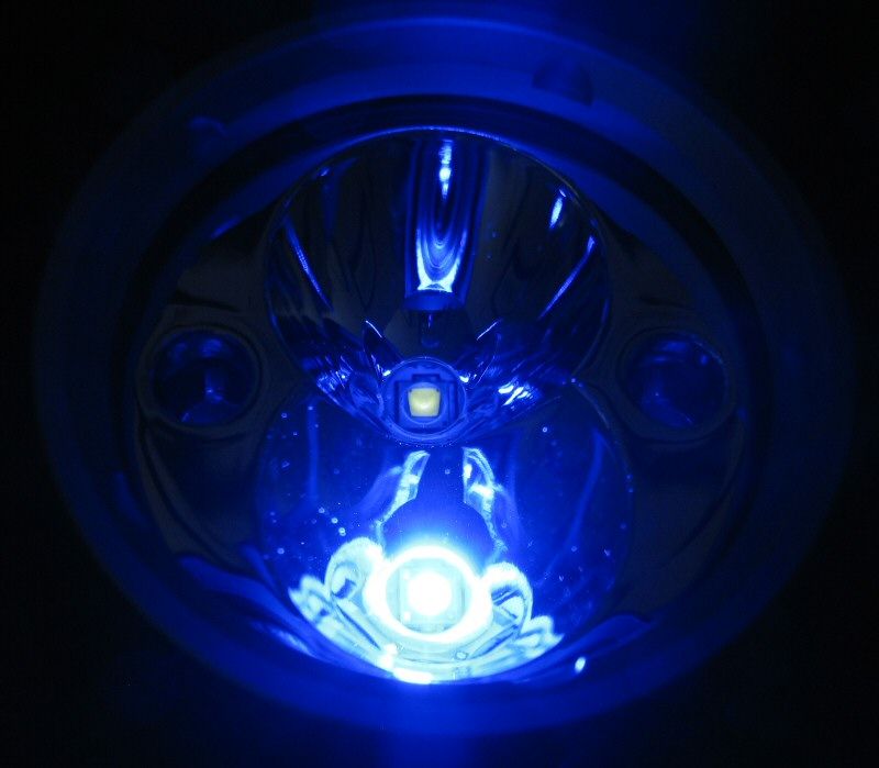

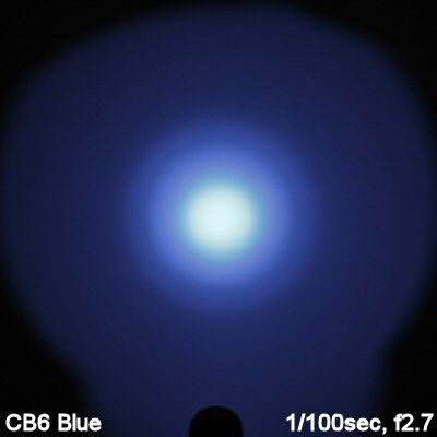

    CB6 Blue XP-E:

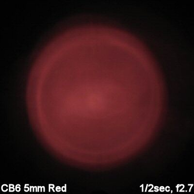

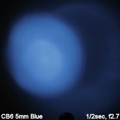

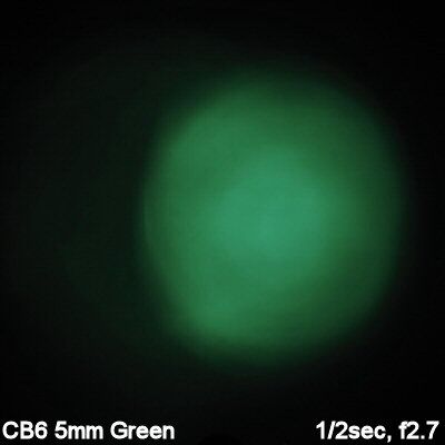

    And now the 5mm LEDs:
    CR6/CG5/CB6 Red 5mm:

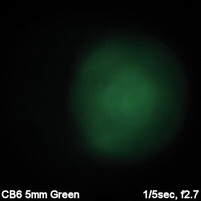

    CR6/CG5/CB6 Green 5mm:
    CR6/CG5/CB6 Blue 5mm:

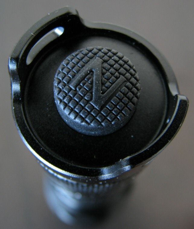

    Turn the light on by forward tailcap clicky - press and release for momentary on, click for locked on.
    Emitter choice and output mode level are controlled by the two electronic side switches in the head. The light has mode memory and comes back on in whatever level you last left it.
    Click the left-mode WHITE button to activate the XP-G2 white output modes. Mode sequence is Lower > Lo > Med > Hi > Turbo, in repeating sequence.
    Click the right-mode COLOR button to activate the colored XP-E and colored 5mm emitters. Mode sequence is XP-E Lo > XP-E Med > XP-E Hi > 5mm Red > 5mm Green > 5mm Blue, in repeating sequence.
    Press and hold either mode switch to activate the blinking modes for those emitters. For the WHITE button, that will give a high frequency Strobe mode. Press and hold again for Beacon mode. Press and hold again for SOS mode. Click at any time to return to the constant output modes. Note there is mode memory for the Strobe mode only (otherwise, the constant output mode is memorized).
    For the COLOR button, press and hold for "police strobe" (i.e., alternating red and blue blinking of the 5mm emitters). Note that is may not be permissible for you to use this sort of strobe publicly in your local area (i.e., a lot of municipalities have restrictions on the use of emergency signals, and may not have much of a sense of humor about attempts to imitate police officers). There is no mode memory here.
    Finally, there is an option to jump to Turbo white output from off, regardless of the memorized state. Simply hold down the WHITE secondary button when you click on at the tailcap.
    Note as well that there is a low voltage indicator located underneath the side switches. This functions to alert you as the cells are running low, and worked on both 18650 and CR123A in my testing.

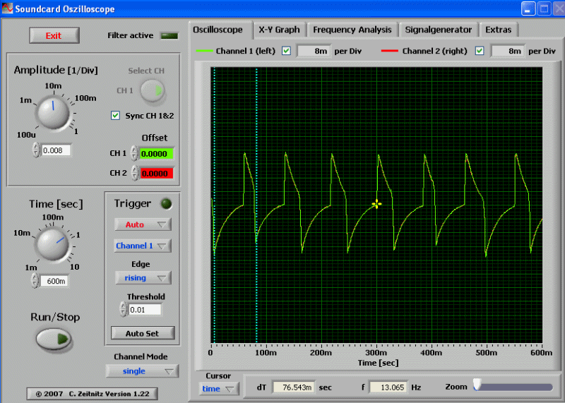

    The Chameleon series lights are current-controlled, on all levels (i.e., no PWM). 
    That said, I did detect some consistent high-frequency noise on Lo/Med/Hi of the white XP-G2 (but not the Lower/Turbo), as well as the all three modes of the colored XP-E (Lo/Med/Hi).
    Noise:
    In all cases, this signal had a consistent 4kHz frequency. At NO point did this signal become visible (i.e., you cannot see it by eye, even when shining on a fan). Again, it is most definitely not PWM, and I doubt anyone will be able to detect this without an oscilloscope. But consistent with my review standards, I report on anything that I can measure.
    Rest assured, it is not visible, and not a concern in actual use.

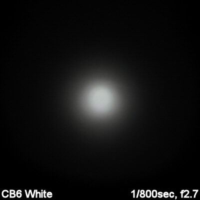

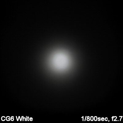

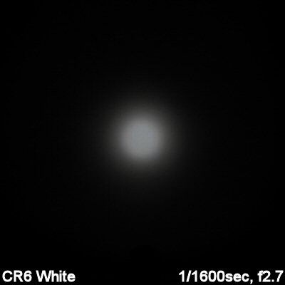

    For white-wall beamshots below, all lights are on Max output on an AW protected 18650 battery. Unless specified otherwieser, all lights are about ~0.75 meter from a white wall (with the camera ~1.25 meters back from the wall). Automatic white balance on the camera, to minimize tint differences.

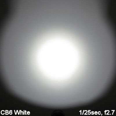

    Let's start with a comparison of the XP-G2 white emitter on all three models:
    As you can see, there's no real difference between my three samples – as you would expect given the common specs.

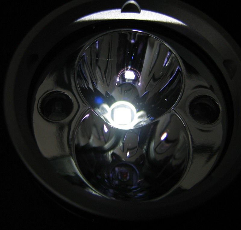

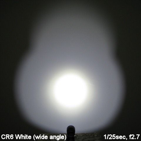

    But you may have noticed something odd about the spillbeam. Let's take a pic with the camera further back:
    As you can see, there is an elongate spill into a small "bubble" just above the main spillbeam in the photo above. This is due to some of the white light emitted by the XP-G2 being picked up in the reflector around the red XP-E emitter on the sample above.

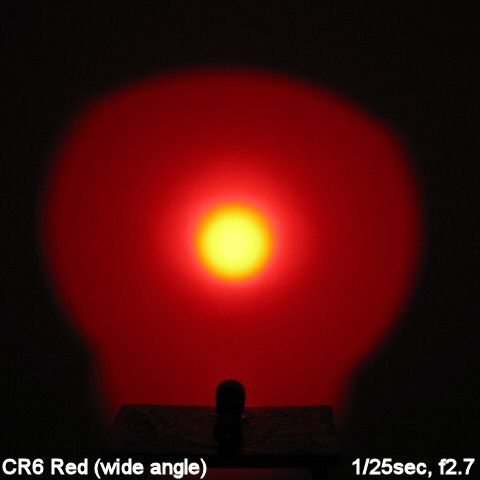

    As you can see, the matching effect occurs if you activate the red emitter:
    This is an unavoidable effect of the overlapping emitter design for the two primary emitters. However, in real life, it is not so noticeable as it only effects the spill.
    Let's continue with our comparisons ...

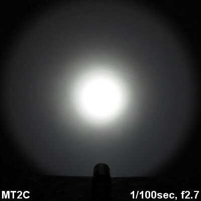

    White wall beamshot comparisons (XP-G2 emitter):
    Beam profile is about what you would expect for a XP-G2 white emitter, with a relatively small reflector well. Overall pattern is not that different from the MT2C.

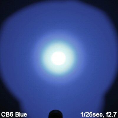

    XP-E R/G/B emitters on CR6/CG6/CB6:
    Note: At this close-range, my camera is over-saturated at long exposures. In real life, the beams are a consistently solid color. Also, the beam tints are somewhat off here, due to the automatic white balance and saturation settings of my camera. Please don't rely on them for tint estimation.
    Again, the saturation levels above are all off - all three colors are rich, bright and vibrant in real life.
    Also - as previously mentioned - Nitecore provides bin information for each emitter (Red R2, Green G2, and Blue D4), so you can track down the specific wavelengths. According to the Cree XP Family Binning document, that should mean the red is 620-625nm, the green is 520-525nm, and the "royal blue" would be between 455 to 460nm.
    Nitecore output specs are consistent with the Cree product information .... but an interesting point to note above: while the blue beam of the CB6 looks brighter than the other two colors with the camera, all light meters (and the Cree/Nitecore specs) report much lower values for the blue XP-E. As you will see in my detailed tables below, my calibrated lightbox sensor is reasonably consistent with the Nitecore/Cree specs (and reports much lower output levels on blue). But my NIST-certified lux meter gives ridiculously low values for throw and ceiling bounce on blue, so I have opted not to present them below.
    This is a good point to keep in mind – light meters are not equally sensitive across the spectrum of colors.

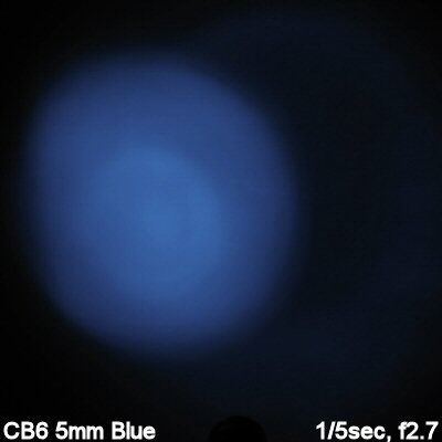

    5mm R/G/B emitters:
    Note: I am using a longer exposure here, to show you the beam profiles better. The 5mm emitters are much dimmer than the XP-E emitters shown above.
    As expected, the 5mm LEDs have a lot of artifacts. You can also see they have a relative positioning difference (i.e., the red is in the center of the frame, the green is on the right, and the blue is on the left). This likely reflects the positioning of the die sources in the emitters.
    As I mentioned previously, light meters are not equally sensitive across the color spectrum. Consistent with Nitecore specs, my lightbox sensor gives lower output readings for the blue XP-E, compare to red or green. My NIST-certified lux meter gave ridiculously low values, so I didn't bother presenting them above. In real life, I don't find much of an actual output difference between the 3 colored models … but that's hard to quantify, obviously. The wall beamshot photos earlier in this review probably give the best indication of what to expect.

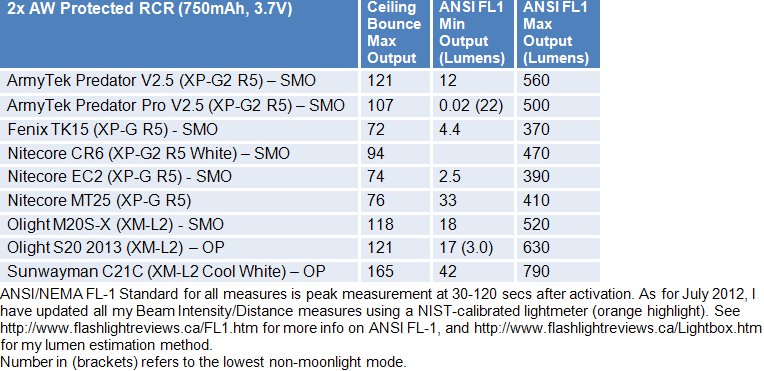

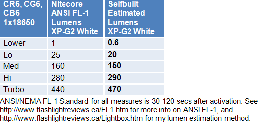

    Let's see how all the output levels do, against the Nitecore specs:
    I have pretty good concordance between my calibrated lumen estimates (from my lightbox) and the official Nitecore specs.

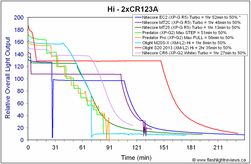

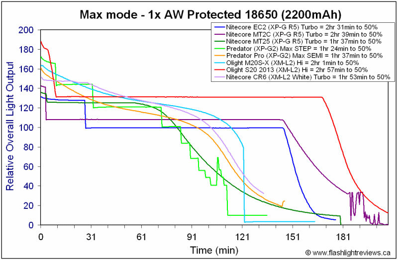

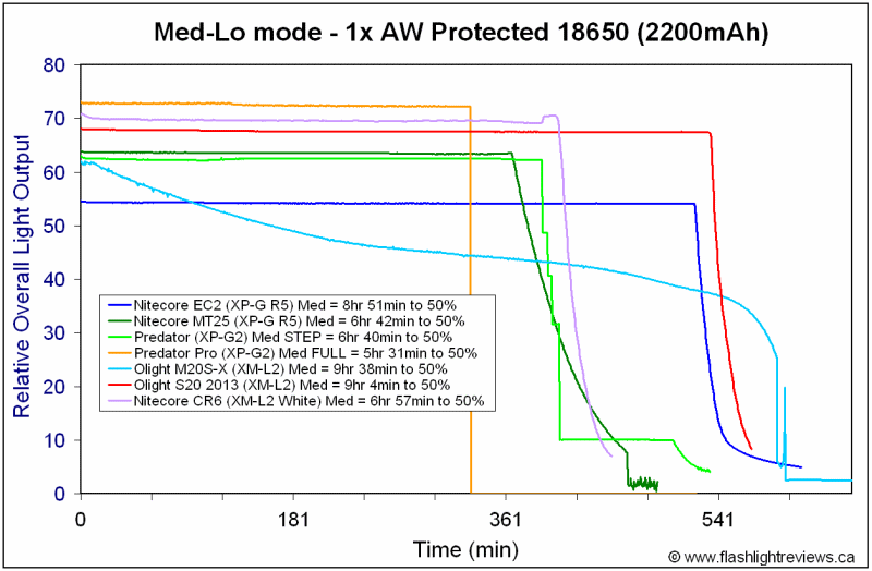

    Output/Runtime Graphs:
    Let's start with the comparison of the main emitters:
    Again, take the relative output levels of the colored XP-E samples on the 3 models with a grain of salt – I tend not to trust the sensitivity of any light sensor for such widely separate and defined wavelengths.
    But the above graph does give you an idea of what to expect for runtime and regulation. As you can see, there is a variable period of flat regulation in all cases, followed by a very gradual drop-off.
    And now the XP-G2 white emitter against the competition:
    No surprises on 18650 - this is what you would expect for a good current-controlled XP-G2 light with defined levels.
    There is an interesting slight step-down on both 2xRCR and 2xCR123A over time. But again, it is gradual enough that you would not be able to notice it in real life. Overall efficiency remains excellent for the class.

    Pocket clip is pretty basic, and not very useful as a clip in the head-down confirguation (given the fat head of the Chameleon series). Does help as an anti-roll device, though.
    Flat-top cells can't be used in the light.

    Default Re: Nitecore Chameleon Series CR6 CG6 CB6 (XP-G2, XP-E, 5mm - 18650) Review: BEAMS, R
    CU Series "Firefly" mode.
    On a German forum somebody has found an interesting "ultra low" mode that can be switched on as follows:
    - Switch on with tails switch while holding the right "Color" button.
    - Press the left "White" button once
    The white LED now lights up at an extremely low "firefly" level.
    Kudos to the guy in this forum : http://www.taschenlampen-forum.de/ni...chameleon.html
    6,936
    Quote Originally Posted by hikanio View Post
    Confirmed, that works on all my samples as well.
    The output level is indeed ridiculously low. I don't have a calibration that low for my lightbox, as it reads <0.01 lumens. You can stare into the beam quite comfortably.
    FYI, there is also mode memory for this level - if you turn the light off and back on by the tailswitch, it returns to it. So this means that you can set it up in advance. Cool find, thanks for sharing!

    Has anyone swapped out the tail cap ? it is a surefire / soalrforce / jetbeam thread. i bust my plastic cigar ring and wanted more space on the tube so i have ordered a solarforce L2-S8 switch which i think will give a nice flashlight feel and a stable tailstand too.
    Jun 2014
    CT
    553
    Both my C2 and RRT26 tail caps fit, same thread, but do not work. I think the RRT26 is to deep I don't know why the C2 doesn't.
    Jan 2009
    UK
    1,075
    Quote Originally Posted by Taz80 View Post
    strange ? i seem to be able to run anything .
