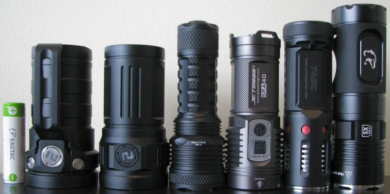

    From left to right: Eagletac Protected 18650 3400mAh; Niwalker MiniMax Nova MM15 prototype #2, prototype #1; Foursevens MMU-X3; Jetbeam SRA-40; Sunwayman T45C; Eagletac SX25L3.
    MiniMax Nova MM15 Prototype #2: Weight (with handle): 332.7g (516g with 4x18650), Length: 115.3mm, Weight (bezel): 60.7mm
    MiniMax Nova MM15 Prototype #1: Weight: 268.3g (452g with 4x18650), Length: 114.0mm, Weight (bezel): 58.0mm
    Eagletac SX25L3 3x18650: Weight: 315.9g, Length: 150.2mm, Weight (bezel): 47.0mm
    [Crelant 7G10: Weight 643.4g (827g with 4x18650), Length: 198mm, Width (bezel): 79.0mm
    Nitecore TM11: Weight: 342.6g (476g with 8xCR123A), Length 135.3mm, Width (bezel): 59.5mm
    Niwalker BK-FA01: Weight: 687.6g (870g with 4x18650), Length: 209mm, Width (bezel): 80.0mm, Width (tailcap): 50.3mm
    As before, the MiniMax is the smallest 4x18650 light I've tested to date – compare it to Nitecore TM11 to get an idea.

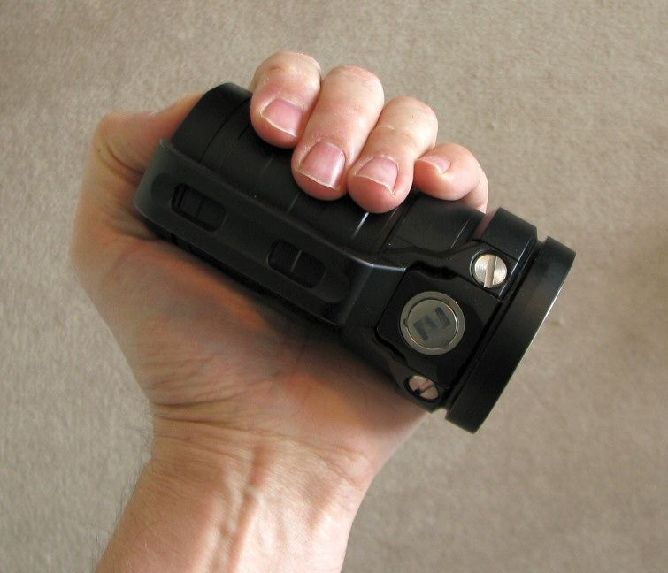

    I said it on the first prototype review, and I'll say it again – this is a remarkably tiny light!
    Exterior styling has been updated, but overall size and dimensions are not very different. The head is slightly wider at the top, and the light is slightly longer – but only by a millimeter or two in each direction. Anodizing is a black matte finish (presumed to be HA), and is in good shape on my samples (except for the screw threads, see below). There was still no labeling on my second prototype sample.

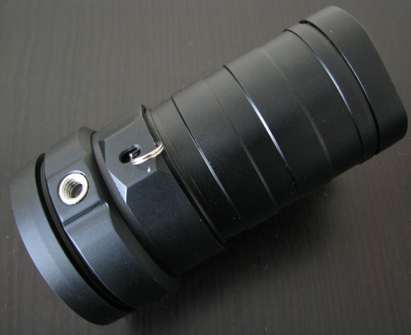

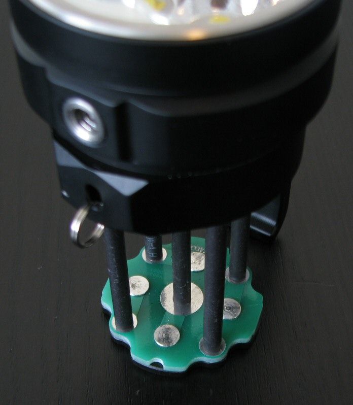

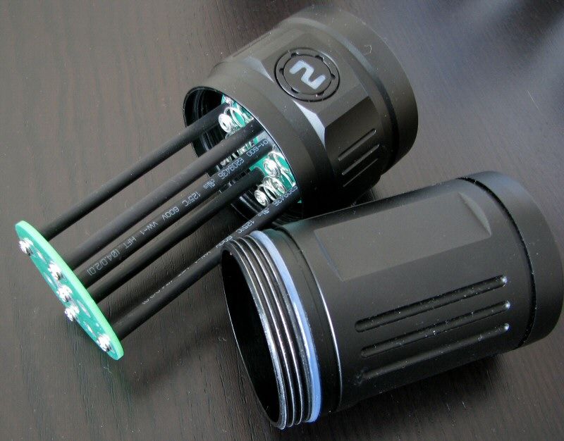

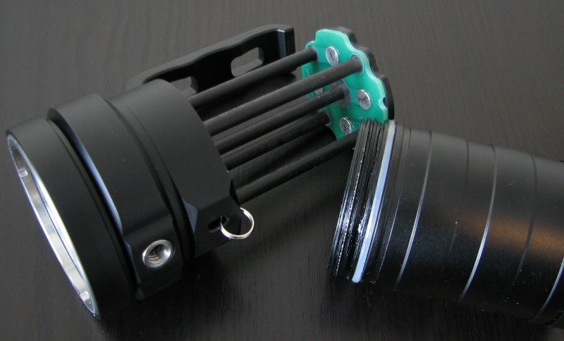

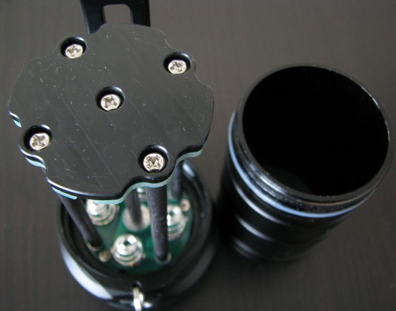

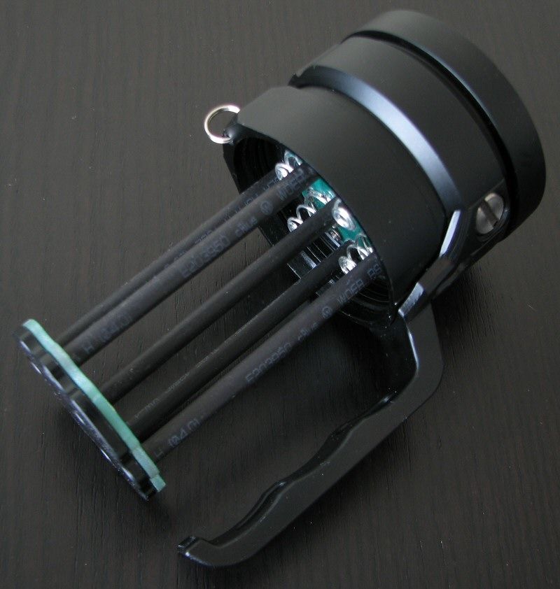

    The integrated battery carrier has been updated slightly, and there is now a protecting piece of plastic at the end of the exposed carrier end plate. Height of the built-in carrier appears to have been increased slightly, as it is now a bit easier to insert longer 18650 cells (the original carrier was very tight for length). That said, you may still find longer or wider high-capacity 18650s a bit of a challenge in this light.
    As before, the four 18650 cells are in series, not parallel (i.e., 4s1p). There have been some circuit updates however, so please see my analysis below for user interface changes and standby drain/lockout.

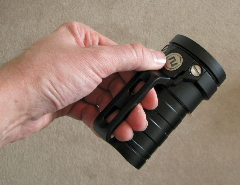

    As before, the body's aluminum handle is really just a protective cover - you can run the light without it. Threading is unchanged from first prototype – square-cut threads, but with worn anodizing. Of course, that doesn't matter, since there is no current passing through the body cover.

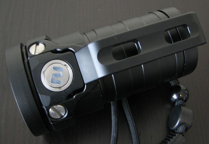

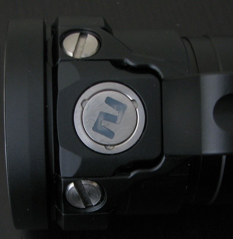

    The head region has been re-designed, and is better organized. The switch is located directly in front of the handle, with a revised button cover (it now appears to be made of stainless steel). The center "N" logo is raised with a "grippier" texture. Switch traverse/feel is pretty much unchanged, and about typical for an electronic switch. The tripod attachment point has been move to directly opposite the switch on the head.

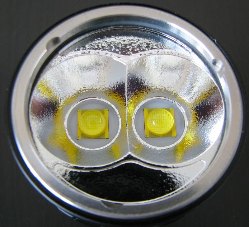

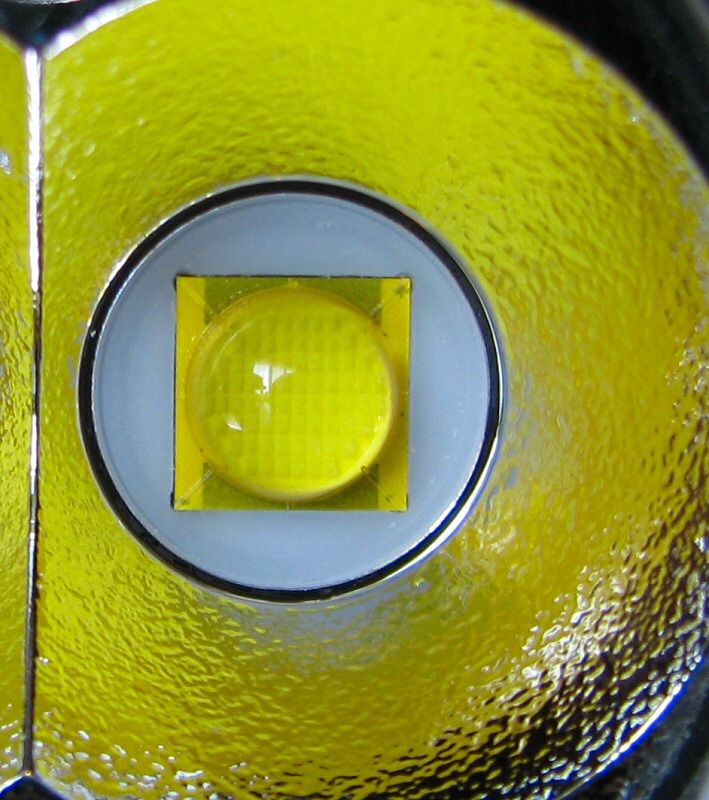

    As before, the MiniMax runs off two MT-G2 emitters in relatively shallow reflector wells. The main difference now is that the reflector is more of a "light orange peel (LOP)" finish, compared to the heavily textured earlier prototype. This has not appreciably changed the beam – it is still very much a flood light (scroll down for beam shots).
    A stainless steel bezel ring has replaced the previous black (presumably aluminum) one.

    As before, turn the light on/off by the electronic switch. There is no momentary mode – once you release the switch, the light comes on in constant output.
    Previously, the light always comes on in Hi mode first – the new prototype has mode memory (for the regular non-Turbo modes). It also has one additional regular mode, intermediate in output from the previous Hi and Turbo levels (I call this level "Higher" in my assessments below). This nicely fills in a gap that I felt was missing in the original prototype.
    As before, press and hold the switch to cycle through all the modes in sequence: Moonlight > Lo > Med > Hi > Higher (i.e., there are now 5 regular levels, up from 4 previously). Release the switch to select the desired level. Note that that you can now restart the level ramp at any time (previously, you could only activate it once while the light was on). But as before, Turbo is not available on the regular mode sequence.
    As before, double-click from On to access Turbo. Double-click again for strobe. Another double-click brings you to SOS (new on the second prototype). Note there is no mode memory for Turbo or the strobe modes.
    There is now a lock-out mode, accessed by a rapid triple-click of the switch from off. The two MT-G2 emitters will flash twice to indicate the lock-out is engaged. Another triple-click re-activates.
    Also new on this sample is a standby indicator that flashes when the batteries are connect but the light is not on. A brief green flash of the switch occurs every four seconds.
    As before, the switch "N" logo lights up green when in use. The N changes to red as the cells near exhaustion – this is a warning to switch down to a lower level, as the light will shut-off automatically soon (due to an internal shut-down feature in the circuit). I provide details on this in my testing below. You can re-activate after the light shuts down, by pulling one of the cells out and re-installing.

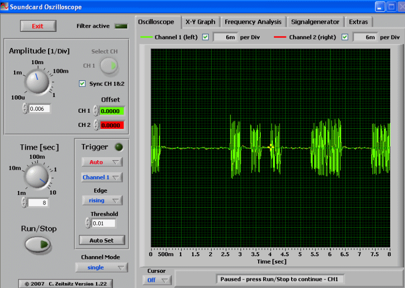

    PWM/Strobe
    As before, there is no sign of PWM that I can see, at any output level – I believe the MiniMax is current-controlled.
    However, I did detect high frequency noise with my oscilloscope on some modes (Lo through Higher – but not Moonlight or Turbo) – consistent with the earlier prototype.
    Noise:
    The frequency was extremely high – about 21kHz (up from 14 kHz on the first prototype sample). Either way, neither of these signals are visible to the eye in actual use. Rest assured, the light is fully flicker-free in all modes.

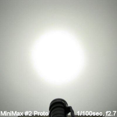

    As before, the MiniMax has an unbelievable amount of output on Turbo. Hard to directly compare, but my ceiling bounce results tell me that the second prototype is slightly brighter than the first. Scroll down for my detailed tables and assessments.
    But first, here are some indoor shots in a basement, to allow you to better compare. For your reference, the back of the couch is about 7 feet away (~2.3m) from the opening of the light, and the far wall is about 18 feet away (~5.9m). Below I am showing a couple of exposures, to allow you to better compare hotspot and spill. And again, the camera is set to a Daylight white balance for all lights below.
    Again, these are all done with a Daylight white balance, in better show tint differences. But a single white balance will never capture the true difference between lights – in practice, the X6 is not that cool, and the Minimaxes are not that warm.
    As with the white wall beamshots, the second MiniMax prototype seems to be slightly more "throwy" than the first – but it's not really noticeable in real life, even with the lights side by side. Rest assured, this is still a pure flood light. Scroll down for actual output and throw measures.
    Outdoor beamshots aren't possible right now, given the several feet of snow on the ground around here. But for your reference, here are the outdoor beamshots taken from my original prototype review. As always, these are done in the style of my earlier 100-yard round-up review. Please see that thread for a discussion of the topography (i.e. the road dips in the distance, to better show you the corona in the mid-ground).
    Given that this location was picked to illustrate relative throw (which the MiniMax is not designed for), it doesn't really capture the overall brightness of this light very well – recommend you stick with the indoor basement shots for now.
    That said, you can get a few hints of its relative brightness if you examine the far right end of the zoomed-out shots above (i.e., the tree line in the distance on the right). Depending on your monitor calibration, you may be able to faintly make the trees there (which are more than 100 yards away). You'll note how much hard it is to see these on the comparator SX25L3 or X6.

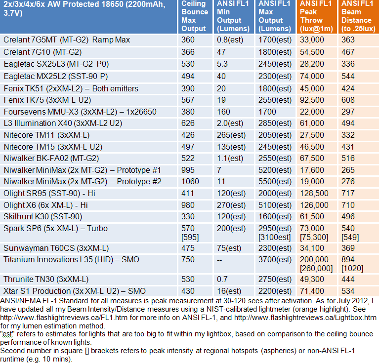

    Since my high-output lights don't fit in my lightbox, I am really relying on my ceiling bounce measures here. The second MiniMax prototype manages to squeeze out a few more lumens than my original sample – a very impressive ~5500 lumens in my testing
    Throw remains definitely pretty minimal, given the overall output of the MiniMax. As always, the MT-G2 produces a very smooth beam profile.

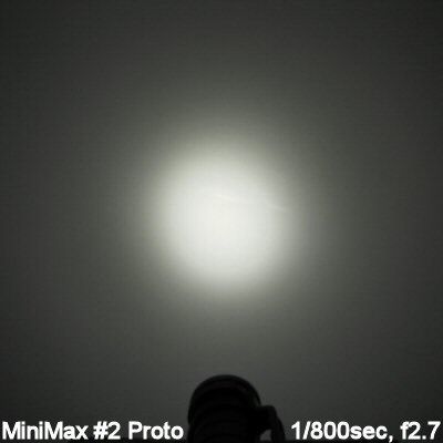

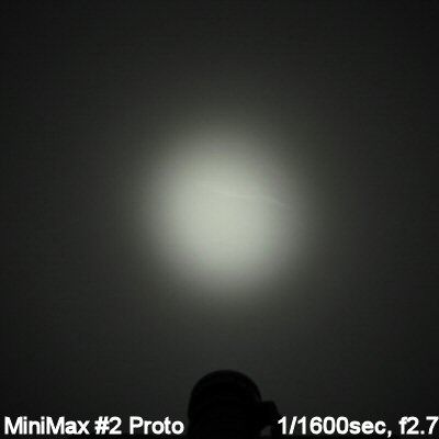

    Let's see how the rest of the output levels compare, between the two prototypes:
    Again, take these with a bit grain salt, given my limited ability to measure output on these lights. But it gives you a general idea of spacing. As you can see, Niwalker added a fifth regular mode (which I am calling "Higher" above). This is the intermediate output level I recommended on my initial prototype review.

    • Selfbuilt Recommendation #6: External build issues: the switch is hard to find by touch alone, the tripod mount should be moved opposite to the switch, and some sort of lanyard/carry device should be added.
    • Check, check and check. The switch now has a metal finish (making it easier to see), with a raised rubberized logo (making it easier to find by touch). The tripod mount has been moved directly opposite. A removable handle (held by screws) has been added, with a split-ring and wrist lanyard attachment on the opposite side. The handle also helps you locate the switch easier (i.e., located right at the head).
    • Selfbuilt Recommendation #7: This wasn't an official recommendation, but I did note in my internal build overview that the integrated carrier was very tight for 18650 cell length, and had exposed contacts on the end plate.
    • Check. Niwalker has extended the length of the carrier slightly (although longer cells are still a relatively tight fit). There is also an additional piece of plastic protecting the end plate of the carrier.

    Your "From left to right" lists different lights than the ones pictured.

    What gets me is the 'higher' mode, if I'm reading the graph correctly it shows 2000 dropping slowly to 1500 for 5 hours on 4x 2200mah 18650s. That's equivalent to 1700+ lumens average for 1hr 15 minutes on a single 2200mah 18650, which would suggest 1700+ for nearly 2 hours on a 3400mah NCR18650b.
    That's more than double the typical performance of a single 18650 XM-L/XM-L2 light.
    Sorry about that - fixed.

    Ah yes, I forgot to mention this in the review - the reflector cups have been rotated 90-degrees (relative to the button) from the first prototype to the second. This does make more intuitive sense, given how people carry lights with the button straight up.

    What gets me is the 'higher' mode, if I'm reading the graph correctly it shows 2000 dropping slowly to 1500 for 5 hours on 4x 2200mah 18650s. That's equivalent to 1700+ lumens average for 1hr 15 minutes on a single 2200mah 18650, which would suggest 1700+ for nearly 2 hours on a 3400mah NCR18650b. That's more than double the typical performance of a single 18650 XM-L/XM-L2 light.
    Yes, I must say I was surprised by this result as well. It is a remarkably good showing on the Med/Hi/Higher settings. In addition to the circuit updates, I'm thinking these are probably top-line output bins on this sample as well.
    Also, I should mention that my runtime data is collected in a lightbox that isn't fully calibrated for most of the high-output lights. I am pretty confident about my ANSI FL-1 lumen estimates for this light (at least in terms of how they compare in relative terms to other lights I've tested - keep in mind my estimates are all relative). But because the light doesn't physicially fit fully inside my lightbox, the "decay pattern" over time may not be entirely accurate.
    For a typical small light that fits inside my lightbox, I know this calibration is consistent across the whole run. But for larger high-output lights that don't fit, it's possible that the relative values are not entirely consistent from each other (due to an inconsistent amount of partial light making it in, depending the reflector design). I could only test this by stopping the runs at a certain points and immediately re-doing the ceiling bounces for each light (but that would interupt the runtimes). I haven't done that to date, because most of them seem to match about what you expect. But it's always possible that this light (with it's very distinctive floody beam) is not entirely consistent with most of the other over-sized lights I've tested.
    In any case, I expect the above would only be a minor contribution to any discrepancy.
    Default Re: Niwalker MiniMax Nova MM15 (2xMT-G2, 4x18650) REVISED Prototype Review: RUNTIMES+
    That's an interesting idea. I can understand how this could lead to inconsistencies between lights with different beam profiles, but surely the same light over time maintains the same beam profile (and therefore % of beam getting inside the box) and so the runtime graph should be correct at least in terms of proportional output from start to finish?
    Also, I would expect a floodier light would mean less getting into the box if the head isn't fully inside, so shouldn't that disadvantage the MM15 rather than the opposite? But maybe I'm imagining the set-up wrong.

    Quote Originally Posted by RedForest UK View Post
    In general terms yes ... but since the calibration is based on a non-linear power conversion of output measures from inside the lightbox, I can't be completely sure it applies equally to all lights partially outside. But it's something of an esoteric point - it really shouldn't make much of a difference since the initial point is calibrated, and the light doesn't move during testing. I was just musing out-loud. End of the day, the runtimes should be a pretty good representation of what is going on over time.
    That is adorable.
    It is interesting how part of the handle nearest the switch and 2 holding screws appears flush against the body of the light. Is that to "collect" heat and use handle as a heat sink? If not, it would seem to me possible to place some spacers where the screws go in, with handle attaching above the spacers. This would give more clearance for larger hands.
    Dave
    6,936
    Quote Originally Posted by hikingman View Post
    The handle attachment is flush with the head, so it would stick out if you added a spacer. I haven't checked the length tolerances of the screws, so not sure how much play you would have here. Simplest thing would be for Niwalker to build in the extra clearance.
    Screws have to fit fully into because impermeability, is right? Or their holes are sealed at the end?
    Jul 2009
    Illinois
    2,327
    Quote Originally Posted by weekend warrior View Post
    That is adorable.
    Yes! I like that little handle.
    mee too
    According to a review on a German forum they have already committed to building in that extra clearance for the final production model
    6,936
    That's good to hear. I've also heard from another member on that forum that apparently beacon mode will be added to the final shipping version.
    I've asked Niwalker for confirmation of these changes (plus whatever else might be in the works). I will let you know when I hear back.
