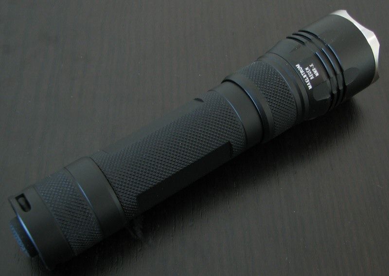

    Foursevens has sent me their first integrated in-light charging 18650 model, the Maelstrom Regen MMR-X (XM-L2). The MMR-X features a number of selectable output modes, and USB charging for its custom 18650 cell.
    As always, let's see what the official specs have to say ...

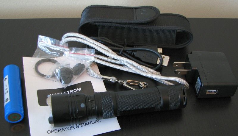

    Packaging is the new presentation-style Foursevens display box. Inside, included with the light and custom 18650 are spare O-rings, good quality lanyard, holster, micro-USB charging cable, USB-AC adapter, spare forward clicky switch boot cover, spare reverse-clicky switch and low-profile boot cover, flat black aluminum bezel, and manual.

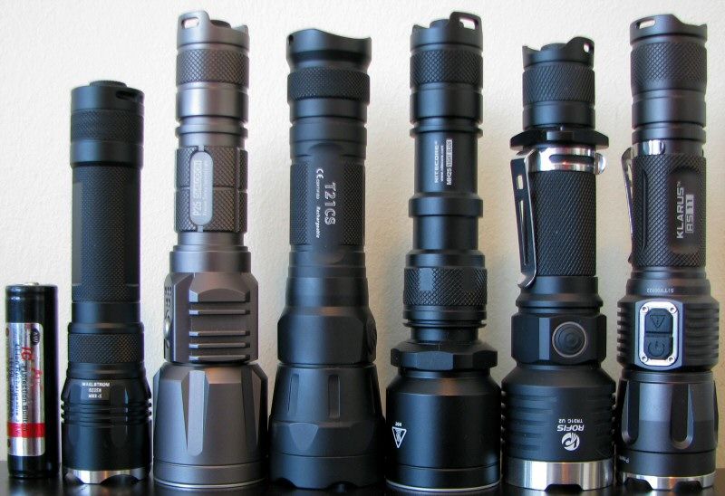

    From left to right: AW Protected 18650 2300mAh; Foursevens MMR-X; Nitecore P25; Sunwayman T21CS; Nitecore MH25; Rofis TR31C; Klarus RS11.
    Foursevens MMR-X: Weight 90.8g, Weight (with 18650): 138.5g, Length: 138.6mm, Width (bezel): 31.5mm
    Foursevens MMX: Weight 145.8g, Length: 153.3mm, Width (bezel): 38.7mm
    Nitecore P25: Weight: 171.3g, Length: 160mm, Width (bezel): 40.0m
    Olight M20S-X: Weight: 124.1g, Length: 145.4mm, Width: 35.5mm (head)
    Klarus RS11: Weight 158.0g, Length: 160mm, Width (bezel) 34.9mm
    Rofis TR31C: Weight: 180.7g, Length: 153.0mm, Width (bezel): 39.8mm

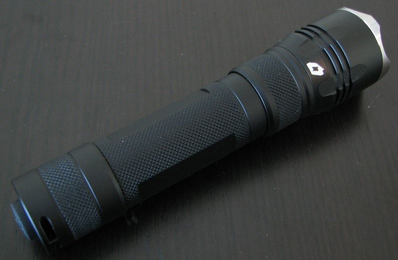

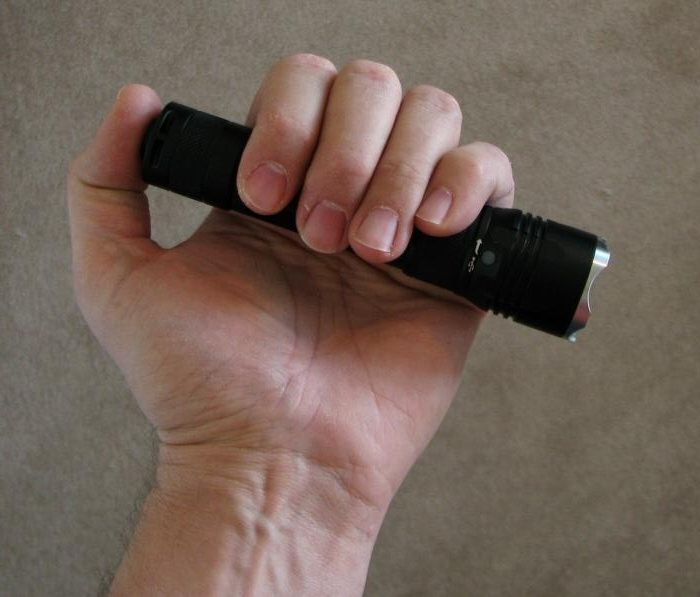

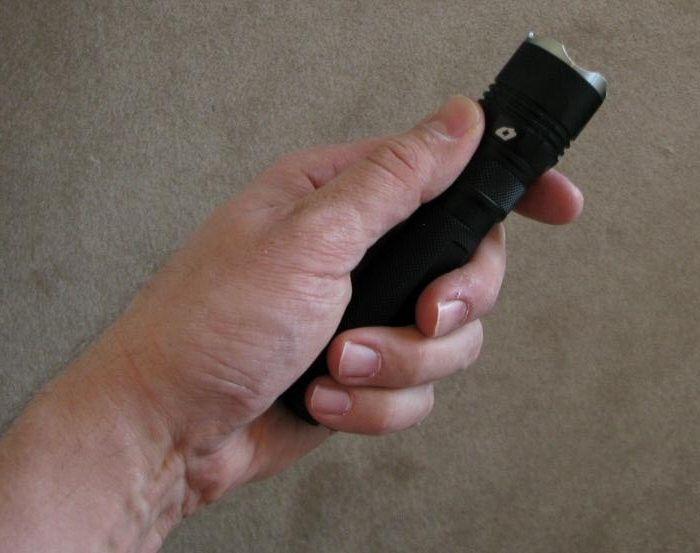

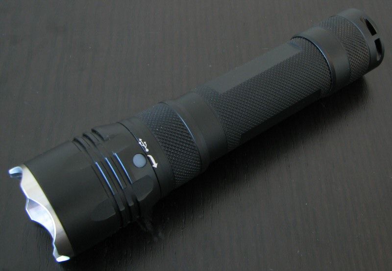

    The MMR-X is pretty compact for an in-light charging 18650 flashlight. As with other Forusevens Maelstrom lights, anodizing is a shiny black finish, hard anodized (i.e., type III). Body labels are minimal, but bright white and clear. Knurling is fairly aggressive, and certainly helps with grip.

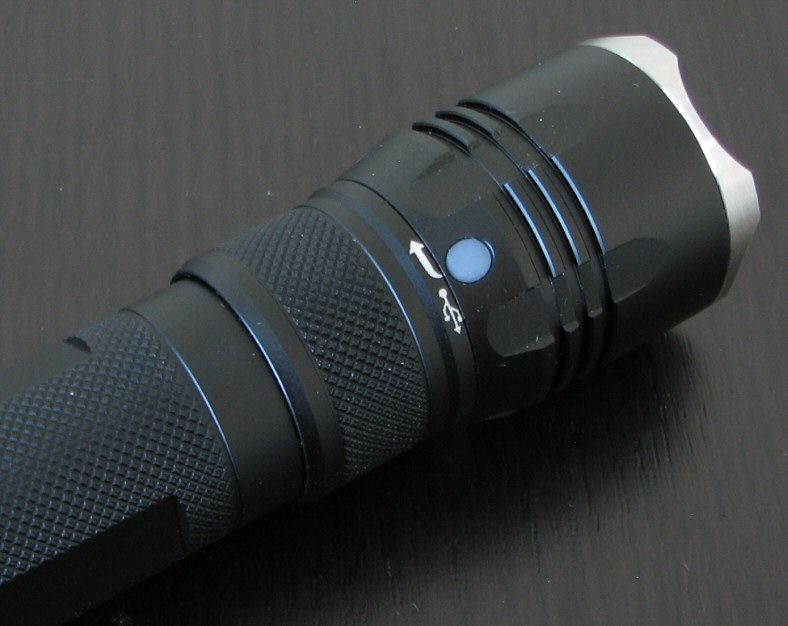

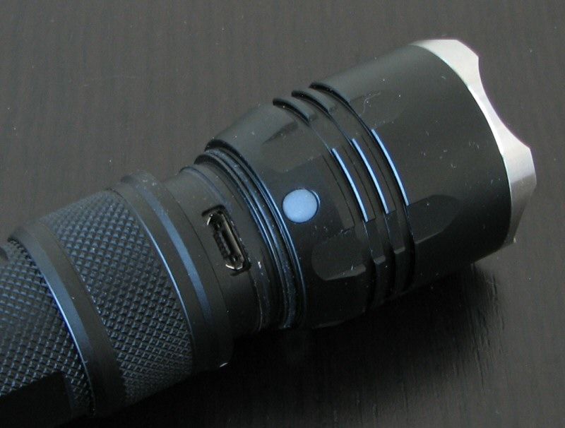

    There is a "hidden" micro-USB charging port located right below the charging indicator LED. Simply unscrew the power cover and slide down. Resistance is firm, making it clear there is an o-ring in there for waterproofness (when closed).

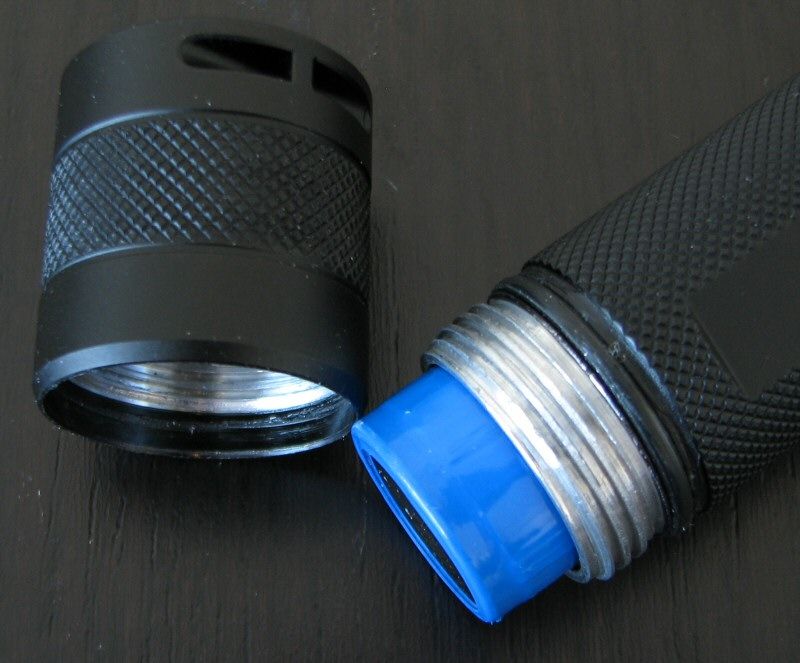

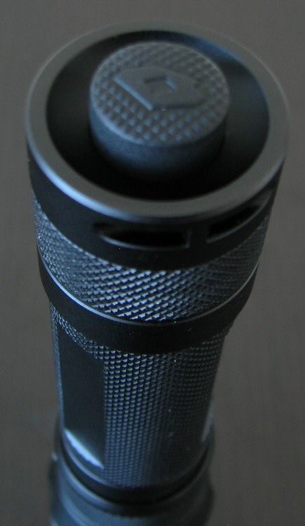

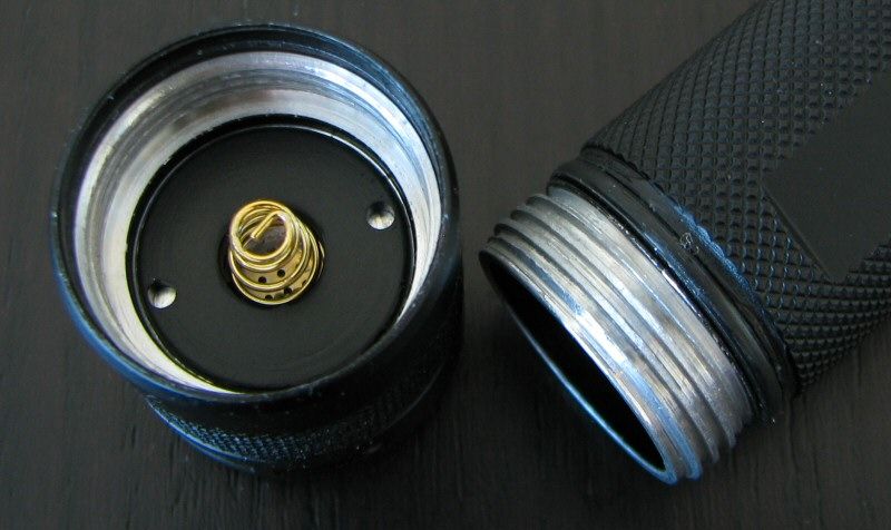

    Tailcap screw threads are square cut and not anodized (i.e., no tailcap lock-out is possible). This is not surprising though – all in-light charging models that I have seen leave the screw threads unanodized for the extra current path.

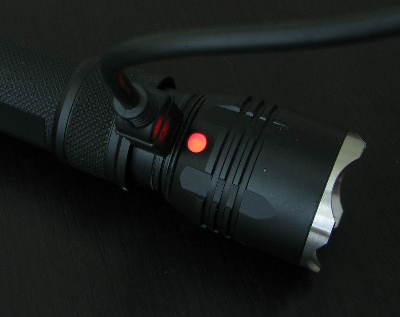

    Charging the battery (and programming the light) is done by plugging the included cable into the micro-USB port of the light, and the other end into a standard computer USB port. An AC adapter is included, if you want to charge right from a wall outlet. The LED indicator above the charging port will glow red when charging, and green when fully charged. Scroll down to the UI section for an explanation as to how to program the light modes.

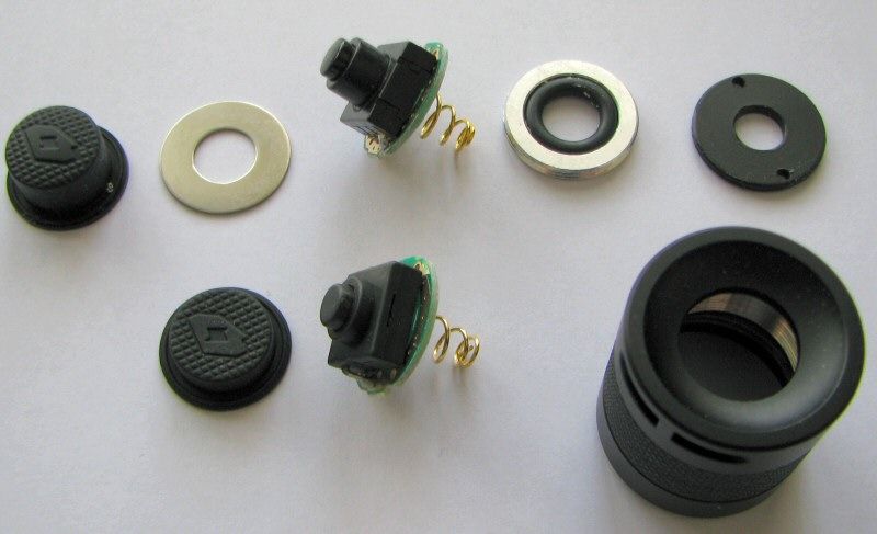

    By default, the MMR-X uses the same type of protruding forward tactical clicky switch as seen on the MMX (i.e. press for momentary on, click for lock-on). This protruding clicky doesn't allow tailstanding. But Foursevens also includes a reverse-clicky switch, with a low profile boot cover. If you swap the switch, the light will now tailstand and function as a reverse clicky (i.e., press and release to activate, instead of just press).
    The top row above are the items included by default in the tailcap (i.e., the forward clicky switch), diassembled. The second row is the extra reverse-clicky switch included in the package. You swap the switches by unscrewing the plastic masking disc on the far right (I'll come back to this one), then unscrew the metal switch retaining ring (you can't see the indendations above, they are on the other side). Once you do this, everything else just falls out (so pay careful attention to the order of things!). Note that as always, you will need snap-ring pliers or a sturdy set of tweezers to unscrew the rings.
    All mode switching is done by the tailcap clicky, but you can program the light to one of 5 mode-set states (one of which is single-mode Turbo). Please see my User Interface section for a discussion.

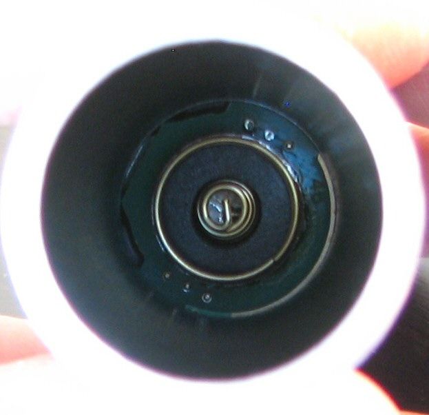

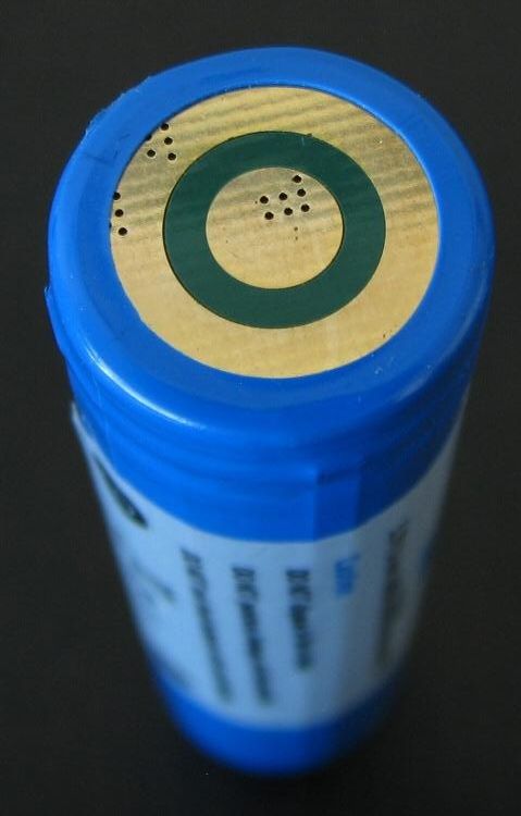

    There are two springs on the contact board in the head, which are used for charging the custom 18650 cell (which contains positive and negative contacts on the head). Note that you can use a standard 18650 cell, but Foursevens recommends you unscrew the extra plastic masking disc in the tailcap and mount it in the head (to block the outer spring contact). This removes the risk of accidentally shorting flat-top cells. The plastic masking disc in the tailcap serves no other function - you can safely remove it from the tailcap at any time.

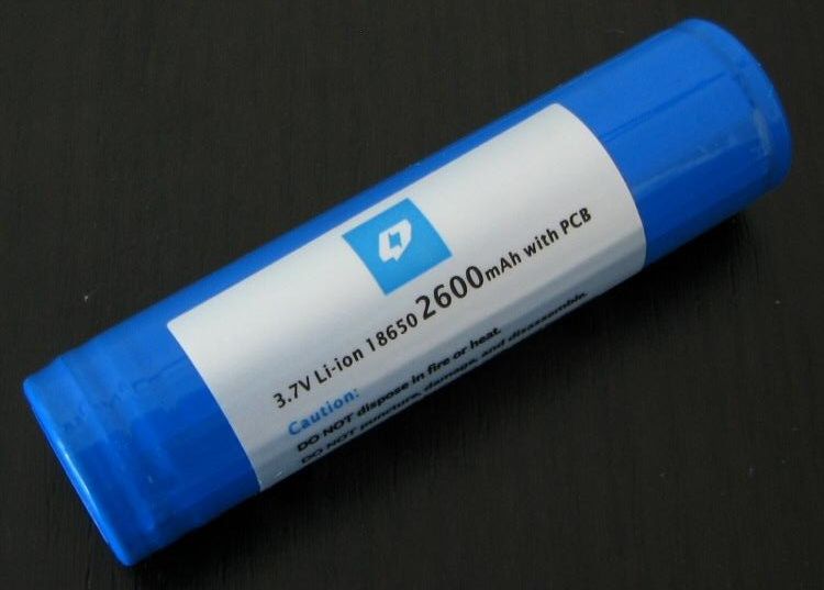

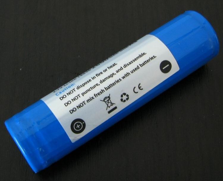

    Again, note the custom 18650 design, with an inner and outer contact on the 18650 cell's "positive" terminal. Only the inner contact is actually positive, which is why you must use the plastic mask from the tailcap if you plan to use a regular 18650 cell inside the light.

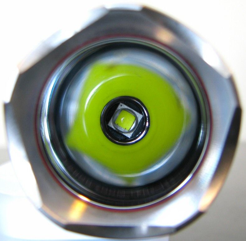

    The MMX comes with a crenalated stainless steel bezel by default (flat black aluminum one included in the package).

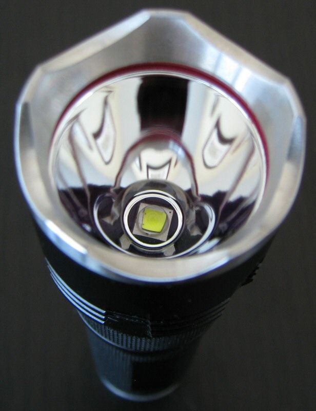

    The overall head is not very large. Reflector is smooth, and fairly deep. Coupled with the XM-L2 cool white emitter (which was well centered on my sample), I would expect a fairly typical beam. Scroll down for beamshots.

    Charging time using the supplied Foursevens 2600mAh cell was under 5 hours in my testing using a USB cable (sorry, I don't have more exact measure). I haven't tested the AC adapter to see if there is any difference in charging time.

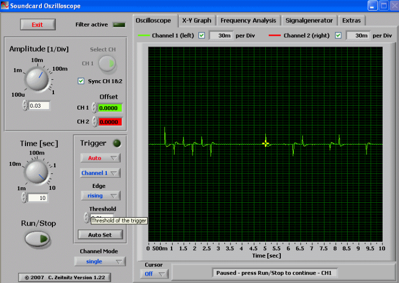

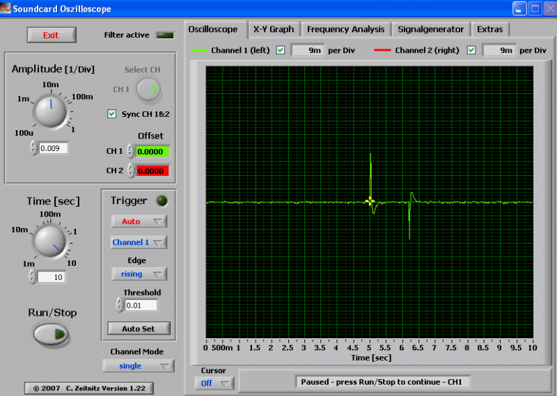

    PWM/Strobe
    The MMR-X is current-controlled. There is no PWM, on any level.

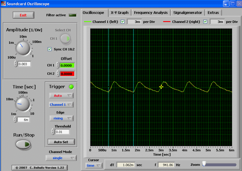

    However, I did observe circuit noise on the Lo/Hi levels (but not Moonlight or Turbo):
    Noise:
    This reoccurring signal was around 940 Hz, but was not strong enough to be detected visually (even when shining on a fan). As is often the case with these kinds of circuit noise, it is only detectable with an oscilloscope. Rest assured, the beam was completely flicker-free at all levels.

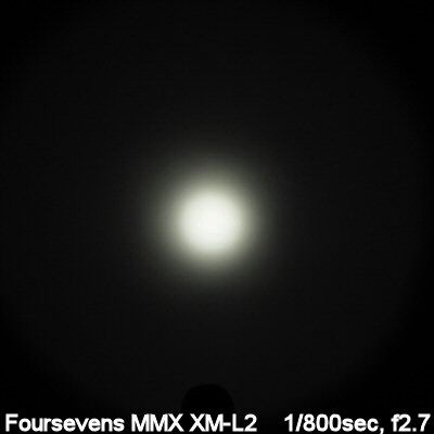

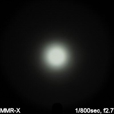

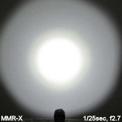

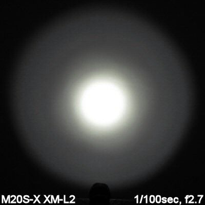

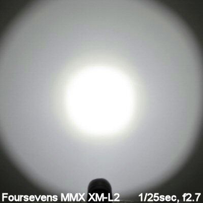

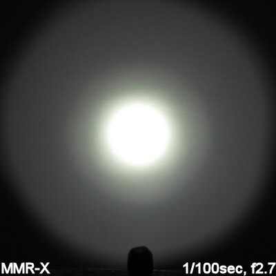

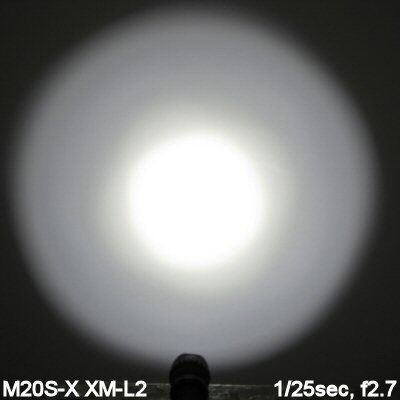

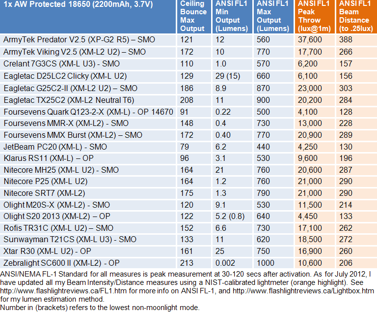

    Beam pattern and overall output are what you would expect for a light this size. The MMR-X is generally similar to the Olight M20S-X in beam pattern, although the MMR-X has higher max output. That said, the MMR-X does not seem to quite as bright on Max as the specs would indicate. Scroll down to my output tables below for direct measures.
    Consistent with what you saw in the beamshots, the MMR-X has a reasonable amount of output, with a generally balanced beam (i.e., not a great thrower). According to the specs, the MMR-X is a 1x18650-only light (i.e., 2xRCR or 2xCR123A does not appear to be supported).

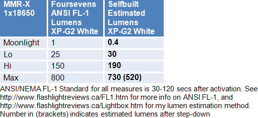

    Here are how all the levels compare to the official specs, in my lightbox:
    There is a generally good concordance between my estimated lumens and Foursevens published specs - although I should note that I have historically found Foursevens to be somewhat conservative in their output measures, relative to most other makers. Personally, I would normally take Foursevens specs as the minimum expected output, as opposed to the average expected output.
    The one exception in my testing is the max output on the MMR-X – my lumen estimates are lower than the Foursevens specs. That has never happened before Still, this max output level is quite consistent with other lights of comparable size (i.e., I would put max output in the typical range of lights in this class).

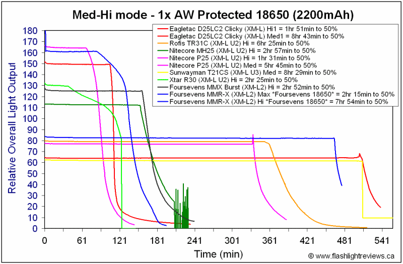

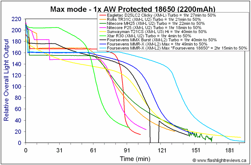

    Output/Runtime Graphs:
    As you can see above, on Turbo the MMR-X steps down after about a minute and a half of runtime. I would estimate the revised output as ~520 lumens after step-down, which is higher than most lights that step-down. Regulation pattern is good at this reduced output, with the bundled 2600mAh Foursevens cell producing longer total runtime than my standard 2200mAh AW cells.
    For the Max and Hi runtime tests below, I have used the bundled Foursevens 18650cell instead of my usual AW 18650 (to give you a better idea what to expect in stock form).
    Overall efficiency and regulation are excellent on the MMR-X, at all levels tested. Note that the "Hi" level is really more a Med, compared to the terminology most makers use.

    When using your own flat-top 18650 battery, ensure the masking contact disc (from the tailcap) is in place, to prevent accidental shorting.
    The light can't tailstand.
    Screw threads are not anodized (consistent with other lights in this in-light charging class), so no lock-out is possible.
