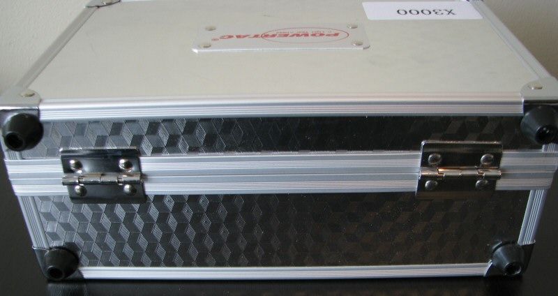

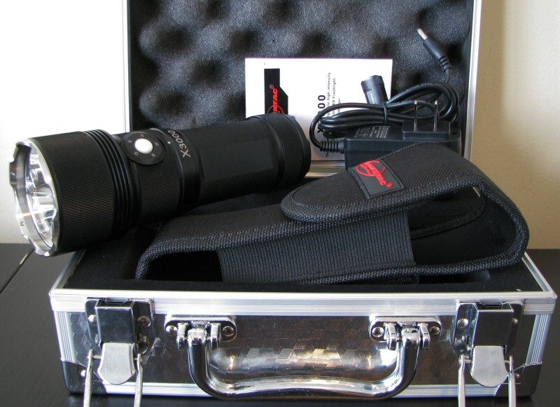

    Packaging (and build, for that matter) remains similar to a number of higher-end Thrunite, SupBeam and L3 Illumination lights. You get a presentation-style carrying case, with metal hinges and clasps. Inside, included with the light are spare O-rings, AC charging cable, belth holster with velcro closing flap, and manual.
    Note that there is currently no specific labelling to indicate this as the quite distinct "Gen II" model.

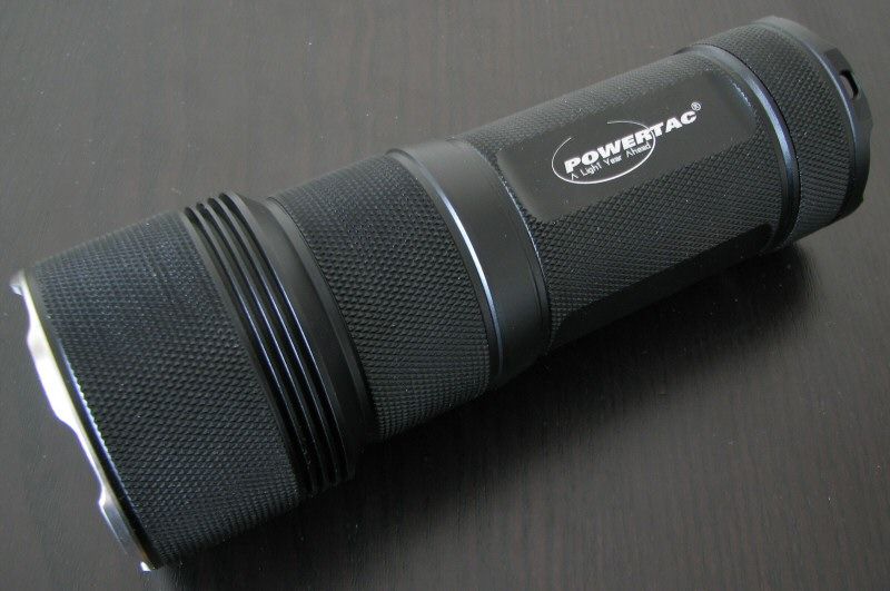

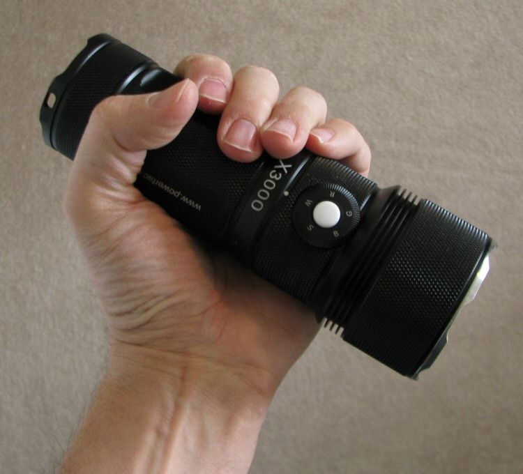

    Again, overall impression is that the light is similar to many SupBeam, L3 and Thrunite models - but with a few unique adaptations here. Weight is consistent with other robust 4x18650-class lights.

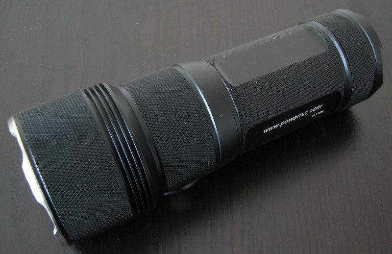

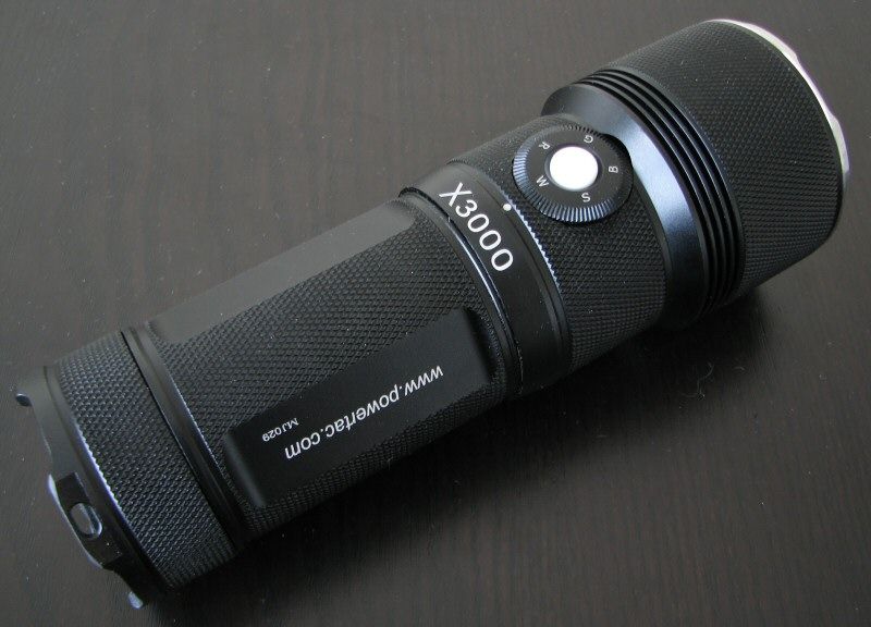

    Flashlight anodizing is a matte black, and seems to be good quality on my sample. Labels are bright white, clearly legible against the dark background. There is a very generous amount of knurling, and it is fairly aggressive. I would say grip is very good.
    The light is controlled by an electronic control switch in the head, along with a rotary mode-setting dial. Simply turn the dial to the setting you want, and click (press-release) the white button to activate the light. Scroll down to my User Interface section for more info.

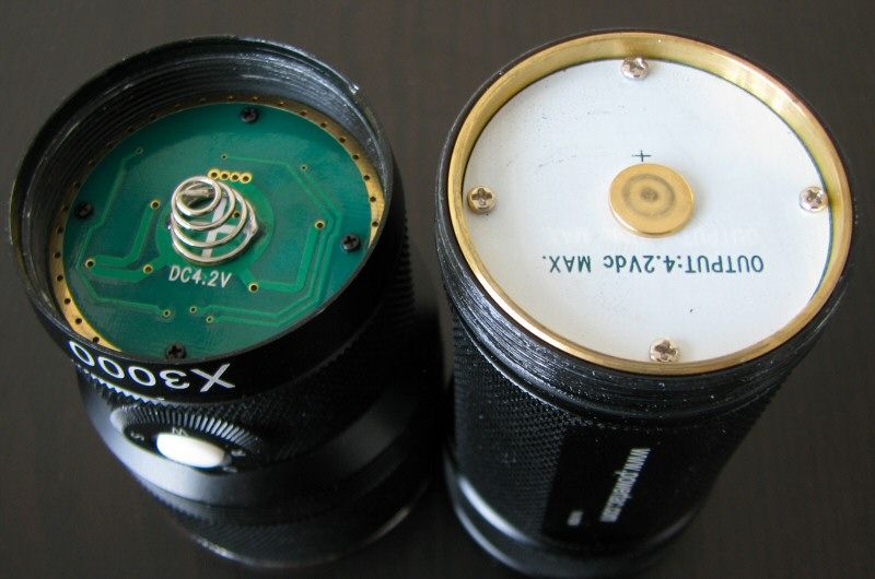

    The X3000 features a built-in battery pack, which is not user accessible. According to the specs, it is a custom pack with 4x2600mAh 18650 cells (presumably in parallel). There is a barrel plug connector in the base, for charging the pack (from the included AC charger). There is also a neat feature: a USB-out connector, thus allowing you to charge other USB devices from this battery pack. I'm only aware of a couple of other lights that have attempted this. It's a smart feature, should you be away from an electrical outlet and decide that charging your cell phone is more important than extended flashlight runtime. Finally, there is a charge status indicator on the tailcap as well. Scroll down to my User Interface section for more info.
    There are anodized screw threads between the handle/battery pack and the head. This means you can lock-out the light by a simple loosening twist of the head.
    Light can tailstand stably.

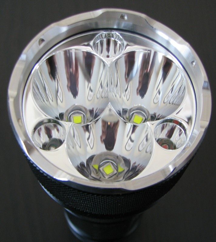

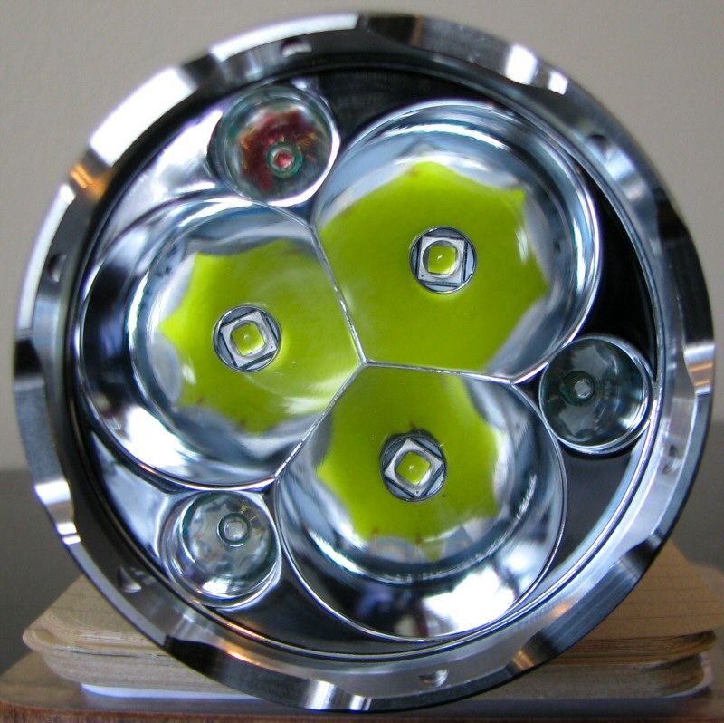

    The head of the X3000 is pretty distinctive. You get the standard three white XM-L2 emitters in overlapping reflector wells – but you also get three individual XP-E colored emitters, arranged around the periphery of the head.
    Each XP-E emitter is in a small reflector well, suggesting these will be mainly flood-style beam profiles. The main white XM-L2 wells are fairly deep, so the X3000 should have reasonably good throw for the class (albeit with some concomitant beam artifacts).
    Let's take a closer look:
    White XM-L2 emitter:
    Blue/Green XP-E emitter:
    Red XP-E emitter:

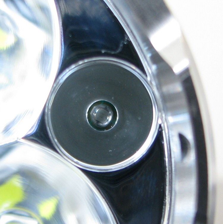

    The blue and green XP-Es don't look visibly different when the power is off, but the red XP-E has a noticeable red dome and reflection.
    You may be wondering what the specific wavelengths are for the dedicated XP-E colored emitters. Powertac doesn't provide tint codes with their specs, only output bins (i.e., Red N3, Green Q3, and Blue I5). According to the Cree data product sheet for the XP-E, these are all mid-range output bins, and commonly available. Associated tint ranges for these XP-E emitters are between 620nm and 630nm for red, 520mm and 535nm for green, and 450nm and 465nm for "royal blue".

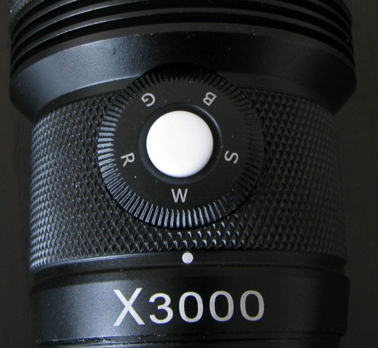

    Turn the light on or off by clicking (rapid press-release) the electronic switch in the head.
    Emitter choice and mode are controlled by the rotary dial around the switch. The indicator dot at the bottom of the head indicates the currently selected mode. Going in a clockwise orientation, the mode options are: White > Red > Green > Blue > Strobe. You can adjust the dial while the light is on or off.
    In each mode position, there are potential secondary levels. You access these by pressing and holding the switch. For the White mode ("W" on the dial), you have the choice of four output levels: Hi > Med > Lo > Firefly, in repeating sequence. Strobe modes are available at the "S" position on the dial. There are a few surprises here, though, as I describe below.
    The Hi mode is all three emitters on their max output, as you would expect. But there is an unusual feature that I have not seen before – The Med mode is simply one of the three emitters running at max. Typically, you would want to run all emitters at a lower drive level, to capitalize on efficiency gains. But as you will see in my circuit testing below, there is one potential advantage to this setup. Med and Lo and similarly produced on one emitter.
    Another interesting feature - the X3000 rotates between the 3 emitters on subsequent re-entry to the Med level. This is presumably to help prevent accelerated aging of any one emitter. See my video overview for a description of this.
    For the colored XP-E modes ("R", "G", "B"), the default option is single-stage max output. Pressing and holding the switch brings up a rapid strobe. Press and hold again to return to the single constant output level.
    For "S" Strobe modes, the default option is a rapid "tactical" strobe mode. Note that all 6 emitters actually light up for this strobe mode, with alternation of the colored emitters. In practice, this doesn't matter too much, but it does add some extra color to the predominantly white full-power strobe. Press and hold to activate "police strobe" (which is a rapid alternate flashing of just the red and blue emitters). Note that is may not be permissible for you to publicly use this sort of strobe mode in your local area (i.e., a lot of municipalities have restrictions on the use of emergency signals, and may not have much of a sense of humor about attempts to imitate police officers).

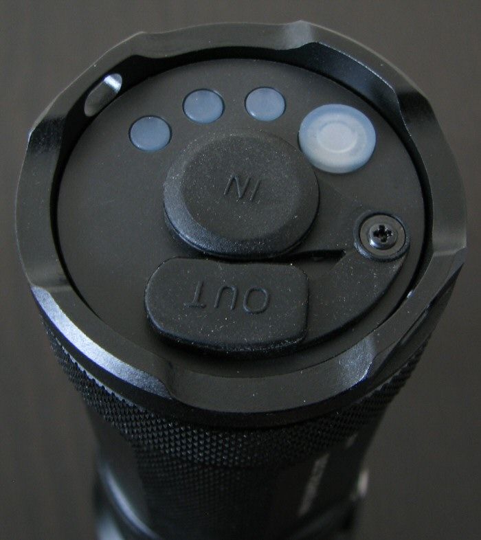

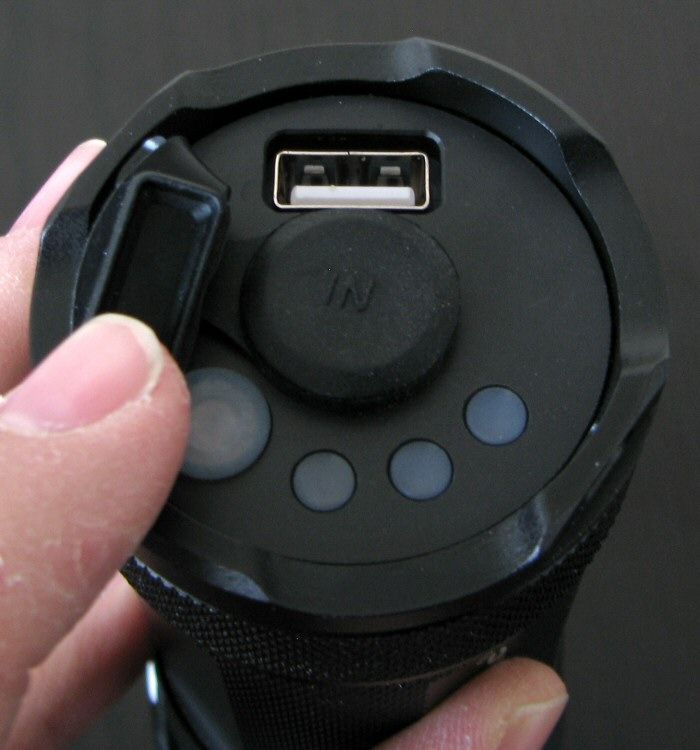

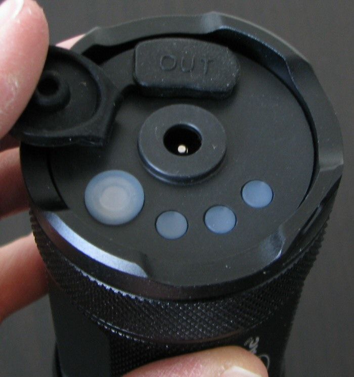

    At any time, you can press the charge indicator button to see an estimate of charge remaining (this will likely be more accurate if the light is off). To charge the battery pack, simply plug the supplied AC power cable into the center "IN" port. The indicators also light up to indicate relative charging status during charging. Charging time using the bundled AC charger was around 4 hours, which is impressive for a battery pack of this size.
    The X3000 Gen II also features an innovative USB "OUT" port, suitable for recharging small hand-held devices. To activate, press-and-hold the battery read-out button for a few seconds. The charge status indicator LEDs will turn on. If you now plug a USB-chargeable device into the USB port on the handle, the device should charge from the battery pack.
    Powertac reports that the charging characteristics are suitable for both the Apple iPod and iPad (which I can confirm). It also worked fine on my Android phone, but not on my previous generation Blackberry Bold (which is not uncommon – Blackberry uses different voltage characteristics than most other makers).

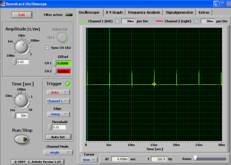

    The X3000 uses pulse-width-modulation (PWM) for its low modes. However, due to the unusual quirk I described in the UI overview (i.e., the Med mode is simply one emitter on max, compared to three in Hi), this means that the X3000 is constant current on Hi and Med, and only using PWM for the Lo and Firefly levels.
    Firefly mode
    Lo mode:
    As someone who is sensitive to low frequency PWM flicker, I am disappointed to see a very noticeable 200 Hz PWM signal on these lower levels. Of course, it's unlikely that you buy a high-output light to run predominantly on Firefly or Lo, so this may not practically be an issue for you.

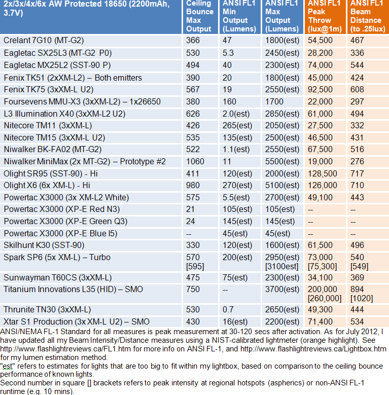

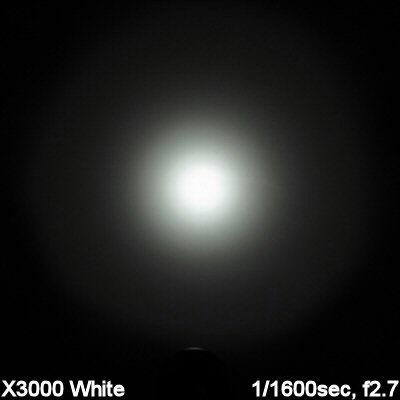

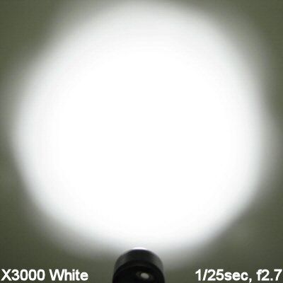

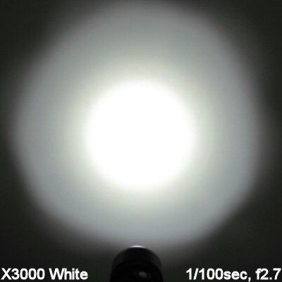

    And now, what you have all been waiting for. All lights are on their respective max rechargeable battery sources (i.e., 18650s), about ~0.75 meter from a white wall (with the camera ~1.25 meters back from the wall). Automatic white balance on the camera, to minimize tint differences.

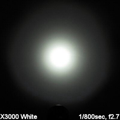

    Let's start with the main white XM-L2 emitters, relative to the competition:
    The X3000 has about the beam profile you would expect for the 3xXM-L/XM-L2 class with tri-head reflector design with overlapping wells: you get reasonable throw, with some artifacts in the spillbeam. Actually, X3000 is not as bad in terms of artifacts, compared to some of the other lights I've tested. Overall output is similarly quite consistent with other recent lights in this class.
    Unfortunately, we are still in a middle of a deep freeze here in my part of Canada, with several feet of snow on the ground. As such, outdoor shots would be meaningless (think of snow as equal parts ground-level diffuser and a massive reflector to get the general idea of why outdoor beamshots won't work).
    So for now, you will have to make do with some indoor shots in my basement. For your reference, the back of the couch is about 7 feet away (~2.3m) from the opening of the light, and the far wall is about 18 feet away (~5.9m). Below I am showing a couple of exposures, to allow you to better compare hotspot and spill. Comparison lights are the Nitecore TM15 and L3 Illumination X40.
    The X3000 is certainly in the same output range as my other 3xXM-L/XM-L2 lights. Scroll down to actual output and throw direct measures in my Summary table.

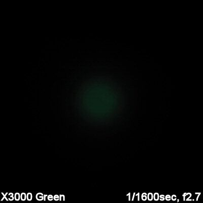

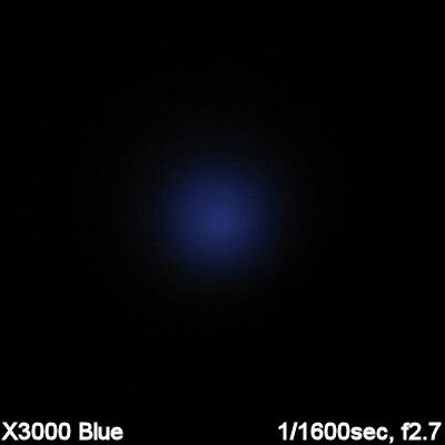

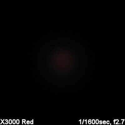

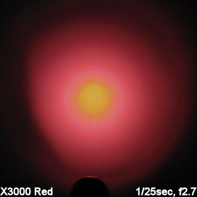

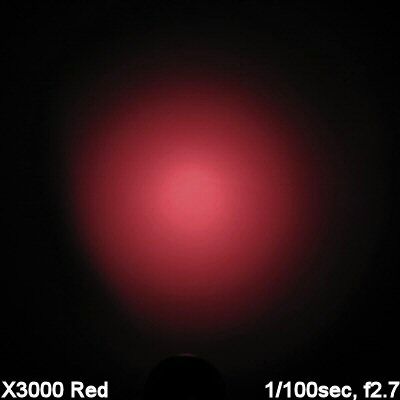

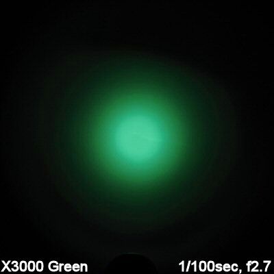

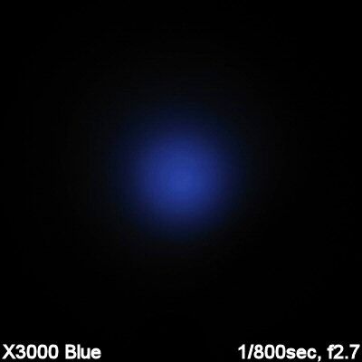

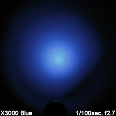

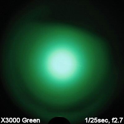

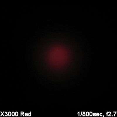

    XP-E R/G/B emitters:
    Note: At this close-range, my camera is over-saturated at long exposures. In real life, the beams are a consistently solid color. Also, the beam tints are somewhat off here, due to the automatic white balance and saturation settings of my camera. Please don't rely on them for tint estimation.
    There are some beam artifacts with each of the emitters, which seem to be a result of the specific location of the reflectors near the periphery of the head (i.e., bezel gets in the way). These diminish with distance though, and are not an issue in actual use – it is just the close-up nature of these beamshots makes things look worse than they are.

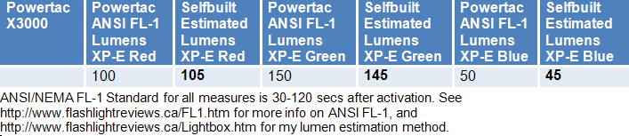

    Powertac's output specs for these emitters are generally consistent with the Cree product information. But an interesting point to note above: while the blue XP-E beam looks brighter than the other two colors with the camera, all light meters (and the Cree/Powertac specs) report much lower lumen values for the blue XP-E.
    As you will see in my detailed tables below, my calibrated lightbox sensor is reasonably consistent with the Powertac/Cree specs. But my NIST-certified lux meter gives ridiculously low values for throw and ceiling bounce on blue, so I have opted not to present them below. This is a good point to keep in mind – light meters are not equally sensitive across the spectrum of colors.
    As I mentioned earlier, Powertac doesn't provided specific wavelength information for the dedicated XP-E colored emitters. But according to the Cree data product sheet for the XP-E, tint ranges for these XP-E emitters are between 620nm and 630nm for red, 520mm and 535nm for green, and 450nm and 465nm for "royal blue".
    Consistent with what you saw in the beamshots, the overall output and throw of the X3000 is fairly close to the Nitecore TM15.
    As for the colored XP-E modes, it's important to recall that light meters are not equally sensitive across the color spectrum, as previously mentioned. Consistent with Powertac specs, my lightbox sensor gives lower output readings for the blue XP-E, compare to red or green. In real life, I don't find much of an actual output difference between the 3 colored models … but that's hard to quantify, obviously. The wall beamshot photos earlier in this review give you another possible indication of what to expect.

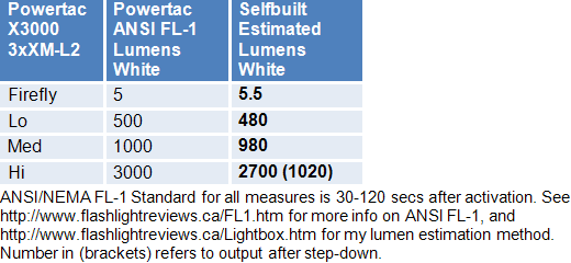

    Let's see how all the output levels do, against the Powertac specs:
    Generally, I have very good concordance of my estimated lumens to Powertac specs. Note that I don't have a really good way to measure output on these really big lights, so you should take my numbers as a relative comparison between models in my possession. I would rate the X3000's max output as well within the typical range of recent 3xXM-L/XM-L2 lights.
    As previously mentioned, the Hi mode is made by running all three emitters at max. In contrast, the Firefly, Lo and Med modes are produced by running a single emitter at full power (Med), or a single emitter at reduced PWM-controlled output (Firefly/Lo). The light alternates between the possible 3 emitters on successive cycles of mode switching. See my oscilloscope traces earlier in this review for more info.
    But there is one additional interesting feature here – the X3000 steps down on Hi after 5 mins continuous runtime, with all three emitters at reduced output. This reduced Hi is similar to the Med output level of a single emitter on max, but is performed by visible PWM-controlled reductions in the output on all three emitters.
    For the colored emitters, I again have pretty good concordance between my calibrated lumen estimates (from my lightbox) and the official Powertac specs.

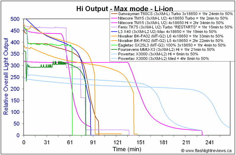

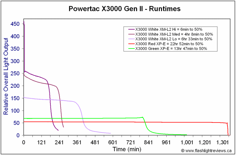

    Output/Runtime Graphs:
    I haven't done a runtime on the blue emitter, but here is a comparison of the main white XM-L2 emitters to the red and green XP-Es:
    As you can see, the X3000 steps down on Turbo after about 5 mins of continuous runtime. The step-down is to a similar level as the Med mode, but is controlled differently (i.e., stepped-down Hi is all 3 emitters run at reduced PWM-controlled output, whereas Med is one emitter at max – see above for details).
    The X3000 shows a direct-drive-like regulation pattern on all white emitter levels.
    Runtime on the green XP-E was consistent with Powertac specs of 15 hours (for ANSI FL-1 time to 10%). Runtime on the red XP-E considerably exceeded the comparable Powertac specs.
    Regulation patterns were also different for these colored emitters, with both showing a more fully-regulated output overall. That said, the red XP-E drops more abruptly in output than the green XP-E (i.e., rapid termination on red, as opposed to the slow "moonlight" phase on the green emitter).
    I haven't done the blue emitter, but I suspect it would look similar to the green XP-E runtime, based on my Nitecore Chameleon series testing (check out the comparison color XP-E runtime graph in that review).
    Let's see how the X3000 performs relative to the competition. Keep in mind that the X3000 is using the equivalent of 4x 2600mA cells, compared to my standard lower capacity 2200mAh AW cells in the other runtimes here.
    The X3000 steps down to a lower level on Hi than most lights with a step-down feature. As you might expect, the decision on the X3000 to run one emitter at max for Med – and to use PWM on all three emitters to produce the step-down Hi level - results in some efficiency loss compared to current-controlled 3xXM-L/XM-L2 lights at comparable output levels. But absolute runtimes at these levels are still perfectly accetpable for this class.
    Similarly, the X3000 Lo level (which uses PWM on one emitter) is also a bit less efficient than other lights that reduce the output on all three emitters, in a current-controlled fashion. But the absolute runtime of the X3000 on Lo is again quite acceptable.
    The X3000 uses pulse-width-modulation (PWM) for its Lo/Firefly modes, at a visually detectable 200 Hz (i.e., perceptual "flicker", for those who are sensitive to PWM). The Med and Hi modes are constant current, due to the varying number of emitters used to produce these levels (i.e., one emitter on max for Med, all three for Hi). But the Hi mode eventually steps-down to PWM-controlled state.
    Overall efficiency is bit lower than typical current-controlled lights in this class, but the extra capacity of the battery pack helps compensate in terms of absolute runtimes. I would consider runtimes to be reasonable.

    Thanks for the review!
    Edit: Your labels for blue/green emitter and red emitter are switched around.

    A question to SB that I did not put in my above post. Have you taken the 4 screws out of the battery cover? Personally I would have to have a look.
    6,936
    Default Re: Powertac X3000 Gen II (3xXM-L2, RGB XP-E) Rechargeable Review: RUNTIMES, BEAMSHOT
    Quote Originally Posted by gkbain View Post
    No, I haven't ... I don't typically disassemble sealed battery packs. I doubt there would be much in the way of identifiable components.
    Thanks. Just curious.
