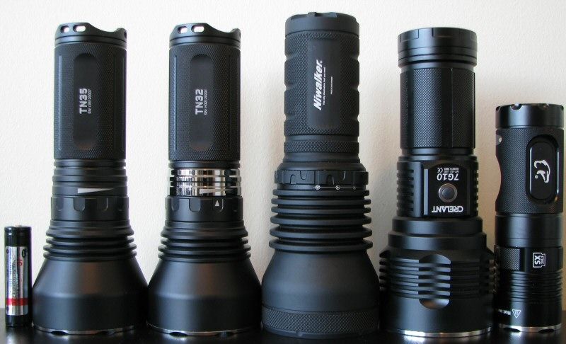

    From left to right: AW Protected 18650 2200mAh; Thrunite TN35, TN32; Niwalker Vostro BK-FA02; Crelant 7G10; Eagletac SX25L3.
    Thrunite TN35 (MT-G2): Weight: 571.4g (723g with 3x18650), Length: 201mm, Width (bezel): 78.9mm
    Thrunite TN32 (XM-L2): Weight: 655.9g (808g with 3x18650), Length: 201mm, Width (bezel): 79.0mm
    Crelant 7G9: Weight: 482.2g (634g with 3x18650), Length: 188mm, Width (bezel): 64.0mm, Width (tailcap): 46.7mm
    Crelant 7G10: Weight 643.4g (827g with 4x18650), Length: 198mm, Width (bezel): 79.0mm
    Eagletac SX25L3: Weight: 315.9g, Length: 150.2mm, Weight (bezel): 47.0mm
    Nitecore TM15: Weight: 450.6g (634g with 4x18650). Length 158mm, Width (bezel): 59.5mm
    Niwalker BK-FA02: Weight: 687.6g (870g with 4x18650), Length: 209mm, Width (bezel): 80.0mm, Width (tailcap): 50.3mm

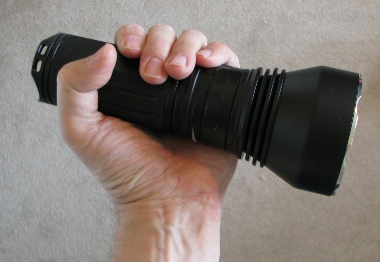

    As you can see, the TN35 is not as heavy as the TN32, despite the similar overall size (although it is heavier than the specs suggest). The difference between the lights is likely due to extra brass heatsink of the TN32.

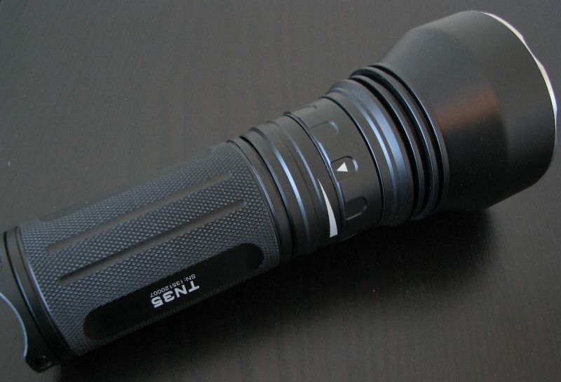

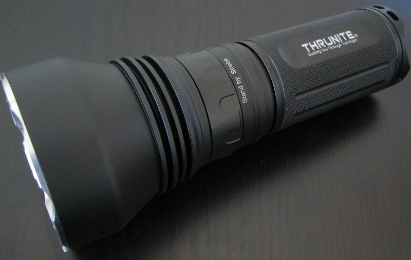

    As before, overall anodizing is a glossy black. Quality seems very good as always, there were no chips or damage on my sample. Labels were sharp and bright white against the black background. Knurling is fairly aggressive on the handle, helping with grip.
    One main difference is the standard heatsink with aluminum build on the TN35 (i.e., gone is the chrome-plated brass heatsink of the TN32). In this regard, the TN35 looks a lot like the older TN31.
    Unfortunately, the TN35 is not capable of physical lock-out like the older lights - screw threads are not anodized here. While this change from the TN31 to the TN32 was understandable (due to the new heatsink), it’s disappointing to see it missing here. My guess is that they are using a common manufacturing process for the body handles for these two newer lights, and weren’t able to cost-effectively re-introduce thread anodizing on just one. Threads are standard triangular cut as before, and seem of good quality.

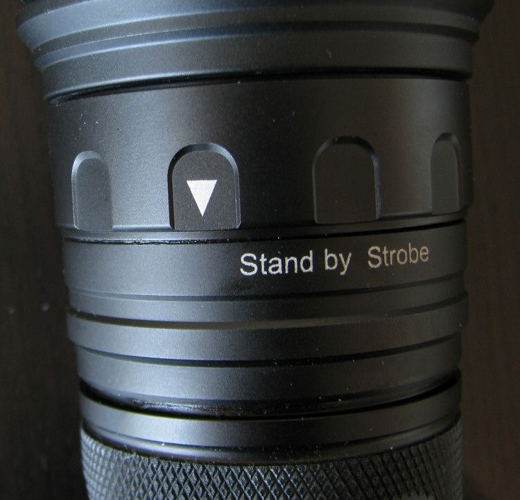

    The control ring feels the same as other lights in this family, with detents for the various defined modes (and cut-out indentations on the ring itself, to help with grip). Labels for the control ring indicator arrow are located below the ring, as always.
    As before, the six constant output modes are not individually labeled, but there is a graded output bar pictogram over the first couple of levels (i.e., shows the direction to turn to raise or lower the output). Scroll down to my User Interface and Standby Drain sections for a discussion of how the light works.

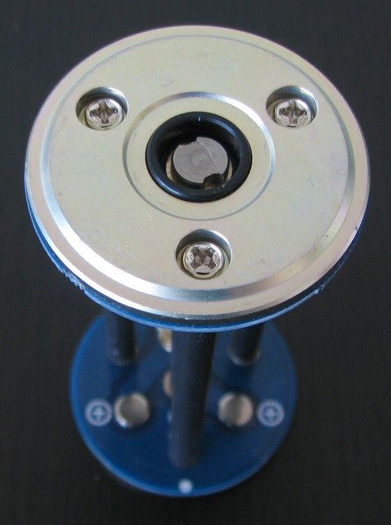

    Let's look at the carrier:

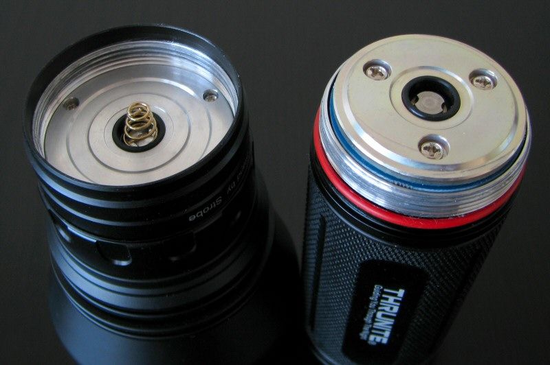

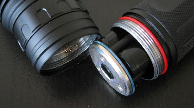

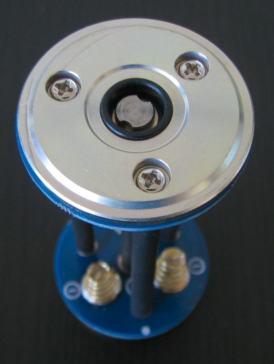

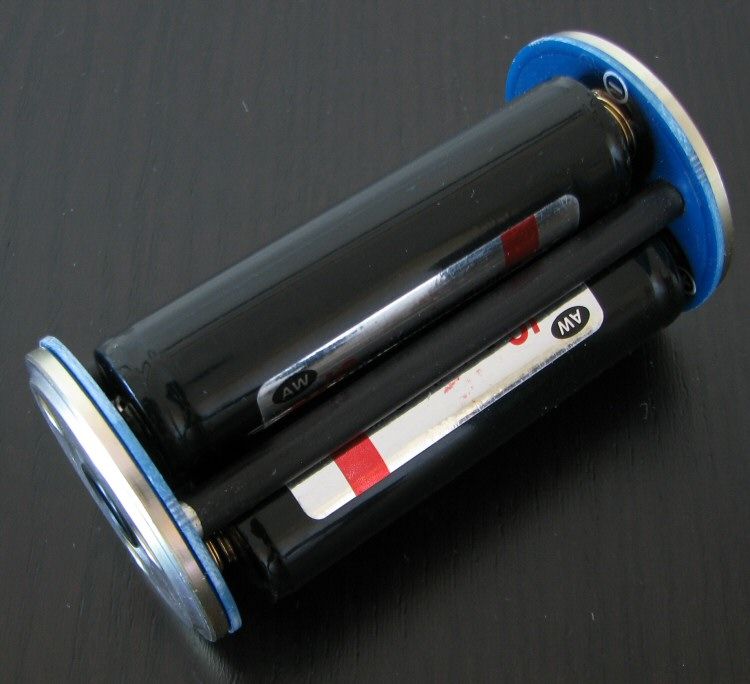

    As before, there is a metal battery carrier that holds 3x 18650 cells. While the carrier appears to be the same for the TN32 and TN35. The three cells are in series (i.e., 3s1p). The positive contact plates remain slightly raised, so all types of 18650 cells should work fine (i.e., true flat-tops, wide and small button-tops). Longer cells may be a bit tight, but my protected 3100mAh cells all fit. The carrier can be inserted either orientation into the handle. Note that particularly wide cells may be a tight fit into the handle.

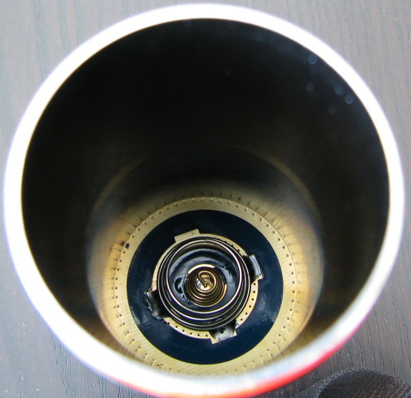

    There is a double set of springs in the base, in addition to the spring in the head. The double-set of springs in the tail was always a tip-off that something interesting is going on with the tail-switch and the battery carrier (more in a moment).

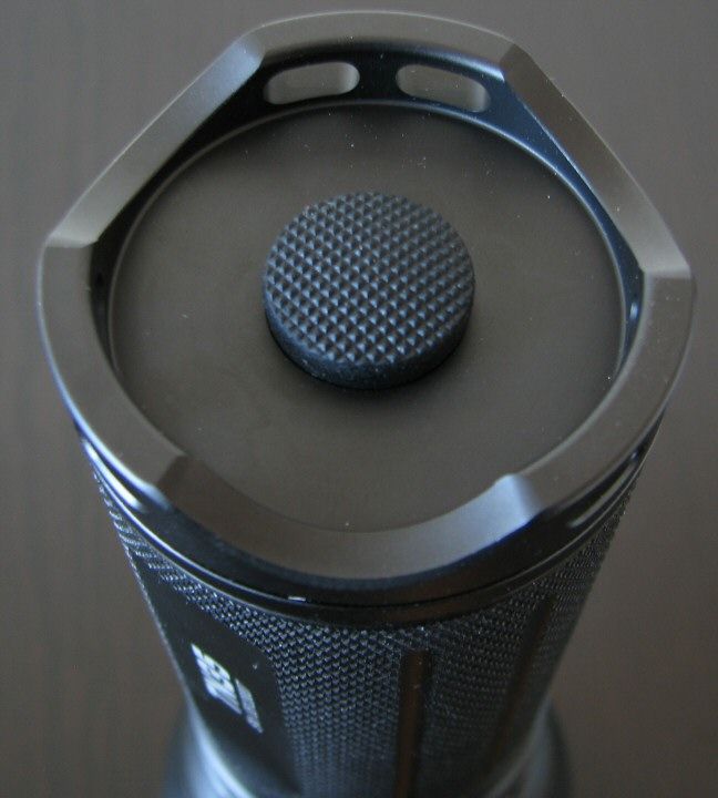

    The light can tailstand stably, and the tailcap cut-outs facilitate access to the switch (style of the cut-outs has been updated somewhat). Switch is the same sort of forward clicky switch as before. But as with the other members of this family, the switch is a little more complicated than typical. Here is a pic of the switch internals, from my original TN31 review:

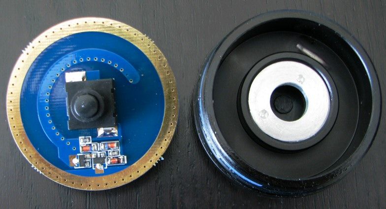

    As you can see, there is a circuit along with the forward clicky switch (TN31 shown above, but TN35 should look comparable). As you can imagine, the full current of this heavily-driven light on Max would wreak havoc with a traditional clicky switch in no time. The purpose of the circuit is to provide an assist to the switch, cushioning the load on it. The dual springs in the tail are how it draws power from the battery carrier, irrespective of the head. Scroll down to my Standby Drain section for more info about what this means in terms of current drain.

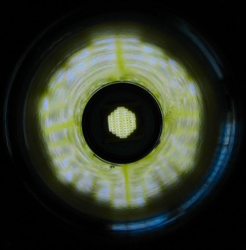

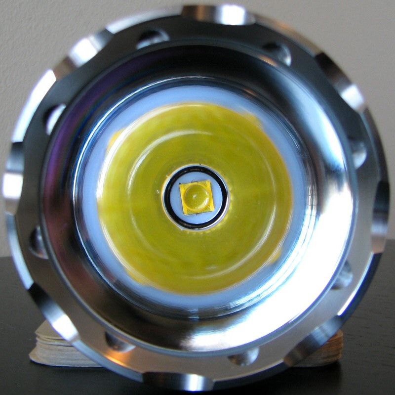

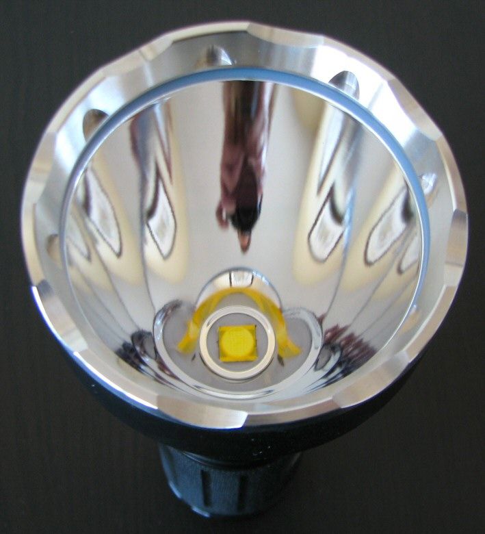

    Aside from the heatsink, the main difference from the TN32 is the emitter:
    As the TN35 is capable of a very low "moonlight level", I thought I'd show you a close-up with the light on:
    The Cree MT-G2 is certainly a different beast from the standard Cree emitters most people are used to. The MT-G2 is a remarkably large emitter, with a dome diameter of almost 8.9mm (vs. 5mm on the XM-L2). Of course, what really matters is the surface area of the die underneath, which is only 2x2mm on the XM-L2. I am not sure of the actual die dimensions on the MT-G2, but there appears to be a grid of 72 distinct segments on it.
    Note that the MT-G2 only comes in neutral-warm tint bins (i.e., the coolest one available is 5000K). All the MT-G2 samples I've seen have certainly been in the typical "Neutral White" range, and this one is no exception.
    Due to the large die, don’t expect great throw from a MT-G2 light. But with the deep and smooth reflector used here in the TN35, you should get relatively good throw for this emitter class. Scroll down for beamshot comparisons.

    Change output modes by turning the control ring in the head. Arranged clockwise (i.e., turning from left-to-right with flashlight held in front of you), the modes are level 1 (moonlight) > level 2 > level 3 > level 4 > level 5 > level 6 (max) > standby > tactical strobe.
    No light is produced on standby, but a small current will be drawn to allow the circuit to respond to a ring turn (see below).

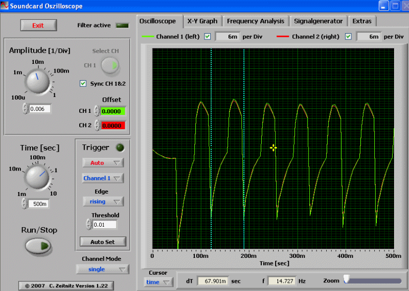

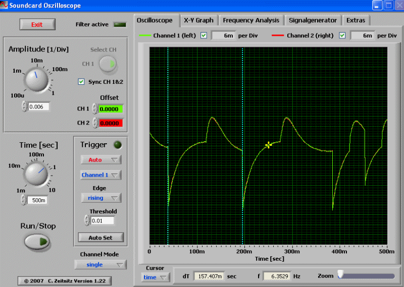

    PWM/Strobe
    There is no sign of PWM on any level – I believe the light is current-controlled.
    I haven't done traces of the TN35 strobe mode, as it looks very much the same as the TN32 that I just reviewed:
    As you can see, strobe on these lights is an oscillating frequency strobe, switching between 6.4Hz and 14.7Hz on my TN32 sample. Each frequency lasts for about 2/3 of a sec. Here is a blow-up of each strobe frequency individually:
    There is a bit of a ramp-up to the peak strobe output, but it is not something you could see in practice. Strobe is quite blazingly fast to the eye.

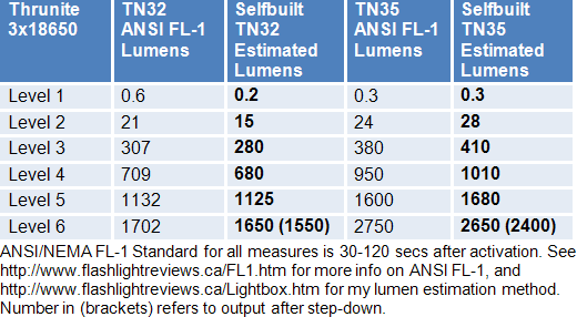

    My directly measured ANSI FL-1 Peak Intensity for my TN35 sample is bang on with the Thrunite specs for this model.
    Here is a breakdown of the estimated lumen values for both the TN35 and TN32 in my testing:
    As you can see, the reported output specs from Thrunite seem remarkably consistent with my testing. I suspect Thrunite did indeed get these tested in a properly-calibrated integrating sphere.
    Step-down occurs on L6 after 70 secs of runtime.

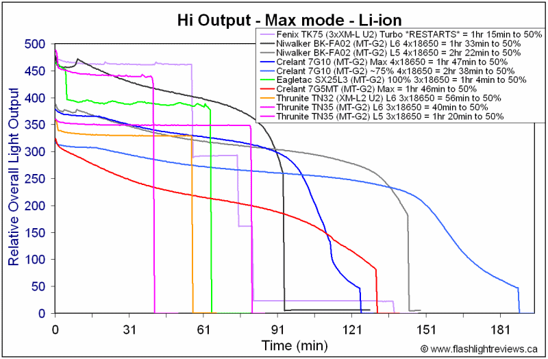

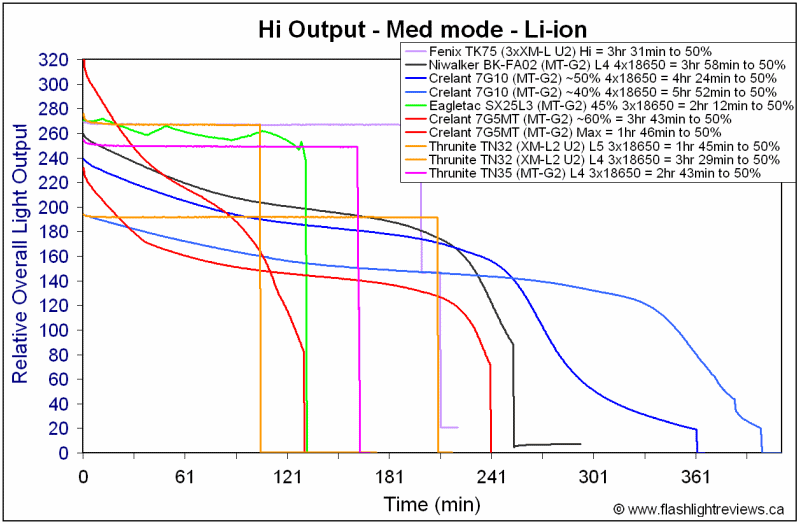

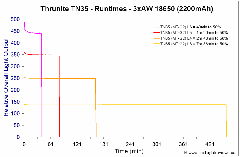

    Let's start with a comparison of the top four output modes. As usual, all my 18650 runtimes are based on AW protected 2200mAh cells.
    Somewhat surprising for a MT-G2 light, you get excellent flat regulation on all levels. This is the first time I’ve seen this level of consistently flat regulation on a MT-G2 light.
    Note that all my runtimes are done under a cooling fan – you may experience some gradual drop in output over time if run without any sort of cooling. See my TN32 review for more details.
    Let's see how it does against the high-output class of 3x/4x18650 lights:
    Again, all these Li-ion runtimes are based on AW 2200mAh protected 18650 cells. The TN35 was an excellent performer for this class, with very good output/runtime efficiency for this group. This is all the more impressive, given the consistently flat regulation profile.
    In contrast, the Crelant and Niwalker MT-G2 lights show a predominantly direct-drive-like pattern on all levels. The Eagletac SX25L3 is more regulated at higher levels, but still shows some fluctuations in output over time (and appears to be direct-drive at lower ones). Note that none of this is a problem – the drop in output when in direct-drive on Li-ion is so gradual as to be completely undetectable visually. But for those of you who are fans of perfectly flat regulation, the TN35 best fits that bill.

    I think, as others have mentioned, that this is the best balance of the TN3.. lights. If you could only choose one this might be the choice.
    I can see why you would feel that way. But it is interesting though, since the TN31/32 build was designed for "throwers", compared to the smaller 3xXM-L TN30. However, the larger build is just so well suited to producing a pleasant overall beam pattern with a MT-G2 emitter.

    Quote Originally Posted by MBentz View Post
    I'm kind of surprised Thrunite made a light that is so similar to the BK-FA02 that was released last year without any significant advantages.
    Hmmm, why not release one? Using largely stock parts, this model helps fill out a niche in their product line up (and there seem to be plenty who find this to be a good combination).
    I agree that if you already have a BK-FA02, there isn't much of a compelling to reason to get this light as well (unless you really want the clicky switch or the perfectly flat-stabilized regulation). And personally, I also like having the standby and strobe modes at the other end as you and hikingman do. But for someone looking to purchase one of these lights for the first time, its quite the possible that the balance of features could tip them in the direction of the TN35.

    I wonder: FlashLion measured longer runtime than you and he used 3100mAh batteries. Did you use 2600mAh?
    6,936
    Default Re: Thrunite TN35 (MT-G2, 3x18650) Review: RUNTIMES, BEAMSHOTS, VIDEO and more!
    Quote Originally Posted by Swedpat View Post
    Yes, sorry - it's usually in the descriptor and/or the figure title. I use AW protected 2200mAh cells in all my testing. I'll update the review.

    On your first "runtime" chart, the hours (stated in text) do not seem to match the lines drawn on the graph.
    6,936
    Quote Originally Posted by akapuckthecat View Post
    Oops, sorry about that - labels fixed. And

    A few days ago I received TN35. Personal impression:
    I just have to say this is a great light! Hold comfort is good with the knurling. The tint is very nice neutral. I like the control ring which makes it possible to choose and know the level before I turn the light on. Also I really like that I can change to a lower level without first cycle through the higher mode(s), which is typhical for many lights.
    The battery carrier is simple and makes it possible to change batteries in darkness if so needed. Just put the minus poles to the springs and then drop the carrier in any direction into the body.
    And worth to note is that TN35 provides a stable tailstanding as well!
    When I compared TN35 to Nitecore EA4W I noticed that these two lights have very similar beam patterns. Actually a pretty good description of the beam of TN35 could be: take a EA4W and make it 3 times brighter! The tints are pretty close as well, but I find TN35 to be more creamy white in a side by side comparison.
    One thing I noticed when I compared the lux value of ceiling bounce with lightmeter is that in opposite to Selfbuilt's test not only the highest level drops around 10-11% after a while before stabilizes, but also level 4 and 5. Could the explanation be that I had no active cooling? I mean at level 4 the cooling should not be close as important as level 6. Anyway; the initial decline isn't even noticable for the eyes so I hardly consider it as an issue at all.
    Conclusion: based on my experience so far I can't find any serious negative with TN35. The feeling of turning on the TN35 at max level the first time was something like I felt when I first tried Fenix TK30 with the TK10 as a reference. While it's not a pure thrower it throws very good due to the raw output. And with a very bright spill. This is fun. Now we are talking bright flashlight! And yes: I bought it for the brightness. And still I got a moon mode included.
    Interesting. You can see a slight decline on L5 and L4 on my runtime charts, but the effect is nowhere near as large as the L6. Of course, cooling is used in my testing, so that may explain it. In any case, I agree it is below a visual detection threshold and therefore not an issue in actual use.
