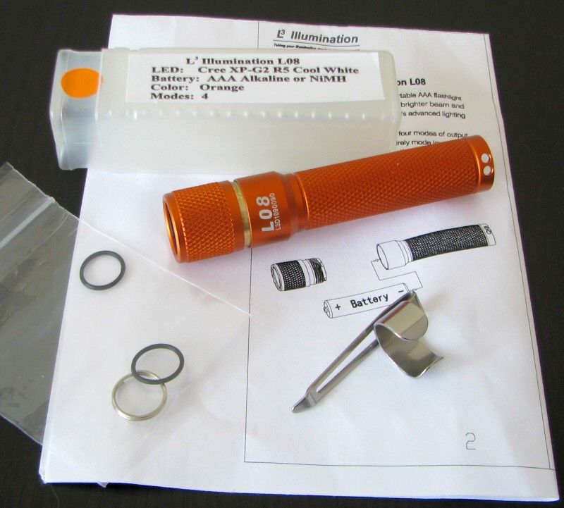

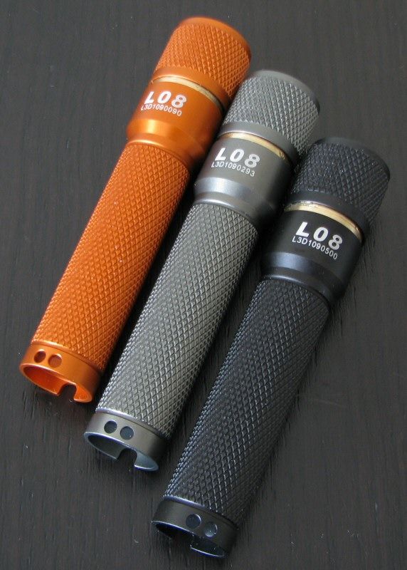

    Packaging is the same as the L10, and is very basic. A slightly opaque plastic "tube" contains the light, extra o-rings and a small keychain split ring. Printed on the outside of the container are the light specifics (including emitter type, color and mode number). A manual is included separately (although was out of date for the XP-G version in this case). As before, you are best to rely on the website for more recent emitter specs (although as stated above, runtimes specs are identical to the L10, which is clearly inaccurate).
    From left to right: Duracell NiMH AAA; L3 Illumination L08; Crelant V10A; Olight i3s; Thrunite TiS; Foursevens Preon P1; Titanium Innovations Illuminati; L3 Illumination L08.
    From left to right: Duracell NiMH AAA, AA; L08, L10, L08, L10.

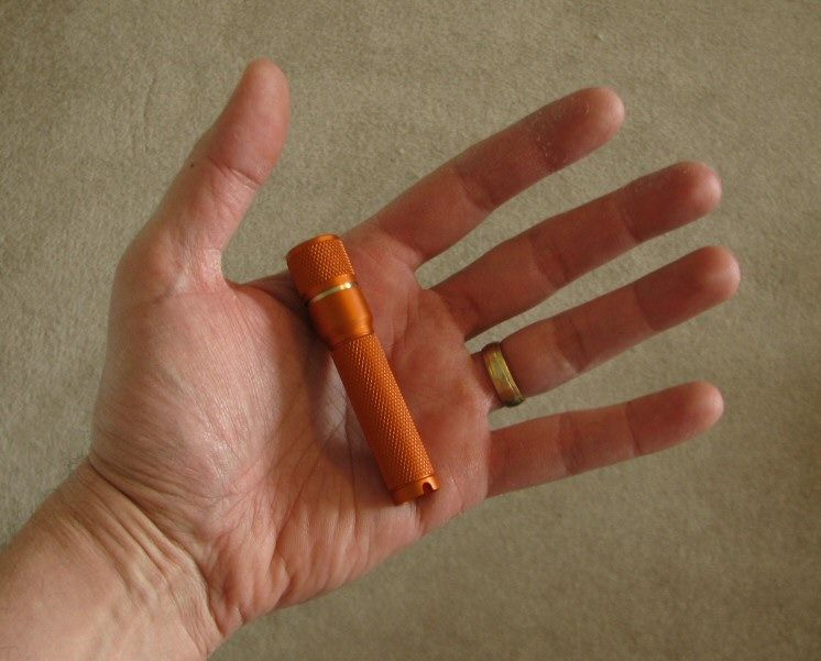

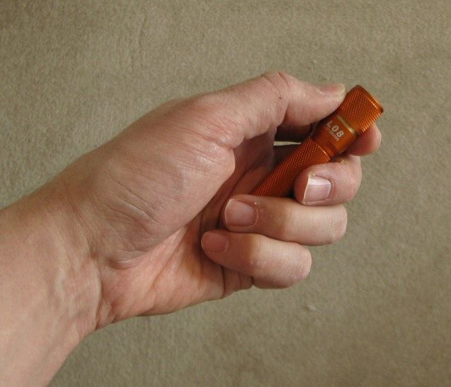

    As you can see, the L08 is slightly larger than most 1xAAA lights. Surprisingly, it is also slightly heavier than the 1xAA L10, despite have a thinner body (although with comparable overall head diameter).
    EDIT: Of course, weight with battery installed will be higher on the L10, due to the larger size cell. Total weight with Eneloop battery is 34.1g for the L08, and 47.1g for the L10.

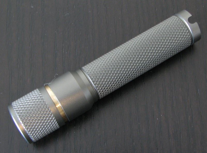

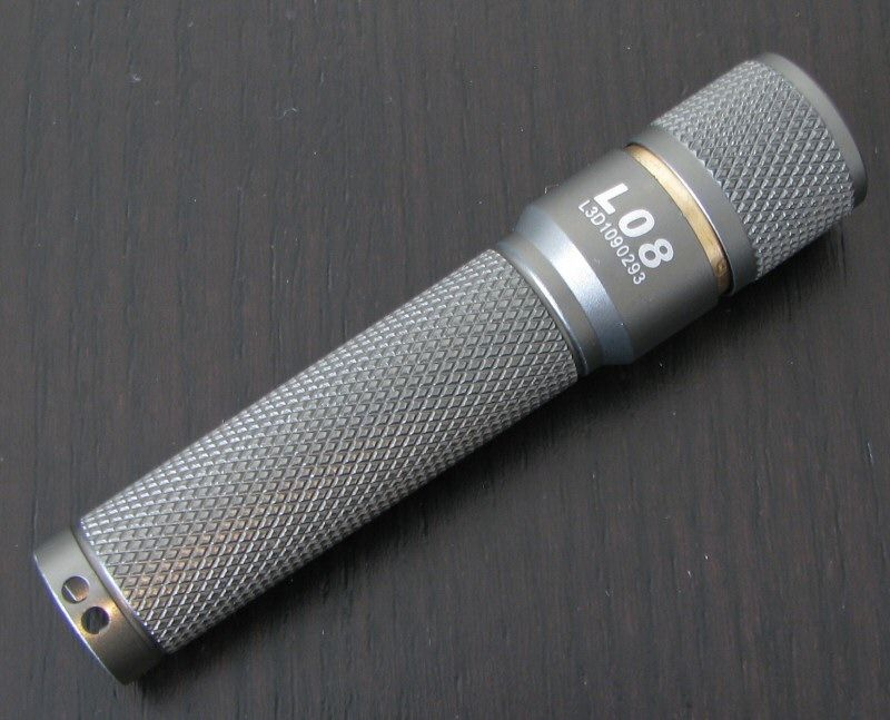

    The L08 feels like a solid light for this class, with its larger than typical head and slightly higher weight than typical. I would expect the L08 to hold up well to keychain carry (well, except for anodizing – but that's an issue for any flashlight you keep next to keys). The anodizing quality seems quite good on the colors I have, with no chips on any of my samples (as was also the case on the full range of L10s I was sent). Manufacturer claims hard anodized (aka, type III), which is better than most colored lights (which are only of type II strength).
    The L08 has knurling all over the body, which is something most lights in this class lack. While not overly aggressive (i.e., it won't shred clothing), it does help with grip. You may still find it hard to use in twisry-fashion single-handed, due to the overall small size.

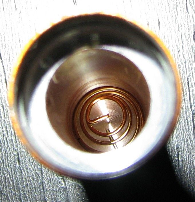

    Screw threads are standard triangular cut, fairly fine (like most lights in this class). You can expect some play, but I found the fit to be tighter than typical for this class (although that may have had more to do with the o-ring than the threads).

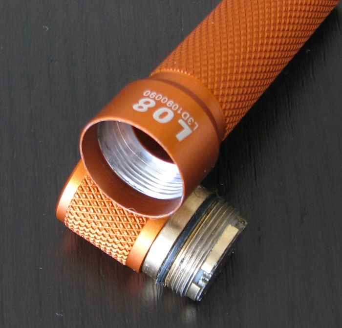

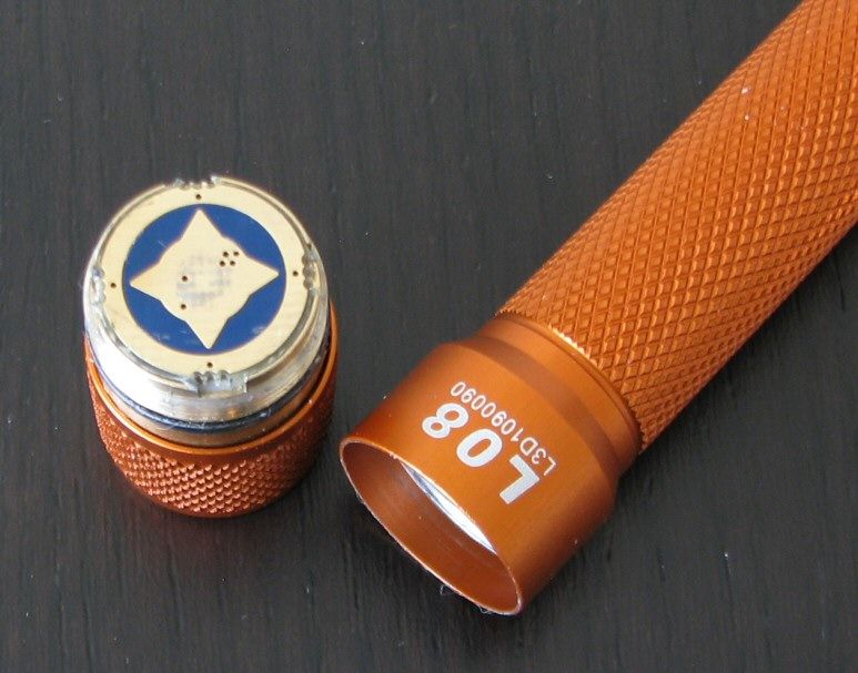

    As you can see, the head of the L08 has a brass pill/base, like a number of lights in this class (presumably for heat-sinking purposes). The battery contact surface in the head is flat, but doesn't include a foam cushion like the L10. Also, there is an actual spring in the L08 tail now. This is unusual, as most small lights (including the L10), only have a small raised metal post in the tail (hence the need for foam cushioning). This should help reduce the risk of crushing your AAA cells in this light.
    FYI, the L08/L10 heads are the same diameter, and screw on to each other's body tubes. However, there is one key difference – the L08's contact board is isolated from the pill, and needs to make contact with the unanodized ring near the top of L08 battery tube. What this means is that while the L10 head can potentially be run on the L08 body, the L08 head cannot be run on the L10 body. In practical terms, the spring design of the L08 body tube may make it difficult to maintain consistent contact with the L10 head (i.e., mode switching is difficult, if you were to try this).

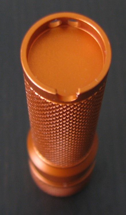

    There are two small attachment points in the tailcap, with a cut-out for the keychain split-ring. As such, the L08s can tailstand stably.

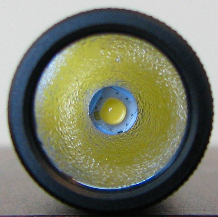

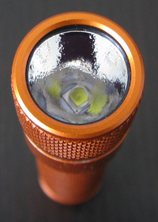

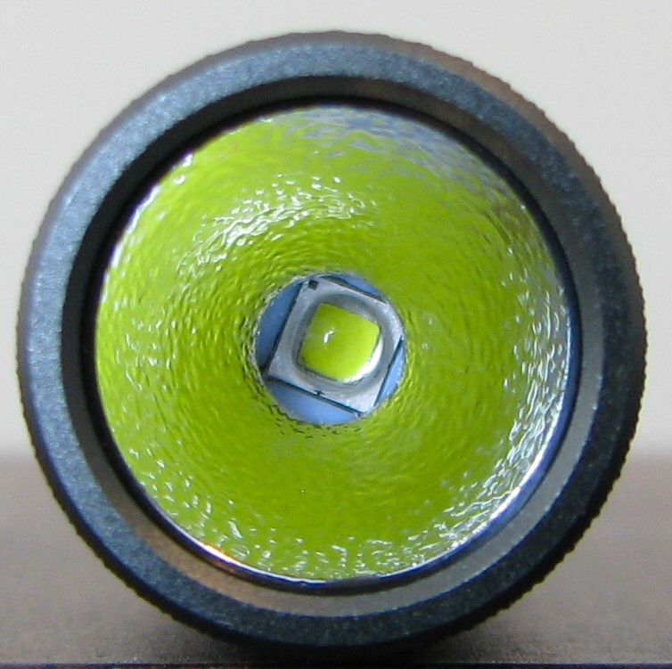

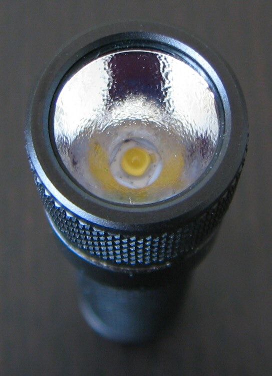

    As mentioned earlier, the lights are distinguished by their emitter choice:
    Nichia 219
    XP-G2 R5
    Centering was good on my Nichia 219 sample above – but pretty variable on the XP-G2 samples (both were noticeably off). This doesn't realty affect the beam on such small lights though. Both emitter versions seem to come with the same reflector – and which seems to be the same as the L10. Reflector is not overly deep, with an orange peel (OP) coating to smooth out the beam.
    Please see my detailed beamshots later in this review, for each model.

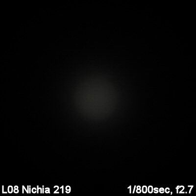

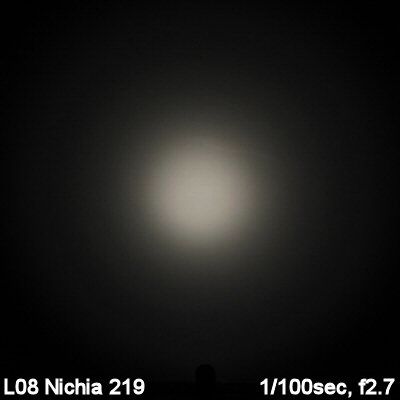

    For white-wall beamshots below, all lights are on Max output on a Sanyo Eneloop NiMH (800mAh). Lights are about ~0.75 meter from a white wall (with the camera ~1.25 meters back from the wall).
    Automatic white balance on the camera, to minimize tint differences – except for the Nichia 219, which is using a Daylight white balance on my Canon camera.
    Beam tint differences are really the first thing you are likely to notice between these emitters. The 4500K on the Nichia is very pleasing (to my eye) neutral white. The higher color rendition index (CRI) should also help display colors more consistently. This is hard to capture on a camera though, due to the narrow range of white balancing options
    The second most obvious difference is that the XP-G2 is more "throwy" than the Nichia 219, with a more defined hotspot on the XP-G2 models.
    Note: The manufacturer recommends you do not run on 10440 (3.7V Li-ion), so I haven't tested them.

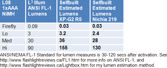

    The performance of the L08 samples is remarkably consistent with the L10 samples I tested previously.
    To explore this a little further, here is a breakdown of relative output levels on the L08, using my standard lumen estimation method:
    In general, I get pretty good match between the Nichia 219 and XP-G2 samples at the Moonlight/Lo/Med levels – and reasonably good concordance to the specs. Where things get particularly interesting is on Hi – the XP-G2 samples were brighter than the Nichia 219, and both models are brighter than the specs would indicate.

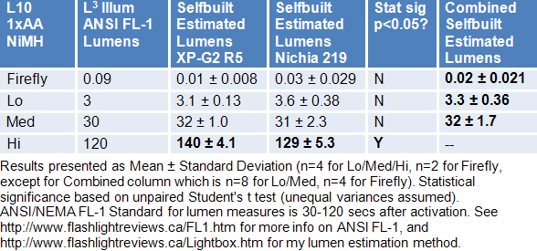

    To put these results into better context, let's take a look at how the L10 sample did in my earlier review:
    The above table is a little more complicated, as I had a sufficient number of samples of each L10 model to do statistical comparisons. The bolded numbers above tell you what you need to know. See my earlier L10 review for an explanation and discussion of the statistical methods.
    Generally, the L08 samples performed very similar to the L10 samples tested previously (i.e., equivalent output, at all levels). However, my XP-G2 L08 were both marginally brighter than my L10 XP-G2s (even though the specs say that are not driven as hard).
    As you will see in the runtimes below, part of the reason for the slightly higher max output here may have to do with the AAA NiMH chemistry and capacity, compared to AA NiMH. We'll come back to that ...
    In any case, based on these results alone, I would be tempted to conclude that the L10 and L08 are using the exact same circuit (despite the lower reported specs for Hi on the L08). But let's see if that conclusion holds up on further battery runtime testing below …

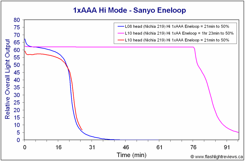

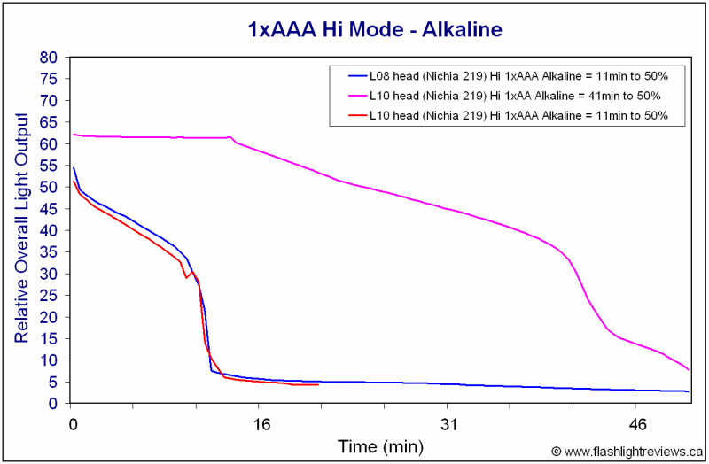

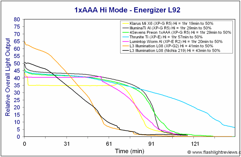

    Runtimes
    To facilitate output comparisons, I've left the y-axis (i.e., the relative output values) on the same scale for all Hi-mode runtimes.

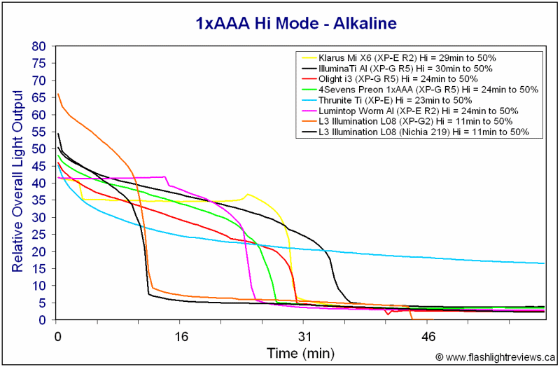

    As you can see, the L08 is unusually bright on Hi and Med on NiMH Eneloops (for the AAA-class). Unfortunately, it seems to be draining the cells too quickly on Hi on NiMH Eneloops. Typically, the max safe discharge rate for NiMH is 2C (i.e., a full discharge in 30 mins). The L08 is definitely pushing the AAA Eneloop cells to those limits.
    Another thing that is interesting to note is how much the output drops when run on standard alkaline or L92 AAA cells. For example, going from Eneloop to alkaline on Hi, my XP-G2 L08s drop from an ANSI FL-1 lumen estimate of 155 to 125 lumens, and my Nichia 219 L08 drops from 130 to 90 lumens. I had previously observed a small drop in output in my L10 testing (on the comparable AA battery sources), but the magnitude of the effect is much larger on the L08 with AAA cells.
    There are also runtime pattern changes between these two models as well – the L10s were far more flatly regulated on Hi, on all battery types (see my earlier L10 review for runtimes).
    There are two possible explanations here – either the circuit in the L08 responds differently than the L10 to battery voltage, or the lower capacity of AAA cells are affecting the results. Fortunately, I can partially verify this by testing the L10 heads on the L08 body. Note that while this is technically feasible, it is a bit tricky given the body tube design differences (and won't work for the L08 head on the L10 body). See my build overview comments earlier in this review for more detail.
    Here is what the runtime comparisons look like, for Hi on alkaline or Eneloop.
    The key point above is that when you run the L10 head with AAA cells on the L08 body, it shows exactly the same lower output and stabilization characteristics as the L08. These results make it very clear – the apparent performance differences between the L08 and L10 are due entirely to the difference in battery capacity and chermistray between AAA and AA.
    You also have an explanation aove for the slightly higher max output of my XP-G2 L08 samples compared to the L10: either head, when run on AAA NiMH, shows higher initial output than when run on AA NiMH. Eventually this levels off at a comparable output - but ANSI FL-1 output testing only takes into account the peak output within 30-120 secs after activation. Thus, the reason for the higher output on my L08 testing is due to the reduced stabilization pattern of AAA Eneloop cells compared to AA cells.
    Taken together, this all supports my conclusion that there is no real difference in the circuit used in the L10 and L08. But there are build differences in how the head is assembled, so you can't easily switch body tubes (again, see my earlier build comments).

    Although still small in absolute terms, the L08 is relatively large for a 1xAAA light. The head has identical dimensions to the L10 model, for example, and overall weight is comparable between the 1xAA and 1xAAA models.

    As promised, here are some size comparisons of the L08 and L10:

    Quote Originally Posted by stevenkelby View Post
    Why would someone choose this over the L10?
    Default Re: L3 Illumination L08 (XP-G2 R5 or Nichia 219, 1xAAA) Review: RUNTIMES, BEAMS, VIDE
    Yes, I tend to favor the L10 myself for improved regulation and extra runtime (for roughly similar overall size). But weight with eneloop battery is 34.1g for the L08, and 47.1g for the L10 (if that matters).
    You could still use an AAA eneloop in the L10. The cheap plastic AAA->AA adapters are 3.4g (net 35.8g using AAA in L10), still, the L10 is still the preference for me too. Just goes to show how compact the L10 is.

    Would you say that power and battery suspension mechanism in the L10 (i.e., "battery crusher" design, with foam doughnut) is better or worse than that of the L08 (i.e., spring and isolated board)?
    It seems to me like the L08 is a better design in that regard. Then again, has L3 Illumination just traded one problem ...
    -- [risk of battery damage over time in the L10]
    for another ...
    -- [risk of circuit board wearing out where it contacts the body in the L08]
    6,936
    Quote Originally Posted by ronniepudding View Post
    for another ...
    Yes, it is a bit of six of one, half a dozen of the other. Hard to know which is worse in the end.
    I wouldn't, if they'd put a spring in the L10 too.
    Also, I like that the head is larger than the body, for quick orientation in the dark (for those of us who carry loose in the pocket & not on a keyring). But that's less of a factor than the spring for me.

    How hard do you have to twist to "crush" the battery? I have an L10 that I use with an Eneloop, and I've never noticed any damage to the battery. Do you mean a really hard twist, like you're taking the lid off a jar? Or can it be damaged from normal use? I also have a Preon P0 that uses the same design, and haven't noticed any battery damage from it either. Neither lights see much use, so does it only occur over time and a lot of usage?
    Yeah, I wouldn't call the L10 a battery crusher. The foam pad makes it feel cheap and less durable than a spring, but you only need to twist it down just enough to make electrical contact. Now the Peak QTC lights really do feel like battery crushers

    Quote Originally Posted by MojaveMoon07 View Post
    Considering the regulation and runtime of the L08 AAA on high, could this shorten the lifespan of the NiMh battery?
    Yes, that is exactly the problem here. As long as you discharge a battery within its max safe discharge rate (which is 2C for NiMH - i.e., fully discharged in 30 mins), you should be fine. But as you can see my L08 samples seem to be exceeding that rate on standard 800mAh eneloops. That is not a good idea for the long-term health of your cells.
    There's a good test of this for Eneloop cells here:
    http://www.candlepowerforums.com/vb/...-Cycle-Testing
    In summary, this guy torture-tested AA Eneloops to see how many cycles they get. The generation 1 cells got about 300 cycles (instead of 1000), and the generation 4 got about 600 or 700 cycles (instead of 2100). So while it's a lot less than the gentle usage that will get you the full 2100 cycles, it's still several hundred cycles if you abuse them. That's likely many years worth. I wouldn't worry about it.
    It has a spring contact instead of a foam doughnut, it is the best throwing light in aaa format, the only aaa with decent optics and a good range of outputs to use a nichia 219. For all these reasons I can forgive its size and it will still sit better in my watch pocket than the L10. Have ordered natural 4 mode nichia 219 from SB flashlights.... should be here soon...

    ... that is exactly the problem here. As long as you discharge a battery within its max safe discharge rate (which is 2C for NiMH - i.e., fully discharged in 30 mins), you should be fine. But as you can see my L08 samples seem to be exceeding that rate on standard 800mAh eneloops. That is not a good idea for the long-term health of your cells.
    I've noticed that the max output on the L08 has recently been reduced to 90 lumens. When I enquired with the manufacturer, they replied that this was done to improve runtimes on high. It also likely resolves the concerns of excessive battery discharge rate at 130-140 lumens. I realize this driver change doesn't make the light more appealing to those objecting to size/weight when compared to the L10 twisty, -- but for those who like the design of the L08 better, it does address the other main issue raised by Selfbuilt's review.
    6,936
    That's good to know - thanks for sharing the update!
