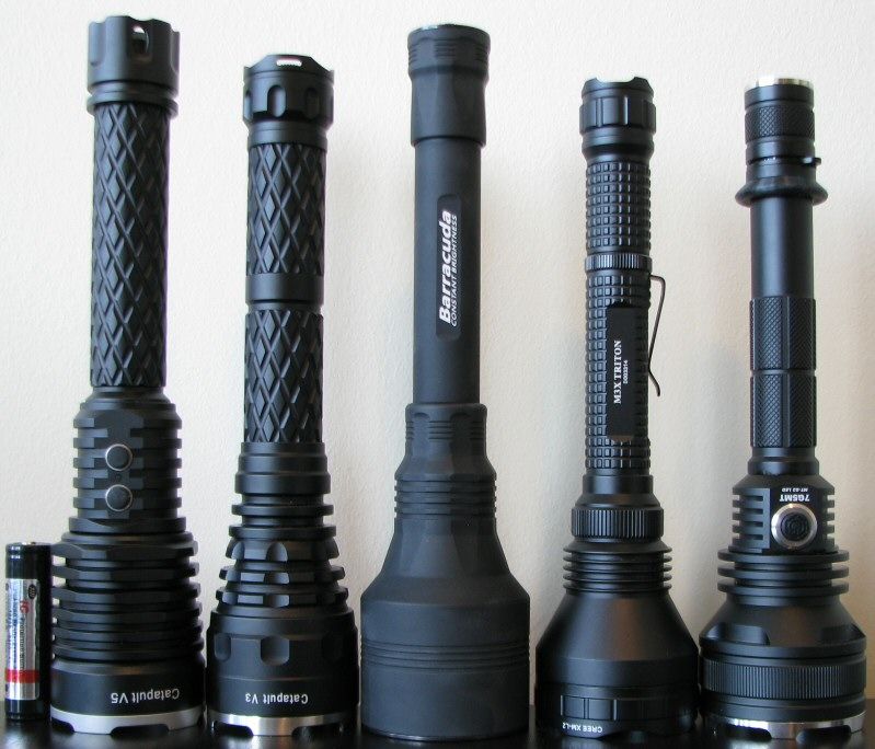

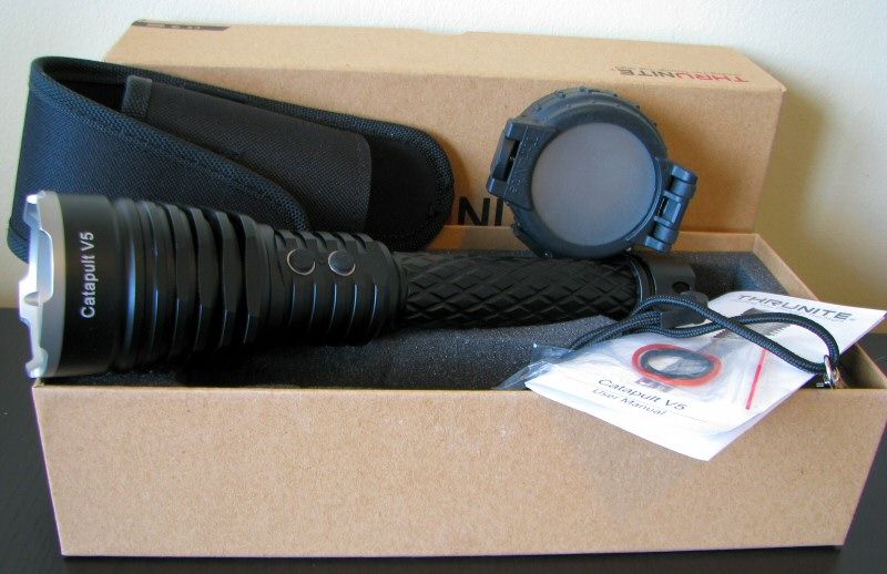

    Packaging is a hard cardboard box with cut-out foam. Inside are the light (in bubble wrap), open-ended belt pouch, wrist lanyard, manual, extra o-rings, and snap-on flip-top diffuser cover.
    From left to right: AW Protected 18650 2200mAh; Thrunite Catapult V5, V3; Armytek Barracuda; Olight M3X; Crelant 7G5MT.
    Thrunite Catapult V5: Weight: 556.7g, Length: 266mm, Width (bezel) 59.1mm
    Thrunite Catapult V3: Weight: 434.8g, Length: 254mm, Width (bezel) 58.0mm
    ArmyTek Barracuda: Weight 400.8g, Length 264mm, Width (bezel): 64.0mm
    Crelant 7G5CS: Weight: 334.5g, Length: 247mm Width (bezel): 64.0mm
    Eagletac GX25L2 Turbo: Weight: 320.7g (with battery pack: 412.5g), Length: 251mm, Width (bezel): 62.0mm
    Eagletac SX25L2 Turbo: Weight: 343.4g (with battery pack: 534.3g), Length: 255mm, Width (bezel): 62.0mm
    Klarus XT30: Weight: 283.1g, Length: 247mm, Width (bezel): 58.0mm
    Niwalker 750N1: Weight: 408.0g, Length: 269mm, Width (bezel): 58.6mm
    Olight M3X with Extender: Weight 277.8g, Length 244mm, Width (bezel): 62.3mm
    Sunwayman T40CS: Weight: 296.7g, Length 227, Width (bezel): 63.5mm
    Surefire UB3T: Weight: 311.1g, Length 229mm, Width (bezel): 63.1 mm

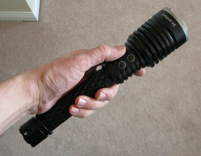

    As before, the Thrunite Catapult V5 is one beefy light. This line has always had a very thick-walled build, with high weight for the class. Anodizing is as before, a glossy black with no chips or damage on my sample. Labels were sharp and bright white against the black background. There isn't traditional knurling per se, but the V5 uses the same checkered pattern on the battery handle for grip. Thanks to the relative sharp edges, grip is very good on the Catapult series.

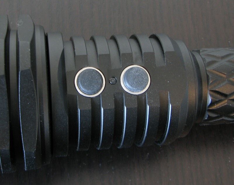

    The main change from the V3 build is the use of two electronic switches in the head now, instead of the tailcap clicky/head twist control mechanism. See my User Interface for a discussion of how they work. Switch feel has a little more resistance here than typical I find, and the switches themselves are fairly small. There is a definite click sound on a full press.

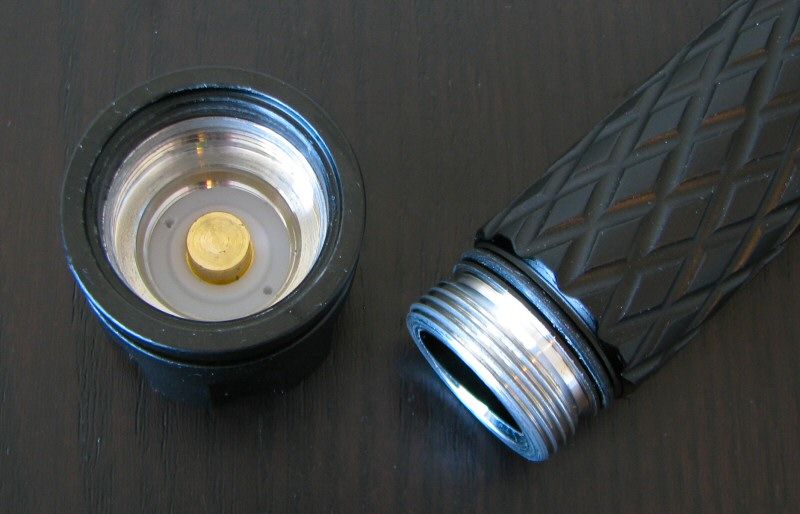

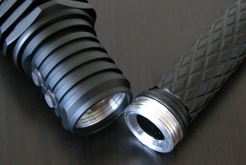

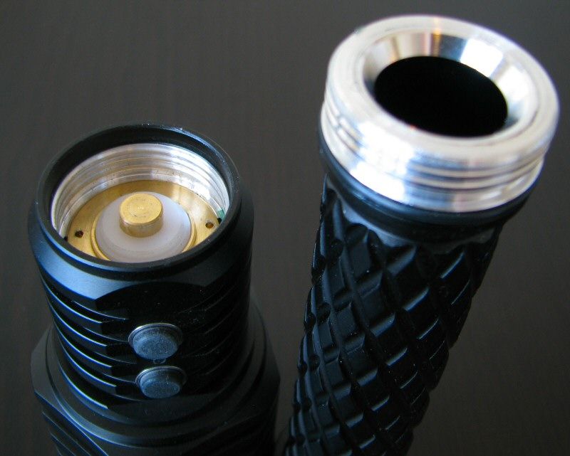

    The body handle is one solid piece now – it no longer separates to allow 1x18650 use. There are cosmetic touches to the styling at the base of the head and tailcap, and bezel is more polished now (but still made of stainless steel).
    Another difference is screw thread diameter has changed at the head (unchanged at the tailcap). Threads are also no longer anodized for lock-out. Threads are standard triangular cut in the tail, and square-cut in the head. All seem of good quality.

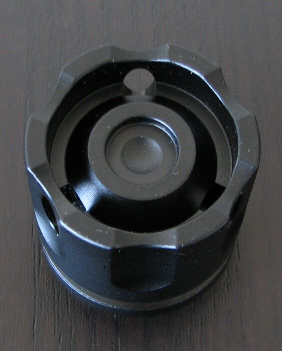

    There are spring in the head and tailcap, both covered by a brass-colored cap. The tailcap has a redesigned appearance, and the light can tailstand as before (the raised ridges also serve as attachment points for the wrist lanyard).

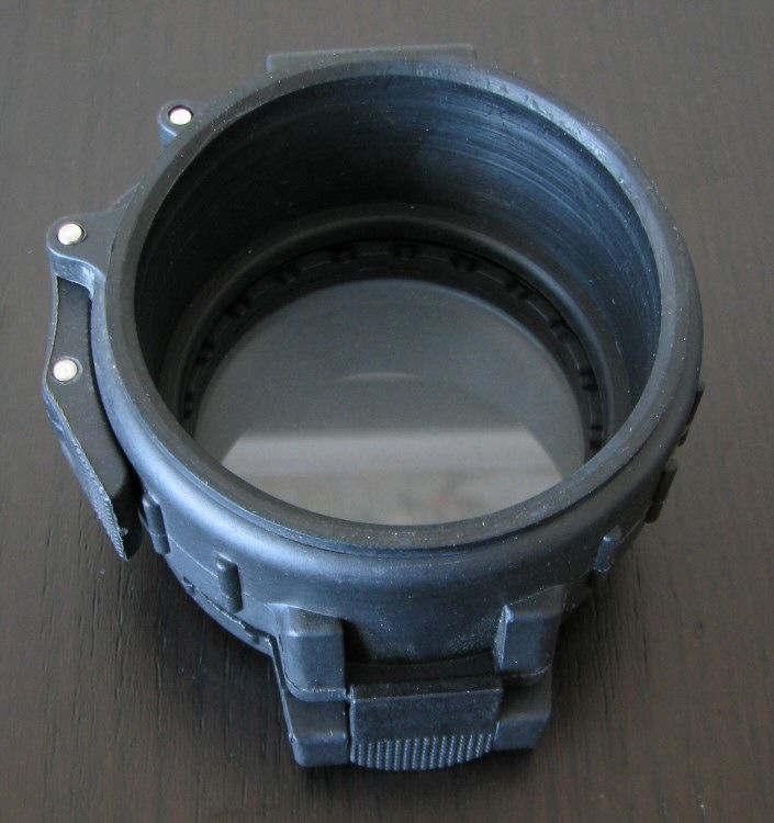

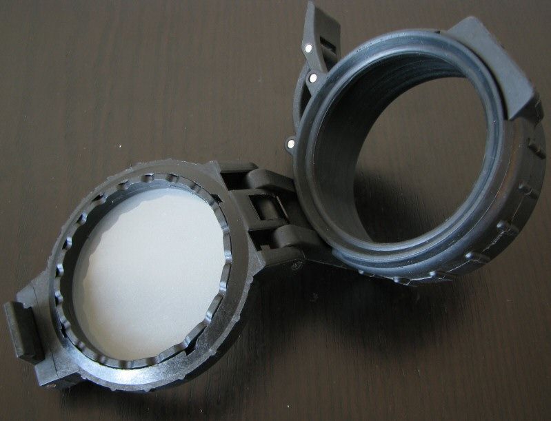

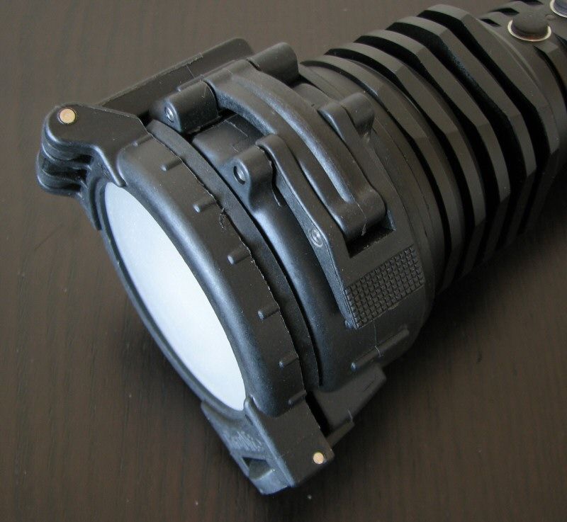

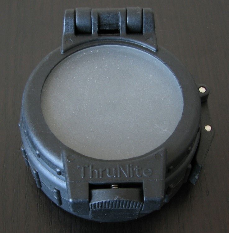

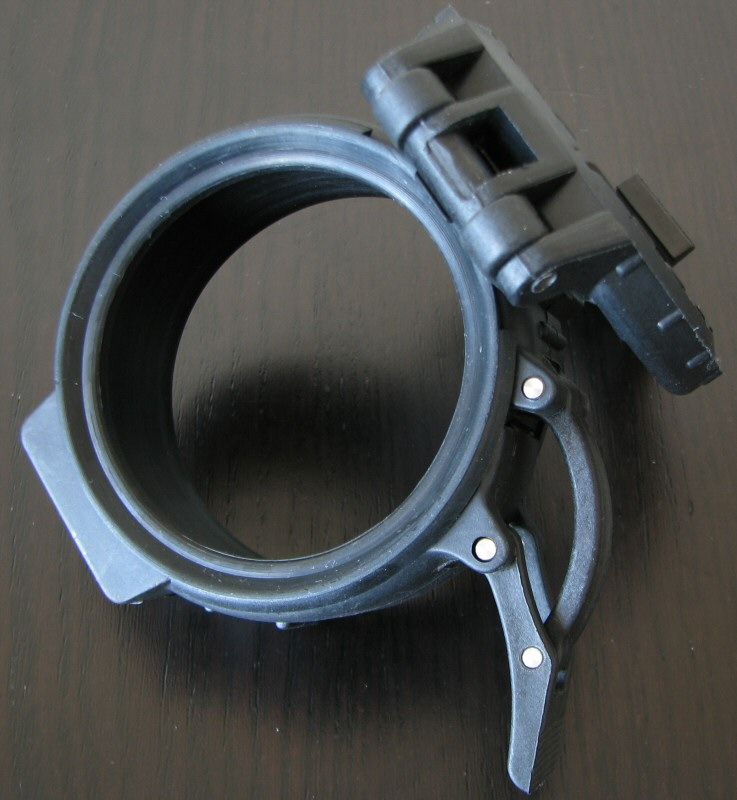

    Here's an interesting addition to stock package – Thrunite has thrown in their flip-top diffuser:
    The Thrunite snap-on, flip-top diffuser is very similar to the old Surefire Beam Shapers (e.g., see my old UB3T review). You loosen the side clamp and slide the diffuser assembly over the bezel. Once in position, clamp down to hold the diffuser on securely. There is a spring-mounted latch that holds the diffuser cover down. Presumably, you could swap out the diffuser lens with colored filters, if available.

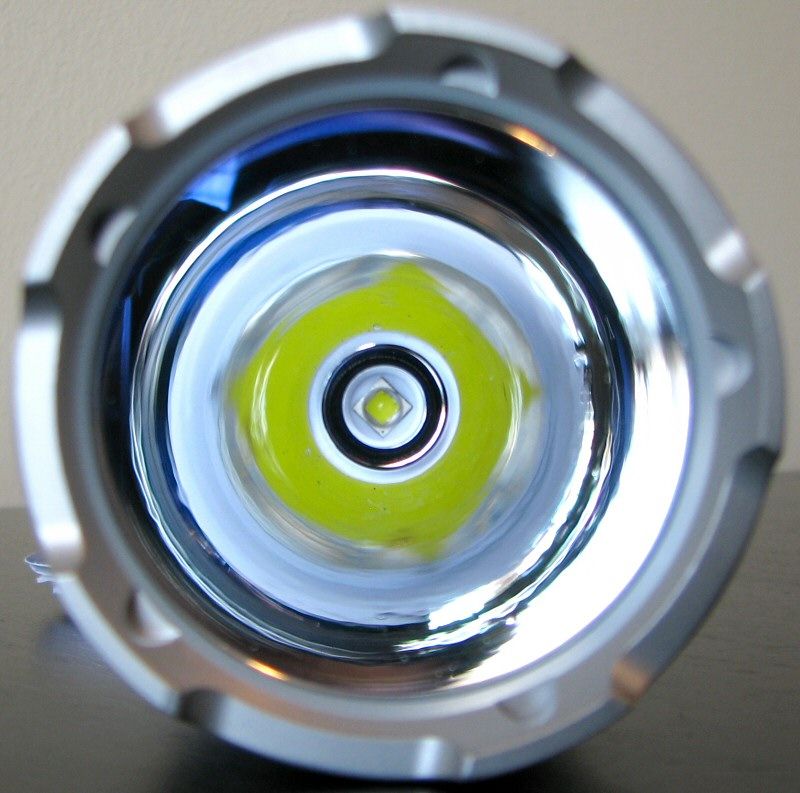

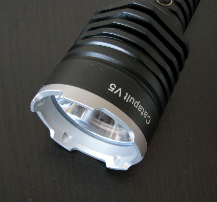

    The XM-L2 emitter was well-centered at the base of a very large and deep reflector on my Cat V5. Overall reflector dimensions look similar to V3, but I haven't measured it. Smooth finish as before, this should provide outstanding throw. There is a good quality anti-glare coating on the lens. Scroll down for beamshots.
    Turn the light off/on by clicking the lower electronic switch.
    Change output modes by clicking the upper electronic switch. Mode sequence is Lo > Med > Hi > Turbo, in repeating sequence. There is mode memory, and the light will return the last level used after turning off/on.
    To access Strobe while on, press and hold the upper mode switch. To access Strobe directly from off, similarly press and hold the upper mode switch (momentary mode). If you hold the switch down for more than 3 seconds, the light will remain in constant Strobe mode once you release.
    To lock out the light, hold down the lower electronic switch for between 3-6 seconds. After 3 secs, the main beam will flash twice. Once you release the switch after this point, the light will be locked out. Hold the switch down for 6 secs to unlock.
    There is small, faint LED indicator indicator located between to two switches. This flashes blue once ever ~12 secs or so when in standby (i.e., off, with battery installed). It turns on in constant blue when the light is running. It turns red as the batteries are running low, and starts flashing red once they are nearly exhausted.

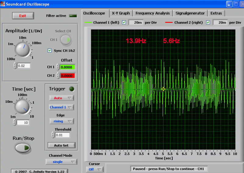

    PWM/Strobe
    There is no sign of PWM on any level – I believe the light is current-controlled.
    As with other recent Thrunite lights, strobe is an oscillating frequency strobe, switching between 5.6Hz and 13.9Hz on my sample. Each frequency lasts for about ~2 secs. Here is a blow-up of each strobe frequency individually:
    There is a bit of a ramp-up to the peak strobe output, but it is not something you could see in practice. Strobe is quite blazingly fast to the eye.

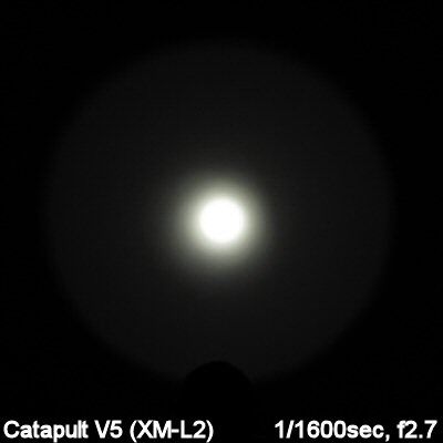

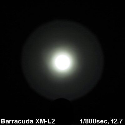

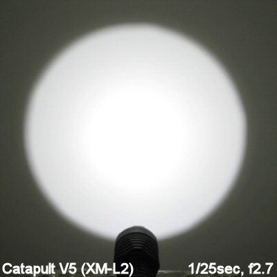

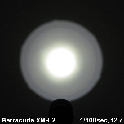

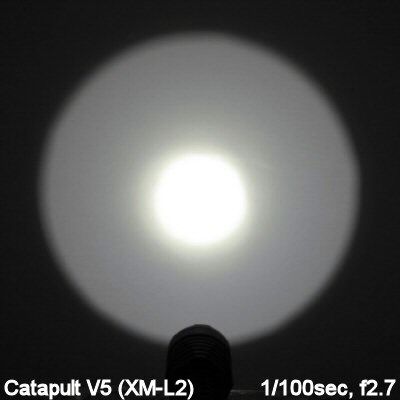

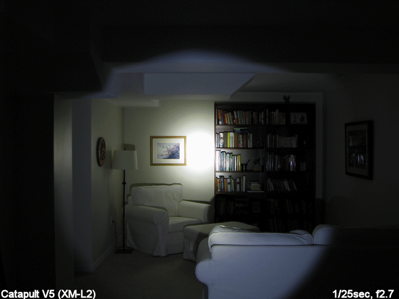

    And now, what you have all been waiting for. All lights are on 2x AW protected 18650 2200mAh. Lights are about ~0.75 meter from a white wall (with the camera ~1.25 meters back from the wall). Automatic white balance on the camera, to minimize tint differences.

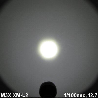

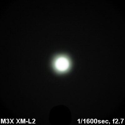

    Obviously, it's hard to tell much at such ridiculously close distances. The most obvious observation is that the Catapult V5 has a very similar beam profile to the V3 - but with a lot more output (and throw).
    It is interesting to compare to the two other top XM-L2 throwers in the 2x18650 class - the ArmyTek Barracuda and Olight M3X. The Barracuda has a deeper and narrower reflector, giving you good throw, but at the expense of spillbeam width (compared to most other lights). The M3X has a relatively wide reflector, giving you a much wider spillbeam width than the Catapults.

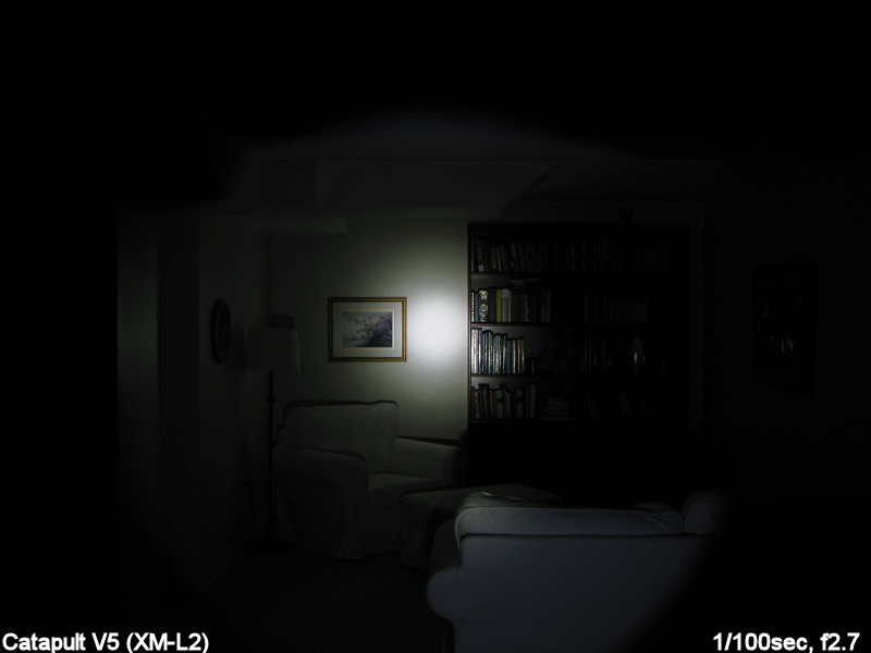

    Unfortunately, spring is still slow in showing up in my part of Canada. Outdoor shots still aren't feasible for at least a few more weeks – I will update this thread once they are ready.
    For now, you will have to make do with some indoor shots in my basement. For your reference, the back of the couch is about 7 feet away (~2.3m) from the opening of the light, and the far wall is about 18 feet away (~5.9m). Below I am showing a couple of exposures, to allow you to better compare hotspot and spill.

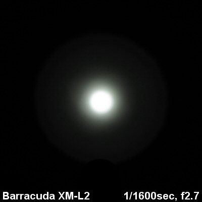

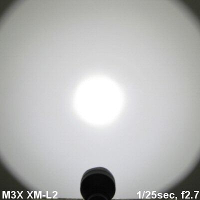

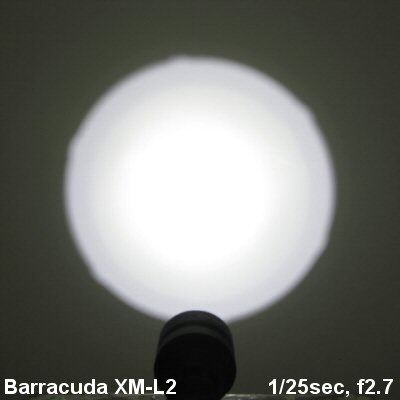

    Let's compare the Catapult V5 to the earlier V3, and the ArmyTek Barracuda:
    I've done a lot of exposures above so that you can directly compare. Technically, the Barracuda can produce about the same peak intensity throw (i.e., compare the center of the hotspots). But it should be obvious from the above that the Catapult V5 has a more uniformly bright hotspot. The result is that everything that falls into that Cat V5 hotpot is evenly lit, whereas the Barracuda has a gradation in output from the center to the edge.

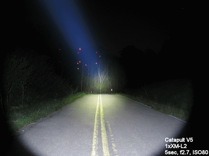

    UPDATE May 17, 2014: Weather conditions have finally improved enough to start taking outdoor beamshots around here. Here is a comparison of the Catapult V5 to the Thrunite TN32, and Fenix TK61 (stock).
    As always, these are done in the style of my earlier 100-yard round-up review. Please see that thread for a discussion of the topography (i.e. the road dips in the distance, to better show you the corona in the mid-ground).
    I realize these comparisons are a little unfair, as the Catapult V5 is only a 2x18650 light (compared to 3x and 4x specimens above). But it goes to show you how impressive the V5 is, that it can approach the larger and more heavily-driven TN32. If I get the chance to compare the V5 to other lights in the 2x18650 class, I will update this review.

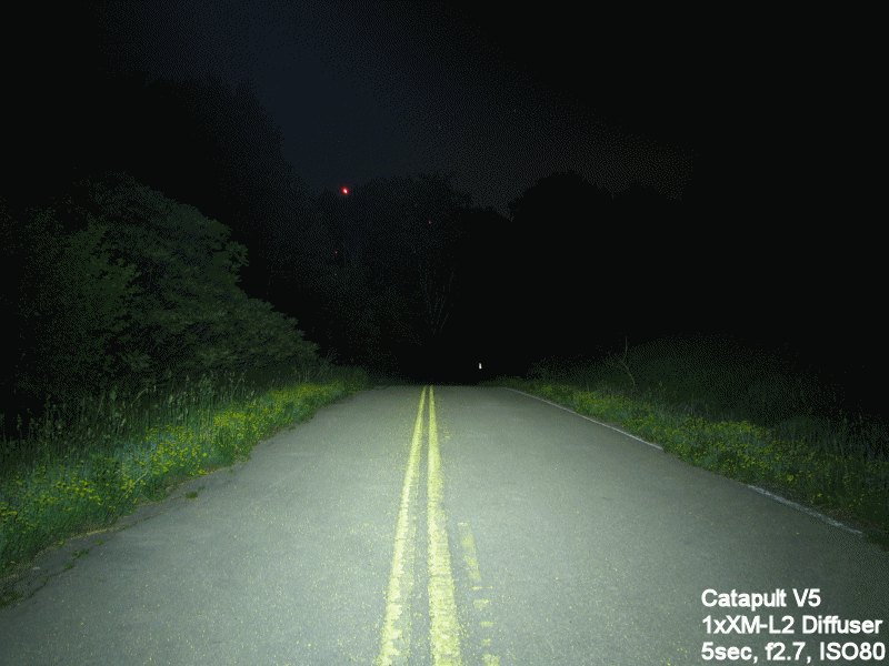

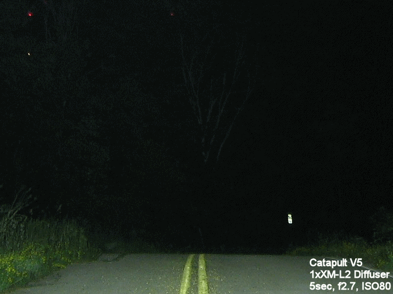

    UPDATE JUNE 12, 2014:
    FYI, here is an additional outdoor beamshot with and without the diffuser in place.
    As you could probably tell from the indoor beamshots, the Cat V5 is a lot brighter than the Cat V3 – both for output and for throw. In terms of peak intensity center beam, the Cat V5 narrowly squeezes past the ArmyTek Barracuda (which is not driven as hard overall). Given the significant differences in the beam pattern of all the max thrower lights, the beamshots really tell this story the best – scroll back up for some shots.

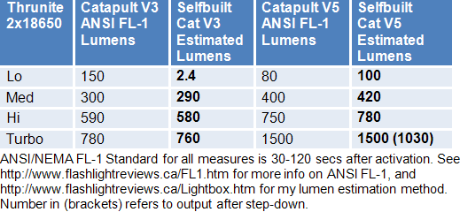

    As an aside, it's nice to see that the ANSI FL-1 specs for output and center beam intensity are bang-on with my sample.
    Here is a breakdown of the estimated lumen values for both the Cat V3 and V5 in my testing:
    As usual, Thrunite's output specs remain remarkably consistent with my testing – making me thing they did indeed get these tested in a properly-calibrated integrating sphere. The exception above is the Lo level of the Cat V3, but that may have been due to the early review sample I received (i.e., later models were adjusted for Lo).

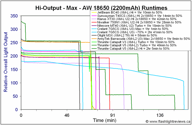

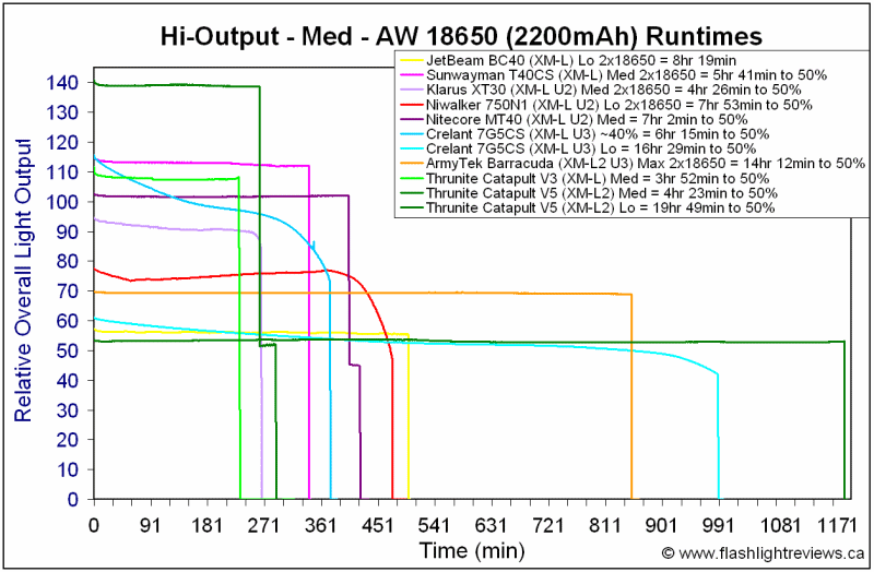

    Output/Runtime Graphs:
    As usual, AW protected 2200mAh cells are used in all my runtime testing
    The Catapult V5 now shows a clear step-down pattern over time, as the cells drain. The first step-down from Turbo happened around 4 mins in my testing. This is actually a positive development – the earlier Catapults were heavily driven on max, without a timed or thermal step-down. This made it potentially unsafe to run on 4xCR123A (i.e., the cells internal PTC protection feature could be set off on sustained runs).
    The overall output/runtime efficiency is excellent, at all levels tested. Similarly, the light shows flat stabilization at all levels (with defined step downs over time).
    Any way you look at it - from an output, efficiency, or regulation perspective - the new Catapult V5 is well suited to both 2x18650 and 4xCR123A. A definite winner in my books.

    The physical clicky switch has been replaced by two electronic switches in the head. As a result, there is stand-by current now when off – but it was so low (~10 uA in my testing), that it is absolutely not a concern for draining your cells. This is below the self-discharge level of Li-ion. Accidental activation is another possibility, as the light no longer has anodized threads for physical lockout - but Thrunite does provide an electronic switch lock-out feature.
    Switch buttons are relatively small, and require a firmer than typical press to activate. I sometimes found nothing would happen upon a button press, if I didn't press it firmly in the center.
    The bezel has a more polished/brushed appearance now, but it is still made of stainless steel.

    Default Re: Thrunite Catapult V5 (XM-L2, 2x18650 4xCR123A) Review: RUNTIMES, BEAMSHOTS, VIDE
    I have a question about the "step-downs" on your run times charts for this light. After the initial step-down (4 minutes on turbo), if you turn off the light and let it cool off, I assume you will get full turbo brightness if you turn the light on again. (Maybe that's wrong.) What happens to the later step-downs under the same circumstances? For example, if the batteries are sufficient depleted to have triggered a step-down in high mode (or medium mode), will a cooled-off light come on at the stepped-down level or will it recover?
    6,936
    Quote Originally Posted by akapuckthecat View Post
    That's correct. The first step down is different from the later ones, as it responding to the heat generated on Turbo. If you restart the light cool, you will get max output again for a few mins.
    No, in these cases the batteries are too drained to let the light continue to run at the higher levels. Cells recover a bit of voltage once you remove the load, so it's quite likely you will be able to re-active at the higher set level - but the light won't stay there for long, as the drained batteries will trigger a step-down.
    I haven't tested the light to confirm the above, but it is what I would expect based on my experience with other lights with similar circuit patterns.

    I’ve also emailed HKEquipment.net, to ask if the TN Catapult Flashlight Flip RED Filter they are selling is diffused light or a coloured lens.

    Thanks for adding the perspective. Yes, it does just go to show what a well-designed diffuser cover can do to enhance the value of a light.
    I got a diffuser with my Eagletac MX25L3 and used it a few times. I'm not really convinced they're a great idea or at least it failed to impress on that light.
    6,936
    Quote Originally Posted by InspectHerGadget View Post
    The value of a diffuser often depends on how throwy a light is, and how narrow the spillbeam. It definitely makes a huge difference to the Cataput V5. I wouldn't consider it as essential for the MX25L3 MT-G2 version (although could be more useful on the XM-L2 version)
