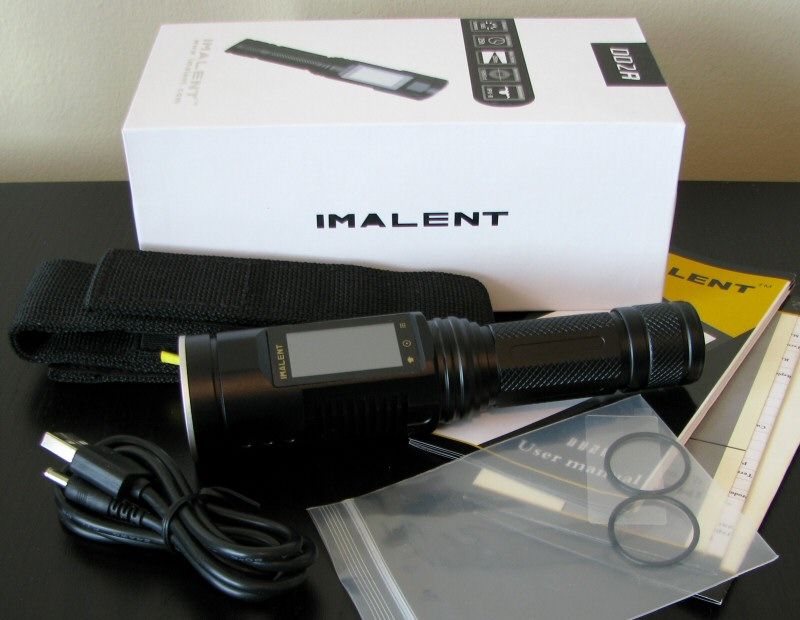

    Packaging is similar across the IMALENT line. Inside the hard cardboard case with cut-out packing foam are the light, spare O-rings, spare display cover, micro-USB charging cable, belt holster with Velcro closing flap, product inserts and manual.

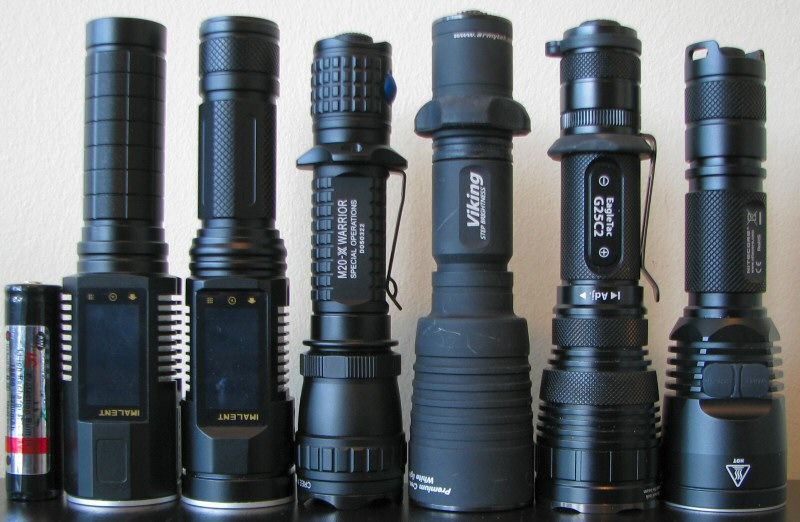

    From left to right: AW protected 18650 2200mAh; IMALENT EMT16, DD2R; Olight M20S-X; ArmyTek Viking; Eagletac G24C2-II; Nitecore CR6.
    IMALENT DD2R: Weight: 143.6g , Length: 149.4mm, Width (bezel): 36.0mm
    IMALENT EMT16: Weight: 152.9g , Length: 150.0mm, Width (bezel): 36.6mm
    Fenix PD35: Weight: 82.7g, Length: 138.1mm, Width (bezel): 25.4mm
    Foursevens MMR-X: Weight 90.8g, Weight (with 18650): 138.5g, Length: 138.6mm, Width (bezel): 31.5mm
    Foursevens MMX Burst: Weight 145.8g, Length: 153.3mm, Width (bezel): 38.7mm
    Klarus RS11: Weight 158.0g, Length: 160mm, Width (bezel) 34.9mm
    Nitecore P12: Weight: 89.7g, Length: 139.4mm, Width (bezel): 25.4mm
    Nitecore P25: Weight: 171.3g, Length: 160mm, Width (bezel): 40.0m
    Rofis TR31C: Weight: 180.7g, Length: 153.0mm, Width (bezel): 39.8mm
    Thrunite TN12-2014: Weight: 80.0g, Length: 140.5mm, Width (bezel): 25.4mm
    Zebralight SC600 II: Weight 79.3g, Length: 101.8mm, Width (bezel) 29.7mm

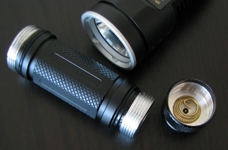

    The DD2R anodizing is a matte black, and seems to be good quality on my sample. Labels are minimal and bright white, clearly legible against the dark background. There is some knurling on the battery tube and tailcap, but it is of mild aggressiveness. With the heatsink fins and buttons in the head, I would say overall grip is good.

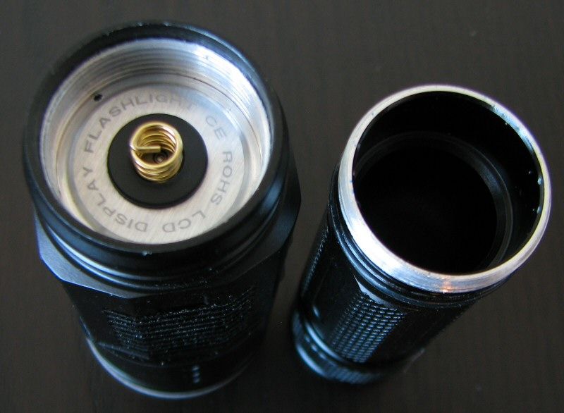

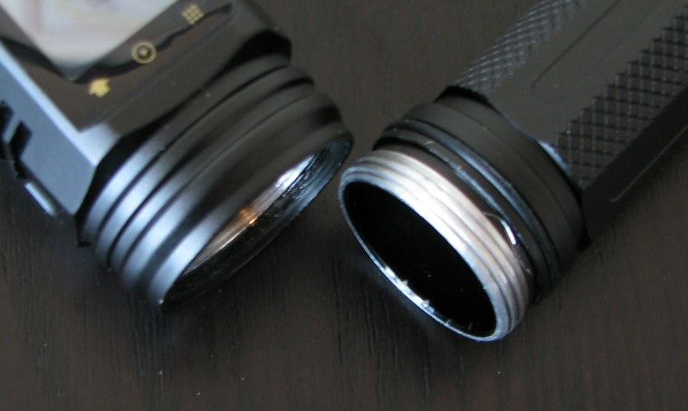

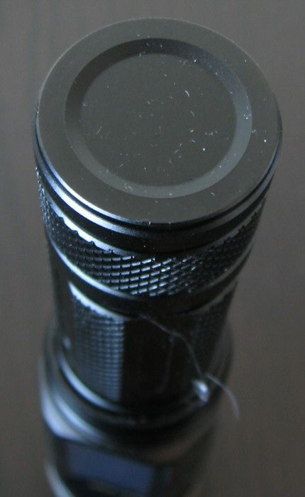

    Note that the light opens at both ends of the body/battery tube. Screw threads are square cut, but are not anodized at either end. As such, tailcap lockout is unfortunately not available.
    Light can tailstand stably.

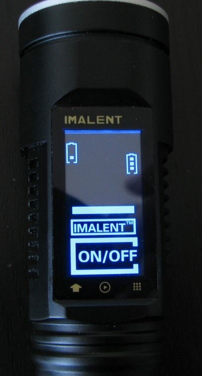

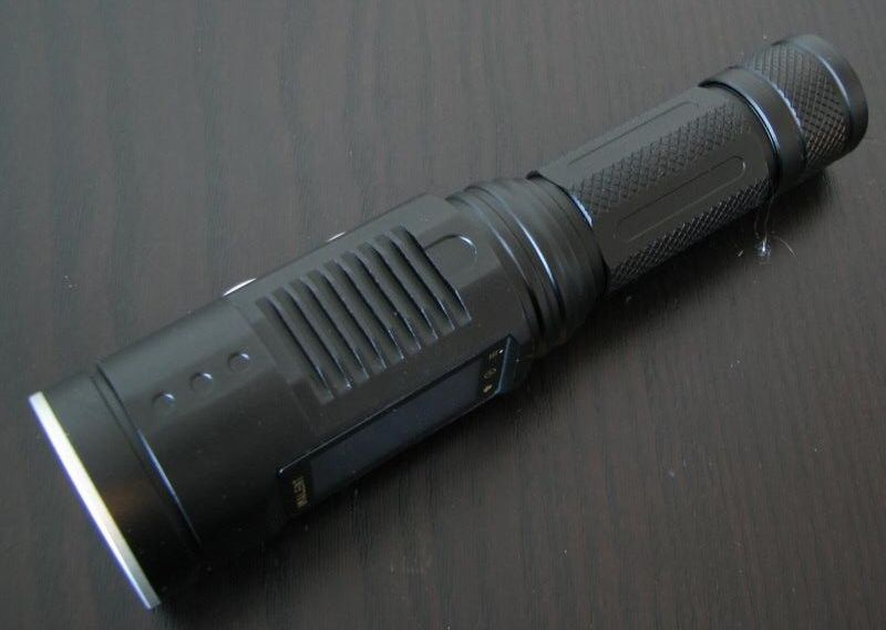

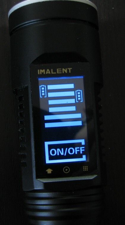

    There is no physical clicky switch – the light is controlled by the electronic switch and touch screen in the head. Timings for the electronic switch have been updated from earlier models (see User Interface section later in this review).
    The touch screen, when activated, displays relevant information about battery status and output level.
    What you are looking at is two conditions: one when the light is running on full power (i.e., all 6 level bars indicated), and one where it is on minimum output (i.e., one level bar showing). You can control the output using the touch screen, as I will explain in the User Interface section below (and in the Video).
    Note that there are a lot more than 6 output levels – I can count dozens of individual levels per status bar on the display (IMALENT reports 100 discrete levels). The display is simply showing a relative output level, using 6 bar indicators. Again, scroll down to my User Interface section to learn how to use the light.
    The battery indicator on the left is telling you estimated charge remaining on the installed cells. The right battery indicator seems to be specific for charging (i.e., isn't displaying relevant info when simply running the light). Below the IMALENT name is an ON/OFF indicator, which is used to control activation when the light is in a special Standby mode (or strobe, when the light is on). Again, see my User Interface section below for more info.
    Incidentally, you may see pics out there of the touch screen with an orange display. The first batch of samples produced by IMALENT had an orange screen – the recent shipping versions all have a blue screen.

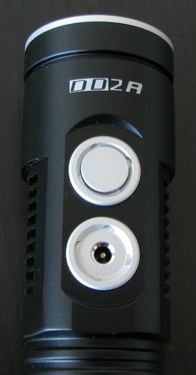

    The electronic switch has a typical traverse and firm "click" for an electronic switch – although the metal button cover can move around somewhat (i.e., feels "loose"). Just above it, there is a built-in charging port for the 18650 cell.
    The light comes with a micro-USB charging cable. Simply plug the light into any USB port (or with an adapter, to any AC outlet). The maximum charge current of USB 2.0 is 500mA, so it will take several hours to charge an 18650 cell. See my detailed results and comments under User Interface section below.

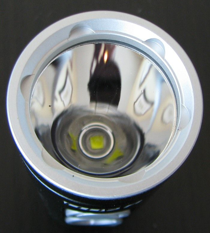

    Let's take a look at the head and emitter …
    There is a lightly-colored bezel ring that holds the lens in place (I can see an anti-reflective coating on the lens). At the base of a relatively deep and smooth reflector is the XM-L2 emitter, which was well centered on my sample. I would expect reasonably good throw for the class, with a narrower than typical spillbeam. Scroll down for some beamshots.
    IMALENT has a novel interface, with the use of a pressure-sensitive touch screen to control output levels on their lights. When you first connect a battery, the display will illuminate for ~3 secs, while the circuit determines the best settings to match the installed battery type.

    Turn the light on quick click of the electronic switch in the head. Turn the light off by a sustained press-hold of the switch for ~1 sec. On previous models, you had to hold the switch for several seconds (i.e., on the earlier models it was ~2 secs to turn on, ~3 secs to turn off).
    When first activating the light, the touch screen panel will illuminate at the same time as the main beam. You can now set your constant output level by sliding or tapping your finger up and down the screen, in the area where the six bars are located. The light sets the output at whatever level you left it when you remove your finger.
    Note that although the display only shows six possible bars, there are actually many more discrete levels (IMALENT reports 100). While not enough to make the light seem truly continuously-variable in handling, it is enough that you will not be left wanting for levels. The 6-bar indicator is thus only a rough approximation of output.
    The output continuum of the touch display is not "visually linear", but distributed around actual output levels. In practice, this means that there will not be a lot of visual difference between the 4-6 bar levels, and a lot of variation in the low levels (i.e., it is well known our perceptions of relative output are skewed in a non-linear way).
    The sensitivity of the screen is reasonably good, but you will likely experience some "jerkiness" as you move up and down between levels. It is also not as touch sensitive as modern smartphone/tablet screens – think more along the lines of the sensitivity of a stand-alone GPS unit. Note that the touch screen is pressure sensitive, not capacitive. This means that you can adjust the output while wearing gloves (although it also explains why it is less responsive than a capacitive screen).
    There is mode memory for when you turn the light off/on at the electronic switch (i.e., returns to the last level you left it at).
    The battery indicator on the top left gives an estimate of the battery life remaining.
    Previously, the "IMALENT" label on the display flashed continuously whenever you are running the light at Max output. At my suggestion, IMALENT has disabled this (i.e., it no longer flashes at you).
    The touch display will turn itself off if there is no activity at the panel for 30 secs. IMALENT considers this to be a "lockout function", as you cannot accidentally change modes after the display shuts off. To toggle the touch display on or off at any time, simply click (press-release) the electronic switch. This is unchanged from previously
    Strobe is accessed by touching and holding you finger on the "ON/OFF" label on the touch display for ~0.5 secs (previously need >2 secs). Press and hold again to advance to SOS. Press and hold again to return to constant output. Note that there is no memory for the blinking modes (i.e., off/on switching returns to you to the last memorized constant output mode). Interestingly, the output level control works when in SOS or Strobe – simply slide your finger over the display to control the relative output of these modes, at any time.
    There is an alternate way to control the light, which is to put it into official Standby mode. To do this, press and hold the electronic switch for ~0.5 secs from On, and release. Do not hold it the >1 sec required to fully turn off, and do not do a quick click (required to activate/deactivate the screen). The timings are much quicker now – you need to be ~0.5 secs to enter Standby mode. When in this mode, the touch screen remains illuminated, but with only the "ON/OFF" indicator lit. Simply tap the "ON/OFF" label on the display to re-activate the light in the last constant-output mode you left it.
    To be honest, I'm not really clear on the value of this special screen-sensitive (and illuminated) Standby mode. You could always just turn the light on by a simple click of the switch (since it is always drawing a standby current).
    UPDATE April 12, 2014: IMALENT informs me that they will remove this additional standby mode on the DD2R and DD4R, and further shorten the time required to turn the light off by the electronic switch.

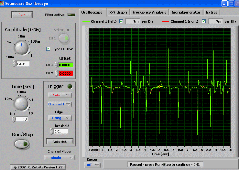

    PWM/Strobe
    The DD2R appears to be current-controlled. I saw no sign of PWM in my testing, on any level. Like the DD4R though, there was some high-frequency circuit noise (invisible to the eye).
    DD2R Noise:
    Note that this sort of noise is common on many current-controlled lights, and does not affect performance (nor is it detectable visually). As per my usual review policy, I simply report on all circuit features that I can detect – it doesn't mean they are significant in use. Rest assured, the DD2R is flicker-free in use, at all levels.

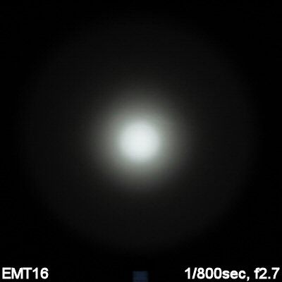

    For white-wall beamshots below, all lights are on Max output on an AW protected 18650 battery (2200mAh). Lights are about ~0.75 meter from a white wall (with the camera ~1.25 meters back from the wall). Automatic white balance on the camera, to minimize tint differences.
    Beam patterns are effectively identical for the DD2R and EMT16. The common beam pattern is what you would expect for lights with reflectors of this size – a narrower than typical spillbeam, but with reasonably good center-beam throw.

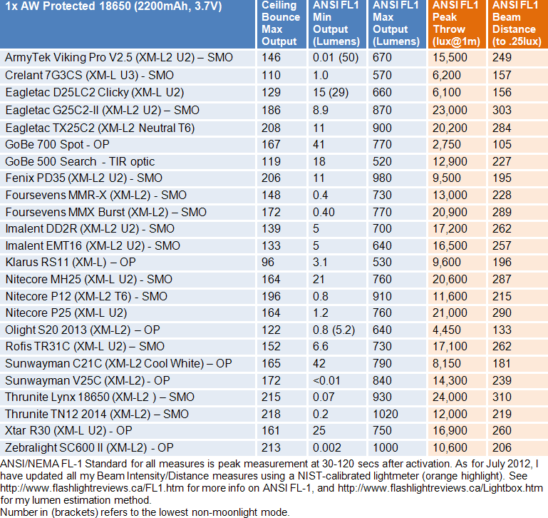

    Peak intensity throw on my DD2R and EMT16 samples are fairly consistent with the specs, but max output levels are lower than what is reported by IMALENT. My DD2R was slightly brighter overall on max than my EMT16 - but it is difficult to compare exactly, due to fluctuations in initial output on activation. As with my DD4R sample, I believe IMALENT is using "emitter lumens" instead of actual measured out-the-front output (i.e., specs are based on theoretical maximum of the emitters, not taking into account all possible sources of loss in a light). As such, it would be reasonable to knock off ~30-35% from the output specs for approximate output.
    Output on 2xCR123A was lower than 1x18650. See runtimes for more info.

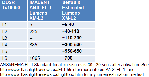

    In terms of relative output spacing, here is a table giving you a general breakdown of what I was able measure for each of the various indicator levels:
    Again, these are VERY approximate - it is difficult to provide reliable estimates for the output range of each "bar" on the display (recall that IMALENT reports 100 discrete levels, but only 6 indicator bars). Take my numbers above as a general indication of what to expect only. I was able to provide a better estimate on my EMT-16, thanks to the defined steps on the remote control. See my EMT16 review for details.
    As you can see, there is not a great deal of difference between max (bar level 6), near-max (bar level 5), and the upper part of bar level 4.

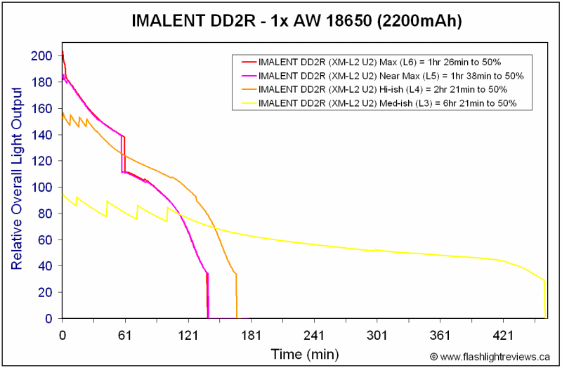

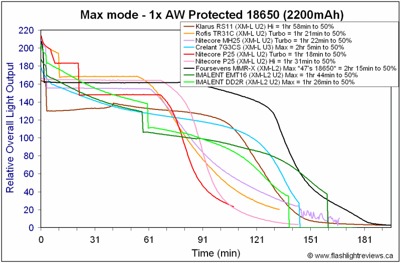

    Let's start with a comparison of sample outputs on one of my standard 2200mAh AW Protected 18650 batteries. Again, there are actually many possible output levels for each individual bar - so I would take the exact output levels shown below as being approximate examples.
    The first observation is the DD2R has a largely direct-drive like pattern. There was a defined step-down on each of my bar level 5 and 6 runs. The lower bar level 3 and 4 runtimes show a series jumps in output over a period of time initially. As previously noted in my DD4R review, the regulation pattern on these lights is a little unusual.
    As you can see, there does not appear to be a great difference in output or runtime between the various 5 and 6 bar levels – or with the upper part of the 4 bar range either.

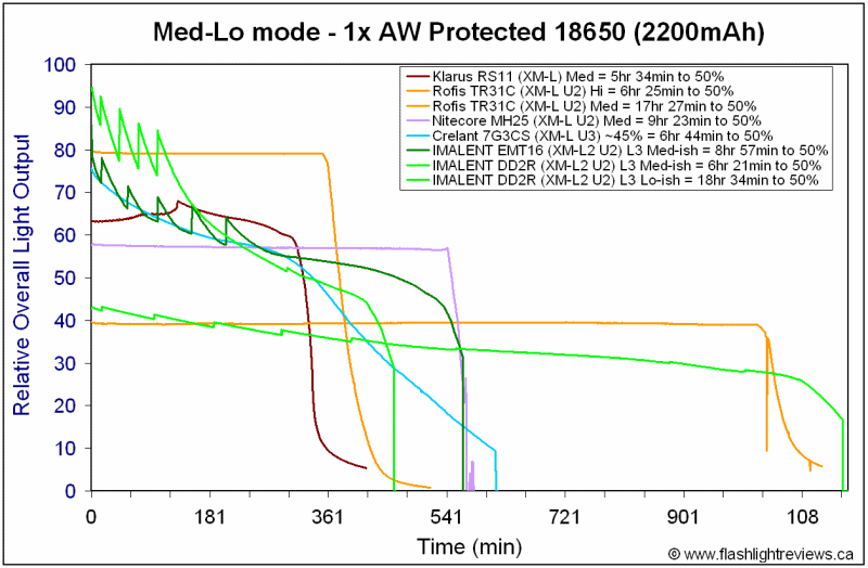

    Let's see how the DD2R and EMT16 perform relative to each other, and the competition, starting with 1x18650.
    The EMT16 and DD2R appear to have equivalent circuits, with equivalent runtime patterns on 18650.
    The overall performance of these lights seems reasonably good, certainly on par with the continuously-variable Crelant 7G3CS/7G6CS. However, the IMALENT lights are not as flatly-regulated as other lights in this comparison.
    Max output is lower on 2xCR123A than the other battery sources. This is due to an immediate step down that occurs, within 30 secs of activation. Overall output/runtime efficiency seems fine.
    The DD2R and EMT16 show a largely direct-drive-like pattern on all levels (with some early variation in output). IMALENT tells me they are working on improving this.

    Quote Originally Posted by gkbain View Post
    Thanks for the review, very interesting. As mentioned, that is some serious current dra
    On that note, IMALENT has just informed me that as per my suggestion here, they will remove the additional touch screen standby mode on the DD2R and DD4R, and further shorten the time required to turn the light off by the electronic switch.
    I've also suggested they add anodized threads, as it would be good to be able to fully lock out the light.
