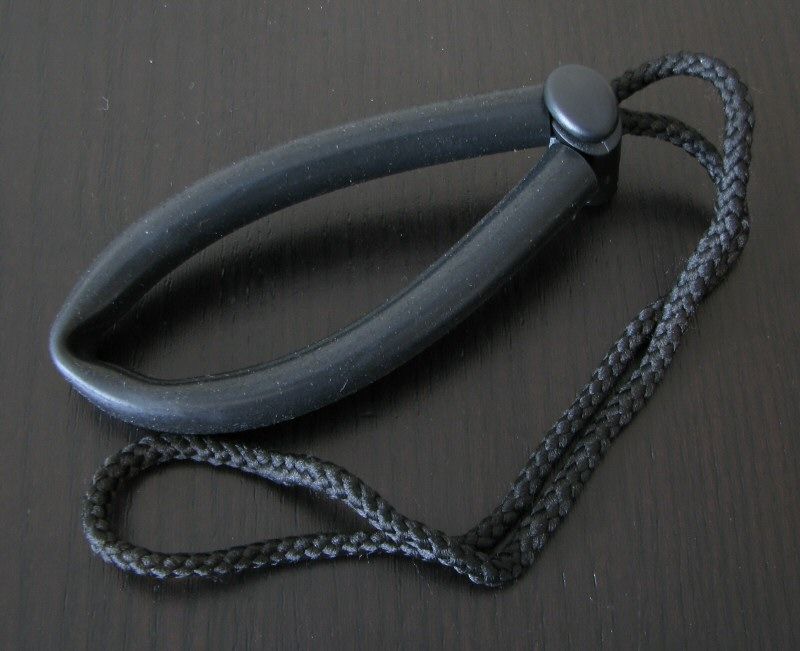

    • Accessories: O-ring, wrist strap, lanyard (standard wrist strap fastens flashlight to the back of your hand, portable underwater).

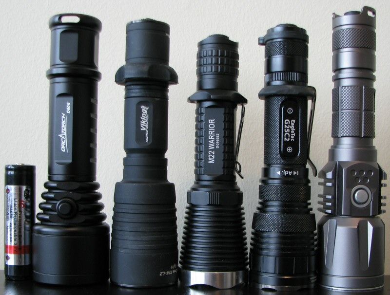

    From left to right: AW Protected 18650 2200mAh; Orcatorch D500; Armytek Viking Pro; Olight M22; Eagletac G25C2 Mark II; Nitecore P25.
    Orcatorch D500: Weight: 217.8g, Length: 152.7mm, Width (bezel): 44.9mm
    Fenix PD35: Weight: 82.7g, Length: 138.1mm, Width (bezel): 25.4mm
    Foursevens MMX Burst: Weight 145.8g, Length: 153.3mm, Width (bezel): 38.7mm
    Light & Motion GoBe+ 500 Search: Weight (with built-in battery): 189.2g, Length: 132.4mm, Width (bezel screw threads): 47.7mm
    Nitecore P12: Weight: 89.7g, Length: 139.4mm, Width (bezel): 25.4mm
    Nitecore P25: Weight: 171.3g, Length: 160mm, Width (bezel): 40.0m
    Olight M22: Weight: 148.4g, Length: 144.8mm, Width: 41.2mm (bezel)
    Zebralight SC600 II: Weight 79.3g, Length: 101.8mm, Width (bezel) 29.7mm

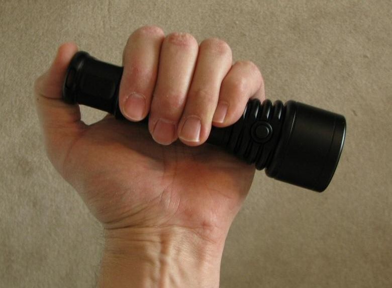

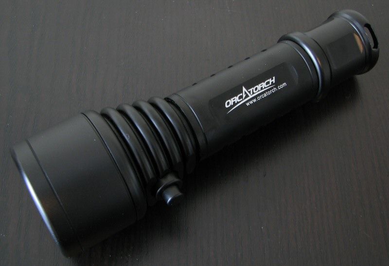

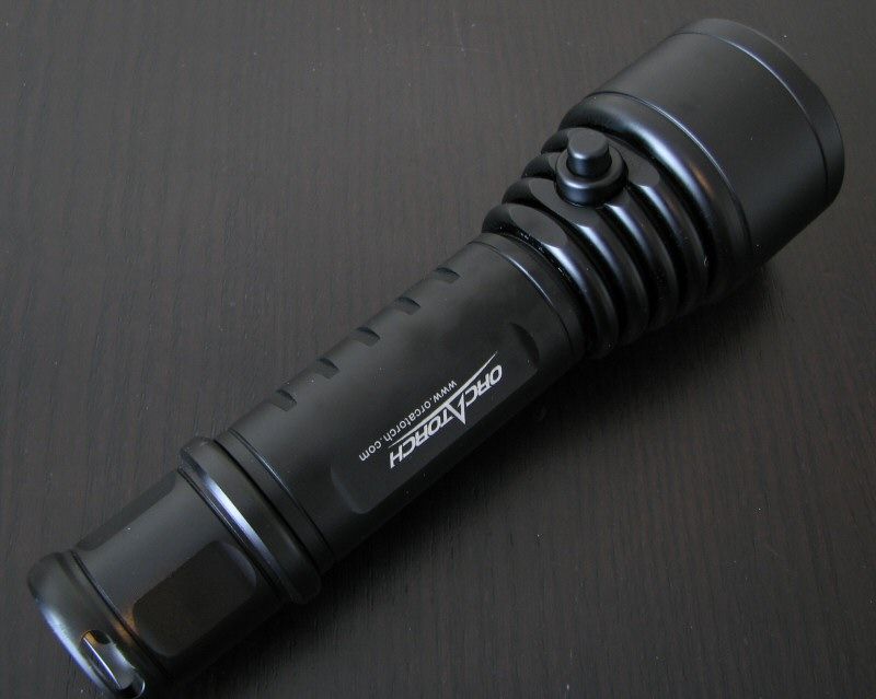

    The D500 is a stocky light, as is common on diving lights (i.e., thick-walled to withstand higher pressures). Anodizing is a matte black finish, hard anodized, with no chips or damage on my sample. Body labels are bright white against the black background. There is no knurling to speak of on the body, but there are a number of ridges and concentric rings (although these are quite smooth). I would consider the light to be relative smooth overall – which is part of the reason why it comes with the lanyard and wrist holster.

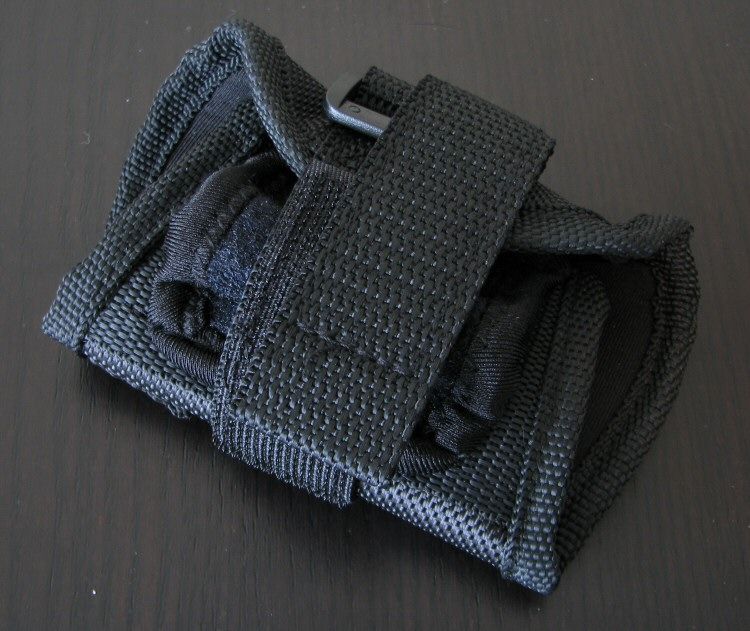

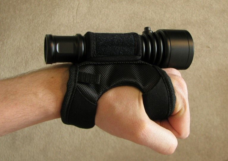

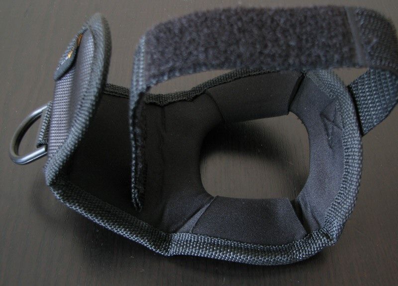

    I am not a scuba diver, but it seems to me that this holster would work quite well for that purpose. The elastic material holds the light quite securely.

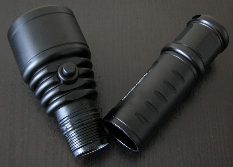

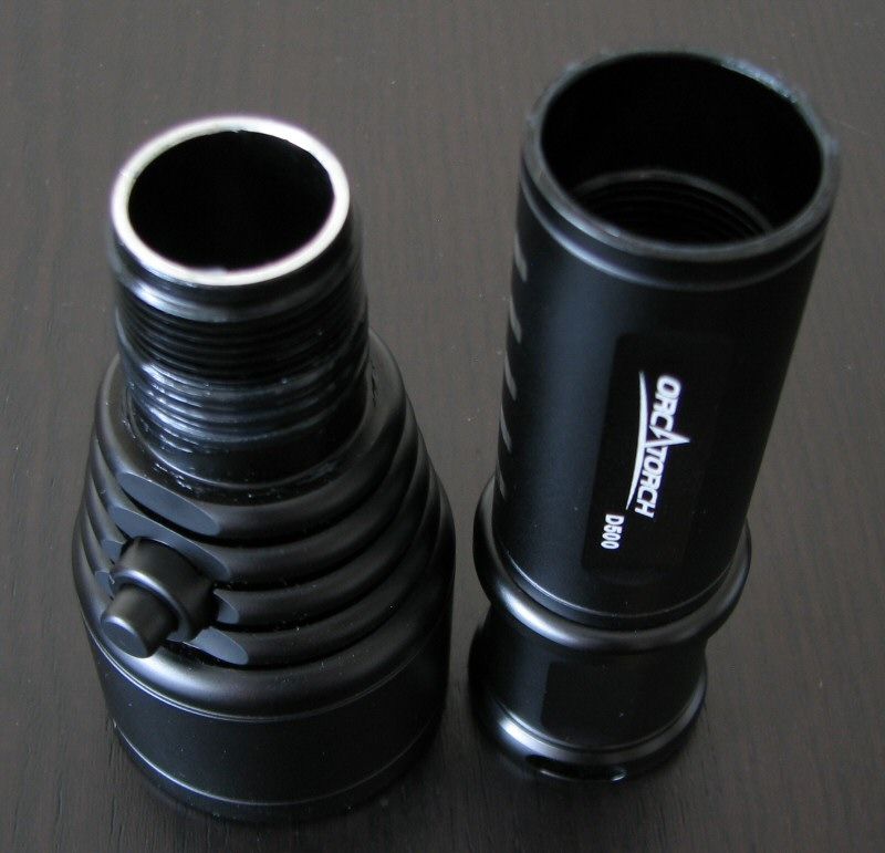

    A unique feature to the D500 is the magnetically-isolated switch. Normally, the switch housing is loctited on shipping samples, but Orcatorch sent me one that wasn't so that I could show you what it looks like.
    As you can probably tell from the above, the circuit internals are fully isolated and protected – the light is waterproof even without the switch in place. The switch cover itself is basically just a piece a plastic with a small rare earth magnet at the inside end. When you press the switch down all the way, the magnet activates the internal switching mechanism. The gold-plated spring simply provides resistance, and pushes the switch cover back out. The whole assembly screws into the light (and would normally be sealed with Loctite).
    This is a clever design for a diving light. Note that it makes for an unusual switch feel – it's basically like a little plunger, with no click or other evidence of physical contact. All you are doing is getting the magnet close enough to register with the internal control mechanism. See my User Interface section for more info.

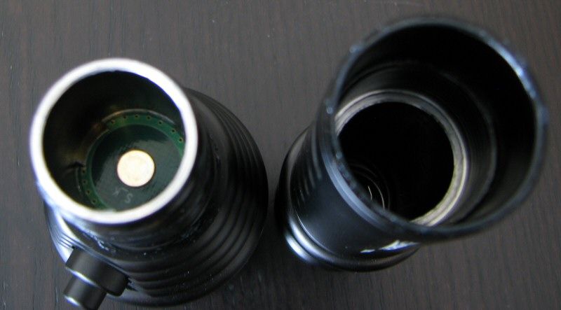

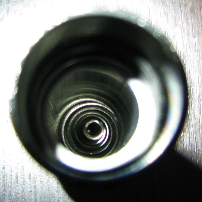

    Screw threads are square cut, and there are a greater number than usual. Threads are anodized, allowing for a physical lock out. The head seats quite deeply on the light, and has two o-rings for waterproofness. There was a generous amount of lube on the threads and o-rings on my sample.
    There is a small (slightly raised) contact on the board in the head, so some flat-top cells can be used. All of my cells worked, except the recessed flat-top AW cells. All button top cells work fine, of course. The body tube is wide enough to accommodate all size 18650 cells. There is a spring at the base of the body tube.

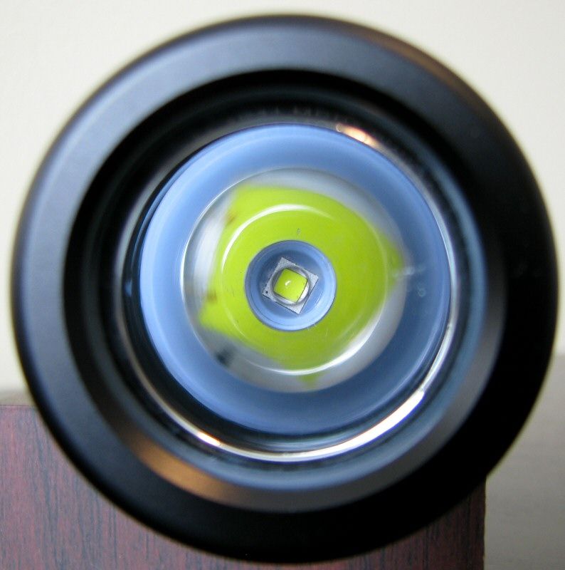

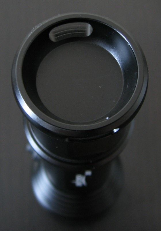

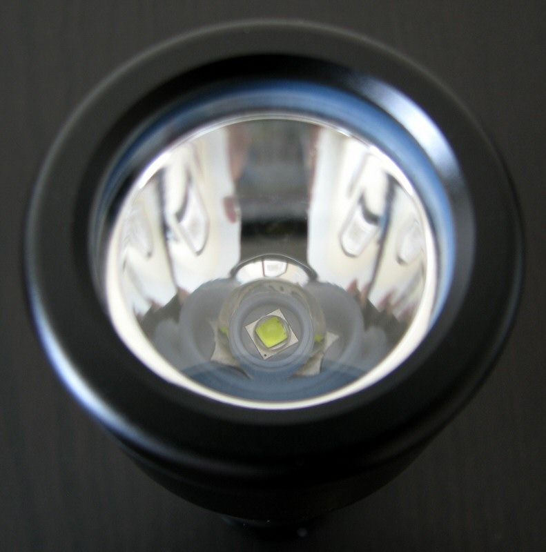

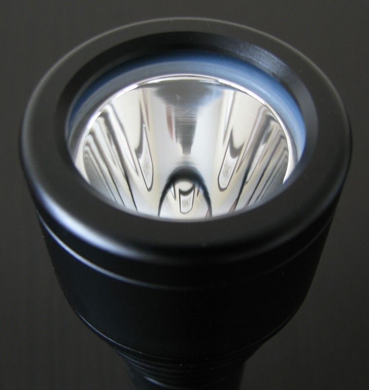

    The head is substantial on D500, with a remarkably thick lens (4mm). This is again to provide depth resistance. Note that due to its thickness, I find it slightly opaque compared to most lights (i.e., slightly less transmittance than typical). Given the reflector size, I would expect the light to be relatively more focused for center-beam throw. Scroll down for beamshots.

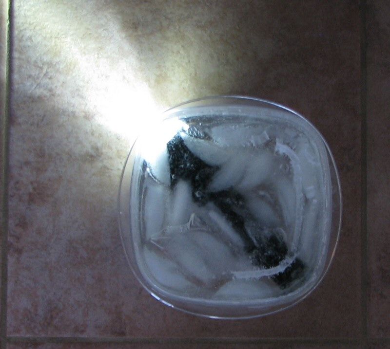

    So how best to simulate the increased pressure of water depth? Well, the best I could think of was to try freezing the light in water. I don't imagine this hugely increases the pressure on the light (since all my containers allow room for the ice to expand) – but it certainly is another level of stringency.

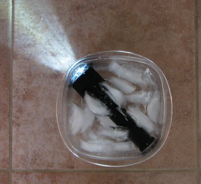

    Freeze test #1:
    I started by placing the light (on Lo) in a bucket on top of ice:
    I then half-filled the bucket with water and left outside one night at around -10 C for 6 hours:
    Unfortunately, the ice wasn't fully formed around the light, so I figured I need to change things around a bit. Note that the light survived this rather mild test just fine, with no signs of any water entry.

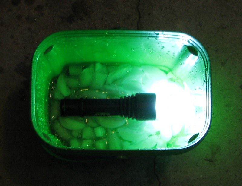

    Freeze test #2:

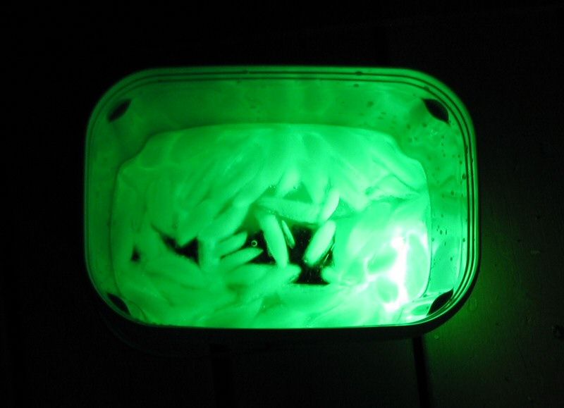

    For this test, I put the light in a smaller container of ice water:
    And stuck in my freezer for 12 hours:

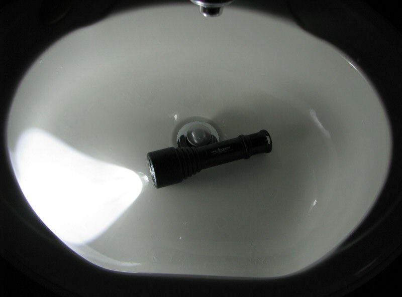

    Now the light came out pretty well frozen in a block. I then placed everything in a sink and started melting away at the ice with lukewarm water:
    I then drained the sink:
    And examined the light closely. There were absolutely no signs of water entry at any surface. I opened the light, and saw all water was stopped by the first o-ring – the inside was completely dry.
    Based on these rather simple tests, I suspect the light will function fine for typical diving purposes.

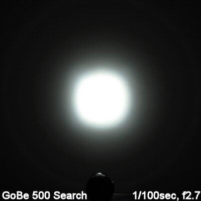

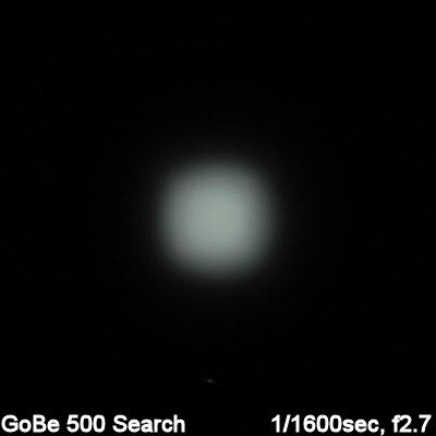

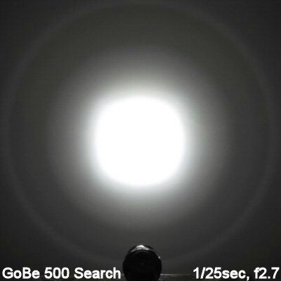

    Beam pattern is what you would expect for a light this size – a fairly throwy hotspot, proportionately-speaking. Scroll down for detailed output and throw measures.
    For its size, the D500 is about typical – it has a reasonable amount of overall output and goof throw. In fact, peak intensity was slightly higher in my testing than the published specs. The beamshots earlier in this review will give you a better idea of how it compares in practice,

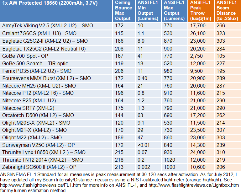

    Let's see how all the levels compare to the official specs in my lightbox:
    There is excellence concordance between my estimated lumens and Orcatorch's published specs. I expect Orcatorch is using an actual integrating sphere for their measures.

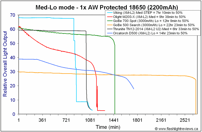

    Output/Runtime Graphs:

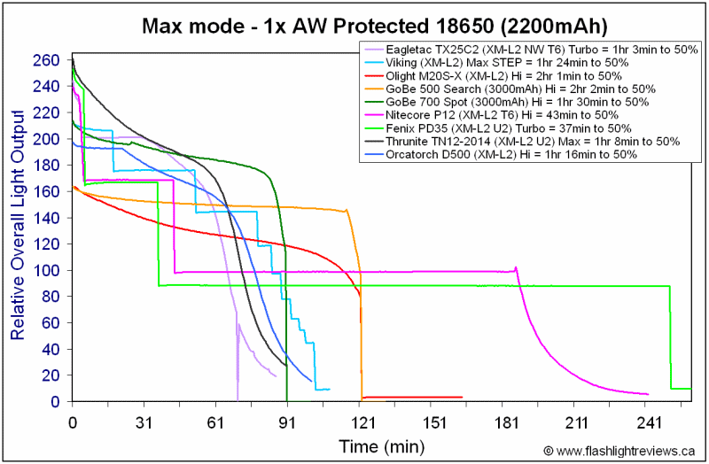

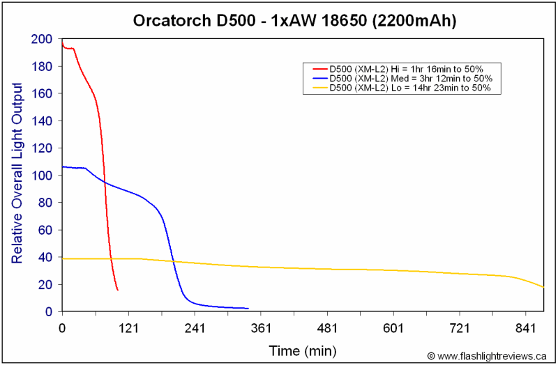

    To start, here is a comparison of three levels on the same scale:
    On all modes, the light maintains reasonably flat regulation for a period of time, and drops into a direct-drive-like pattern.
    As with the other Orcatorch specs, runtime performance is bang on. Keep in mind that I am using lower capacity 2200mAh cells here, and the ANSI FL-1 standard is time to 10% output).
    Let's see how it does against a wider range of lights:
    Output/runtime performance on Hi is about typical for the class. The high-frequency PWM on Lo/Med means that the D500 takes a bit of hit compared to the current-controlled competition. But in absolute terms, runtimes are still perfectly acceptable.

    I particularly like the wrist holster – makes a lot of sense for underwater activities. It could even be useful as a headlight replacement on land, as it still leaves your hands relatively free,

    I love diving and I love flashlights... And I used to love diving flashlights. In the pre-LED era, halogen dive lights were the best and brightest EDC's (or so I remember, showing them off in the nineties to all my mag-lite wielding prepubescent peers.) Somewhere during the last decade, the EDC style of small-medium lights used for diving have failed to evolve (for the most part). Many of the popular (and expensive) brands are still using the same plastic flashlight bodies from 20 years ago (time to update the insides). And, by the way, the magnetic switch has been pretty popular in my history of dive lights.
    So I have a dive trip in a couple weeks. You know what I'm looking for? A good light just like any other light in any of your reviews, but waterproof to a little deeper. That's the only requirement, really. I think that's what most divers are thinking when looking for LED primary dive lights. So either dive light companies need to update the guts of their lights, or more manufacturers need to explore entering this niche' market. Or maybe I need to keep researching...
    Again, I love the reviews and your efforts are very appreciated.
    Thanks, that makes sense - and good to know!
    Yes, that is an interesting question. It's hard to know which lights would handled a bit more immersion (the IPX standards aren't that rigorous really - and it's hard to know who actually follows the proper testing anyway). I would recommend you start a thread about this (maybe in the recommendations forum?), to see if others have experience with specific models. It would be interesting to know if some models handle this better than others.
