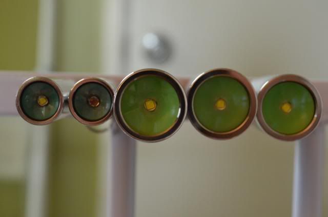

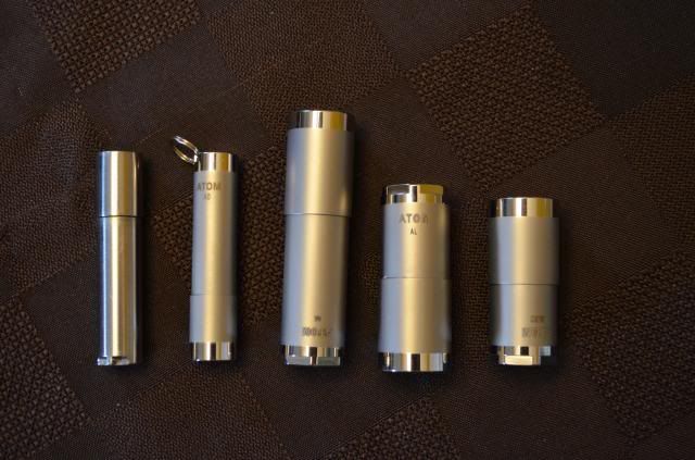

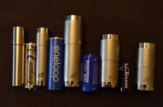

    Family Shot!
    Shown below (from L-R) is the Atom A0/Preon P0 (with hand brushed finish), Atom A0 red, Atom AA, Atom AL, Atom ALR2
    This review will encompass the following models as shown in the chart below, please note, the Atom A0 is simply the Preon P0 with a new name. My sample is older and was originally called the Preon P0.

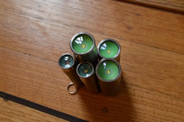

    As you can see, these lights are tiny, being barely larger than the batteries they house. The following picture shows the lights next to their respective cells.
    The lights are all reflector-less pure flood (or "mule") configurations, so they are best used for close range tasks where a wide, even, flood beam is desired. Any notion of throw should be discarded, these are task lights, not a spotting or tactical lights. That said, I found the beams to be very useful for the intended purposes: close range tasks, reading, working in tight spaces etc.

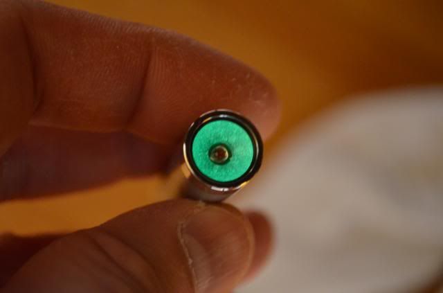

    Instead of a reflector, there is a disk of glow material that provides a nice after-glow when the light has just been used. This may add some green tint to the edge of the beam, but it was not an issue in use. Note that while the Atom A0 red also has glow material around the LED (see picture below), the red LED does not charge the material, hence it will not glow normally.
    The A0 red shown below has had the glow material charged by another light.

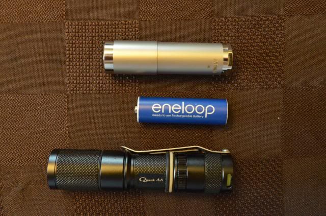

    Here is the Atom AA (longest) vs the Atom ALR2 (shortest). While not too unweildy, the AA is the oddest looking and feeling of the family when used as a headlamp.
    And another profile shot
    I did notice hit or miss results when trying to use 14500 cells. The output is increased to about 6/110 lumens as per the Atom AL/ALR2 models, so this is a nice option to get those levels. The issue is the cell fit. I found my AW 14500 (black) cells did not function because the button top was too low. My AW IMR14500 (red) cells also had the problem of being too short to activate the light while also having a too-short button top. A small magnet in the head provides some functionality but it tends to cause issues and is not recommended. I did get good results using an Ultrafire 14500 cells (with tall button tops) but those are low quality cells and are not recommended. So, one can achieve favourable results using 14500 cells but the cells must be long enough and have tall/small button tops.
    The Atom AA is the longest Atom, but is still dwarfed by the Quark AA.

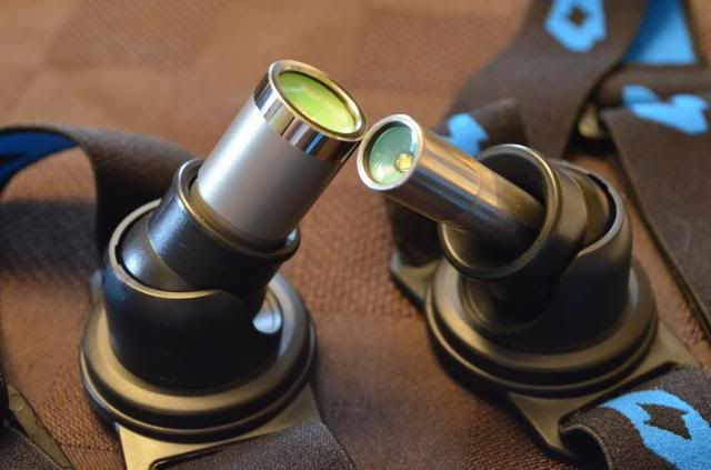

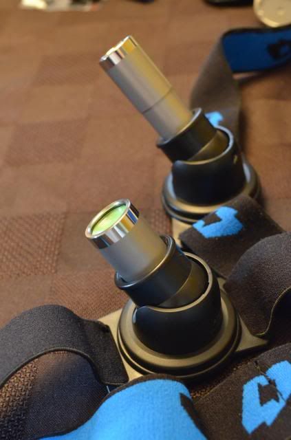

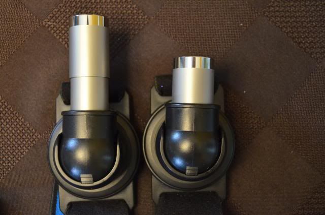

    Here is the Atom AL vs the Atom A0 in headlamp configuration
    The A0 red is useful in that it helps preserve night vision. Overall it’s even more of a niche product, but those who favour red lights will like this one (e.g. Astronomy uses)
    It’s a shame that these lights don’t share the progressive twisty UI of the Atom AA/AL/ALR2, but they are based on the older Preon design. Perhaps future designs could change the switching configuration, but it would likely increase the cost ($25 retail). In any case, the design works well enough and functions well in headlamp configuration.

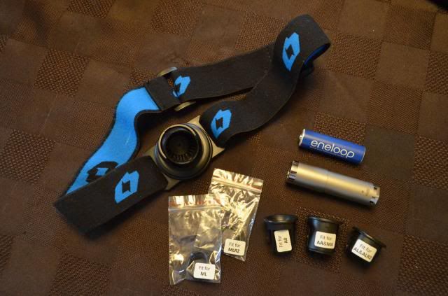

    I won’t go into the 360° headlamp kit as I feel that my previous review covers the details quite well. That said, longer term testing has shown no issues with the headlamp kit. This kit is now my go-to headlamp combination. The kit comes with a variety of adapters to fit every Atom and Mini model (well, not the 2AAA model!).

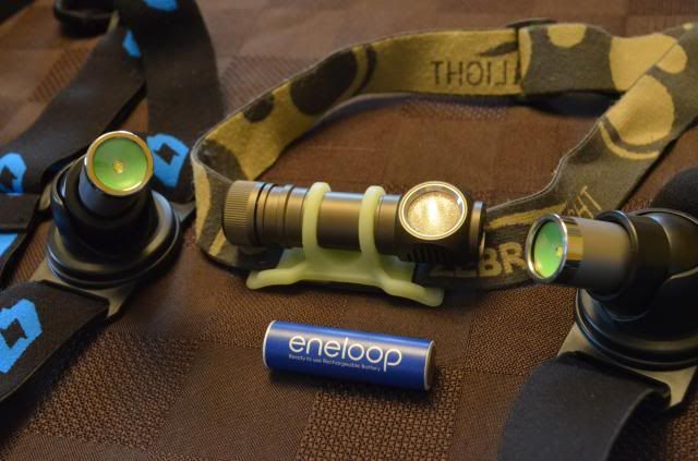

    Here is the Atom AA (left) and Atom ALR2 (right) vs the very common Zebralight H51
    Overall, the Atom Family provides great versatility and functionality. You can just pick based on your preferred battery type and get a very useful little task light.

    I followed the demagnetization procedure mentioned in the linked thread above, with the following results.
    I started by removing the head and battery from the light. The O-rings were all broken, so there was none to remove, but an O-ring certainly would not benefit from being left in place. I then held the magnet within the flame of a lighter for about 20 seconds. A black residue appeared on the portions of the light that contacted the flame. After waiting a few minutes for the light to cool, the residue wiped right off with a paper towel. The magnet was significantly weakened, but not totally demagnetized.
    A second, 30 second heating resulted in the same black residue and no further change in the magnet's strength.
    The split ring had been left in place for the prior 2 heatings, but i removed it for the third heating to make cleaning the residue off the light easier.
    A third, longer heating was stopped after 50 seconds when I noticed smoke coming from the interior of the tube. When I examined the tail of the light, I found that the magnet had fallen from its recess. Once everything cooled down and everything was wiped clean of the black residue, I found that the magnet was completely demagnetized. I tossed it in the trash. I never identified the source of smoke from inside the light, but at this point there is no danger of the magnet damaging any cards. When everything was re-assembled, the light worked normally.
    So, one of my two objections to the design of this light has been addressed. Once my O-rings arrive, I'll apply the lubricant and see about the other one.
