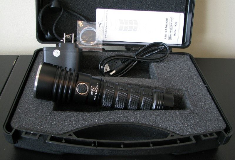

    The K26 comes in a presentation-style plastic carrying case, similar to the ones from other makers. Included with the light (and custom 26650 cell) are spare O-rings, good quality wrist lanyard, USB charging cable, USB-AC adapter, and manual.

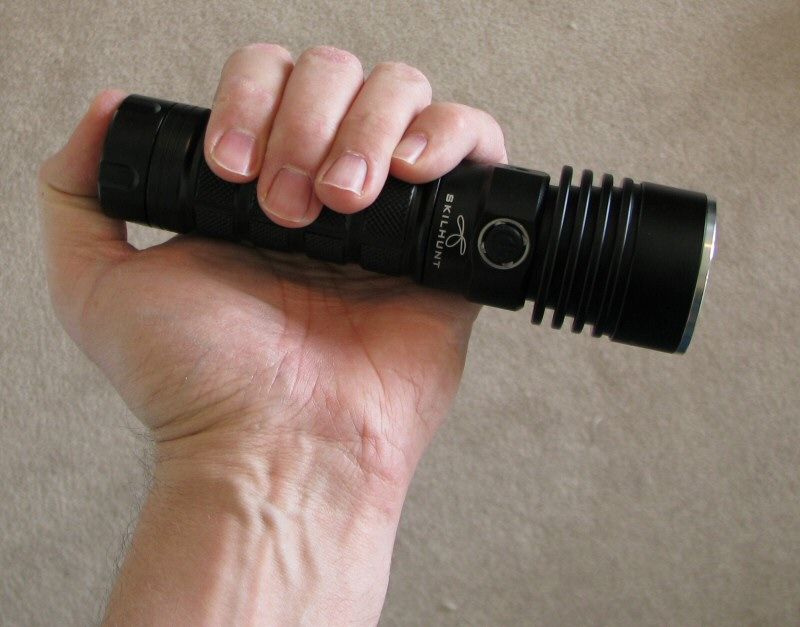

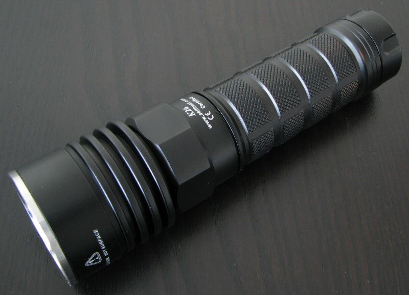

    As with other Skilhunt lights, the K26 has a well-crafted build and appearance - it looks and feels like a quality light. Anodizing is a glossy black finish, hard anodized (i.e., type III). Body labels are bright white and sharp against the black background. The K26 has knurling on the body, but it is not very aggressive. However, thanks to the cut-out large checkered pattern with ridges, overall grip is actually pretty good. The head has a few concentric ring fins - likely to help with heat dissipation, but also serve to enhance grip.
    Screw threading is standard triangular cut, but of good quality. Threads are anodized to allow for lock-out.
    The control switch is an electronic side switch in the head, with typical feel for this class. The black boot cover projects a bit, making it relatively easy to find by touch.
    There is an LED indicator near the switch. This presumably serves as a low voltage warning indicator during use. It does not indicate charging status during a charge cycle.

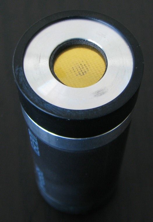

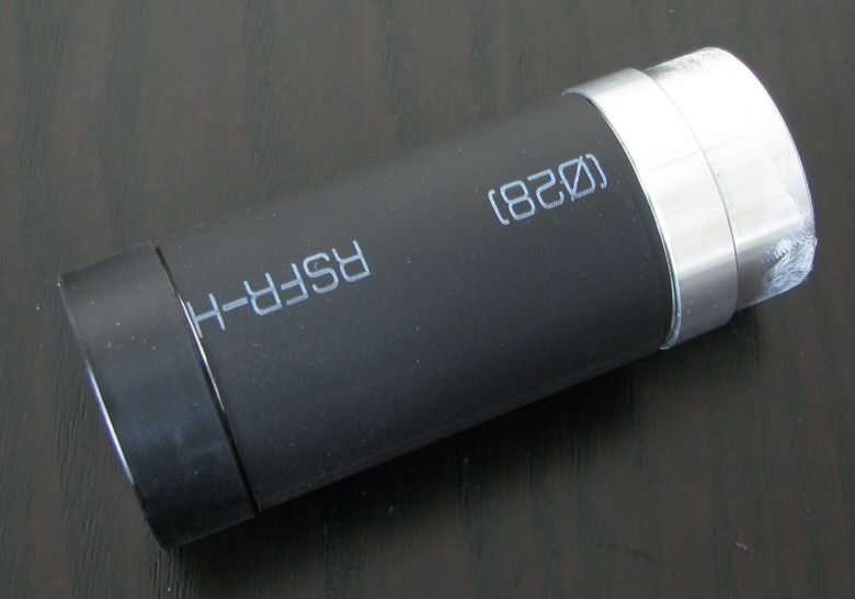

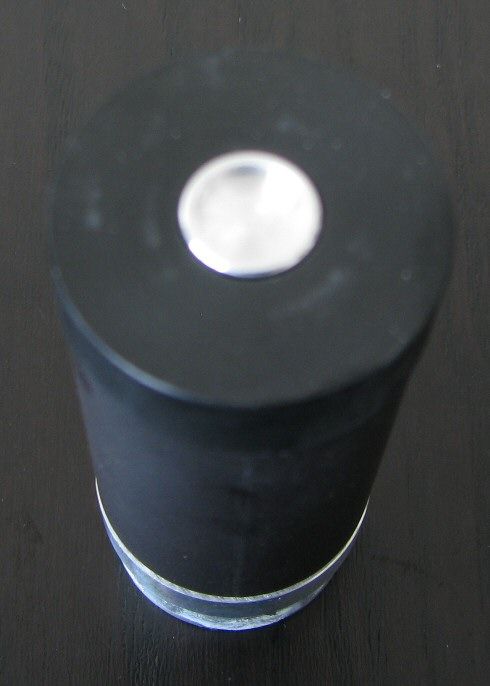

    Let's take a look at the battery:

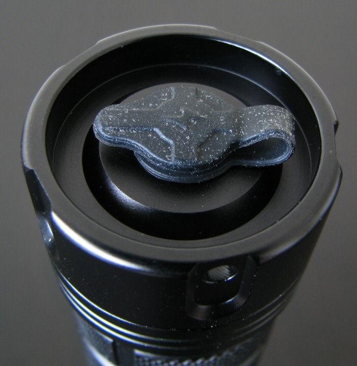

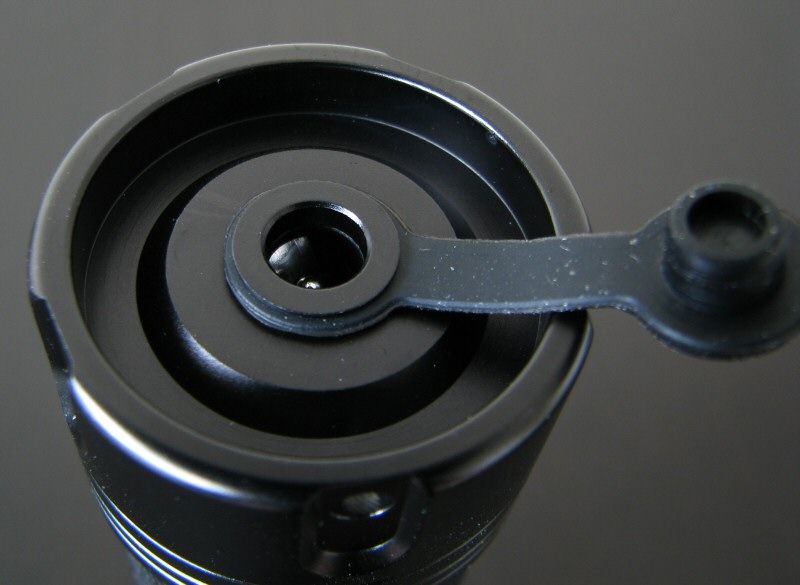

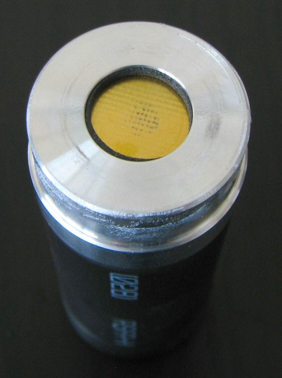

    The custom 26650 used here is distinctive, with a recessed negative contact point in the tail (surround by a positive contact disk). This is what allows charging of the battery inside the light. Thoughtfully, Skilhunt has designed the tail assembly so that regular 26650 cells can be used inside the light – you just need the bundled cell if you want to take advantage of the charging feature.
    You charge the light through a barrel plug connector in the tailcap. Note that the rubber cover is a tight fit in the plug hole, and the connecting piece that surrounds the hole (and holds in in place when the plug is not inserted) can fall off fairly easily on my sample.

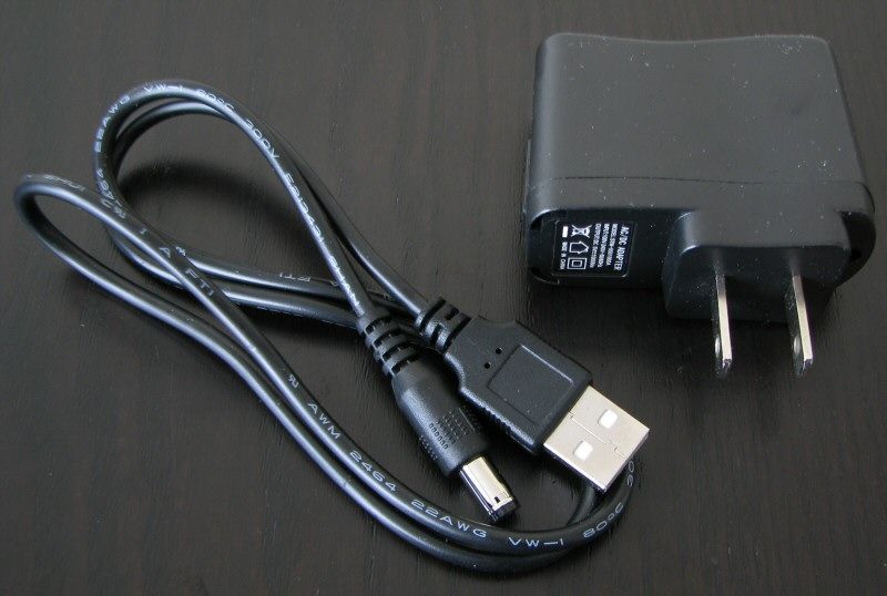

    The bundled USB-AC adapter reports a max 1A charge rate, should do a pretty good job of charging the 26650 is a reasonable amount of time. When charging using the AC adapter, it took about 5 hours for the charger to terminate (and the charging light on the adapter to turn green from red). The bundled 26650 cell read as ~4.19V resting voltage at termination, which is a good level in my view.
    Given the USB-AC adapter design, you have the option to charge the light by a USB port instead. There are two issues with charging the light this way. First, there is no indication of charging status, or when the charge is completed (i.e., there is no indicator LED signal, as this was present only on the AC adapter unit). Secondly - and more importantly - the integrated charger continues to pull the same high current from the USB port.
    I was surprised to discover this - when I pulled the light off my USB port after 5 hours charging, the previously depleted cell was again reading ~4.19V. Note that the maximum charge rate for USB 2.0 is 500mA, so this drastically exceeds charging spec. I have checked with Skilhunt, and they confirm the K26 draws the same >800mA max current from both the USB cable and the USB-AC adapter.
    They report that they have not experienced any issues with this charging current. Depending on your motherboard and USB ports, I suppose this higher current level may be possible - but you are risking damage to your USB ports if you try it. Based on my recommendation, Skilhunt is considering reducing the charging current on the USB-only method. In the interim, I recommend you stick with using the AC charger exclusively.

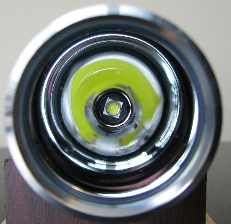

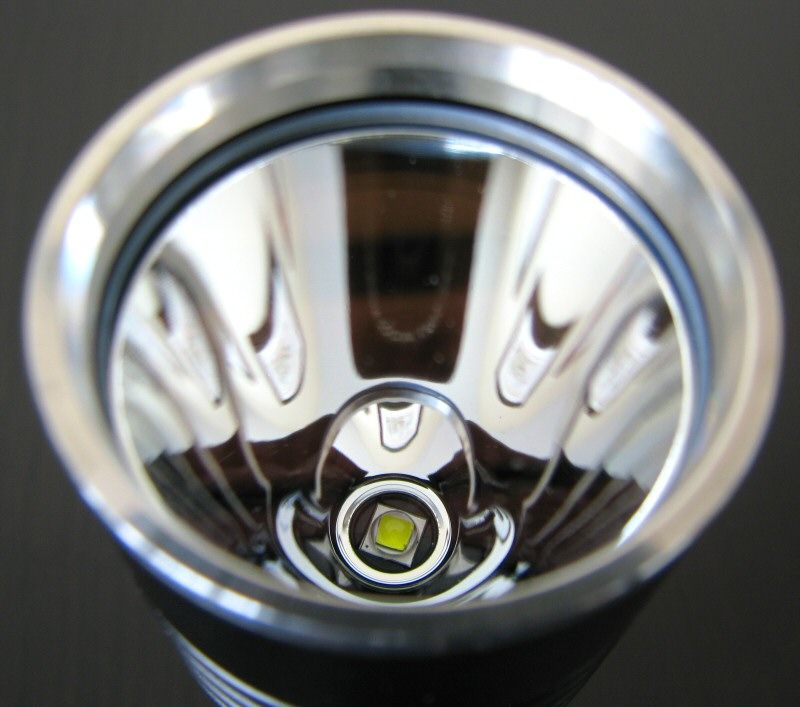

    Reflector is smooth, and fairly deep. Coupled with the XM-L2 cool white emitter (which was well centered), I would expect reasonably strong throw. Scroll down for beamshots.

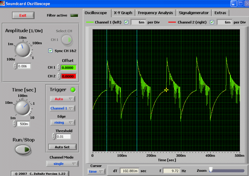

    PWM/Strobe

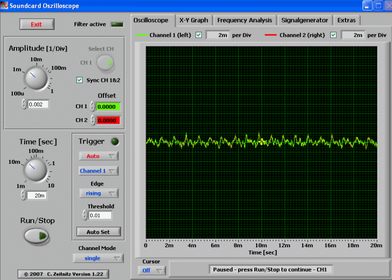

    As with other recent Skilhunt lights, the K26 is current-controlled on all levels. I can detect no sign of PWM – neither by eye, nor on my sound card oscilloscope.
    There is some circuit noise present on some levels, but this was not visible in the beam:
    Note that circuit noise is common on many current-controlled lights. It does not affect performance, nor is it detectable visually. As per my usual review policy, I simply report on all circuit features that I can detect – it doesn't mean they are significant in use. Rest assured, the K26 is flicker-free in use, at all levels.
    The strobe is a fairly typical fast "tactical" strobe, of 9.7Hz frequency.

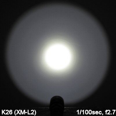

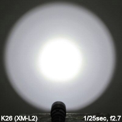

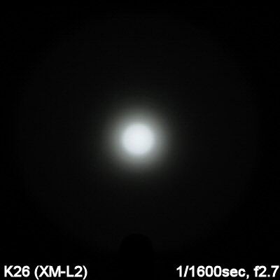

    The K26 has a slightly narrow spillbeam than most lights, due to the relative deep reflector. As expected, it is well focused for throw, with a small hotspot. Note that there are some faint concentric rings in the beam on my sample. This can occur with very "throwy" lights with smooth reflectors.
    Scroll down to my testing results for more information.

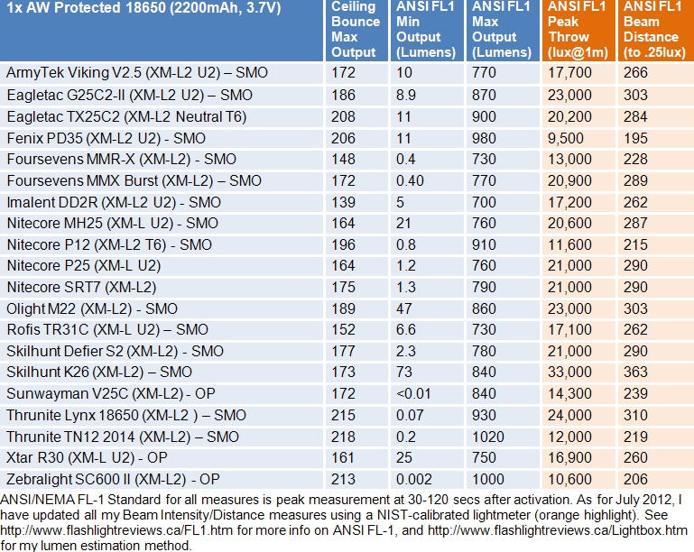

    Since I haven't tested too many 26650 lights, I will start with a comparison of the K26 to the 1x18650 class, followed by the 1x26650 class.

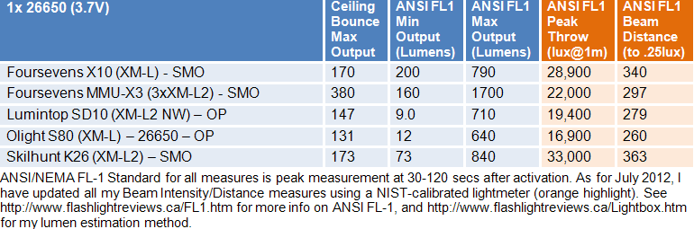

    Peak intensity throw is very much in keeping with the Skilhunt specs – and are what I would have expected, given the size of the reflector.

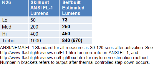

    Max overall output is in keeping with single Li-ion source. Let's see how all the output levels do:
    Overall, my lumen estimates are reasonably close to Skilhunt's specs. Note that the product page for this light mentions that it will automatically step down to 700 lumens after 3 minutes of Turbo mode, to prevent overheating.
    Personally, I would have preferred a lower lo mode.

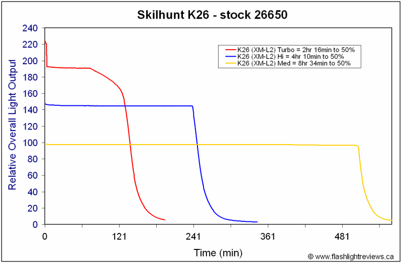

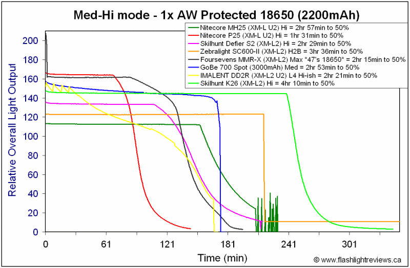

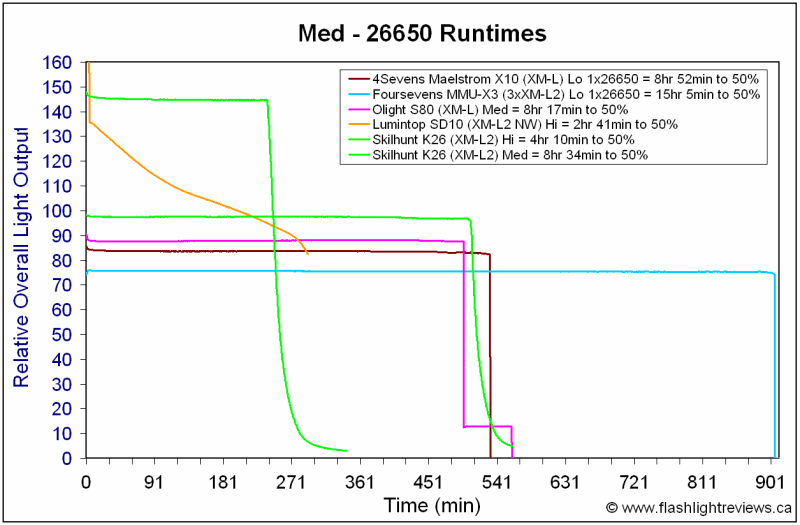

    Output/Runtime Graphs:
    As you can see, there is indeed a step-down on Turbo after about 3 mins runtime. The reduced output level is still higher than the defined Hi mode (as also shown in my Summary table above).
    The light maintains flat regulation for as long as it can at all levels, until the battery is nearly exhausted.

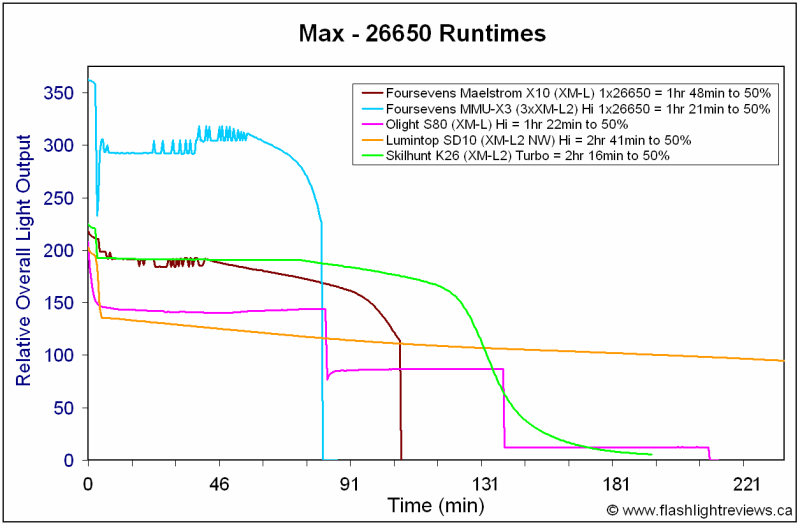

    Let's see how it compares to other 1x26650 lights that I have tested. Note that for the analysis below, I am typically using the stock 26650 cell provided by the manufacturer. For the SD10 run, I am using the Foursevens 26550 from the X10.
    Max output is consistent a heavily-driven single XM-L/XM-L2 emitter. Overall output runtime efficiency is also consistent with other good current-controlled lights in this class.

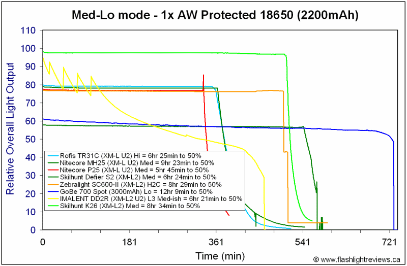

    Let's see how it looks relative to the 1x18650 class:
    Again, good max output and runtime in comparison to this class.

    Consistent with its throw-focused smooth reflector, there were some beam ring artifacts on my sample.

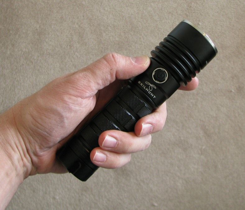

    Although substantial, the light has good balance and hand feel. It is straightforward to use, once you get used to a press-hold for on/off and a click to change modes (i.e., this is the opposite of most makers). It is little quirks like that, and lack of a true Lo mode, that give me some pause before recommending the light more generally. Personally, I like a light that you can hand to anyone and they can figure out how to use it immediately.

    Beam pattern is definitely on the throwy side, thanks to the large and deep reflector.
