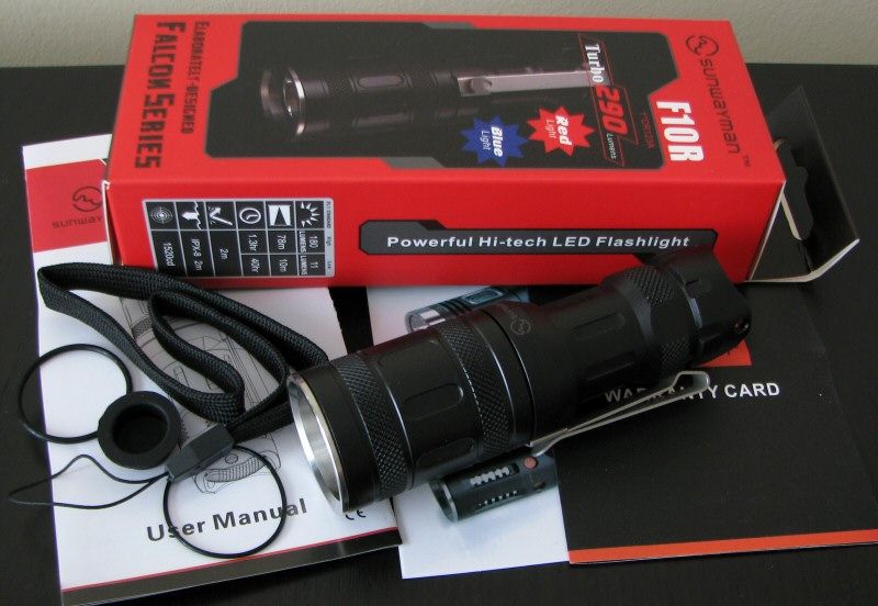

    The F10R and F20C come in standard Sunwayman retail packaging. Inside, you will find the light, very basic wrist strap, extra o-ring, spare switch boot cover, manual, product insert and warranty card. There is no holster.

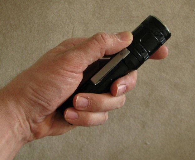

    The F10R and F20C are substantial lights for their classes. They both have a larger than typical head, with higher weight. Overall impression is very good - both seem like very high quality lights. They finish in particular is just superb, with flawless anodizing. Color is hard to describe – it looks black under most lighting, but seems to be a really dark brown/black natural finish. Either way, I quite like it. These two specimens are impressive to handle and behold.
    Overall grip is good, thanks to all the ridge detail, knurling, and built in clip. On that latter point, I like that the clip supports both bezel-up and bezel-down carry.

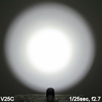

    And now the white-wall beamshots. All lights are on the identified battery. Lights are about ~0.75 meter from a white wall (with the camera ~1.25 meters back from the wall). Automatic white balance on the camera, to minimize tint differences.
    1xCR123A
    1xRCR:
    1x18650:
    Thanks to the relatively deep reflectors, these lights have a reasonably "throwy" beam for their size (i.e., hotspot is tightly focused). The embedded red/blue emitters don't seem cause any significant artifacts for the main white beam. Scroll down for my actual beam measures.

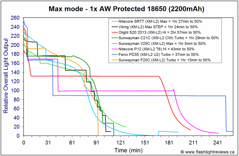

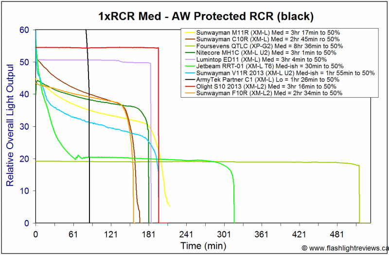

    Output/Runtime Graphs:
    F10R:
    F20C:
    Regulation patterns and output/runtime efficiency are about typical for current-controlled lights in their respective classes.
