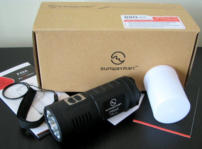

    The F40A comes in the standard Sunwayman hard cardboard box packaging. The light and extras are well secured in hard packing material. Inside you will find the light, good quality lanyard with clip, extra o-ring, holster, manual, product insert and warranty card.
    From left to right: Duracell NiMH; Sunwayman F40A, D40A; Nitecore EA4; Eagletac GX25A3; JetBeam SRA40.

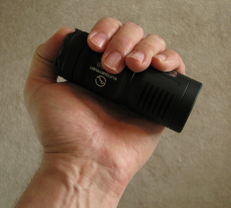

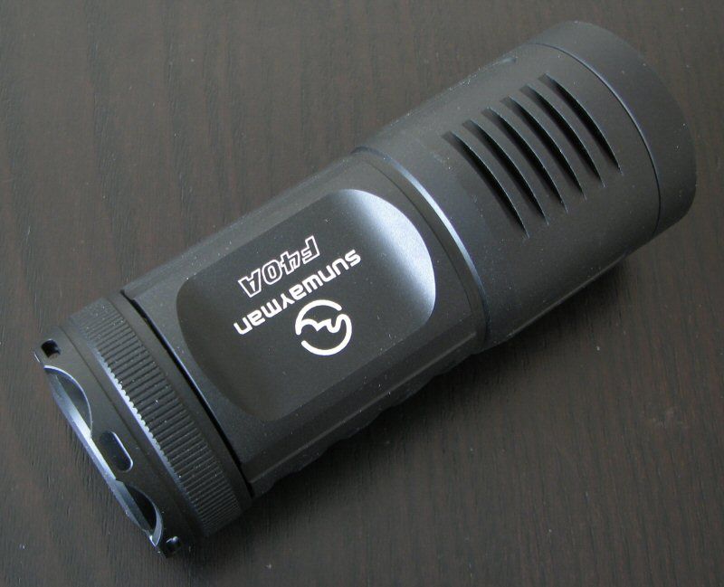

    The overall build is different from the other Falcon-series lights I've reviewed. The F40A has much more matte-finishing, with a slightly "grippier" effect (although not as thick as the Armytek lights). There is no real knurling to speak of, but overall grip is style good thanks to all the ridge detail. Hand feel is very good – the light is very compact, and you find the buttons by touch alone fairly easily. Labels are bright white and very clear.
    If I were to try and summarize the external build differences to the D40A, I would say the F40A feels more "rugged", whereas the D40A feels more "refined".

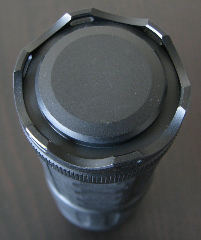

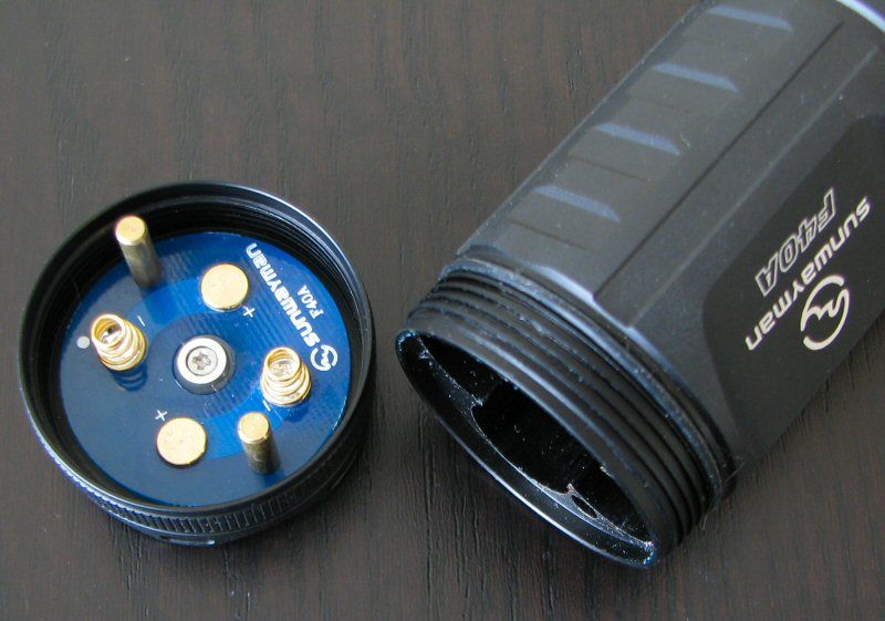

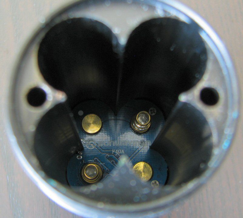

    Batteries are inserted directly into the handle, in series. Like with other lights in this class, there is contact plate in the tail that can spin to allow tailcap tightening. Simply line up the two tailcap posts with the corresponding holes on the body of the light
    Tail screw threading is square cut (i.e., trapezoid) and is anodized – but that doesn't matter for lock-out, since it is the tension on the springs that control contact. Threading felt stiff on my sample on arrival, but extra lube helped – as did loosening the center screw on the contact board in the tail (i.e., too much resistance initially for turning).
    The F40A can tailstand easily, thanks to the flat base. There are lanyard attachment points all along the tail, but these shouldn't interfere with tailstanding.

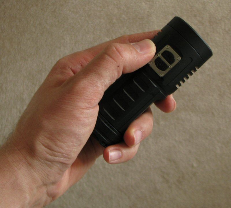

    There is a dual-switch interface in the head to control the light. This has changed from the D40A, as there are now distinct (and rubberized) button covers over each switch. See User Interface below for more information.

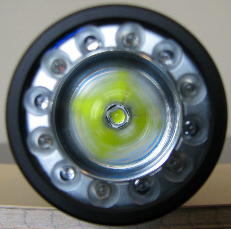

    The head of the light is certainly distinctive – although it does remind me of the original M40C.

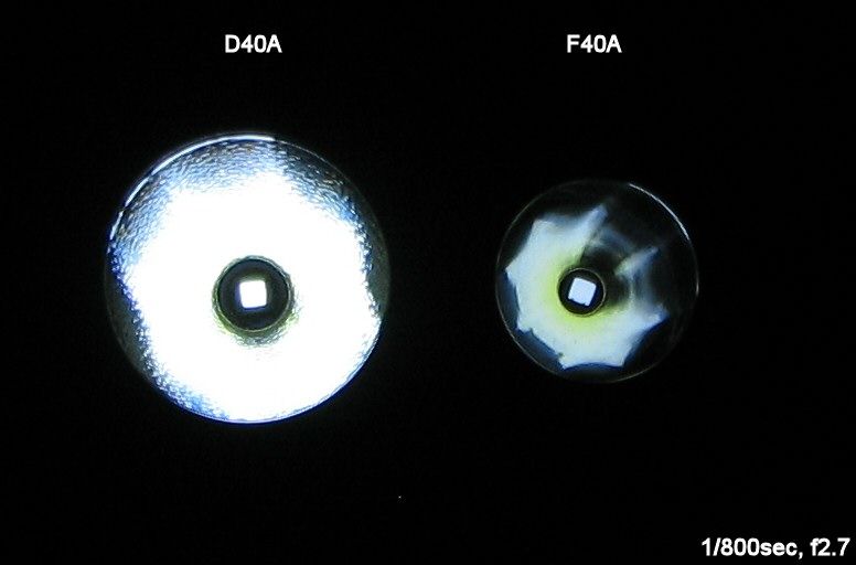

    The main reflector for the XM-L2 emitter on the F40A is smooth finish, and relatively deep - although narrow, due to the ring of 5mm LEDs around the periphery. Red and blue LEDs are interspersed (i.e., red and blue are alternating). I've attempted a couple of different focusings above, to make this clear.

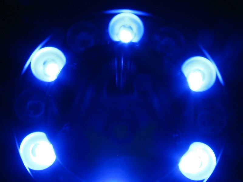

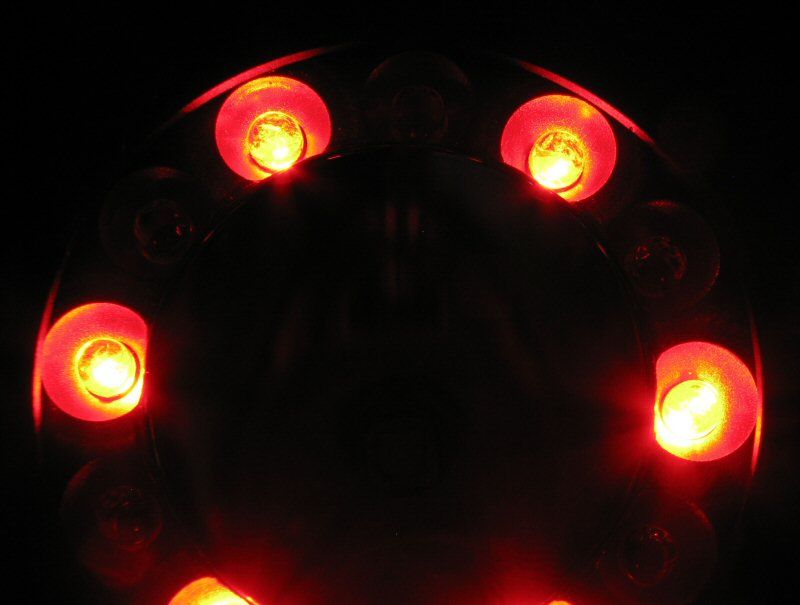

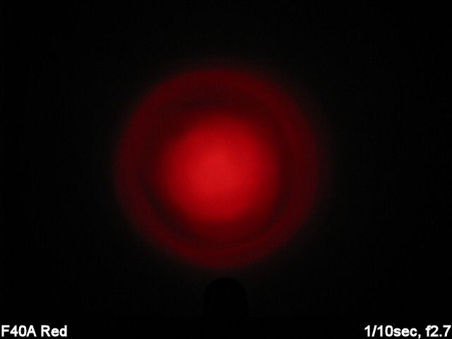

    Here is what the red and blue LEDs look like when activated:

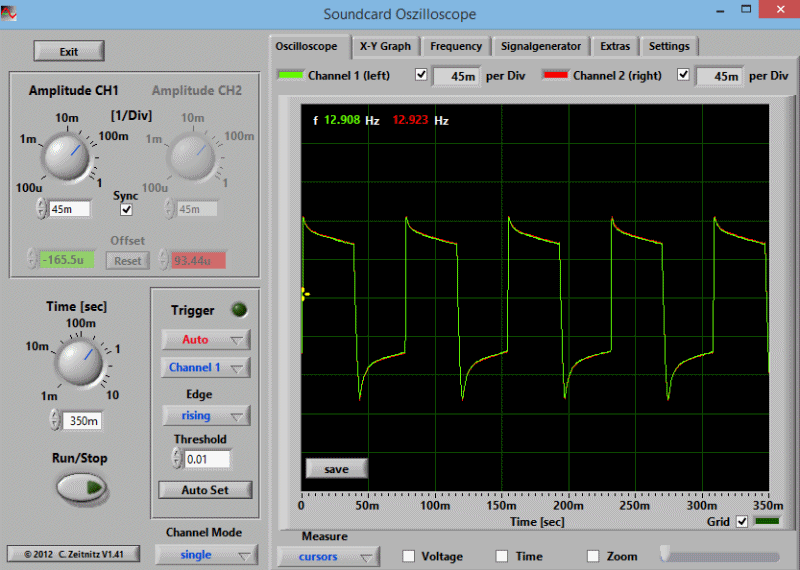

    PWM/Strobe
    Reviewer's note: I have recently updated my oscilloscope software, so the traces below may look a little different from my earlier reviews.
    There is no sign of PWM that I can see, at any output level – I believe the light is current-controlled.
    White Strobe:
    The main strobe is a standard high frequency strobe, measured at 13 Hz (which is similar to my D40A).

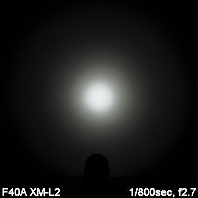

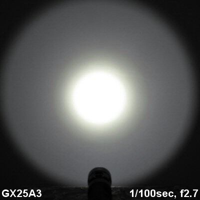

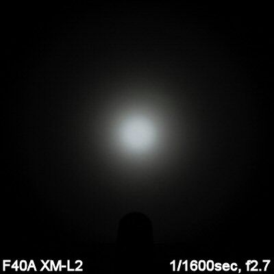

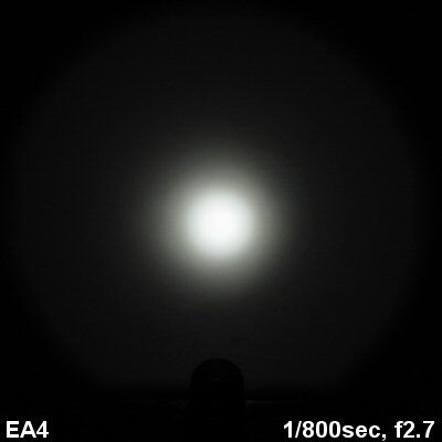

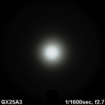

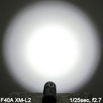

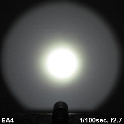

    And now the white-wall beamshots. All lights are on Sanyo Eneloop NiMH (4x). Lights are about ~0.75 meter from a white wall (with the camera ~1.25 meters back from the wall). Automatic white balance on the camera, to minimize tint differences.
    The overall beam pattern is similar to other lights in this class, although with a less intense hotspot on the F40A. Scroll down for my actual beam measures.

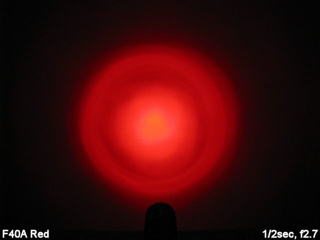

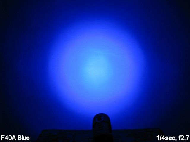

    F40A Color modes:
    The relative intensity of the red and blue emitters seems much better balanced than on my F10R/F20C samples. I would describe the F40A as having a reasonable amount of light on both (although the F10R/F20C were brighter on blue – see that review for details).
    As you can see, despite its small size, the F40A has good max output (and reasonable throw). Of course, throw is lower than the D40A, due to the smaller relative reflector for the white emitter.
    One other difference from the D40A is the common "1 lumen" low mode. Only having one sample of each light, it's hard to draw any conclusions here. But my relative output measure estimates are at least consistent across samples – and the F40A is a true ultra-low moonlight on my sample. Here's a couple of comparative beamshots, to show you the difference visually

    As for the red/blue LEDs, it's hard to provide reliable output estimates given the differing sensitivity of light meters to these wavelengths. 5mm LEDs are also relatively low output, further compounding the difficulty. Probably the best way I can describe it is that the brightness of each 5mm emitter is about "typical" here, so the five emitters put together make this reasonably bright for this class. But it is still nowhere near as bright as a typical single colored XP-E emitter (or, oddly, the blue emitters of the F10R/F20C).

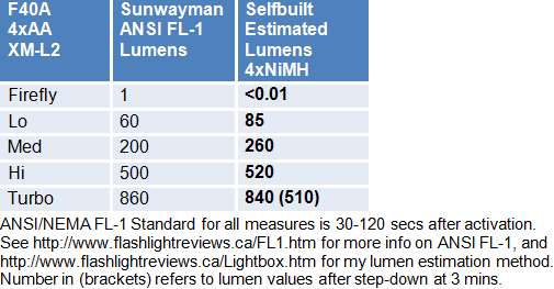

    Let's see how my white output estimates compare to the official Sunwayman ANSI-FL1 specs for this light:
    Note that the step-down feature (after 3 mins) actually steps you down directly to the Hi level. See runtimes below for more info.

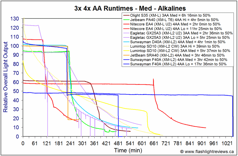

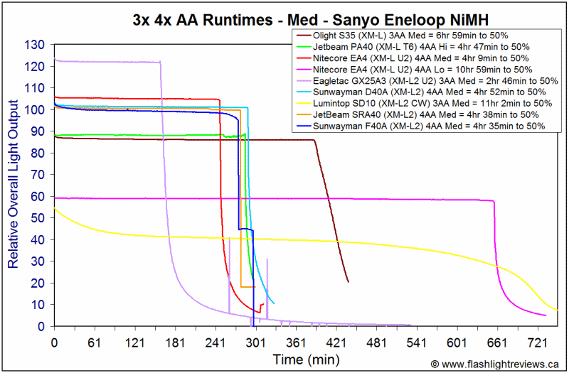

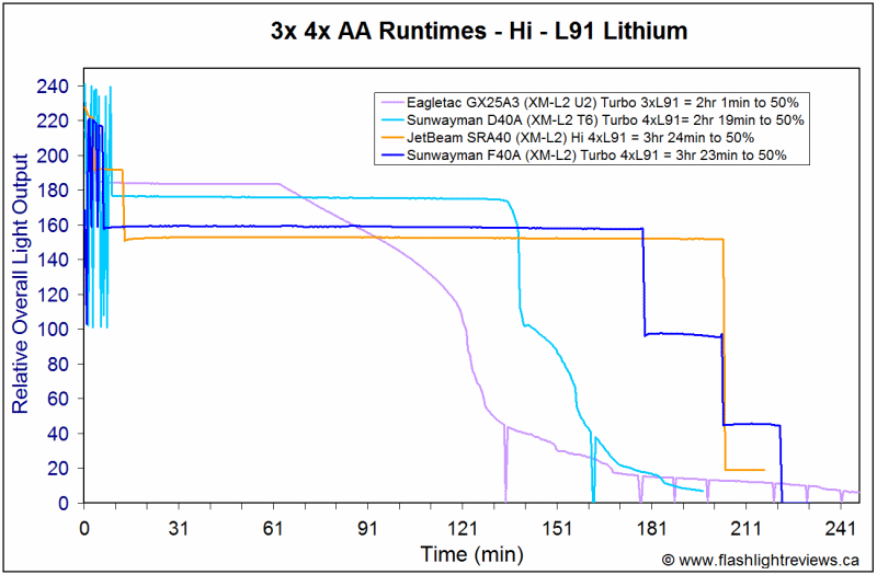

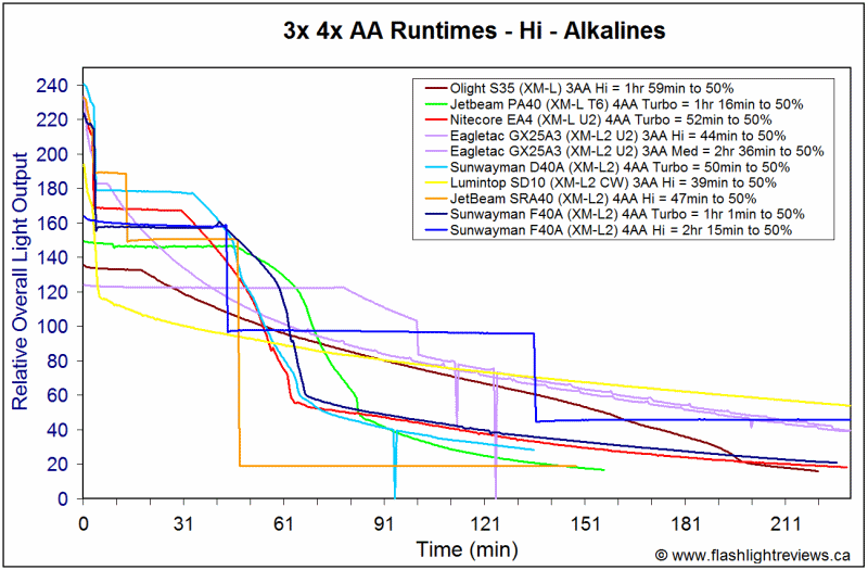

    Output/Runtime Graphs:
    As you can tell from above, Sunwayman is using a good current-controlled circuit in the light. Performance is particularly good on alkalines, where both regulation and runtime are very impressive. The F40A has a more step-wise progression as the batteries drain (i.e., jumping down to the next lower level and maintaining regulation for an extended period). This allows you to better predict the battery charge status, and the relative amount of runtime left.
    As with my D40A, the F40A has difficulty running at max output on L91 lithiums initially. The light repeatedly steps down every few seconds, requiring me to manually restart for several minutes (hence the messy initial traces above for these two lights). As before, I suspect the reason for this is that the voltage sensor detects fresh L91s (which can be ~1.7V) as outside the acceptable range for the light. Once you run down the L91s for a few minutes (at a lower level), enough capacity drains off so that you can run the light stably at the higher levels.
    Due to the electronic switch, there is a standby drain when not in use. This drain was negligible on my D40A – and I will update this review in a few days with the F40A results. Unfortunately, you cannot easily lock out the light physically on the F40A (i.e., need to almost completely unscrew the tailcap).
    The light won't stay in Hi or Turbo on fresh L91 lithiums without rapidly stepping down. This appears to be an over-voltage issue, and resolves after several minutes of runtime (to drain off full capacity).

    Physically, the F40A is even smaller than the D40A (thanks to the smaller reflector and lack of battery carrier now). It also has a more "rugged" appearance, with thick matte finish anodizing. It's an impressive amount of light in a small package.

    But why 6 red & 6 blue LED's !
    i think 4 red & 4 Blue & 4 green LED's would have been better idea , right ?
