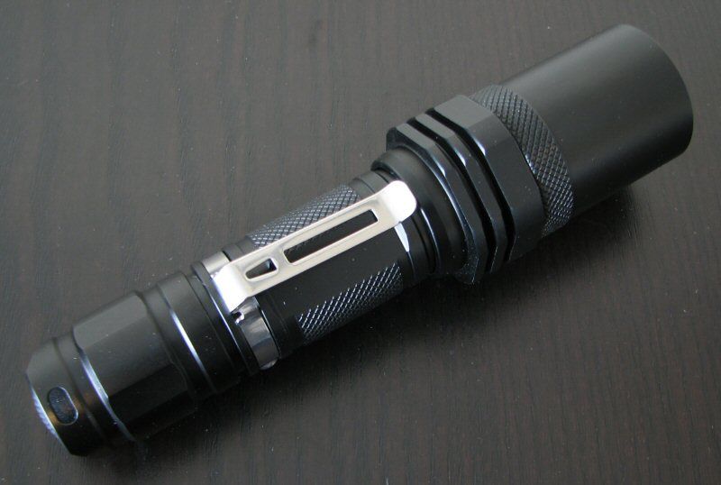

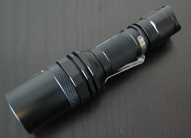

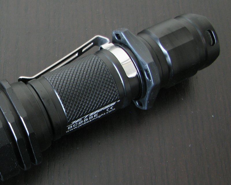

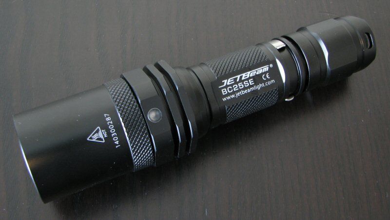

    The Backup series (BC and BA-series lights) were always pretty basic in build. The components were generally interchangeable among the family, but unfortunately I never tested the original BC25 (and so can't directly compare).

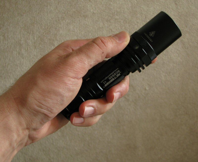

    One comment I will make here is that the BC25se does seem slightly bulky in the head for a simple two-stage light. This is likely due to the battery voltage indicator in the head.
    Like the other Backup lights, the BC25se has black anodizing (type III), relatively glossy. Lettering is a bright white against the black background (legible and clear, but not obtrusive). Knurling is not very aggressive, but there are some ridge detail items to help with grip.
    The removable pocket clip and plastic grip ring also both help with grip (and anti-roll) when installed. The pocket clip is fairly basic, but seems to hold acceptably. Note that as with the earlier models, the clip is not reversible. Also, as common on most lights with this sort of grip ring, it can still rotate even with the tailcap installed.

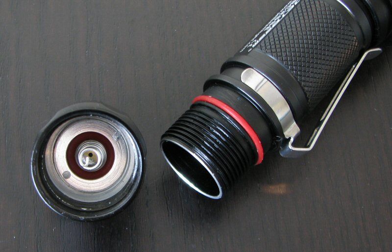

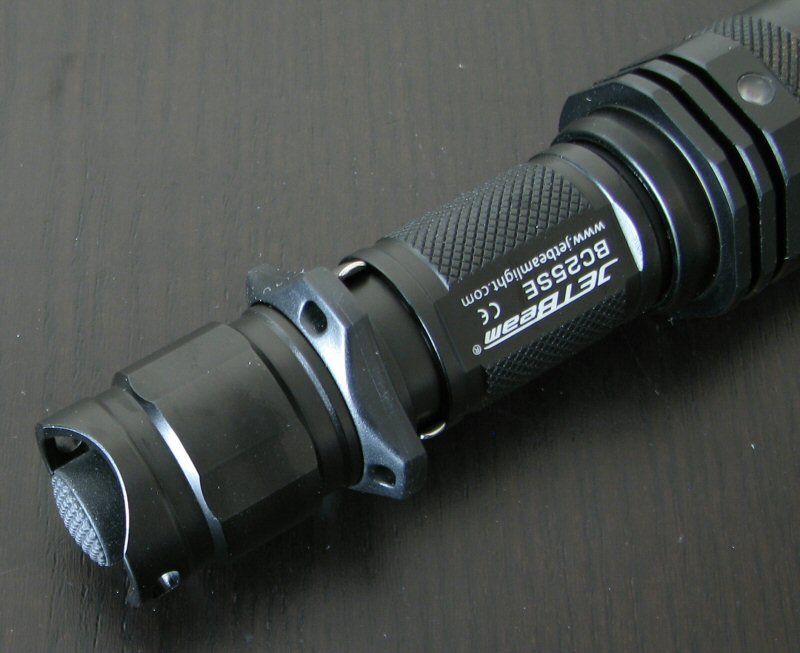

    There are a lot of screw threads in the tail area, with a traditional fine triangular cut. Threads are anodized, allowing for lock-out. The BC25se uses a forward physical clicky switch, as is common on these sorts of lights. I found the switch reasonably easy to access, with a typical traverse and feel.
    Note that the sample reviewed here cannot tailstand, given how much the switch boot protrudes beyond the tailcap rim. I understand from Jetbeam that they have corrected this, and all currently shipping samples should be able to tailstand.

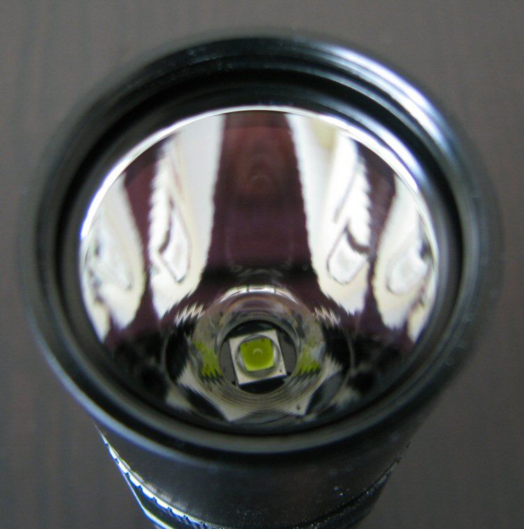

    The BC25se comes with a XM-L2 emitter and smooth reflector (emitter was well centered on my sample). Scroll down for beamshot comparisons.

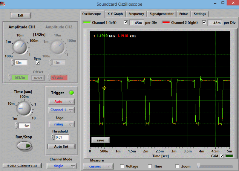

    Reviewer's note: I have recently updated my oscilloscope software, so the traces below may look a little different from my earlier reviews.
    On the earlier Backup series lights I tested, there was no sign of pulse-width modulation (PWM). I believe those lights were current controlled.
    On the BC25se though, there is visible PWM on the Lo mode:
    The frequency is 1.19 kHz, which is reasonable for a PWM light – but still visually noticeable for those of us who are sensitive to it. I would consider this to be reasonable for a PWM frequency. It terms of sensitivity to PWM, there is clearly a lot of variability out there – some people either don't see it or aren't bothered by it, others do.
    Moreover, the new circuit means the BC25se steps down to a series of discrete outputs as the battery voltage drops (starting a few mins after activation, on fresh cells). PWM was similarly detectable on all of these steps as well. This means that you will also notice PWM on the Hi mode fairly quickly as your cells drain.

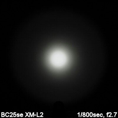

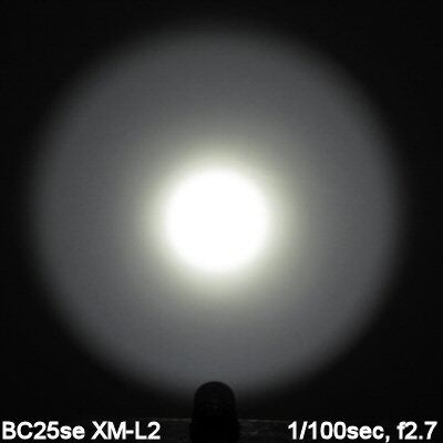

    And now the white-wall beamshots. All lights are on AW protected 18650 (2200mAh). Lights are about ~0.75 meter from a white wall (with the camera ~1.25 meters back from the wall). Automatic white balance on the camera, to minimize tint differences.
    The BC25se has a narrower overall spillbeam compared the smaller lights in this class (due to the relatively deep reflector here). It is also a "throwier" light, with a more focused hotspot. Scroll down for my actual beam measures.

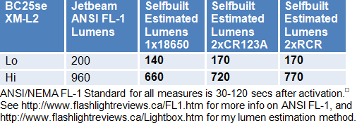

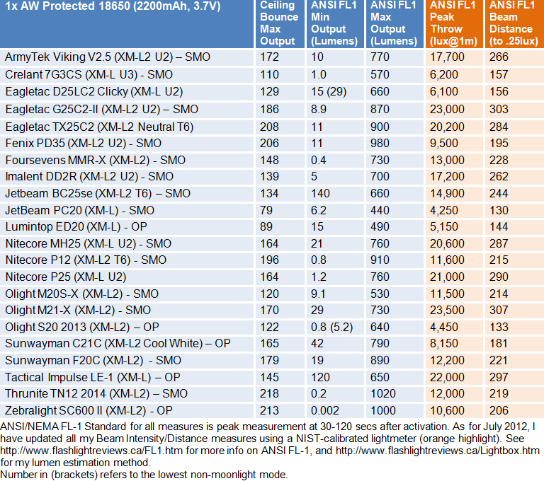

    There's a lot of data up there. Probably the best way to make sense of it all is to compare the performance of the BC25se on all batteries:

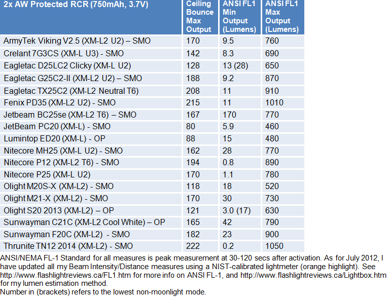

    First off, I'm a little surprised by the official "960 lumen" ANSI FL-1 rating on this light – in my testing, it was always a good ~200 lumens below that (even on 2xRCR). Not that this is a big deal – the 660-770 estimated lumens reported here is still a good amount of light.
    Note that I measured ANSI FL-1 Beam Intensity of 17,200cd (262m beam distance) on the highest output source, 2xRCR. This is proportionately lower than the reported max specs as well.
    See runtimes below for more info.

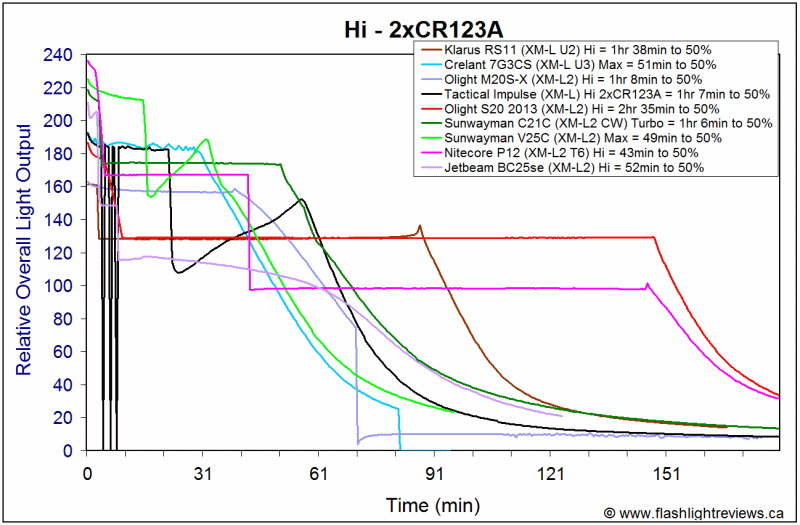

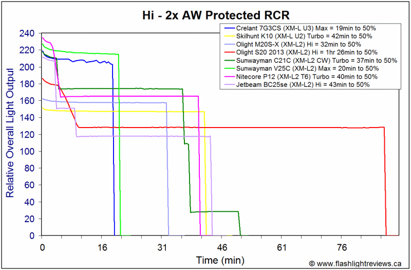

    Output/Runtime Graphs:
    These results require a bit of an explanation.
    The BC25se suffers from relatively low efficiency on its Hi mode, due to the use of PWM as soon as the first step-down occurs (3 mins into the run). All the other lights shown above - including several PWM-based ones – maintain constant-current on their highest mode. Since the BC25se steps down, it is bound to show lower overall efficiency on Hi.
    A better indication of how the BC25se compares can be found on the Lo mode 18650 test. Here, you can see the BC25se performs fairly close to the Olight M20S-X (another PWM-based light). Indeed, the BC25se is pretty much run-of-the-mill for a PWM light (i.e. better than the Tactical Impulse, not as efficient as the Crelant 7G3CS, for example).
    If it weren't for the novel PWM-based step-down on Hi, I'm sure the BC25se would have performed equivalently to the other lights above.
    The BC25se uses PWM for its Lo mode, at a reasonable (but still visible) 1.19 kHz. However, the new circuit design causes the light to step down repeatedly from its initial Hi mode (with the first step at 3 mins after activation). All these reduced Hi modes have a similar PWM frequency to the Lo mode. This means that within 3 mins of runtime on Hi, you may be able to detect PWM visually.
    The use of PWM on the Hi mode also means that the BC25se has lower overall output/runtime efficiency than other lights in my collection. Note that all the other PWM-based lights I've tested maintain constant current on their highest mode.

    Thanks for the review! Lets see here ansi rated at 960 lumens and only delivers 760? No thanks. I cannot stand it when manufacturers pull the "overrate and overstate" marketing BS. I had enough overrated and overstated heartbreak with my supposedly 960 lumen yet actually nearly a ridiculous 200 lumens lower SRT7. I do like Jetbeam though I have an SRA40 and just got the new 3m Pro and am more than impressed with them both.

    Selfbuilt, thank you for the review.
    I was THIS close || to considering getting this light until I read your review. Good thing, because I would not have liked this light's performance.
    You mention the light yielded only 17,200cd (262m beam distance) on the highest output source, 2xRCR. Per the table above, I think you skipped a row.
    It's only 14,900cd (244m): way below the advertised 22,000cd.
    This kind of shameless embellishment might just be enough for me to stay away from this brand altogether.
    6,936
    Default Re: Jetbeam BC25se (XM-L2, 1x18650, 2xCR123A/RCR) Review: RUNTIMES, BEAMSHOTS and mor
    Quote Originally Posted by scs View Post
    No, it's just that I don't typically report beam intensity/distance on anything but 1x18650 in the tables (i.e., those two orange columns are missing from the 2x tables). Rather than make two new columns on the 2xRCR table for only one row that has data, I simply reported the results in the text.
    My BC25se produces 14900cd on 1x18650, and 17200cd on 2xRCR.
