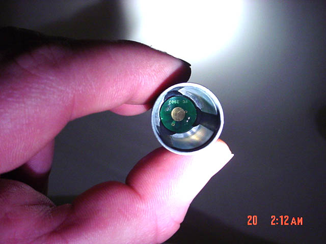

The first thing I did was take head apart and do some measuring. Believe it or not, the internal dimensions of the head are pretty much identical to a MM. Which, of course, means an NX05 or Fraen will drop right in (sans tab). Score #1! So, I move on to the body. The body was milled out in a kind of clover shape to hold the 3xAAAA configuration, but a AA fit beautifully as well. After gutting the tube I realized the first half inch or so was not fully milled and has the same I.D. as the MM. One of Dat2Zip's MM sandwiches would drop in. Score #2! The only problem was that when I dropped the switch/lamp assembly from a MM into the T-45 body the AA was too long to fit. No problem, heck even better, since the body has a bit larger O.D. than a MM It could be milled out. Score #3! A short trip to the company machine shop and I had a 1x123 body.

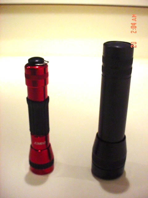

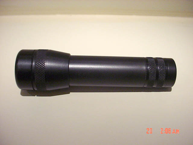

So, here it is:
Next to a Dorcy AAA for comparison. It works in candle mode!

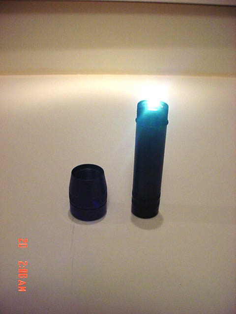

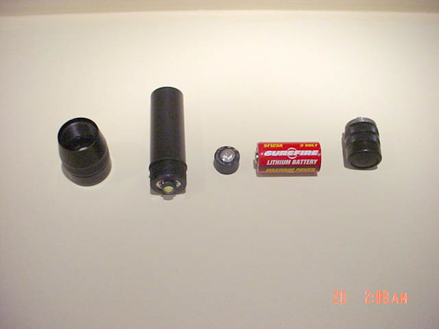

Partially disassembled and a shot into the milled body:
The obligatory beamshots:
First: Dorcy AAA (That purplish smudge on the left) and the T-45 (right)
Second: SF C3 (top left), Modded T-45 (middle right), Dorcy AAA (That purplish smudge on the bottom left)
While trying to decide if I should buy a MM+Q3 or a MM+LuxIII T they um... both sold out /ubbthreads/images/graemlins/icon23.gif So I ended up dropping a MM+Q2 in it. Now I know what people mean when they describe an LED as a "greenie" or use a /ubbthreads/images/graemlins/icon15.gif icon. There's a really funky green color that only a bad bruise, rotting pork, or (apparently) an LED can make. Don't get me wrong. The sandwich is awsome and the center of the hotspot is a nice color and bright, but man, the outer edge is *yuck*. Oh well nothing a better binned sandwich won't fix. /ubbthreads/images/graemlins/wink.gif
