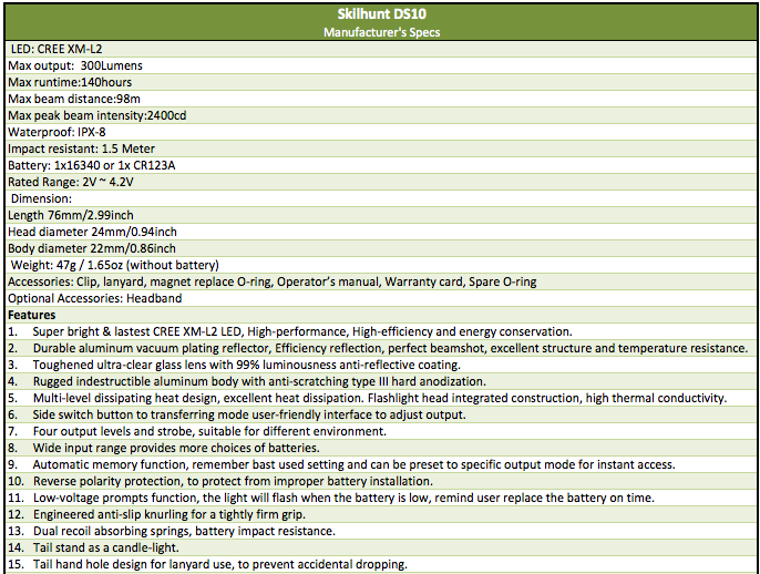

    Manufacturer's Specifications
    Price: 40 USD

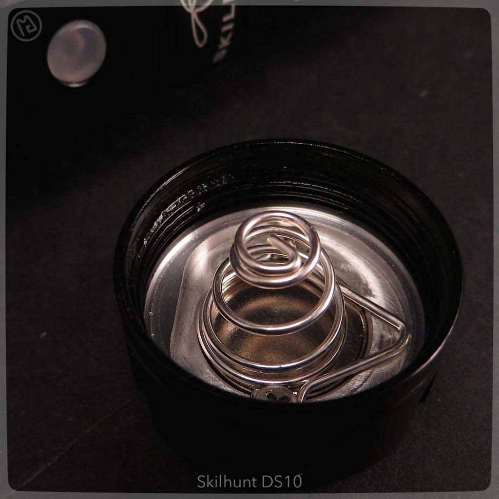

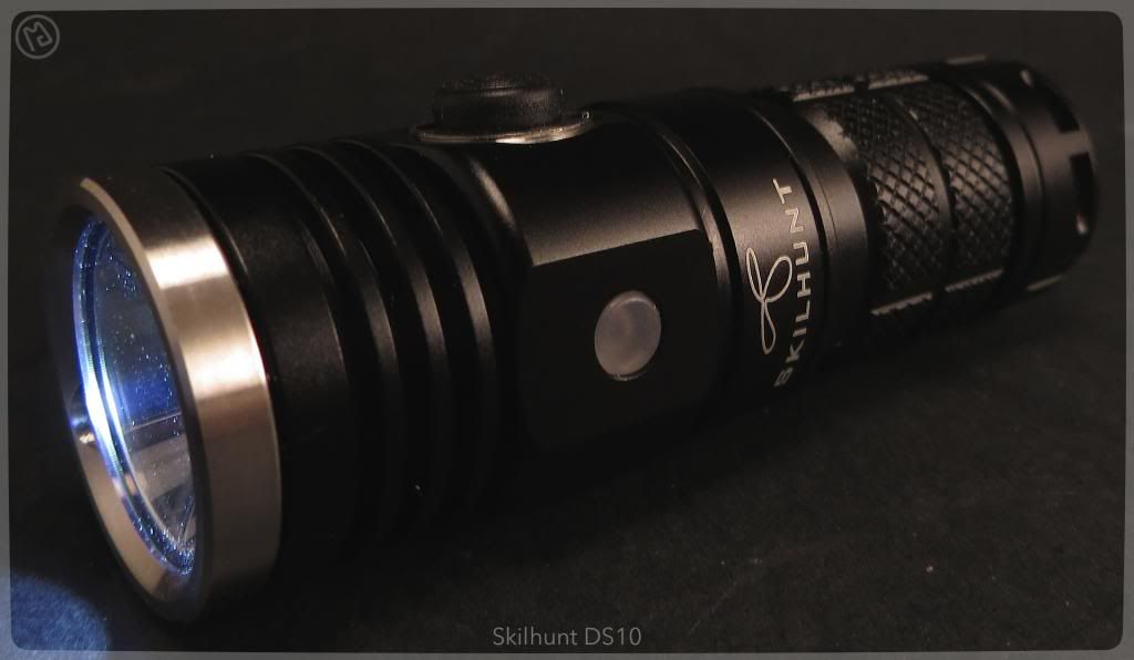

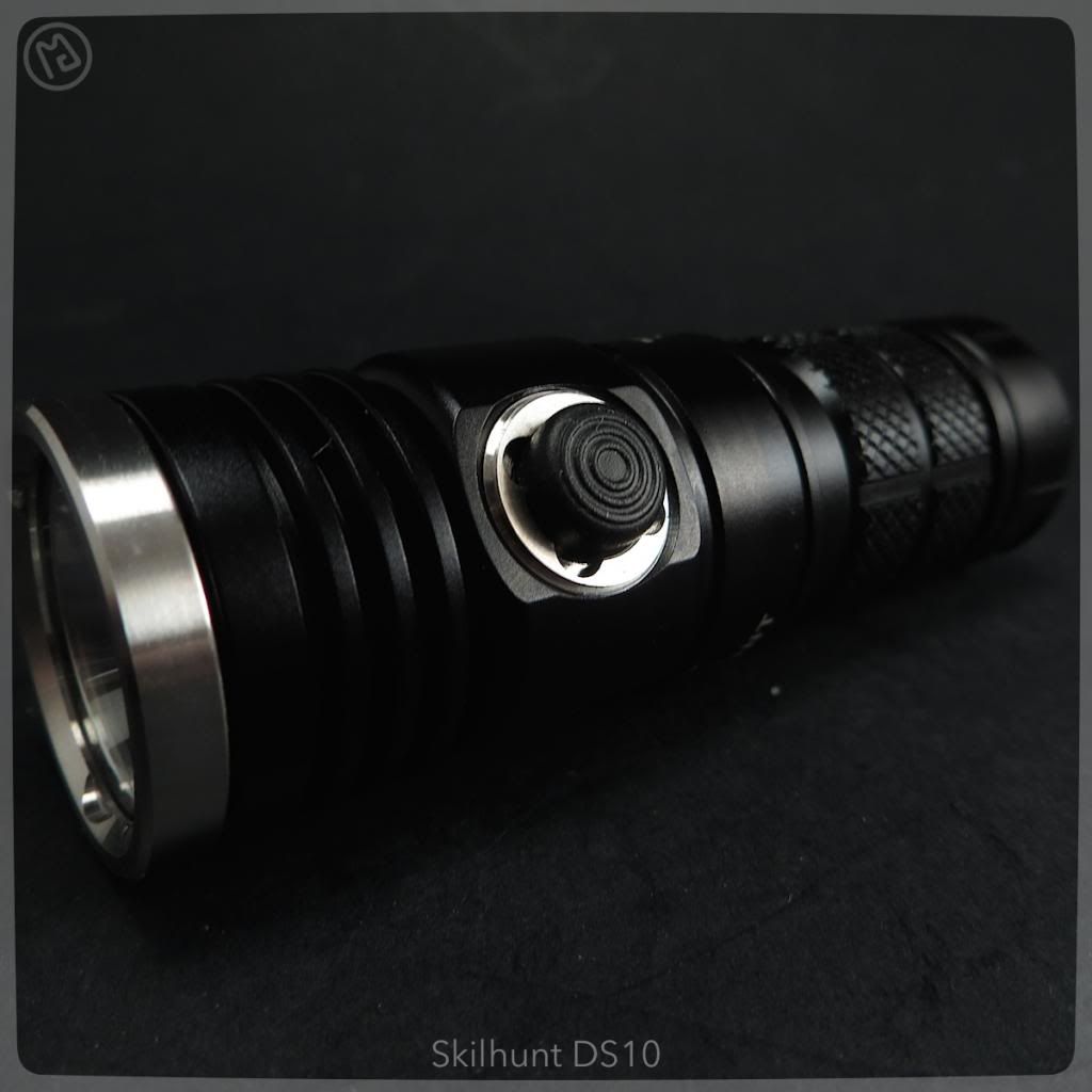

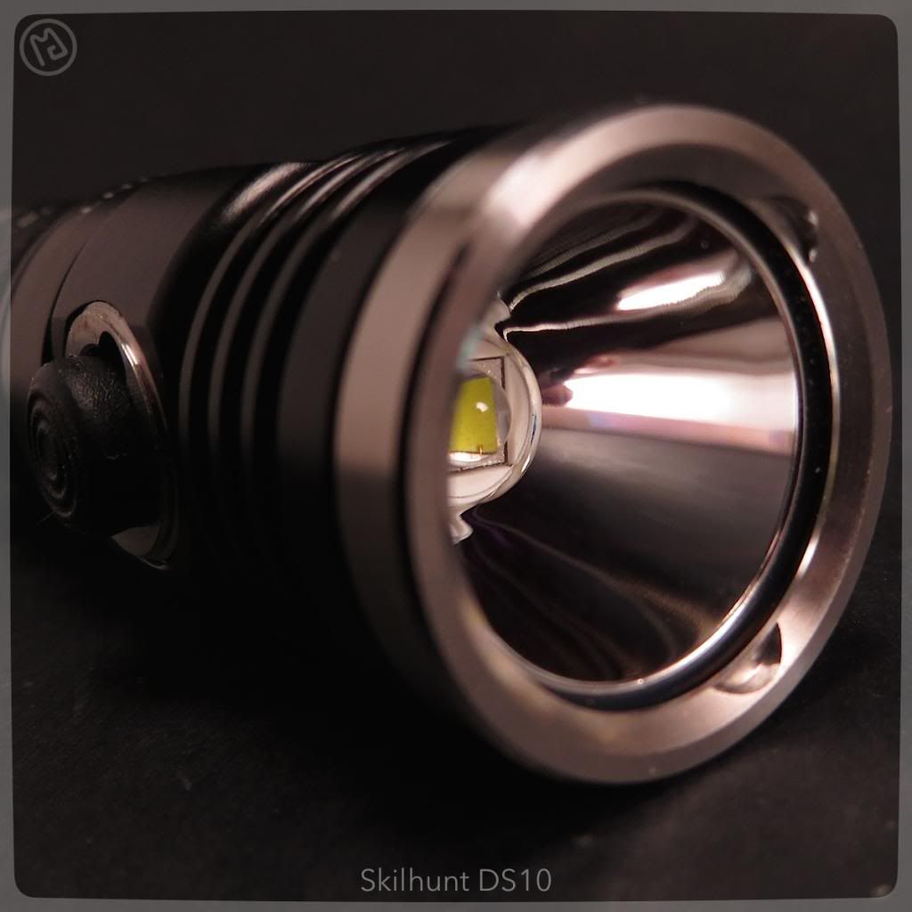

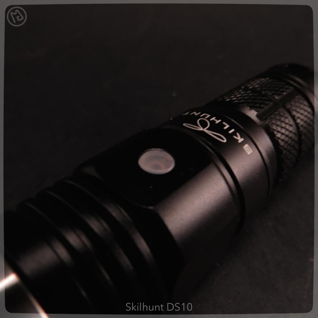

    Plus, here's a few shots with some good detail.
    The DS10 shares an interface with other models in the DS series, controlled by a single electronic side switch (a magnet in the tail has replaced the traditional tail switch).
    To turn the light on in the last brightness mode used, press the switch once quickly. Once on, a single quick click rotates through the sequence Low -> Medium -> High -> Turbo. Two quick clicks switches to strobe mode. To turn the light off, hold down on the switch for about a second.
    Also, when the light is off, you have direct access to the Low mode by holding down the switch for a second instead of a quick click, or direct access to Turbo by using two quick clicks. The result is that when the light is off, you can always turn it on in Low, Turbo, or the last used brightness setting.

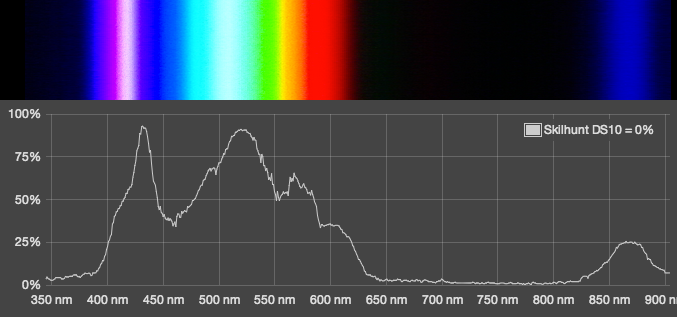

    Spectral Analysis
    All light that we see as white is actually made up of several different colors put together. The relative intensities of the different colors in the mix are what determine the tint of the white we see. For example, cool white LED's have a lot of blue, and warm white LED's have more red or yellow. This measurement was done on a home made spectrometer. The plot below the picture is corrected for the spectral sensitivity of the human eye. Note: the peak in the 900nm region doesn't really exist, it's a piece of the second-order spectrum that's showing up here because of the high intensity of the light source.

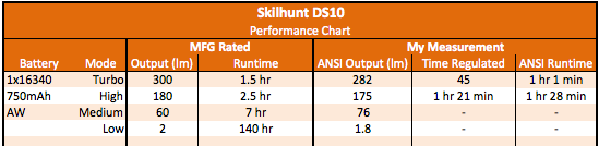

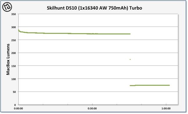

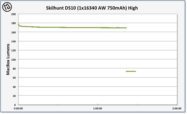

    Output and Runtime
    ANSI FL-1 runtime ratings are the time it takes for a light to fall to 10% of it's original output (counting from 30 seconds after turning the light on).
    The vertical axis of the graphs below represents a relative brightness measurement using a home made light box. The horizontal axis is time in hours:minutes:seconds. Runtimes are stated in hours:minutes:seconds. These graphs may be truncated to show detail.
    Mode Comparison
    Turbo
    High

    This brings me to what I like about the light. First, it's tiny (the second smallest CR123 light I have, the smallest is a twisty-only with no switch) so that it can be carried easily even in small pockets, or even clipped to the brim of a hat. Second, the tail has a very impressive magnet. You can see the video above to see just how strong the magnet is. I've seen other lights with magnets in the tail, but this is the first one I've used that was a high quality light, the others being the kind of cheep thing you find at a chain hardware store. The magnet is exceedingly useful for keeping the light where you want it in a variety of situations (I anticipate keeping this in the car as an emergency light, with a lithium battery installed).

    Turbo graph has been updated, the first one was bad due to and instrumentation failure.
