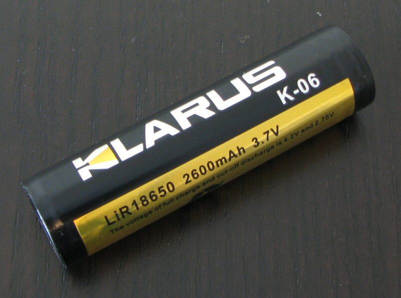

    • Brand New custom KLARUS 2600mAh 3.7V rechargeable Li-ion battery, using Samsung cells and a unique contact design that automatically aligns positive/negative current regardless of battery orientation

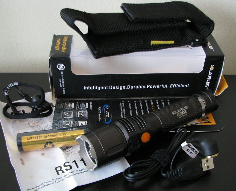

    The RS11 uses similar display packaging as before, but updated with new info and specs. The light comes with a good number of extras – most notable is the custom magnetic USB charging cable and custom 2600mAh protected 18650. Also included are the standard manual, spare o-rings, basic wrist strap, removable pocket clip (attached), and belt holster (with closing flap). Note there is no grip ring included.

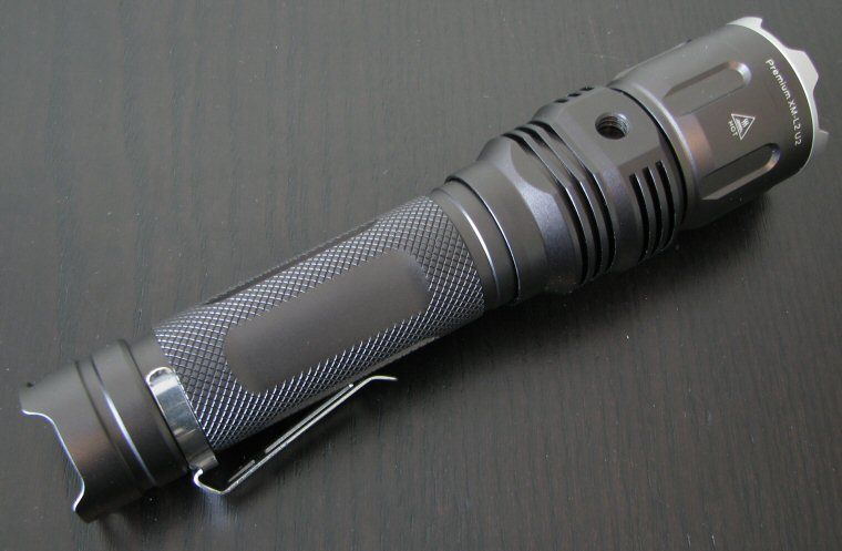

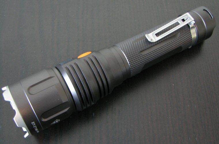

    Generally, the RS11-2014 looks similar to the old RS11-2012. The main external difference is the appearance of the switch buttons. Otherwise, the anodizing remains a rich dark grey-brown color (hard anodized). As before, no blemishes or flaws on my sample – I find this color very attractive. Labels are clear against the dark background. As before, knurling is not very aggressive. But with all the ridge detail and extra elements around the head and body, overall grip remains good.
    As before, the clip-on pocket clip is fairly basic, but seems to hold on fairly well (for this type of clip). And again, the clip is head-facing, and not reversible. There is no grip ring bundled with light (in keeping with the electronic switches in the head). There is now a tripod screw attachment in the head.

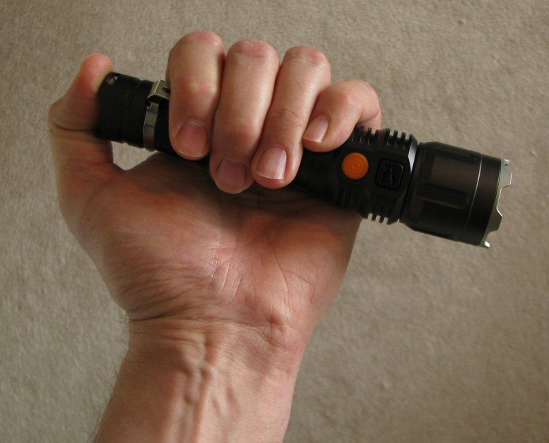

    As before, the light is controlled by two electronic switches in the head. The upper black on/off switch is on a raised part of the head. The lower bright orange button is the strobe switch. The interface is unchanged from before (scroll down for the UI section details). Switch feel is about typical for electronic switches, but the timings may take a little getting used to (again, scroll down to the UI section).
    The RS11 can tailstand, thanks to the raised side areas (which are also the lanyard attachment points).
    Screw threads in the head remain traditional triangular-cut, and silky smooth in action – I wish more lights glided so easily when tightening and loosening. Threads are also anodized now for lock out, thanks to the re-designed charging system.

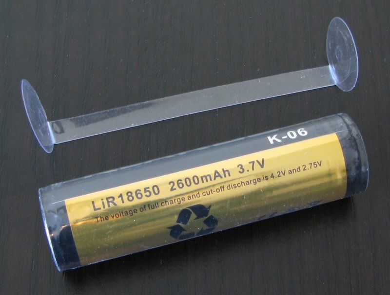

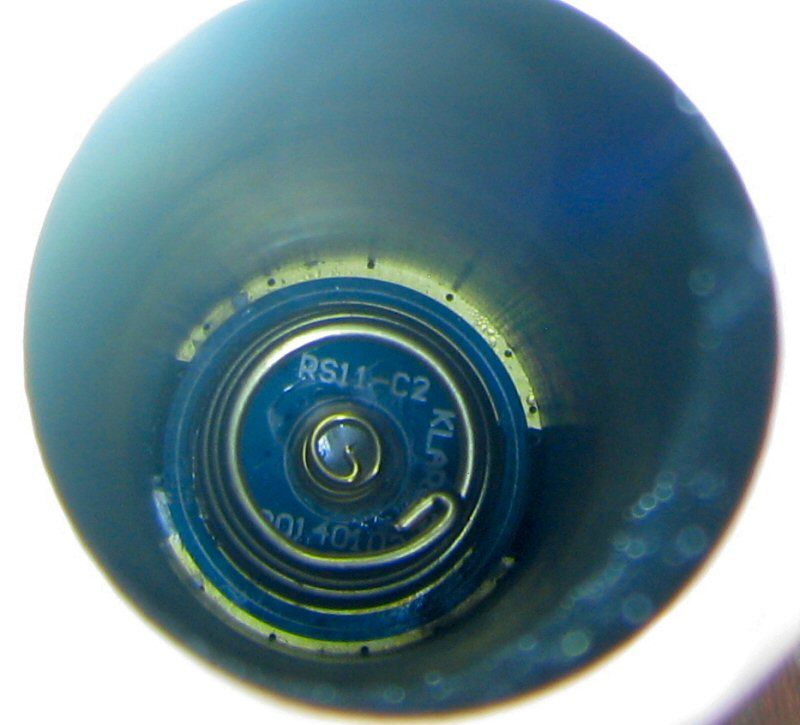

    There is a small spring in the head, so all flat-top high capacity cells should fit and work fine in the light. It also accommodates the custom 18650 supplied, shown below.

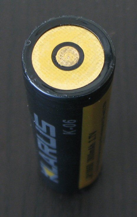

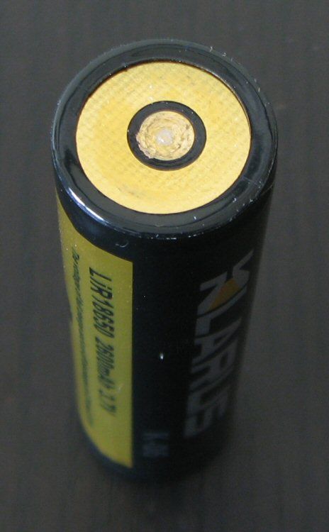

    The plastic insert you see in the second and third pics is just to lock the battery out during transport (i.e., it is shipped inside the light). You can discard it, as well as the external clear plastic wrapper.

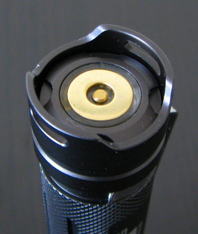

    The cell has custom positive (center) and negative (outer) contacts on both ends. This is for charging the custom cell inside the light, using the supplied charger.

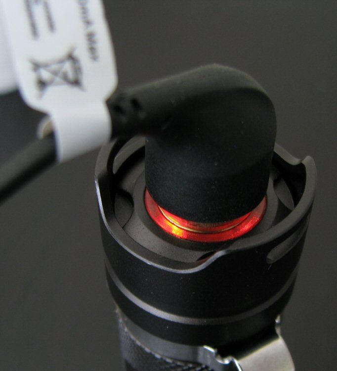

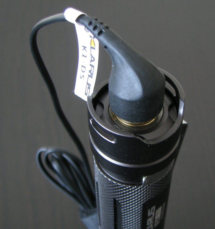

    Let's look at the charging setup:
    The tail uses a similar magnetic charging dock to before (with the exact same charging cable). The 18650 charging cable directly attaches to the external tailcap contacts through a strong magnetic connection (you can see two metal circular contacts). As before, I was not able to read a battery voltage at the external tailcap contacts with an 18650 installed inside the light. This means you don't have to worry about accidentally shorting out a battery inside the light.
    Inside the tailcap, these contacts are connected to the positive and negative terminals of the custom battery through two springs. This replaces the previous inner metal sleeve that was connected to the head (for the second current path). This is why anodizing was not possible on the original RS11. The flip side to the custom charging arrangement used here is that you need to use the bundled custom cell to charge inside the light. Regular 18650 cells will work fine in the light, but you won't be able to charge them.
    The charging indicator LED has also been updated from before, and is now a ring around the charging dock (instead of a separate indicator). A nice touch.

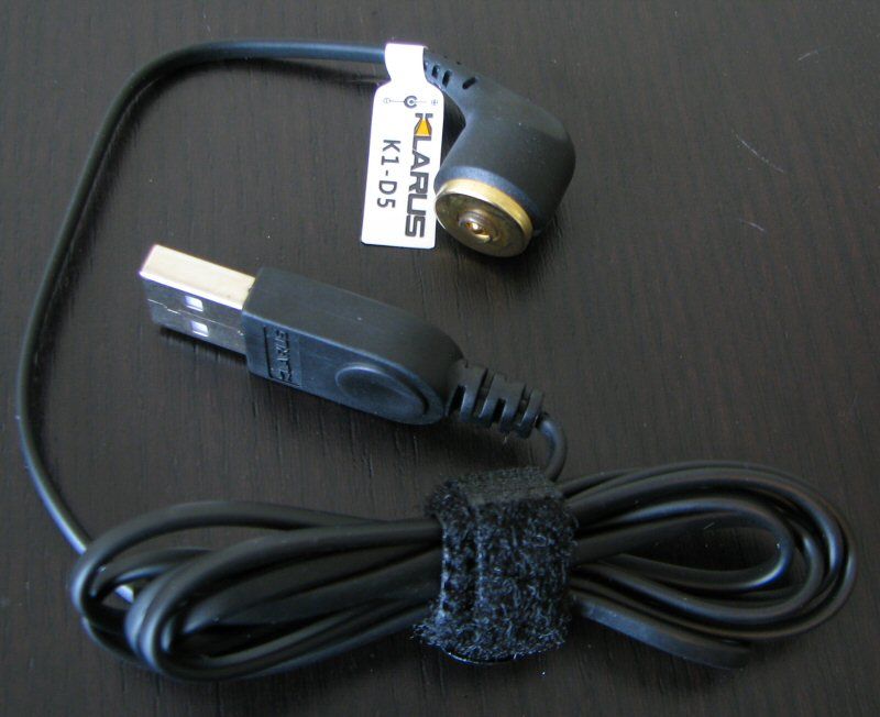

    The charging cable is unchanged from the initial version. As before, there is a raised plastic divider separating the inner and outer magnetic contacts on the charging cable. The divider is important, as you could otherwise potentially short your USB connector if the magnet attracted metal to both contacts simultaneously. To be on the safe side, I always recommend that you connect the magnetic head to the flashlight before you connect the USB end to your computer or an AC power adapter.
    Please scroll down to my new Charging Current section for detailed measures of charging performance.

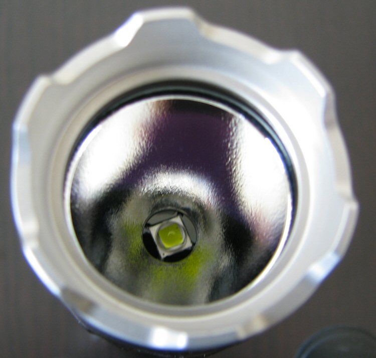

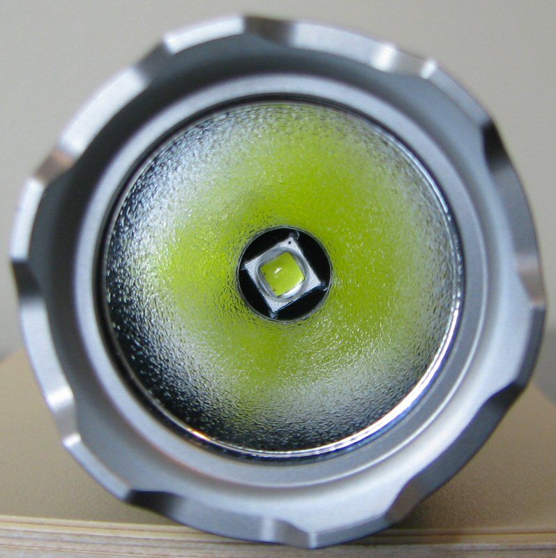

    The RS11-2014 seems to use the same reflector as before, only with a light orange peel texturing on my sample.
    There is also a removable stainless steel bezel ring as before. The head diameter and threading is unchanged from before, so the colored filters or diffuser available as accessories for the original RS11/XT11 will work here as well.

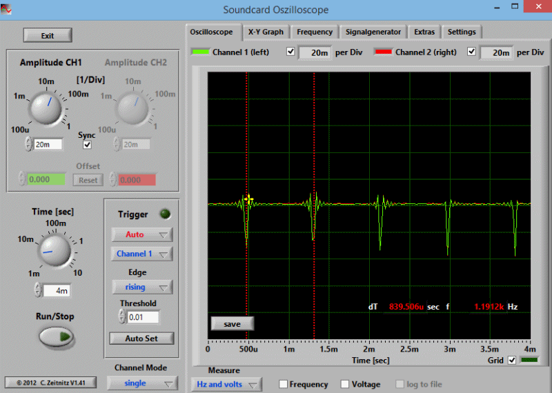

    PWM/Strobe
    Reviewer's note: I have recently updated my oscilloscope software, so the traces below may look a little different from my earlier reviews.
    The original RS11 used PWM on all modes (including Hi) at ~1.16-1.17 kHz. Let's see how the new RS11-2014 fares …
    Pretty much the same, although I measured the frequency as ~1.19-1.20 kHz.
    PWM is an apparently unavoidable by-product of having the dual control circuit. Typical, ~1kHz PWM is visually detectable at the lower modes (for those of us who are sensitive to it), but I at least I do not find the PWM frequency to be annoying or obtrusive on any level in this light.
    Note as well that it is practically impossible to notice the PWM on the Hi mode, even when shining on a fan. I have come to realize in my testing that PWM is far more noticeable when the duty cycle is low (i.e., the light is off more than it is on for each pulse). For higher perceived output (where the light is on for most of the time), the visual perception of PWM drops considerably. This is an example where you would need an oscilloscope to be able to detect the Hi mode PWM.

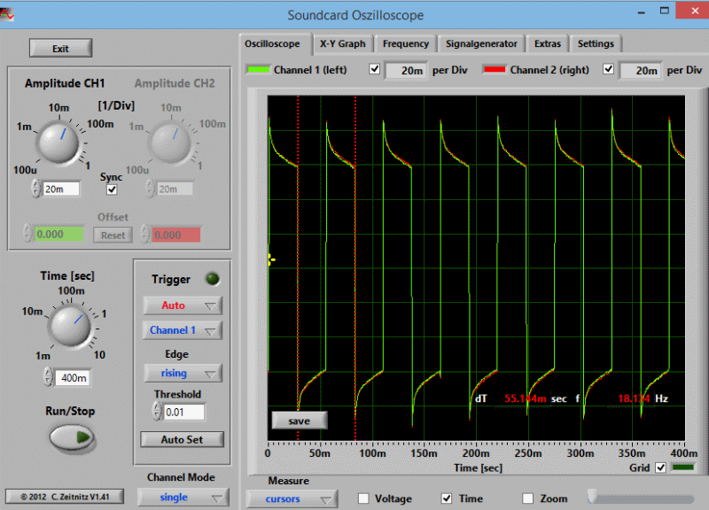

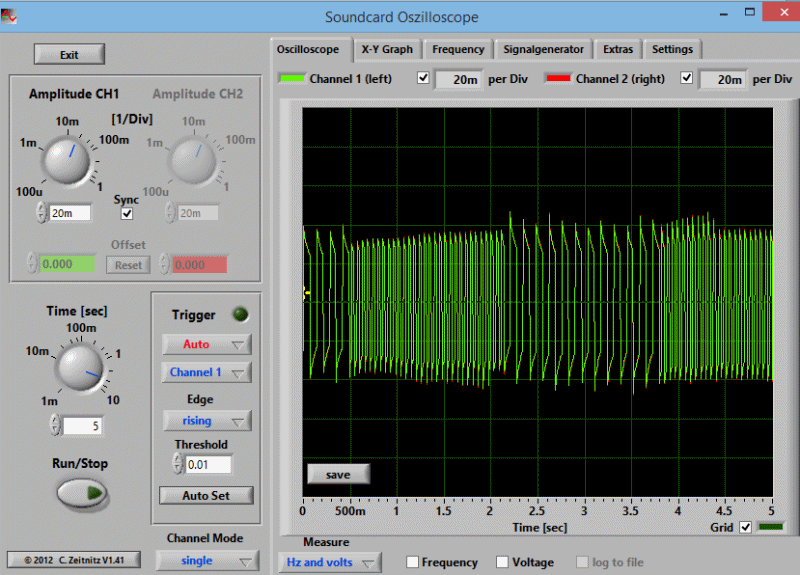

    As before, strobe is an oscillating strobe that switches between two frequencies every ~1.6 secs or so. Here is a blow up of each frequency:
    As you can see, the strobe switches between 7.2 Hz and 18.1 Hz.

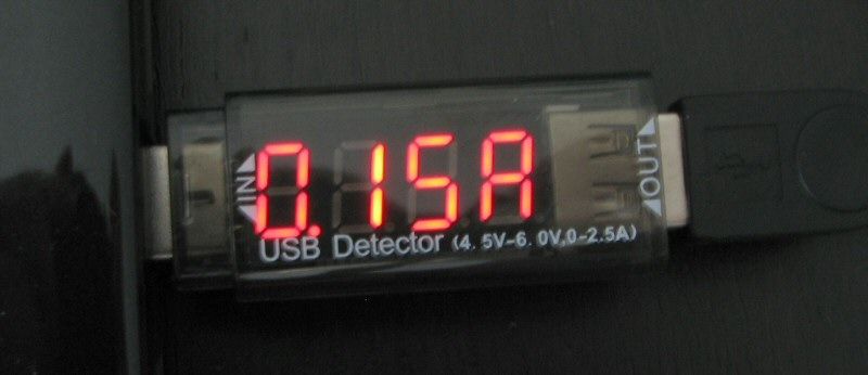

    A new feature I am adding to my reviews is direct measures of the charging current for USB-based in-light charging systems. For these measures, I am using the new Xtar VI01 "USB Detector", which has recently been reviewed by HKJ here. Basically a specialized USB multimeter (current/voltage meter), I have picked up this model thanks to the confirmation from HKJ that his sample was accurate within the typical USB spec range. Note these units report input voltage (not output voltage), so they typically show the standard USB spec of ~5V DC
    For charging tests, I started with a discharged Xtar RS11-2014 2600mAh battery, reading ~2.60V resting voltage. For all these tests, I remove the USB detector after each reading was taken, to ensure accurate charging times,

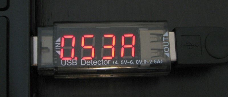

    Initial charging current and input voltage:
    As you can see, charging started at 530mA with a typical USB 5.0V input voltage ("U" is meant to represent Volts on the second display above). This is the max charge current that I would expect from USB (i.e., the USB 2.0 standard of 0.5A).

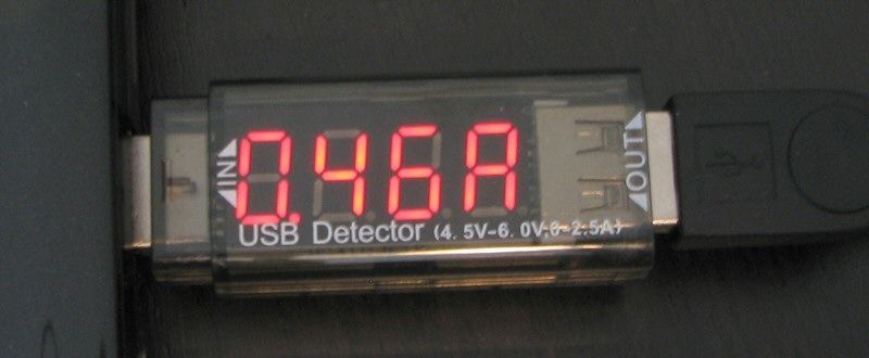

    After 3 hours of charging, I re-measured charging current and input voltage:
    As you can see, the charging current has started to drop down by this point, to 460mA. Input voltage is largely unchanged, as expected.
    After 6 hours of charging:
    Charging current has now dropped to 150mA, still with ~5V DC input voltage. As you might expect, it won't be long until charging terminates.
    In my testing, the charging indicator went green ~45 mins later, for a total charging time of 6hr 45mins. Resting voltage of the Xtar 2600mAh battery was 4.20V.
    This is quite reasonable charging time and final termination voltage.

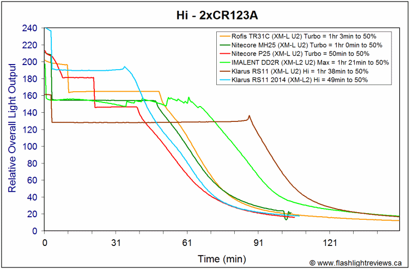

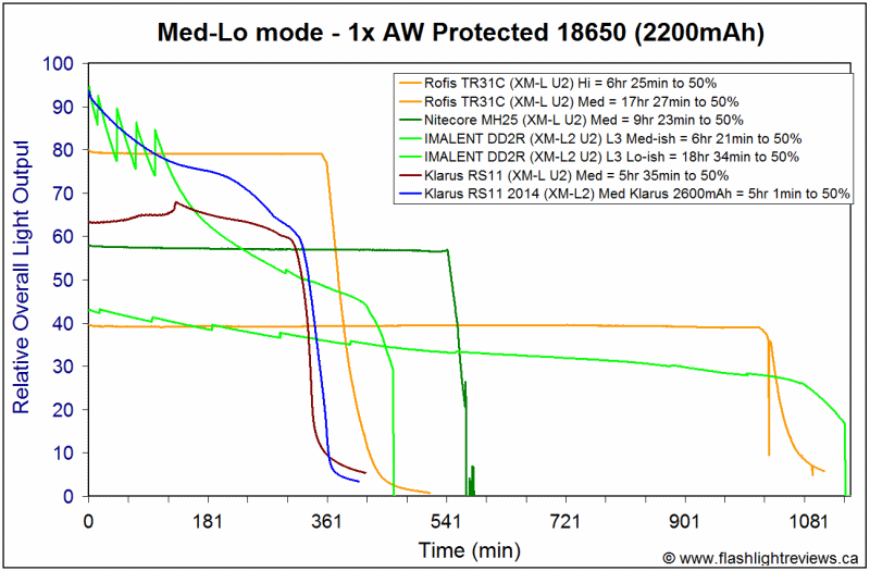

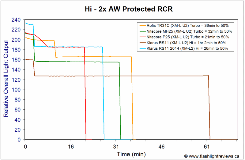

    Output/Runtime Graphs:
    Let's start with a comparison of the new 2104 versions of the RS11 and XT11:
    As you could tell from the earlier tables, the RS11 is more consistent than the XT11 in its output levels across batteries. As a result, the graphs above should give you useful direct comparison information on relative output and runtimes of the two models.
    Let's see how the RS11-2014 compares to others in this class, including the original 2012 version.
    In general terms, the RS11-2014 performs as you would expect – but with much greater output now on the Med and Hi levels, compared to the original 2012 version. This typically puts the RS11-2014 among the higher max output 18650 lights I've tested.
