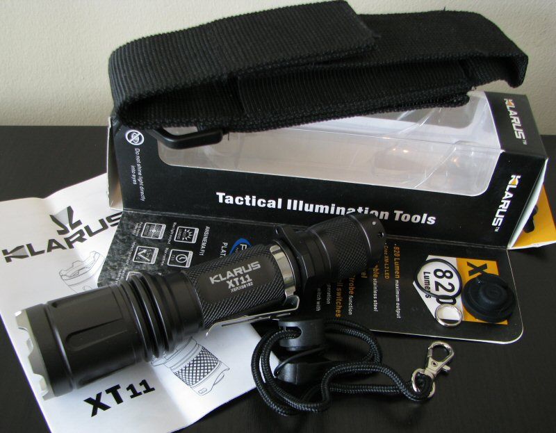

    The XT11 uses similar display packaging as before, but updated with new info and specs. The light comes with the usual extras – including the a manual, spare o-rings, wrist strap, removable pocket clip (attached), removable grip ring (attached) and belt holster (with closing flap).
    From left to right: AW 18650 protected; Klarus XT11-2014, XT11-2012, RS11-2014, RS11-2012; Nitecore P25; Eagletac G25C2-II.

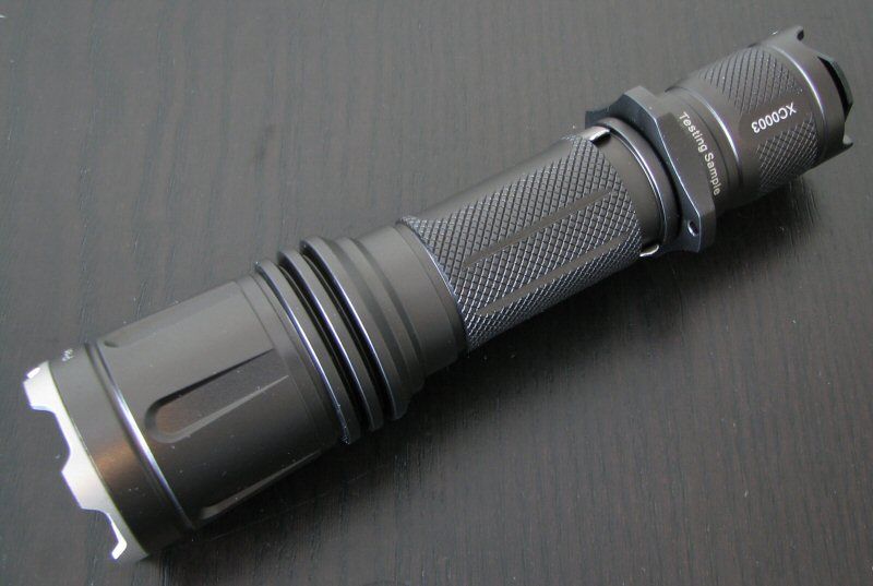

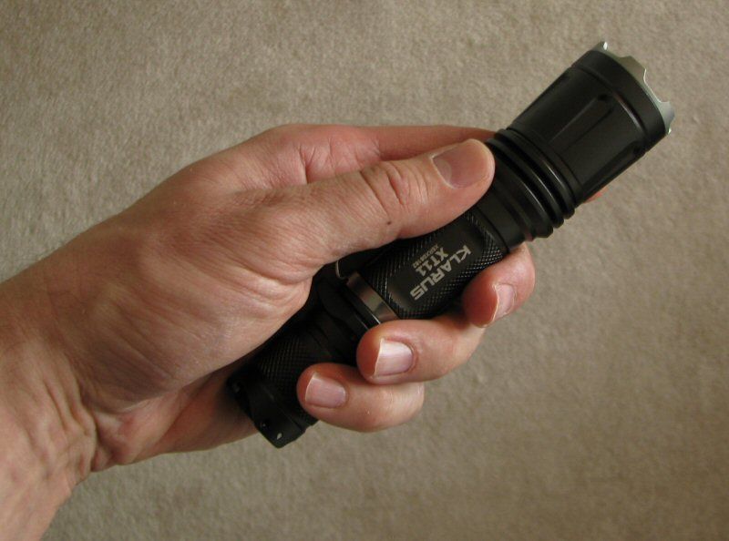

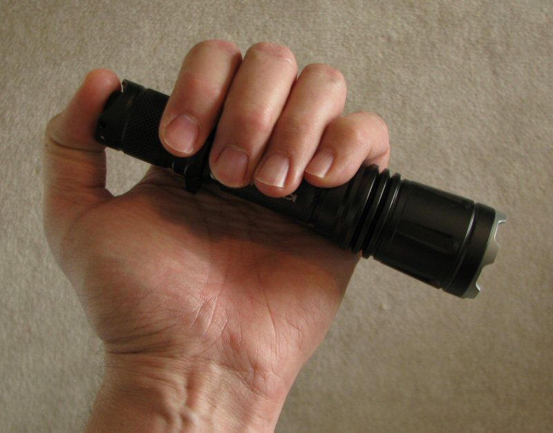

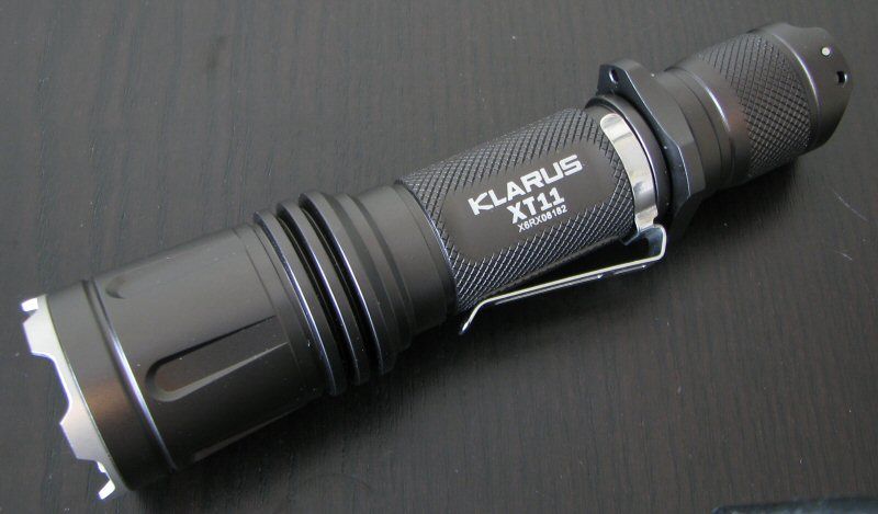

    Generally, the XT11-2014 looks similar to the old XT11 that I last reviewed in 2012. The main external difference is the new tailcap switch. My earlier 2012 also had the low profile bezel ring – this was replaced some time ago by the standard bezel ring of the RS11 model
    Anodizing remains a rich dark grey-brown color (hard anodized). As before, no blemishes or flaws on my sample – I find this color very attractive. Labels are clear against the dark background. As before, knurling is not very aggressive. But with all the ridge detail and extra elements around the head and body, overall grip remains good.
    As before, the clip-on pocket clip is fairly basic, but seems to hold on fairly well (for this type of clip). And again, the clip is head-facing, and not reversible.
    The bundled grip has been made of metal for some time now (I recall there were some initial issues with the original plastic ring cracking when dropped). It can still spin when the tailcap is fully tightened (as with many other lights in this class).

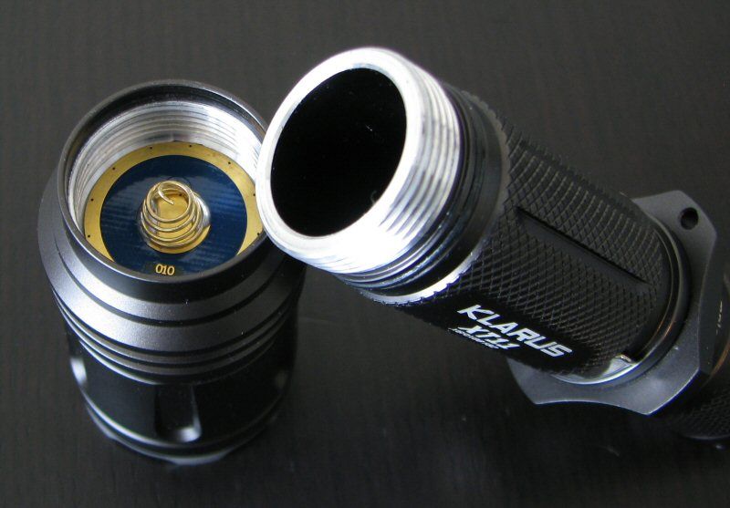

    There is still a spring in the head, so all flat-top high capacity cells should fit and work fine in the light.

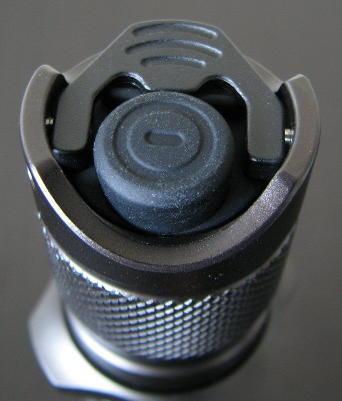

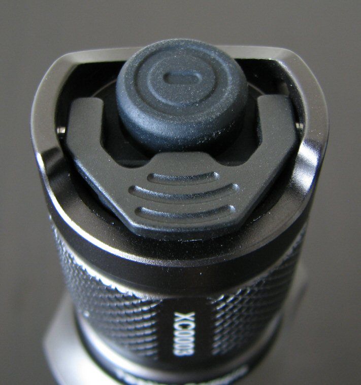

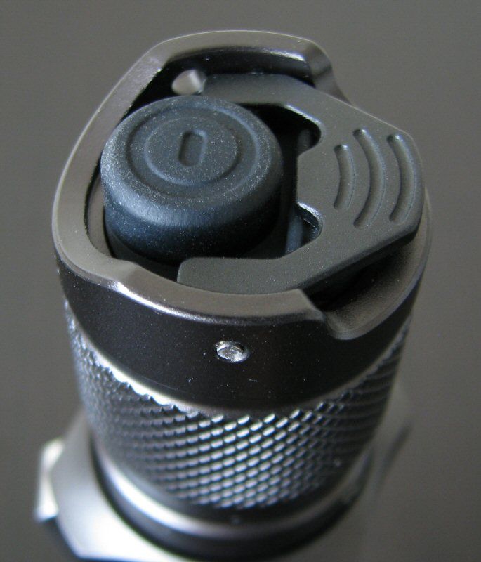

    As before, the light is controlled by two switches in the tailcap – a primary physical clicky (for off/on) and a secondary electronic switch (for strobe or mode switching). What has changed recently is the addition of a lever over the electronic switch (held in place by a pin through the tailcap). This greatly facilitates access to the secondary switch now. As always, both switches can be accessed one-handed by the thumb or index finger, in whatever grip style you prefer.
    My previously XT11 definitely couldn't tailstand, but I found the new 2014 version of the tailcap better in this regard. The light is still very wobbly though, so I wouldn't trust tailstanding ability in this case.

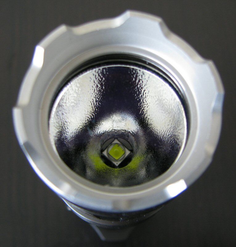

    The XT11-2014 seems to use the same reflector as before, and the same reflector as the current RS11. The new XM-L2 emitter was reasonably well centered on my sample.
    As previously mentioned, the removable stainless steel bezel ring is now the same as the RS11 model (with typical crenelations). The bezel diameter and threading is unchanged from before, so the colored filters or diffuser available as accessories for the original RS11/XT11 will work here as well.

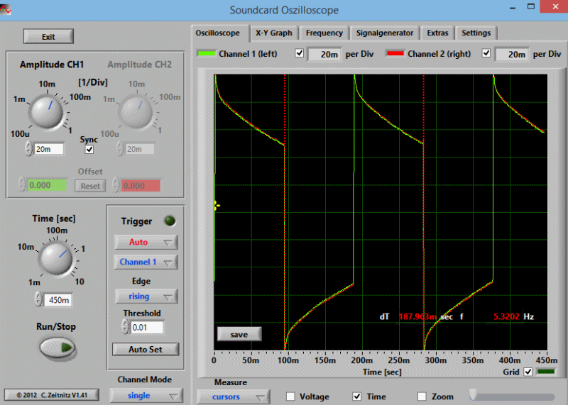

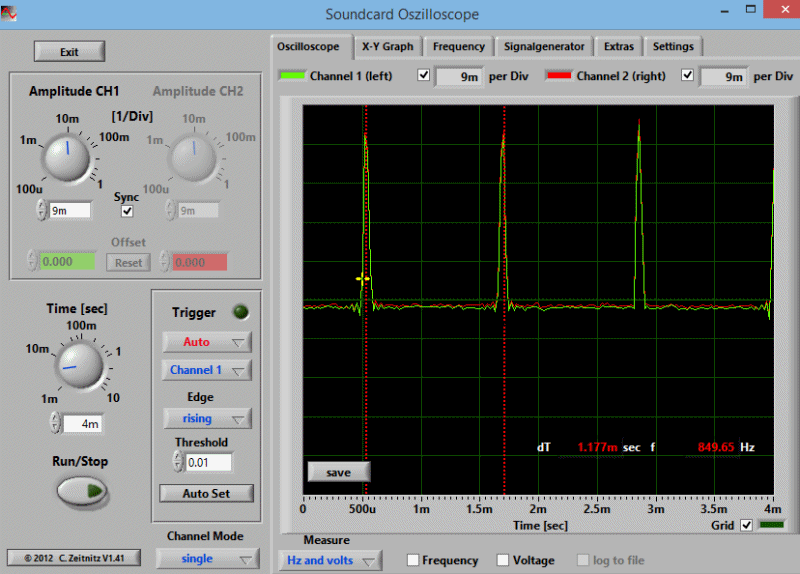

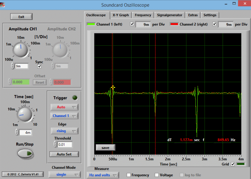

    PWM/Strobe
    Reviewer's note: I have recently updated my oscilloscope software, so the traces below may look a little different from my earlier reviews.
    The original XT11 used PWM on all modes (including Hi) at just under 1 kHz. Let's see how the new XT11-2014 fares …
    The new XT11 is not all that different from before. The PWM range is from ~850-880 Hz on the various levels my new XT11. Note that PWM is an apparently unavoidable by-product of having a tailcap control circuit combined with a head circuit.
    As with the RS11 that I have reviewed recently, it is practically impossible to notice the PWM on the XT11 Hi mode (even when shining on a fan). PWM is far more noticeable when the duty cycle is low (i.e., the light is off more than it is on for each pulse). For higher perceived output (where the light is on for most of the time), the visual perception of PWM drops considerably. This is another example where you would need an oscilloscope to be able to detect the Hi mode PWM.

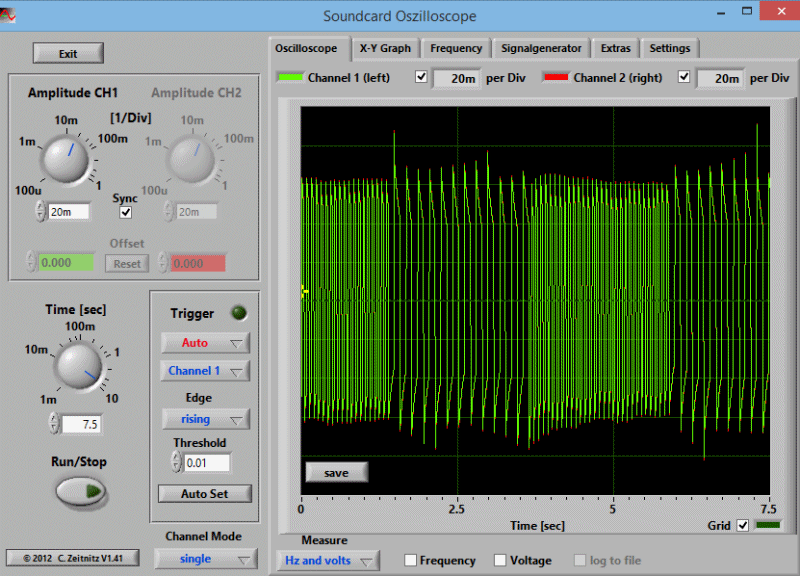

    As before, strobe is an oscillating strobe that switches between two frequencies every ~2 secs or so. Here is a blow up of each frequency:
    As you can see, the strobe switches between 5.3 Hz and 13.5 Hz. This is a little lower than the previous XT11, but still equally annoying to look at.

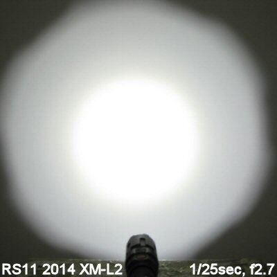

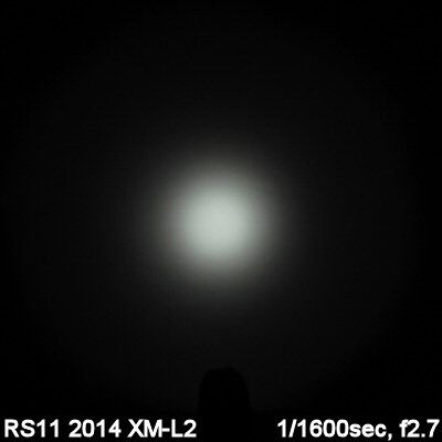

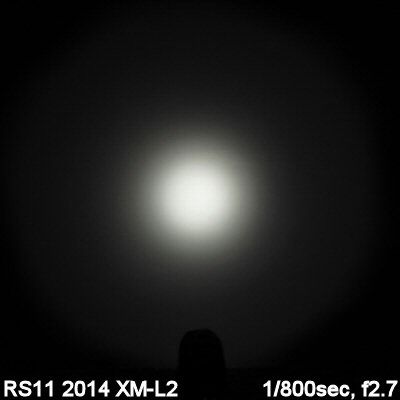

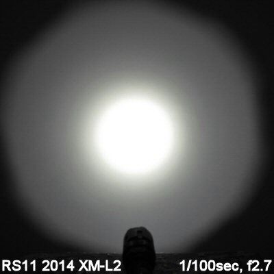

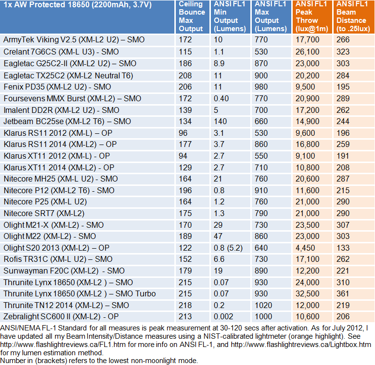

    And now the white-wall beamshots. All lights are on 1x18650 AW protected (2200mAh). Lights are about ~0.75 meter from a white wall (with the camera ~1.25 meters back from the wall). Automatic white balance on the camera, to minimize tint differences.
    For the beamshots below, "Klarus XT11" refers to the original XM-L version released in 2012.
    As before, the RS11 and XT11 2014 versions continue to have very similar beams – the difference above is simply one of max output on a single 18650. The pattern looks much the same as the earlier 2012 models – again, just differing in terms of max output on this battery source.
    Scroll down for direct output and throw measures.
    Ok, there's a lot of data up. The simplest way to describe it is that the new 2014 versions of the RTS11 and XT11 have higher output on Hi than their predecessors. This can be a bit variable by battery type, with the XT11 again showing greater variability across battery sources.

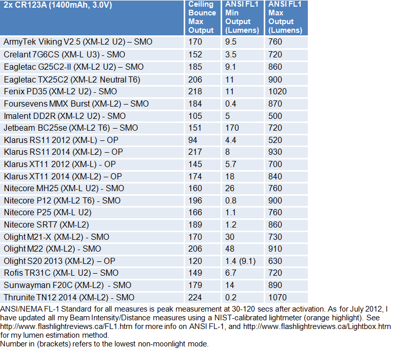

    To help you compare, here is a comparison of all output levels on each supported battery type, for the new 2014 versions of these lights:
    The XT11-2014 has a pronounced set of output changes depending on the voltage source – with again greater max output on the higher-voltage 2x battery sources. In contrast, the RS11-2014 has a fairly consistent set of outputs across the various battery types (at least on Med and Hi).
    FYI, this general pattern is similar the original the RS11 and XT11 lights (i.e., the XT11 was always more variable on different voltage sources). But the absolute output levels have changed on both models now, as you can tell from the summary tables above.
    These results help explain the reported beam distance measures for the two lights (i.e., you might reasonably wonder why two lights with the same emitter/reflector have significant differences in throw). It all comes down to the different drive levels on different battery configurations.
    According to Klarus, all their ANSI FL-1 measures were done on a 2200mAh cell in the XT11-2014 (and the included 2600mAh cell in the RS11-2014). That certainly fits well with my measured beam intensity/distance measures for these two lights on 18650. However, in absolute terms, I find my 2xCR123A lumen estimates better correlate with the official lumen output specs for both lights.
    In any case, the output and beam measures reported here are directly measured in my hands, so you can rely on the relative consistency across lights, batteries, and levels.

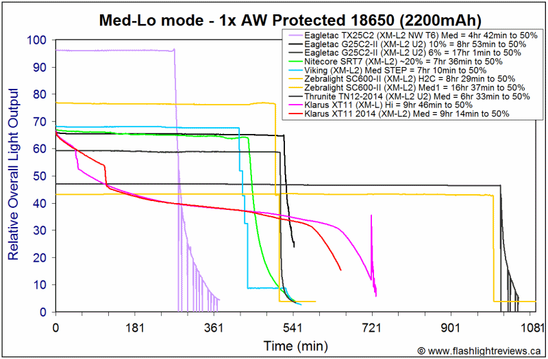

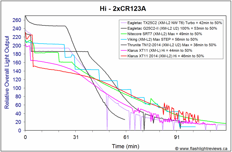

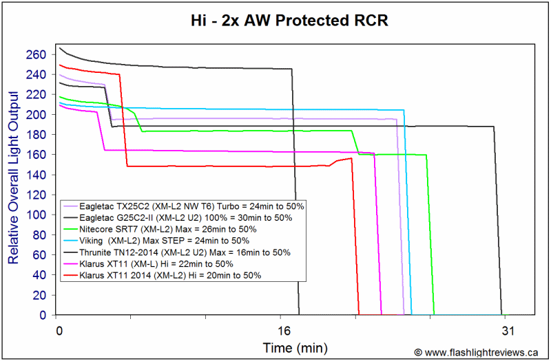

    Output/Runtime Graphs:

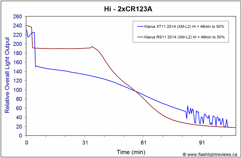

    Let's start with a comparison of the new 2104 versions of the RS11 and XT11:
    As you could tell from the earlier tables, the RS11 is more consistent than the XT11 in its output levels across batteries. As a result, the graphs above should give you useful direct comparison information on relative output and runtimes of the two models.
    Let's see how the XT11-2014 compares to others in this class, including the previous 2012 XM-L version.
    As you can see, on all battery sources, there is a clear increase in initial Hi output – although the step-down level is not very different from before (and if anything, is slightly lower). Aside from this initial output bump, overall runtimes are pretty comparable to the earlier 2012 model.
    There is certainly no difference in the Med mode output from the earlier version.
    As before, the light uses PWM on all modes (including Hi) at a detectable ~850-880 Hz. I find this perfectly fine on Med and Hi (i.e., not visually-distracting), but it may be an issue for some of the Lo mode.
    Interface in unchanged from before (e.g., the light lacks a memory mode, and always comes on in Hi).
    Light uses an electronic tail switch, and therefore requires a stand-by current when fully connected. However, this is negligible (<1uA) in my testing, and not a concern. You can always lock-out the light with a simple tailcap twist, thanks to the anodized threads.
    As before, output is higher (and runtime lower) on 2x battery sources compared to 1x18650.

    The major physical change is the addition of a lever over the secondary mode/strobe switch on the tailcap. This is an interesting design, and definitely facilitates consistent access to the switch - even when wearing gloves (which was one of the challenges of the earlier version). Otherwise, the overall build has not changed – it is still a solid light, with quality hand feel.

    Thanks for the review and the clear photos on that lever. As I thought nothing has really changed, they only added that plastic-lever on top of the mode-button. Still, the XT11 rocks

    The lux is close between old and new models but this can be misleading because if you look at the going gear video it show how much brighter the new model is and how the throw has increased , I don't know if there is that big of a difference in person but on video it's clear .
    The bad thing about the new xt11 is that runtime/output graph shows that the new xt11 has even lower output after stepdown then the old one . Both lights should have stepdown of 30% but the new version looks to be underperforming , this is probably due to the initial turbo mode being higher then old version which depletes the battery faster but if manufacturers claim 30% stepdown then it should be closer to 30% not 40% + .
    6,936
    Default Re: Klarus XT11 2014 (XM-L2 - 1x18650, 2xCR123A/RCR) Review: RUNTIMES, BEAMSHOTS, + m
    Quote Originally Posted by GehenSienachlinks View Post
    Well, it can't be that great if matched with comparable batteries. Depending on the battery source, my XT11-2014 (XM-L2) is ~20-30% brighter than my original XT11 (XM-L) - on the same battery. Given the same optics, that would mean that on average I would expect ~20-30% more peak beam intensity (or ~10-15% more beam distance) for the new light. Frankly, that would be pretty hard to notice unless you had the two lights side-by-side.
    Depending on the battery, my XT11 2014 drops by ~45-55% in estimated lumens once step down occurs (the relative output scale on the graphs is not linear to estimated lumens). You could always re-start the light at this point, of course.

    Selfbuilt, have you investigate how the dual switch works in the tailcap? From the photos it looks like the tailcap has the standard contacts of a sprung plunger and a contact ring. This gives the normal connections for power and simple on-off switching. The additional electronic click switch for modes, does not appear to have any additional contacts to communicate with the driver circuit.
    It seems to me that either the driver is in the tailcap (very unlikely) or the electronic switch sends a signal over the power connection (like these Ethernet over Power computer network extenders) to indicate a mode change.
    Any ideas?
    Tactical Reviews by Subwoofer
    6,936
    I haven't explored how the switch functions, but here's a pic of the internals:
    Not shown is the secondary switch electronic contact on the base (but it looks as you might imagine). Not sure if I could safely disassemble the plastic to investigate further without damaging the switch, so I don't plan to attempt. Based on my testing results, a secondary circuit inside the tailswitch assembly is a possibility (i.e., PWM on all levels including Hi is common on dual-circuit setups).

    The dual switch tailcap design. Sense tension between Klarus and Nitecore... heheheh
    Live to learn.
    I have both the 600 and 820 version, although the 820 ("first" upgrade) doesn't have the hard switch. I use max 90% of the time and would prefer easier access to that versus ease of strobe and changing modes. Anyone find the height of the hard switch in relation to the main switch to cause accidental mode changes or strobe hit instead if max from off?
    The original switch I have works perfect and I never confuse the two or have accidental mode changes. I would like to have a spare in case the stock one breaks or stops working so I don't have to wait weeks for replacements. I don't plan on using the light wearing heavy gloves if that helps with suggestions. Is the hard switch easily removable if I find it cumbersome? Thanks.

    I need a tac light with good spill and a simple UI that can tailstand for EMS work. This fits the bill except for it not tail standing so well.Can you elaborate on its tail standing ability? Is there a way to make it tailstand better?
    6,936
    Quote Originally Posted by Xak View Post
    Not that I can see - the switch assembly doesn't really seem modifiable on this light. Unless someone has some other experience?
    Hey guys
    I'm kinda new to this flashlight thing and this might be a stupid question but I'd like to make sure anyways. Does the Runtime/Output Graph say that after a couple of minutes with the 18650 battery the lumens drop from 710 to about 425? Also will it stay on 425 or go back up after restarting the flashlight?
    What if I used an IMR 18650.. Would there be less of a drop despite the shorter batterylife?
    Thanks in advance!
    Aug 2011
    Ocean State
    3,600
    Welcome to the Forum!
    Most lights usually "step down" from the initial high lumens output (710). In looking at the chart, it does appear that the output steps down to a more useable light output (425) based on the battery used. I think that if the light is turned off, and then turned back on again, and the voltage isn't to low, that it would turn on in the high mode again and go through the step down process all over again.
    Selfbuilt would provide much better information than I. As you can see by his awesome reviews, he knows his stuff when it comes to lights!
    6,936
    Yes, that is right. The light steps down after a few mins. But you can easily restore max output by turning off and on.
    Or at least, as high a level as the batteries allow. Certainly as they drain, max output will drop somewhat.

    "Potential Issues
    As before, output is higher (and runtime lower) on 2x battery sources compared to 1x18650."
    Thank you for the review. I got the all-black version, and has a detectable PWM on Lo mode. Although it is intermittent, and goes away after a while. This is probably the only downside on otherwise an almost perfect tactical-type EDC. It has replaced my E2D Led as my primary EDC, and that is saying a lot.
    And for Selfbuilt's measurement running on 18650 - my obeservation is around the same, the Lo mode is definitely weaker than 5 lumens, and I actually think it is a plus for me, preferring the 1 or sub-lumen mode for Lo.
    And one more thing, the beam is very nice, a well balanced throw and flood, cool tint. A happy camper here, solid light!

    after a few weeks, the pwm at low mode is present, and is a bit annoying, like a candle haha. otherwise almost my primary edc choice...
    Cheap secondary mode switch. Not recommended for any professional use.
    Notice that my switch is different than the one in Selfbuilt's photos.
