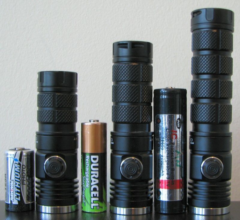

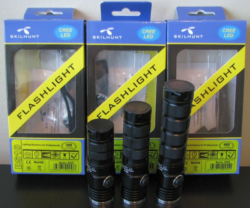

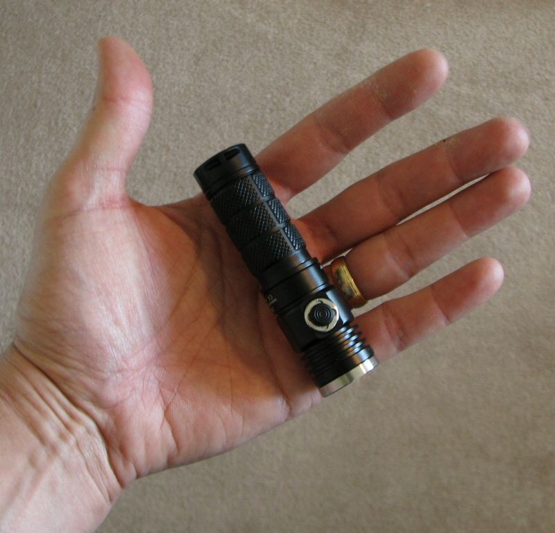

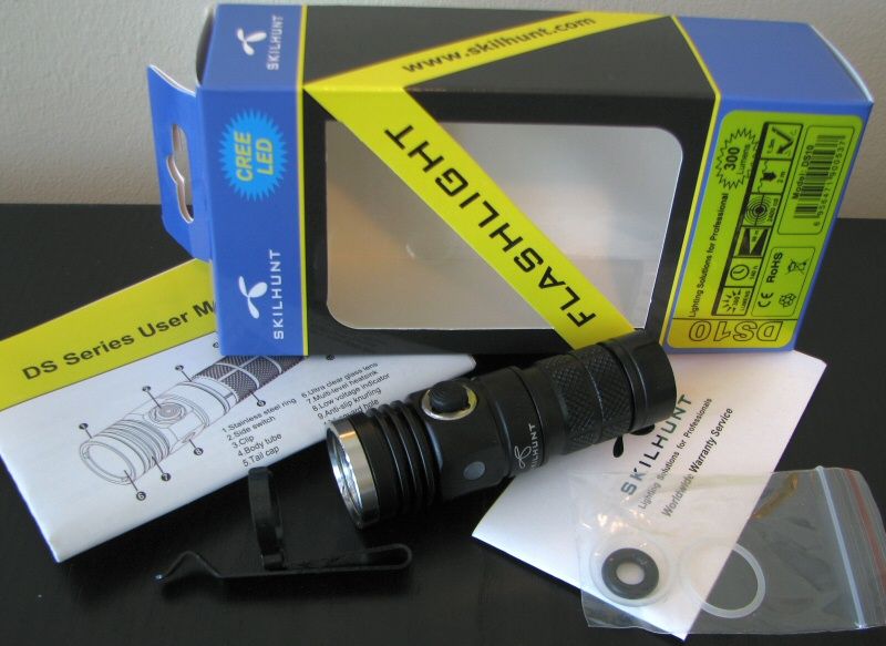

    The packaging is the same for each model. Inside the standard display packaging is the light, extra o-rings, replacement gasket for the removable tailcap magnet, reversible pocket clip, warranty card and manual. Note the manual is common for the whole series, and provides specs for each of the three models.
    From left to right: CR123A; Skilhunt DS10; Duracell NiMH AA; Skilhunt DS15; AW Protected 18650; Skilhunt DS20.

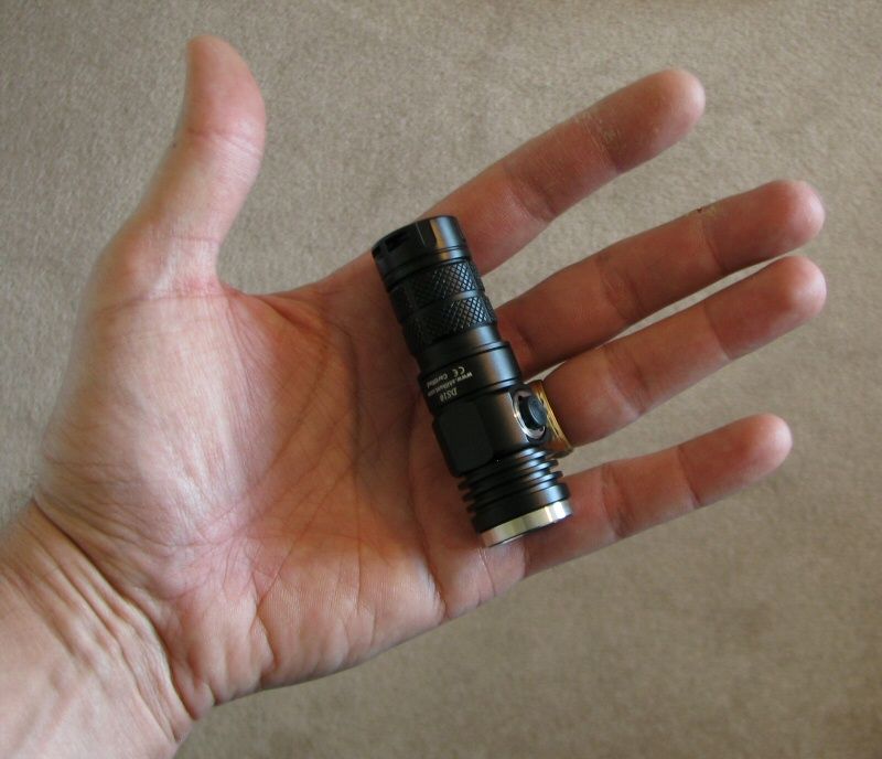

    As you can see above, the DS-series lights are quite compact. For detailed comparisons within their respective battery classes (and full measures and testing), scroll down this review. For right now, I will go over the common build and interface.

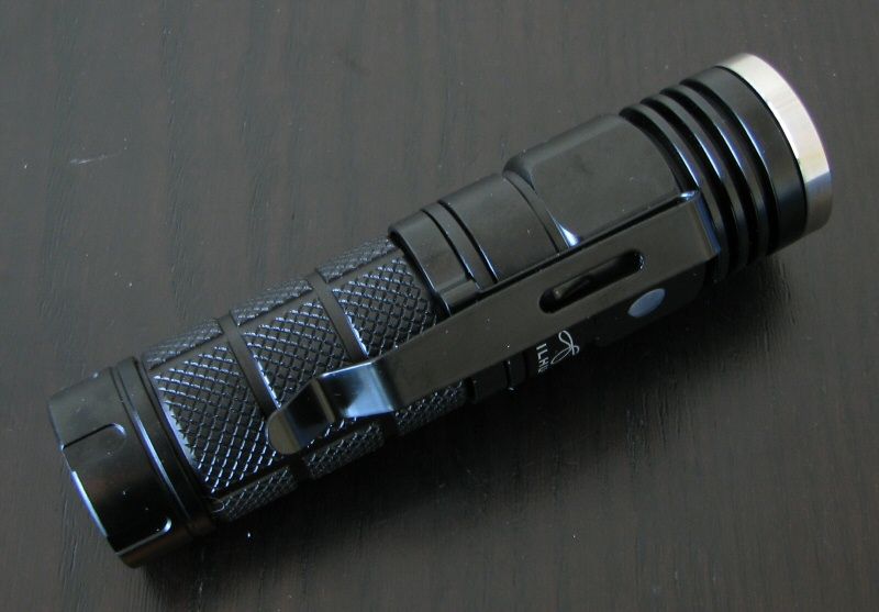

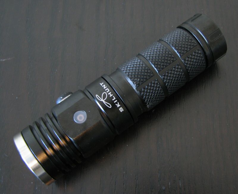

    Common Build
    For the pics below, I've used all the models interchangeably, as representative examples. You'll note that I installed the pocket clip on the DS15.

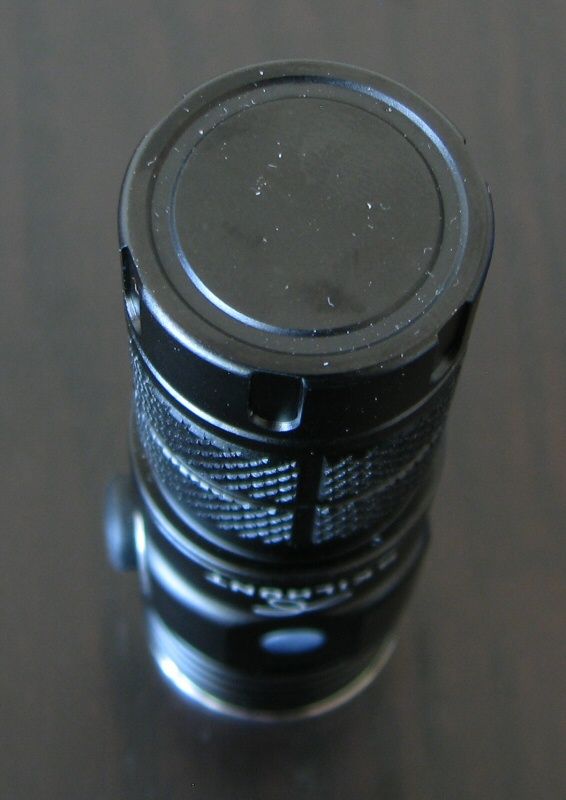

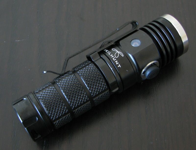

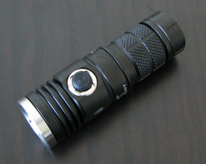

    Physically, the DS-series lights are remarkably similar to the Olight Baton lights (i.e., S10, S15 and S20) - right down to the inclusion of a removable magnet in the tailcap.
    One interesting difference given the compact size of the lights – all DS-series models open at both the head and the tail. Despite this, the lights are all quite petite for their respective classes. Lights come with black anodizing (gloss finish) and bright white labels. There is knurling over the body tubes, but of fairly mild aggressiveness. With the raised checkered pattern and protruding switch covers, I would say overall grip is pretty good.
    The removable clip helps further with grip. It holds onto the light fairly securely – I actually scratched the anodizing trying to get it off my DS15 sample above. Note that the clip allows for both bezel up and bezel down carry.
    There is a low voltage warning indicator on the head. This flashes red when the cells are nearly exhausted.

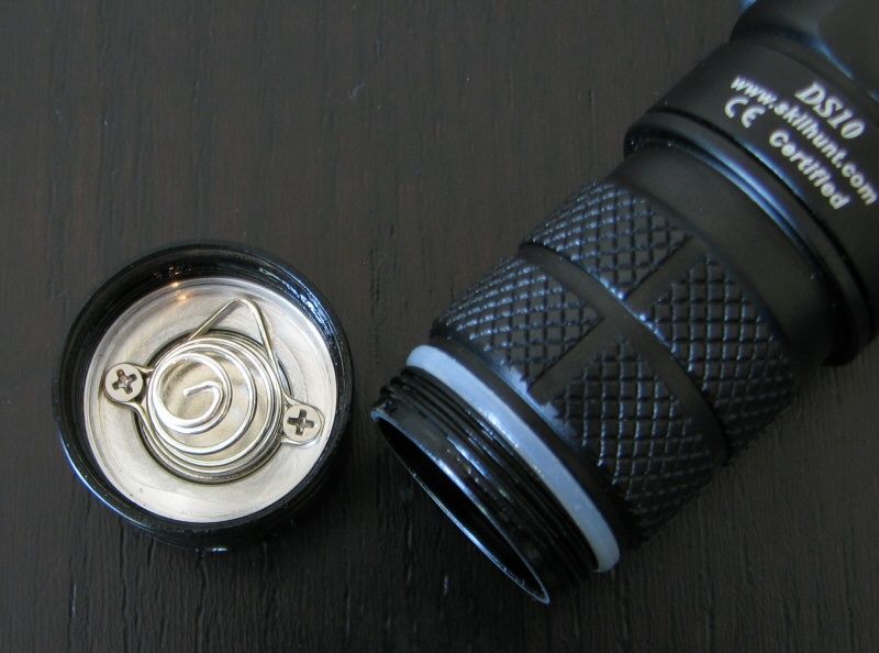

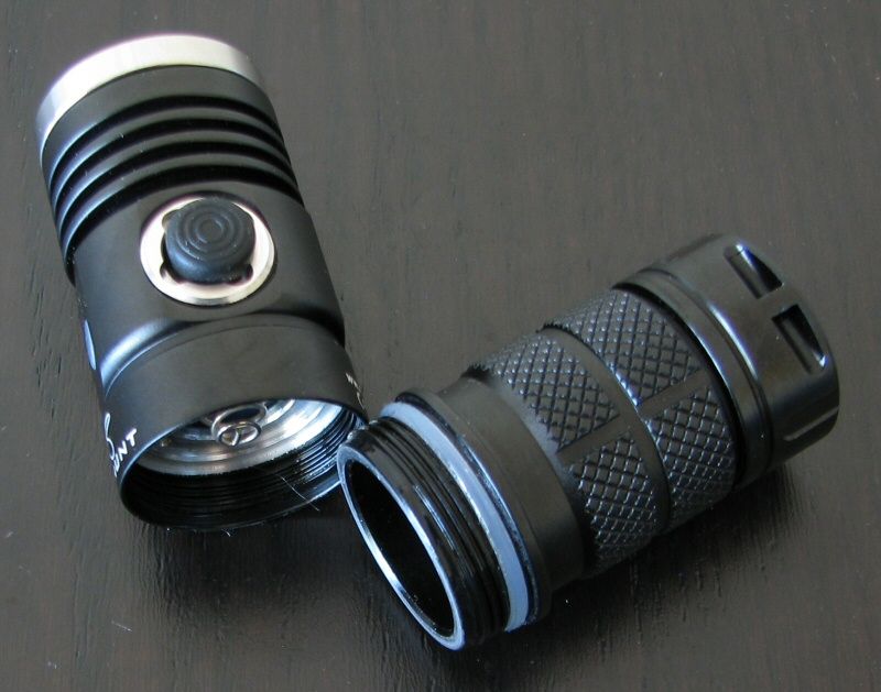

    The DS10 and DS20 models came with a spring in the head, so flat-top cells will work fine. The DS15 does not, but this is hardly surprising, as all AA class cells have button tops. Note that even 14505 primary lithium cells work find in this light.
    Screw threads are anodized at both the tail and head regions for lock-out. Note that there are not a lot of threads at either location, but enough to do the job.
    Lights can tailstand, and there is a split-ring/lanyard attachment hole on the side of the tail cap. More interesting, the tailcap incorporates a removable magnet that is strong enough for the lights to stand horizontally off any vertical metal surface. Similar to the Olight Baton lights, the main difference here is that the tailcap springs are screwed in place over the magnet (i.e., they were spring loaded on the Baton lights). Swapping out the magnet and replacing the supplied rubber gasket is thus very simple, as long as you have a small Phillips head screwdriver handy.
    Again like the Baton lights, the DS-series light use an electronic switch located near the head. The button cover is quite raised, making it easy to find by touch (and serves as an effective anti-roll device). User interface is similar to other Skilhunt lights (see below).

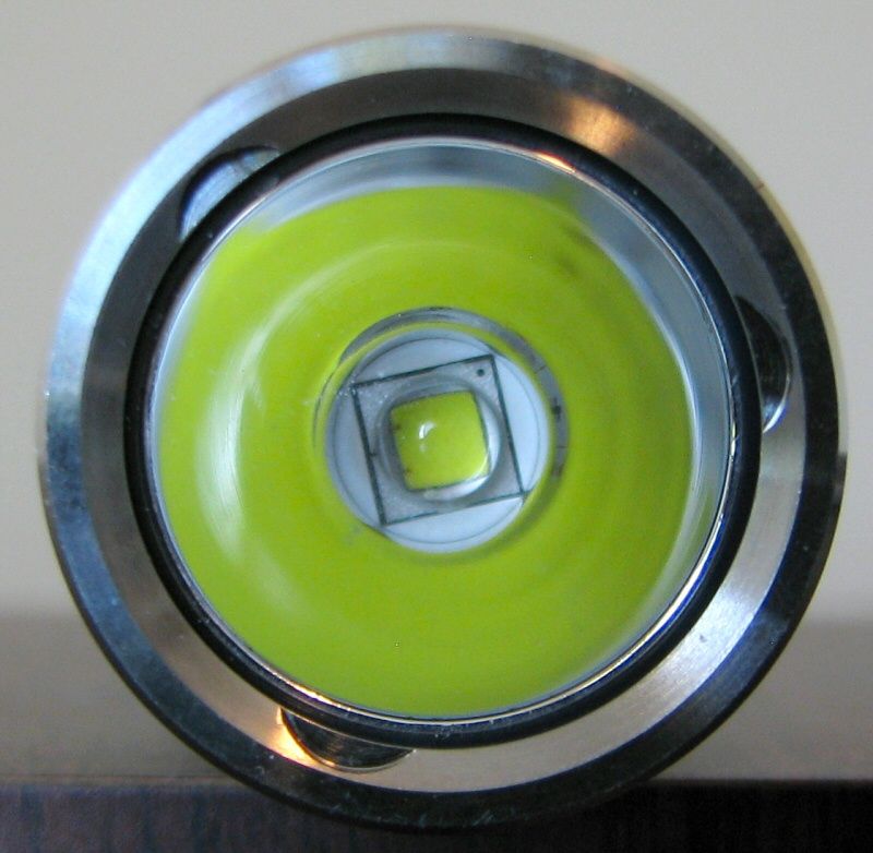

    The DS-series lights all have a flat stainless steel bezel. Reflectors are fairly smooth, and smooth finish. Centering of the emitters was excellent on all three of my samples.

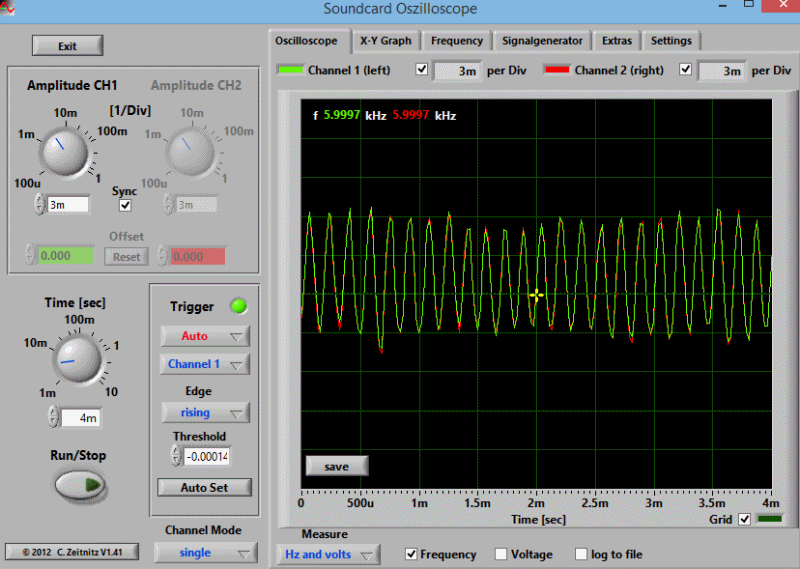

    PWM/Strobe
    The DS-series lights are all current-controlled – there no indication of pulse width modulation on any mode.
    For more information on strobe, please see the individual overviews below, for each sample.

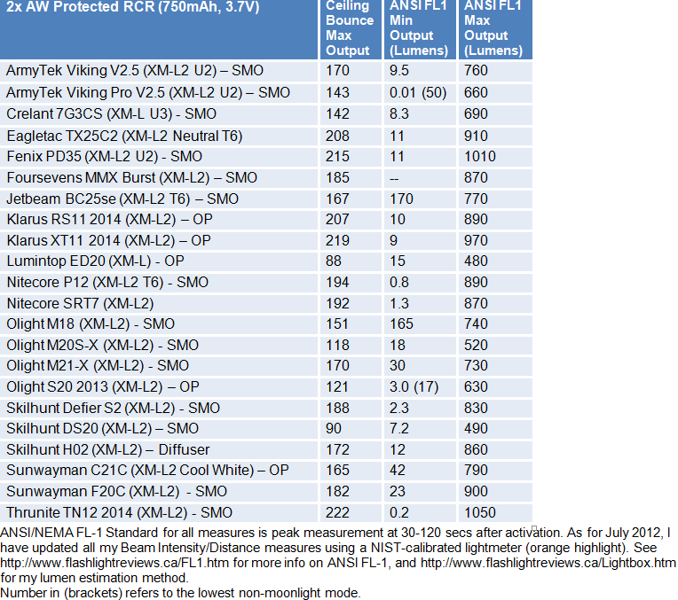

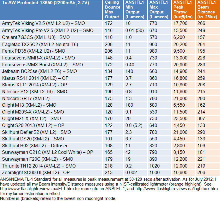

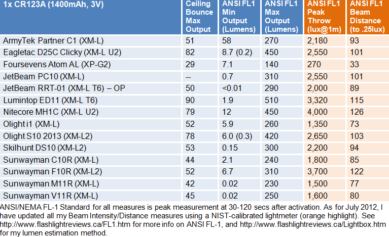

    Throw/Output Summary Charts:

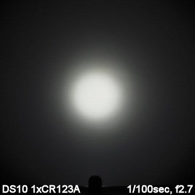

    Individual Comparisons

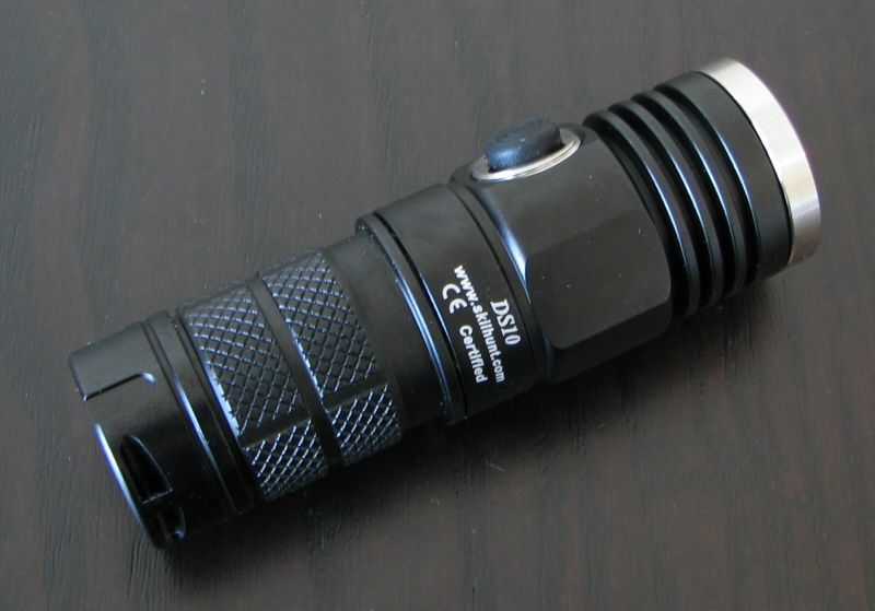

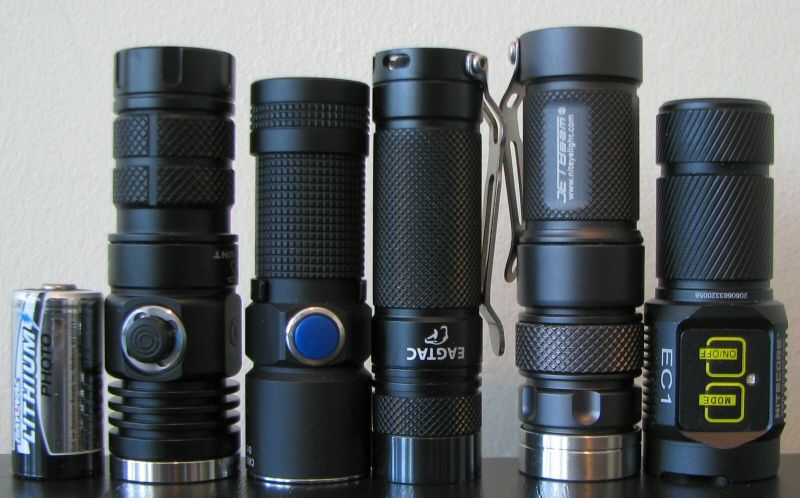

    DS10

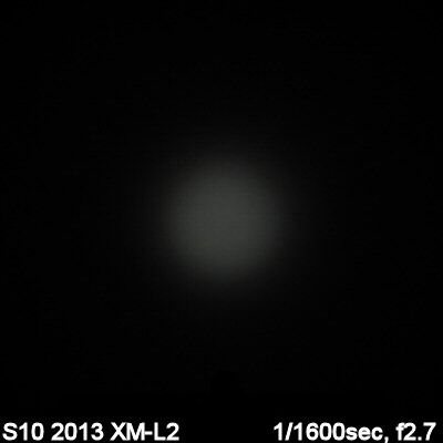

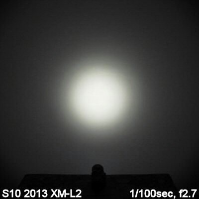

    From left to right: CR123A; Skilhunt DS10; Olight S10 (201); Eagletac D25C; Jetbeam RRT-01; Nitecore EC1.
    Skilhunt DS10: Weight: 47.0g, Length: 76.1mm, Width (bezel): 24.0mm
    Olight S10 (2013, XM-L2): Weight: 40.5g, Length: 70.8mm, Width (bezel): 23.1mm
    ArmyTek C1 XM-L: Weight: 43.0g, Length: 80.2mm , With (bezel): 23.1mm
    Lumintop ED11: Weight: 44.1g, Length: 83.7, Width (bezel): 21.8mm
    Foursevens QTLC: Weight 36.4g, Length 84.1mm, Width (bezel) 22.1mm
    Sunwayman C10R: Weight: 57.3g, Length: 76.2mm (no lanyard plug), 82.3mm (with plug), Width (bezel): 25.6mm, Width (head at widest part): 28.6mm
    Eagletac D25C Clicky: Weight: 30g, Length: 76.0mm, Width (bezel): 20.0mm
    Jetbeam PC10: Weight: 50.5g, Length: 93.6mm, Width (bezel): 22.6mm

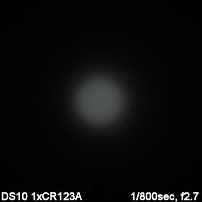

    DS10 Strobe:
    Although the DS10 has a fairly typical strobe frequency of 9.7 Hz, the on-pulse of each cycle is longer than typical (i.e., normally a 50:50 on/off cycle). It is doesn't make much of a difference visually, though.

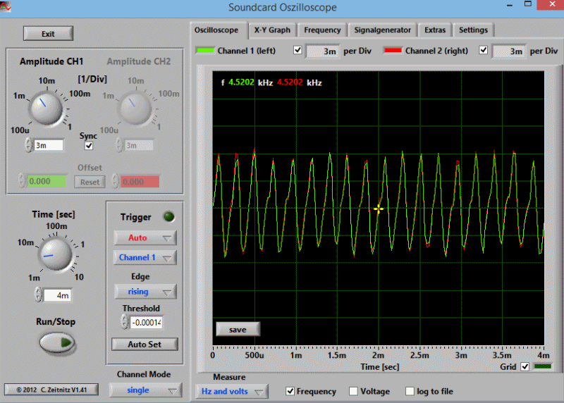

    DS10 Med Noise RCR:

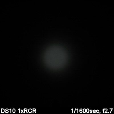

    As with many current controlled lights, there is circuit noise detectable on some modes on some DS-series lights. In the case of the DS10, there is high frequency 4.5 kHz noise only on the Med mode (for both RCR and CR123A). Rest assured it is not visible – the light is flicker-free in all modes.
    Standby current (after the brief pre-flash) was ~25uA on a CR123A. I couldn't get a stable reading on RCR, which fluctuated from ~10~50uA (but average out around ~25uA as well. That would translate into over ~4 years for RCR, and over ~6.5 years on CR123A, using standard capacity estimates. Either way, again not a concern.

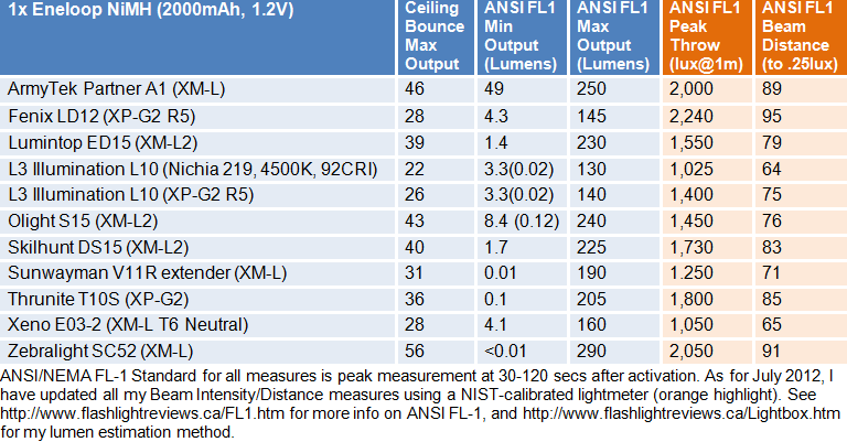

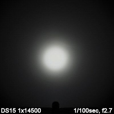

    DS15
    From left to right: Duracell NiMH AA; Sklihunt DS15; L3 Illumination L10; Zebralight SC52; Nitecore EA1; Fenix LD12.
    Skilhunt DS15: Weight: 52.0g, Length: 92.1mm, Width (bezel): 24.0mm
    Olight S15 1xAA: Weight: 46.4g, Length: 87.0mm, Width (bezel): 23.1mm
    Nitecore MT1A: Weight: 54.6g, Length: 104.6mm, Width (bezel): 22.7mm
    Nitecore SENS AA: Weight: 26.1g, Length: 82.7mm, Width (bezel): 19.8mm
    Lumintop ED15: Weight: 59.7g, Length: 100.2, Width (bezel): 21.9mm
    Zebralight SC52: Weight 39.5g, Length 79.0mm, Width (bezel): 22.6mm, Width (max) 25.4mm
    Rofis ER12: Wright: 35.5g, Length: 96.2mm, Width (bezel): 18.6mm
    Xeno E03:: Weight: 48.1g, Length 96.7mm, Width (bezel): 21.5mm

    DS15 Med Noise NiMH/14500:
    As with many current controlled lights, there is circuit noise detectable on some modes on some DS-series lights. In the case of the DS15, there was a consistent high frequency 6 kHz noise on the Med mode (for both 14500 and NiMH AA). There was also a variable frequency noise on the Turbo level, but only on 14500. Rest assured these are not visible – the light is flicker-free in use for all modes.
    Standby current (after the brief pre-flash) on NiMH AA was 20uA, with periodic jumps up to 49uA (roughly every 10 secs). For 14500 Li-ion, I got a stable 5uA. That would translate into about 10-15 years to drain typical standard capacity NiMH or 14500. Certainly not a concern.
    1xAA Sanyo Eneloop NiMH
    1x14500 (AW Protected 14500) Li-ion

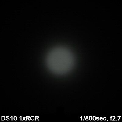

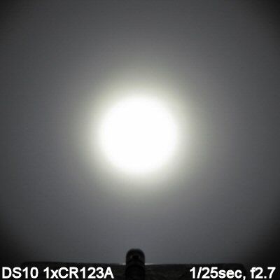

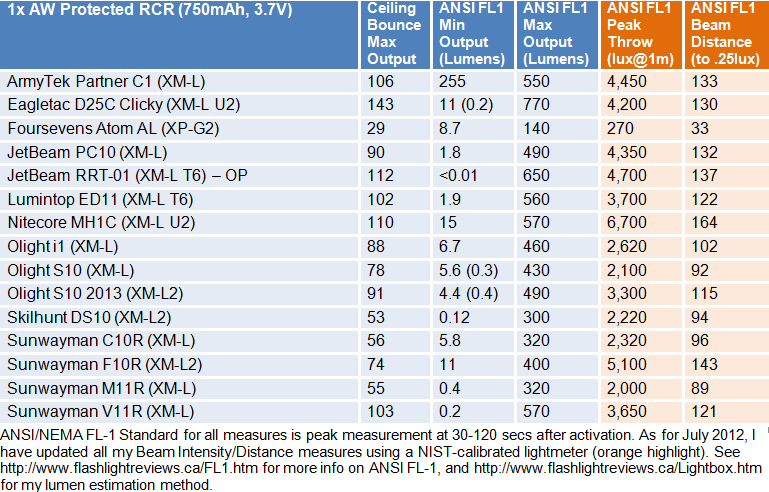

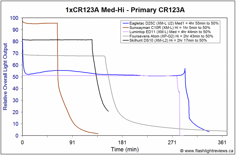

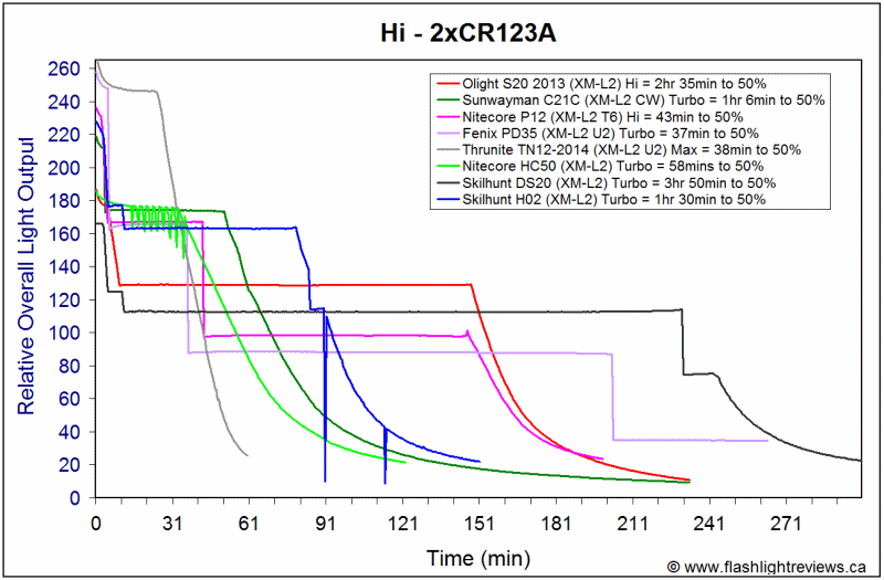

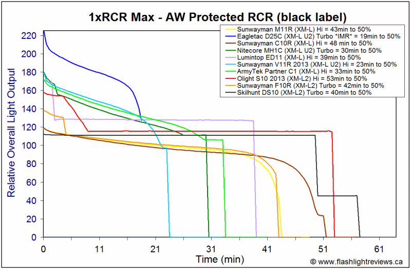

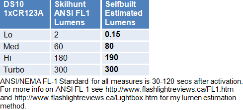

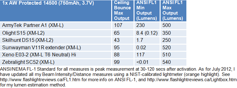

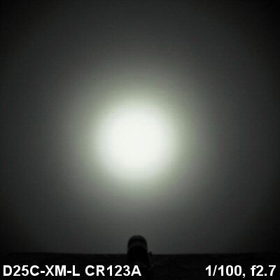

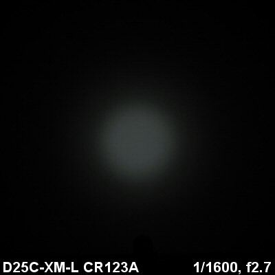

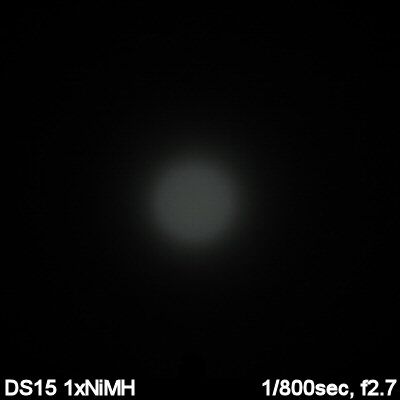

    Overall output is generally very consistent with the Skilhunt specs – on all models, on all batteries. The main exception was the Lo mode on the DS10, which was more like moonlight on my sample (on both CR123A and RCR).
    Max initial output is reasonable for each model above, although lower than most other recent lights in these classes. Note as well that the DS20 (but not the DS10 or DS15) steps down on Turbo after a few mins.

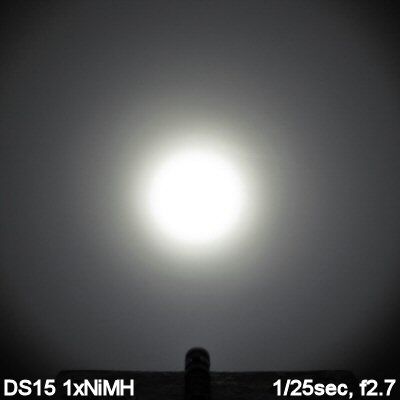

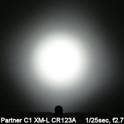

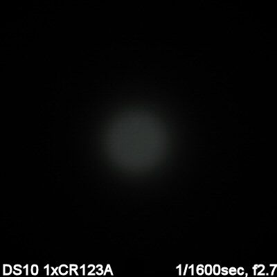

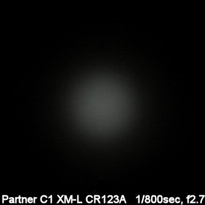

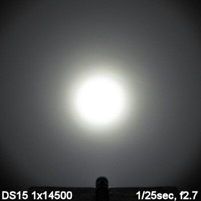

    The overall beam pattern is as expected for lights of this size. Thanks to the smooth reflectors, they have a slightly more defined hotspot than the equivalent Olight Baton lights.
    The DS-series lights are current-controlled on all levels, with no signs of flicker.

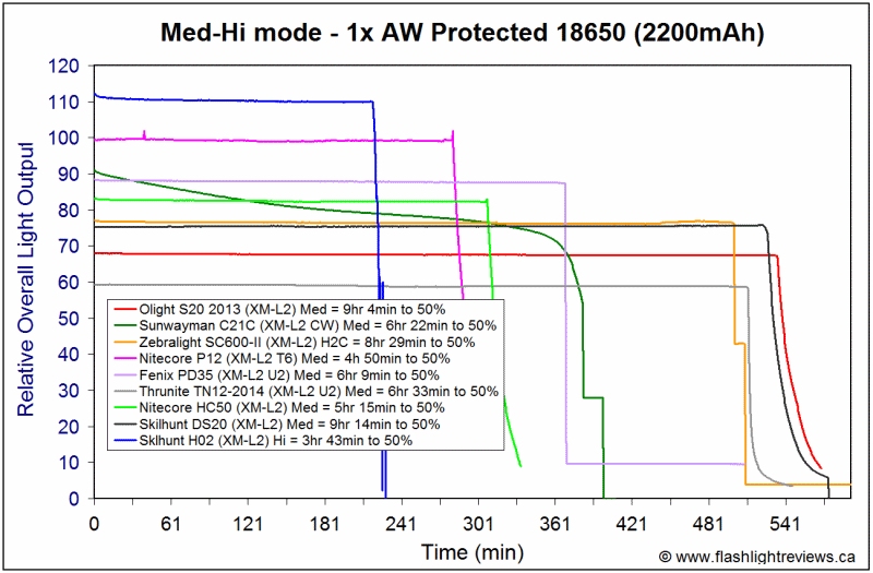

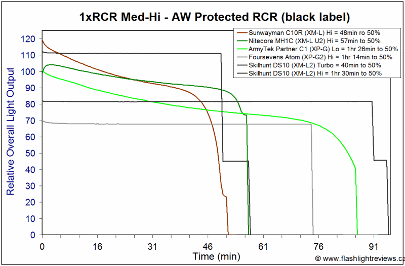

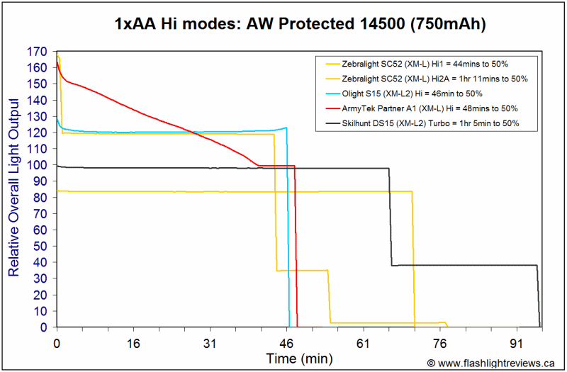

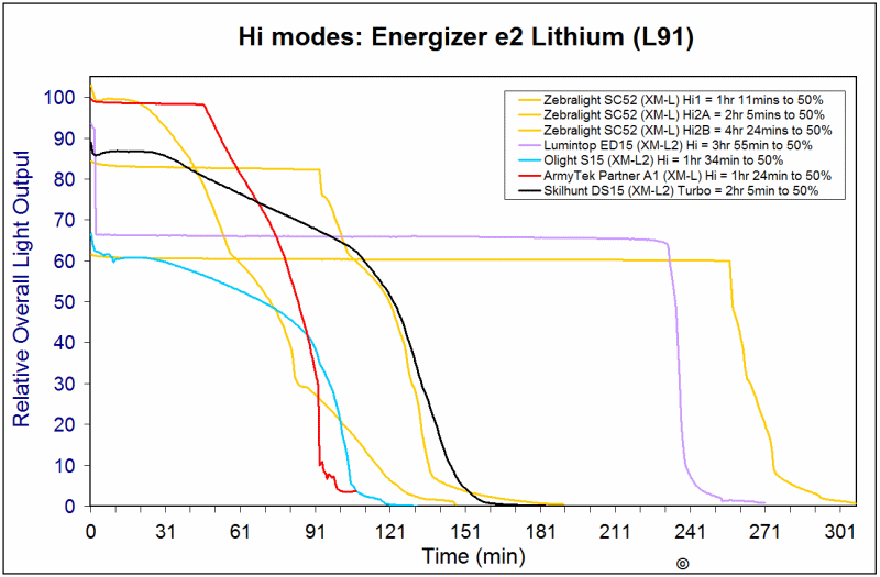

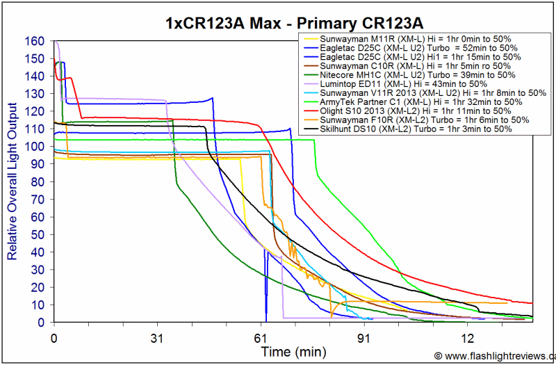

    Regulation and Runtime

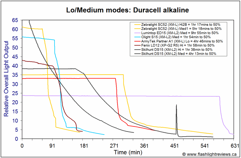

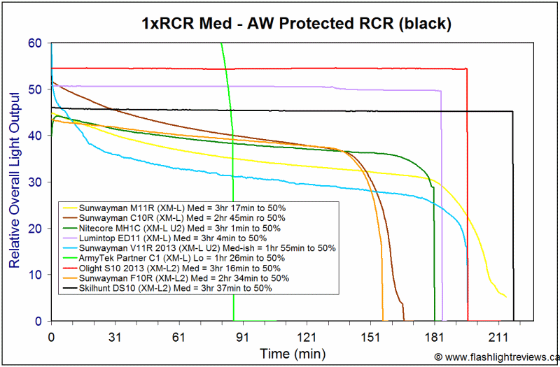

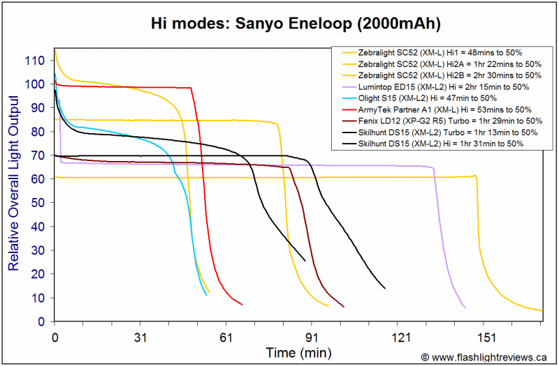

    The DS-series lights are all fully flat-regulated on all battery types, across all models. The DS20 (but not the DS10 or DS15) shows step-down on Turbo after a few mins runtime, on all batteries.
    Overall output/runtime efficiency was very good to excellent on all models and all battery types. This is consistent with good quality current-controlled circuits.

    I'm wondering if the DS15 can fit 18500 cell since the DS15 (AA) is the same width as the DS20 (18650)?
    No, the lights are only the same size at the head. At the tails/body, the DS10 and DS15 are 22.0mm, while the DS20 is 24.0mm.

    I have the first generation Baton S10 and absolutely love it. However, my protected 16340s are nearly 2mm too long and I don't want any unprotected, nor do I want to use primaries. I fudged an insert for the tailcap to make contact but the O-ring is no longer covered so no waterproofing.
    Just wondering if you have any idea of the maximum length of cell the DS10 wil accommodate?
    Thank you sir, I missed that part.

    Just wondering if you have any idea of the maximum length of cell the DS10 wil accommodate)
    Hmmm, haven't tried too many cells, but my AW protected RCR were fine (but then again, the same was true for my S10s).
