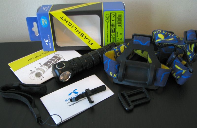

    The packaging is identical to the DS20, except for the inclusion of the good quality headband. Inside the standard display packaging is the light, extra o-rings, replacement gasket for the removable tailcap magnet, reversible pocket clip, warranty card and manual.

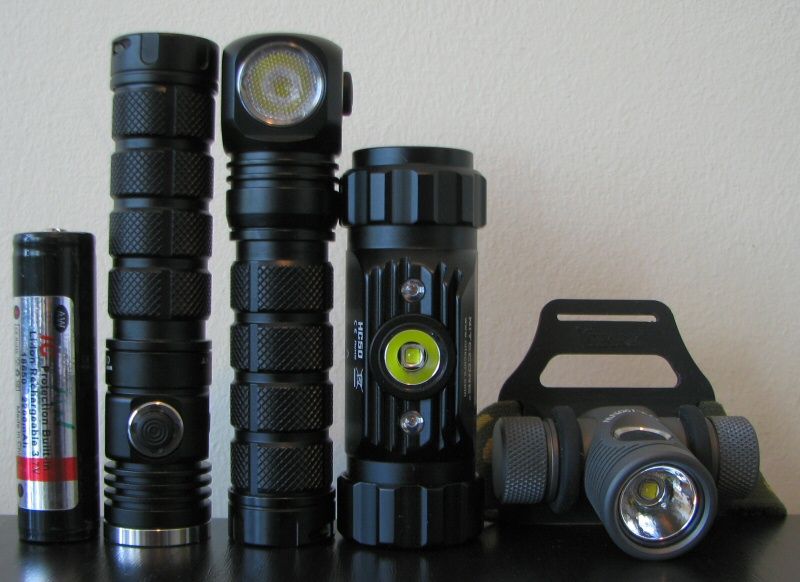

    From left to right: AW Protected 18650 2200mAh; Skilhunt DS20, H02; Nitecore HC50; Spark ST-5.
    Skilhunt H02: Weight: 61.3g, Length: 110.8mm, Width (widest): 28.0mm
    Nitecore HC50: Weight 85.4g, Length: 86.0mm, Width (widest) 36.4mm
    Other 1x18650 flashlights:
    Eagletac D25LC2: Weight: 50.0g, Length: 116.3mm, Width (bezel): 22.5mm
    Foursevens Quark Q123-2 X (Regular tailcap): Weight: 44.6g, Length: 112.7mm, Width (bezel) 22.0mm
    Jetbeam PC20: Weight: 60.0g, Length: 127.5mm, Width (bezel): 22.6mm
    Olight S20 (2013, XM-L2): Weight: 52.4g, Length: 106.5mm, Width (bezel): 23.1mm
    Skilhunt DS20: Weight: 53.8g, Length: 110.0mm, Width (bezel): 24.0mm
    Sunwayman C20C: Weight 57.6g, Length: 104.8mm. Width (bezel): 25.6mm
    Thrunite TN10: Weight: 154.7g, Length: 145.5mm, Width (bezel): 35.1mm
    Zebralight SC600: Weight 87.2g, Length: 107.8mm, Width (bezel) 29.7mm
    Headlamps:
    Olight H15S Wave: (1xLi-ion, 4xAAA): Head alone: 42.2g, Battery compartment alone: 31.0g, Battery compartment alone with OPS-H15S Li-ion battery: 58.3g, Battery compartment alone with 4xAAA: 77.3g, complete unit (with basic headband and Li-ion battery): 118.1g
    Petzl Tikka XP2 (3xAAA): 52.3g, 88.4g with batteries
    Spark ST5 (1xAA): Weight, 41.5g, Length 58.4mm, Width 42.8mm (max body), Width 24.0mm (bezel)
    Zebralight H31w (1xCR123A): Weight: 28.6g, Length 66.9mm, Width (bezel) 22.1mm.

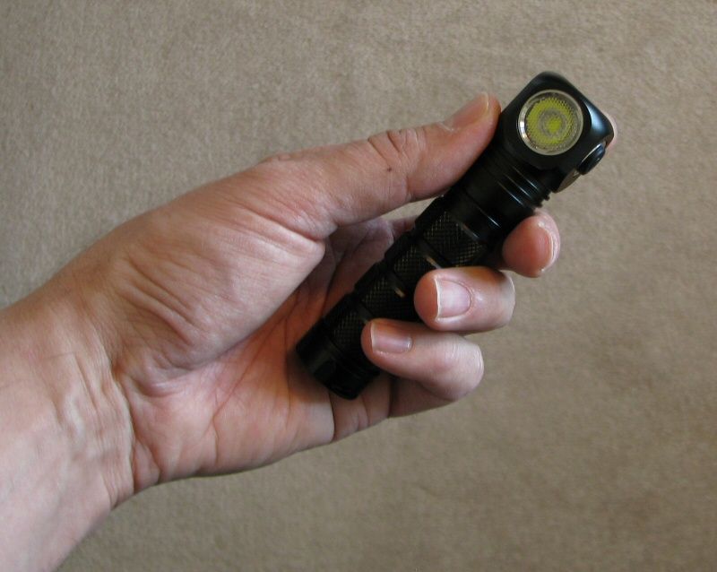

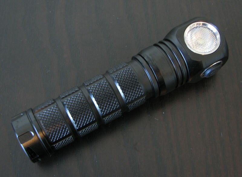

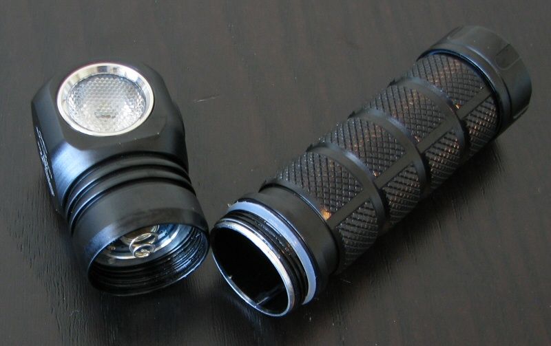

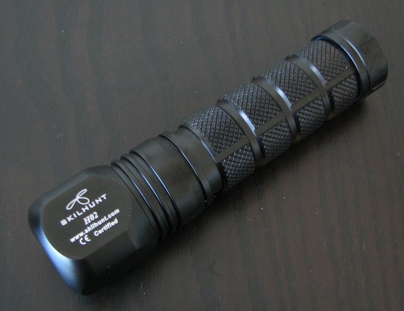

    Physically, the H02 is very similar to the DS20 – except for the enlarged head with side-mounted emitter (under a diffuser). The same accessories for the DS20 fit here (e.g., reversible pocket clip), and the H02 has the same removable magnet in the tailcap.
    Despite opening at both the head and the tail, the H02 is reasonably compact for a 1x18650 class headlight. The light comes with black anodizing (gloss finish) and bright white labels. There is knurling over the body tube, but of fairly mild aggressiveness. Note the H02 shares the same body tube and tailcap with the DS20. With the raised checkered pattern and protruding switch cover, I would say overall grip is pretty good.

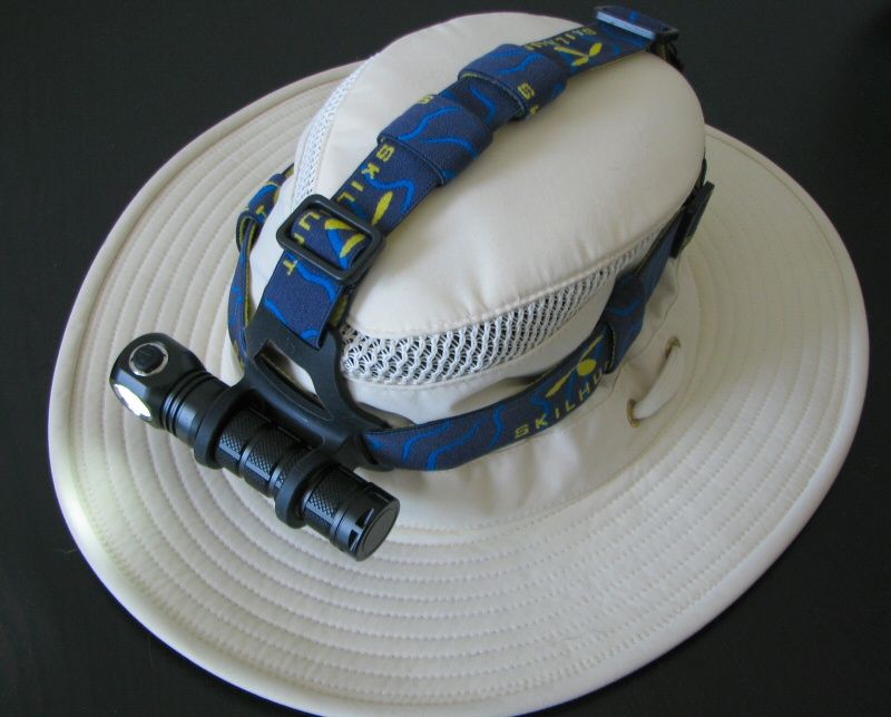

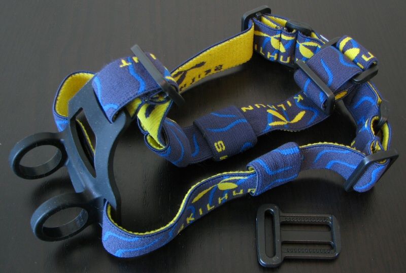

    The headband is good quality, with lots of adjustment points. It comes with top strap as well as the side strap. The rubber attachment holds the light fairly firmly, so I wouldn't expect much accidental movement in use.
    The removable clip is a nice feature, if you wanted to carry the light on you (i.e., angle-head style). It holds onto the light fairly securely.

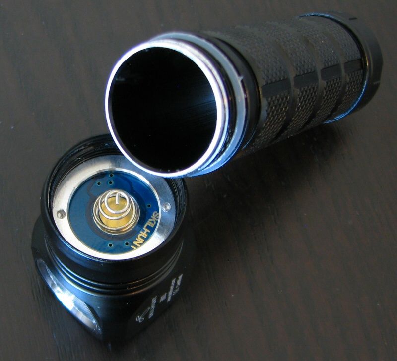

    Thanks to spring in the head, flat-top cells will work fine. Screw threads are anodized at both the tail and head regions for lock-out. Note that there are not a lot of threads at either location, but enough to do the job.
    Lights can tailstand as well as headstand, and there is a split-ring/lanyard attachment hole on the side of the tailcap. More interesting, the tailcap incorporates a removable magnet that is strong enough for the light to stand horizontally off any vertical metal surface. Similar to the Olight Baton lights, the main difference here is that the tailcap springs are screwed in place over the magnet (i.e., they were spring loaded on the Baton lights). Swapping out the magnet and replacing the supplied rubber gasket is thus very simple, as long as you have a small Phillips head screwdriver handy.

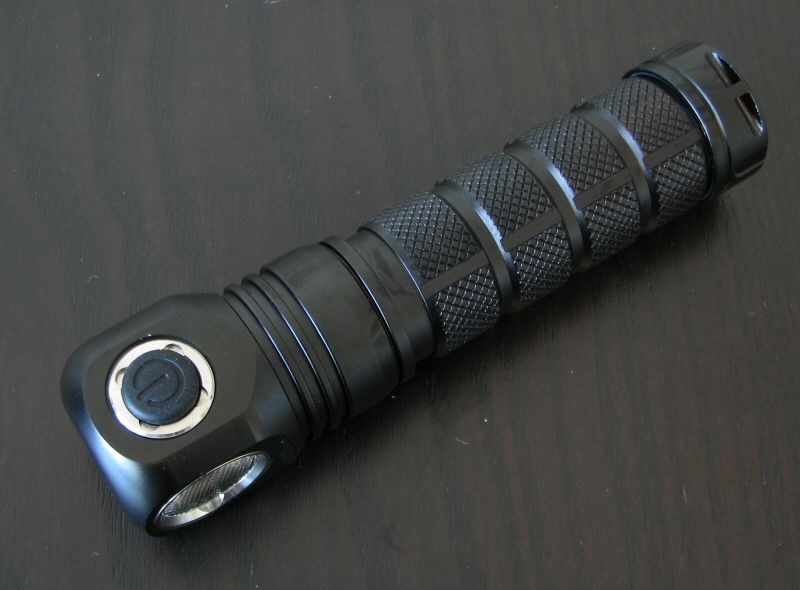

    The H02 shares the same interface and control mechanism as the DS20. There is an electronic switch on the head. The button cover is quite raised, making it easy to find by touch. See below for a discussion of the UI.
    The H02 has a built-in diffuser cover, with a flat stainless steel bezel. This should provide wide-spread dispersed light, as opposed to a focused beam. Scroll down for specific beamshot comparisons.
    Turn the light on a single click of the eelectronic switch (i.e., rapid press release). Turn the lighs off by a sustained press-hold of the switch for ~1 sec.
    There are four main output levels controlled by a click (rapid press release) of the electronic switch. Mode sequence is Lo > Med > Hi > Turbo, in a repeating loop. The light has mode memory, and retains the last level set when you turn it off/on.
    Double-click the switch to jump to Strobe. You can exit at any time by a single touch of the switch. As such, there is no mode memory for strobe – you exit as soon as you press the switch.
    Note that this interface is different from most lights, in that you need a sustained press to turn off, and a simple click to change modes. On most lights, it is the other way around.

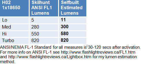

    Finally, let's take a look at estimate lumens across all levels on the H02:
    As with most of the DS-series lights, overall output is very consistent with the Skilhunt specs. However, I would have prefer an additional Lo mode between ~11 and ~300 lumens.
