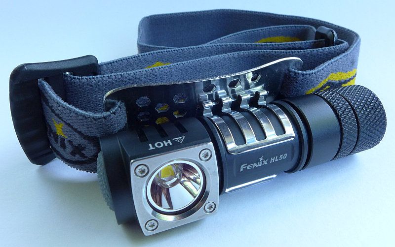

    Fenix headlamps have been growing in number, and though not their first single AA powered headlamp, this is the first to use CR123. Oh, and not to forget their first 'dual-fuel' headlamp, with both AA and CR123 power options.

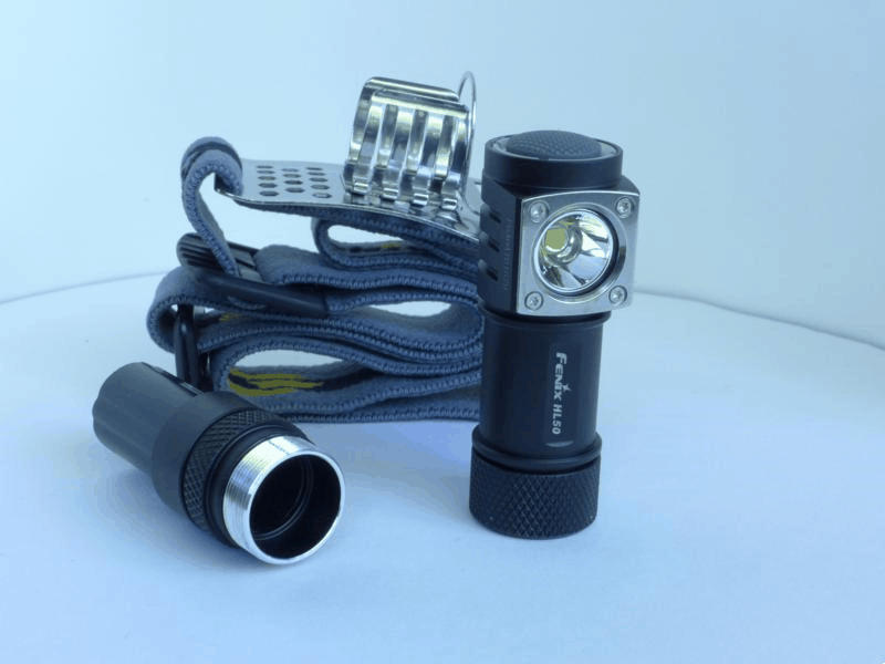

    Much like the HL10 (previously reviewed here), the HL50 is effectively a compact right-angle flashlight with a headband mount, so can be used as a headlamp or as a small hand-held light.
    Here it is shown with the AA extender fitted and attached to the headband mount.

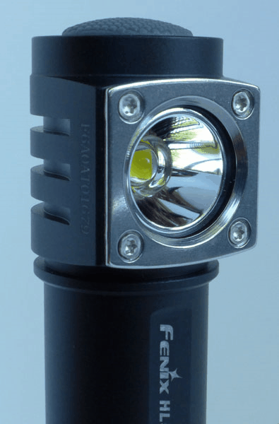

    The reflector with XM-L2 Neutral White LED

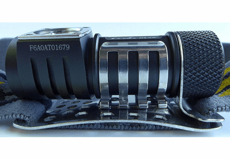

    Now for a closer look at some details of the mount. A nicely finished all stainless steel mount, which holds the HL50 very securely. All edges are rounded and nothing sharp to catch the elastic or light on.
    As standard, the HL50 light is held both by the main mount, and what I can only think is a 'safety retainer ring'. The first photo shows how the HL50 is still attached to the headband even when removed from the mount. I'm afraid the first thing I did was to remove this retaining ring as it made removal and refitting of the HL50 difficult.
    Due to the mount design, only the headband contacts your head, so is very comfortable to wear for long periods.
    The clamp of the mount is joined to the back plate with a 'clinch'. This is a method of joining sheet metal by pushing part of one sheet through the other and creating a form of rivet called a clinch. The clinch itself is well formed and very secure, and when seen from the back has not created any sharp edges to catch on the headband itself.

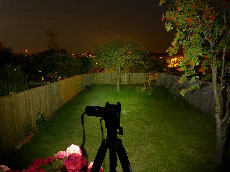

    The beam is neutral white (The camera's white balance is set to daylight here in an attempt to represent the tint), and a very pleasant colour to work with.
    There is a more defined hotspot than I would have liked for a single AA headlamp (considering it is for closer range use due to limited power). Though the hotspot is not too strong, it did make me aware of head movements which headlamps like the HL10 or HL30 do not.
    Outdoors the beam does run out of steam somewhat, with the exposure here adjusted to help show the beam shape.

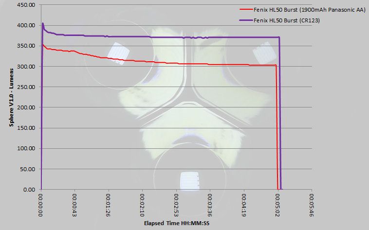

    Press and hold the switch for 2s to enter Burst mode. As soon as you release the switch it will return to the previous state (OFF or other output mode).

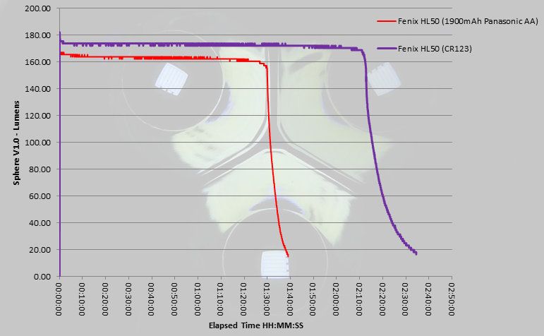

    This following runtime traces show three different scenarios. First is the ANSI cut-off runtime where the trace ends once the output drops to 10% of the initial ANSI output. Next these traces are continued beyond the ANSI cut-off to show the behaviour on low power. And finally there is a five minute trace of the burst mode, which I carried out to see how well the output is maintained.
    ANSI output - High
    Extended output - High
    Burst mode for 5 minutes

    Just to add to the Burst mode description:
    If the HL50 was on, while holding the button to access Burst, it will initially go off, and then switch to Burst. The reason for this is that to turn the HL50 off, you press and hold the button. To access Burst, you press and hold the button, but for slightly longer than to switch off.
    So if the HL50 is off, when accessing Burst, you only see the light come on, but if the HL50 was on already, first you see it turn off, then go into Burst. If the HL50 was on when accessing burst, as soon as you let go of the button, it will revert to the mode you were using.

    Subwoofer, one of your graphs shows burst mode for 5 minutes, but it is not clear to me whether the cells discharge entirely after just five minutes of burst, as the graph appears to indicate, or whether you terminated the test at the five minute mark. Or, perhaps that is the HL50's internal limit on burst usage. Can you clarify?
    Default Re: Fenix HL50 Neutral White Headlamp - 'Compact Review' (1xAA or 1xCR123)
    On re-reading, I found my answer in the paragraph preceeding the graph, but I am still curious about overall runtime on burst.

    Quote Originally Posted by jn2 View Post
    I thought you would.
    The issue is that the feature is designed for short periods of use and is made non-latching to prevent it being left in that mode. This should only be used for bursts of high output as it is taking the light to its limits.
    When I have asked Fenix about clamping butttons on their lights with burst modes to measure the runtime they said it might lead to LED damage. I have therefore backed off this and went this the longest I could be bothered to hold it by hand.

    Another question for you subwoofer. In your two graphs showing runtime on high, there is a very sharp falloff at about 2hrs 20 min. My question is, what voltage would the battery have at the moment where the curve turns sharply down, if it were taken out and measured at that point?
    Hove, UK
    2,449
    This isn't something I measured at the time (as it would have meant interrupting the runtime test), so unfortunately I can't tell you.
