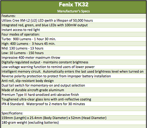

    Manufacturer's Specifications
    Price: 95 USD

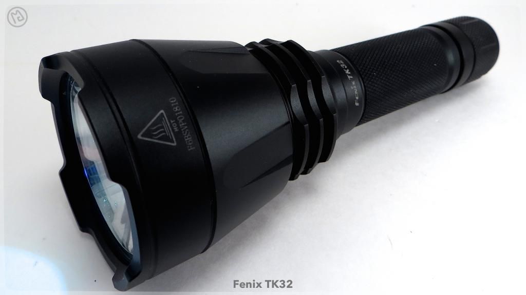

    Plus, here's a few shots with some good detail.
    (click to enlarge)

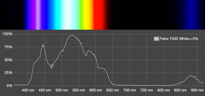

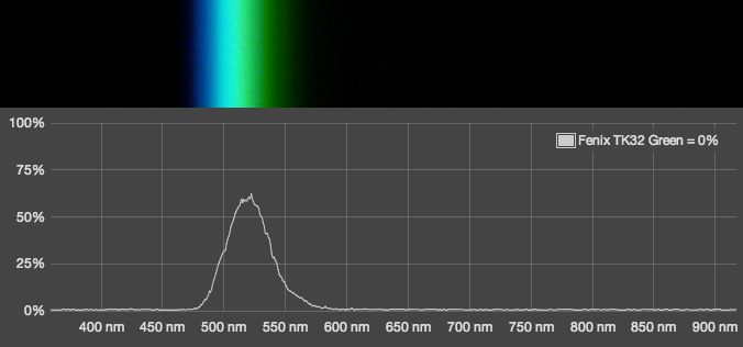

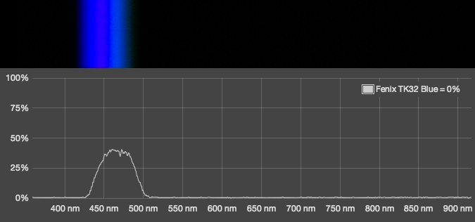

    Spectral Analysis
    All light that we see as white is actually made up of several different colors put together. The relative intensities of the different colors in the mix are what determine the tint of the white we see. For example, cool white LED's have a lot of blue, and warm white LED's have more red or yellow. This measurement was done on a home made spectrometer. The plot below the picture is corrected for the spectral sensitivity of the human eye. Note: the peak in the 900nm region doesn't really exist, it's a piece of the second-order spectrum that's showing up here because of the high intensity of the light source.

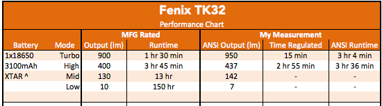

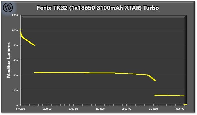

    Output and Runtime
    ANSI FL-1 runtime ratings are the time it takes for a light to fall to 10% of it's original output (counting from 30 seconds after turning the light on).
    The vertical axis of the graphs below represents a relative brightness measurement using a home made light box. The horizontal axis is time in hours:minutes:seconds. Runtimes are stated in hours:minutes:seconds. These graphs may be truncated to show detail.
