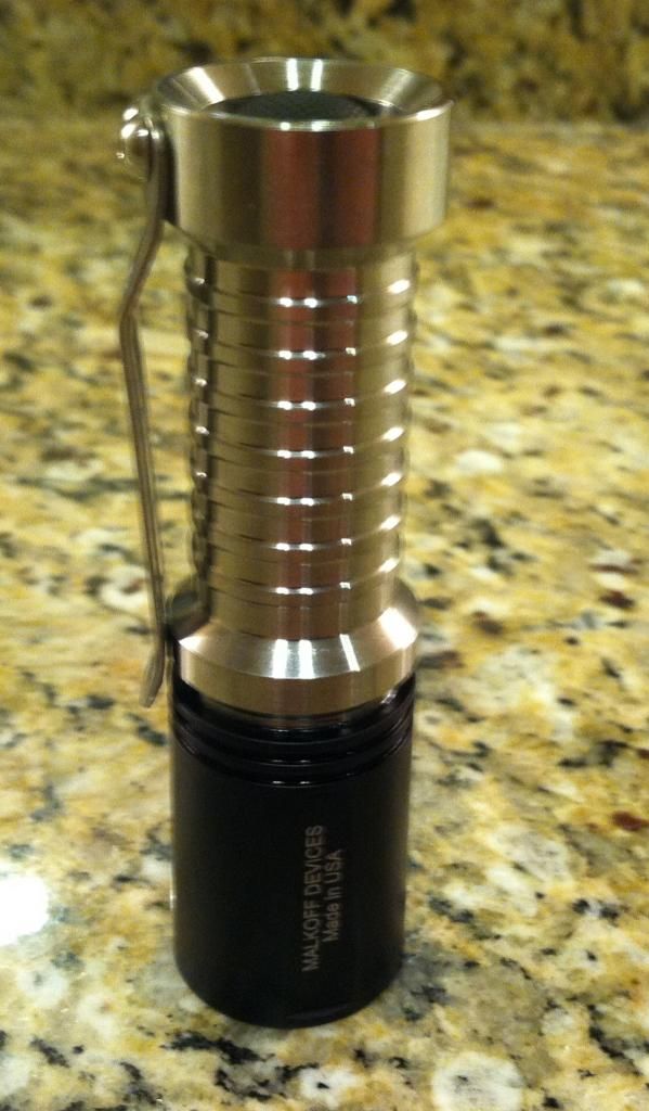

    Malkoff MDC - The “Poor Man's Haiku” - Another Ideal EDC
    As many know, I have been a tireless proponent of the McGizmo Haiku since mid 2011 when I first got mine. I love the Haiku in all its iterations! Frankly, I don't think Don (McGizmo) can make a bad light, but I digress. Ever in the search of the perfect EDC, I settled on the Haiku and I still think that it is as close to perfect as I have come in my travels through flashaholism since about 2007 when I joined CPF. If you are interested in reading my thoughts on the Haiku, you can read my review here.
    However, when suggesting the Haiku to others I am often met with criticism. "Yeah sure, I bet it is great, but at $400+ I won't be trying one anytime soon." I have heard more than one member say they wish that Don would offer aluminum versions of his lights so people could experience them without the same cash outlay.
    Fortunately, I have a solution! As I have continued my search for additional Made in USA high end and Custom EDC lights, I have found a fantastic light made by another one of CPF's finest - Gene Malkoff. Although many people are familiar with Gene's dropins, I don't see so much discussion of the MDC outside of the main MDC thread. But the Malkoff MDC is a super light that needs more attention! I'd like to talk a little bit about why I feel the MDC is a very comparable alternative to the Haiku, even sharing some genetic material with the McGizmo, and available at about 1/4 the price. Interested in the Haiku experience but on a budget? Consider the MDC.

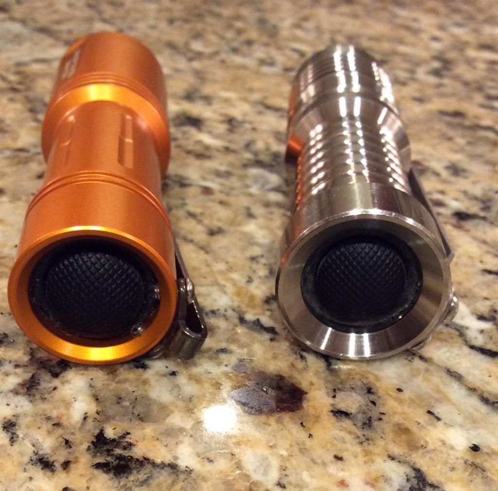

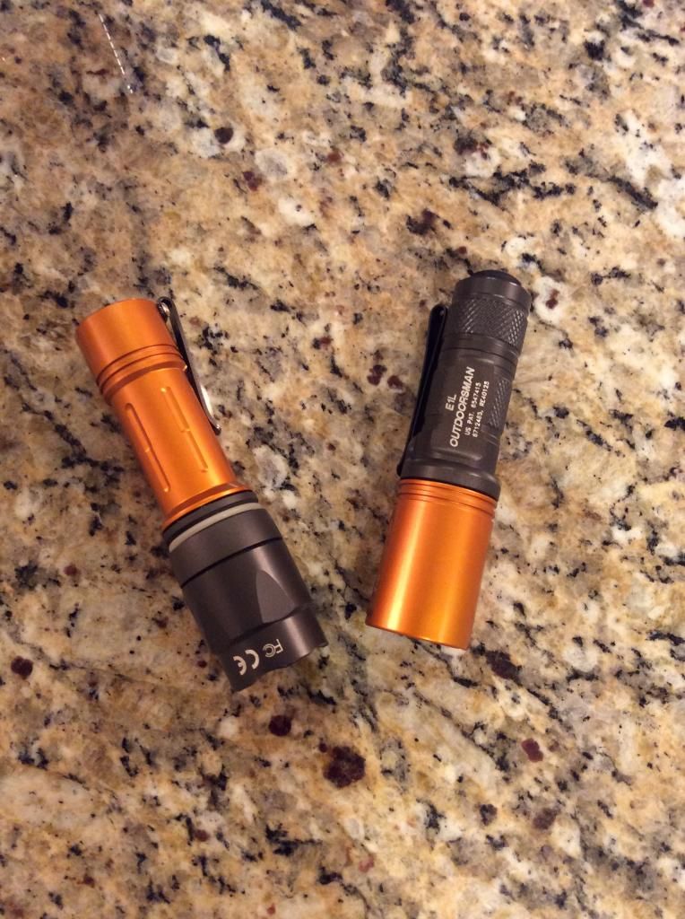

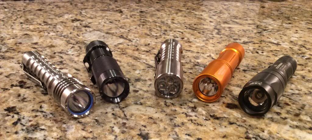

    The MDC alongside a few of my favorite EDC lights. A worthy addition!

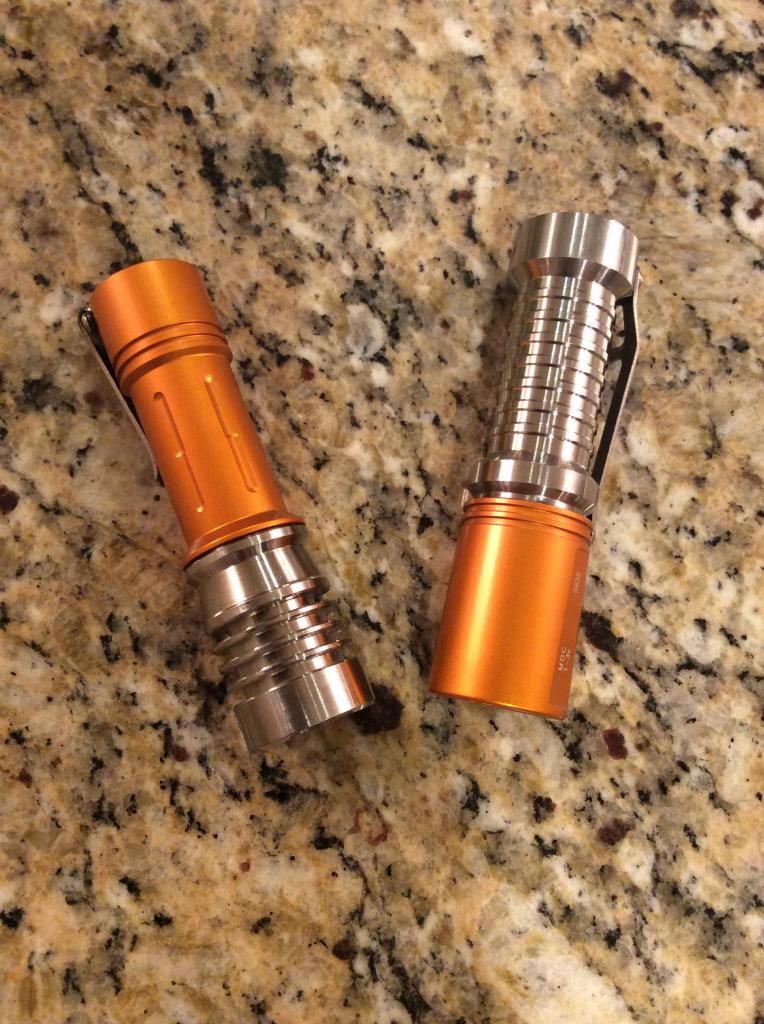

    Modularity:
    One of the great things about Don's lights is the modularity they afford. Different heads, bodies, and converters are available, and his lights are cross compatible, as well as compatible with SureFire E-series lights and with other Custom components built to work off that platform.
    Well, the MDC series is similarly modular! Gene offers AA and CR123 bodies and heads designed to work on AA, CR123, or li-ion rechargeables with several different options as to output and modes. Cool right? Plus, MDC parts are similarly E-series compatible. If you want to put your MDC head on an E1L body or a Ti McGizmo clicky pak, you can!! Some members have come up with some pretty neat Legos using Malkoff parts, even altering the UI by combining MDC heads with alternative switching mechanisms. I have been using a Lego of a McGizmo Pak with an MDC head and I really like it.
    McClicky Switch:
    Remember how I said that the MDC shared genetic material with the Haiku? One of the ways is in the McClicky switch used in the MDC and designed by Don. Gene has been using McClickies for years as I recall, and they are widely known around the forum as one of the most reliable and toughest aftermarket Clicky switches around. They are excellent and responsive switches, and they are easy to remove and replace if somehow you wear one out. A dash of Don in the tail of this light and it’s a beautiful thing. In McGizmoan style it is sealed in with an o-ring to keep out the elements and make this light ready for action in whatever conditions you throw at it.

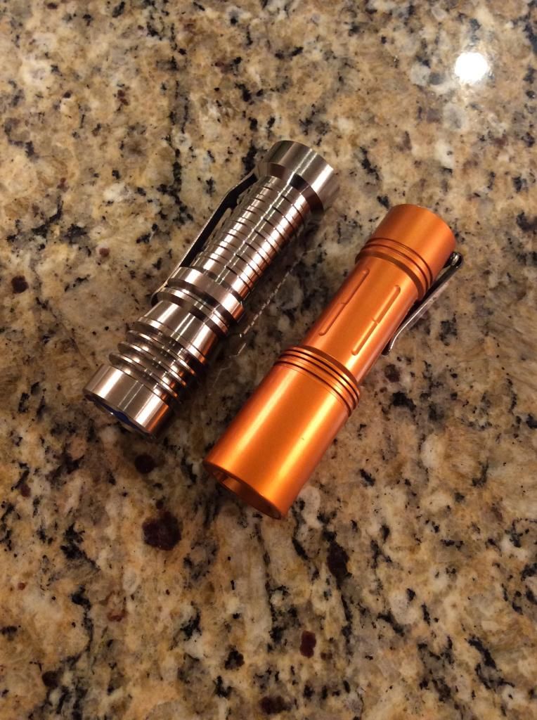

    The MDC is very comparable to the Haiku in size, shape and ergonomics, especially since both can be had with either a CR123 or AA battery compartments. I find the MDC to be quite comfortable to hold, though a little more slippery than the Haiku. The ribs in the Ti on the Haiku as well as the fins on the head offer a lot of purchase on the light, even when wet. The MDC does not have knurling or ribs as such on either the body or head, and its anodized aluminum body is a bit slicker. I personally don’t mind it too much as it’s gentler on my pockets, but if you work in wet, muddy, bloody or gooey environments, you might want to try legoing the head with a SureFire E-series body with some knurling. Legos FTW!! Also, this is why I am working with the McMalkoff lego I showed above.

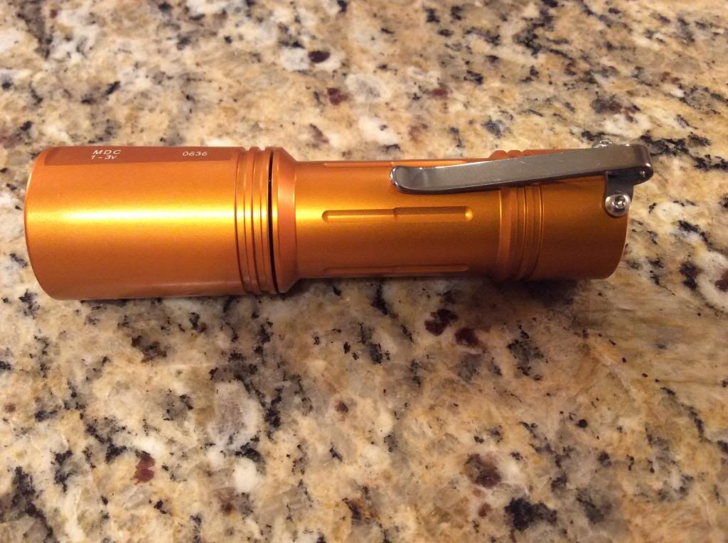

    Pocket Clip:
    Clips are a must for me for EDC lights. When it comes to Don’s lights, I think he has the freakin’ awesomest clip ever made. IMHO. The clip is my single biggest quibble with the MDC. It’s OK, but it’s not awesome. At least it is there and it faces the right direction though, which is more than many manufacturers can say!! I like that it is a true deep carry, and dives low in the pocket, especially in dress pants, but it is skinny. It’s kind of hard to get onto my pocket edge sometime and it doesn’t clamp in place quite like Don’s does. I’m sure this is a non issue for most people but I am a clip snob and I just plain love the McGizmo clip.

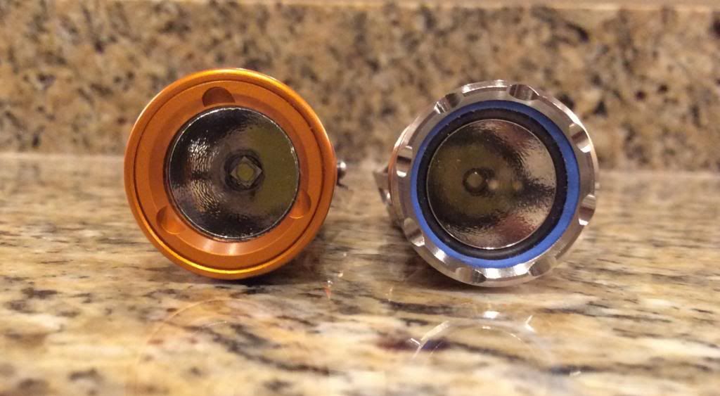

    Beam Quality:
    The beam quality on the MDC is excellent, as it features another bit of DNA from McGizmo, the reflector. Once again, I believe Gene has been using McRs for many years, but it is another great example of his using the best quality components for the job. Don has been designing reflectors for years and is known for excellent quality beam patterns in his own lights. The MDC is no exception. The combination of the XP-G2 with Don’s reflector serves up a plate of “punchy flood” that suits me very well, and is very comparable to the Haiku. It has plenty of throw for most applications with a generous hotspot and considerable spill. Yummy! The transition is pretty smooth and devoid of irritating rings or artifacts. For me, these lights share a similar beam that is basically ideal for EDC purposes. I like the throw of a TIR on occasion, or the perfect flood of my Mule indoors, but when you need one light for general usage throughout a day, an XP-G/2 with a McR selected for it gives the perfect blend of spot and flood.

    2. I think the clip needs to be redesigned. Totally in the way of Mcgizmo or Zebralight SC52. The screws should not be disposed and can be seen from the tail side. And the clip should not protrude.

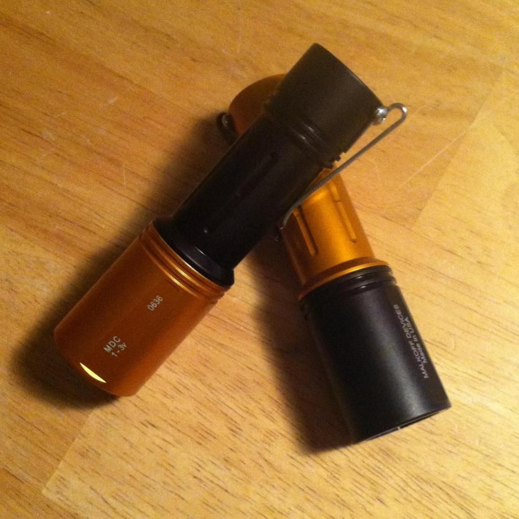

    I got my second MDC in today. I love that Cathy writes a note on the packing slips, it's such a nice personal touch, and makes me all warm and fuzzy while I open up my Malkoff packages.
    It is the same guts as the other one but HA-BK. I really like this Malkoff black ano - it seems thick, but is very smooth and even colored, and it is a bit more matte than glossy, which I personally like. I think this one has a bit more grip than the orange anodizing, just by way of its natural texture. Very impressed with the HA-BK - among the best I have seen.
    (Sorry for the grainy pics, I will try to re-shoot them, I used my old iPhone instead of my iPad Air which has a better camera. )
    Ahhh, hybrids!
    This is going to be my new workday EDC light, the HA-BK MDC head with a Ti McClicky Pak. All the great parts about the MDC with the advantages of a grippy body with a killer clip. Who doesn't like a hot body?
    And here's a little lego I had been playing with with the orange body - I think it looks great with the black. Black and Ti really go well together!! This is the MDC body with a McGizmo Mule head on it. For indoor uses it's perfect - It's super tiny, dives deep and disappears in my pocket when I have to be in dress pants - I love it!!

    Nice Mule. I have the same basic light, but with a black Aleph head. 119v 3 speed LE. Got it used with a single speed cool LE. I may need another MDC when Gene and Cathy get the neutrals back in stock. Had a couple early low/high/strobe but let them go... Good write-up.

    Thanks Greg. These MDC parts are great for legos. I'd love to see your Mule too. This one is running Don's 119 LE also. That's a great emitter for Mules anyways, and like I mentioned, for dressy applications, the smaller slimmer MDC body is a nice option for a super compact little light.
