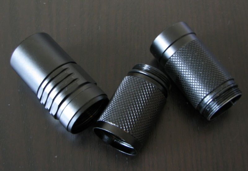

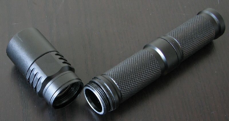

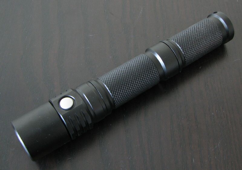

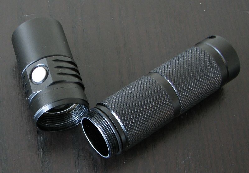

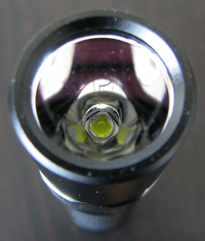

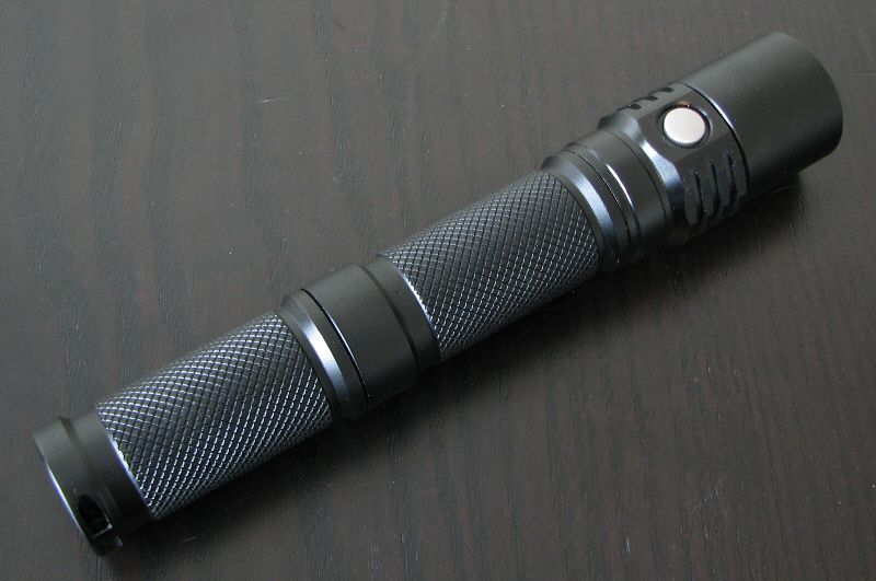

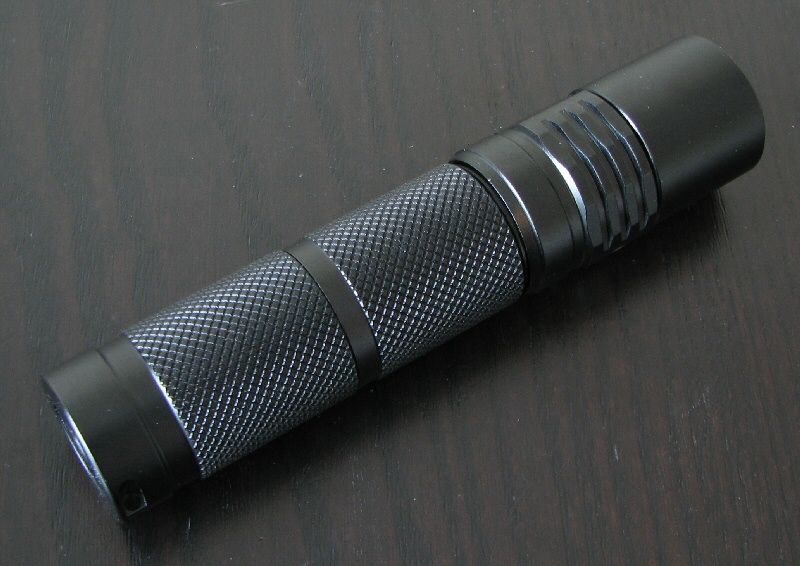

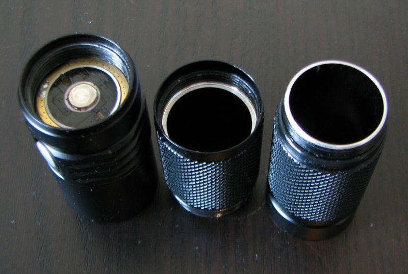

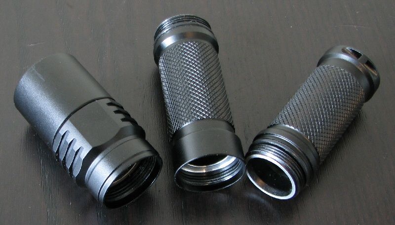

    Physically, the new Neutron lights are very similar to one another – indeed, the heads look almost identical. But they are completely different from the original 2011 Neutron series, which had a "classic" tailcap clicky-switch build, with very aggressive knurling and crenelated stainless steel bezels. The 2C 2011 model had a narrow body width though, preventing 18650 cells from being used.
    The new Neutrons for 2014 have a larger common-sized head, but with only a small side-mounted electronic switch (i.e., no physical clicky). Knurling is mild in comparison to before. The lights also have a fairly "plain" look to them (e.g., flat aluminum bezels, fair smooth, no aggressive styling, etc.). Body tubes have a generous internal diameter though, allowing all modern high capacity cells to be used. Basically, this is a completely different design.

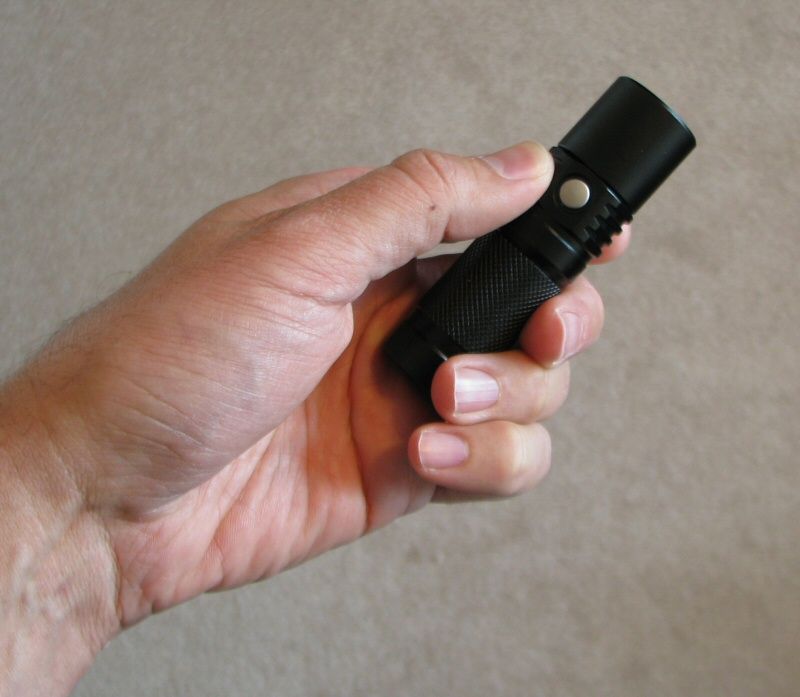

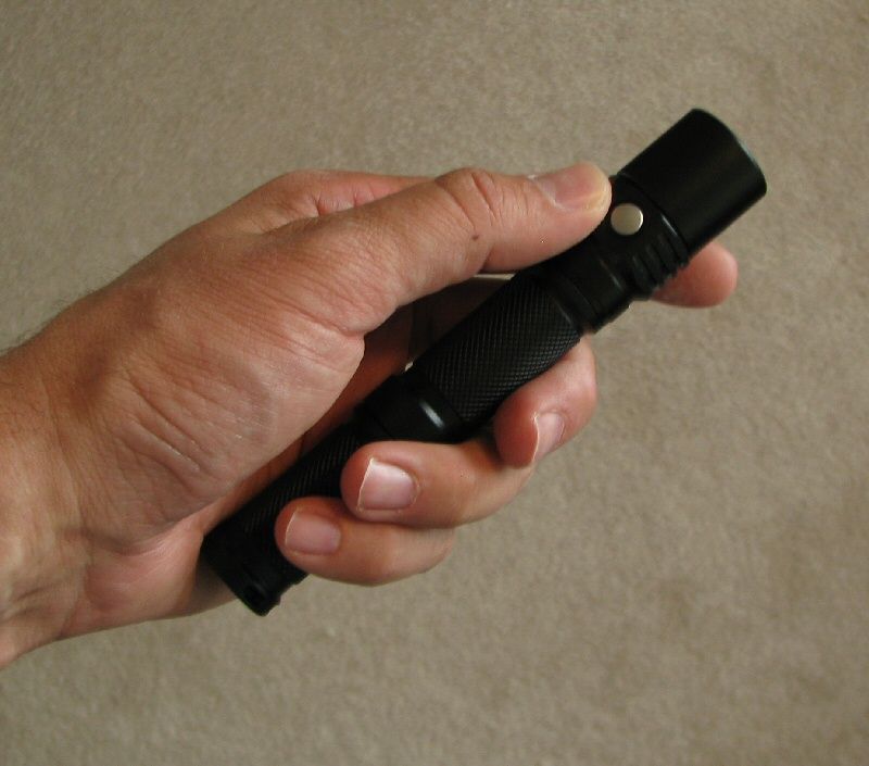

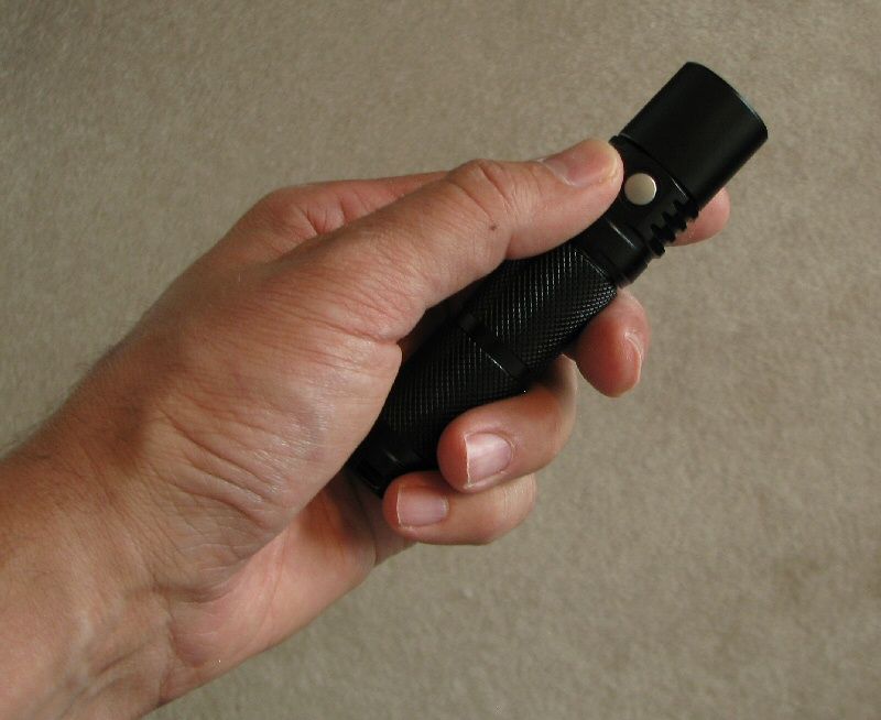

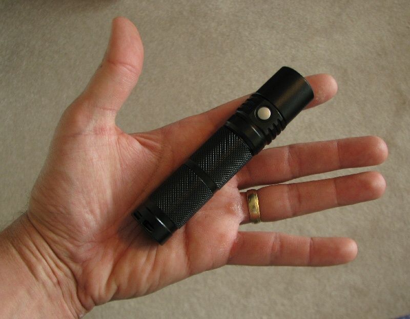

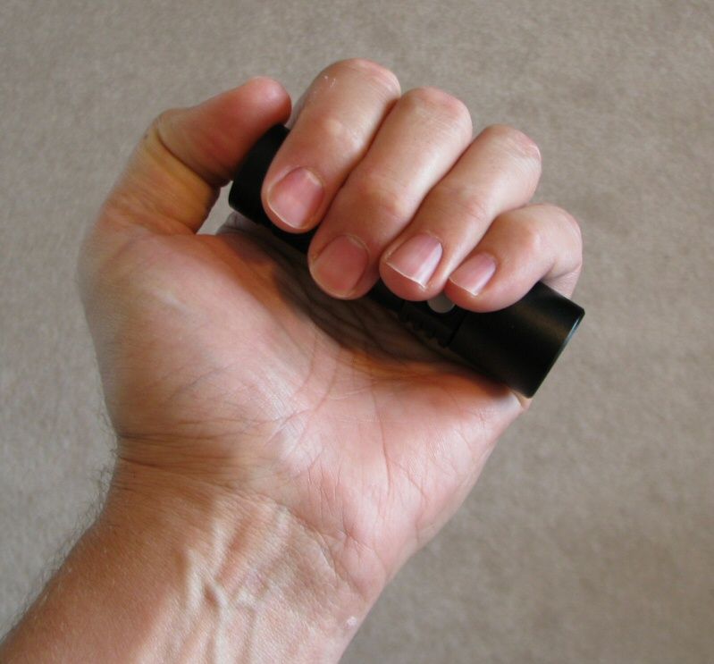

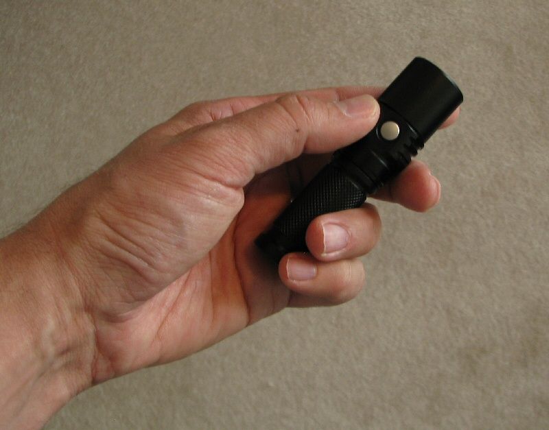

    Hand feel is ok, but I would prefer some additional elements to help with grip and anti-roll (e.g., I believe clips will be included, but I haven't seen them yet). The 2A is a bit better in this regard, as the battery tube segments are fluted in segments (i.e. it uses thinner AA-category cells).

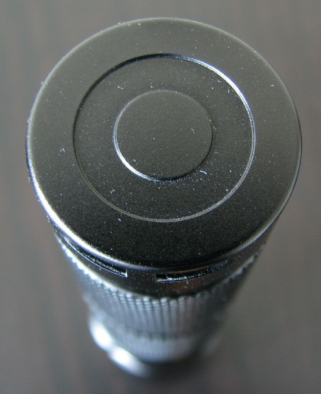

    The side-mounted electronic switch has a typical feel for a small button switch. But I would prefer a more prominent switch that is easier to access by touch alone (i.e., raised and enlarged). Switch function was ok for all mode-changing features (see User Interface discussion below).

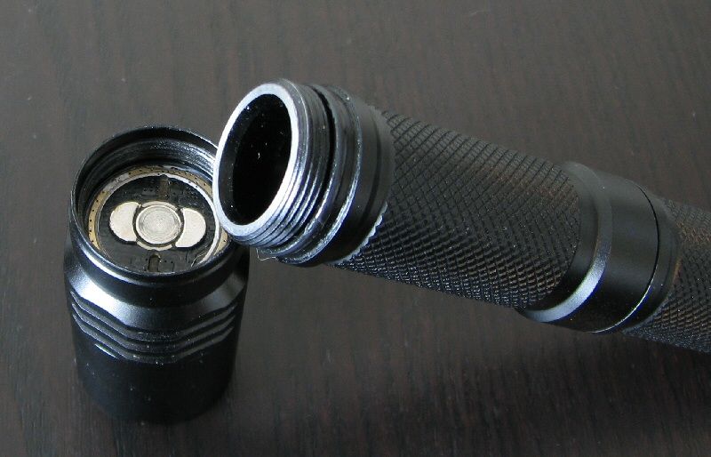

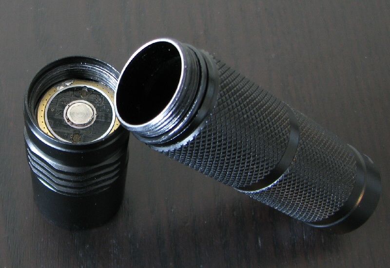

    The only difference on the heads of these units is that the 2A has the classic reverse-polarity feature that is common on the circuit boards of many AA-based lights (i.e., only small button top can be used). The 2C lacks this feature, and so will take flat-top cells just fine.
    Screw threads are anodized, allowing head lock-out on either model. Both models come with a removable section for the second AA or CR123A cell (i.e., remove the middle body tube piece, and the 2A becomes a 1A, and the 2C is a 1C). I personally like this design, as it gives you the flexibility to switch between 1x cells for ease of carry and 2x cells for maximum output and runtime. Note that the 2C does not fully support 1xCR123A however (more on this later).
    The lights can tailstand, and there is a split-ring/lanyard attachment hole on the side of the tail.

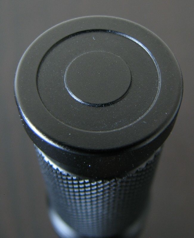

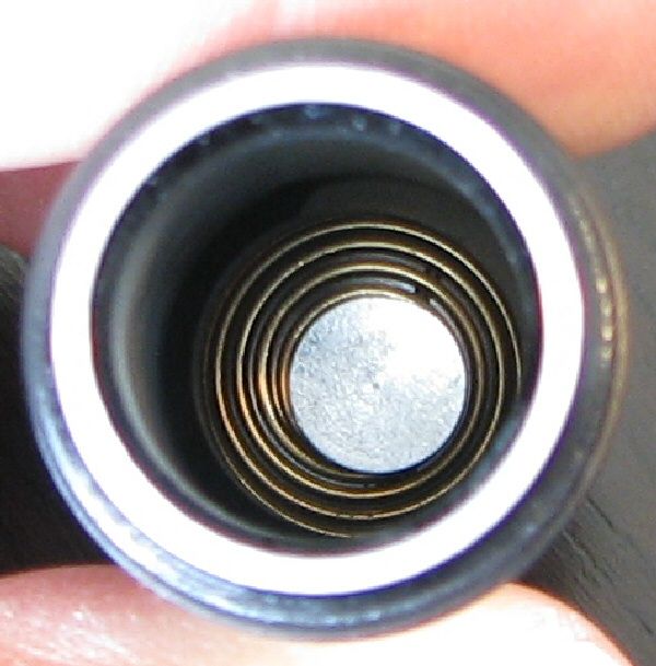

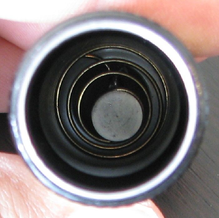

    At the base of the battery tube there is flat contact plate on top the spring (which will save your batteriess from any potential scratching). A nice touch.

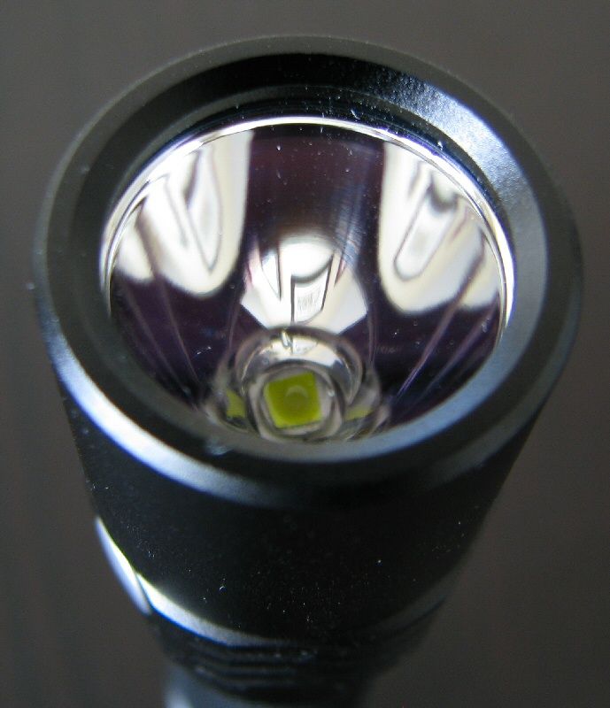

    The new Neutrons use a flat bezel design. Reflectors are smooth finish, and of about typical dimensions for this class. Centering of the emitters was good on my two samples. There seemed to be a bit of damage at the base of my 2A reflector (this didn't affect the beam, though).
    Scroll down for specific beamshot comparisons for each model/battery config.

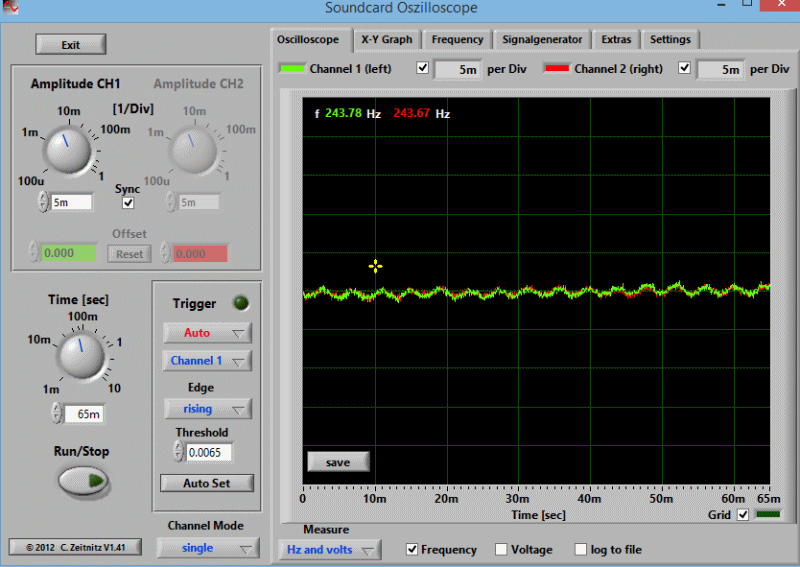

    PWM/Strobe
    The new Neutron 2014 series lights are both current-controlled – there no indication of pulse width modulation on any mode.
    I was able to detect a very faint noise signal on the Med and Hi levels of the 2C:
    It is quite common to see circuit noise on current-controlled lights – it does not affect the visible perception of the beam in any way. Rest assured, the new Neutron series lights are flicker free in use. This is significant upgrade for the 2C, which had quite visible low-frequency PWM on its initial 2011 release.

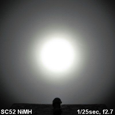

    Neutron 2A – 1xAA size
    From left to right: Panasonic Eneloop Pro NiMH AA; Thrunite Neutron 2A 2014, Olight S15; Zebralight SC51; Sklihunt DS15; Fenix LD12; Thrunite T10.
    Neutron 2A (1xAA form): Weight: 57.6g, Length: 95.6mm, Width (bezel): 25.6mm
    Olight S15 1xAA: Weight: 46.4g, Length: 87.0mm, Width (bezel): 23.1mm
    Nitecore MT1A: Weight: 54.6g, Length: 104.6mm, Width (bezel): 22.7mm
    Nitecore SENS AA: Weight: 26.1g, Length: 82.7mm, Width (bezel): 19.8mm
    Lumintop ED15: Weight: 59.7g, Length: 100.2, Width (bezel): 21.9mm
    Rofis ER12: Wright: 35.5g, Length: 96.2mm, Width (bezel): 18.6mm
    Skilhunt DS15: Weight: 52.0g, Length: 92.1mm, Width (bezel): 24.0mm
    Xeno E03:: Weight: 48.1g, Length 96.7mm, Width (bezel): 21.5mm
    Zebralight SC52: Weight 39.5g, Length 79.0mm, Width (bezel): 22.6mm, Width (max) 25.4mm

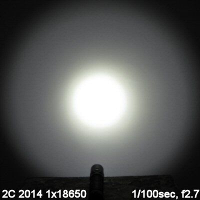

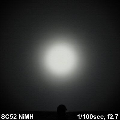

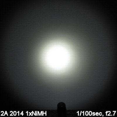

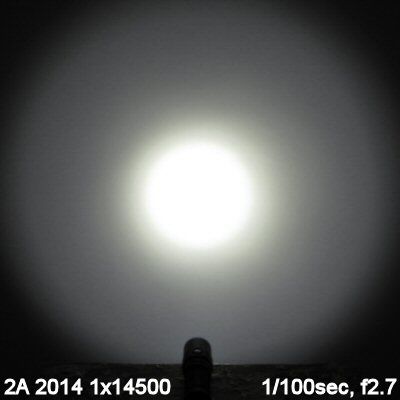

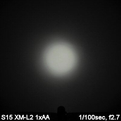

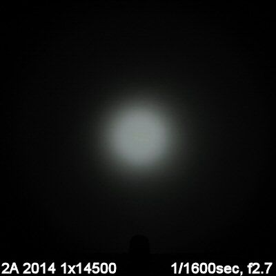

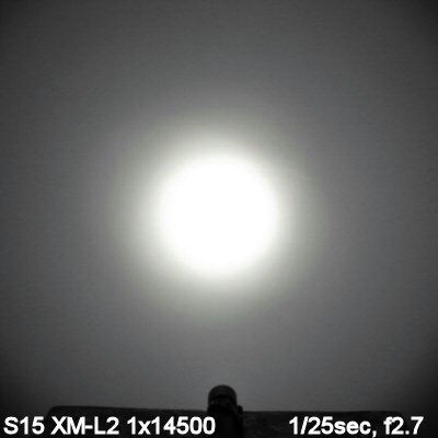

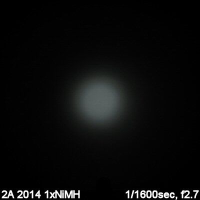

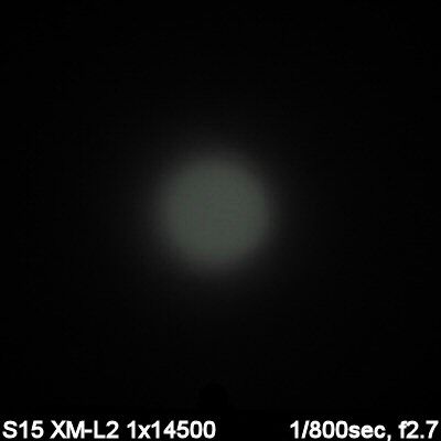

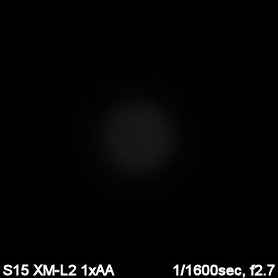

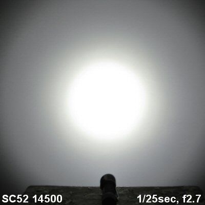

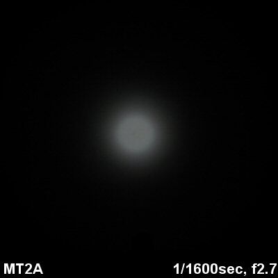

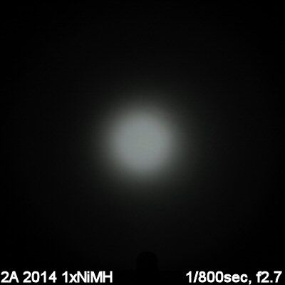

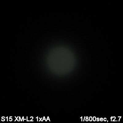

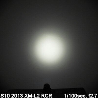

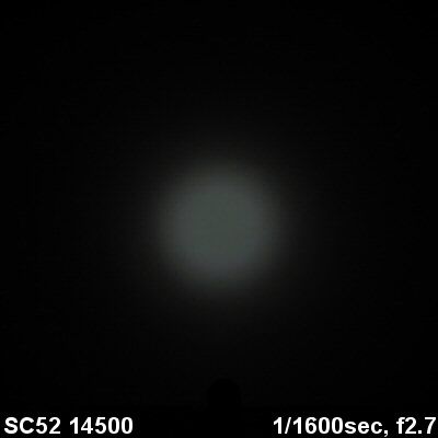

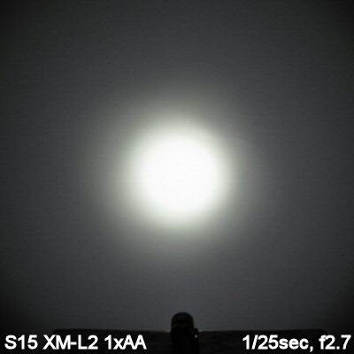

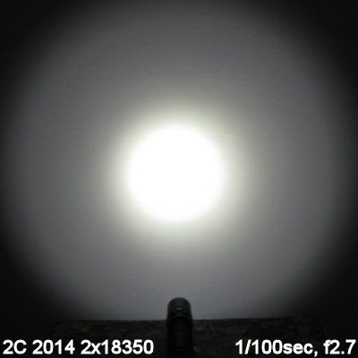

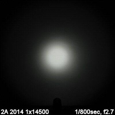

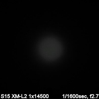

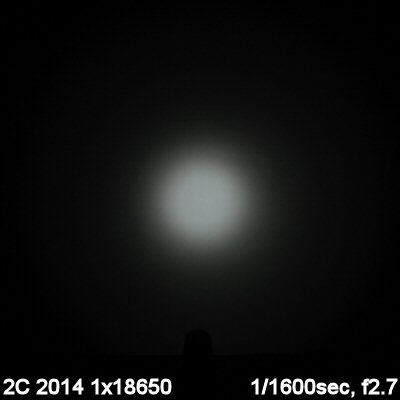

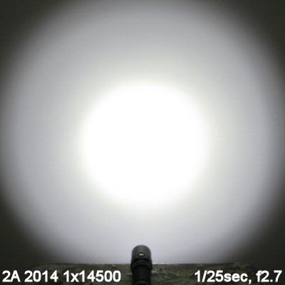

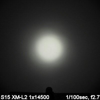

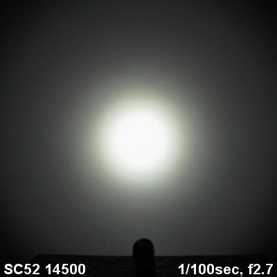

    For white-wall beamshots below, all lights are on Max output on an NiMH or 14500 AA-sized batteries. Lights are about ~0.75 meter from a white wall (with the camera ~1.25 meters back from the wall). Automatic white balance on the camera, to minimize tint differences.
    1xAA Sanyo Eneloop NiMH
    1x14500 (AW Protected 14500) Li-ion

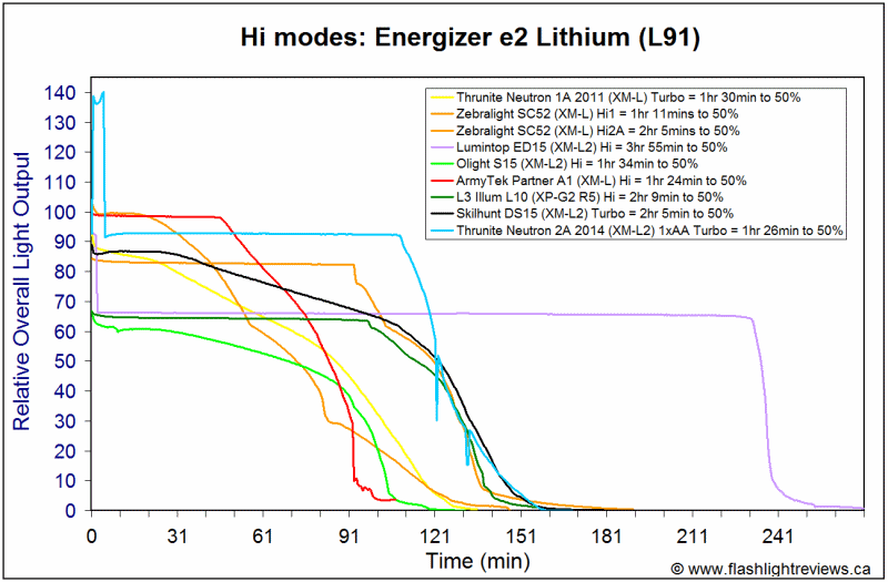

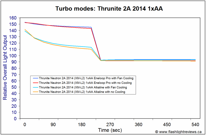

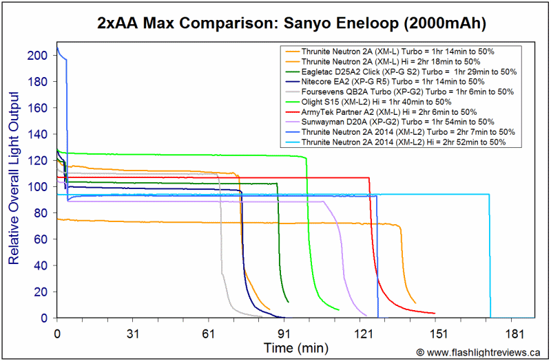

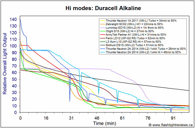

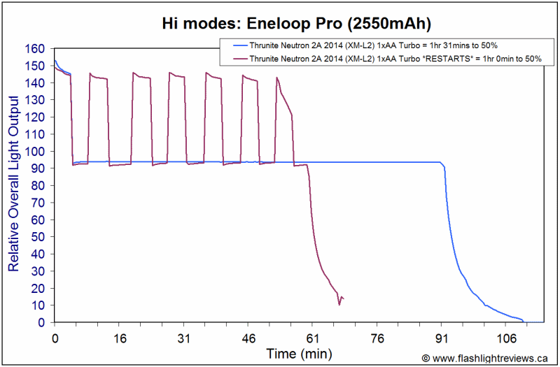

    UPDATE August 19, 2014: Here is what repeated restarts on Turbo looks like. I manually restated the Turbo after ~4 mins of the step-down Hi, repeatedly.
    Impressively, the light is able to maintain a fairly well regulated Turbo mode - up until the point where the battery is nearly exhausted.
    And here is a shorter time comparison of the effect of fan cooling (my standard process) and uncooled runs, on Turbo on 1xAA alkaline and Eneloop Pro:
    As you can see, cooling has (surprisingly) relatively little effect on output over the timescales shown.

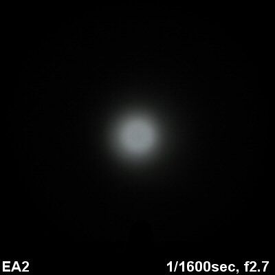

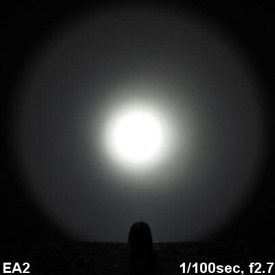

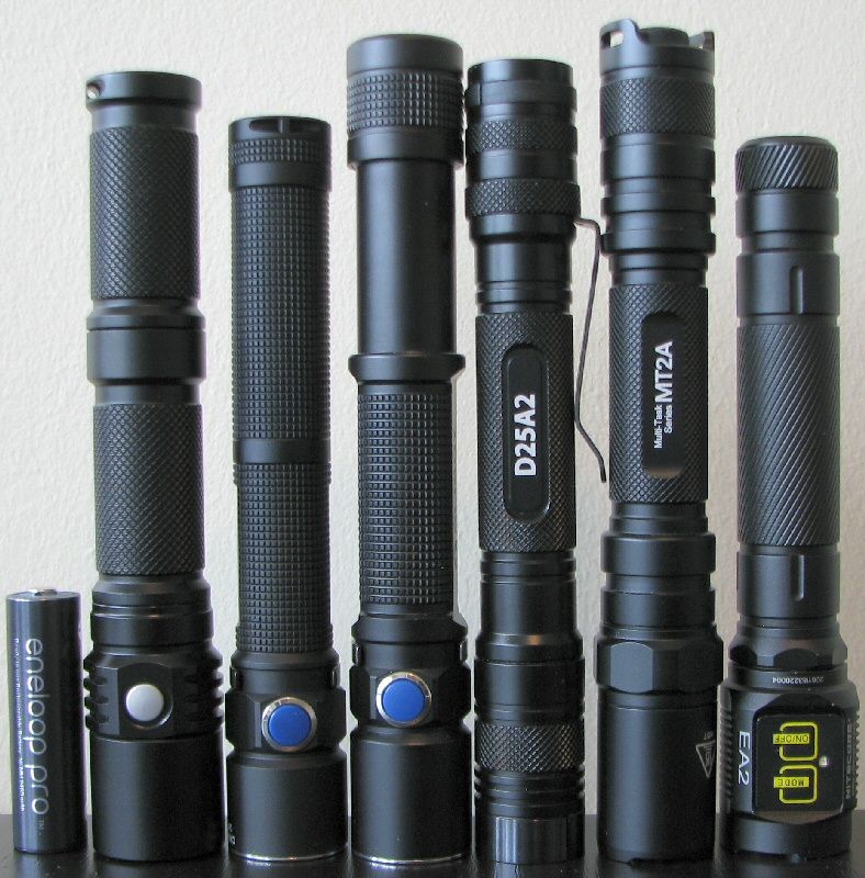

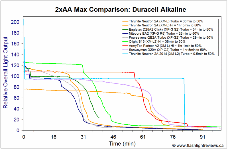

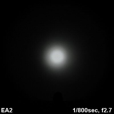

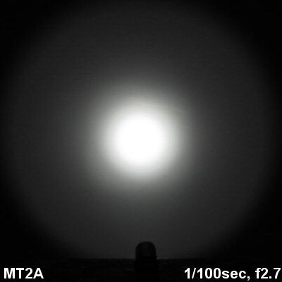

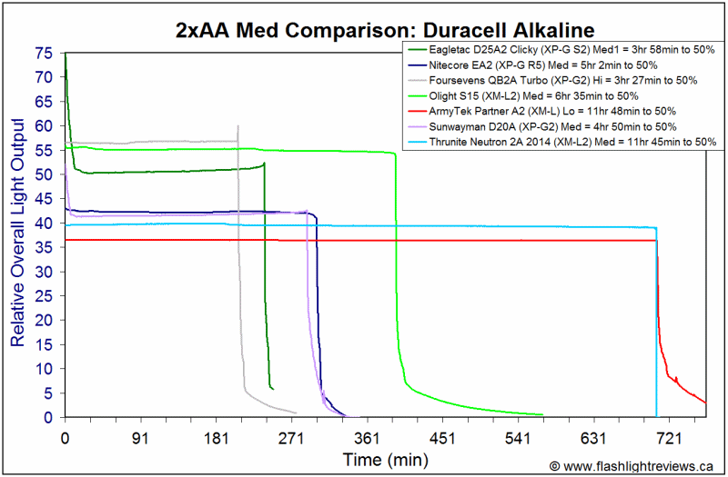

    Neutron 2A – 2xAA size
    From left to right: Panasonic Eneloop Pro NiMH AA; Thrunite Neutron 2A 2014; Olight S15 with extender, ST25; Eagletac D25A2; Nitecore MT2A, EA2.
    Neutron 2A (2xAA form): Weight: 73.46g, Length: 146.2mm, Width (bezel): 25.5mm
    Eagletac D25A2: Weight: 54.8g, Length 148.5mm, Width (bezel): 21.0mm
    Foursevens QAA-2 X (Tactical tailcap): Weight: 60.1g, Length: 149.1mm, Width (bezel) 22.0mm
    Olight S15 2xAA: Weight: 59.2g, Length: 137.9mm, Width (bezel): 23.1mm
    Jetbeam BA20: Weight: 70.2g, Length: 156.4mm, Width (bezel) 23.2mm
    Nitecore MT2A: Weight: 66.9g, Length: 154.3mm, Width (bezel):22.7mm
    Nitecore EA2: Weight: 68.9g, Length: 134.4, Width (bezel): 26.1mm
    Sunwayman D20A: Weight 118.4g, Length: 102.6mm, Width (head) 20.9mm, Height (head) 35.1mm

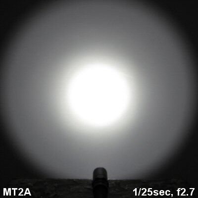

    For white-wall beamshots below, all lights are on Max output on 2xNiM AA (Sanyo Eneloop). Lights are about ~0.75 meter from a white wall (with the camera ~1.25 meters back from the wall). Automatic white balance on the camera, to minimize tint differences.

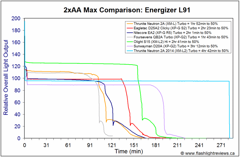

    Note: the 2A shut down around ~45 secs on the Turbo Alkaline mode run - so the light was restarted on Hi.
    Note: the 2A shut down after ~2 secs on the Turbo L91 mode run - so the light was restarted on Hi.

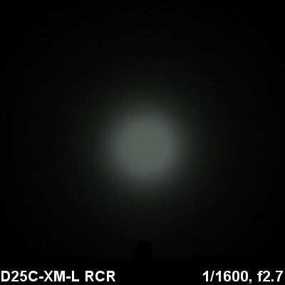

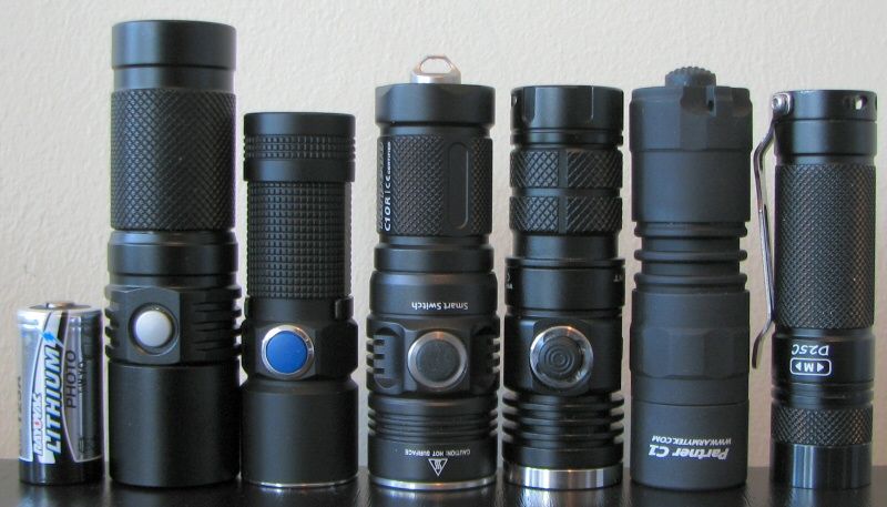

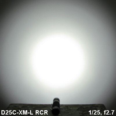

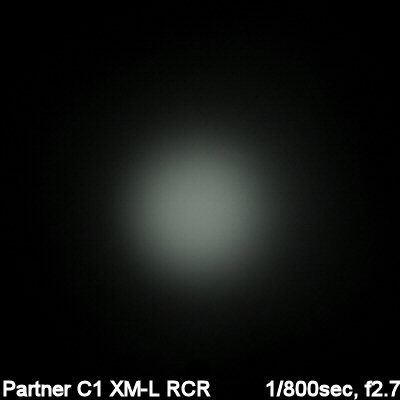

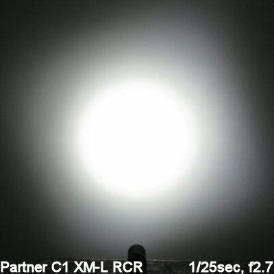

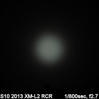

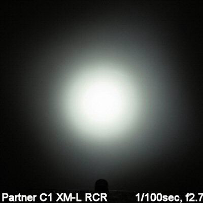

    Neutron 2C – 1xCR123A/RCR size
    From left to right: Rayovac CR123A; Thrunite Neutron 2C; Olight S10 2013; Sunwayman C10R; Skilhunt DS10; Armytek C1; Eagletac D25C.
    Neutron 2C (1xCR123A/RCR form): Weight: 63.0g, Length: 87.7mm, Width (bezel): 25.5mm
    ArmyTek C1 XM-L: Weight: 43.0g, Length: 80.2mm , With (bezel): 23.1mm
    Eagletac D25C Clicky: Weight: 30g, Length: 76.0mm, Width (bezel): 20.0mm
    Foursevens QTLC: Weight 36.4g, Length 84.1mm, Width (bezel) 22.1mm
    Jetbeam PC10: Weight: 50.5g, Length: 93.6mm, Width (bezel): 22.6mm
    Lumintop ED11: Weight: 44.1g, Length: 83.7, Width (bezel): 21.8mm
    Olight S10 (2013, XM-L2): Weight: 40.5g, Length: 70.8mm, Width (bezel): 23.1mm
    Skilhunt DS10: Weight: 47.0g, Length: 76.1mm, Width (bezel): 24.0mm
    Sunwayman C10R: Weight: 57.3g, Length: 76.2mm (no lanyard plug), 82.3mm (with plug), Width (bezel): 25.6mm, Width (head at widest part): 28.6mm
    1xRCR/18350

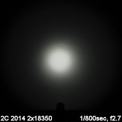

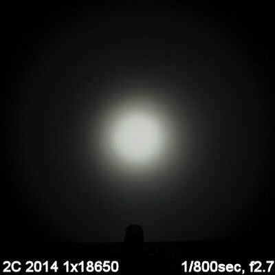

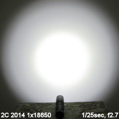

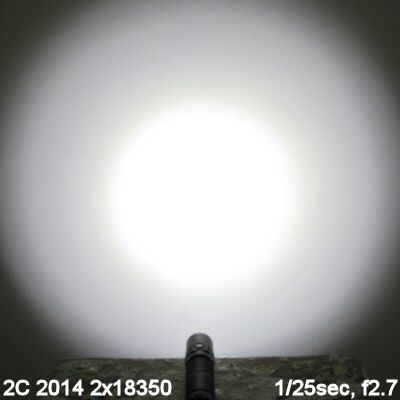

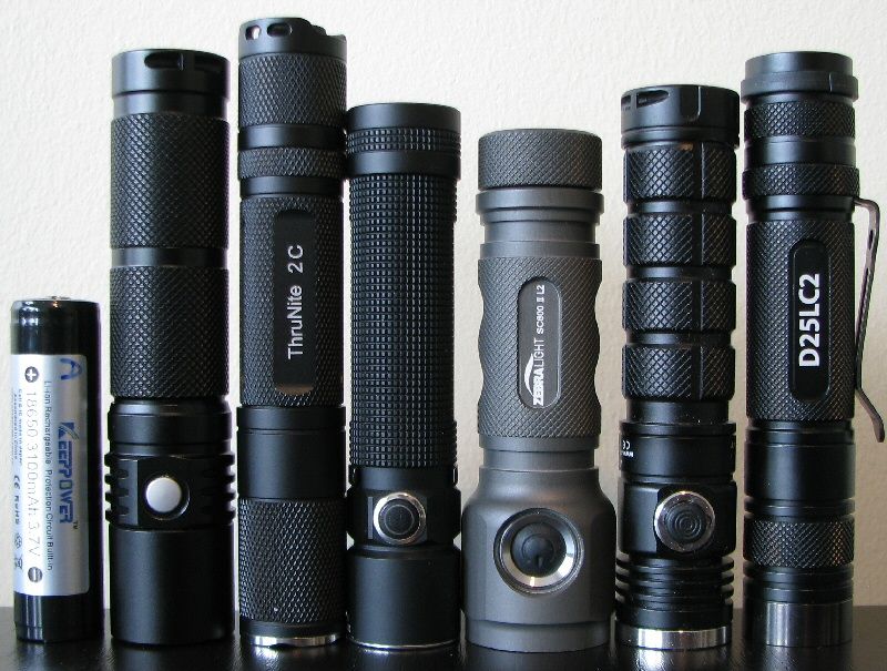

    Neutron 2C – 2xCR123A/RCR 1x18650 size
    From left to right: Keeppower Protected 18650 3100mAh; Thrunite Neutron 2C 2014, 2C 2011; Olight S20 (2013), Zebralight SC600-II, Skilhunt DS20; Eagletac D25LC2.
    Neutron 2C (2xCR123A/RCR form): Weight: 71.2g, Length: 117.7mm, Width (bezel): 25.5mm
    Skilhunt DS20: Weight: 53.8g, Length: 110.0mm, Width (bezel): 24.0mm
    Olight S20 (2013, XM-L2): Weight: 52.4g, Length: 106.5mm, Width (bezel): 23.1mm
    Eagletac D25LC2: Weight: 50.0g, Length: 116.3mm, Width (bezel): 22.5mm
    Foursevens Quark Q123-2 X (Regular tailcap): Weight: 44.6g, Length: 112.7mm, Width (bezel) 22.0mm
    Jetbeam PC20: Weight: 60.0g, Length: 127.5mm, Width (bezel): 22.6mm
    Skilhunt K11: Weight: 120.5g, Length: 129.6mm , Width (bezel): 34.1mm
    Sunwayman C20C: Weight 57.6g, Length: 104.8mm. Width (bezel): 25.6mm
    Thrunite TN10: Weight: 154.7g, Length: 145.5mm, Width (bezel): 35.1mm
    Zebralight SC600: Weight 87.2g, Length: 107.8mm, Width (bezel) 29.7mm

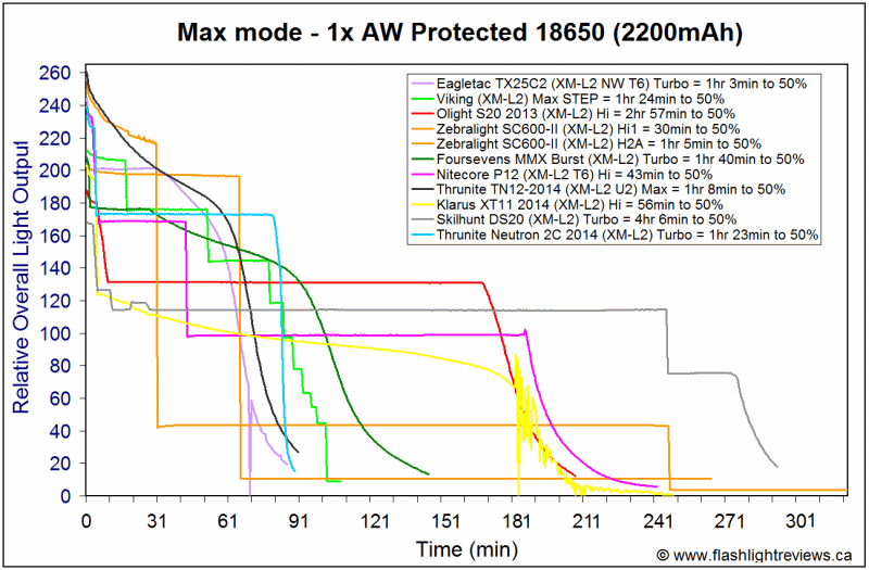

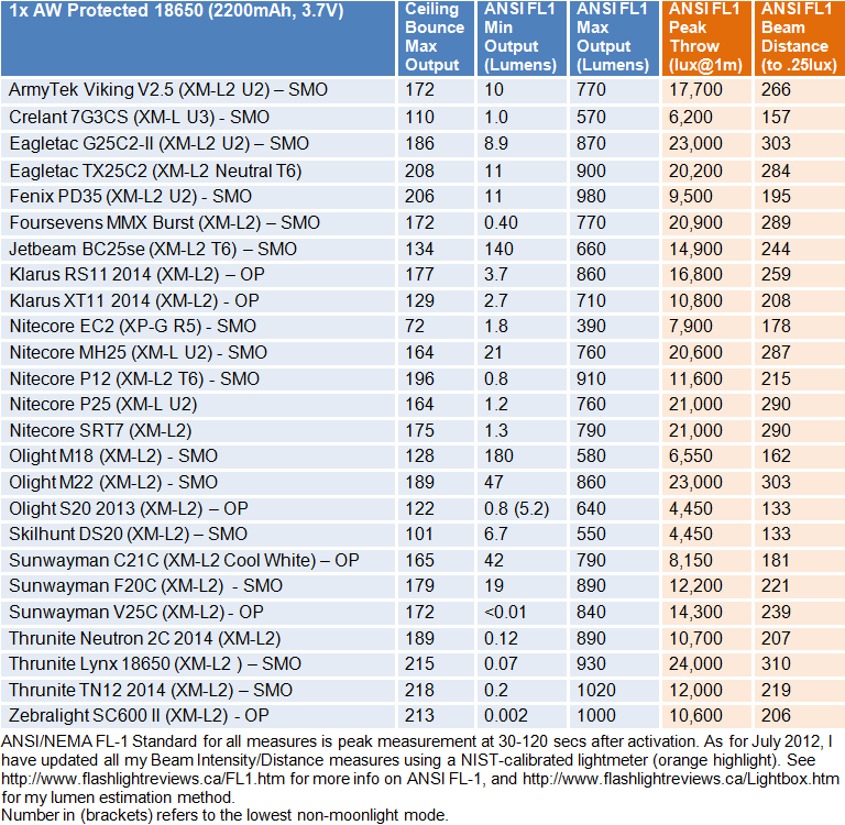

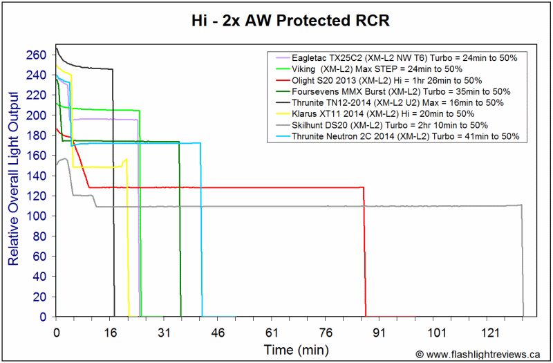

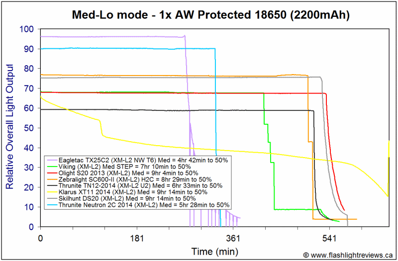

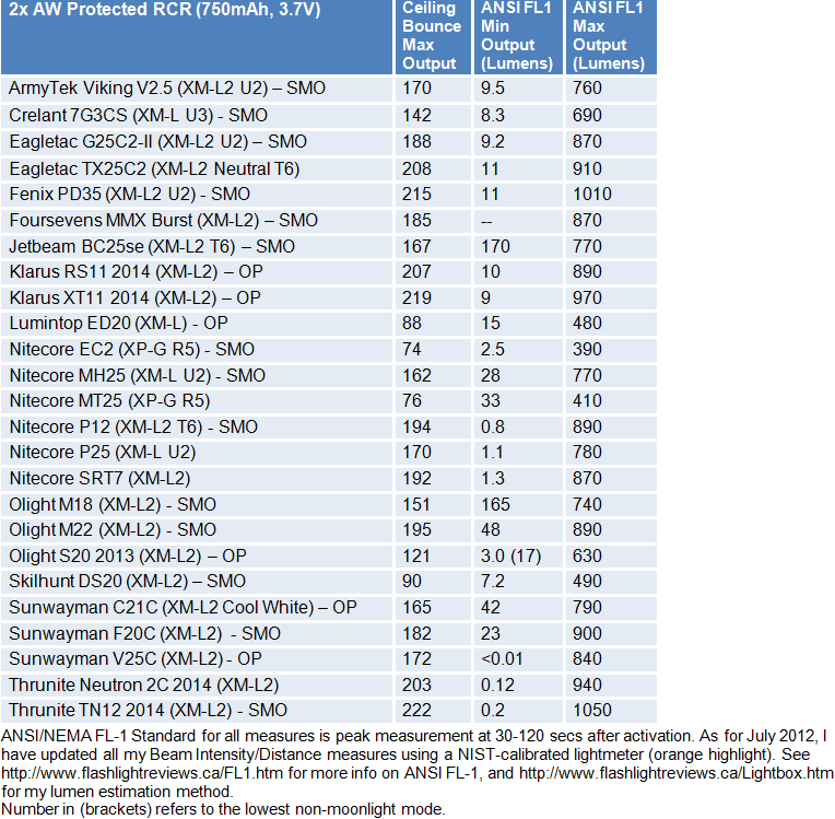

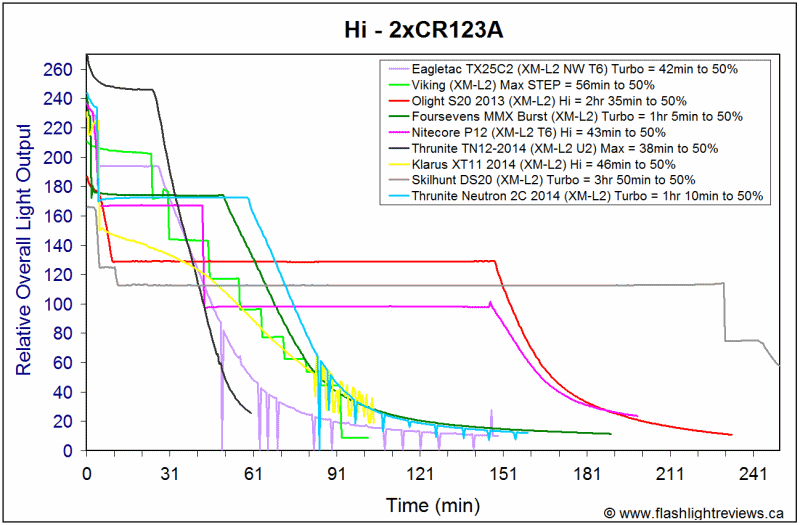

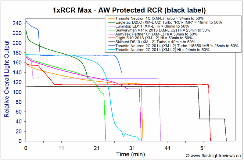

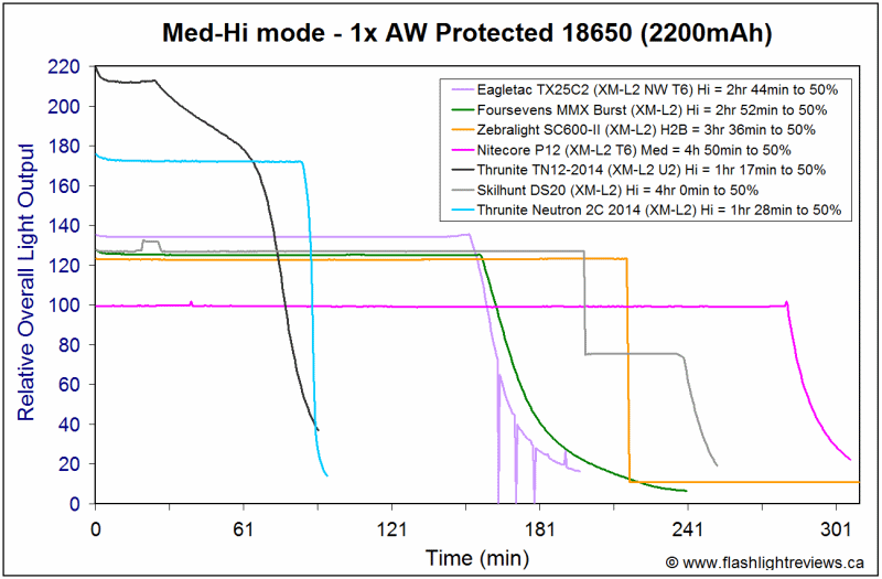

    Let's start with a comparison of my standard AW protected 2200mAh to protected NCR18650A 3100mAh:
    And now on my standard cells:
    The new Neutron series for 2014 use an electronic switch, and therefore require a small stand-by current when fully connected. However, the standby drain was completely negligible on both models, on all batteries – with multi-year (or decades) before batteries would be drained.
    Accidental activation is always a potential concern with electronic switches. However, you can physically lock out the lights by a twist of the head.
    The switch button is small, and may be hard to locate by touch alone.
    On the 2C, 1xCR123A is not fully supported (i.e., no Hi or Turbo, and Med is a lower direct-drive-like mode).
    On the 2C, 1x16340 is not recommend on Turbo, unless you are using IMR chemistry. The Turbo discharge rate on a single cell is too high for standard ICR chemistry.

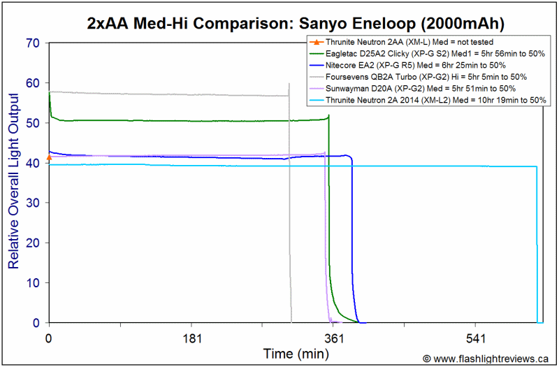

    On the 2AA in 2xAA form, only 2xNiMH would provide the full 4 mins of Turbo mode before step-down. Alkaline cells lasted less than 1 min on Turbo (before shut-down), while fresh L91 cells wouldn't last more than a few seconds before shut-down (may be a voltage issue with new cells).
    On the 2AA in 2xAA form, the light abruptly terminates without warning when the cells are nearly drained (i.e., no gradual drop-off in output). This applies to all batteries, including primary alkaline and L91.
    On 2AA in 1xAA form, the light shows a gradual drop-off in output as the cells are nearly depleted – but with intermittent low voltage warning flashes beginning as soon as the light falls out of regulation.

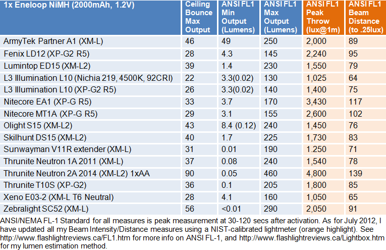

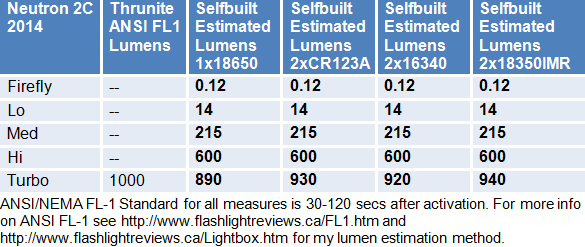

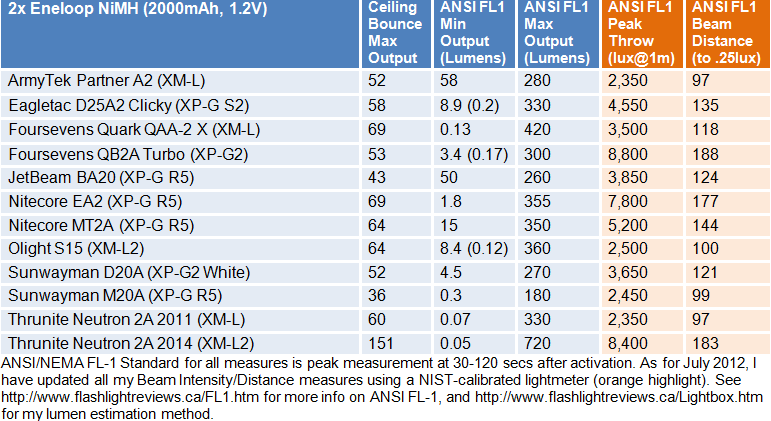

    Neutron 2A
    Max overall output is generally very consistent with the Thrunite specs – almost unbelievably so, in the case of the 2A.

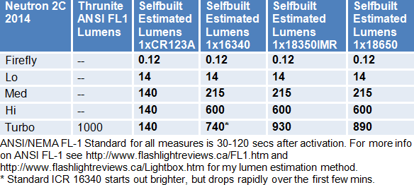

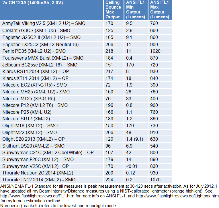

    I am reproducing some of the key summary tables below, where there are interesting findings (again, scroll back for the complete set of tables):
    The main point above is that the 2A is MUCH brighter on Turbo than any other light I've tested in the 1xAA/14500 or 2xAA classes.
    As always, I don't insist on the absolute value of the lumen estimates in my lightbox (although I encourage you to review my methodology – including the number of sources used for generating the calibrations). But the relative comparisons are entirely consistent across reviews. EDIT: see post #19 for a further discussion.
    So, for example, whatever you think the Zebralight SC52 produces in terms of max ANSI FL-1 output, my Neutron 2AA 2014 (on 1xAA) exceeds my SC52 sample by nearly an additional ~60%! Similarly, my Neutron 2A 2014 (on 2xAA) exceeds my Foursevens Quark AA-2 by ~70%. These are unheard increases in output for the AA class.
    Of course, due to the heat produced and the drain on the cells, it 2A won't stay at those turbo-charged levels for long. The light automatically steps down from Turbo after 4 mins runtime, but you can always manually re-activate. While the 2A performed consistently in the 1xAA form testing, the higher output of the 2xAA form was an issue for alkaline and L91 cells (i.e., only NiMH would reliably produce the 4 mins of Turbo before step-down). I understand there is a circuit feature to prevent over-heating, which may be at play on the 2xAlkaline runs (e.g., I noticed the light flashed briefly twice before shutting off, in less than 1 min).
    To learn more about how the 2AA performs, you will need to scroll back up to the actual runtimes. In general terms, output/runtime performance is excellent for the 2A. With the exception of Turbo, you get very flat stabilization at all levels. And overall efficiency is outstanding – the 2A is typically a top performer among the current-controlled class!
    Neutron 2C

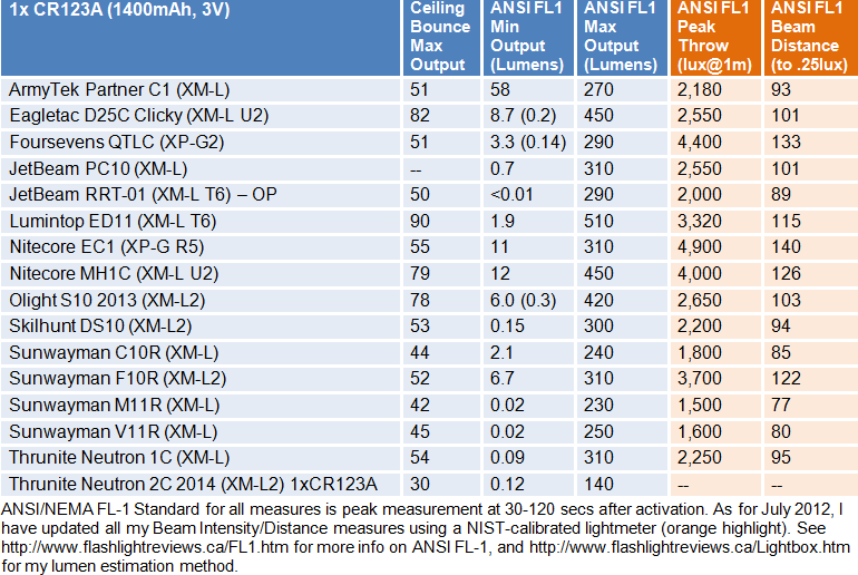

    Like the 2A, the 2C can be run on 1xCR123A/RCR form – but a single CR123A is not fully supported. Again, from the summary tables earlier in this review:
    The 2C is a good performer for the 1x18650, 2xCR123/RCR class. Max output is in keeping with other lights in this class. And as you will see in the runtimes above, the 2C shows flat stabilization and excellent output/runtime efficiency.
    When it comes to running the 2C in 1xCR123A/RCR form, you need to be aware of a few limitations. Due to the incredibly high output on Turbo, I strongly recommend you do not run the 2C on standard 1x16340 (aka RCR), as this will exceed discharge specs for ICR. Instead, you will need to use IMR chemistry 16340 or 18650 cells for Turbo (note that these cells are unprotected, so you would need to take care not to over-discharge). Also, 1xCR123A is not really supported – you lose Hi and Turbo, and Med is a lower output direct-drive-like mode.

    460L with 1X NiMH, and 810L with a single 14500 Li-ion...along with cutting edge effiency, wow...pretty impressive design! And...just when I thought production XM-L2/1 X AA lights were reaching thier practical limits in output and efficiency...the bar is raised dramatically!

    would it be possable to configure as 3X AA if you had an extra extention tube ? higher output and extended runtimes ?
    I would preffer the TN12 config side switch and forward clicky, option to buy an extention with a clicky maybe ?

    Yes ... although I wouldn't recommend extended Turbo on standard 1x14500. That would be hard for ICR chemistry (i.e., likely to exceed max discharge rates)
    That's an interesting idea. It may be possible, but it depends on what the absolute max voltage range of the 2A circuit is. I would have to check with Thrunite.

    Thanks for another great review, especially since Thrunite's lumen claims on these were being doubted on the forum. Until now, nobody has gotten this kind of output from a single AA to my knowledge.
    Yes, I have to say I was quite surprised myself when I started compiling the data (especially on 1xAA). It is certainly a jump from other lights I've tested.

    Default Re: Thrunite Neutron 2A (1xAA/14500 2xAA) and 2C (1xRCR/18650 2xCR123A/RCR) 2014 Revi
    Wow, so to get 750 lumen from an XM-L2, it is around 2.6A to the LED, and the boost from 2.4V to 3.3V, must be pulling over 3A from the batteries. I don't suppose you could zoom in on your Eneloop Pro and regular Eneloop 2xAA max graphs around the first drop down could you?
    Just think about what the 1xAA would need. So to get 450 lumen, it needs to be around 1.3A to the LED. Boost to 3V from 1.2V, must be looking at close to 4A from a single battery!

    Also, another slight correction....
    In your photo lineup of CR123 lights, the Olight model is the S10 I think and not S15 as captioned?

    Thank you selfbuilt for your great review (as always). May i add some informations based on my review in TLF?
    This is the output with 1x NiMH (Eneloop XX) with restarts. Output on turbo remains on the same level even the voltage drops.
    Final version comes as follows:
    The Neutron 2C comes with additional 18350!
    Pricing for us-customers will be ~ $49,95 for both versions.
    For eu-customers 49,95€, group-buy 39,95€
    One thing i have to criticize in your reviews: in my opionion your lumen readings are to high. I don't know any other reviewer with comparable high lumen readings.
    You measure even higher lumens than manufacturer ratings. ;-)

    Nice review, and pretty nice lights.
    So I guess I can't EDC it because it will constantly be switching on in my pocket(s)?
    That's one thing the SC600 does well, not turn itself on.

    As deduced a few posts up, the light could be drawing 3-4 amps in turbo, and the ICR and 16340 etc, are hard pressed to keep up. It was also interesting that the L91 could not support turbo as long as the Alkaleaks, albeit neither could support it long....but you think the new L91 cells were the issue? New L91 have not reached full ability until allowed to run longer? Am I understanding you correctly? I am not familiar with this yet...please school accordingly.
    Ironically, my old SC600 used to do the hot pocket routine a lot, but the new design with a more recessed button only activates in-pocket once in a while....mostly from other crap in there finding the button, etc. A twist of the tail cap to lock lights out is the way to go when in doubt.
    Pants with thick pocket fabric help too. (Duluth Firehose Pants are excellent in that regard...)
    It does sound like a teeny light with a teeny side switch COULD benefit from a morphology that leads the finger to the button....perhaps a depression/finger pocket in the body with the button nestled where the finger would naturally come to rest/glow in the dark/illuminated button?
    Or just add the tail switch? (Would add length though, so, I get the logic of the side application)

    http://www.thrunite.com/neutron-2a-v2/
    First line of the specs states Working Voltage: 0.9 - 5V so 3X AA Alkline or 4X AA Nimh is possable it appears, assuming you have the extra tube and 2/3 extentions fit together, now all that is needed is a forward clicky .

    Quote Originally Posted by Mr Floppy View Post
    Sure, except I only take measurements at 30 sec intervals, so there is not much more to see. To make this interesting, I decided to add non-cooled runtimes to my 1xAA Eneloop Pro and alkaline runs (in 1xAA form only so far):
    Personally, I'm actually a bit surprised that heat doesn't play more of a role in the first 4 mins on 1xAA. Since I always use a cooling fan in my runtimes, it's hard to know what non-cooled performance would look like (unless I specifically test for it).

    Also, another slight correction....In your photo lineup of CR123 lights, the Olight model is the S10 I think and not S15 as captioned?
    Good catch, fixed
    Great to finally see someone taking advantage of the performance capabilities of good NiMH cells rather than keeping output artificially low for those who insist on running alkaleaks!
    The flip side to that is it's important to warn people not try and use alkalines on Turbo! Certainly in the case of the 2xAA form, the high output causes an abnormal termination within about 1 min (i.e., I get a double-flash, and the light shuts off).
    While it is nice to have a circuit feature to shut-down the light when excessive heat is detected, I would never want to rely on that in actual use. So I would hope to see a warning that alkalines are at a minimum "not recommend" on Turbo mode (or better yet "banned", to use one maker's language). Alkalines seem fine on Hi modes on down, of course.

    One thing i have to criticize in your reviews: in my opionion your lumen readings are to high. I don't know any other reviewer with comparable high lumen readings.You measure even higher lumens than manufacturer ratings. ;-)
    That's pretty funny from where I sit, given that in the last 3 months I have had two manufacturers - and a group of users about a third manufacturer - complain to me that my readings were too low for their lights.
    More seriously though, I tend to agree that the my middle-lumen estimates (i.e., ~300-800 range) seem to be a bit higher than current norms suggest. The problem, as always, is what is everyone basing their lumen estimates on? As I explained in the methodology section, my lightbox calibration is based on ~150 samples across ~40 lights in what was considered 3 reputable sources at the time (plus three sets of manufacturer data - again considered reputable at the time, and consistent in my own testing). I don't know what everyone else is using, since many don't go into details (although I have seen a couple of people over the years report hyper-precise lumen estimates based on home-made setups and lights from manufacturers that I know to be a lot more inconsistent in relative specs).
    In my ongoing testing, I can tell you the calibration standard still holds up quite well against Fenix published specs for more recent lights I've tested (and they claim to use a proper flashlight-calibrated ANSI FL-1 integrating sphere). It certainly still does well for <300 lumen measures - although I am noticing a somewhat consistently elevated result for my calibration in the ~300-800 lumen range, by about ~10% or so (which is similar to the difference I note in my readings from your setup on your samples). Of course, even if the numbers are off by that much, that could still fall within expect variation between samples. Again, I am only getting a single light from the manufacturers normally (and cannot be sure they are not "cherry-picking" higher output ones).
    But as I always emphasize, the value to my consistent calibration is that it allows readers to make relative comparisons across all lights tested in my reviews. This is where the true value lies at present. There is no point in revising the calibration until I can ensure it is truly accurate. And the ONLY way to resolve that is for me to test the actual samples that I have on hand in a proper flashlight-calibrated ANSI FL-1 rated integrating sphere (which typically cost ~$25K or so). I have as yet not been able to source one locally for testing. There is also the issue of costs, as these places typically charge a pretty penny (i.e., I've seen ~$100 a measure quoted at one distant site with such a setup).
    As you can tell from the above, I am working on these possibilities - and hope to be able to produce a newer (and more demonstrably accurate by direct testing) set of measures in the future. In the meantime, I suggest people focus on the relative comparisons within any given reviewer's data (unless they actually have direct access to a properly calibrated integrating sphere rated for flashlight ANSI FL-1 testing).
    Quote Originally Posted by BWX View Post
    I would be worried about accidental activation as well if carried that way - you would need to lock it out by a head twist.

    Quote Originally Posted by Wolf359 View Post
    Ah, those specs are new - I haven't seen them before (and they differ a little from what I was told by Thrunite). Thanks for the link, I will update the official spec portion of the review.
    And yes, it therefore seems that 3xAA would be fine (assuming an extra battery tube is available, and fits appropriately).
    My jaws dropped and broke.... Thankfully such a review was not posted on the 1st of April or I would not believe it
    How floody is it compared to the Quark X 2AA version sb?
    Thanks for the great review as usual.
    Ok, here's a repeated restart runtime on the 1xAA form of the 2A, using an Eneloop Pro (2550mAh) battery. I manually restarted the Turbo after ~4 mins of step-down Hi (just to be consistent with overall time spent at both levels).
    Excellent overall runtime. I am also impressed to see that it keeps a fairly well regulated Turbo mode output level (up until the point when it drops out of regulation).
    You can directly pull the beamshots from that review, to compare to the ones above. The 2A is more relatively "throwy", thanks to its larger and deeper reflector.
    Quote Originally Posted by Swedpat View Post
    I have to say that the head of Neutron looks very similar to the head of Fenix PD12. May the body fit to TN12 head?
    No, it's completely different threading. The new Neutrons use standard fine triangular threads (and relatively few). The TN12 use thick square-cut threads.
    Sorry, I wrote wrong and I corrected it. Of course I meant PD12. Otherwise I had expressed it really confusing...
    But I see that PD12 also uses square-cut threads.
    You are not alone there - I wouldn't have believed those specs if I hadn't tested the sample myself!
    I certainly encourage a healthy dose of skepticism when it comes to manufacturers specs (indeed, that is why I do my reviews in the first place - to provide independent testing, under consistent conditions). In this case, the output specs seem surprisingly accurate.
    Great, thank you very much for your additional runtime graph. This kind of graph is imho more praktical and useful than your usual runtime graphs. Why? Because in my experience it is not a normal use to fire up a flashlight and let it run until the batteries are fully drained. I think it is more realistic to use a flashlight for some time. And perhaps the next hour/day again for some time and so on. It is therefore more useful to know how powerful a torch would be depending on battery voltage each time you switch it on. By the way you could use a handful of batteries too with different voltage to verify the output instead of continuos restarts. By this means heat does not matter.
    The addition runtime graph with restarts (+ cooling fan) overlayed by the "regular" runtime graph is perfect. It completes your great review. Wish you would add this graph in future to all your reviews.
    6,936
    Quote Originally Posted by amaretto View Post
    This kind of graph is imho more praktical and useful than your usual runtime graphs. Why? Because in my experience it is not a normal use to fire up a flashlight and let it run until the batteries are fully drained. ... The addition runtime graph with restarts (+ cooling fan) overlayed by the "regular" runtime graph is perfect. It completes your great review. Wish you would add this graph in future to all your reviews.
    I fully agree - both types of graphs provide a lot of very useful information. But they are also more labor intensive to complete (especially the repeated restarts one). As it is, my lightbox is almost constantly in use every day (and most nights for longer runs).
    Typically, the main goal of my runtime testing is really to provide a consistent comparison of output/runtime efficiency and regulation patterns over time, across multiple levels. I try to supplement with the additional context-specific testing whenever time permits - especially on lights where this would be most relevant (i.e., high or rapid step-downs, high output with thermal-controlled circuits, etc.), as well as lights where there is a lot interest. I think these models qualify on both fronts.
