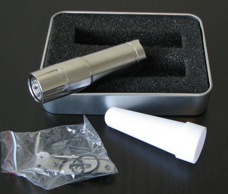

    Packaging is the similar to the T10S - stylish, with a light-weight metal case (no clear display window on my sample, though). Inside, in packing foam, is the light, diffuser wand, extra o-ring, pocket clip with screws and mini-Allen key, and manual.

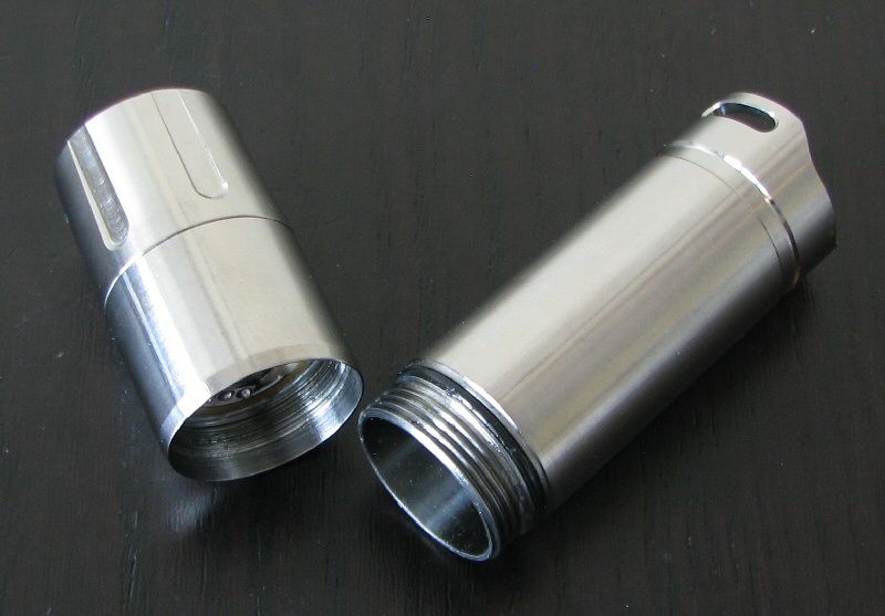

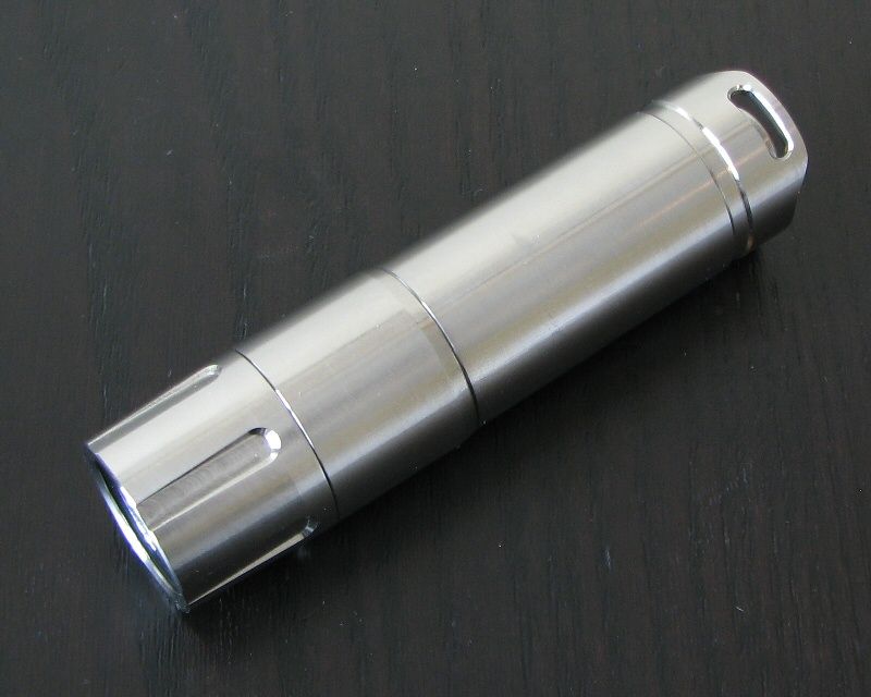

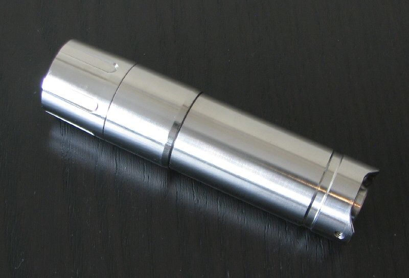

    Like T10S, the T20T has a solid build. Titanium is a lighter and stronger metal than stainless steel. Finish on the titanium model is smooth and shiny (compared to brushed finish on the stainless steel model, and black anodizing on the aluminum). Labels are missing on my sample, but shipping versions should have a simple black "T20T" label (i.e., similar to my T10S). As before, there is no knurling to speak of, but there are fluted ridges on the head. This are sufficient to allow you operate the light one-handed (i.e., you can twist the head one-handed).
    As always, I recommend you install the included stainless steel pocket clip on these models – not only does it help with grip, bit it serves as an effective anti-roll device (otherwise, there is nothing to stop rolling). The clip is not very large, and fairly lightweight, but seems to work alright as a pocket clip. It reminds me a lot of the clip that comes on the Jetbeam RRT-0 - and is similarly fastened by a pair of hex screws.
    While titanium is great for strength and lightness, one of its disadvantages is that you tend to get more "galling" of the screw threads (i.e., titanium doesn't slide over itself as well as other metals). But my T20T sample is surprisingly good in this regard, compared to other titanium lights I've tested.
    This is particularly important on the new T-series lights from Thrunite, as they can still function as a twisty (i.e., contact is only made when the head is fully tight against the body). So as long as you have the tailswitch clicked on, you can mode switch by simply twisting the head (which is feasible single-handed on my T20T).

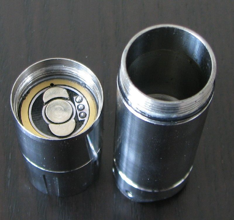

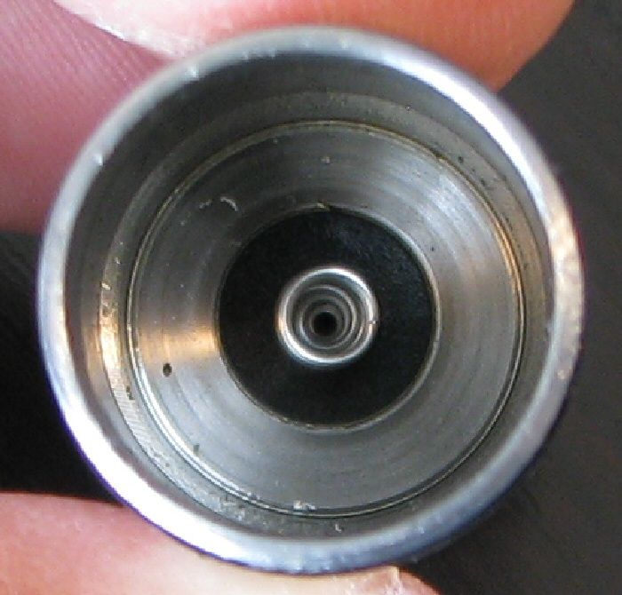

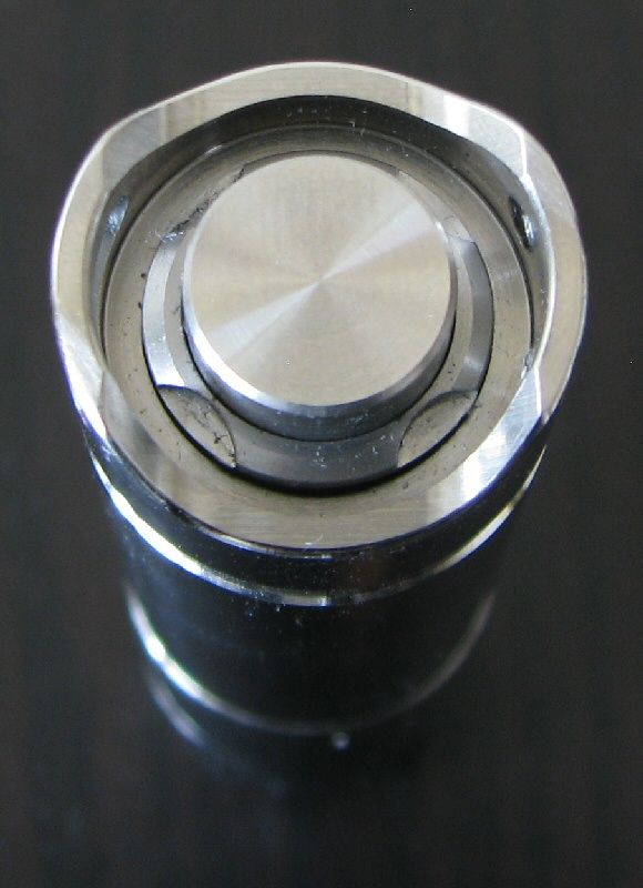

    The physical clicky in the tail is located under a metal boot cover. Switch is the reverse-clicky type (i.e., press and release to turn on/off), however you can change modes by a soft-press. Scroll down to the User Interface section for more info.
    There are raised lanyard attachment points at the base of the tail, with cut-outs. As such, the lights can all tailstand stably. However, the actual switch is still somewhat recessed (due to the low-profile switch and boot cover).

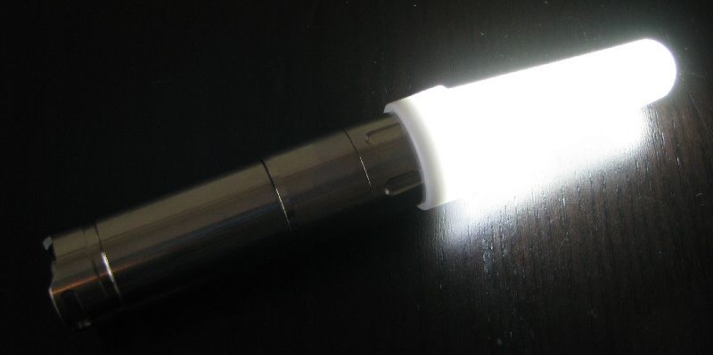

    Like the T10S, the T20T comes with a diffuser wand attachment. This fits securely on the light.

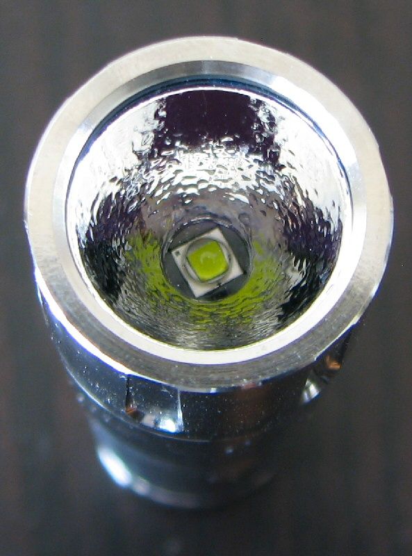

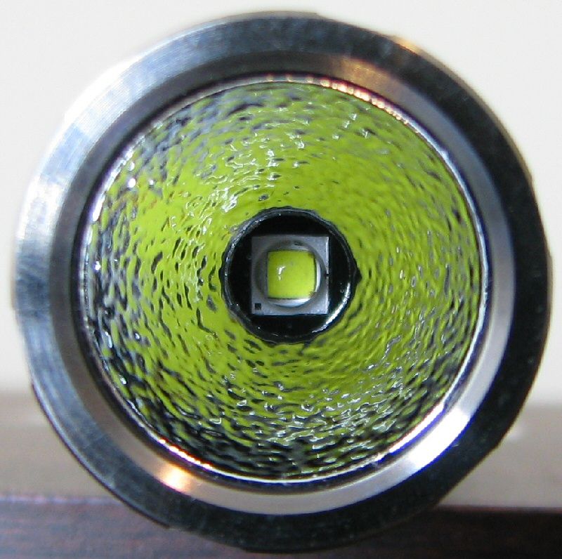

    Centering of the XP-G2 cool white emitter was good on my sample (neutral white is also available). The reflector is reasonably deep for the size, and has an orange peel (OP) texturing to help smooth out the beam. Please see my detailed beamshots later in this review.

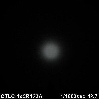

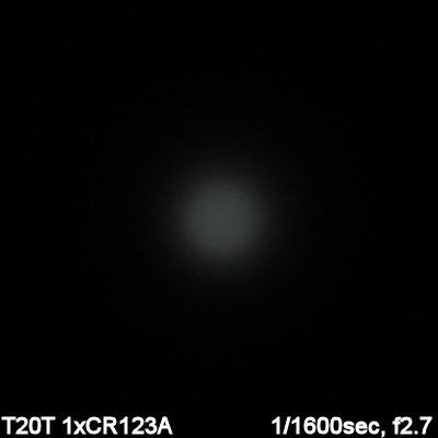

    1xCR123A

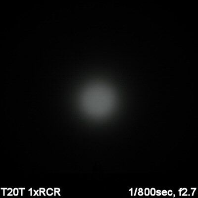

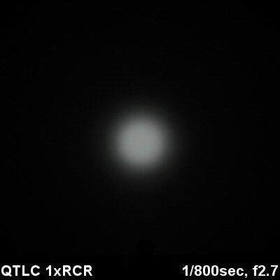

    1xRCR

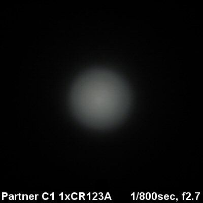

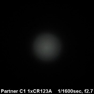

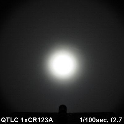

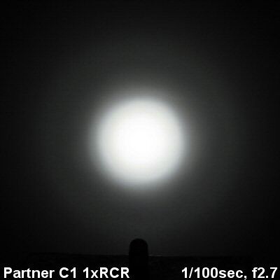

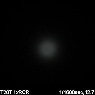

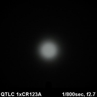

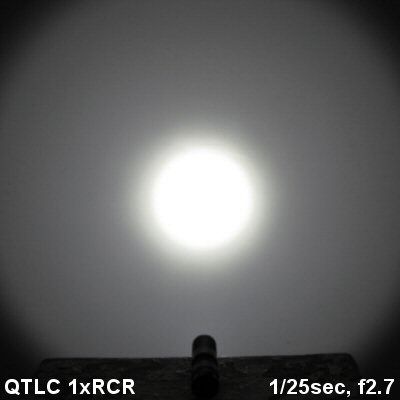

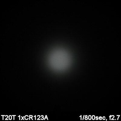

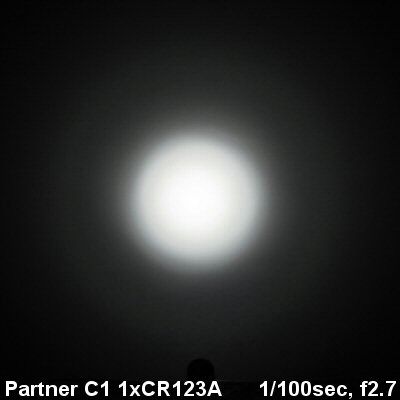

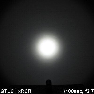

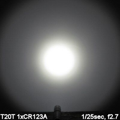

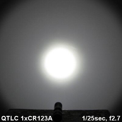

    The T20T has a reasonable beam profile for a 1xCR123A/RCR light. It is a bit "throwier" than the T10S, due to the slightly larger head/reflector. Overall output seems comparable on CR123A and RCR for the T20T - which definitely makes it lower than other recent RCR lights. Scroll down to my detailed testing results.
    The T20T is not driven as hard on Hi as most other lights I've tested. On CR123A, it is toward the low end of the pack (but not unreasonably so). On RCR however, the T20T definitely trails most of the competition. Peak intensity throw is also reasonable, for the size head. Keep in mind that XP-G/XP-G2 lights show lower output than XM-L/XM-L2 lights on max.
    The Lo level is quite low for the class, and is really more of "Moonlight" low level.

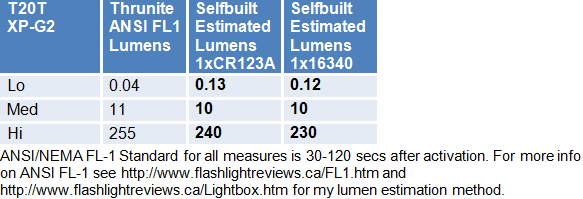

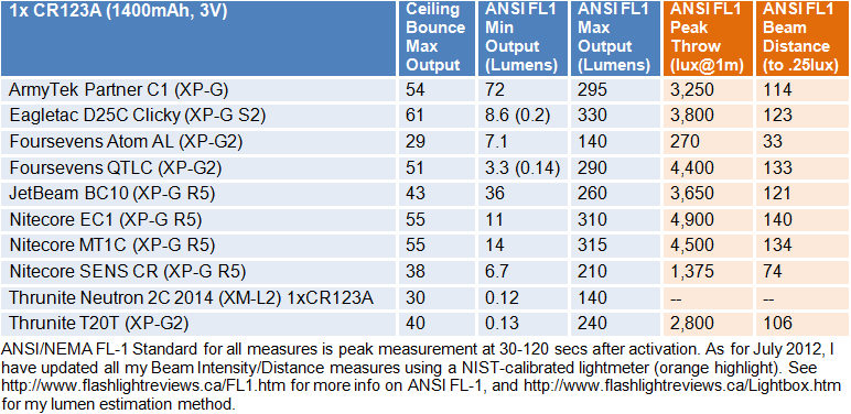

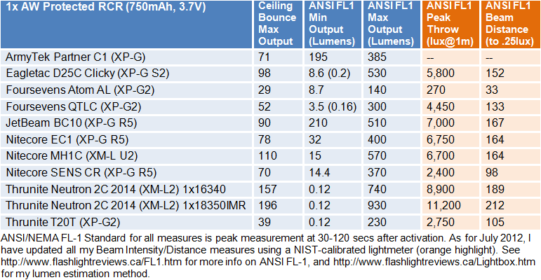

    Let's see an output breakdown for all levels, relative to the specs:
    As you can see, my numbers match pretty well to Thrunite's specs. Again, like the T10S, sequence is more of a Moonlight > Lo > Hi spacing.
    It is interesting that they have managed to keep the output so consistent between CR123A and RCR.

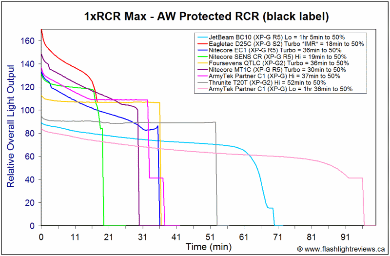

    Runtimes
    Runtime on Hi is lower than other lights in this XP-G/XP-G2 class. However, overall output/runtime efficiency seems excellent. The stabilization pattern is also quite flat on both batteries (which is rare for 1xRCR).

    Titanium lights can suffer from "galling" on the screw threads, but my T20T is surprisingly smooth (i.e., comparable to my stainless steel T10S).

    Max output on 1xRCR is the same as 1xCR123A (and thus lower than most competing lights in this class).

    Well, the T20T on Med on an AW RCR (650mAh) didn't last the night, which pegs the max runtime at somewhere <15 hrs in my case.
    I have just done initial current measures, and get 3.52mA on Lo and 36.4mA on Med. Those would suggest the stated runtimes in the specs are reasonable.
    Default Re: Thrunite T20T (XP-G2, 1xCR123A/RCR, Titanium) Review: RUNTIMES, BEAMSHOTS, VIDEO+
    Holy cow. Interesting! It reminds me of the "inefficient medium and low" portion of your latest EagleTac review, D25 AAA.
