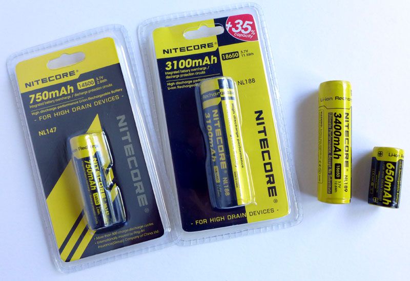

    NITECORE also offer a range of top specification li-ion cells (but no NiMh option at this time). You can go with a single brand solution, with light, cells and charger all being NITECORE, or mix and match any of these components with other manufacturers products.

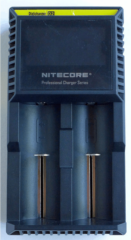

    Starting with the smaller of the two Digi chargers, the D2.
    The photos here show; the packaging, contents, the banner label and screen's protective films being removed, the pristine D2, the screen when powered on but no cells are inserted, a single 18650 showing the voltage, then charging current, adding a second li-ion cell shows its voltage, the finished charging voltage displayed for a NiMh cell (also showing the LOW charge current setting), and the display when all cells being charged have completed.
    A quick look round all sides of the D2.

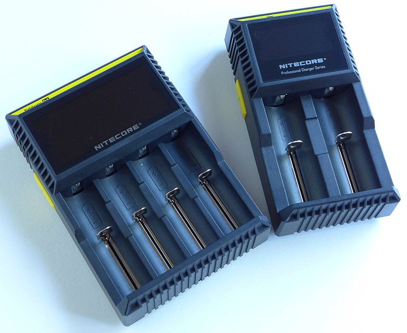

    A quick look round all sides of the D4.

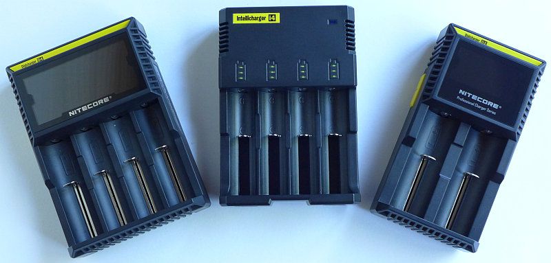

    The new Digi chargers are slightly bulkier and heavier than the earlier Intellichargers. The D4 and D2 are shown here with an i4

    NITECORE's selection of li-ion cells covers most of your needs. All of them are my preferred cell design, having button tops. Using button tops makes them more universally compatible with different lights. Many lights have built-in physical reverse polarity protection, this protection makes the use of flat top cells impossible.
    Though not specifically run through capacity tests, all of the NITECORE cells have performed in accordance with their state capacity in comparative real world use.

    Important update - 26650 Users take note!
    The D2 comfortably takes 2x 26650, however, the D4 does not. In the D4 a single 26650 sits very comfortably in either slot 2 or 3, however you cannot fit a 26650 into both slot 2 and 3 at the same time. Slots 1 and 4 in the D4 just about take a 26650, but the cell can easily pop off the positive contact pad and stop charging.

    I am considering the D2. My 18650 cells are a bit on the long side. From tip of the button to the base is 71.2 mm to 71.5mm.
    I have looked up and down and I found inconsistent comments. One "buyer review" said 70mm, another said 68mm. Can anyone with a D2 measure what is the max cell length that I can squeeze in?
    If max is 72mm, life is good. If it is 70mm, I could repack my savaged laptop cells possibly down to 70mm by removing one of the two 0.3mm insulation layer I put in. But I don't think I could get it down to 68mm.

    Just to add to HKJ's excellent information, I've just measured both bays in my D2 and they were 69.6mm and 69.9mm.
