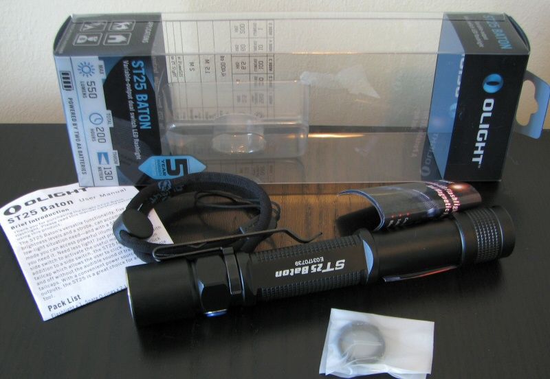

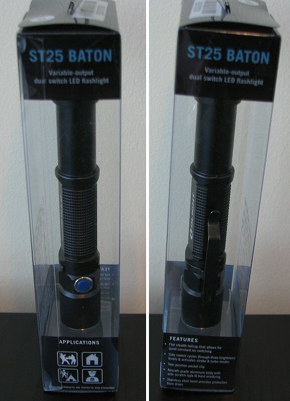

    The retail display packaging is identical to the other recent Olight lights (and bears a close resemblance to the recent Foursevens lights). Specs and performance are printed on the clear plastic box. Inside, you get the light with dual-direction pocket clip attached, wrist lanyard, extra o-rings, product insert and manual.

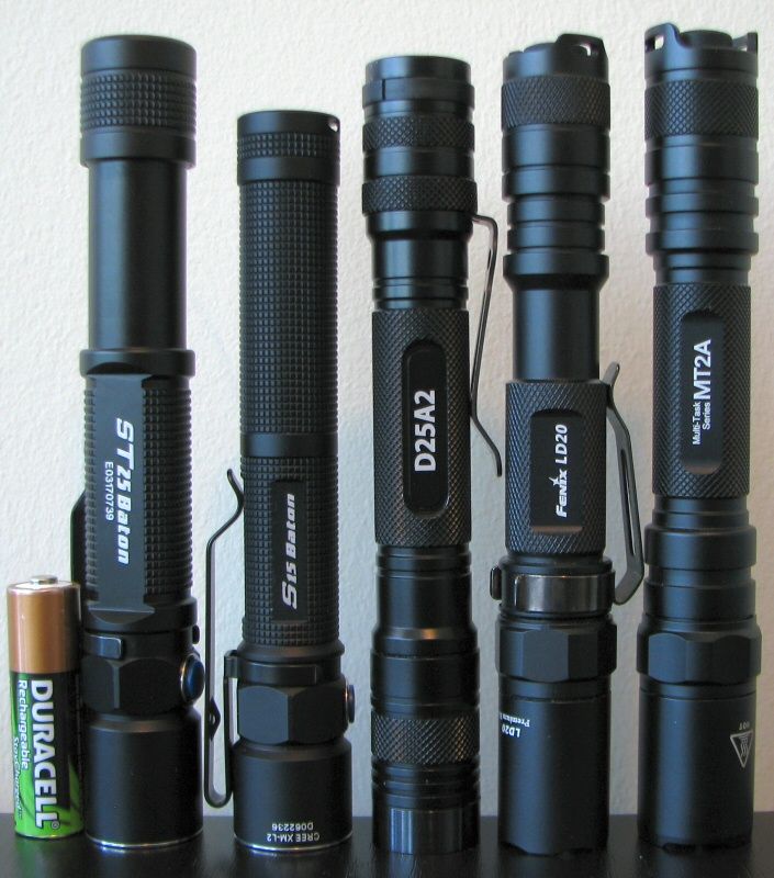

    From left to right: Duracell NiMH AA; Olight ST25, S15 with extender; Eagletac D25A2; Fenix LD20; Nitecore MT2A.
    Olight ST25: Weight: 76.1g, Length: 152.4mm, Width (bezel): 23.0mm
    Olight S15 2xAA: Weight: 59.2g, Length: 137.9mm, Width (bezel): 23.1mm
    Neutron 2A (2xAA form): Weight: 73.46g, Length: 146.2mm, Width (bezel): 25.5mm
    Eagletac D25A2: Weight: 54.8g, Length 148.5mm, Width (bezel): 21.0mm
    Foursevens QAA-2 X (Tactical tailcap): Weight: 60.1g, Length: 149.1mm, Width (bezel) 22.0mm
    Jetbeam BA20: Weight: 70.2g, Length: 156.4mm, Width (bezel) 23.2mm
    Nitecore MT2A: Weight: 66.9g, Length: 154.3mm, Width (bezel):22.7mm
    Nitecore EA2: Weight: 68.9g, Length: 134.4, Width (bezel): 26.1mm
    Sunwayman D20A: Weight 118.4g, Length: 102.6mm, Width (head) 20.9mm, Height (head) 35.1mm

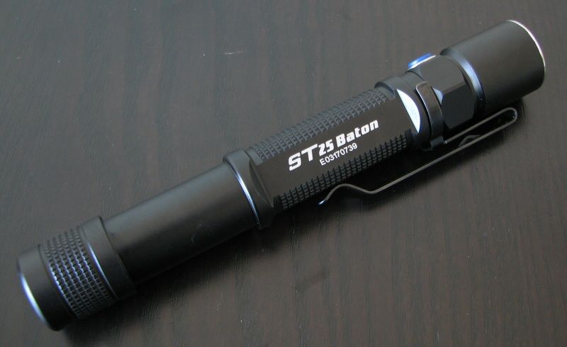

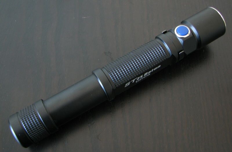

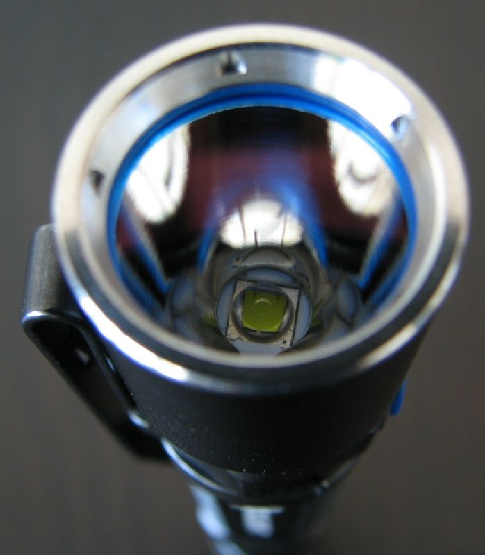

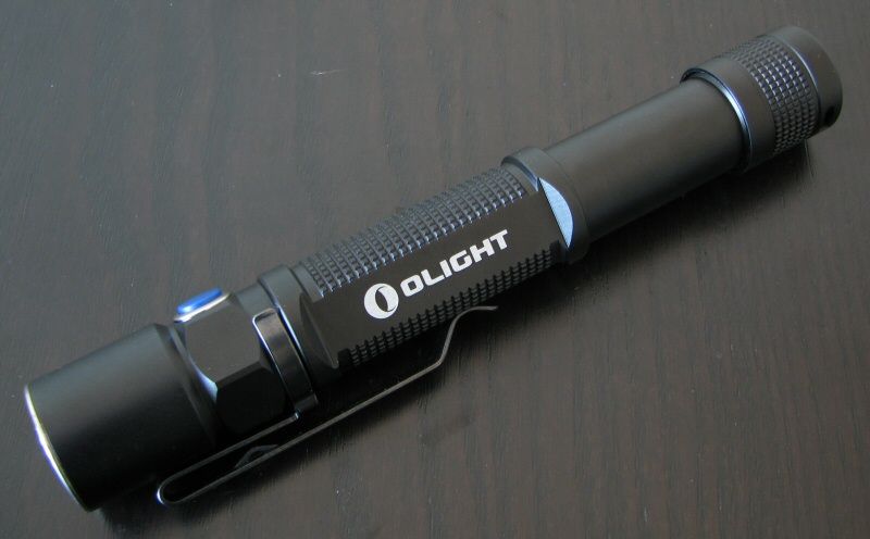

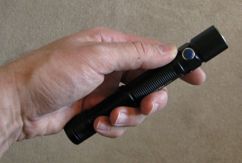

    Physically, the ST25 is a larger light than the S15 (with 2xAA extender rube). As you can see above, it is within the size range of most 2xAA lights. Overall impression is still similar to the other Baton series lights, however, with black anodizing (matte finish) and bright white labels. Although still without typical knurling, the ST25 shares the same raised checkered pattern as on the S15 and other Batons. With the pocket clip attached, I'd say grip is pretty good.
    The pocket clip is comparable to the S15, and seems to hold onto the light fairly securely. I personally like it, as you can clip it on you in either orientation (i.e., bezel-up or bezel-down carry), although it might be rough on clothing given how tightly it fits.

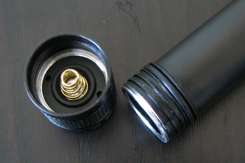

    Like the other Batons, the ST25 uses square-cut screw threads (anodized for tail lock-out, like the other Batons). Light can tailstand, and there is a split-ring/lanyard attachment hole on the side of the tail cap as before.

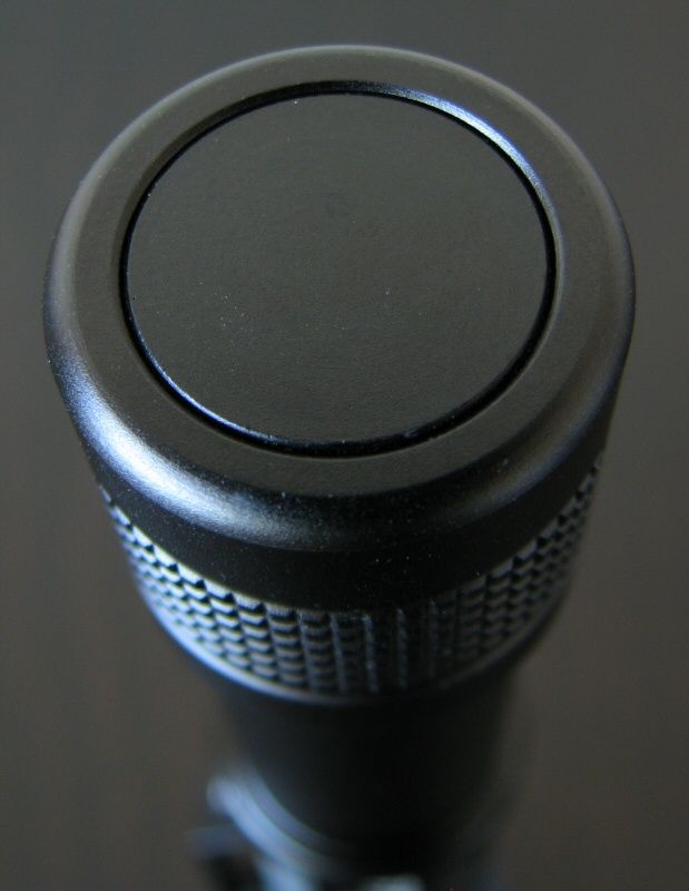

    What's new about the tailcap is the secondary electronic on/off switch. This is recessed slightly at the tail, and functions as a reverse-clicky (i.e., press-and-release to turn the light on or off). See my User Interface section for a greater discussion.
    Main control of the light is through a side electronic switch, as with the other Baton lights. Switch feel is a bit different though, as the ST25 has a more pronounced "click" to it than the earlier Baton series lights I've tested. User interface has been updated from the earlier models (again, see UI section below).
    As with other Batons, the light has a flat stainless steel bezel ring. The o-ring is no longer red (as on the old Batons), but uses the same glow-in-the-dark blue of my recent M18 Striker. Reflector is smooth, and relatively deep. The lens anti-glare coating is also similar to my M18 (i.e., not as pronounced as the old Batons, which tended to introduce some purple/green fringing).

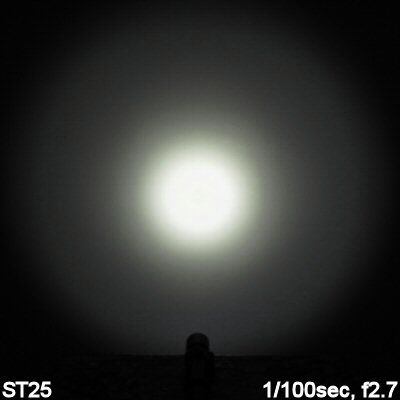

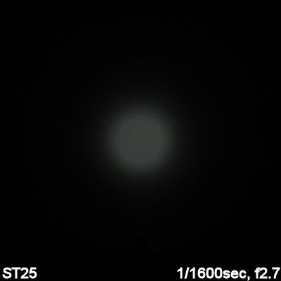

    Beamshots

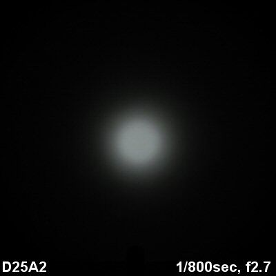

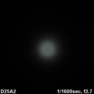

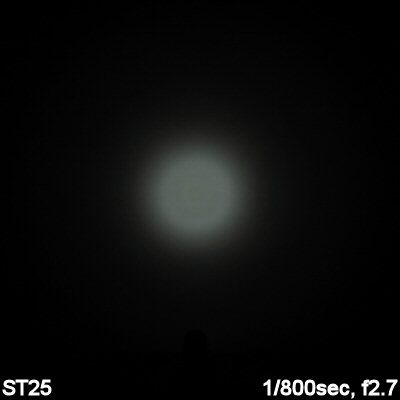

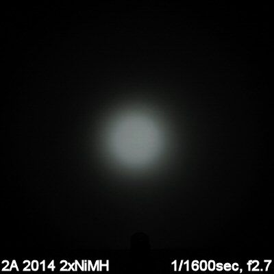

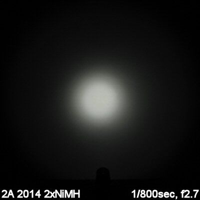

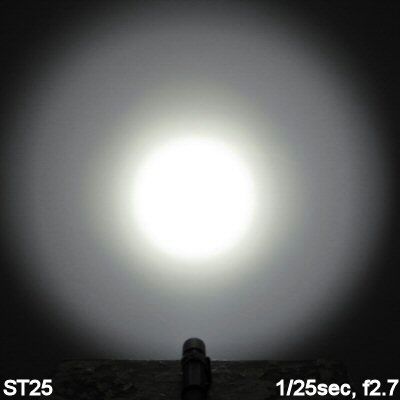

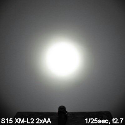

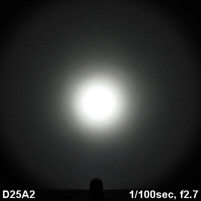

    For white-wall beamshots below, all lights are on Max output on 2xNiM AA (Sanyo Eneloop). Lights are about ~0.75 meter from a white wall (with the camera ~1.25 meters back from the wall). Automatic white balance on the camera, to minimize tint differences.
    There are some artifacts in the beam on my ST25 sample – although this doesn't show up in the up-close beamshots above. But at a distance, the hotspot has a defined outer edge and defined bright middle, with a dark ring between them. There is also a noticeable tint shift, with a relatively yellow-green tint to the center hotspot, and cooler white tint to the outer hotspot ring. The spillbeam is a consistent cool white.
    Note that this is really only visible on a white wall (but unmistakably there). It is likely an artifact of the exact focusing depth of the reflector on my sample.

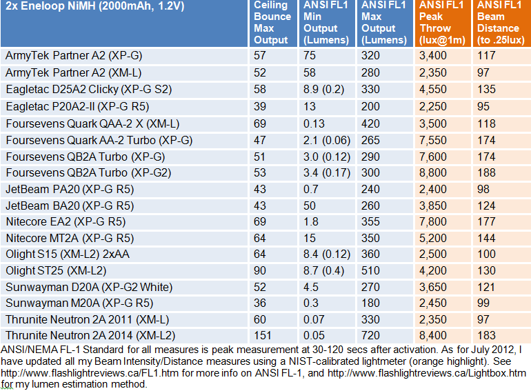

    Throw/Output Summary Charts:

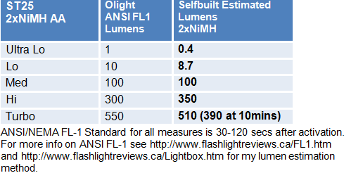

    Although the ST25 is rated as "550 lumens" on Turbo, that is definitely misleading. While the light is >550 estimated lumens upon activation in my testing (on 2xNiMH), it quickly drops off in output. By the time you reach the ANSI FL-1 standard of 30 secs post activation, output was ~500 estimated lumens. And after a few mins runtime, you will be down to <400 estimated lumens. See my runtimes below for more info.

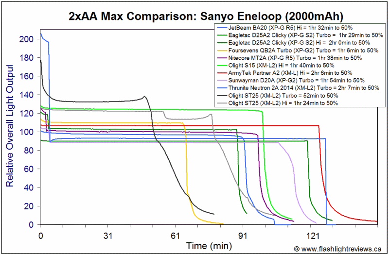

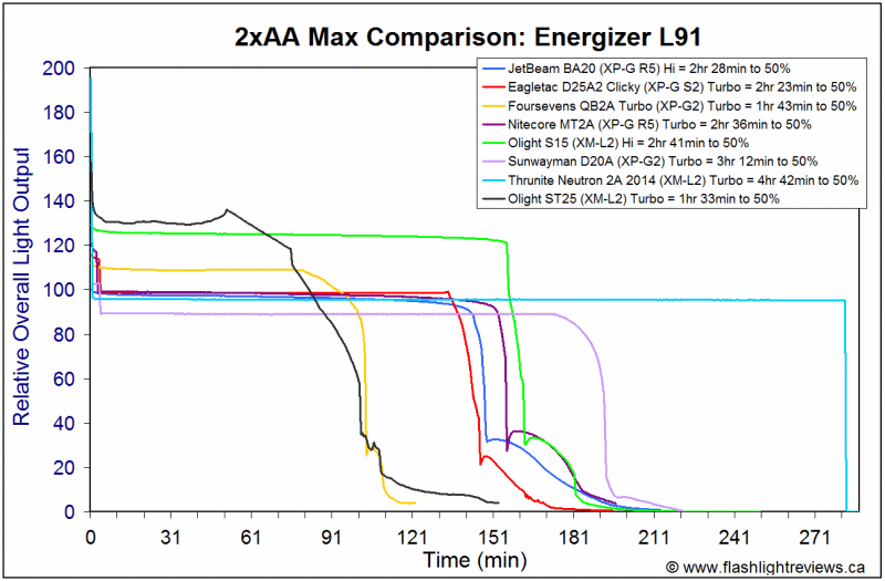

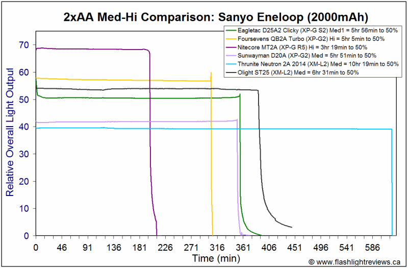

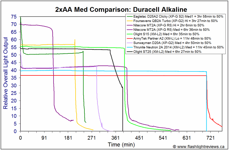

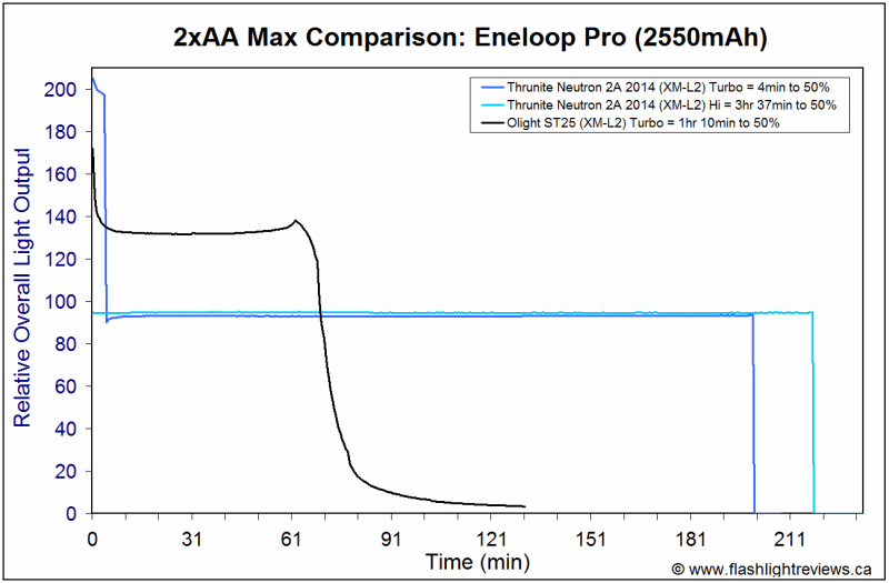

    The ST25 generally shows quite flat stabilization – except on Turbo, where there is a rapid drop-off in output over the first few seconds to minutes.
    Overall output/runtime efficiency is quite good for the class. The ST25 performs comparably to the S15 on Med – but on Hi/Turbo, my S15 was a stellar performer in comparison. The S15 was particularly impressive on Hi on L91 lithiums.
    Turbo is only available from Off (with a double-click), not from the main mode sequence when On.
    Turbo output does not last for long – in my testing, you will only have ~550 lumens for a few seconds at most, even on NiMH. Within a few minutes, Turbo output flattens off at a <400 lumen level (i.e., see my lumen tables and runtimes above). You will also need to use NiMH to noticeably appreciate the initial difference from Hi.

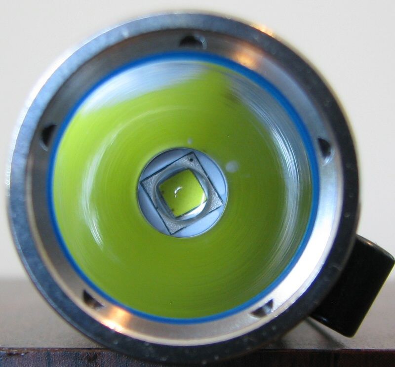

    My ST25 had more pronounced hotspot artifacts than typical in this class (i.e., a well-defined dark ring, with tint shift on either side). This is likely due to the precise depth adjustment of the reflector on my sample.
