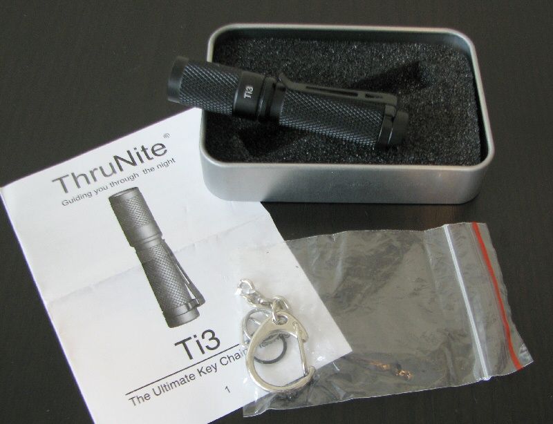

    Packaging is stylish, with a light-weight metal case with clear display window. Inside, in packing foam is the light with pocket clip attached, extra o-ring, split ring, keychain clip, and manual. There is also a little triangular piece of medal that I presume can be used as a linking piece for the keycahin clip - but it seems pretty flimsy, so I recommend you stick with the split-ring.

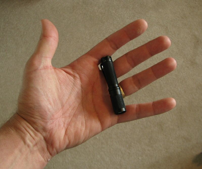

    All dimensions directly measured, and given with no batteries installed.
    Thrunite Ti3: Weight: 11.5g, Length: 69.9mm, Width (bezel): 13.6mm
    Foursevens Preon P0: Weight 13.0g (with keychain clip), Length 55.0mm, Width 12.6mm (bezel)
    Foursevens Preon P1: Weight 15.3g (with keychain clip), Length 75.6mm, Width 14.0mm (bezel)
    Klarus Mi X6: Weight 16.2g, Length 72.9mm (battery installed), Width 12.8mm
    L3 Illumination L08 (1xAAA): Weight: 22.4g, Length: 77.8mm, Width (bezel): 17.0mm
    Lumintop Tool AAA: Weight: 15.3g, Length 82.6mm, Width 14.4mm (bezel)
    Lumintop Worm Aluminum: Weight: 14.3g, Length 72.0mm (battery installed, off), Width 14.1mm (bezel)
    Olight i3: Weight 13.2g, Length: 71.9mm, Width (bezel): 14.0mm
    Titanium Innovations Illuminati Aluminum: Weight 13.9g (with keychain clip), Length 68.8mm, Width 14.0mm (bezel)
    As you can see, the Ti3 is in keeping with other 1xAAA lights that use a similar mechanism.

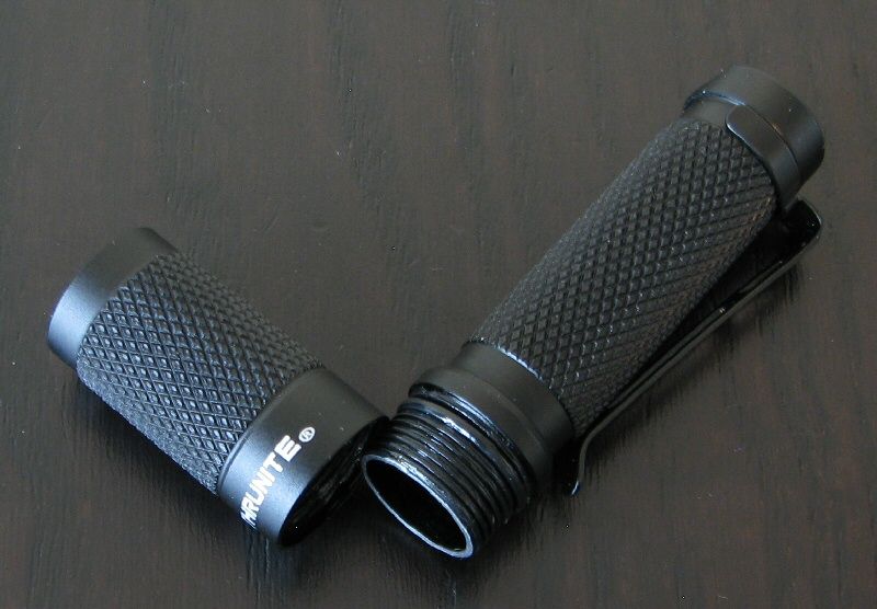

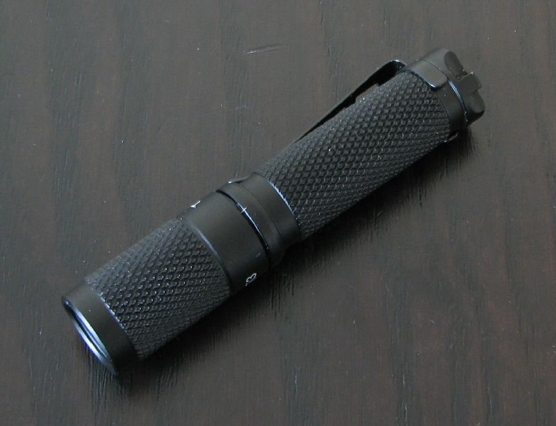

    The Ti3 feels very similar to other lights in this class. My sample came in black anodizing (which, as usual, I don't expect to hold up well for actual keychain use), with bright white lettering. The Ti3 has fairly aggressive knurling on both the body and head to help with grip – much better than most light in this class. It reminds a lot of the old Maratac models. Mode switching single-handed worked fine.

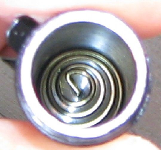

    Screw threads are standard triangular cut, fairly fine (like most lights in this class). You can expect some play, but I found the fit to be good - and better than most lights I've tested in this class.
    There is a circuit board in the head and a spring at the base of the battery tube – as is standard on these sorts of models.

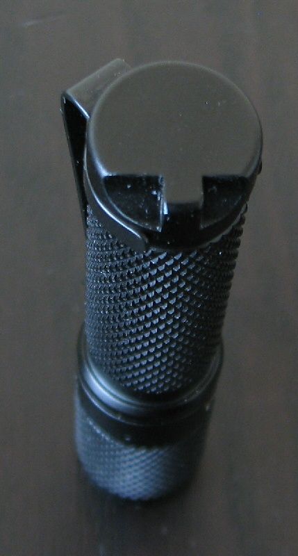

    There is a small attachment point in the tailcap with a cut-out for the keychain split-ring (while still allowing tailstanding).
    The provide pocket clip is fairly basic, but holds onto the light well.

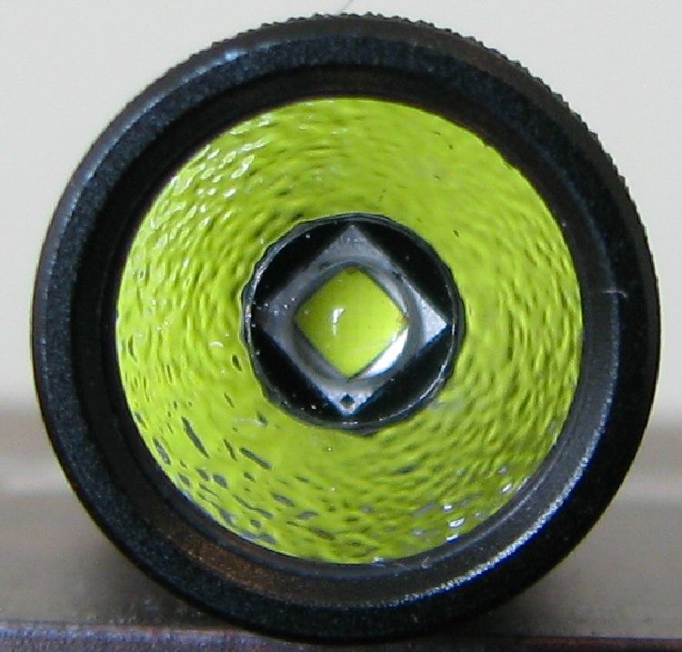

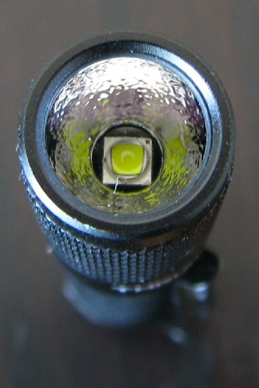

    Centering was good on my sample above – note the XP-G2 at the base of the textured reflector. Please see my detailed beamshots later in this review.

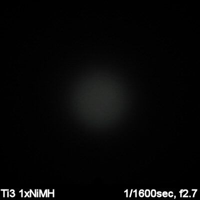

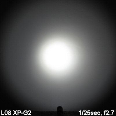

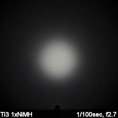

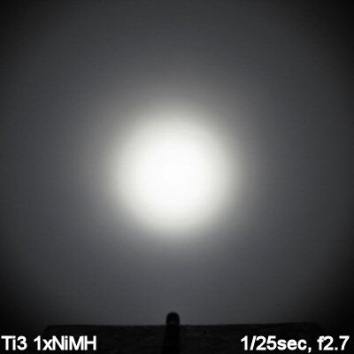

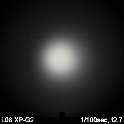

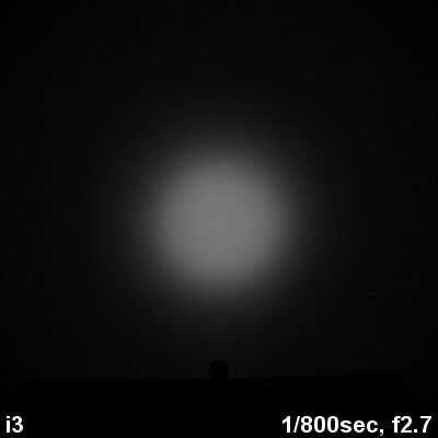

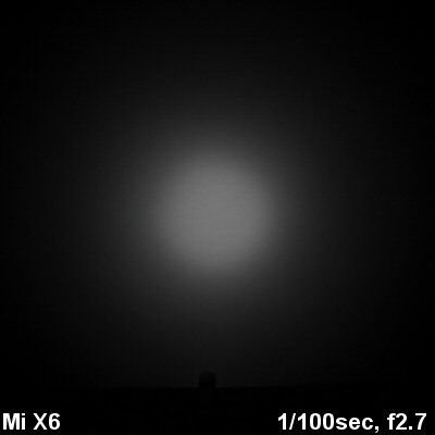

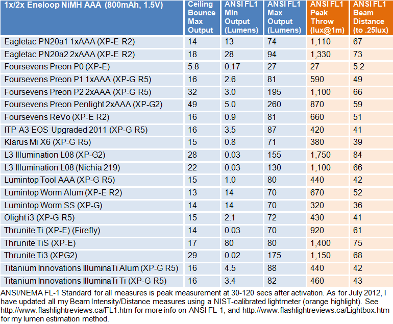

    For white-wall beamshots below, all lights are on Max output on a Sanyo Eneloop NiMH AAA (800mAh). Lights are about ~0.75 meter from a white wall (with the camera ~1.25 meters back from the wall). Automatic white balance on the camera, to minimize tint differences.
    Pretty typical beam for a XP-G2-equipped light of this size.

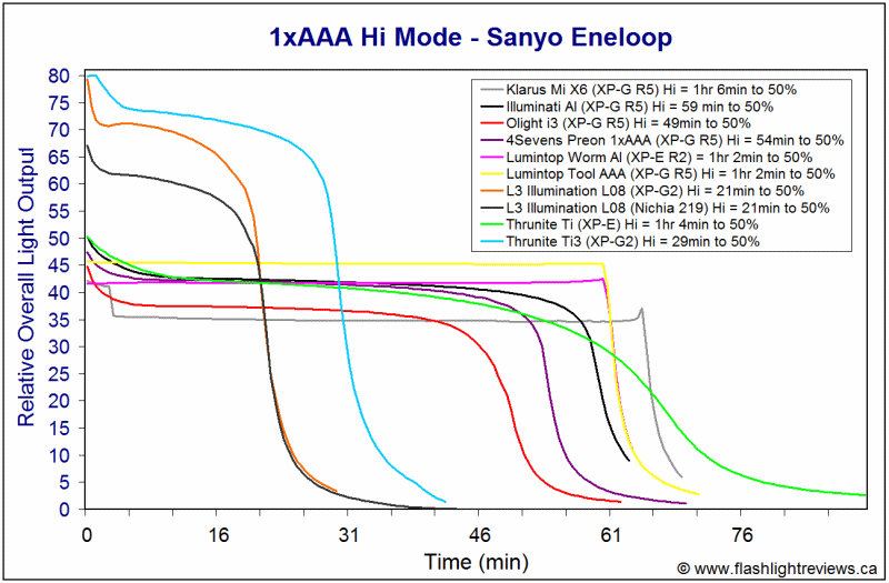

    The Ti3 is remarkably highly driven for a keychain light (on 1x NiMH AAA). Similarly, it's "Firefly" mode is quite low as well.

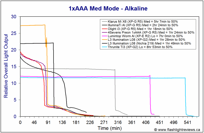

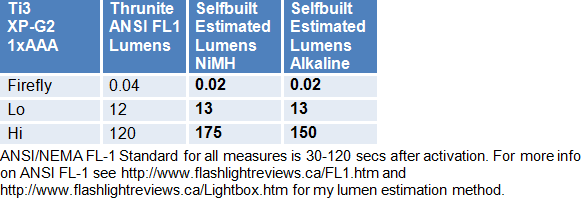

    To give you a better idea, here is a lumen estimate of all the modes, on both NiMH and alkaline:
    The Ti3 is still impressive on alkaline (although note that max output drops rapidly on this battery source – see runtimes below).
    The range of output levels differs from most keychain lights – but makes a certain amount of sense for this keychain class (i.e., Firefly > Lo > Hi). That said, I expect some here would have preferred a more traditional Lo > Med > Hi.
    As always, I don't insist on the absolute value of the lumen estimates in my lightbox. For more info, please see my lumen estimate methodology – including the number of sources used for generating the calibrations. But the relative comparisons are entirely consistent across all my reviews, which is the best that any reviewer can claim (unless they have proper ANSI FL-1 certified, calibrated integrating sphere).

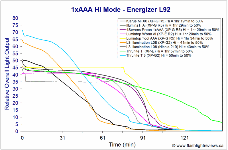

    Runtimes
    Runtime patterns are similar to the L3 Illumination L08 that I recently reviewed – although with slightly higher output and runtime on my Ti3 sample. This makes the Ti3 an outstanding performer for this class (assuming you like the range output levels, of course).
    Output levels are higher (at the max end) and lower (at the low end) than typical for this 1xAAA class. I suspect some would have preferred a more traditional Med mode (i..e., sequence is really Firefly > Lo > Hi).
    Ti3 has a "hidden" strobe mode – although in practice, this means it will take time to activate it when you want it, and you may still accidentally activate on occasion.
    10440 Li-ion is not supported.

    Ok so I finally got my NW TI3. The light is really nice and it's finishing is very good.
    The NW version is definitely much warmer then the tint from the nichia 219 but it still looks very very neutral to me.
    The only negative thing that i can say is that, my light come with it's led very badly aligned. And the beam shows part of the reflector blocking. Just emailed Thrunite, hopefully they can replace my head for me.
    Other then that this light is a must get. Very bright and small!! I would say the NW beam is still very nice and its not pinkish in tinge. Definitely get the NW version if you guys wanna to have a beam thats much warmer as compared to the CW version
    Thanks for the update on the NW emitter.
    It's unfortunate that you a visibly mis-aligned emitter, but does it actually affect the beam? I find small shallow reflectors are typically very forgiving in this regard. Personally, I've never found an alignment issue to cause a significant visual beam distortion on a keychain light (although it certainly can on larger lights with smooth and deep reflectors)
    Apr 2014
    Singapore
    36
    Default Thrunite Ti3 (XP-G2, 1xAAA) keychain light review: RUNTIMES, BEAMSHOTS, VIDEO+
    Yeap it affects the beam to a huge extend. The beam is no more circular, and you can see visible artifacts that doesn't smooth out from the hot spot, I'm thinking it's because of the uneven reflection of light from the reflector.
    Thrunite customer's response team has replied me fairly quickly and had agreed to send me a replacement head so all should be good.
    Nonetheless I really love the tint of the NW version!

    Quote Originally Posted by recDNA View Post
    Great review but I would have liked to see the Tis on that chart as well. Probably just me but I prefer single mode for keychain lights.
    Ok, I've just updated the review with a new ANSI FL-1 Summary chart, to include the TiS:
    Note that I have also updated the Ti entry. I originally reported this model as being ~80 estimated lumens, based on the first sample I bought. However, I have a couple of additional samples on hand (picked up as gifts on a previous batch order) - testing these, I find output actually ranges on Hi from ~60-80 estimated lumens. So I have put the more "typical" 70 estimate in the table for that model.
    If I get the chance to add runtimes for the one TiS sample I have on hand I will, but I don't know if there is much point now that I don't see that model listed on the Thrunite website any longer.
    As an aside, there is also quite a bit of variability in peak throw between the Ti/TiS samples.

    Default Re: Thrunite Ti3 (XP-G2, 1xAAA) keychain light review: RUNTIMES, BEAMSHOTS, VIDEO+
    I just noticed the second chart doesn't show the estimated Medium Mode lumens.
    "To give you a better idea, here is a lumen estimate of all the modes, on both NiMH and alkaline:"
    6,936
    Quote Originally Posted by GordoJones88 View Post
    Sorry, it was there, but accidentally got replaced when I went to update the summary table above. I've restored the table.
