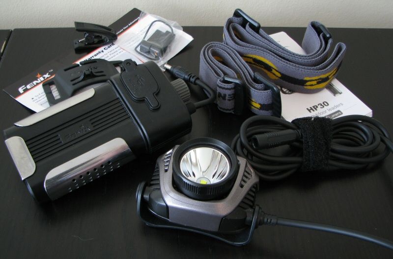

    The packaging is a sturdy box with specs print on the outside. Inside, in cut-out foam, are all the component pieces: headlamp head with cables, head straps, battery compartment, removable diffuser cover (with flip), extra o-rings, headband clips for holding the wire, product insert and multi-language manual.

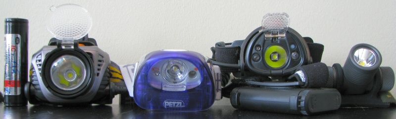

    From left to right: AW Protected 18650 2200mAh; Fenix HP30; Petzl Tikka XP; Olight H15S; Spark ST5.
    All dimensions directly measured:
    Fenix HP30: Head unit alone: 99g, Head unit with diffuser, head strap and wire: 169g, Battery compartment alone: 129.4g, Battery compartment with 18650 batteries 219g, complete unit (with headband, compartment and batteries): 388g
    Nitecore HC50: Weight 85.4g, Length: 86.0mm, Width (widest) 36.4mm
    Olight H15S Wave: (1xLi-ion, 4xAAA): Head alone: 42.2g, Battery compartment alone: 31.0g, Battery compartment alone with OPS-H15S Li-ion battery: 58.3g, Battery compartment alone with 4xAAA: 77.3g, complete unit (with basic headband and Li-ion battery): 118.1g
    Petzl Tikka XP2 (3xAAA): 52.3g, 88.4g with batteries
    Skilhunt H02: Weight: 61.3g, Length: 110.8mm, Width (widest): 28.0mm
    Spark ST5 (1xAA): Weight, 41.5g, Length 58.4mm, Width 42.8mm (max body), Width 24.0mm (bezel)
    Zebralight H31w (1xCR123A): Weight: 28.6g, Length 66.9mm, Width (bezel) 22.1mm.

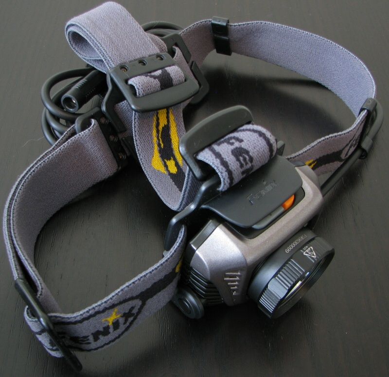

    One of the key points to note above – the headlamp alone weighs much more than typical for this class. This is due to the use of metal in the casing (to provide proper heatsinking). This should allow for sustained higher output performance. Note that overall weight is still fine, as the battery compartment has been off-loaded to the belt-attachement.
    This is a substantial headlamp – and a quality one in my opinion.
    Many headlamps that I have used have a cheap plastic feel to them, which raises concerns about long-term stability. The HP30 feels like what you would expect from Fenix – a solid headlamp unit (with metal components), and good quality head straps. The headlamp angle mechanism is firm, with well-defined detents as you adjust the headlamp relative to its attachment base. Note that there are two body color choices when choosing the model – gray (as shown here) and orange.

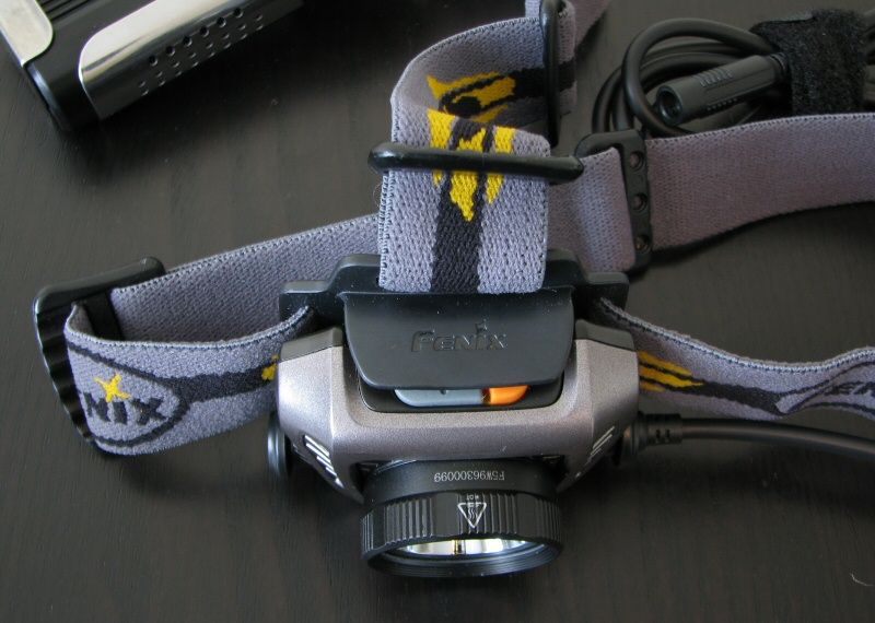

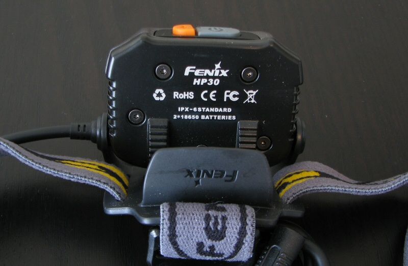

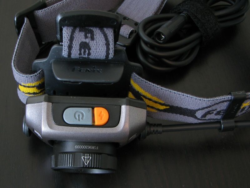

    Controls on the headlamp are easy to access – accept when the headlamp is angled fully straight ahead (there is a plastic "lip" to the attachment base that covers the buttons, presenting accidental mode changes). The rest of the time, there are two buttons – an elongated gray one for on/off and mode level changes, and a raised orange one for momentary Turbo mode. Both are electronic. Scroll down for a discussion of the user interface.
    Given the headlamp nature of the light, it makes sense to me to keep Turbo restricted to momentary access.
    The headband itself is well-made, with good quality stitching. I particular like the nice touches like the extra clips (to keep the power wire under control). The connection point of the wire to the battery pack is solid (although I would have liked a screw-down connector instead of the clip-together style). The wire itself is fairly stiff - a coiled spring-style cable might also have been good, although I found the included length fine for my above-average height.

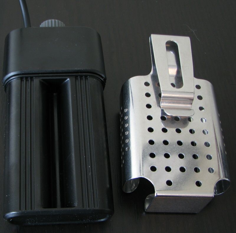

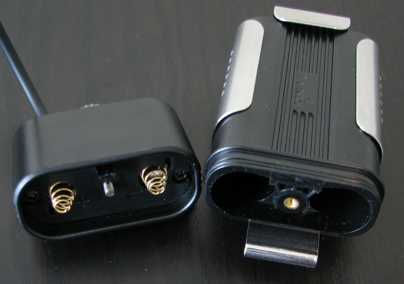

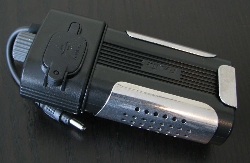

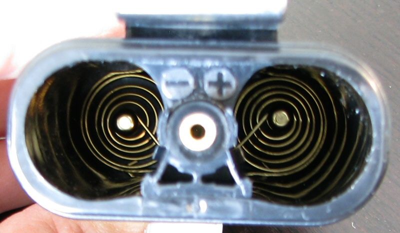

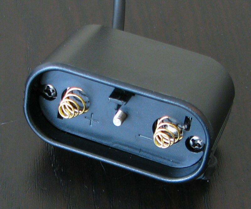

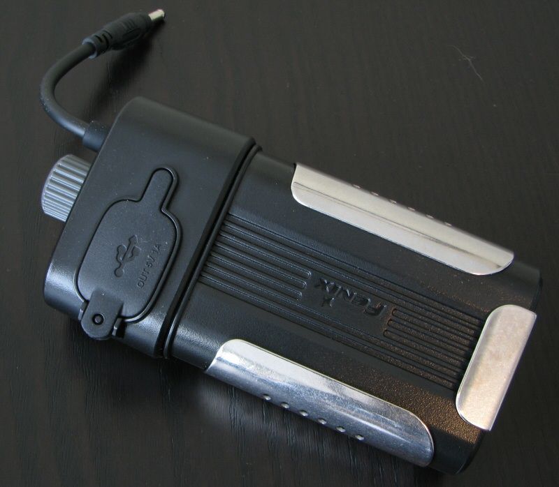

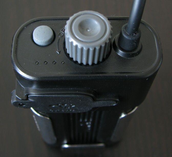

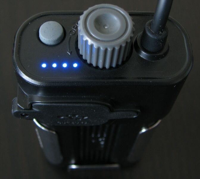

    The 2x18650 battery compartment has been offloaded to a separate belt attachment. Although I suppose you may be able to jury-ring something to the back of the headband, this design is really meant for belt/pocket carry of the battery compartment.

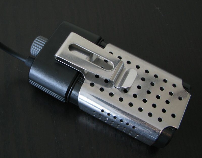

    The compartment is solid, and I like the removable metal holster (i.e., you don't need to use it). One thing to keep in mind is the battery orientation – despite how it looks, the cells are arrange in series. Given the symmetrical design however, you need to make sure you follow the + and – label instructions on the base and head of the compartment when inserting cells. Since the cells can fit either orientation, you run the risk of reversing (or cross-connecting them) if you are not careful.
    There is a central screw on the top cover compartment – this is what keeps the lid tight against the body, allowing contact and operation. Tension can be a bit stiff (especially when using longer batteries), so I recommend you manually hold the lid part down over the bottom compartment when tightening or loosening the screw. There is an o-ring here for waterproofness. Note that I found thicker high capacity cells could be a tight squeeze inside the compartment.
    There is a small button on the head – press it once to display the charge capacity of the installed batteries (1-4 blue LEDs will light up). To use the remote USB-charging feature, press and hold this button for 3 seconds (lights will flash in sequence).

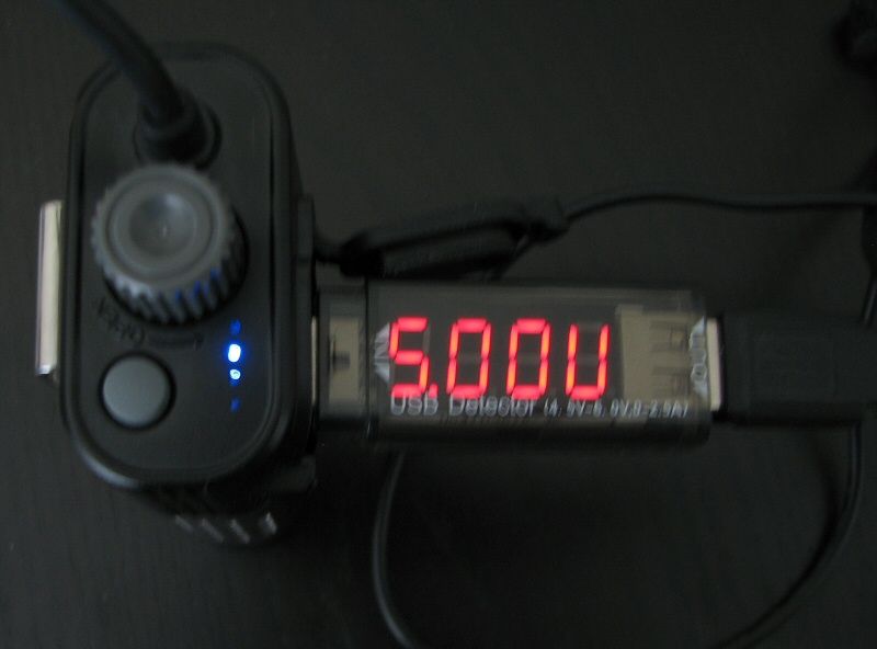

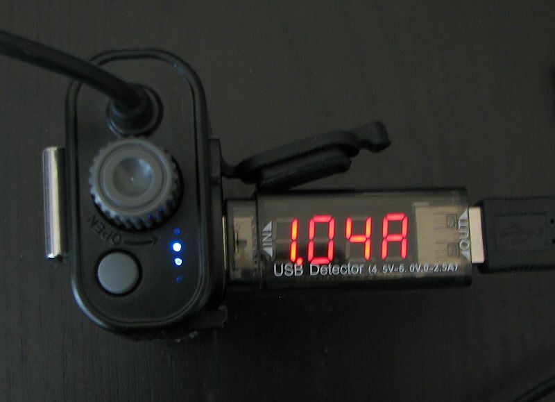

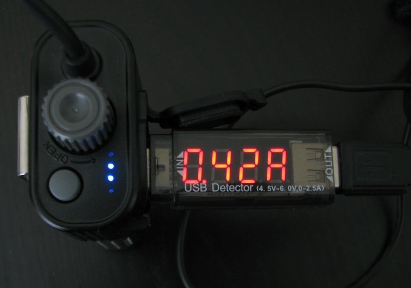

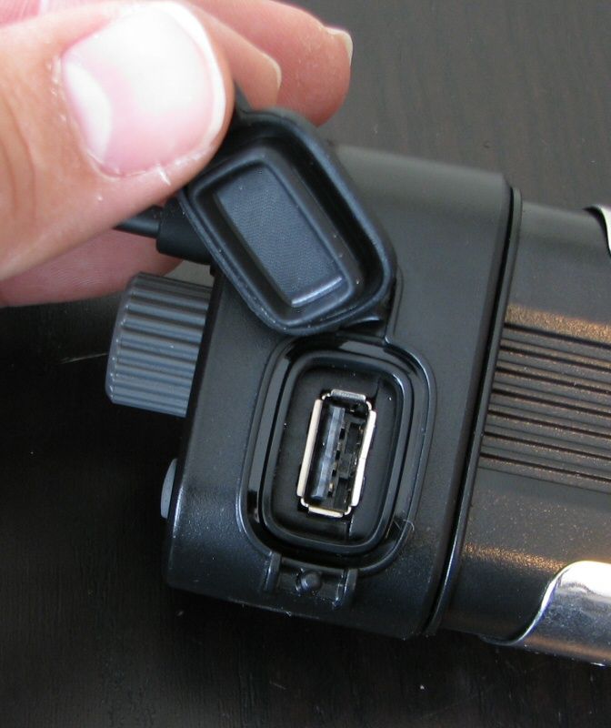

    Under the side-mounted rubber cover on the lid of the battery compartment is a standard USB port. When in the mode to accept remote charging, simply plug any standard USB-rechargeable device.
    As you can see, the battery compartment can easily charge up to the standard USB 2.0 specs of 5V and up to 500mA. This is a great feature if you are in a remote environment and decide that using your cell phone is more important than the headlamp.
    As an aside, there are number of USB charging devices out there that will exceed the USB 2.0 spec, and charge up to 1A (for a faster charge). While I don't recommend exceeding specs, I notice the HP30 will allow charging up to this level on devices that request it:

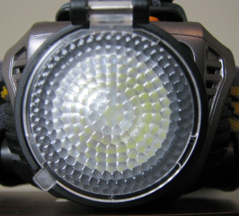

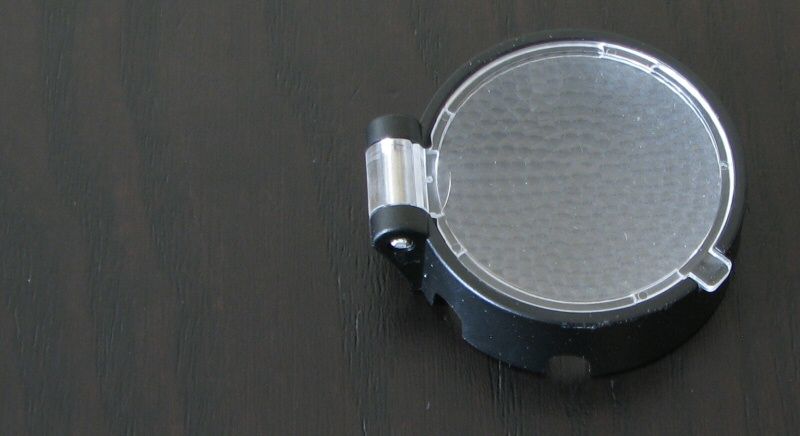

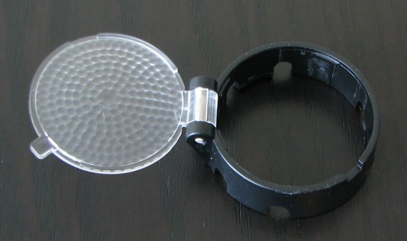

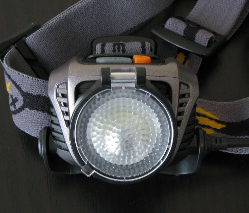

    The HP30 comes with a basic – but functional – flip-style diffuser cover

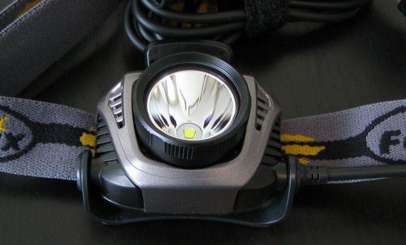

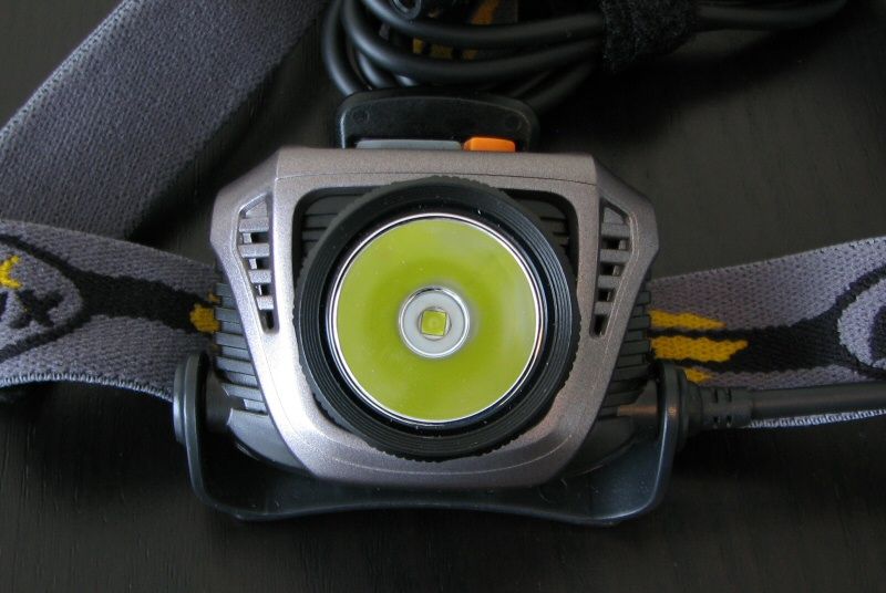

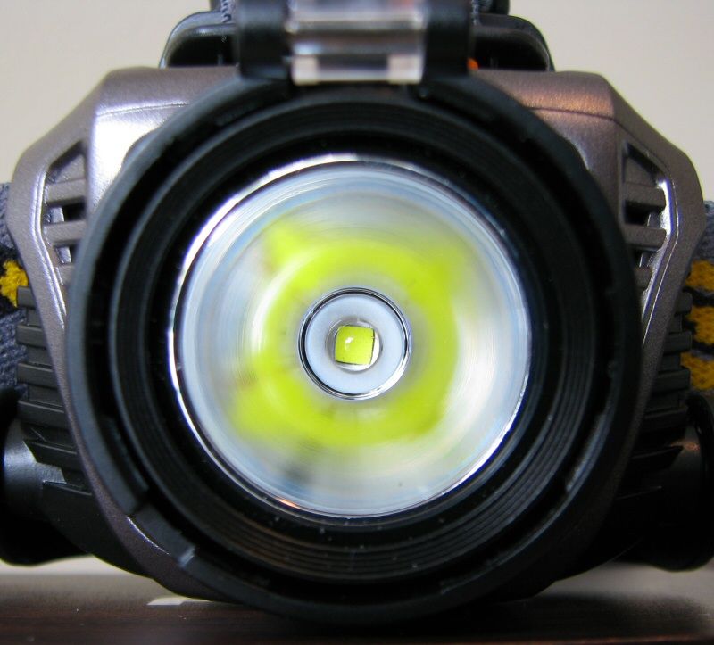

    Let's take a closer look at the business end of the light:
    The HP30 has a good size smooth white reflector, with a cool white XM-L2 at the base (well centered on my sample). Combined with the diffuser cover, you have a lot of flexibility here in the beam pattern.

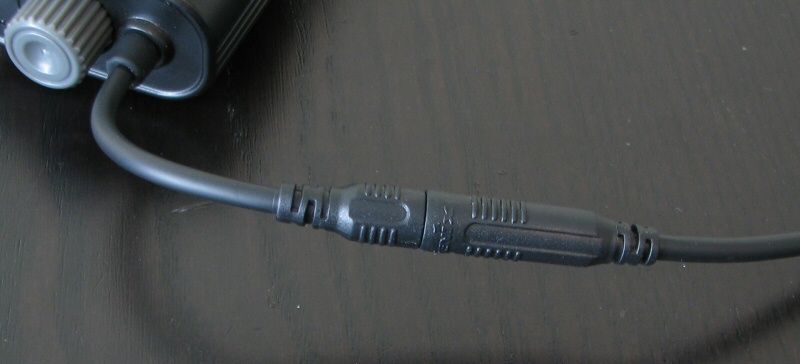

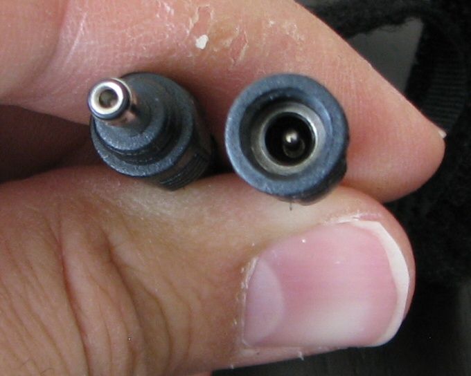

    You can lock out the headlamp by disconnecting the power cable.

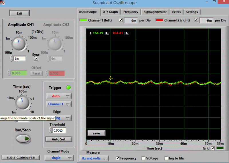

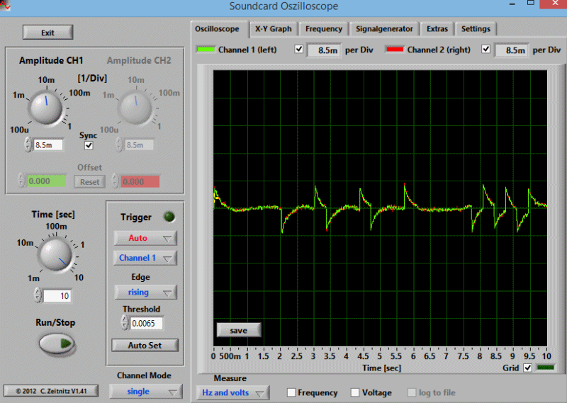

    PWM/Strobe
    Like most Fenix lights, the HP30 is current-controlled – there no indication of pulse width modulation on any level.
    Noise:
    I did observe some faint circuit noise on the Med/Hi levels, but this not visually detectable in the beam. Again, it is quite common to see circuit patterns on current-controlled lights. Consistent with my standard review policy, I report on anything I can measure. But rest assured, it is not PWM, and it is not visible (i.e., the HP30 is fully flicker-free in all modes).

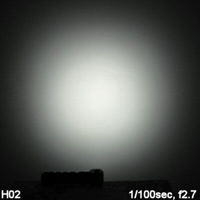

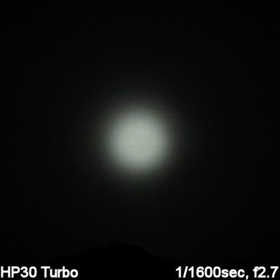

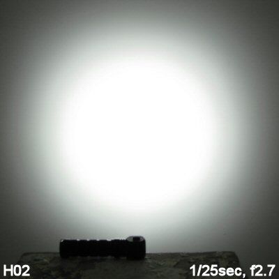

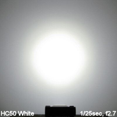

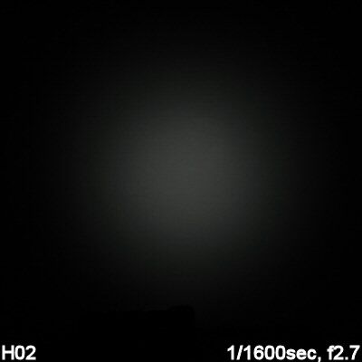

    Beamshots

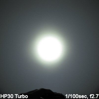

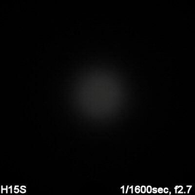

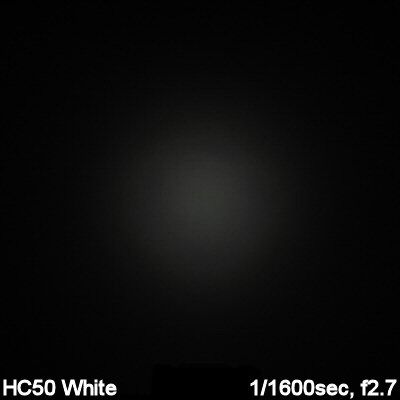

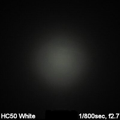

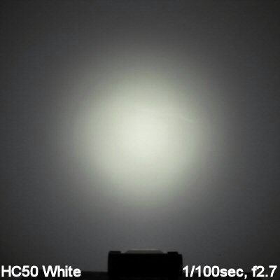

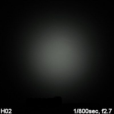

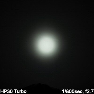

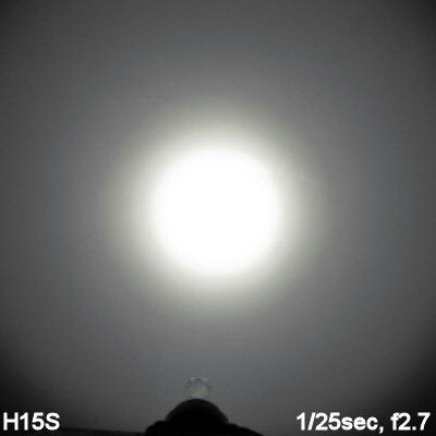

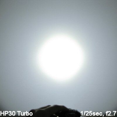

    For white-wall beamshots below, all lights are on Max output on their respective battery source (AW protected 18650 for the HP30). Lights are about ~0.75 meter from a white wall (with the camera ~1.25 meters back from the wall). Automatic white balance on the camera, to minimize tint differences.
    Note the HP30 is on its highest level for these beamshots (i.e. Turbo).

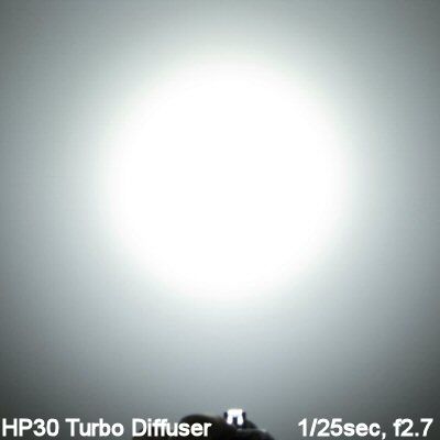

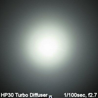

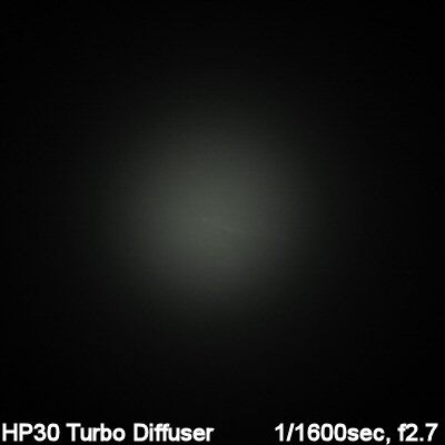

    Let's start with a comparison with and without diffuser:
    Due to up-close distance, this doesn't really show off the diffuser well. In real life, it provides a fairly typical level of diffuse white light.

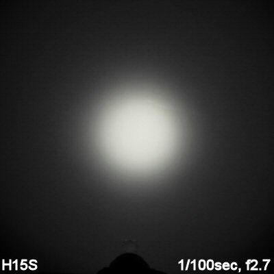

    And now a comparison to some headlamps I've tested:
    The HP30 is clearly capable of greater max output than the other headlamp models tested above. It is also a lot throwier without the diffuser cover in place.
    Scroll down for actual beam distance and output measures.

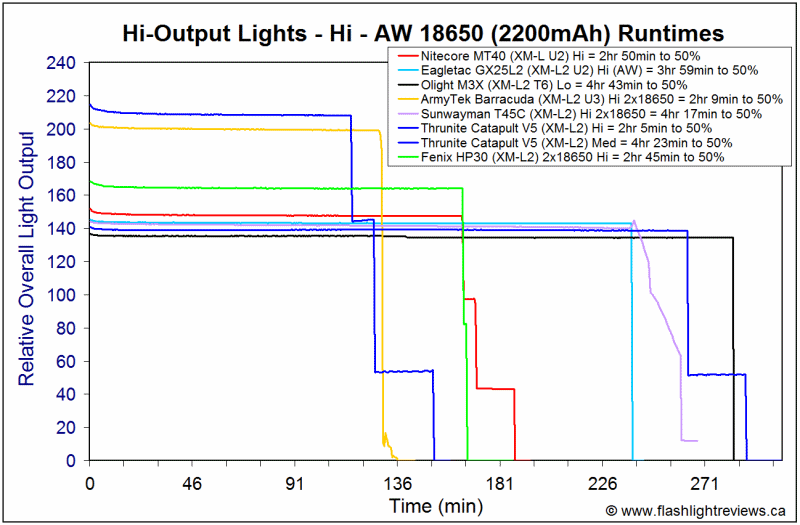

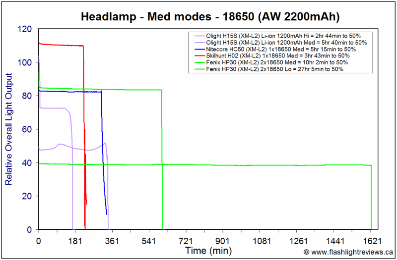

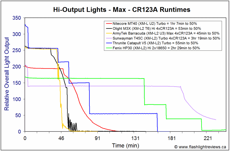

    Runtimes

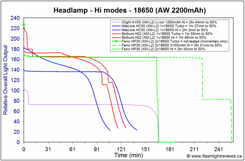

    All my 18650 runtimes are done on AW 18650 protected 2200mAh cells. All runtimes are done under a cooling fan.
    Let's start with a comparison to other recent headlamps I've tested:
    I've thrown in a protected NCR18650A (3100mAh) on the Hi mode run above for comparison purposes. Note that I haven't done a Turbo run, as this is a momentary-only mode.
    Max levels (i.e. Turbo and Hi) are consistent with other 18650 headlights. But of course, runtime (and flat regulation) will last for a lot longer on the HP30, thanks to 2/4x batteries. There are defined step-downs to lower levels as the batteries run out of power, giving you plenty of advance warning to change batteries.
    Overall output runtime efficiency seems excellent. But to really compare, I'll have to bring some other 2x18650 lights into the mix:
    As expected, the HP30 output/runtime efficiency is consistent with an excellent current-controlled circuits.
    Due to the use of 2x18650 (allowing for higher output and greater runtime), the relatively heavy battery compartment has to be carried separately from the headlamp unit. This means that there is a necessary cord running between the two units. The cord is fairly stiff on my sample, but long enough to be used comfortably at my 6-foot-2 height.

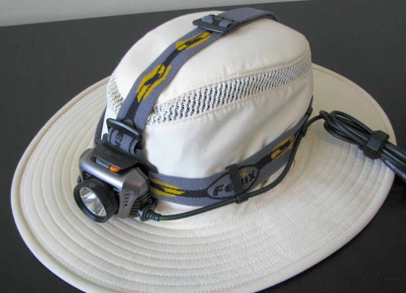

    May I ask what hat you have there and where I might purchase something similar?

    That's actually a Tilley hat, about a decade old now. It's the "Airflow" model, still in production AFAIK. It's different from the standard Tilley hat as the Airflow breathes a lot better and is ultra-light - but very durable (all nylon and polyester construction). It is also has a wider brim, with a sunshade undercoating. It's great for hot and humid environments with a lot of sun (washes up great too, as you can probably tell from the photo).
    Thank you very much! Just what I need for my fishing trip in December where the temperatures climb over 50.

    Thanks for the review Selfbuilt! I've had one for a few months now and adding my "hard core" perspective would say I don't necessarily agree with this part:
    Fenix puts out some incredibly cheap and fragile headlights - most "waterproof" Fenix HL certainly are not "the wet kind of water" proof for example. The HL 30 is better than other Fenix HLs I've had though, so I would generously grant them the label "Not as cheap/fragile as our other lights" but I certainly would not call the HP30 "solid."
    Some critiquing points:
    - Lamp itself is very light weight and feels pretty cheap to me; nothing like an Army tech for example.
    - Went on a 2 hour night jungle bike ride just last night - light gets extremely hot and uncomfortable on the forehead on just MEDIUM mode (I'd never leave it on high 550 lumens for an extended period.)
    - Lots of sweaty runs (admittedly a tough test) and I haven't figured out how to keep the strap in place - if you run lots at night you'll be fiddling with the strap lots. The top strap seems to vibrate/wiggle it's way around as you run stretching one half of the horizontal strap and bunching the other half up. If someone has found a way to reloop it that works better I'd love to see that and am open to the possibility there is a way to improve the strap with some sewing "engineering" skills! I've got an old Petzl head lamp that has spoiled me; no modern headlamp strap I've seen comes close to it in terms of comfort, staying in place, ease of changing sizes and durability.
    - Of course it is nice to have the run time of 2 18650's and to be able to get rid of the weight on the head but this does seem to take longer than it should to get all set up. It certainly is a pain in the jungle with the cable. It feels weird next to my skin under my shirt but it catches on stuff all the time if it is out.
    - The USB charger I really like [Edit: removed]
    - Xstar 3400 work but are extremely tight and though not hard to shove in can be a real pain to get out; I don't know if those batteries are wider than they should be - just wanted to give a reference point on how the batteries fit.
    What I like I about it:
    - The beam; I need throw and though there are lots of other 900ish lumen Headlamps out there there aren't many that can hit 15,000 lux!
    - When I want flood, the diffuser makes for one of the nicest floody beams out there. (I'd be really curious Selfbuilt how many lumens the diffuser robs? No matter - even if it takes 1/2 thats still lots of lumens when you consider how nice the beam is.)
    - I think the (2) 18650's is a great idea for a light this size; it takes a while to set up if you're going on a bike ride/hike for instance but once you got it set up you can use some serious light all night long.
    - Hitting the battery button and seeing how much battery is left is a great idea that keeps me from charging batteries unnecessarily or going out with a light about to die. However I haven't found the 4 led lights to be consistent. Once it goes down to 2 lights left you're almost out NOT just 1/2 way thru the battery life.
    Maybe I can agree with you Self built that it is a good and solid Fenix light...
    for $90.
    I'd be happy to pay $250 for a "real solid" light like this though. This light with:
    - better heatsinking to sustain the higher modes.
    - better strap/head band in league with an old Petzl light.
    - Mode buttons easier to find; I'd love a turbo button on the battery holder or inline with a GITD button!
    - Eco to moonlight - though I must say this is one of the lowest Fenix settings I've had.
    - higher quality/better connecting cable. The present one is really stiff making it hard to work with.
    - Wouldn't mind having the ability to use both a smaller rechargeable battery on the light and/or the big battery pack!

    Quote Originally Posted by rickypanecatyl View Post
    The USB charger I really like but I get really inconsistent results with how much power it puts out. I use it on my Sony Xperia on which I have a battery monitoring widget that tells me what is going in to the battery, and in battery saving mode, dim screen, fully charged 18650's and nearly dead phone battery it ranges from -200mA to +7xxmA. (My phone is consuming +/-400 mA in that state so -200mA means 200 mA is going in if I understand it correctly.)
    I wouldn't trust those measures. To start, I really doubt your phone is consuming 400mA when doing next to nothing. What happens when you use the widget with the phone charging on an actual computer USB port?
    It can be difficult for a device that is consuming power - while simultaneously charging - to give any sort of accurate readout of the input charge current. I've tried a bunch of widgets/apps on a few phones, and only the one specific for my current Samsung model seems to be at all reasonable or accurate. The USB-based dongle that I have works a lot better to give a reliable measure of current flowing through. I have tested it on three modern cell phones, and it gives exactly the same consistent reading on the HP30 battery pack as it does on my computer's USB ports (which is invariably in the 400-500mA range, depending on the phone model).
    Default Re: Fenix HP30 (XM-L2, 2x18650/4xCR123A) Headlamp Review: RUNTIMES, BEAMSHOTS + more!
    Thanks for pointing that out - you are absolutely right! I'm testing my "Battery Monitoring Widget" now and numbers are everywhere. They update about every 30 seconds or so and here's what it is reading for "Battery flow" with my phone battery charged 85%:
    Wall charger: +255mA
    Unplugged: -492/305/591mA
    Plugged into computer: +274/224/91/209/57mA
    (Battery level now at 86%)
    Unplugged: -644/424/290mA
    Plugged into Fenix HP30 battery pack: -77mA/+323mA/299mA
    I was out of line to criticize the battery pack as a back up battery source without knowing what I'm talking about and so I apologize to Fenix for that!! I'll edit my post on that.
    I actually put the battery monitoring widget on my phone as there were several times I was fairly confident my 18650's were fresh in my Fenix Battery pack but I couldn't charge my phone or Garmin with it or a monkey power bank I have. I do believe faulty intermittently working cables have been a source of the problem as well as the issues in the phone itself receiving a charge after getting wet.
    Now I can add to my unknown variables widget may not be accurate AND I don't know how widget is supposed to be working when it is working!
    Yeah, those are both likely issues as well - water damage does seem to specifically wreak havoc on cell phone charging systems (has happened to my son a few times). And now that I have my USB current detector dongle, I can see that certain computer ports and/or USB cables are not the most reliable for providing the full charging current.

    Is it possible to charge the battery in the belt-compartment in any way?
    Or do i have to take them out every time?
    I hope that my English isn`t to crappy?
    6,936
    Quote Originally Posted by Volvo View Post
    No, there is no in-compartment charging option. You will need to take the batteries out and charge them in a separate charger.
    And I understand you just fine.

    We used the HP30 for a night kayaks my adventure this weekend. Battery life wasn't even close to advertised. I was using Olight 3400mAH 18650s and didn't get more than 1.5 hours out of them.
    6,936
    Quote Originally Posted by GulfCoastToad View Post
    Were you running on Hi? My tested runtimes on 3100mAh were ~3:45 on Hi (and another ~30mins on Med after step-down). And that is what I would expect for that output level. Did you check the battery voltage before loading them up? Something is not right.
    No I did not check the voltage. I was camping. I just need the stupid thing to do what it says it will do, whether it's a battery problem or one with the light.
    6,936
    Well, you presumably charged the batteries before going camping, which is why I asked in order to help you troubleshoot. And there is a battery charge readout feature right on the light, which can be used in the field.
    I can understand your frustration of it not matching your expectations, but in this case it is most likely that the batteries were not fully charged before you went to use the light.
