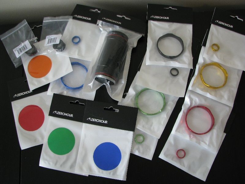

    • Included (XD): Flashlight, Stainless steel bezel, Spare O-rings, USB power adapter, USB charging cable, Carrying bag, Flat cap (2), Open end cap, Carabiner cap, 3x 3400mAh 18650 batteries
    • MSRP: XD: $225, with 3x 3400mAh batteries (X: $155 for flashlight only)

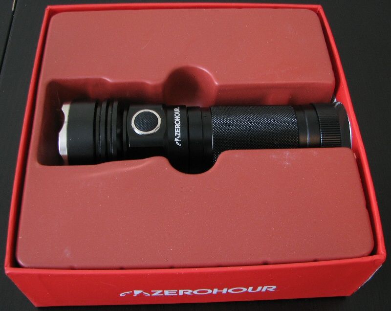

    As you can see, the ZeroHour comes in quite the presentation style box, with lots of display windows and specs printed right on the box. Not to mention extras …

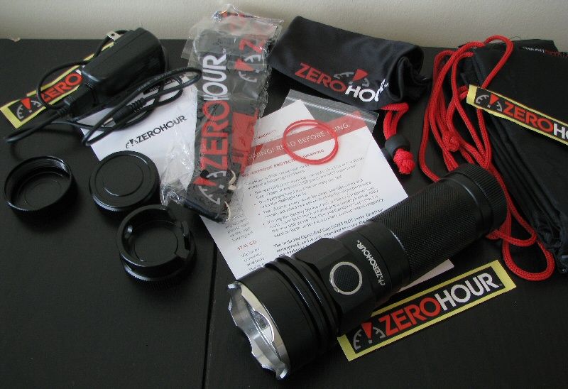

    My XD version of the ZeroHour comes with all the main accessories for the flashlight, including USB-AC power adapter with removable USB cable, spare o-rings, large nylon carrying bag, small microfiber carrying bag, neck lanyard with break-away clip, two flat cap tailcaps, one open end cap, one double-ended cap, one carabiner cap, 3x 3400mAh batteries, manual, stickers, and quick-start card.
    Note that by default the ZeroHour comes with a shiny stainless steel bezel ring and switch ring. Sold separately, ZeroHour also sent me an extra body tube, switch ring removal tool, copies of all the various color stainless rings (red, green, blue, gold, and black), as well as red, green, blue and amber filters (to place over the lens to change output color).

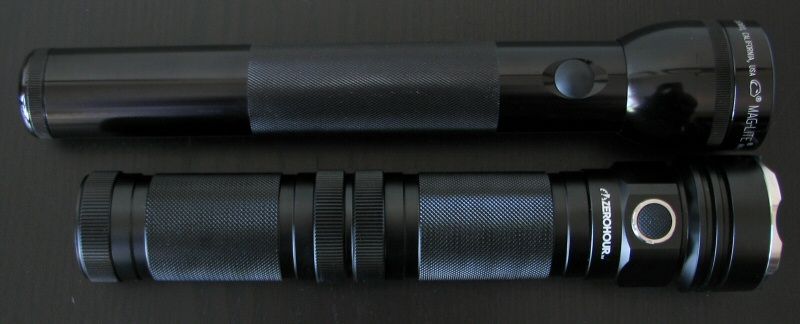

    From left to right: AW Protected 18650 2200mAh; ZeroHourXD; Olight SR52, SR Mini; Powertac X3000; L3 Illumination X40.
    ZeroHour (open tailcap): Weight: 387.5g (531g with 3x3400mAh 18650), Length: 173mm, Width (bezel): 58.0mm
    ArmyTek Barracuda (XM-L2): Weight 400.8g, Length 264mm, Width (bezel): 64.0mm
    Eagletac SX25L3: Weight: 315.9g, Length: 150.2mm, Weight (bezel): 47.0mm
    Fenix TK61: Weight: 605.7g (790g with 4x18650), Length: 218mm, Width (bezel): 96.0mm
    Niwalker BK-FA01 (XM-L2): Weight: 682.3g (864g with 4x18650), Length: 209mm, Width (bezel): 80.0mm, Width (tailcap): 50.3mm
    Olight SR52: Weight: 396.7g (497g with 6xCR123A), Length: 162mm, Width (bezel): 63.1mm
    Olight SR Mini: Weight: 285.5g, Length: 126.9mm, Width (bezel): 48.1mm
    SupBeam K50: Weight: 645.0g, Length: 230mm, Width (bezel): 90.1mm
    Thrunite TN32 (XM-L2): Weight: 655.9g (808g with 3x18650), Length: 201mm, Width (bezel): 79.0mm

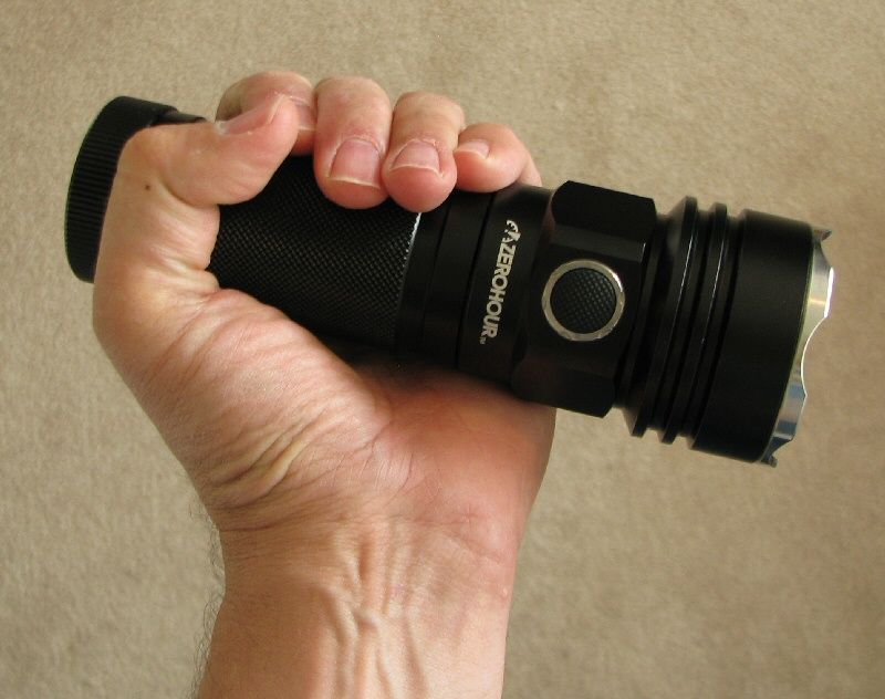

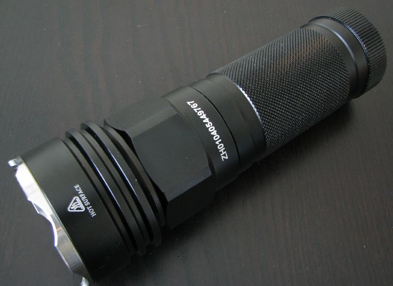

    The Olight SR52 is probably the closest overall comparable, in size and design – although there are some extra features with the ZeroHour. Build is of a reasonable size for 3x18650, with a good size head. The ZeroHour feels solid and more substantial than some lights in this class.

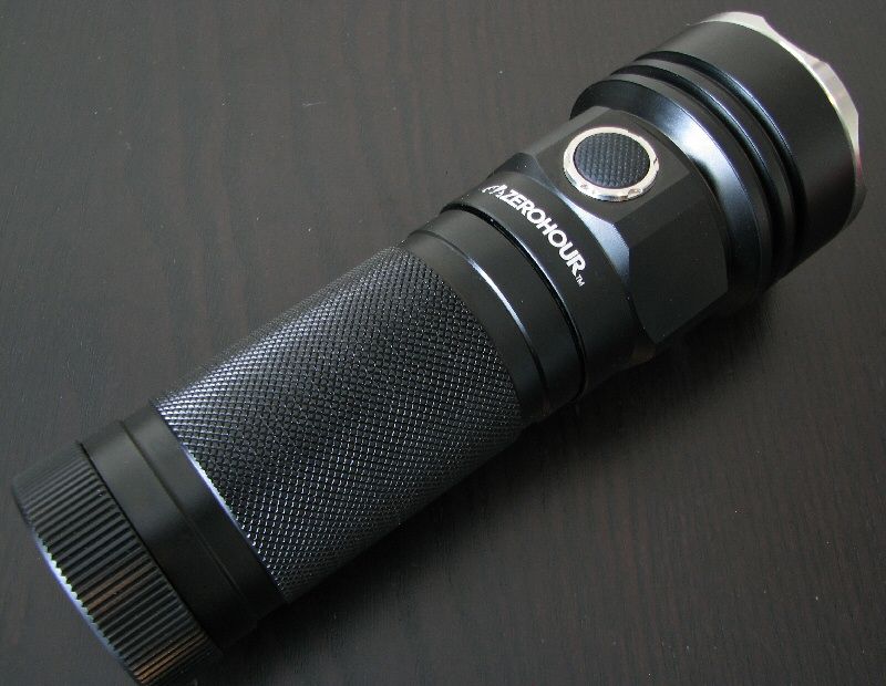

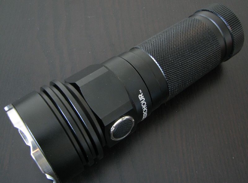

    Anodizing is somewhat glossy, black finish. Knurling on the battery handle is fairly mild, but there are some grip elements in the head, making overall grip pretty good. Body labels are minimal, with bright white lettering.
    The switch is raised with a rubberized cover, making it easy to find by touch alone. Switch feel is good, with a firm click and typical traverse.

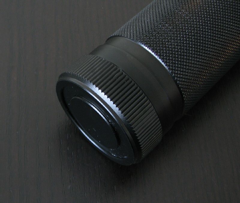

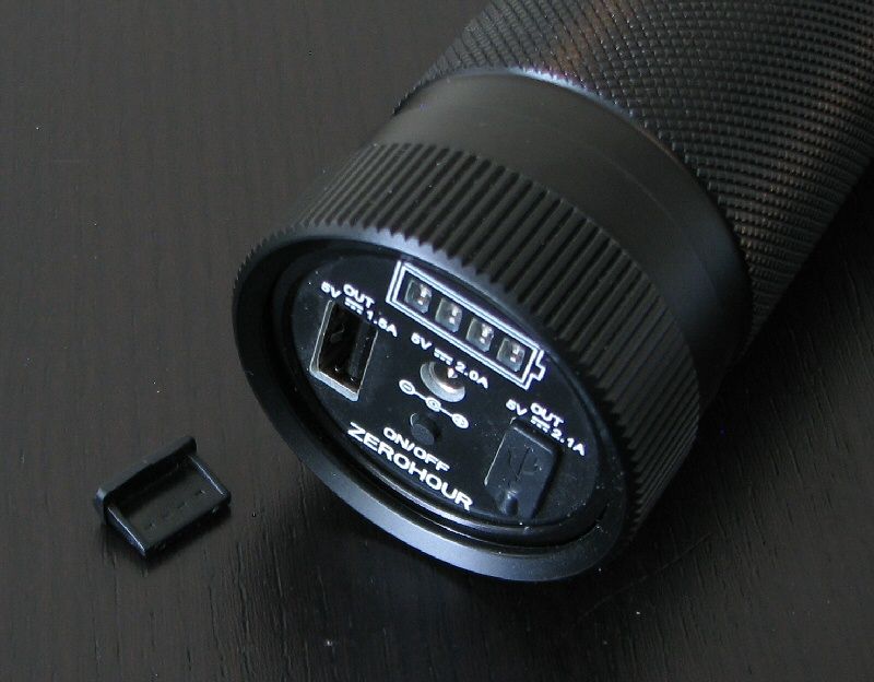

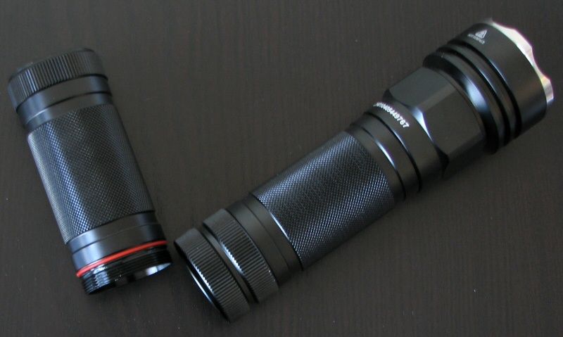

    Let's look at some of the tailcap options:

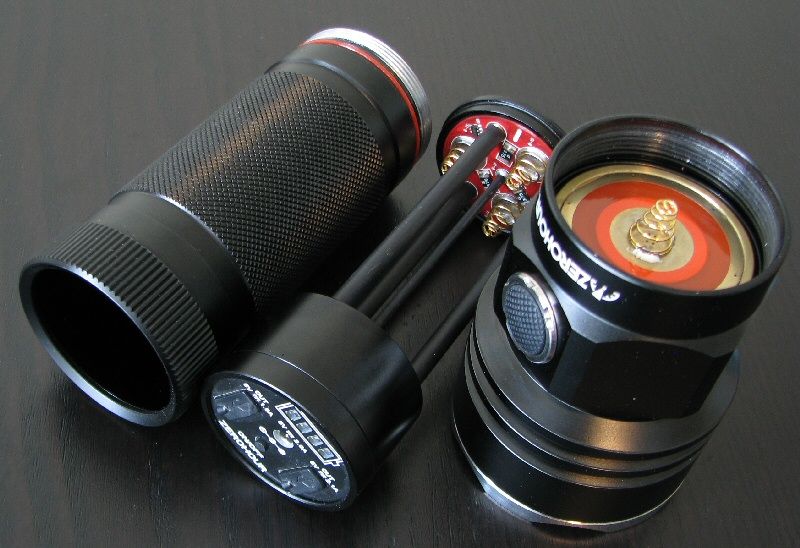

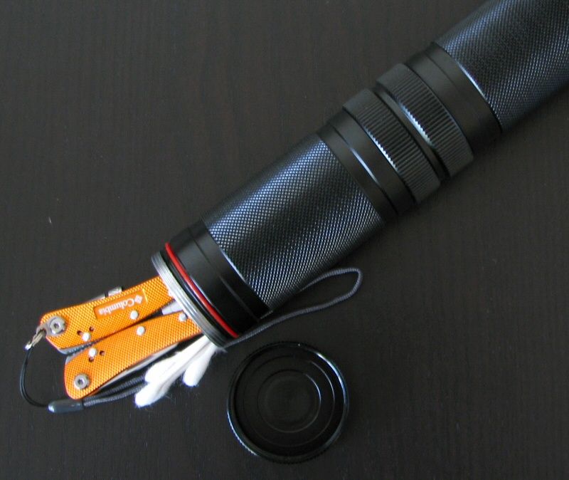

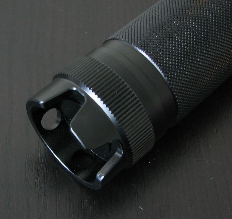

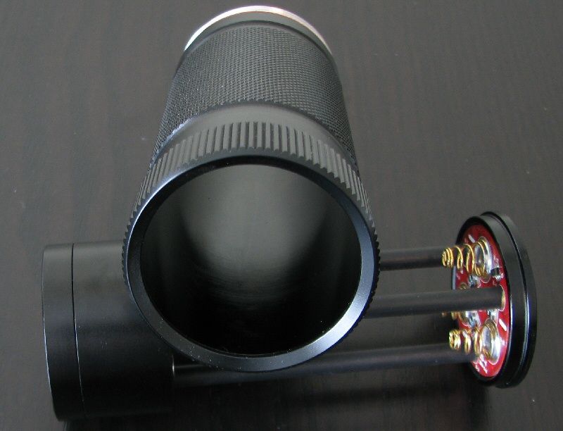

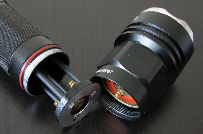

    The light only opens at the head – the integrated battery carrier slides in from this end. But there are a variety of tailcap options included in the package. Threading is identical at both ends of the battery tube (standard triangular cut).
    UPDATE SEPT 18, 2014: ZeroHour has just clarified for me what the point is of the double-ended tailcap. It is apparently an extender cap so you can extend your ZeroHour body tube (but in a compartmentalized way). Note that this doesn't allow you to double the connected cells - but it is a way to attach an additional body tube that you can keep sealed at both ends, like so:
    The point to this is that you could stuff whatever you wanted in the additional waterproof body tube - extra cells, bandages, water purification tablets, etc. And then have access to them by opening the tube up at whichever end you like.
    Think of it as an extended handle for additional carry items in a waterproof container.

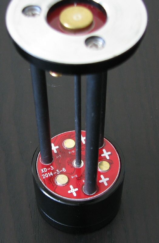

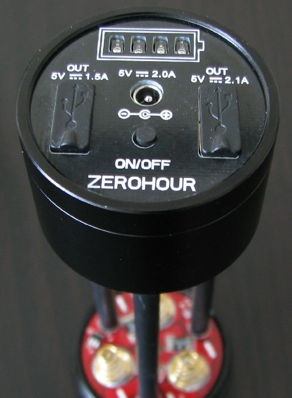

    Let's take a look at the back of the battery carrier:

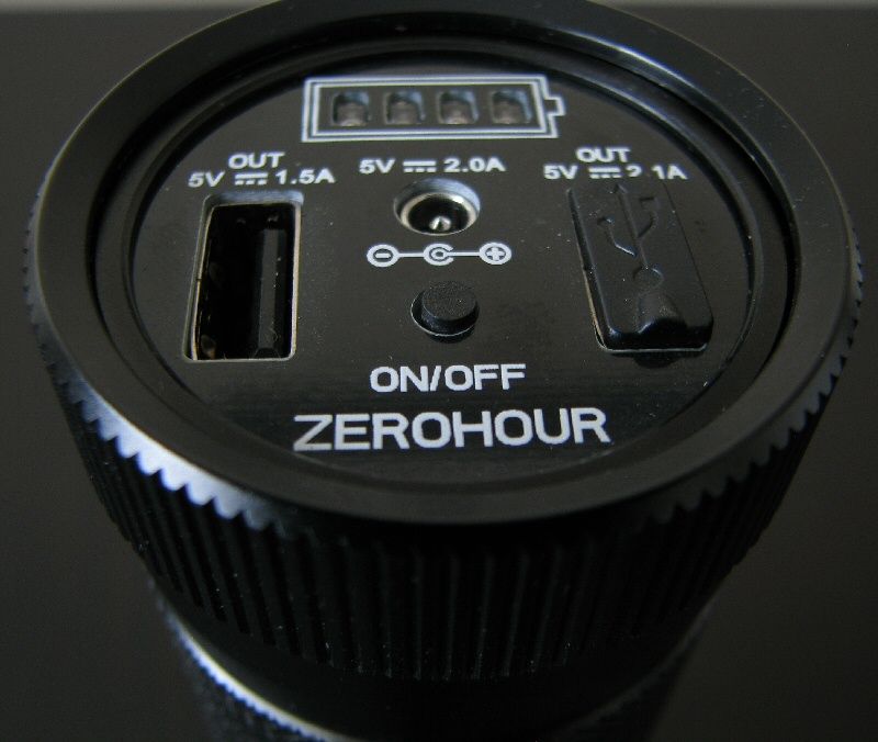

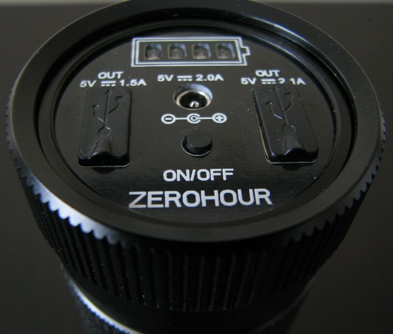

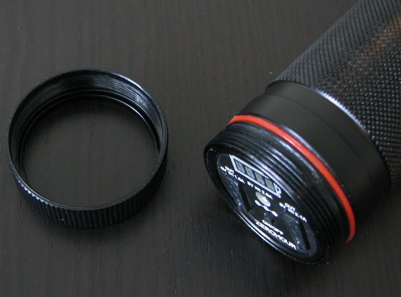

    The open tailcap on the base model allows access to the charging port and USB ports on the base of the carrier – but is not waterproof. For that, you will need use of the closed tailcaps (e.g., flat tailcap or caribiner tailcap). Screw threads in the head are anodized, so lock-out is possible.
    A nice touch is the extra flat (closed) tailcap – due to the common threads, you could remove the head of the flashlight, close this end with the extra tailcap, and simply use this a "backup" battery source to power other USB devices.
    Press the small button on the base of the carrier to read out the battery voltage of the installed cells.
    Let's take a closer look at the carrier:
    Shown on the last pic above, the carrier actually comes with a small cardboard disc to lock out the cells during transport (a nice touch). The carrier is arranged in parallel, so you could run the light on a reduced number of cells (i.e., 1x, 2x, or 3x all possible).

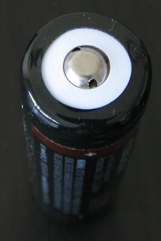

    Let's take a quick look at the batteries that come with the XD model:
    The 3x 3400mAh batteries (presumably based on the Panasonic NCR18650B core) included with this model is how you get up to the "10,000mAh" stated on the packaging. Batteries appear to be good quality, with small button tops.

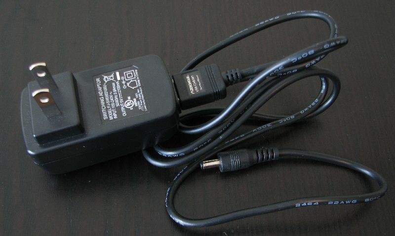

    Like a number of lights I've reviewed recently, the ZeroHour comes with an in-light charging option:
    Just connect the small barrel connector to the base of the carrier, and plug the USB cable into the AC adatper (2.1A max charging current). The indicator will now light up to show relative charge status of the batteries.
    Please see my charging analysis later in this review for more details on the charging characteristics.

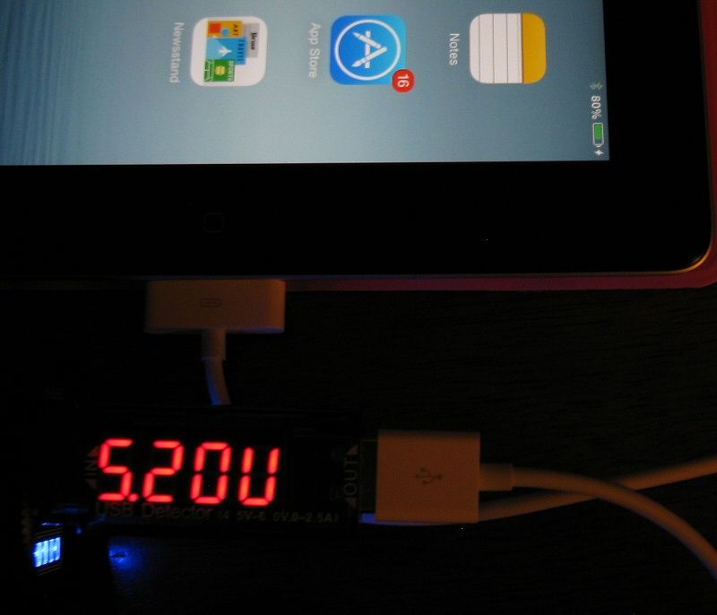

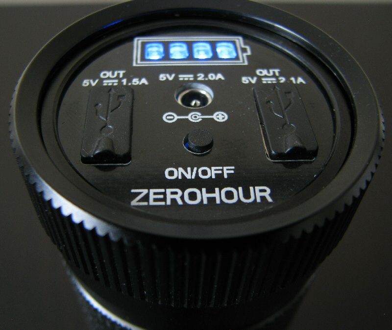

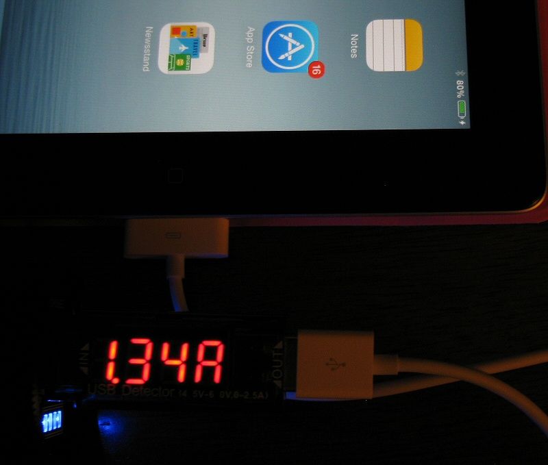

    One of the survivalist features of the ZeroHour is the ability to charge USB devices right from the carrier.
    The USB port on the left can be used for standard USB devices (e.g. cell phone), the one on the right is meant for high-drain devices (like a tablet/iPad). Just remove the dust plugs to access the port.
    I have attempted to charge both standard and high-drain devices from the ZeroHour, and both worked fine. Scroll down for an example of the testing results.

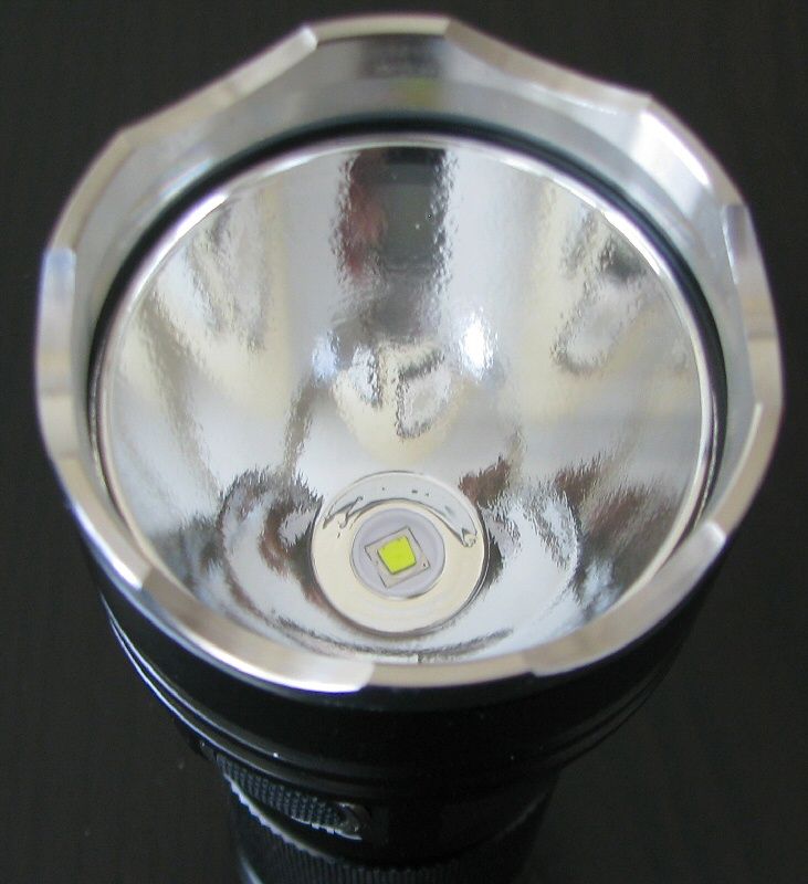

    The XM-L2 emitter was well-centered at the base of a fairly large and deep reflector – with medium orange-peel texturing. I would expect reasonable throw (but not as great as the deeper smooth reflector options in this class). Scroll down for beamshots.

    To check the charge status of your batteries – or to initiate charging of USB devices through the ports on the carrier – simply press the small button on the base of the carrier.

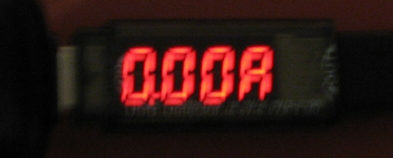

    In-Light Charging

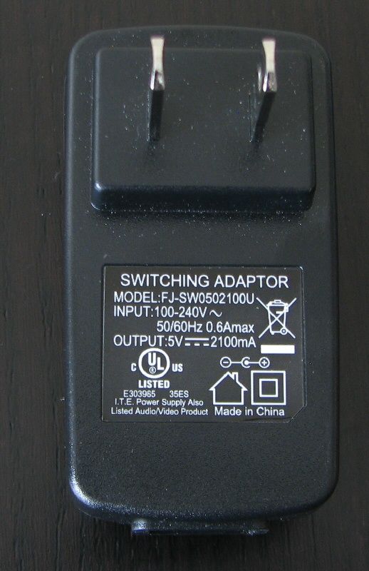

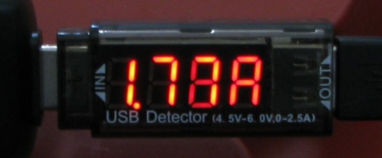

    Because the AC charger uses a USB connector to the charging cable, I was able to take direct measures of the charging parameters using my Xtar VI01 "USB Detector" (basically a specialized USB current/voltage meter). This model has recently been favorably reviewed by HKJ here.
    For charging tests, I started with discharged AW protected 18650 cells, measuring ~2.7-2.8V at rest (i.e., heavily depleted). For all these tests, I left the USB detector in place for all readings. Note that the voltage reading on this device refers to the input voltage (i.e., from the charging brick).
    Initial charging current and input voltage:
    As you can see, charging started at 1.78A with a typical USB ~5.35V input voltage ("U" is meant to represent Volts on the top display above). Recall that the AC adapter has a max charging rate of 2.1 and 5VDC. I won't bother continuing to show the input voltage, since it doesn't change much over the charge cycle (ranged from ~5.33V at the lowest charging current, to ~5.42V at the highest, consistent with other multi-cell lights I've tested).
    The charger quickly ramps up to its maximum charge current and stays there. For example, after 4 hours of charging, the charging current was up to:
    ~2.1A at this point, which is the max current.
    Within half an hour of this point, current had begun to drop (i.e., falls out of constant-current CC phase)
    After by 6 hours and 30 mins of charging on 2200mAh cells:
    Current had dropped to zero, indicating termination.
    Resting voltage of the AW 2200mAh batteries were ~4.16-4.18V at this point. This is very reasonable charging time (i.e., faster than many 3x18650 class lights), with acceptable battery resting voltage at termination.
    Note however that on one of my charging attempts, charging completed in under 4 hours. When I measured the resting voltage of the batteries, one showed the initial ~3.0V depleted voltage, with the other two having the typical ~4.17-4.18V full charge. Of course, since the charger charges in parallel, it terminates once the highest cell voltage is reached. But it appears that one cell on this attempt hadn't made proper contact, and therefore wasn't charged at all.

    As previously mentioned, you can charge both standard and high-drain USB devices from the USB ports on the back of the ZeroHour carrier. Here is an example of a 2nd generation iPad, already at 80% capacity:
    Works great, no problem here.

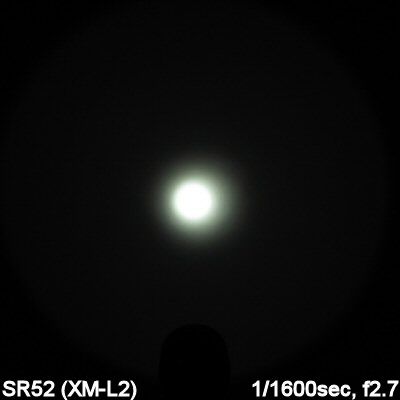

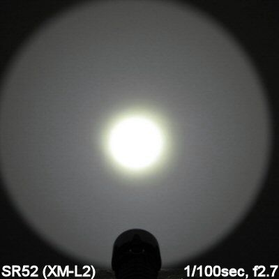

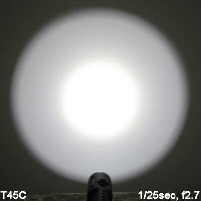

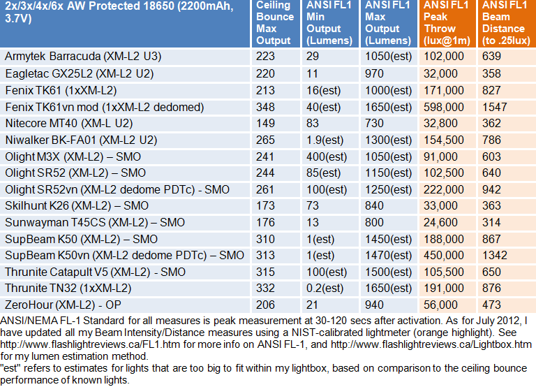

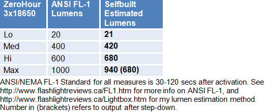

    And now, what you have all been waiting for. All lights are on AW protected 18650 2200mAh. Lights are about ~0.75 meter from a white wall (with the camera ~1.25 meters back from the wall). Automatic white balance on the camera, to minimize tint differences.
    One comment to start – the Max output of the ZeroHour is rated at 1000 lumens, which is bit lower than many 3x18650 flashlights. It is more consistent with the high-end of the 1x18650 class. The reason for this is the apparent intent to allow the light to function equally well on 1x, 2x, or 3x cells.
    Throw is reasonable for the output and size. Scroll down for actual beam output measures.
    I've included only 2x, 3x and 4x 18650 lights in the comparisons above, but the max output of the ZeroHour is actually in keeping with a lot of the maximally-driven 1x18650 lights as well. This seems to be a deliberate design feature, ensuring you can successfully use the light (in all modes) on 1x, 2x or 3x 18650.
    For the max overall output, throw is quite good (i.e., smaller 1x18650 lights are typically in the 20-25K peak intensity range). Basically, I would describe this as being a well-balanced light for throw.
    Personally, for an all-purpose emergency light, I would also like to see a Moonlight mode, or at least a low single-digit lumen level mode.
    Here is a breakdown of the estimated lumen values for each level in my testing:
    Specs seem pretty accurate with my testing results.

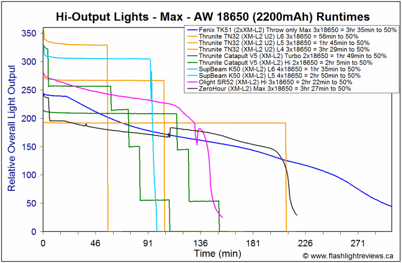

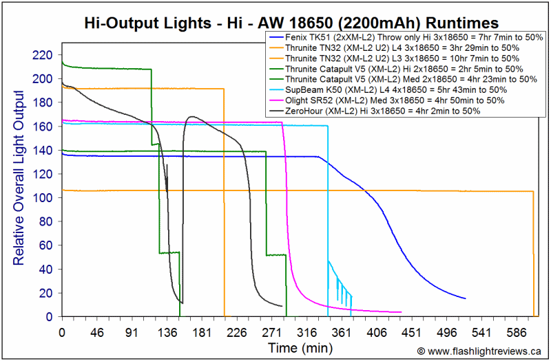

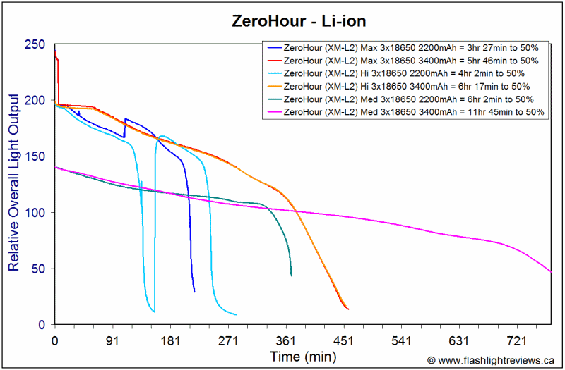

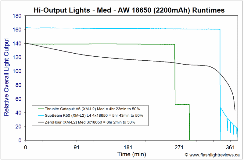

    Output/Runtime Graphs:
    As usual, all my runtimes are done under a cooling fan, and AW protected 2200mAh cells are the standard cells used in all my runtime testing.
    Let's start with a runtime comparison, on my standard 2200mAh cells compared to the supplied 3400mAh ZeroHour ones:
    First thing to note is that there is very little difference between Max and Hi runtimes, as the ZeroHour steps down from Max to Hi after about 5 mins. This is why the orange (Hi) and red (Max) runtimes on 3400mAh look virtually identical.
    A second thing to note is the rather odd behavior on Hi and Max with 2200mAh cells. In both cases, the light "reset" its output level at some point in the run, jumping back up to a more typical Hi level. I don't know if this issue was specific for my 2200mAh cells, or if it was a more general random occurrence. It could be related to a contact issue with one of the cells/wells (see my earlier comments about one well not recharging on one charge cycle). Perhaps the shorter 2200mAh are more likely to experience this.
    In any case, a general observation is that the ZeroHour cannot maintain flat regulation for very long on Hi for lower capacity batteries. The light also doesn't seem to maintain flat regulation at all on Med (i.e., looks like a more direct-drive-like pattern). This is certainly not an issue in actual use though, as you would not notice this slow drop-off in real life.
    Let's see how Max output looks on reduced number of batteries (using 3400mAh ZeroHour batteries)
    As you can see, the light still runs fine – even on Max – with as little as one 18650.
    To compare relative efficiencies, let's look at some competing lights – all on my standard 2200mAh cells.
    Although the ZeroHour is not as flat-regulated as some of the competition, overall output/runtime efficiency seems very good at all levels. Some of the excellent current-controlled circuits (e.g., Fenix) may have a slight advantage, but the ZeroHour does seem to be in the general range of other good models (e.g. Olight and Thrunite offerings).

    Overall length is OAL. 18650 (protected) have a large spread in lengths with some at 70mm. Knowing what the OAL of the included cells would provide a perspective buyer with the option of buying the X version and providing cells longer in length provided the XD/XS 18650s are not already on the long end of the scale. The difference in battery options are between the XS and the XD versions. The XS has lower mAh cells. Another advantage to providing your own batts is the availability of higher mAh (longer runtimes) batts. There are good 3600 mAh 18650s showing up.
    6,936
    Default Re: ZeroHour XD (XM-L2, 3x18650 3400mAh, USB charging) Review: RUNTIME, BEAMSHOTS+mor
    Quote Originally Posted by jw2n View Post
    The three ZeroHour 3400mAh batteries that came with my sample had an average length of 69.35mm.
    From the ZeroHour website @ http://www.zerohourxd.com/collections/batteries
    3400MAH 18650 BATTERY Length: 68.5mm, Diameter: 18.5, Weight: 47g
