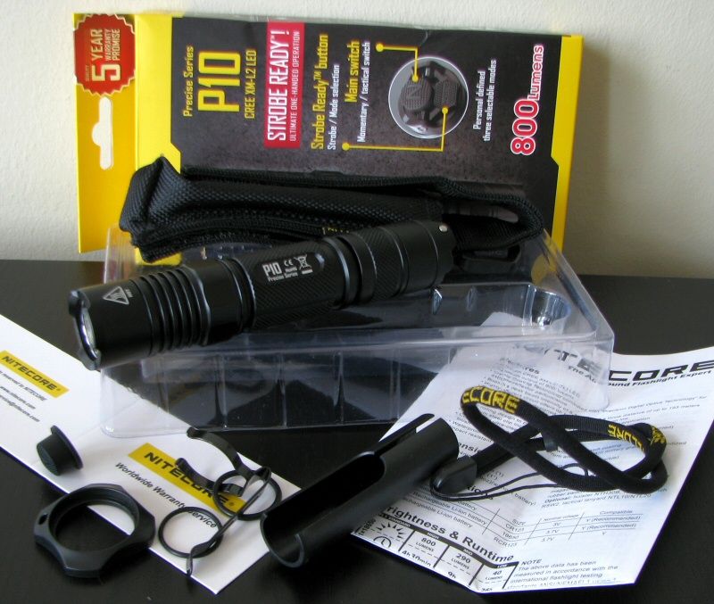

    • Accessories Included: quality holster, CR123 battery magazine, clip, tactical ring, lanyard, spare O-ring

    Packaging is Nitecore's current standard thin cardboard display box, with detailed specs and information printed right on the box. Inside, included with the light are spare O-rings, anti-rattle CR123A plastic insert, spare main switch boot cover, removable grip ring, pocket clip, basic wrist lanyard, holster with Velcro closing flap, product inserts, warranty card, and manual.

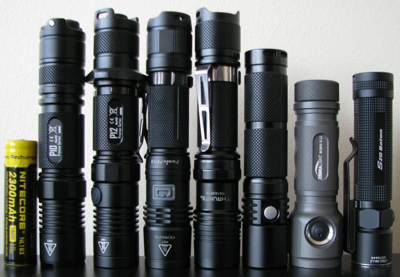

    From left to right: Nitecore protected 18650 2300mAh; Nitecore P10, P12; Fenix PD35; Thrunite TN12 2014; Thrunite Neutron 2C 2014; Zebralight SC600-II; Olight S20 Baton 2013.
    Nitecore P10: Weight 82.0g, Length: 135.1mm, Width (bezel): 25.5mm
    Nitecore P12: Weight: 89.7g, Length: 139.4mm, Width (bezel): 25.4mm
    Eagletac D25LC2: Weight: 50.0g, Length: 116.3mm, Width (bezel): 22.5mm
    Fenix PD35: Weight: 82.7g, Length: 138.1mm, Width (bezel): 25.4mm
    Foursevens MMR-X: Weight 90.8g, Weight (with 18650): 138.5g, Length: 138.6mm, Width (bezel): 31.5mm
    Foursevens MMX Burst: Weight 145.8g, Length: 153.3mm, Width (bezel): 38.7mm
    Klarus XT11-2014: Weight 140.1g, Length: 150.5mm, Width (bezel): 34.8mm
    Olight M20S-X: Weight: 124.1g, Length: 145.4mm, Width: 35.5mm (head)
    Thrunite TN12-2014: Weight: 80.0g, Length: 140.5mm, Width (bezel): 25.4mm
    Zebralight SC600 II: Weight 79.3g, Length: 101.8mm, Width (bezel) 29.7mm

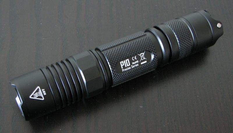

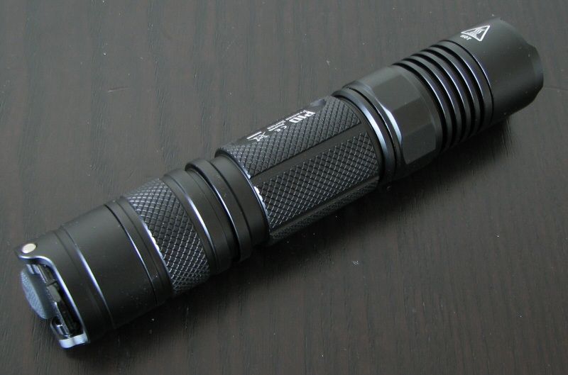

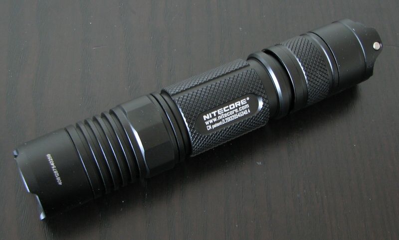

    The P10 is a compact and solid little light, similar in overall appearance to the P12 (though without the secondary switch in the elongated head). Anodizing is a shiny black finish, hard anodized, with no chips or damage on my sample. Body labels are bright white and clear against the black background. Knurling is of moderate aggressiveness on the body tube and tailcap. But when combined all the other grip elements (e.g., side switch cover, fins in the head, pocket clip, grip ring, etc.), I would describe overall grip as very good.
    The light has some anti-roll indentations on the body, but the clip and grip ring are even more helpful in that regard. Clip is supposedly titanium-plated stainless steel, and feels reasonably sturdy. There is also a bundled grip ring in the package, for cigar-grip style carry.
    Tailcap screw threads are standard triangular cut and anodized for lock-out at either end of the body tube. Note that the body tube threading is identical to the P12 (i.e., heads/tails are physically interchangeable).

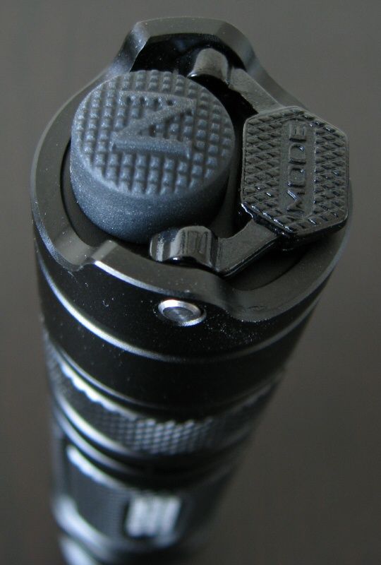

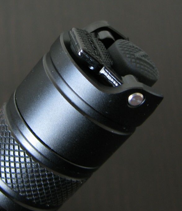

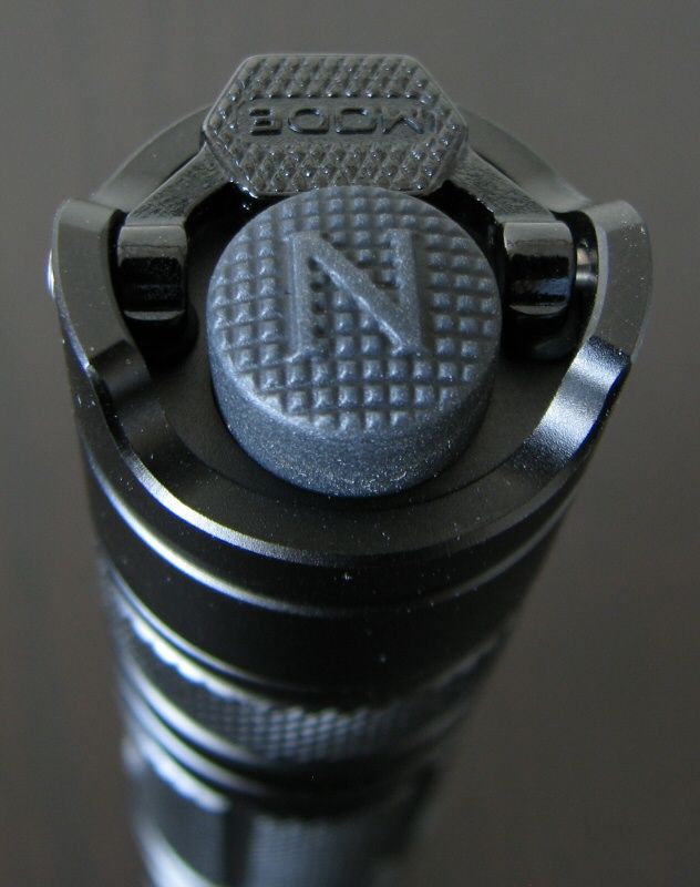

    What differs from the P12 is the dual-switch tailcap design. The P10 is now controlled by two switches in the tailcap – a primary forward physical clicky (for off/on) and a secondary electronic switch (for strobe or mode switching). There is a hard plastic lever over the electronic switch labeled "MODE" (held in place by a pin through the tailcap). Both switches can be accessed one-handed by the thumb or index finger, in whatever grip style you prefer. Nitecore informs that this design was originally developed some time ago (for the P20), but only recently released. Observant readers will note that it looks very similar to the tailcap from the recent Klarus XT11 update for 2014. The feel of the two switches on the P10 are generally similar to my XT11-2014 sample (although with slightly less resistance on the mode changing switch on my P10).

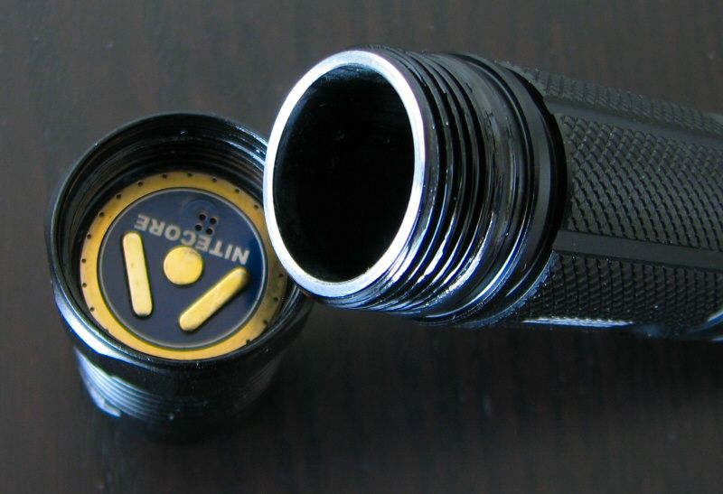

    The contact board in the head is also updated from the P12. On the P10, there is an electronic reverse polarity feature in the head (instead of physical). This means that all flat top cells will not work in the light now (i.e., only smaller button top accepted).
    As before, the body tube is wide enough to accommodate all size 18650 cells, and there seems to be plenty of room of longer cells as well.

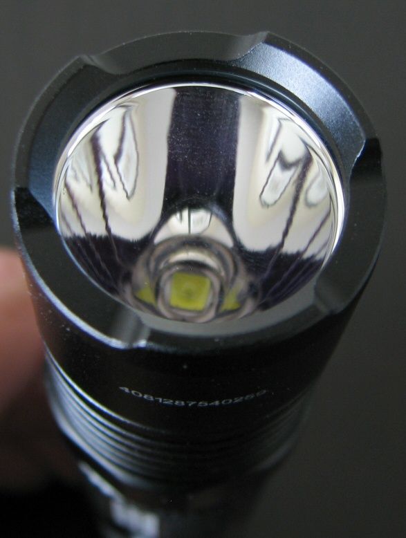

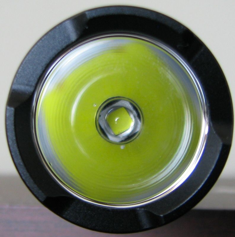

    The P10 comes with a slightly scalloped black aluminum bezel. The overall head is typical for this class - not very large. Reflector is identical to the P12 version, and is smooth and fairly deep (given this size head). Coupled with the XM-L2 cool white emitter (which was well centered on my sample), I would expect a fairly typical beam pattern, comparable to the P12. Scroll down for beamshots.
    There are several programming options for the P10, but basic operation and switch use is similar across the mode sets.
    Press the large forward clicky switch for constant On or Off (press for momentary, click for locked-on).
    When On, you can the change output level by pressing the smaller electronic mode switch under the lever. Note that there are three sets of mode sequences available to you, which I will describe below.
    Also note that in any set, Strobe can be activated directly from Off by simply pressing the mode switch (momentary Strobe only when accessed from Off). Strobe can be activated from On by a press-and-hold of the mode switch for ~0.5 sec (constant on Strobe when accessed from On).

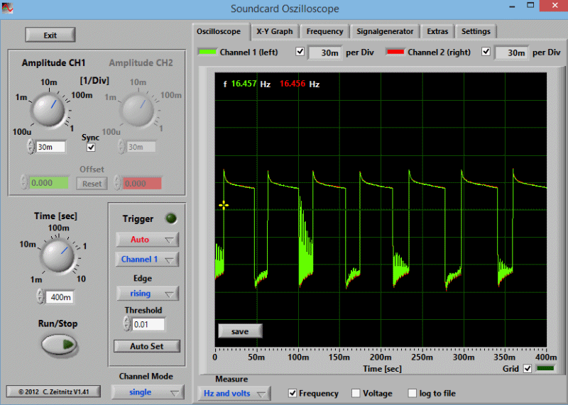

    Reviewer's note: I have recently updated my oscilloscope software, so the traces below may look a little different from my earlier reviews.

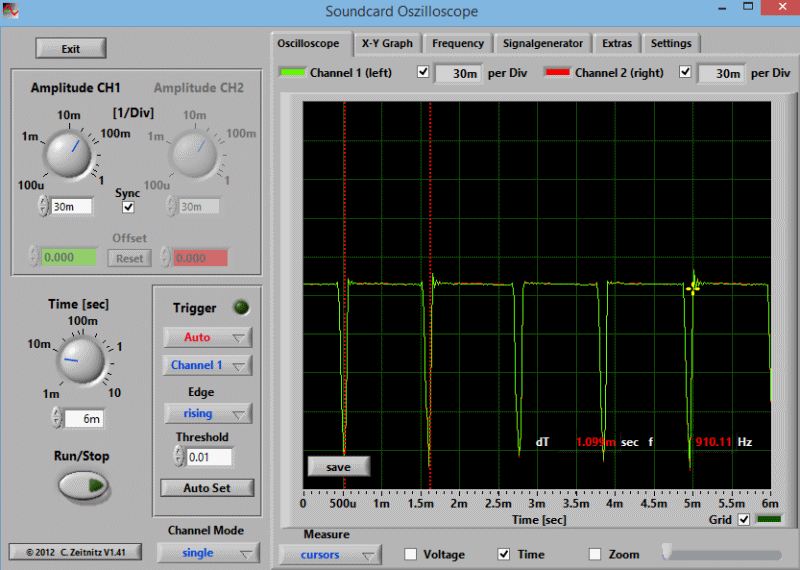

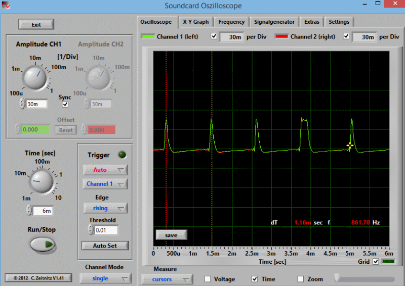

    Unlike the P12 (which was current-controlled), the P10 is bound to use pulse width modulation (PWM) in all its output modes, including Hi. This is a common feature that I have observed on lights that have a secondary circuit in their tailcaps (i.e., ones with a secondary mode switch there). I suspect PWM on all levels is required for how the two circuits communicate with each other and coordinate their function
    Let's see how it looks on the P10:
    Hi:
    Med:
    Lo:
    The P10 uses PWM range in a range from ~860-910 Hz, depending on the output level. This PWM frequency is similar to the other dual-switch tailcap design in my collection, the XT11-2014.
    As with other lights that operate this way, it is practically impossible to notice the PWM on the P10 Hi mode (even when shining on a fan). For higher perceived outputs (where the light is on for most of the time), the detectable perception of PWM drops considerably. This is another example where you would need an oscilloscope to be able to detect the Hi mode PWM.
    PWM is far more noticeable when the duty cycle is low (i.e., the light is off more than it is on for each pulse). Personally, it is really only on Lo where I find it to be particularly noticeable on the P10 (although I can see it on Med).

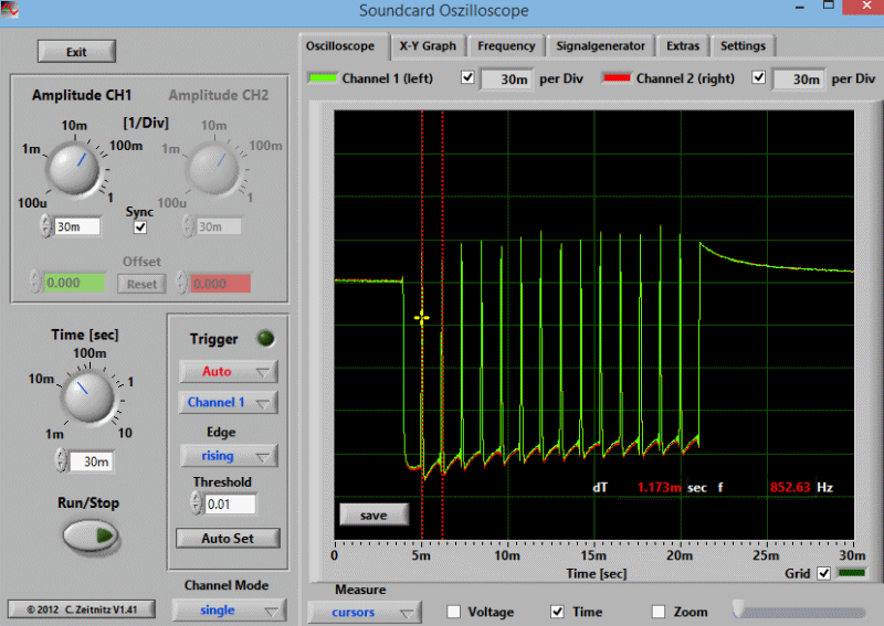

    Strobe
    The overall strobe frequency is very high, around 16.5Hz. But as with many lights with very high frequency strobes, it also has unusual pulse duty cycle. Most strobes have a 50:50 on/off cycle (i.e., the light spends an equal amount of time on and off during each pulse). On the P10, the light is off longer than it on during each pulse – it's actually more of 30:70 on/off cycle. Not that this will be visible to you in practice – the strobe will seem highly disorienting at 16.5 Hz.
    A second point you may have noticed about is the "noisy" spikes during the On phase (i.e., during the negative deflections above). That is just due to the ~860 Hz PWM pattern of the Hi mode described earlier. Here is a blow-up of what this PWM signal looks like during a strobe cycle:

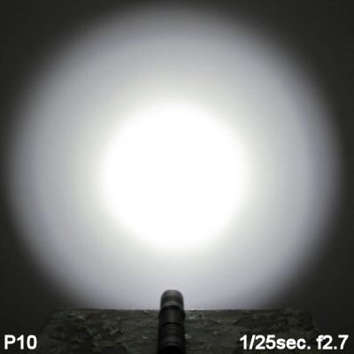

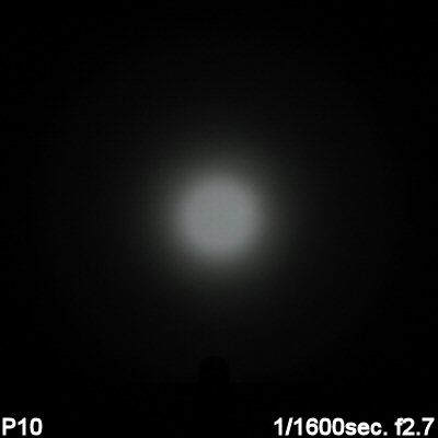

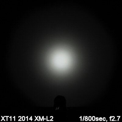

    And now the white-wall beamshots. All lights are on 1x18650 AW protected (2200mAh). Lights are about ~0.75 meter from a white wall (with the camera ~1.25 meters back from the wall). Automatic white balance on the camera, to minimize tint differences.
    As expected, the P10 has very similar beam to the P12 – although max output is slightly less. The larger XT11-2014 has a more "throwy" beam, due to its larger head. Scroll down for direct output and throw measures.
    As shown in the beamshots, max output of the P10 is a bit lower than the P12 – but the overall beam profile is the same (i.e., beam distance is proportionately decreased as well).

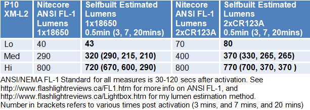

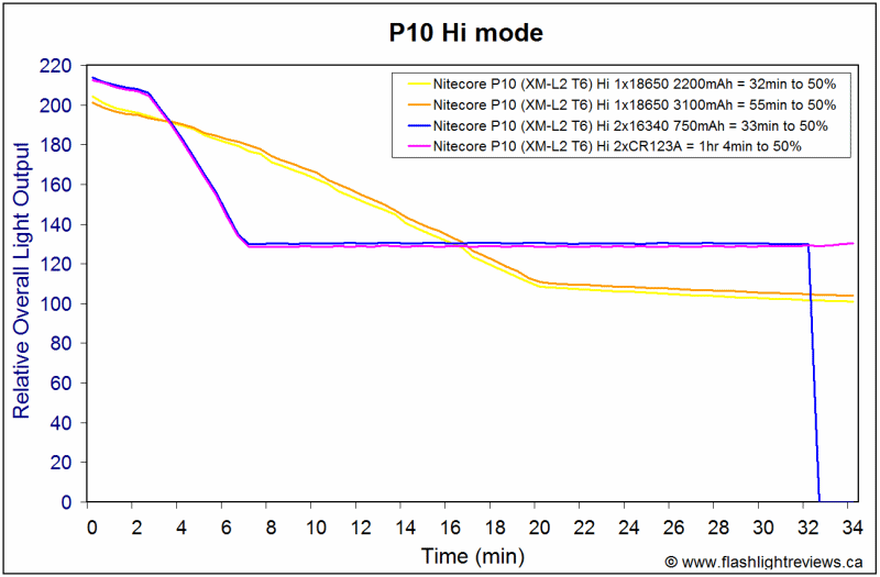

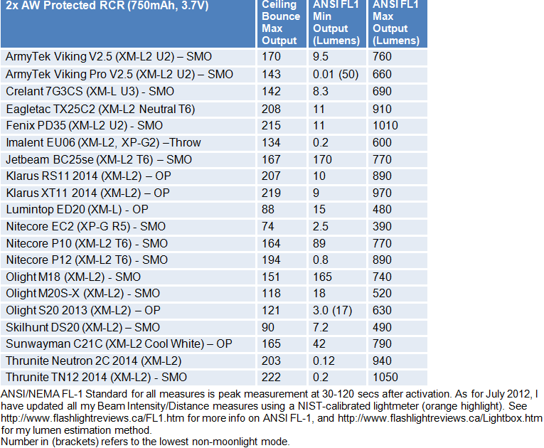

    Here is a comparison of output levels on different batteries. For this table, I've done something a little different, and shown output levels at various times post-activation (in brackets).
    The main point to take away from above is that (unusually) the P10 has different ANSI FL-1 output levels depending on the voltage source of the batteries being used. This is true across all 3 levels (i.e., Lo, Med and Hi). That said, my output estimation measures generally correlate very well with Nitecore's published specs.
    The second point to the above is the reason why I added additional time points in brackets, for Med and Hi. Nitecore reports that the P10 "steps down" at 3 mins runtime. But as you can probably tell from the above, that is not the whole story. Scroll down to runtimes for more info – specifically, for why I choose the 3, 7 and 20 min time periods post-activation shown above.

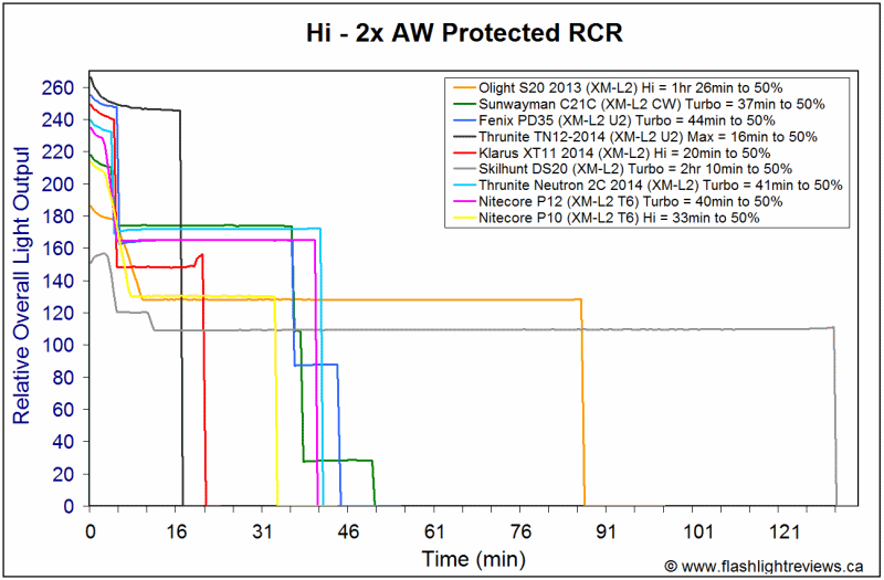

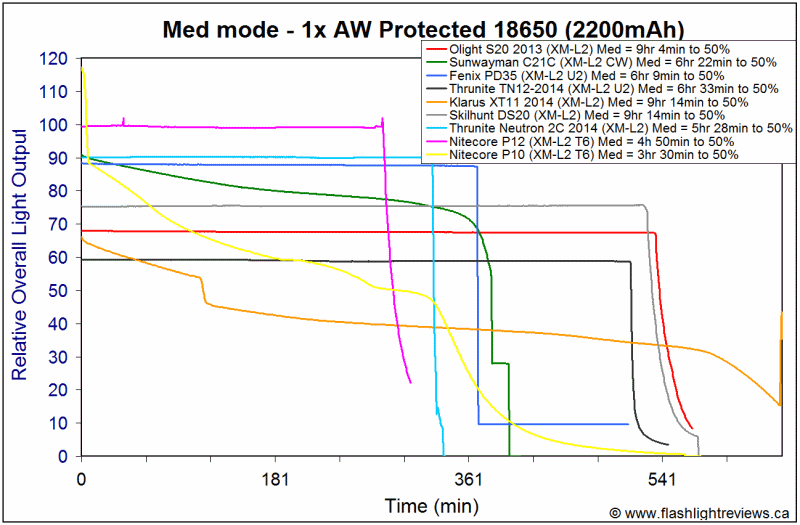

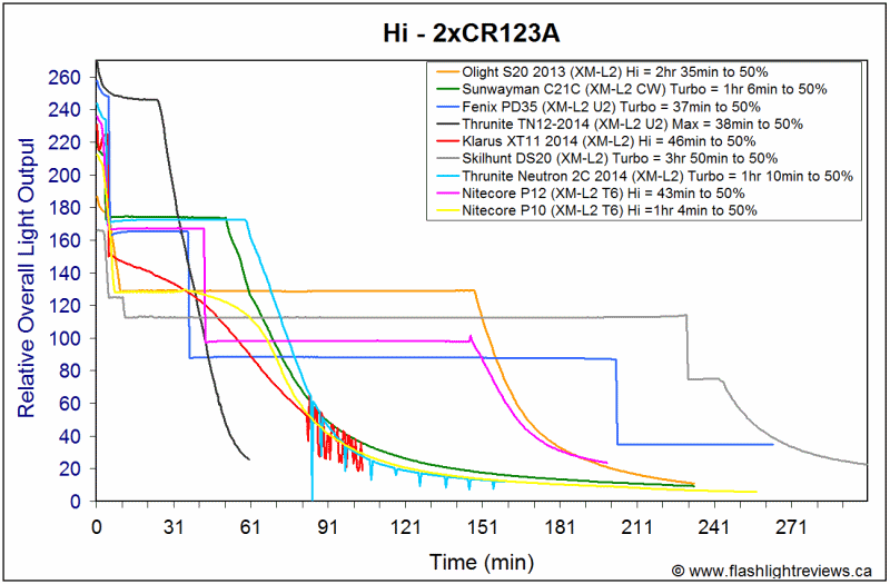

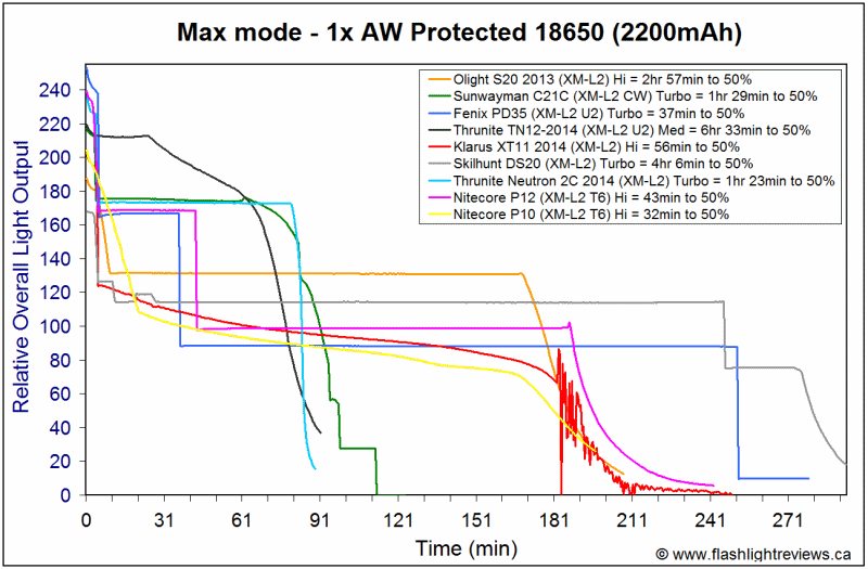

    Output/Runtime Graphs:
    As usual, all my standard runtimes are done on AW protected 2200mAh cells, under a cooling fan.
    The main take-home message above is that overall output-runtime performance and regulation pattern of the P10 is consistent with other PWM lights that use a dual-switch design (e.g., the XT11-2014).
    Clearly, overall efficiency of these lights takes a hit due to the use of PWM on all levels. Current-controlled lights (like the P12) will always have a runtime advantage. The stabilization pattern is also different here compared to most lights. As you can probably glean from above, the so-called "step down" at 3 mins for Med and Hi (as reported by Nitecore) is not the whole story. To show this better, here is a close-up view of output over time for the two levels, on a number of batteries.
    Ok, so for 2x sources (CR123A/RCR), the P10 begins to drop down in output at 3 mins. But this is not an abrupt step – instead, it is a very linear decline over (varying) time. On Hi, it takes 4 mins before it finally settles down to its new flatly-regulated level (which is ~50% of the Hi mode ANSI FL-1 output level). On Med, it takes 1 min before it settles down to its new flat regulated level (which is ~70% of the original Med mode ANSI FL-1 output level).
    But the 1x18650 situation is quite different. Here, there is no linear drop in output beginning at a specific time. Instead, the initial output (which is lower to start with than 2x sources), drops off for exactly 20mins. At which point, the output level "stabilizes" in a direct-drive-like pattern. At 20mins into the runs, output is ~40% of the Hi mode ANSI FL-1 output, and ~65% of the Med ANSI FL-1 mode output.
    I don't know why they went for such distinct regulation patterns on the different cells. But it is unusual to see lights "step down" this much, and in this fashion. Especially so on Med, where I've never seen anything quite like this. However, on the positive side, the rate of decline is slow enough that you are not likely to notice it visually.
    Unlike other Nitecore offerings, the P10 uses PWM on all modes (including Hi) at a visually detectable ~900 Hz. This seems to be a necessary feature on lights with a dual-switch/circuit design in the tailcap. I find the PWM unnoticeable on Hi on this light, but those sensitive to PWM may notice it on the Med and Lo modes (i.e., as perceptual visual "flicker").
    Light uses an electronic secondary mode switch in the tail, and therefore requires a stand-by current when fully connected. However, this is very low (73uA) in my testing, and would take years to drain a battery. To prevent accidental activation and break this current, you can always lock-out the light with a simply twist of the head or tailcap (thanks to the anodized threads at both ends).
    Output is higher (and runtime lower) on 2x battery sources compared to 1x18650, at all levels. Note that max output is toward the lower end of this class, on all batteries.
    The P10 drops in output after 3 mins on both Med and Hi. However, the regulation patterns (and final output level) differ depending on the voltage source (i.e., the number of batteries used). In all cases, final output after "step down" is lower than many competing lights in this class. Please see my runtimes above for more info.
    Light lacks a true Lo mode, on any battery.

    Hi All,
    Just wondering though. Ive been using an NTC1 tailcapnon my P10. Though I can no longer access all other modes except Turbo I was wondering will this eliminate PWM and is "step-down" still present? I emailed Nitecore about it and they said "step dow" is still present. TIA!
    Cheers!
    *Rod
    6,936
    Default Re: Nitecore P10 Dual Switch (XM-L2, 1x18650 2xCR123A/RCR) review: RUNTIMES, BEAMSHOT
    Quote Originally Posted by Roood View Post
    Since the PWM signal is detectable on Hi, i suspect it will still be there in you single-stage mod. It is likely used to synchronize circuits in the head and tail, and thus will always be present.
    Enlightened Roood's Avatar
    Apr 2011
    Philippines
    99
    I see. Thank you SB. Bummer though. I guess PWM is fine than not having ""step down".
    Cheers!
    *Rod
    Finally got time to test my P10 using the NTC1 tailcap... no PWM. Nitecore said the driver/circuit or something is located in the P10's stock tailcap. Using NTC1 will direct drive the light. No PWM detected and output drops approx. 4mins So this is a good to know thing incase the stock P10 tail fails, makes the P10 a lot shorter too.
    Cheers!
    *Rod
    6,936
    Yes, I just checked by using the P12 tailcap - there is indeed no PWM when run this way. You just get single-stage Hi (no different in output from the regular P10 Hi mode).
    Aesthetics wise. The P12 tailcap looks really nice on the P10. NTC1 tail cap on the p12 as well.
    Cheers!
    I'm interested in P10's bigger brother P20. You haven't tested it (yet)? I'm afraid it has the same kind of runtime pattern and PWM since it uses the same kind of tailcap. That might be a dealbreaker for me...
    Does the P10's output "bump" up back to 800 lm mode if you turn it off and on and start gradually dimming again?
    The darkness here is different.
    6,936
    I haven't tested the P20, and don't have any plans to.
    Not sure what you mean by gradual dimming. The various mode set options are described in the review UI section.
    Flashaholic* D6859's Avatar
    Oct 2013
    Finland
    642
    Sorry, I was too tired last night when I was typing the previous post. I meant the "step down". Does the light bump back up to 800 lm and then step down during the next 3 (or 20) minutes?
    6,936
    Quote Originally Posted by D6859 View Post
    Ah, I see. Yes, the light will restart at Turbo at the max level when doing an off-on cycling - and then step-down as usual over the remaining time course.
