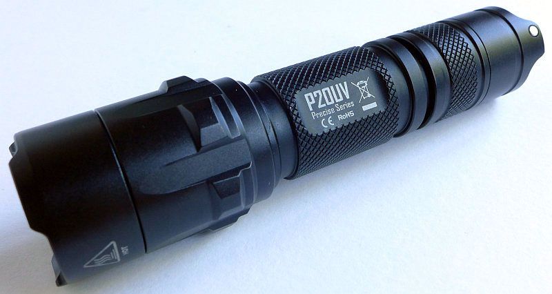

    The photos here show; the packaging, contents, accessories, holster, main and UV LEDs, reflector, tail-cap switches, tail-cap battery contact, tail threads, head contacts, 18650 cell next to the P20UV's CR123 battery magazine, size comparison, P20UV next to an 18650, the P20UV with D2 Digi Charger getting ready to go!.
    For the size comparison, the P20UV is shown with (left to right) the NITECORE CU6, EA41, P20UV and P25.

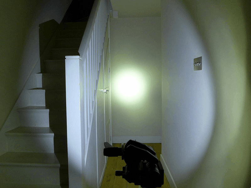

    Despite this compromised reflector, the beam of the P20UV is very good with a defined hotspot and very usable spill. Outdoors the hotspot gives a good range and the spill is still useful.

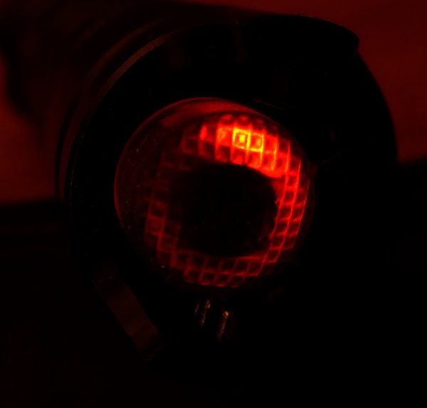

    The P20UV has a battery level indication. When inserting the battery, the main tail-cap switch will flash 1, 2 or 3 times to indicate charge level. Three flashes represent a full battery.

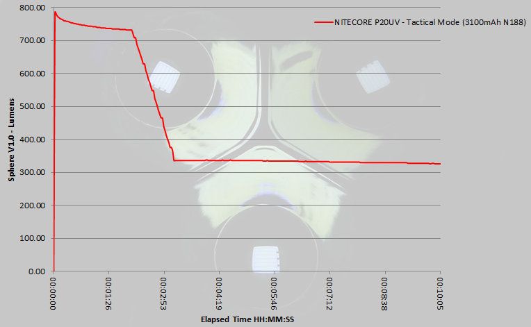

    With the maximum output level, the P20UV maintains this at peak output for nearly 2 minutes, and then the output is gradually ramped down to the Medium output level by three minutes from switch on. Turning the P20UV off even momentarily restores this to the maximum output level for a further two minutes with a ramp down to Medium as before.
    The initial graph shows just this initial part of the output:
    And then the full output trace for High with no output reset carried out.
    Due to the initial high output, the ANSI runtime terminates with 80 lumens still being output at 4h 48m.
