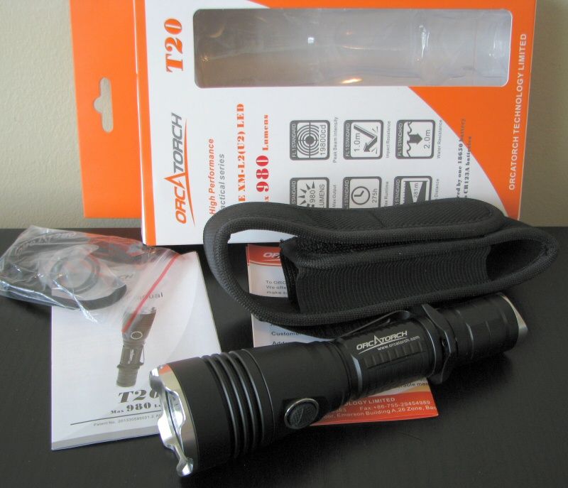

    Packaging is fairly standard, with a thin cardboard box (which has full specs and instructions printed on the back, not shown). Inside, included with the light are spare O-rings, wrist lanyard, belt holster with Velcro flaps, warranty card, and manual. A removable pocket clip and grip ring are included on the light

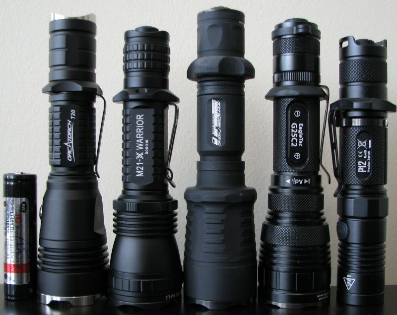

    From left to right: AW Protected 18650 2200mAh; Orcatorch T20; Olight M21-X; Armytek Viking Pro; Eagletac G25C2 Mark II; Nitecore P12.
    Orcatorch T20: Weight: 180.6g, Length: 153.5mm, Width (bezel): 40.0mm
    Orcatorch D500: Weight: 217.8g, Length: 152.7mm, Width (bezel): 44.9mm
    Fenix PD35: Weight: 82.7g, Length: 138.1mm, Width (bezel): 25.4mm
    Foursevens MMX Burst: Weight 145.8g, Length: 153.3mm, Width (bezel): 38.7mm
    Light & Motion GoBe+ 500 Search: Weight (with built-in battery): 189.2g, Length: 132.4mm, Width (bezel screw threads): 47.7mm
    Nitecore P12: Weight: 89.7g, Length: 139.4mm, Width (bezel): 25.4mm
    Nitecore P25: Weight: 171.3g, Length: 160mm, Width (bezel): 40.0m
    Olight M22: Weight: 148.4g, Length: 144.8mm, Width: 41.2mm (bezel)
    Zebralight SC600 II: Weight 79.3g, Length: 101.8mm, Width (bezel) 29.7mm

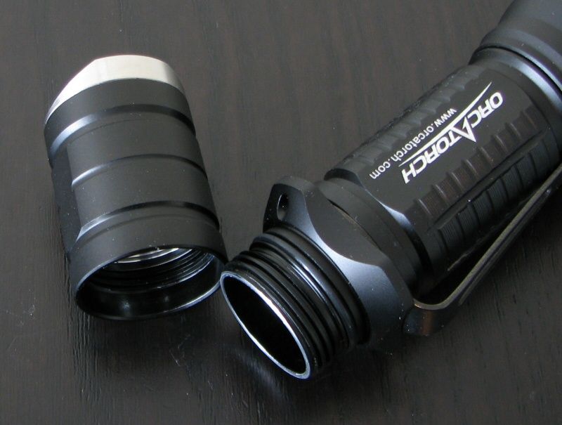

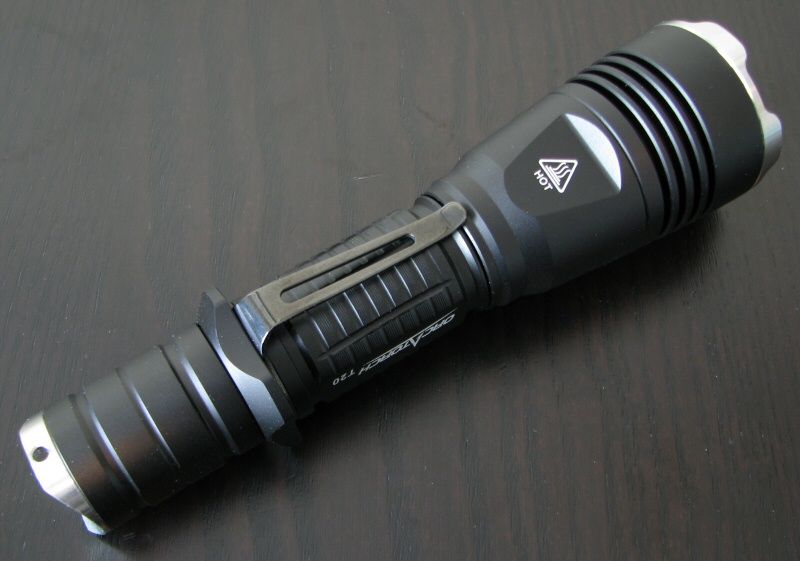

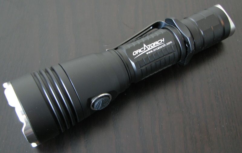

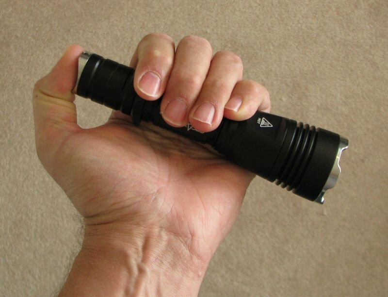

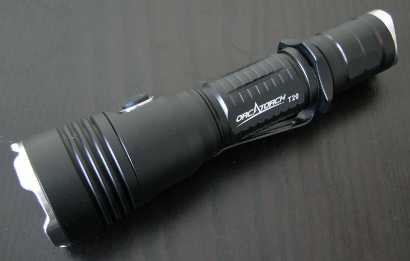

    The T20 has a quality feel, and is similar in overall size and styling to a number of tactical 1x18650-class lights. Anodizing is a matte black finish, hard anodized, with no chips or damage on my sample. Body labels are bright white against the black background. Rather than typical knurling, there are checkered areas on the body tube with fine concentric rings. Combined with the other ridge details over the light, I would say grip is good (excellent with the pocket clip and cigar grip ring installed). Note that the clip and screw on grip ring can both be removed.

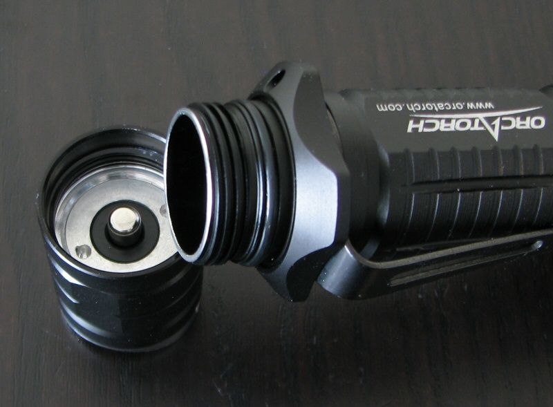

    Screw threading is square cut (trapezoidal), and seems of good quality. Threads are anodized at both the tailcap and the head to allow for lock-out.

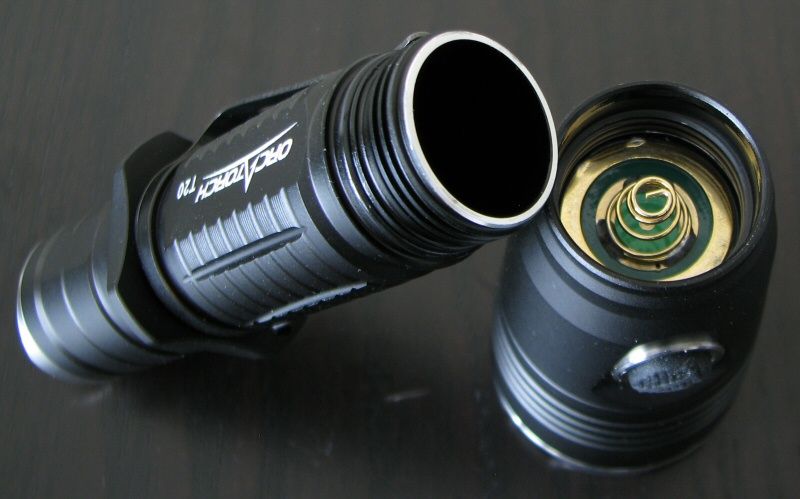

    There is a spring mounted on the positive contact board in the head, so flat-top cells can be used In the light.

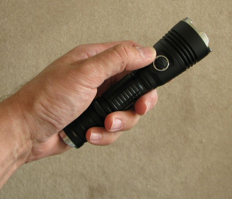

    The T20 has stainless steel rings at both the tailcap and bezel. The tailcap ring is scalloped slightly to facilitate finger/thumb access to the switch. I find the tailswitch to be stiffer than typical (i.e., requires more force). Tail switch is a forward clicky. The light can tailstand stably.
    There is a secondary switch in the head, used for mode switching. This is an electronic swtich, again slightly stiffer than typical for that class. The black boot cover projects a fair amount, making it relatively easy to find by touch.

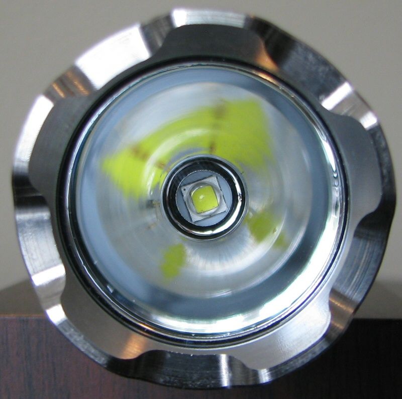

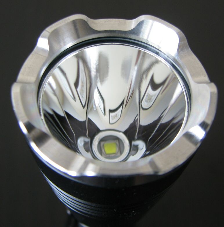

    The light uses a cool white XM-L2 emitter, well centered on my sample. Given the reflector size, I would expect the light to be relatively focused for center-beam throw. Scroll down for beamshots.

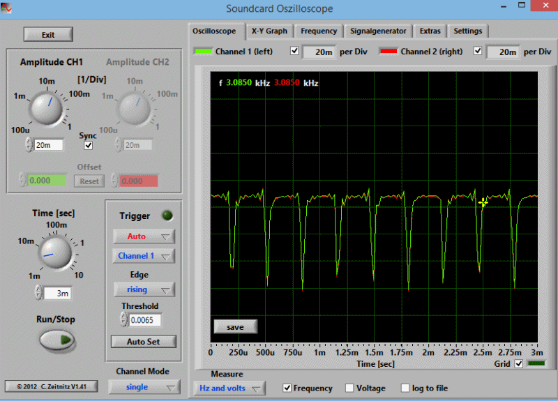

    PWM/Strobe
    The T20 uses pulse-width modulation (PWM) for its Med/Hi modes, but at a fairly high frequency.
    Turbo:
    Hi is not shown.
    Med:
    Lo:
    There is no PWM on Turbo, and Lo was too low output for me to reliably detect. On Med I detected 3.0 kHz PWM, and on Hi 2.8 kHz. Both of these are sufficiently high that you are not able to notice it in real life. I consider these perfectly acceptable (and I am personally sensitive to PWM flicker).

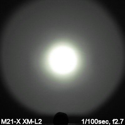

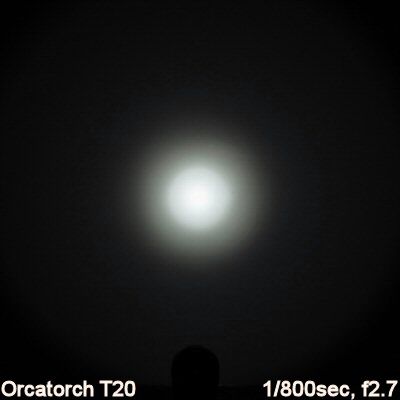

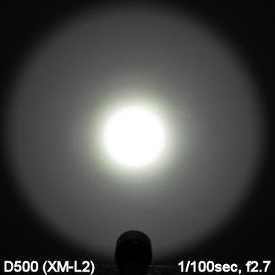

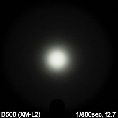

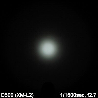

    Beam pattern is what you would expect for a light with a reflector of this size – a fairly throwy hotspot. I did notice a greater than usual number of artifacts on my sample, especially in the hotspot and corona. However, these were not a problem when shining at a distance.
    Scroll down for detailed output and throw measures.

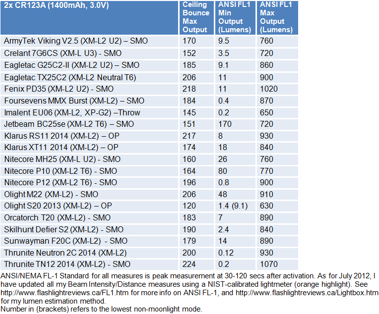

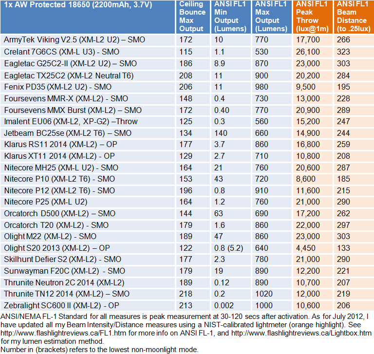

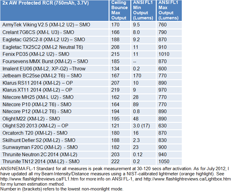

    Max overall output of the T20 is toward the high-end of lights in this class (i.e., the more heavily-driven examples of XM-L2 lights).
    My peak intensity throw measures match the reported ANSI FL-1 specs.

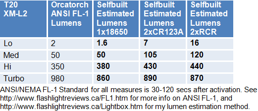

    Let's see how all the levels compare to the official specs in my lightbox:
    As with the D500, there is excellence concordance between my estimated lumen meassures and Orcatorch's published specs. I expect Orcatorch is using an actual integrating sphere for their measures.
    The T20 is somewhat more highly driven on 2xCR123A/RCR compared to 1x18650, on all levels.

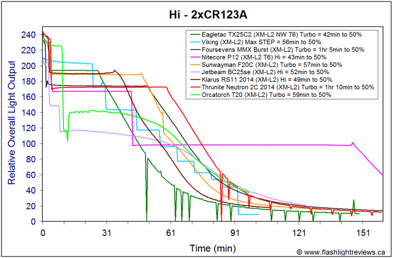

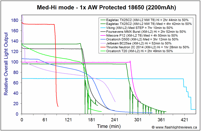

    Output/Runtime Graphs:

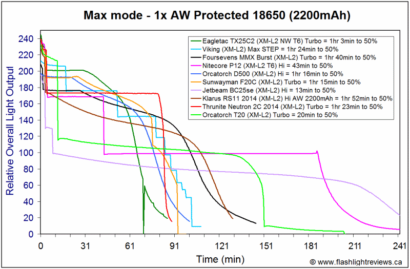

    As always, my standard runtimes are done with AW protected 2200mAh cells, under a cooling fan.
    Output/runtime performance on all levels is excellent for a high-frequency PWM-based light. Note that current-controlled lights will always have a runtime advantage over PWM lights.
    Overall runtimes are still quite respectable, even on Turbo - as the T20 steps down more than most lights do. Note that step-down only occurs after 10 mins runtime, however (which is longer than most lights in this class).
    This is a good balance of output and runtime for a PWM light.
    Light uses PWM for its lower modes, but at a very high frequency (~3 kHz). This is high enough to not be detectable visually.
    While there is always some loss of efficiency with high-frequency PWM lights (compared to current-controlled lights), the balance of output levels and runtime is very good here.

    Beam pattern is quite throwy, as you would expect for this design. Note that I found a higher-than-typical number of focusing artifacts in the hotspot/corona on my sample (although these are more of a problem on a white wall).
