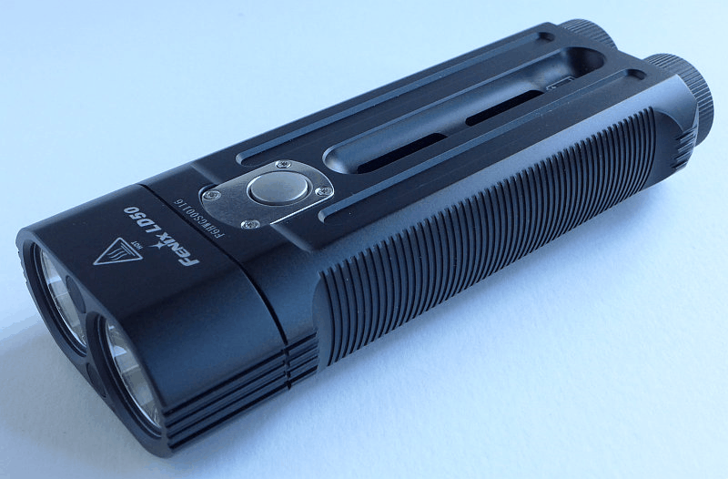

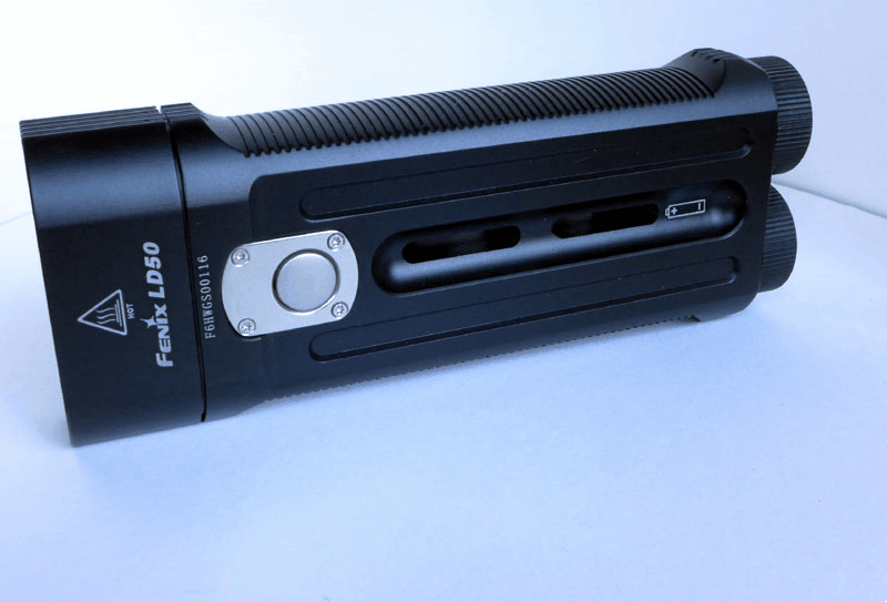

    Taking a more detailed look:
    The photos here show; the packaging, contents, top view, bottom view, side view (showing ultra slim profile), switch, looking through the LD50, lens and reflector, LEDs, one tail-cap removed, internal contact, both tail-caps removed with 2 x ARB-L2S 3400mAh 18650 cells, the LD50 with Fenix ARE-C2 smart charger, and a personalised NW20 whistle (laser engraved by MyFenix).

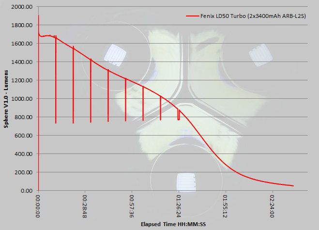

    The LD50 runtime trace was carried out using 2x 3400mAh ARB-L2S 18650 cells, and the Turbo output was reset every 10 minutes when it dropped out of Turbo. During the runtime test, the head reached 56 Degrees Celsius with a cooling fan running.
