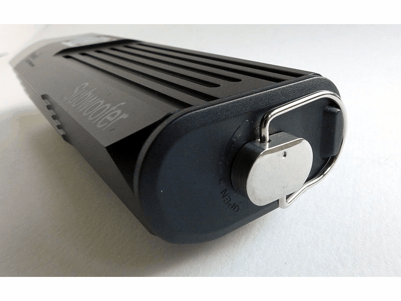

    Battery carrier removed from the BC30

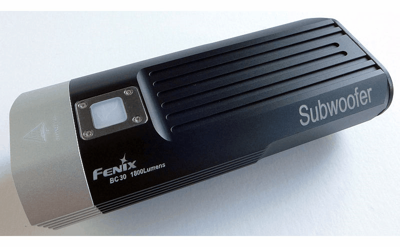

    Switch illumination

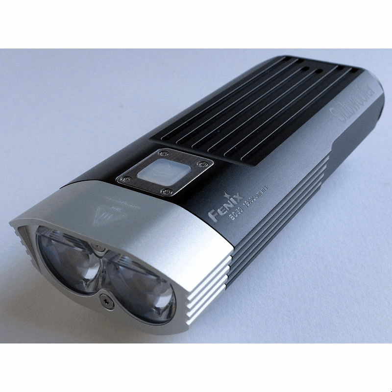

    General shape of the BC30
    Slim side profile
    Battery carrier locking handle

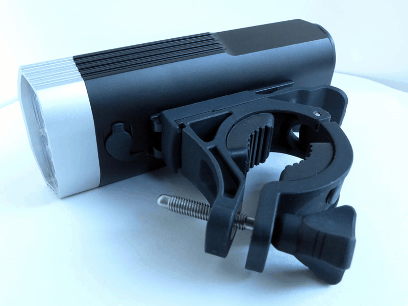

    The underside and mounting rail

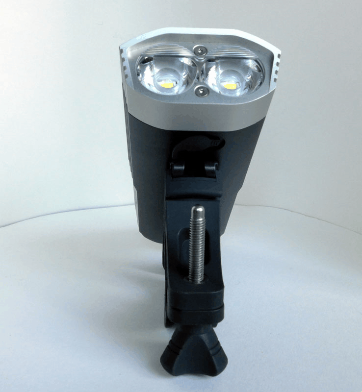

    Twin LED/optics

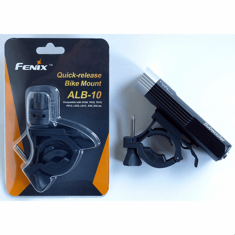

    Bike mounts vary significantly, with even high end lights using o-ring mounts. The BC30 uses a very strong clamp. The design is so good, Fenix sells the system as a flashlight holder (the ALB-10) to go onto the same handlebar mount used by the BC30. This allows you to buy a second handlebar clamp to fit to another bike making moving the light from one bike to another a cinch.
    Here the ALB-10 is shown with the BC30, and the BC30 fitted to a bike, and some details of the clamp.
    The mount has five click stop positions (two either side of centre) for angling the beam from side to side.

    To keep the BC30 very compact yet still allow the cells to be changed, Fenix use a carrier that sides into the BC30 body and is removed as shown here.

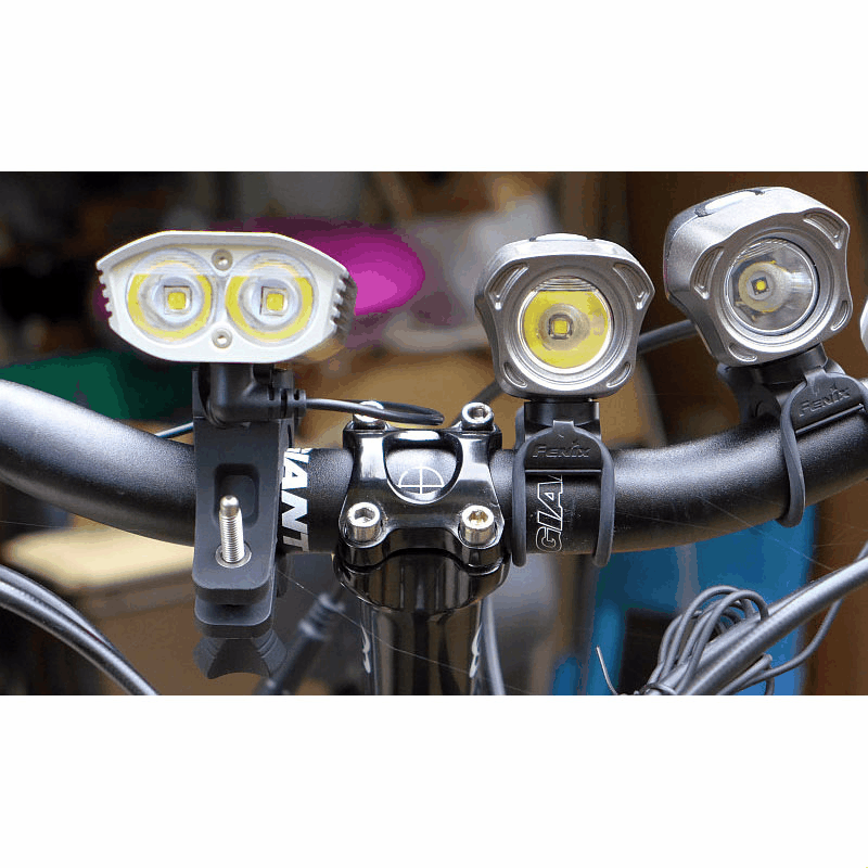

    The BC30 is shown with the BT20 and BT10 (which is being edged out), also shown is the remote switch in this case fitted just above the rapid shifter lever.

    Surprisingly, the BC30 worked best with the light mounted parallel to the ground. Usually I find I have to aim a bike light downwards slightly to get the lighting optimised, but with the BC30 the beam shaping does this for you, so a level mounting position seems to work perfectly.
    Thanks to the neatly designed mounting system (which has low profile rails), the BC30 actually works really well as a hand held light. I happened to have it with me in the office when the power went out, and used it as a flashlight. On a flat desk, it even managed to tail-stand and, via ceiling-bounce, provided my entire department with light. This would not be the case if it had a separate battery pack.
