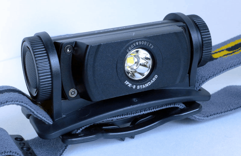

    HL55 and head mount assembled
    Angle adjustment ratchet
    The HL55 and its plastic mount

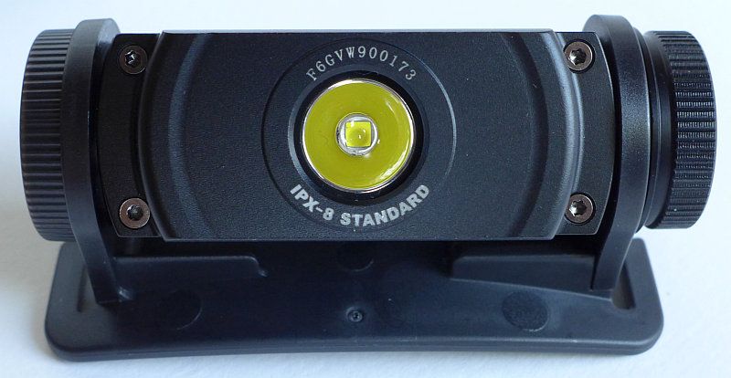

    Front view
    Close-up of XM-L2 LED and reflector

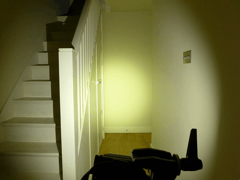

    The beam
    The HL55's beam is combination of flood and throw, and doesn't overdo either. There is a hotspot, but it is not so pronounced as to make the beam uncomfortable at close range, but gives it a bit more punch when looking further afield.

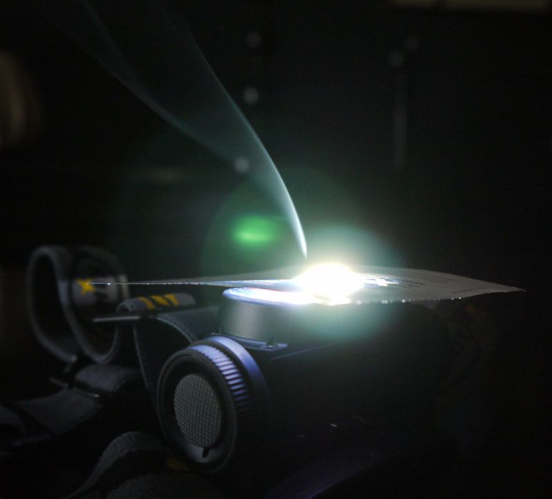

    Unusually, I must start this section with a warning.
    WARNING – The burst output is very intensive, and the HL55 has a small reflector. The result is a massively concentrated beam of light that generates significant heat. Fabrics and other flammable materials placed directly in front of the lens can easily be melted or burnt by the burst mode output.
    I can personally attest to this as during testing the HL55 burnt a hole in my sofa as it fell forwards into the fabric while burst was activated and now I have a HOLE burnt into my SOFA!!! Following this I have burnt through dark paper held directly in front of the lens.
    The switch only requires a gentle pressure, so accidental activation is quite likely. So, if you are going to transport this light in a bag, you MUST lockout the HL55 by unscrewing the battery cap. If you fail to do this, should the switch be pressed long enough to initiate burst mode you could find yourself spontaneously combusting.
