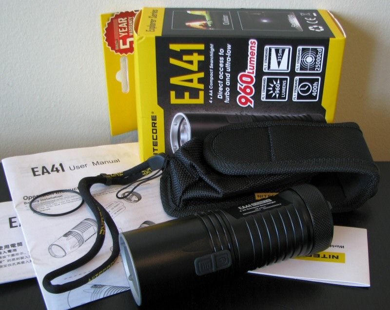

    The EA41 comes in similar packaging to the EA4 and other Nitecore Explorer series lights. Inside the cardboard box, you will find the light, holster with closing flap, decent wrist lanyard, extra o-ring, manual, and warranty card.

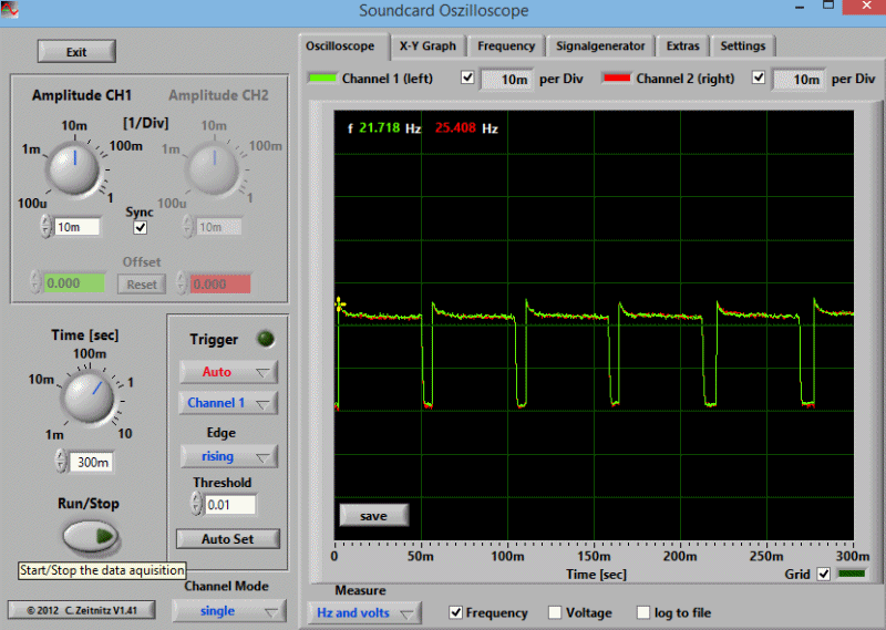

    PWM/Strobe
    There is no sign of PWM that I can see, at any output level – the EA41 is fully current-controlled, as claimed.
    Strobe:
    The strobe is a very high frequency strobe, typically around ~22 Hz in my testing. Note that that the duty cycle of this strobe is unusual, with the light only being on a fraction of the time. For most slower strobes, the duty cycle is about 50:50 (i.e., on half the time, off half the time, for each cycle). The EA41 strobe differs in its "on time", as shown in the close-up scale below.
    I've seen this before on really high-frequency strobes – it seems that as you increase the frequency, you tend to decrease the on-time. In any case, it is very disorienting.
    Note that this differs a bit from the original EA4, with had a true variable strobe (for both overall frequency and pulse duration).

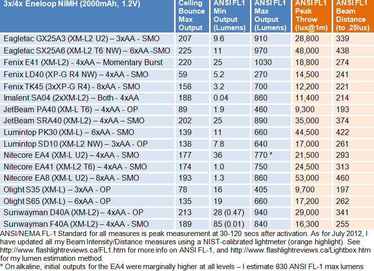

    And now the white-wall beamshots. All lights are on Sanyo Eneloop NiMH (4x). Lights are about ~0.75 meter from a white wall (with the camera ~1.25 meters back from the wall). Automatic white balance on the camera, to minimize tint differences.
    Consistent with the slightly deeper reflector on my EA41 sample, throw seems to be increased slightly over the EA4 (for equivalent output). Overall beam pattern remains very similar though, and consistent with this class. Scroll down for direct output and throw measures.
    The EA41 is very much in the same league as other 4xAA lights I've tested (although max output is a little lower than most of the recent competition). Peak beam intensity has increased from the EA4 though, due to the deeper reflector. Peak intensity and beam distance very closely match Nitecore's ANSI FL-1 specs for this model (T6 bin).
    Note that on my original EA4, there was a slight increase in max output on alkaline cells. This is no longer the case on the EA41 – NiMH and alkaline produce equivalent output on all levels. Let's see how my output estimates compare to the official Nitecore specs for this T6-version of the EA41 (and the original EA4, while we are at it):
    Generally, I get pretty good concordance with Nitecore output specs – except on the Turbo level, where I find initial output to be a bit lower than reported.
    Note that these level spacings are revised from the earlier EA4. Basically, the old Med mode is gone (with the old Lower/Lo levels moving to Lo/Med now), and a new Lower mode has been added. See my EA4 review for details on that light. I personally prefer these new level spacings now.
    Also, please be advised that the Turbo step-down feature is updated from the EA4. Now, on the EA41, there is a gradual reduction in Turbo output over the first 7 mins – at which point, it levels off at a new set level (~600 estimated lumens) for another ~13 mins. There is a second abrupt step-down at ~21 mins into the run, where the light drops to a new flat-stabilized level (~420 estimated lumens). See runtimes below for more info.
    While I generally get very good concordance with the official specs for the 2014 (T6-bin) version, I must say I am a bit surprised by what Nitecore reports for the recently released 2015 (U2-bin) version.
    UPDATE DEC 27, 2014: Please see my new "2015 edition" review for a comparison of the output and runtime of the 2014/2015 editions.

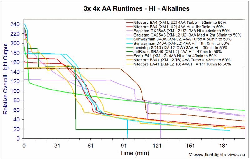

    Output/Runtime Graphs:
    Let's start with standard Sanyo Eneloop NiMH (2000mAh capacity)
    I know the above graphs are rather busy, but a general take-home message is that the EA41 is not very different from the EA4 in terms of overall efficiency. However, the runtime pattern on Turbo has changed, with revised step-downs.
    To see that better, here is a new set of comparisons on Panasonic Eneloop Pro NiMH (2550mAh typical capacity). Panasonic acquired Sanyo a little while back, and the new Panasonic-branded Eneloop Pro cells are an updated version of the former Eneloop XX cells (i.e., Panasonic Pros are basically 3rd generation XX cells, with improved charge holding ability). Given the difficulty in tracking down new 2000mAh Eneloops around here, I will be switching to these higher capacity cells in all new reviews.
    Basically, the EA41 remains fairly stable in max output (~750 lumens) for the first 2 mins or so, then gradually drops off in output over the next 5 mins or so. At 7 mins into the run, the output levels off at a flat ~600 lumens. After another 14mins (i.e., at ~21 mins into the run), the light abruptly steps down to a second flat-regulated output level of ~420 lumens. I saw something similar on my recent Nitecore EC20 review.
    Here is how it compares on standard alkaline/L91 lithium cells:
    Due to the electronic switches in the head, the light has a stand-by current when batteries are installed. I have not measured it in this case, but on most Nitecore lights it tends to be in a range that will drain fully-charged batteries over a course of months. There have been reports that the standby drain is higher when first connected, so you may want to activate/deactivate the light at the switch after a battery change.
    You cannot easily lock out the light physically, so I recommend you use the electronic lock-out in regular use, to prevent accidental activations.
    There are a couple of timed step-downs from Turbo on the EA41, similar to the EC20 that I recently reviewed.

    Default Re: Nitecore EA41 (XM-L2, 4xAA) review: RUNTIMES, BEAMSHOTS, VIDEO and more!
    Great review. I just don't understand how they claim 960 lumens for 1h 45m if it decreases in brightness after 2 minutes. Then again a 2nd time. How is this claim justified? Sunwayman at least mentions this On their website. Imalent and Nitecore flat out lie.
    Quote Originally Posted by Bigpal View Post
    Great review. I just don't understand how they claim 960 lumens for 1h 45m if it decreases in brightness for after 2 minutes. Then again a 2nd time. How is this claim justified? Sunwayman at least mentions this in the specs. Imalent and Nitecore flat out lie.
    Whether or not they're lying depends on who you ask. I say no, technically. But a bit shady if it is not disclosed. Anymore, I look at the medium level on lights to determine its usefulness if I'll be using it for any good period of time (hiking in the dark). Many times I'll just conisder the high/burst/turbo mode as something nice to have, fun to impress with, and use for a minute or two just for seeing further.
    GOOD TINT!
    Flashaholic* SCEMan's Avatar
    Nov 2005
    Pending ex-Taxifornian
    1,431
    Ditto here. I rarely use turbo other than momentary. High is very close to turbo in actual use and is much easier on the batts.
    Quote Originally Posted by markr6 View Post
    Quote Originally Posted by SCEMan View Post
    That's fine if that's the way you use the light and what you need, but for someone shopping for high output for 1h 45m reads their stat sheet, buys the light, gets it home and gets nothing close to that. The point is they should disclose it somewhere. Can I turn the light on and get 960 lumens for 1h 45m like their website/spec sheet advertises? No? Then it's a lie.
    Flashaholic* Timothybil's Avatar
    Nov 2007
    The great state of Misery (Missouri)
    3,608
    From the EA41 User Manual:
    NOTE: The EA41 will lower its output lumens after 20 minutes of use to
    prevent overheating and preserve battery longevity.
    Remember, Two is One, and One is None!.
    Quote Originally Posted by Timothybil View Post
    Ah, I see now. You just need to get the user manual for the light before you buy it to know about the step down.
    6,936
    This is a limitation of the reporting standard as well - ANSI FL-1 requires only the max output between 30 secs and 2 mins to be reported.
    I agree its important to look at the true runtime performance - actual graphs are key for this, which is why I focus on runtimes in my reviews. The dual step-down characteristic is starting to show up on some newer lights, and its important for people to know what to expect.
    Nov 2005
    1,431
    I guess I've been around long enough to realize that most manufacturers make questionable claims and therefore wait for selfbuilt or another reputable reviewer to show actual performance. But you're right, for someone just reading the box or spec sheet, it is deceptive (although widely practiced).
    Right. That's all I'm trying to say. I don't have a problem with the step down. It's OK if that's what you're looking for. I just think they should be transparent about it. Sunwayman states it plainly on their website. I was just looking at the Olight S30R - it's listed plainly on Going Gear's website. It just seems that Nitecore attempts to hide it like it's an unwanted feature. I know it's common practice and a minor annoyance, but I just find the ones who put it out in the open more respectable.
