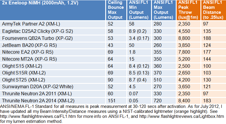

    • Output (ANSI)/Runtime: High: 280 Lumens/0.75 Hours, Medium: 70 Lumens/4 Hours, Low: 7 Lumens/32 Hours, Moonlight: 0.5 Lumens/360 Hours
    • Peak beam intensity: 2,700 cd (Reviewer's note: this is inconsistent with the beam distance measure below)
    • Max beam distance: 84 m

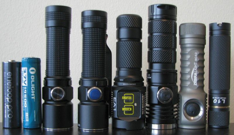

    From left to right: Olight RCR (650mAh), S10R, Olight 14500 (750mAh), S15R; Olight 18650 (2600mAh), S20R.
    From left to right: Panasonic Eneloop Pro, Olight 14500, S15R, S15 (2013); Nitecore EA1; Skilhunt DS15; Zebralight SC52; L3 Illumination L10.
    Olight S15R: Weight: 47.6g (69.2g with Olight 14500), Length: 89.6mm, Width (bezel): 23.1mm
    Olight S15: Weight: 46.4g, Length: 87.0mm, Width (bezel): 23.1mm
    Fenix LD12: Weight: 52.3g, Length: 99.9mm, Width (bezel): 21.6mm
    Nitecore MT1A: Weight: 54.6g, Length: 104.6mm, Width (bezel): 22.7mm
    Nitecore SENS AA: Weight: 26.1g, Length: 82.7mm, Width (bezel): 19.8mm
    L3 Illumination L10: Weight: 20.7g, Length: 79.4mm, Width (bezel): 17.1mm
    Lumintop ED15: Weight: 59.7g, Length: 100.2, Width (bezel): 21.9mm
    Skilhunt DS15: Weight: 52.0g, Length: 92.1mm, Width (bezel): 24.0mm
    Thrunite T10S: Weight: 60.9g; Length: 93.7mm, Width (bezel): 17.8mm, Width (widest): 18.7mm
    Xeno E03:: Weight: 48.1g, Length 96.7mm, Width (bezel): 21.5mm
    Zebralight SC52: Weight 39.5g, Length 79.0mm, Width (bezel): 22.6mm, Width (max) 25.4mm

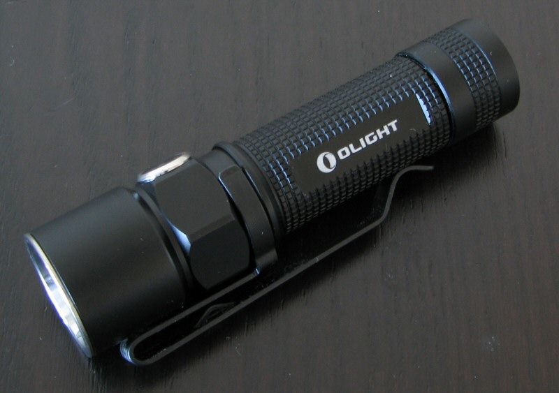

    Overall dimensions are similar to the S15 (2013), except the S15R is slightly heavier and longer now (likely to accommodate the charging circuitry).

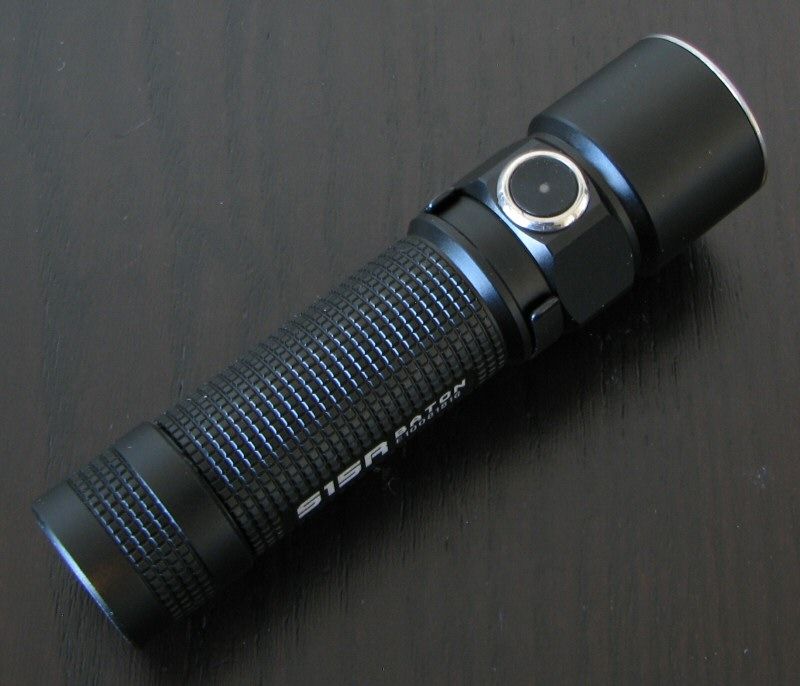

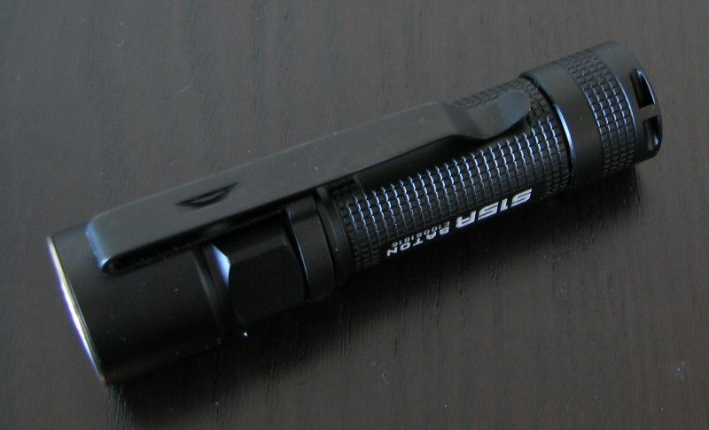

    Physically, the new "R" editions of the Baton lights look generally similar to the 2013 editions of regular Baton family. These lights remain relatively petite for their respective classes. Lights come with black anodizing (matte finish) and bright white labels. Although still without typical knurling, the raised checkered patterns on the body help with grip. With the reversible pocket clip attached, I'd say grip is good. What has changed is the button and tailcap design, which I will get to in a moment.
    The bi-directional pocket clip is comparable to the earlier models, no real change here. It seems to hold onto the light fairly securely. I personally like it, as you can clip it on you in either orientation (i.e., bezel-up or bezel-down carry), although it might be rough on clothing given how tightly it fits. Note that the S15/S15R uses the same clip as the S20/S20R – which is longer than the S10/S10R.
    In the head, the same sort of small spring and plastic surround is present, as on the original S15. This means that flat-top 14500 cells should work. Note that the length tolerances are tight for protected 14500. Even with the supplied Olight 14500, you really need to crank the tailcap tight to make contact.

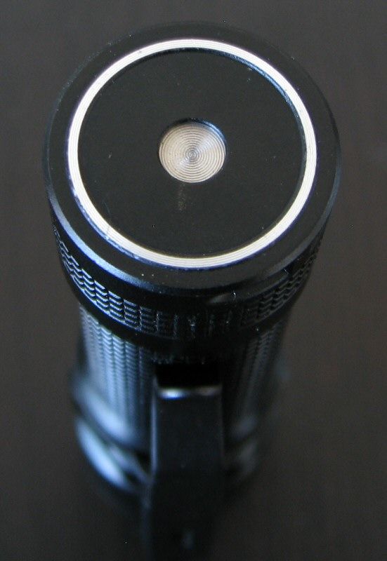

    The R-series tailcaps have been re-designed with a new charging dock feature – but otherwise functions as before. The S15R uses the same square-cut screw threads as before, still anodized for tail lock-out. Light can tailstand, and there is a split-ring/lanyard attachment hole on the side of the tail cap as before. And the tailcap still has a strong magnet, to allow the light to stand horizontally off any vertical metal surface. That said, I don't find the magnet quite as powerful as before. This means you may not be able to get the S15R to hold as stably off a small piece of metal (like a screw head on plastic plate cover, for example). It also does not seem to be removable now, as it is integral to how the charger functions.
    What is new on the tailcap are the two exposed metal areas – an outside ring, and a recessed inner circular contact. These connect magnetically to the charging dock. I am happy to report that there is no open voltage at the tailcap, so there is no risk of accidentally shorting the 14500 battery inside the light. Scroll down for discussions of the dock and charging process.
    As with the earlier model, the S15R uses an electronic switch in the head for on/off and mode changing. The button design has updated though – the hard plastic switch is now slightly recessed behind a raised metal surround. This means that the risk of accidental activation is now greatly reduced.
    A second change is the addition of a low voltage warning sensor under the switch (visible through the clear pinhole opening in the middle). The earlier S15 model lacked a low voltage sensor (previously present only on the S20). The red LED below the switch will light up and flash as the battery nears exhaustion.
    The head of the light is relatively unchanged, with a flat stainless steel bezel ring as before. However, the standard red o-ring has been replaced with GITD blue one.
    The S15R uses the same XM-L2 Cool White emitter and smooth reflector as the previous S15 (2013). The emitter remains well centered on my samples. Please scroll down for beamshots.

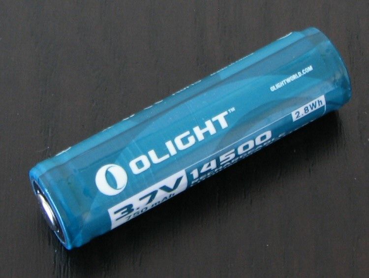

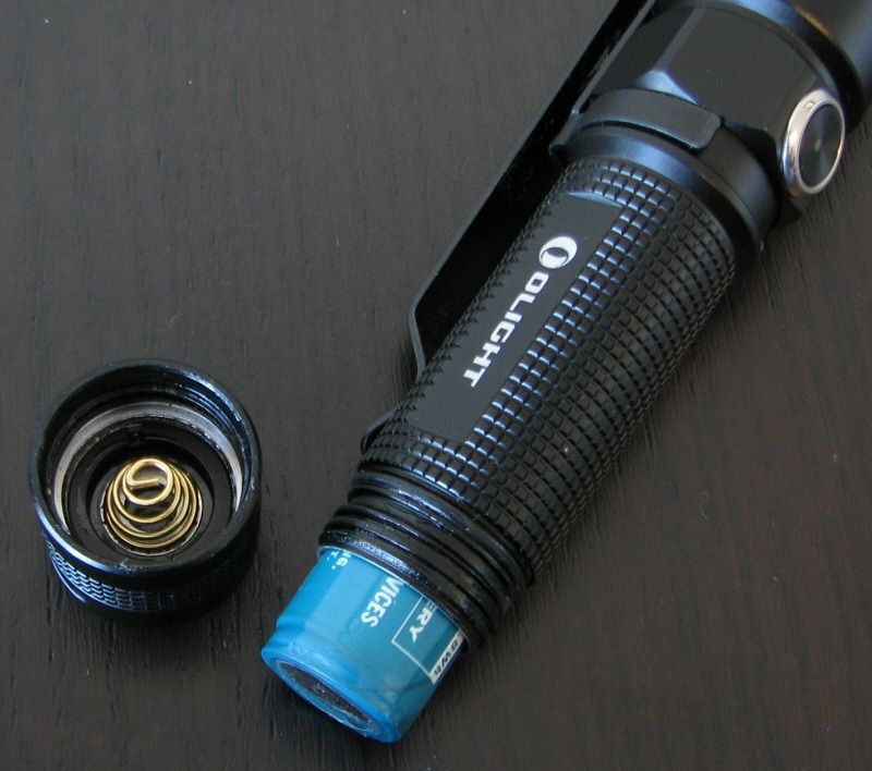

    Olight Battery
    All the new R-version models come with an appropriately-sized Olight-branded battery (3.7V Li-ion). Rated capacity of the 14500 included on the S15R is 750mAh, which is about typical for this class. Scroll down for actual testing results.
    As mentioned before, tolerances are tight for length on the S15R. I find you really need to crank the tailcap tight on my sample, in order for the S15R to run on its supplied 14500 (no problem with standard AA cells, which are shorter).

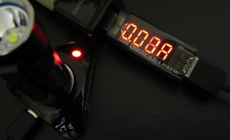

    Because the AC charger uses a USB connector to the charging cable, I was able to take direct measures of the charging parameters using my Xtar VI01 "USB Detector" (basically a specialized USB current/voltage meter). There are many of these on the market now, and this model was favorably reviewed by HKJ here.
    For charging tests, I started with a discharged Olight 14500 battery (protection circuit tripped). For all these tests, I left the USB detector in place for all readings. Note that the voltage reading on this device refers to the input voltage (i.e., from the USB port).
    Initial charging current and input voltage:
    As you can see, charging started at 0.49A with a typical USB ~5V input voltage ("U" is meant to represent Volts on the top display above). This is fully consistent with the USB 2.0 specs.
    After 45 mins, the charging rate was significant reduced, to ~0.37mA.
    By 1hr 15 mins, the rate was down to ~0.27A
    By 2hrs, the rate was down ~0.17A
    By 2hrs 15 mins, the rate was down to ~0.14A
    And by ~2hr 20 mins total time, charging had terminated (and the dock LED was green - not shown in the pic below, which is from my S10R review):
    Note however that final resting battery voltage was only ~4.14V. Olight apparently plans to adjust this or the more typical ~4.2V full charge.
    This pattern is pretty much what I would expect from a typical CC/CV algorithm.

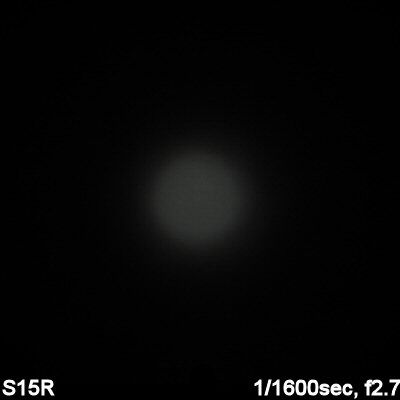

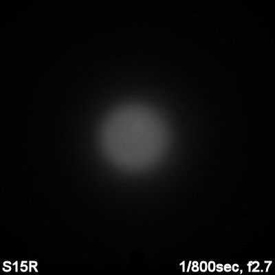

    For white-wall beamshots below, all lights are on Max output on an 3.7V Li-ion (RCR) battery. Lights are about ~0.75 meter from a white wall (with the camera ~1.25 meters back from the wall). Automatic white balance on the camera, to minimize tint differences.
    1x14500:
    Beam pattern remains very similar to the S15 (2013), as you would expect (i.e., the Batons are all relatively "floody").
    I haven't bothered to show 1xAA or 2xAA beamshots, but you can infer relative appearance from my output tables later in this review.
    There isn't an output difference between the new S15R and the previous S15 on 14500 Li-ion. However, there is a definite drop in max output on 1xAA batteries.
    Although the manual makes no mention of 2xAA support, I figured it was a safe bet since the voltage is 2xAA is intermediate to the 1xAA and 1x14500 configurations. The 2xAA extension tube offered on the original S15 still fits on S15R, so I thought I'd give it a try.
    Output levels on 2xAA are virtually identical to 1x14500 (although I did find a slight increase in output over the first minute or two, on fresh cells)
    To better illustrate relative levels better, here is a detailed output comparison to S15, on 1x battery configurations.
    I haven't shown 2xAA, since it's basically the same as 14500 (except for the slight bump in initial Hi).
    As you can see, the specs haven't changed from the original S15 released in 2013. And in terms of 14500 performance, initial output levels seem unchanged across the board. Generally, output is no different between standard AA and 14500 – except on Hi. In fact, this is the only thing that has changed on my samples – my S15R is definitely lower output on Hi than my original S15. See my runtimes for more information.

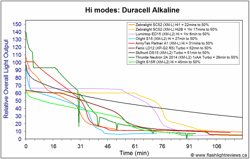

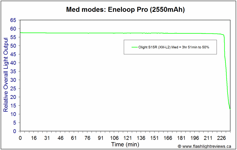

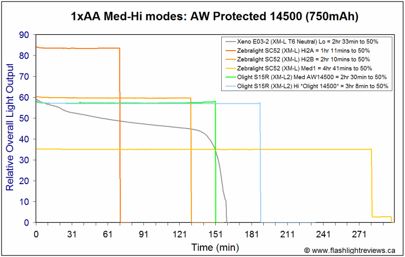

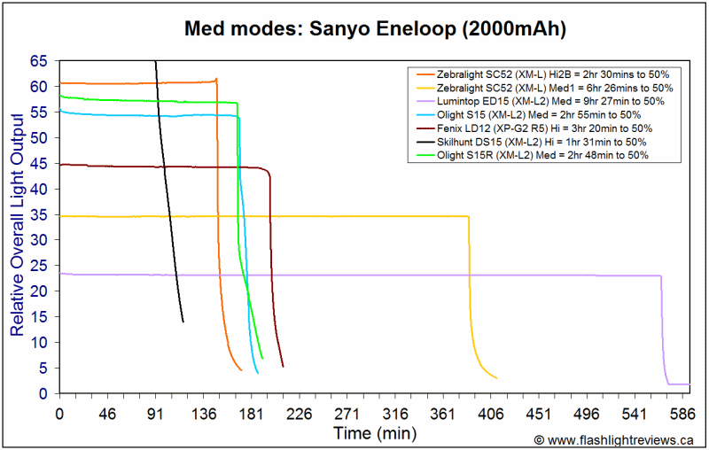

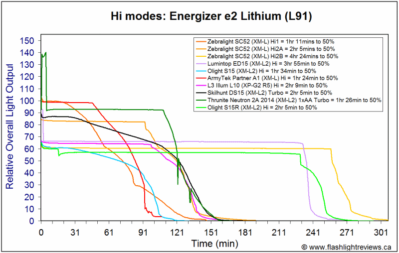

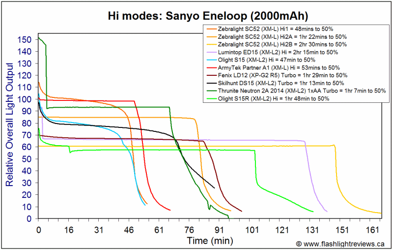

    Output/Runtime Graphs:

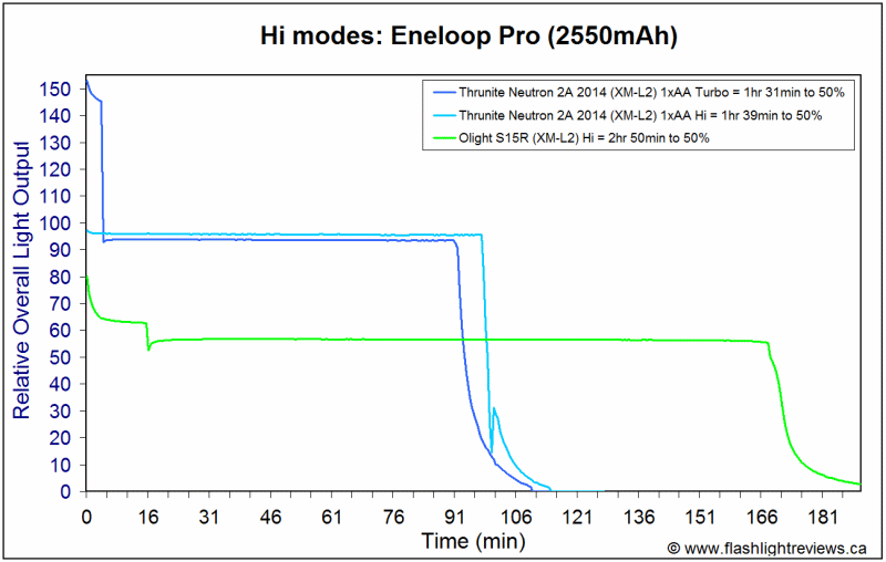

    I have begun to switch to using newer Panasonic Eneloop Pro (2550mAh typical capacity) for my NIMH testing. Panasonic acquired Sanyo a little while back, and the new Panasonic-branded Eneloop Pro cells are an updated version of the former Eneloop XX cells (i.e., Panasonic Pros are basically 3rd generation XX cells, with improved charge holding ability). For the time being, most of my runtime data is still using 2000mAh Eneloops, so both types are shown below,
    1xAA/14500:
    Ok, there's a lot a data up there. Let's start with the 14500 performance.
    The step-down pattern on Hi is different on the S15R than the original S15 (and different from the concurrent S10/S10R as well). On the new S15R, the light steps-down abruptly from Hi to Med after 15 mins runtime. On the S10/S10R, the light starts to step down after 4 mins runtime (and takes another 4 mins to reach the new steady-state). Also, on the S10/S10R, this extended Hi runtime is intermediate to the initial Hi and Med modes (i.e., this differs from the S15R, which steps down to the defined Med level). There was no step-down on the original S15.
    As with my S10R, the supplied Olight Li-ion (14500 in this case) has a longer runtime than my standard AW battery. This suggests it is even greater capacity than the "750mAh" would indicate. The difference is even more pronounced in this case over the RCR in the S10R, but that's likely because of the ability of the Olight 14500 battery to accept a full charge. For some reason, my Olight RCR would only charge to ~4.15V, even with an external charger.
    On the standard AA cells, the runtime graphs indicate that not only is initial output on Hi reduced from the original S15, but it rapidly drops off over the first couple of minutes. Basically, within minutes, the S15R on Hi is not that much brighter than Med (on standard AA/NiMH/L91). And again, after 15 mins, it actually drops to the Med level (although that distance is not very great). There has clearly been a circuit change with the S15R, and standard AA cells are clearly not fully supported on Hi any more.
    However, overall output/runtime efficiency on all levels (on standard batteries) is excellent on the S15R. This is something that was less impressive on the S15 – it was really in the 2xAA configuration that the S15 truly impressed.

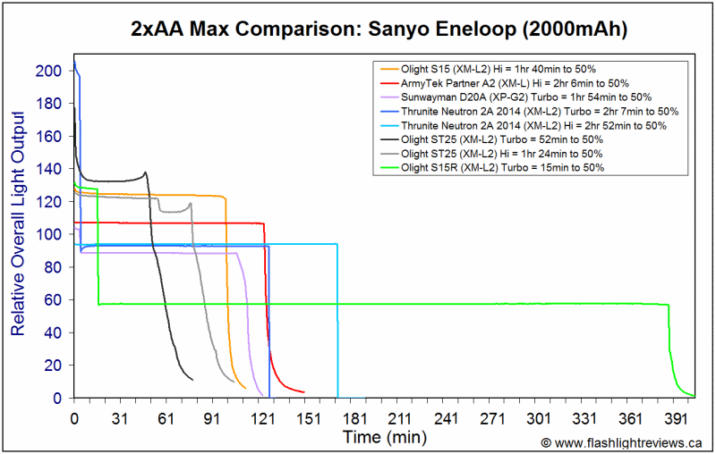

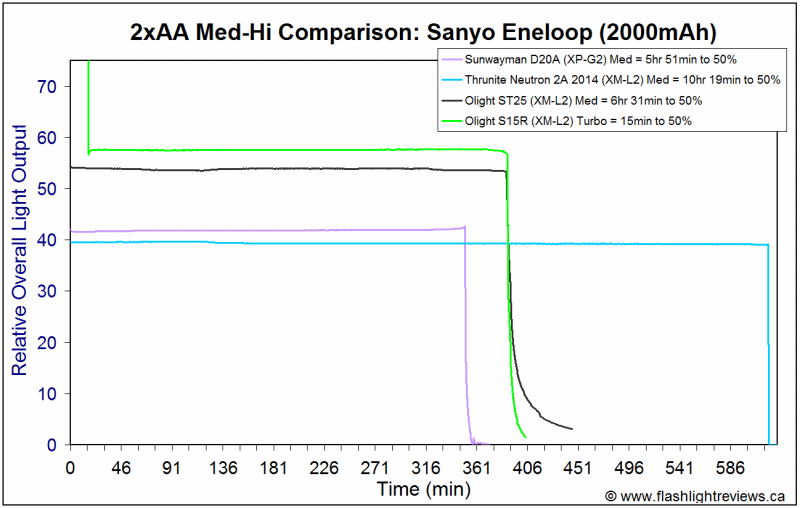

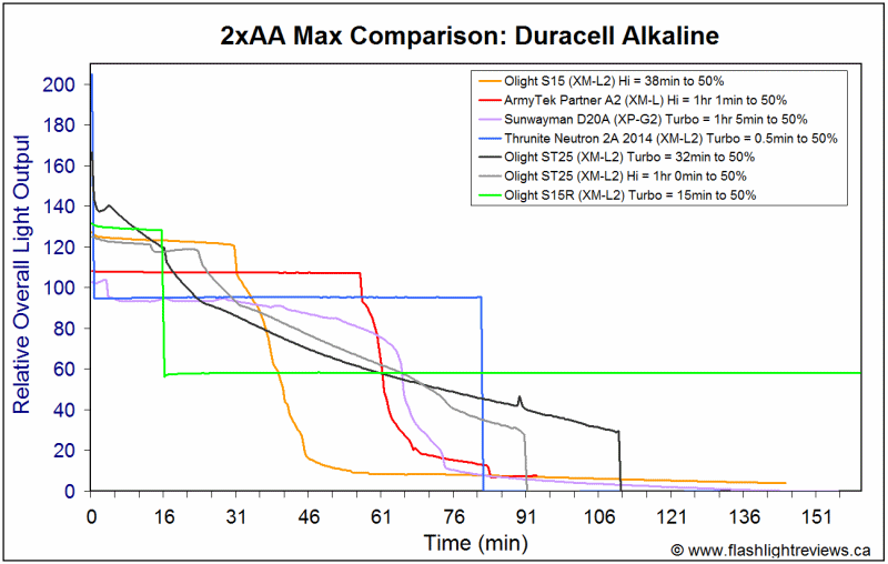

    2xAA:
    For 2xAA, I have done runtimes on a couple of battery types, and only on Hi. Note that since the S15R drops to Med after 15 mins, many of these runtimes would look better on the Med runtime graph scales. Also note that I mistakenly labeled the S15R runs as "Turbo" below (I meant to say "Hi").
    As before, the S15R is quite an efficient performer on 2x standard alkaline/NiMH AA batteries. Note sure if Olight is still offering the S15 body extender tubes for sale, but they are a nice option on the S15R too, in my view. Just make sure you don't try to run 2x14500 – or the circuit is likely to go poof!

    I have had the Olight S15R for two months, and I got some impressions after extended use in the field. Hope this thread is appropriate for such comments.
    • The clip came off one night, not surprisingly (it's spring loaded). Without the clip, it gets pretty hard to find the button in the dark (as it is almost flush with the body of the flashlight, and there is no distinguishing feature where the button side is). A more protruding button would of course make accidental activation easier, but some sort of ribbing in the metal or other mark around it would be nice.
    • I quite liked the modes, easy access to moonlight (hold press & release), easy access to turbo (doubleclick from off - although the timing is pretty critical here). UI is pleasant to use.
    • Magnetic dock is great for desk use, not so great for field use - I charged it from solar panels (via a powerbank, as I am not sure how the internal charger circuitry handles fluctuating current directly from solar), and for such use an (optional perhaps) magnetic cable (like Klarus has) would be better than the dock, as it's just another small gadget to loose or break.
    • The flexibility of a rechargeable light with optional primary cell backup was great. Although for my use, I fortunately never even had to change to primary cell backup.
    Few things to make it even better:
    • locking clip as a distinguishing feature to easily find the button in the dark
    • (optional) magnetic charging cable with USB on one end for field charging (smaller and more rugged than the USB dock)
    Unfortunately, after two months of use, the flashlight broke down. At first, it would not change modes, and finally the LED just flashed and died completely. I must have gotten a bad sample probably. With a generous 5 year warranty, I hope it will get sorted quickly. The flashlight is currently on the way for replacement.

    Good luck with that, no sarcasm.
    Olight hasn't responded since I mentioned S10R an S15R suffer from same issue that S30R had.
    I've a couple that are problematic myself.
    Last I heard from their representing Rep here in forums was over a month ago. Olight CS directly through email, two months now.
    Olight CS said in an email they'd get me new fixed tail caps,
    In July.

    Default Re: Olight S15R (XM-L2, 1x14500/AA) Rechargeable + Dock Review: BEAMSHOTS, RUNTIMES+
    Hi Frank
    The Olight Rep told me that my delay was them re engineering tail cap so it would not jam itself up anymore.(Not sure I believe)
    So the likely hood of your cap failing again is down to, if the seller gave you a cap off of another light in stock or, got one of these new versions.
    I still have not received replacements for mine to date.
    If yours gets jammed up again, I guess we'll know which you got.
    I have to update my sour posts☺
    Parts were in mail yesterday waiting for me when I got in.
    As mentioned, they are new style. Obvious retaining ring inside difference from earlier design doing just a visual. Functions as expected.
