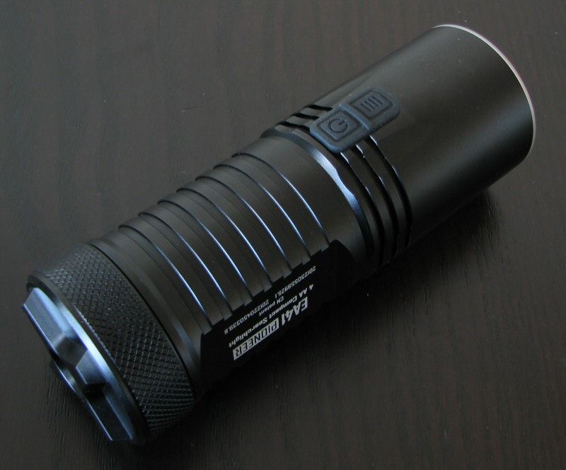

    External packaging for the EA41 has been updated with the new "2015 VERSION" banner, revised emitter output bin (U2) and revised max output and beam intensity measures. Note that the printed beam intensity measures are wrong, and have since been revised down on the Nitecore website (see current official specs above).
    Inside, the packaging is the same as the 2104 edition. Along with the light, you will find a holster with closing flap, decent wrist lanyard, extra o-ring, manual, and warranty card.

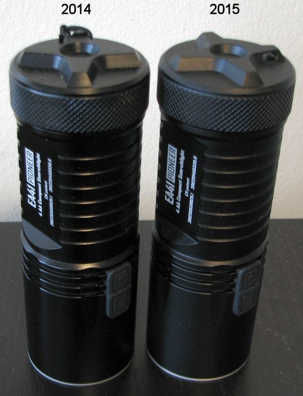

    Note that the light looks exactly the same as the previous 2014 edition. There are no identifying labels anywhere on the light to indicate it is a new edition. As such, I will re-use the body pictures from my 2014 review below.

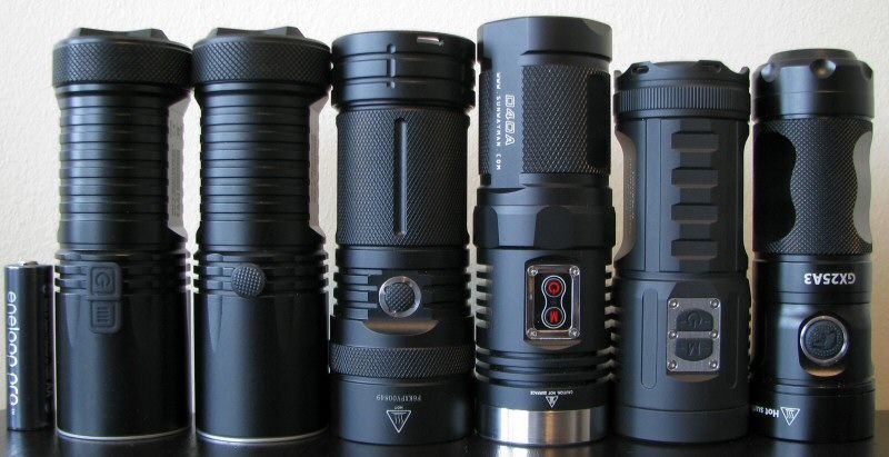

    From left to right: Panasonic Eneloop Pro (2550mAh) NiMH; Nitecore EA41, EA4; Fenix E41; Sunwayman D40A, F40A; Eagletac GX25A3.
    Nitecore EA41 2015 4xAA: Weight: 147.9g , Length: 118.4mm, Width (bezel): 40.1mm
    Nitecore EA41 2014 4xAA: Weight: 149.9g , Length: 118.2mm, Width (bezel): 40.1mm
    Nitecore EA4 4xAA: Weight: 161.6g , Length: 117.9mm, Width (bezel): 40.2mm
    Eagletac GX25A3 3xAA: Weight: 151.4g, Length: 109.2mm, Weight (bezel): 38.6mm
    Fenix E41 4xAA: Weight: 204.1g , Length: 115.9mm, Width (bezel): 44.1mm
    JetBeam PA40 4xAA: Weight: 184.0g, Length: 183mm, Width: 40.8mm (bezel), 42.1mm (max width)
    JetBeam SRA40 4xAA: Weight 236.0g, Length: 126.1mm, Width (bezel): 48.5mm
    Lumintop SD10: Weight: 117.6g, Length: 120.3mm, Width (bezel): 40.1mm
    Olight S35 3xAA: Weight 177.3g, Length: 127.7mm, Width (bezel): 38.7mm
    Sunwayman D40A 4xAA: Weight: 167.9g, Length: 120.4mm, Weight (bezel): 40.0mm
    Sunwayman F40A 4xAA: Weight: 182.0g, Length: 109.3mm, Weight (bezel): 42.0mm

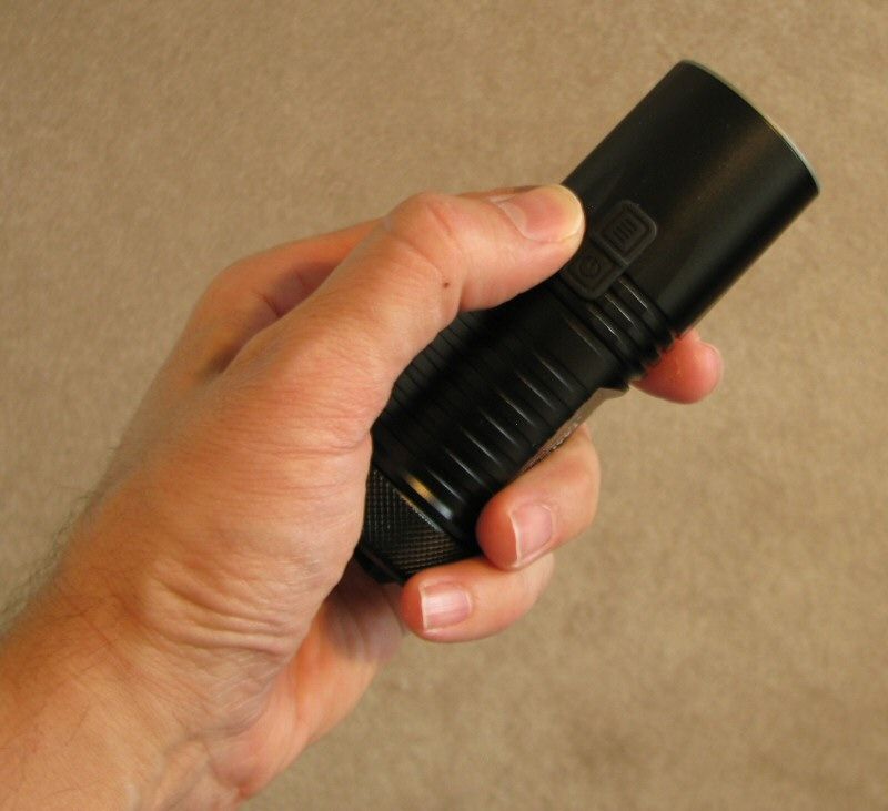

    There is some very minor fluctuation is dimensions between my samples, but I expect that is just normal natural variation.

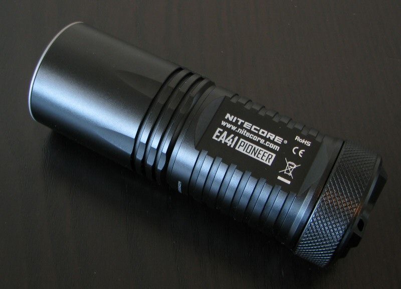

    Again, there is no significance difference in the physical appearance of the light, between the 2014 and 2015 editions. The EA41 series is generally cylindrical, with thick ridges along the body to help with grip. There is no knurling per se, except on the tailcap (but is fairly mild here). Anodizing on my 2014 edition is even more matte finish (flat black) than my previous 2014 edition, but that is again likely just natural variation between samples.
    As before, body labels are rather extensive. What I previously thought was a serial number turns to be just a model number – all labels are the same on both my samples. Labels remain very legible and clear.

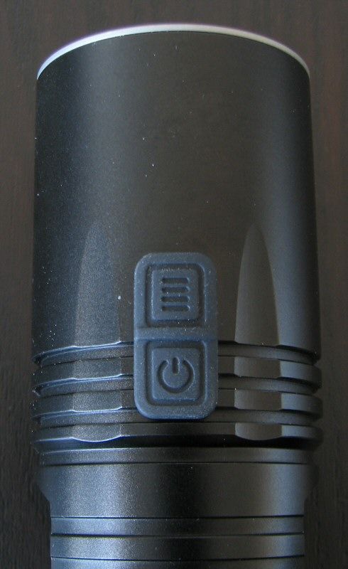

    The EA41 uses two square buttons, located one above the other, as before. The lower button is the power button, and the upper is the mode changing button (see my User Interface section for more info). Button feel is fairly "grippy", and they are slightly raised. That said, the lights do have a tendency to roll away from you.
    As before, there is also a single faint blue LED located underneath the switch area. This is used to signal the state of the light (i.e., battery status, standby). Scroll down for an explanation of the interface.

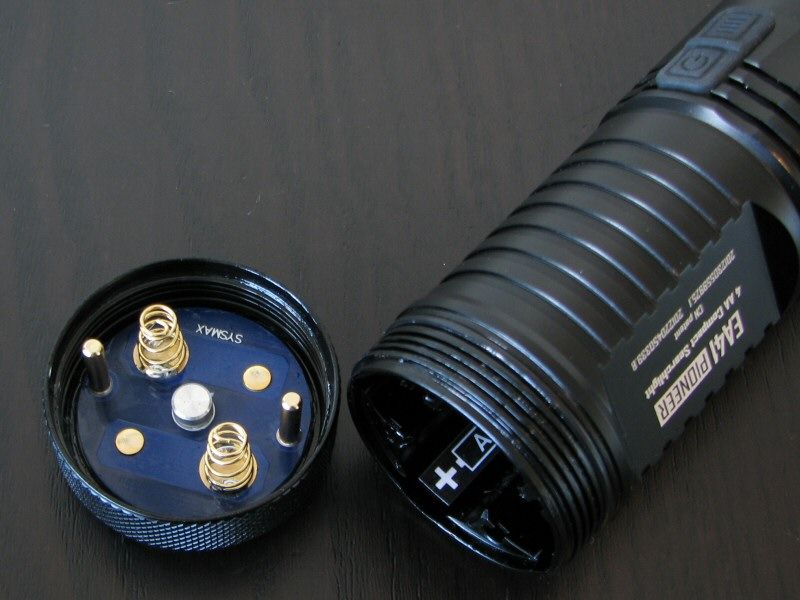

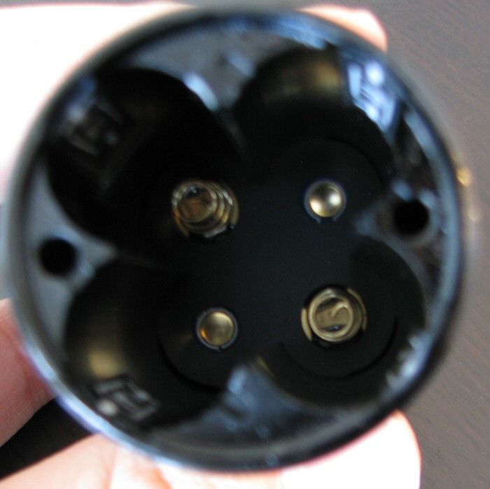

    Battery handle is quite compact, but easily houses 4xAA (alkaline, NiMH or L91). The battery compartments are molded right into the aluminum, with the cells in a series arrangement as before.
    Screw threads are square-cut and anodized as before, but it doesn't really matter – there is no physical lock-out, because the connection is carried by the contacts in the tailcap and not the body. You would need to loosen almost all the way off to break this contact.
    The light can tailstand as before. There is a cut-out on the base to allow you thread a wrist-lanyard through.

    The user interface is unchanged from the 2014 edition of the EA41. Note that it is significantly updated from the EA4, thanks to the use of two separate switches on the EA41.
    Activation is controlled by the lower power switch – press and release (i.e., click) to turn the light on at the previously memorized constant output level. Click the power switch again to turn off.
    While on, click the upper mode switch repeatedly to cycle between the five main output levels in the following repeating sequence: Lower > Lo > Med > Hi > Turbo, in a repeating loop. Note that my EA41 manual still incorrectly states you should "half press" the mode switch to change levels (in fact, you need to do a proper click). The light has mode memory, and will return to the last level used when turned back on from off.
    Note that Lower/Lo/Med/Hi output levels have changed somewhat from the 2014 edition EA41 - see my direct measures later in this review.
    There are a couple of shortcuts available - you can jump directly to Lower or Turbo mode from Off. Press and hold the power switch from Off for more than 1 sec to activate in Lower. Press and hold the mode switch from Off for more than 1 sec for Turbo. Cycle through modes or turn off as before. You can also jump directly to strobe from Off by a double-click of the mode switch.
    For the special modes (i.e., blinking modes), these are normally accessed from On. With the light on, press and hold the mode switch for more than 1 sec. The light will enter into Strobe. To advance to Location (aka beacon mode), press and hold the mode switch again. To advance to SOS, press and hold the mode switch again. A click of the mode switch exits back to constant output modes. Note that there is no memory for the blinking modes.
    The light will read-out the voltage of the cells when you first connect the tailcap, by a series of blue flashes under the switch cover. 3 flashes means there is >50% battery life remaining. 2 flashes indicate <50%, and 1 flash means the batteries are almost dead. You can also check the voltage at any time (when Off) my a single click of the Mode switch.
    To activate the "special" standby feature, press and hold the power switch when turning Off the light. The faint blue locator LED will flash every ~3 secs in this standby mode. This standby flash is disabled by default.
    To lockout the light, you need to start with the light On. Press and hold both buttons for more than 1 sec to electronically lock-out the light. The light will flash once to confirm the lockout. The same sequence (from Off) is required to unlock the light.

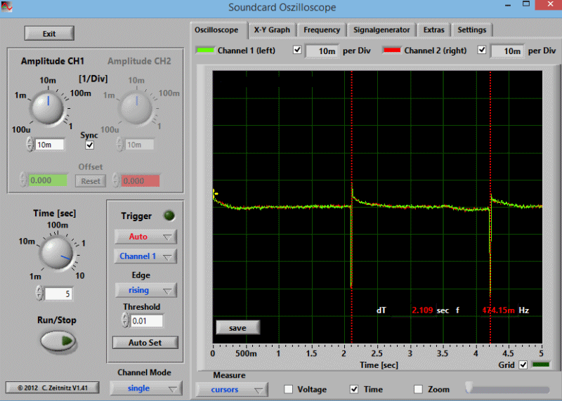

    PWM/Strobe
    There is no sign of PWM that I can see, at any output level – the EA41 is fully current-controlled, as before.
    On the 2014 edition, I reported that strobe was a very high frequency of ~22 Hz, with an altered pulse duration duty cycle (i.e., not the typical 50:50 on/off). This differed from the original EA4, with had a true variable strobe (with a variable overall frequency and pulse duration). My 2015 edition sample brings back the variable pulse duration seen on the EA4, although at the higher frequencies observed in my 2014 EA41.
    What you are looking at above are a few screen grabs from my oscilloscope, showing that the strobe speed (frequency) varies from between ~18-25Hz, with varying pulse durations.
    The above analysis doesn't matter much in use – all models are extremely disorienting.

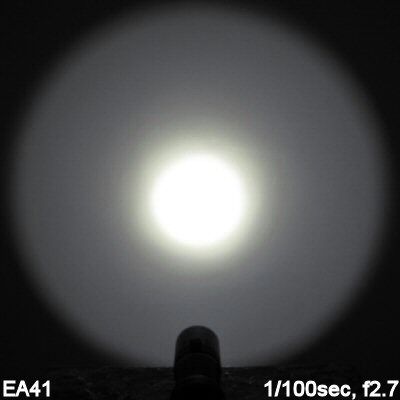

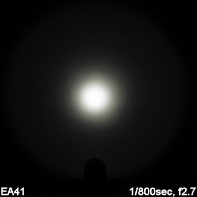

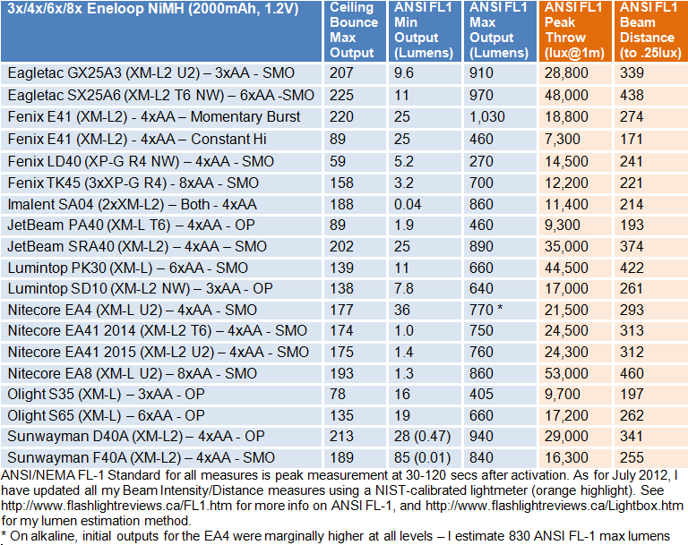

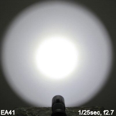

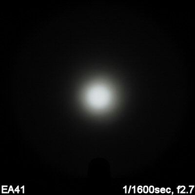

    And now the white-wall beamshots. All lights are on Sanyo Eneloop NiMH (4x). Lights are about ~0.75 meter from a white wall (with the camera ~1.25 meters back from the wall). Automatic white balance on the camera, to minimize tint differences.
    There really isn't much difference between the max output or throw of my 2014 and 2015 editions of the EA41. I did notice some tint variation (especially in the hotspot/corona), but this is to be expected between any two samples of a given light. Scroll down for direct measures of output.
    In terms of comparisons to other lights, the deep reflector of the EA41 certainly makes this one of the "throwier" examples of this class, with a relatively well defined hotspot.
    Consistent with the beamshots, there is no real significant difference in the max output or throw of the 2015 edition of the EA41.
    There was some confusion with the initial release of the 2015 edition as to whether or not output was significantly increased on all levels, compared to the 2014 model. Although Turbo output specs have increased only nominally (consistent with a single output bin step), there was initially a huge increase reported for max beam intensity/distance (i.e., 35,594cd, as printed on the 2015 edition box). This has recently been corrected on the Nitecore website to 28,276cd – which is much closer to what I actually found on my sample.
    But what about the output at the sub-max levels? Here you can see a more significant increase in the output specs (although oddly with no reduction in official runtime). Let's do a comparison of my direct output measures for these two editions.
    Before we start, please be advised that the Turbo step-down feature on the EA41 is a dual step. As I showed in my 2014 edition, there is a gradual reduction in Turbo output over the first 7 mins – at which point, it levels off at a new set level for another ~13 mins. There is a second abrupt step-down at ~21 mins into the run, where the light drops to a new flat-stabilized level. I will report output at all of these levels below:
    What I am showing above are the current official specs for the 2014 and 2015 editions, and my direct measures in my calibrated lightbox. In the last column, you will see a comparison of the percent change; reported followed by measured.
    As you can see, the reported max output has only increased by the estimated output difference between the U2 and T6 bins (i.e. ~6%). At the lower levels, there is a larger reported increase – which implies that Nitecore has increased the drive levels at the Lo/Med/Hi compared to the 2014 edition.
    My testing above bear this out. Generally, I get pretty good concordance with Nitecore output specs – except on the Turbo level of both models, where I find initial output to be lower than reported. My 2015 sample is only ~2% brighter initially on max than my 2014 sample. But that is the nature of output bins - any single bin step is on average ~6% brighter, but any two specimens could be anywhere from ~1-13% brighter, depending where each fell within its defined bin.
    The take home message is that Nitecore is accurate in its relative reported increases in output, at all levels. But those hoping to see a significant increase in max output will be disappointed - the 2015 edition is definitely not driven any harder on max.
    Of course, something that doesn't make sense is why the official runtime specs haven't changed. The output at sub-max levels have increased by more than one output bin step, indicating Nitecore has increased drive current on all sub-max levels on the 2015 edition. There is no free lunch here – you cannot raise drive levels without it negatively affecting total runtime. So let's see how that looks …

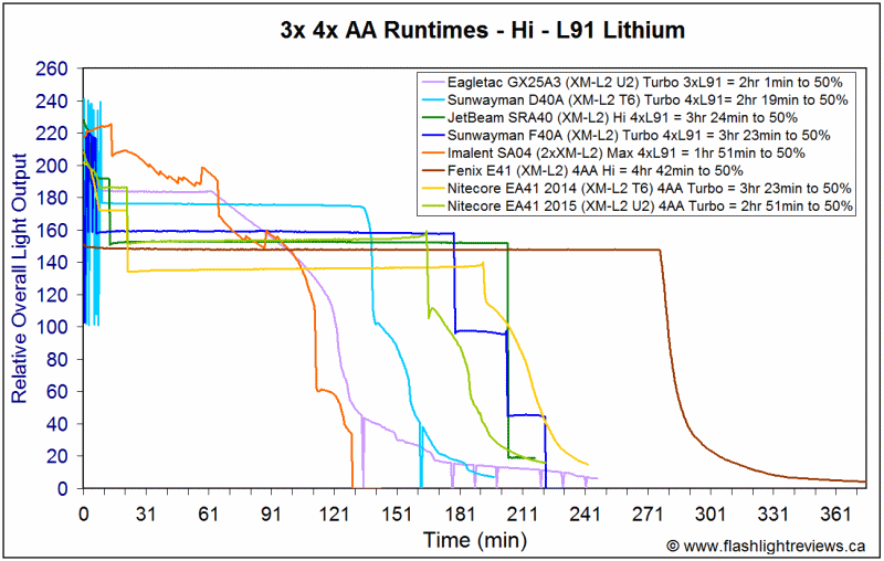

    Output/Runtime Graphs:

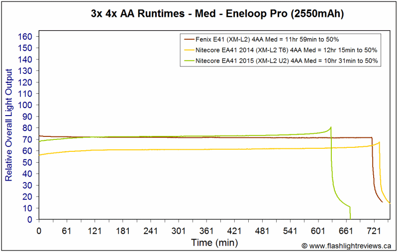

    I have been moving my NiMH AA testing to the newer Panasonic Eneloop Pro NiMH (2550mAh typical capacity). Panasonic acquired Sanyo a little while back, and the new Panasonic-branded Eneloop Pro cells are an updated version of the former Eneloop XX cells (i.e., Panasonic Pros are basically 3rd generation XX cells, with improved charge holding ability). For more comparisons of the 2014 edition EA41 to other lights in this class on standard 2000mAh Sanyo Eneloops, please see my 4xAA Round-up Review.
    Although initial max output is not changed much on my sample, there are noticeable output increases across all the other levels (including the two step-downs from Turbo). Otherwise, regulation pattern looks very similar (i.e., flat regulated, with identical Turbo step-down timings).
    What this means is that absolute runtimes are shorter on the 2015 version, as expected. There is no way around that – when you increase the drive levels, runtimes will be lowered proportionately. The single output bin step does help here (i.e., raises output/runtime efficiency slightly). Note that overall output/runtime efficiency remains very good on the EA4/EA41 series lights.
    Due to the electronic switches in the head, the light has a stand-by current when batteries are installed. I have not measured it in this case, but on most Nitecore lights it tends to be in a range that will drain fully-charged batteries over a course of months. There have been reports that the standby drain is higher when first connected, so you may want to activate/deactivate the light at the switch after a battery change.
    You cannot easily lock out the light physically, so I recommend you use the electronic lock-out in regular use, to prevent accidental activations.
    There are a couple of timed step-downs from Turbo on the EA41, similar to the EC20 that I recently reviewed.
    The take-home message is that the 2015 edition of the EA41 is very similar to the 2014 edition, with slightly higher output on the sub-max levels only. On Turbo, I see no significant initial differences between my samples (although the step-down levels are marginally higher on the 2015 edition).

    I think You have a mistake in the runtime in the Output/Runtime Graph on Hi (Eneloop Pro):
    For the Nitecore EA41 2015 on Turbo the time of 1hr 37m to 50% does NOT correspond to your runtime graph (should be more than 2hr).
    Thank You very much,

    Quote Originally Posted by roberta View Post
    Yes, you are right - I'll re-check the data file and update the legend tomorrow.

    Ah, what I mean is the proportionate increase that Nitecore reports. So, for the example of Turbo, they report a 6% increase (1020 vs 960 lumens). For Med, they report a 33% increae (160 vs 120 lumens). The percent increase gives you the right idea of what to expect (i.e., the relative reported increase).
    The problem with the absolute reported values (in lumens) is that they don't seem to be accurate at all levels. So while the Med mode probably is ~160 lumens now, the Turbo is definitely not 1020 lumens on my sample. But proportionately, the relative increase is correct. I
    I see! Thanks for the explanation SB.

    Smile Re: Nitecore EA41 2015 (XM-L2 U2, 4xAA) review: RUNTIMES, BEAMSHOTS, VIDEO and more!
    Good Day Selfbuilt,
    Great review!
    Best Regards,
    Roberta

    6,936
    Default Re: Nitecore EA41 2015 (XM-L2 U2, 4xAA) review: RUNTIMES, BEAMSHOTS, VIDEO and more!
    Good Day Selfbuilt,
    Any update on this?
    Yes, graph is fixed - it was 2hr 5min to 50% on Turbo on Eneloop Pro in the 2015 version, in my testing.

    Just an update on the issue of the standby drain.
    As I mentioned in the review, it is complicated to try and directly measure the standby drain on the EA41. So I thought I would try an indirect method. Using my Maha C9000 charger, I charged two relatively new sets of Eneloop Pro until "done" was shown on the display (note that the Maha tends to continue trickle charging beyond this point, so these may not be considered "fully charged", only consistently charged). I placed one set of four into the EA41 2015, activated the light, and immediately turned off (with no standby flash). The other set of four sat on the shelf. After 16 days with no interference, I removed the batteries and ran them all through a discharge cycle on the Maha.
    The batteries that were left alone had an average discharge capacity of 2405mA (note as well that the Maha may not "fully discharge" in this mode, but it should be consistent). The batteries in the light, which were subject to a standby drain, had a discharge capacity of 2276mA. That means the batteries inside the light lost 127mAh over 16 days, or 8mAh/day.
    Based on this very limited test, and taking into account the typical self-discharge rate of eneloops, I would tentatively conclude that you should expect less than 9 months lifetime for unused Eneloop Pro (2500mAh capacity) cells in this light, and less than 7.5 months for regular Eneloop (2000mAh capacity). Note the it could be worse than that - I haven't measured the drain of partially depleted cells. But you could take these as a guideline for approximate upper limits. As these are fairly significant standby drain levels, you should probably store the light fully disconnected when not in use.
