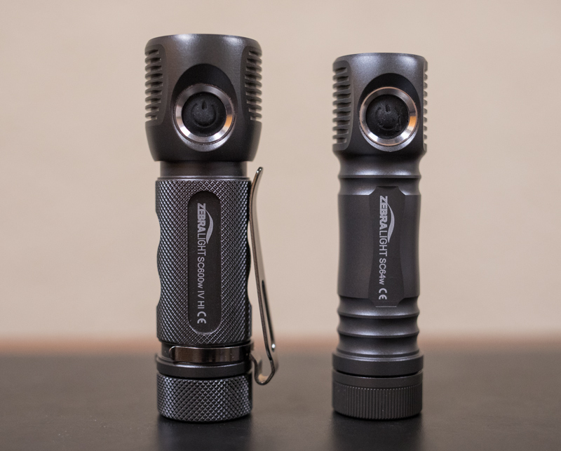

    Tested the SC600w IV HI (replacement) and SC64w last night. ABSOLUTELY THRILLED with this set!! They even included a free NCR18650GA.
    I ordered some spare silver clips (SC63 style) and planned on replacing the black, but I don't know. Even after all the trash I talked about the black, I'm OK with this. Maybe it was just my SC5w II that it didn't work well with. Seems fine on the SC64w. Not loose, not tight.
    No issues with the IV HI turning off within 1/2 second like my previous light. No issues with the SC64w at all.
    Nice dark anodizing. Quiet yet responsive switches - the best yet!!
    Tint? Damn, just perfect. PERFECT!! Both of them are a match and I detect the slightest tannish/pinkish color. Almost like a good 4500K Nichia. Absolute perfection. So glad I didn't go with the SC64c.
    And some pics...
    I tried to vary the distance and modes to match the intensity, but still blew out the SC600. You can still see the nice similar tints though.
    Thanks again Zebralight!!
