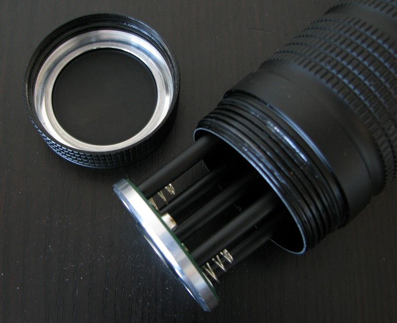

    The light opens at the tailcap only. Tail threads are square-cut, and anodized for lock out. Tailcap is flat, and allows tailstanding.
    The PS03 uses a battery carrier for its 4x 18650 cells. Carrier has metal end plates, and seems of good quality. All my protected cells fit and worked fine inside the light, including flat-top cells.

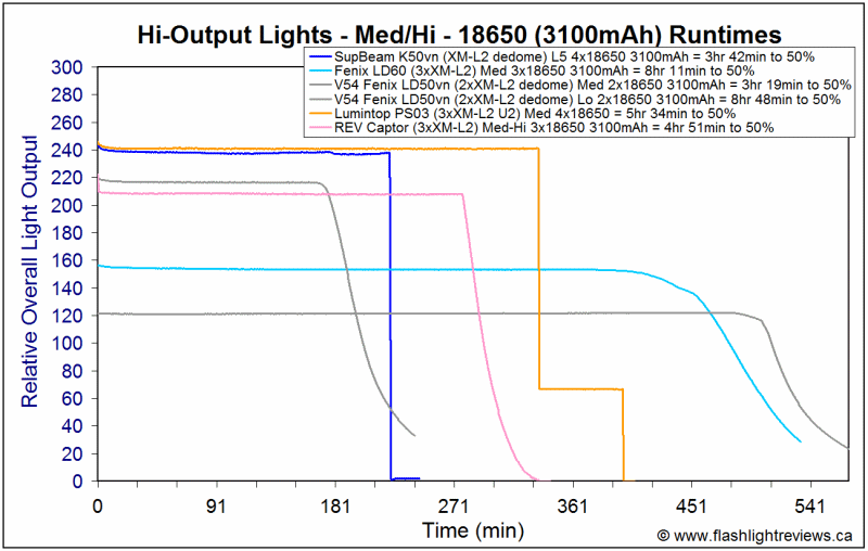

    Output/Runtime Graphs:
    As always, my standard runtimes are done under a cooling fan. Previously, I used to use AW 2200mAh protected cells in my 18650 testing (for their excellent consistency and ability to fit and work in any light). After considerable testing, I have switched to a number of brands of protected NCR18650A cells (3100mAh capacity). I have found a range of brands that show good correlations and internal consistency, and that collectively can fit and work in all of my lights. I have now moved to using 3100mAh cells in all my 18650-class reviews.
    Given the large number of comparisons possible, I've broken the Hi/Turbo runtimes over two graphs – first compared to 3x18650 lights, followed by other 4x18650 lights.
    As you can see, the PS03 has excellent regulation and overall efficiency for this class, similar to other good current-controlled lights. The PS03 steps-down from Turbo to Hi after 3 mins of continuous runtime, so the overall runtime pattern on Hi and Turbo is not that different above.
    Same holds for the Med level – the PS03 is a good performer.
    I like how the light steps down to a lower level before the batteries are drained, giving you advance warning that it is time to recharge the cells.
