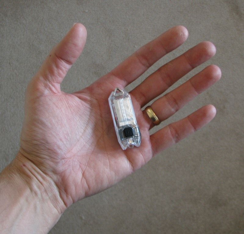

    Reviewer's Note: This is a review of both the stock Nitecore Tube, and the custom modified version from Vinh Nguyen (V54). For more information on Vinh's lights, please check out his subforum of the CPF Custom Flashlight Builders and Modders forum, including his TubeVN discussion thread.
    I've long thought that some sort of rechargeable keychain light would be a good idea, as most of the cheap ones with 2016/2032 lithium coin cells die a slow (or rapid) death from battery drain. As cheap keylights are commonly given out by many vendors when purchasing lights or batteries, I've literally collected buckets of these over the years.
    Since I am curious about the (somewhat oddly named) Tube, I have purchased the full series of colors from an authorized Nitecore distributor. Vinh has kindly sent me his personal sample of the TubeVN to compare. As such, this review can serve as double-duty – a review of the stock Tube, as well as the V54 TubeVN. And since I actually have multiple samples of the stock light, we can also draw some preliminary conclusions about typical variation.

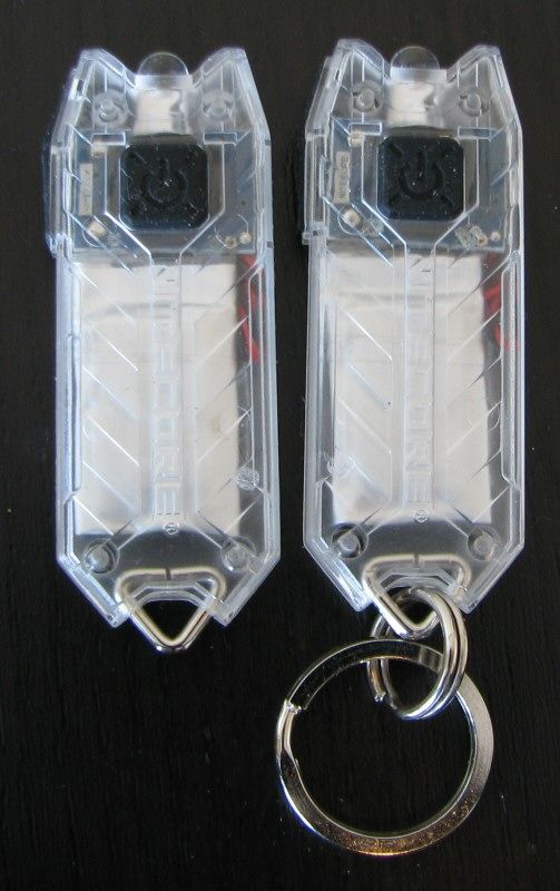

    One point about the Vinh mod – note below that the TubeVN is on the left, stock Tube is on the right below (both clear versions):
    There is no engraving on my sample of the TubeVN, so there are no obvious external signs to differentiate it to the stock Tube. I've attached the included keychain split rings on the stock sample, to help me tell them apart (although the difference becomes more obvious once your turn it on). But more on that in a moment …

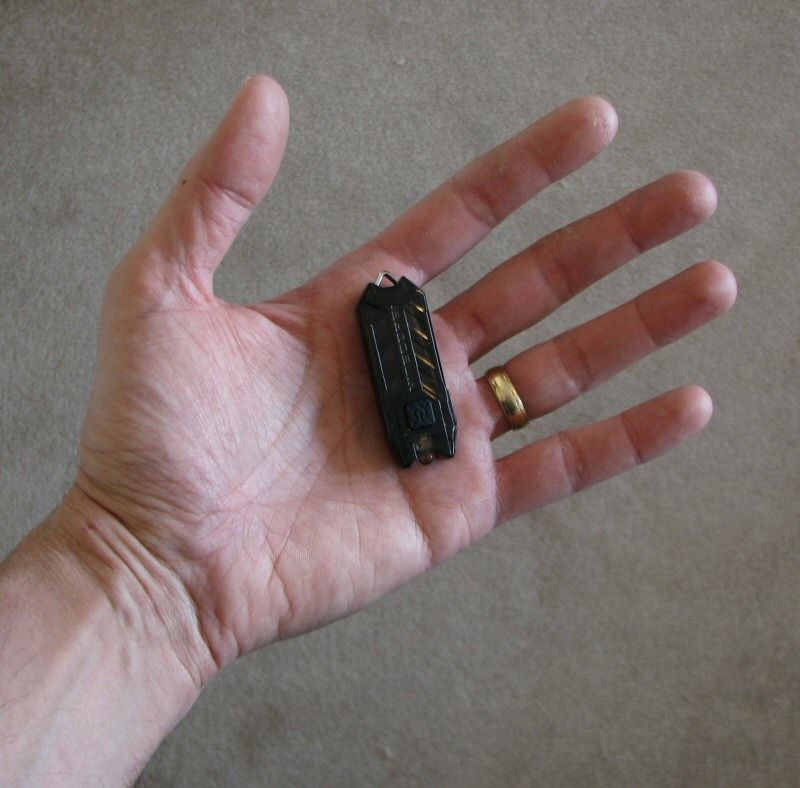

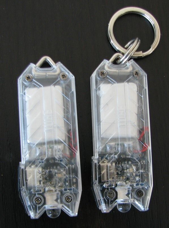

    There is no only obvious difference to the appearance of my TubeVN, so I've used a variety of the colors for the pics throughout this review.

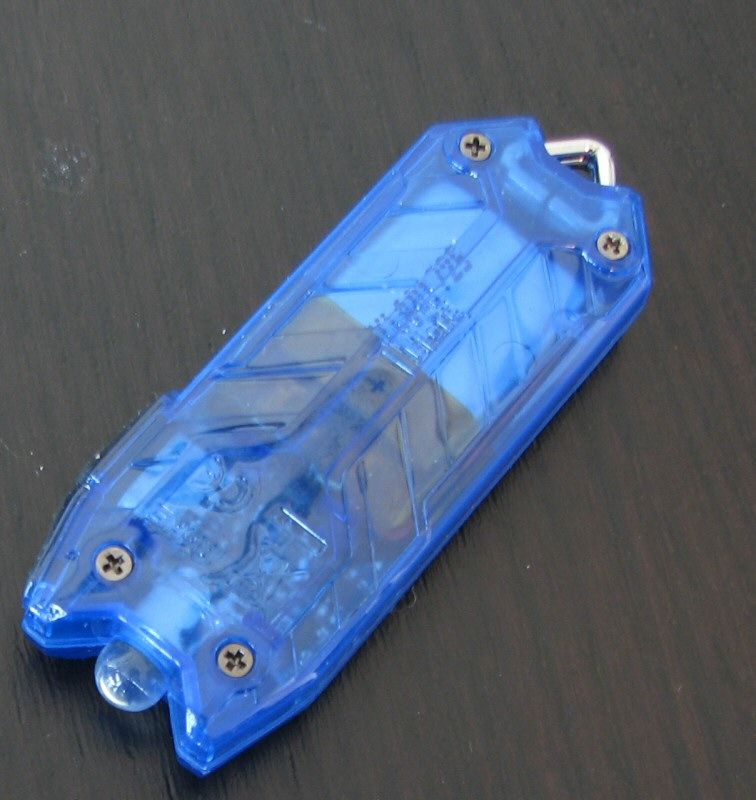

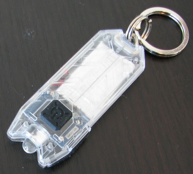

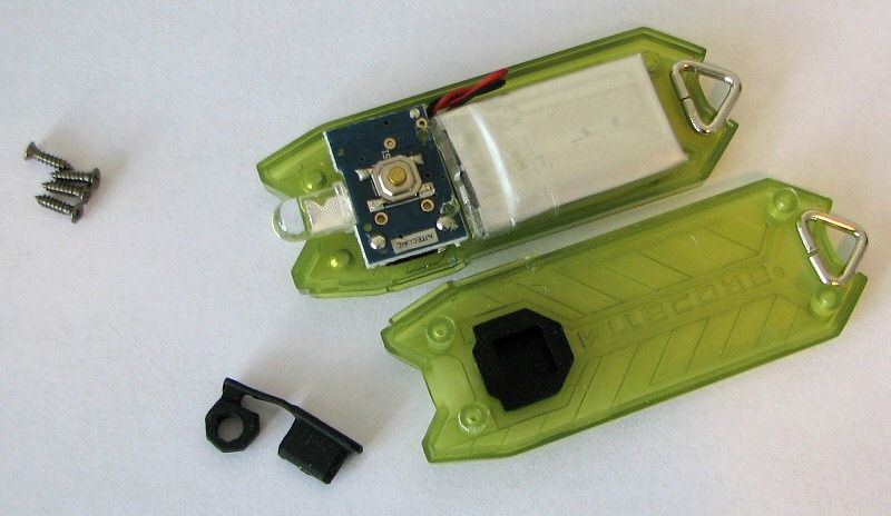

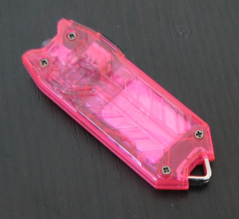

    The Tube lights have thin rectangular bodies, made of polycarbonate (held together by four small screws). There is some texturing/ridge detail on the body, which helps with grip. There are also the rubberized switch cover and micro-USB port cover (which thoughtfully stays attached to internal column at all times, so you won't lose it). There is a double metal keychain attachment point at the base of the light, and two sizes of stainless steel split rings are included.
    The Tube lights come in 5 body colors – clear, black, pink, green and blue. These have varying opacities, which affect how the lights look when on. To illustrate this, below are the clear, black, pink and blue Tubes, followed by the clear TubeVN – first on Min, then on Max.
    Note that the black one is very darkly colored, so relatively little light penetrates the body. Clear obviously lets the most light through, followed by pink and then blue above. The pink body tends to produce a fair amount of red/pink-tinged colored light in the vicinity of the body.
    I find the green to be something of a lime color (not particular attractive in my view, but your tastes may vary). My stock green sample was defective and wouldn't activate when clicked/pressed. Instead, the white LED would flicker on/off when held in certain positions or moved around – making think there was some sort of short on the circuit board. So, I took the green unit apart:

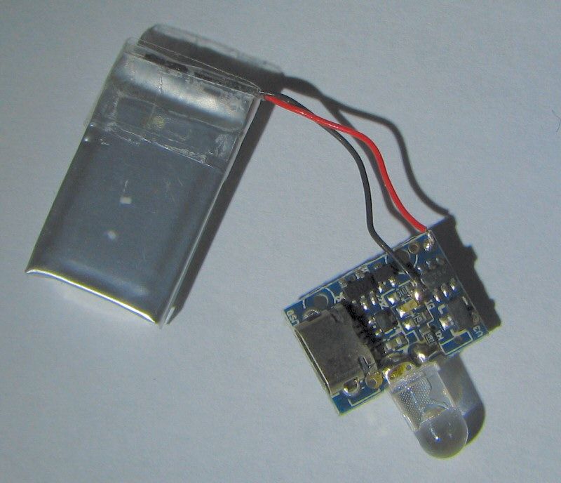

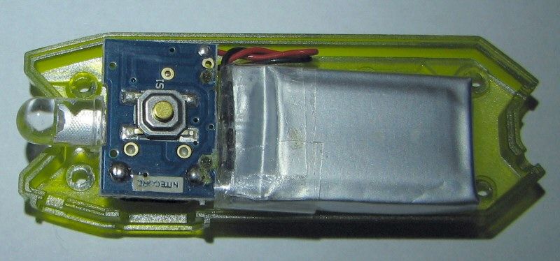

    I noticed one poor solder joint above (bottom right of the switch), but fixing it didn't help – this one sample (out of five purchased) remained DOA.
    As an aside, this may be an argument for getting the TubeVN – at least you know Vinh would catch and fix anything like that.

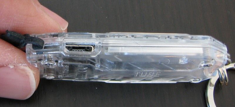

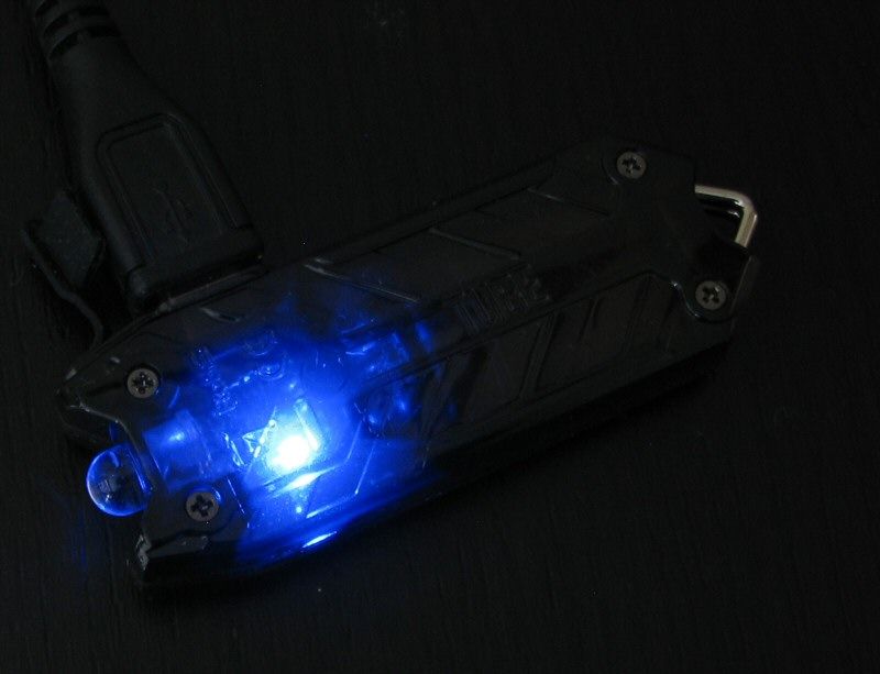

    One of the key features of the Tube is the built-in Li-ion battery, with standard micro-USB charging. Please note however, that you must supply your own cable. These are easily available online for a couple of bucks, but it means an extra purchase if you don't already have one from a cell phone, camera, etc.

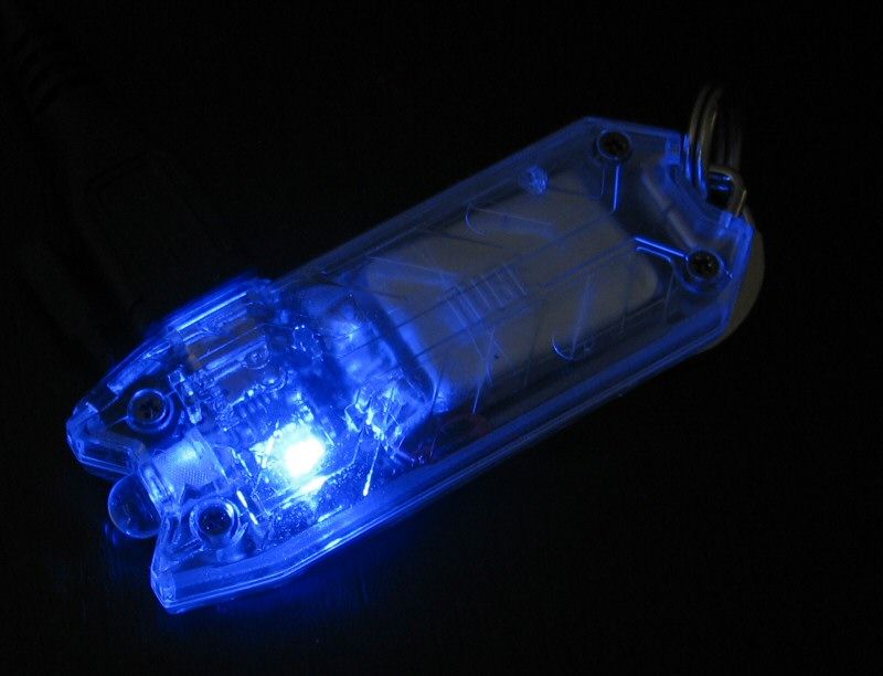

    There is a blue LED on the circuit board that illuminates when a USB cable is attached and charging is going on. Shown below for the clear and black versions.
    Simply peel back the rubber plug covering the micro-USB port to plug in the cable (the plug remains attached). Once the light is fully charged, the blue LED shuts off. Scroll down for more discussion of the charging process.

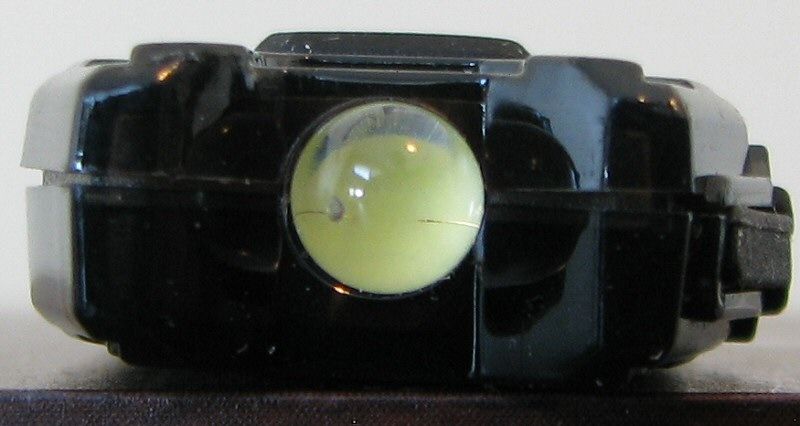

    The main white LED of is of unknown source, and is a (relatively) very high output 5mm type of cool white emitter. Truthfully, even in stock Tube form, I haven't seen one this bright before – it puts all other keychain squeeze lights I've handled to shame.

    To turn the light on in its lowest mode, simply click (press-release) the switch from off. To turn the light on in its highest mode, double-click the switch from off. Once on, a single click turns the light off.
    From on, you can ramp the output from min-to-max in a continuously-variable fashion by pressing and holding the switch. In my testing, it takes 3.2 secs to ramp from min to max brightness. Unfortunately, there is no pause once max is reach – the ramp immediately starts over at min, in a continuous fashion. This means it is hard to choose the absolute max (unless you use the shortcut above from off).
    There is a momentary max mode available from off – simply press-and-hold from off. The light turns off once you release the switch.

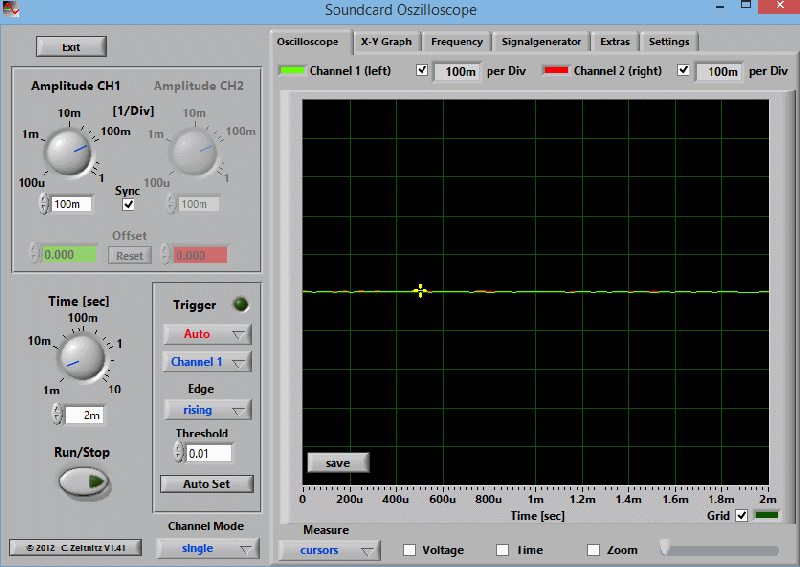

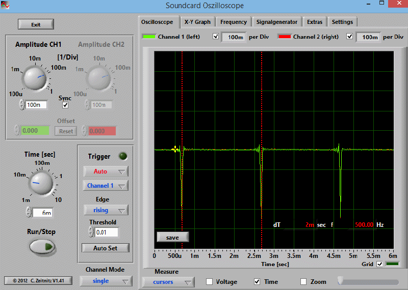

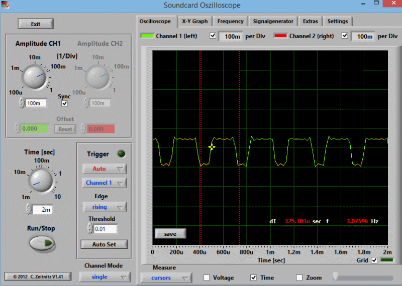

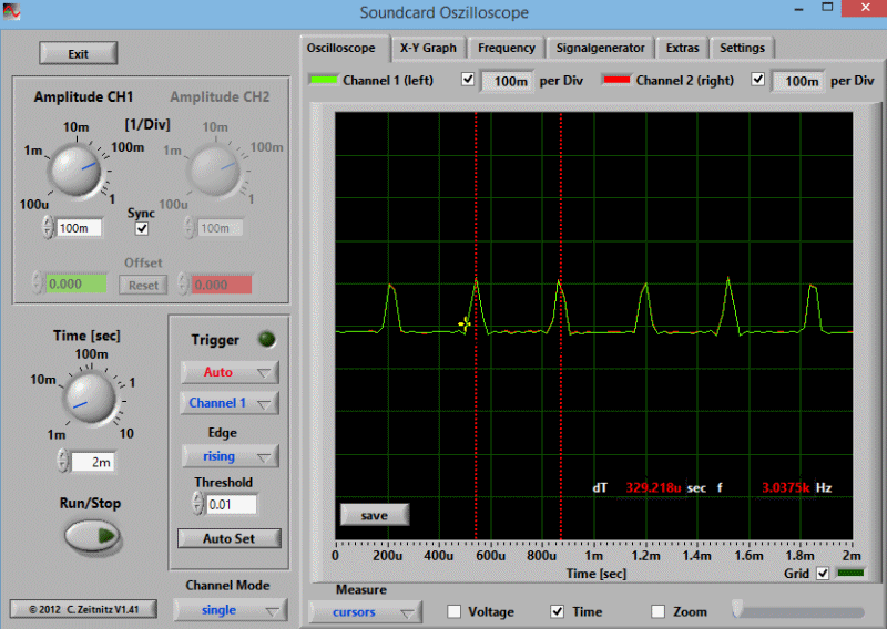

    PWM/Strobe
    The tube uses pulse width modulation (PWM) for its sub-max levels, but at two distinct frequencies
    Tube Min PWM:
    Tube Lowest ramp PWM:
    For some reason, the Tube uses 500Hz PWM at the min activation level, and 3kHz PWM for all levels of the ramp (except max, which is full power).
    What this means in practice is that those who are sensitive to PWM will be able to see if on the min level – but only the min level. The 3kHz PWM all other sub-max levels is undetectable in use.
    Let's take a closer look at the ramp levels, to confirm this is actually PWM here:
    Tube Lo PWM:
    Tube Med PWM:
    Tube Hi PWM:
    Tube Max:
    And indeed it is. Negative deflections above indicate when the light is on – as you can see, as you increase the output level of the ramp, the light spends more time "on" during each pulse. Once you reach the max level, the light is on all the time (as you would expect). PWM frequency remains constant at 3kHz at all ramp levels (below max)
    I consider this 3kHz PWM to be perfectly acceptable in use. You will not be able to detect it visually.
    In case you are wondering about the TubeVN, the mod has no effect on the PWM feature:

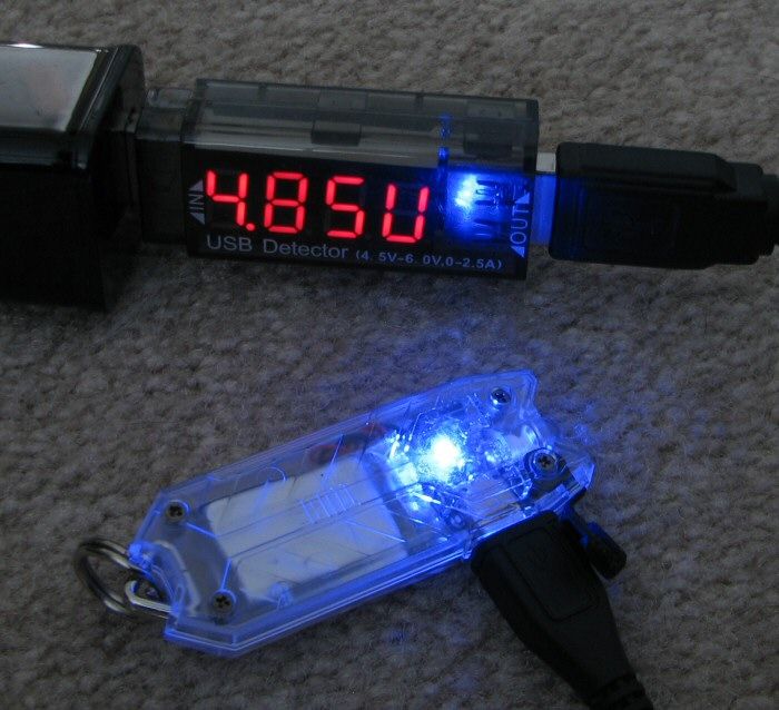

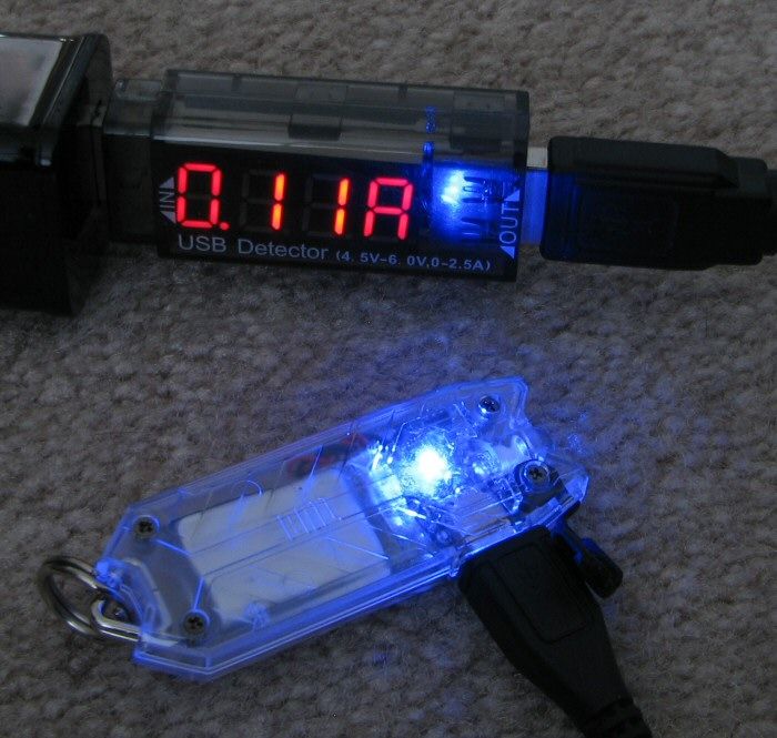

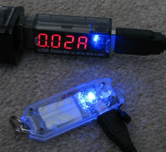

    Charging Current

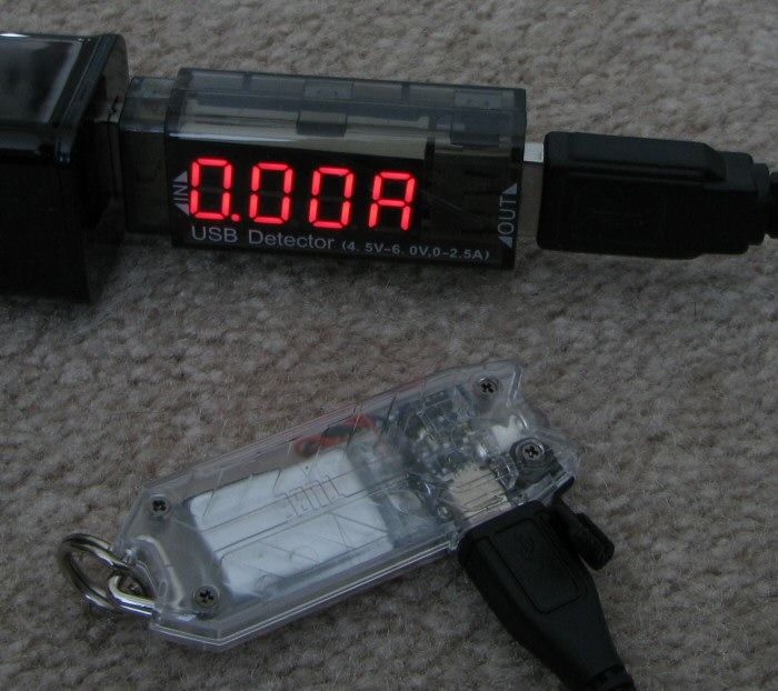

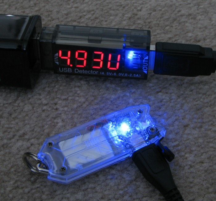

    For these measures, I am using the Xtar VI01 "USB Detector" - basically a specialized USB current/voltage meter. This model has recently been favorably reviewed by HKJ here. I left the USB detector in place for all readings. Note that the voltage reading on this device refers to the input voltage (i.e., from the charging brick).
    For the charging test, I started with Tube that been depleted down to a very low sub-lumen level, <0.1 lumens in my lightbox.
    Initial charging current and input voltage of the nearly-depleted Tube:
    As you can see, charging started at 0.11A and 4.85V input voltage. This is well below the maximum charge capacity of USB.
    Charging current dropped steadily during the charging cycle. Here is one hour into the charge:
    As you can see, charging is down to 0.02A at this point, and input voltage has risen slightly to 4.93V (which is pretty close to what I measure when no charging is taking place).
    Charging in fact terminated within ~5-10 mins after this point.
    As you can see, the blue charging LED has turned off, and the detector is reading 0A.
    This charging time is faster than the rated 2 hours stated by Nitecore, but I suppose it could take longer if you discharged the Tube even further (i.e., far below <0.1 lumens).

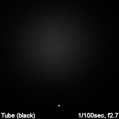

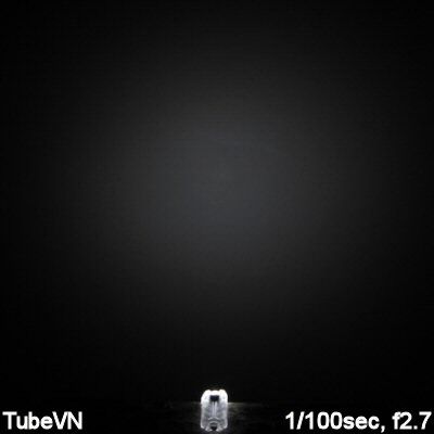

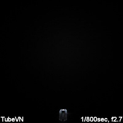

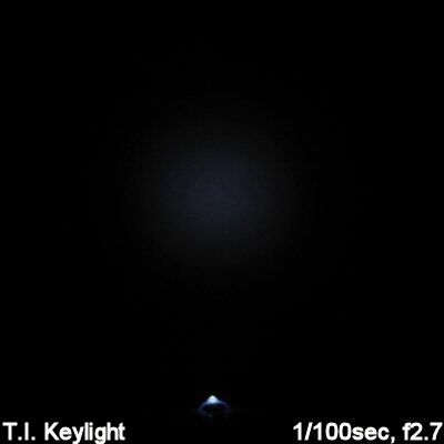

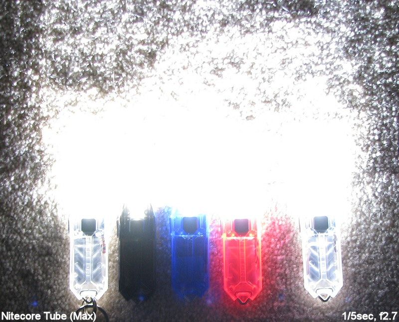

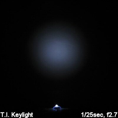

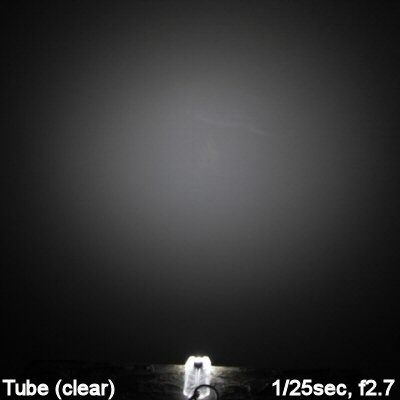

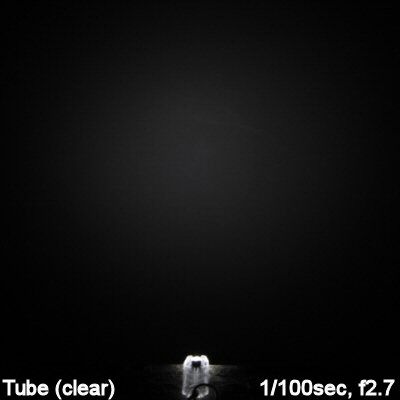

    Lights are about ~0.75 meter from a white wall (with the camera ~1.25 meters back from the wall). Automatic white balance used on the stock lights (to minimize tint differences.
    Let's start with the keychain lights, with all Tubes on max. Note that there are some scratches on my white wall below, just off-center to the right.
    Ok, the stock Tube is a lot brighter than your typical 5mm squeeze-type keychain light. For the comparison above, I am using a recent keylight supplied by Battery Junction (sold under the Titanium Innovations brand name). The Tubes have much better relative tint, with a lot less blue (although in absolute terms, I still find the Tube to be very cool white).
    The TubeVN has a much higher max output, with no appreciable shift in tint (i.e., no dedoming here folks).

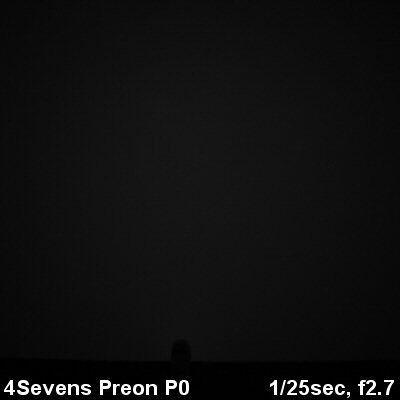

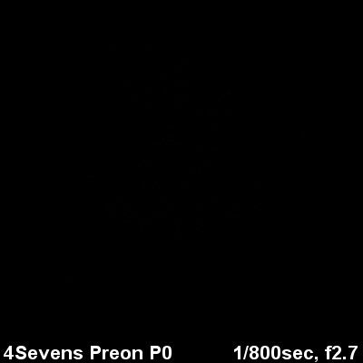

    Let's see how it does against a couple of 1xAAA lights.
    This isn't really a fair comparison, since the Preon P0 is a lower lumen light with a wider spotbeam-type beam pattern. But I think you'll find the Tube's max output is quite reasonable – similar to Hi on some of the older 1xAAA lights, or Med-Hi on some of the latest higher-output ones.
    As you can imagine, no outdoor beamshots here …
    Scroll down for direct measures.

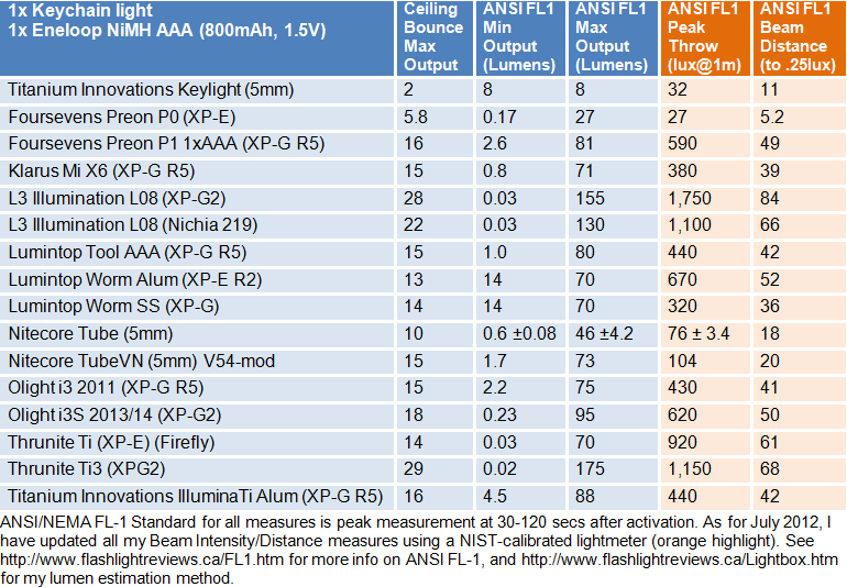

    Let's mix things up a little, and start with a comparison of max and min lumen output for the Tube/TubeVN.
    Since I had 4 functioning Tube samples, I thought I would present these with some basic descriptive statistics: mean (average) and standard deviation (SD). These are reported below as the mean +/- the SD.
    In statistics, the standard deviation is a convenient way to directly compare the variation between groups in a consistent manner. For a normally-distributed population (i.e., the class bell-shaped curve for IQ tests, and many naturally occurring phenomenon), you can think of the mean as the center of the curve, and a single standard deviation unit as being the point on either side of the mean where 68% of the samples would fall within.
    I'm throwing runtime into the table below as well, to the ANSI FL-1 standard of time to 10% ANSI max output.
    First thing to note above is that my output measures suggest the Nitecore specs are fairly accurate – I get 0.6 lumens on average for min output (1 lumen spec) and 46 lumens on average for max output (45 lumen spec). The same goes for runtime – I get 62 mins on average for time to 10% (60 min spec). For all three measures, the SD is a fairly consistent ~10% (i.e., two thirds of the samples fall within ~20% of the mean).
    I only had one sample of the TubeVN, but you can see it is significantly brighter at both its min and max levels, by ~180% and ~60% respectively. Of course, that is just a comparison to the average output – individual pairings could vary (i.e., the TubeVN on max was ~70% brighter than the Pink Tube, but only ~40% brighter than the Clear Tube).
    Runtime on max on the TubeVN is of course reduced compared to the stock Tube. To see how efficiency compares overall, please see my runtime section below.
    To put these results into context, here is a summary chart comparing to the classic 1xAAA lights, and the Titanium Innovations keylight:
    The TubeVN certainly reached the level of max output commonly seen on 1xAA keychain lights (although is a lot less focused for throw, of course). Note that the min level is also increased on the TubeVN - it seems the current mod affects all levels on this light.
    This is one area where I find the Nitecore specs to be a bit inflated – only one of my stock tube samples topped 80cd for beam intensity (spec is 150cd).

    How does this compare to the Titanium Innovations keylight, or standard 1xAAA?
    Ok, the standard 5mm keylight is definitely not in the same class as these Tubes. But as pointed out earlier, the TubeVN definitely reaches a max output level that is consistent with a number of 1xAAA keychain lights.

    I noticed you did beam shots for the black and clear tube. I could not really see any difference. Does the colour of the tube make much difference in real life to the beam. Do you have a preference of colour. I.e is the clear emitting light through the body a bit annoying after a while?
    I did the beamshots to mainly to show the difference in how much light is transmitted through bodies (black vs clear) - and also to show that this doesn't appreciably affect the actual beam itself (as you noticed).
    I did find the pink one to be a bit annoying, as it turns everything immediately around my hand holding the light a candy-pink color. The blue and black are the least distracting. But I don't mind the clear one - it's a just a different experience than the black one, not really better or worse.

    Default Re: Nitecore Tube and V54 TubeVN (5mm, rechargeable) review: RUNTIMES, BEAMSHOTS, VID
    whoa, no PWM on max?
    Looking at the die of the emitter, well the the size of it from side on, I no longer think it is Nichia 570GS-K1. That one could take 200mA but above 80mA it should be pulsed. I have a feeling the design is not for LED longevity but have no idea what the LED is.
    6,936
    Quote Originally Posted by jonwkng View Post
    Always great to see how much Vinh's modding work translates objectively to selfbuilt lumens.
    That was actually harder than usual in this case, given the very floody beam pattern. But both my lightbox and ceiling bounce were pretty close, so I think the ~60% brighter (on average) makes sense for the mod.
    Quote Originally Posted by Mr Floppy View Post
    That's right, it disappears when you jump to max. PWM is being used here in the same way it is on most lights (i.e., to simply reduce overall output from max). I'm actually more puzzled by why they use a lower frequency on the min level than the rest of the ramp.
    Don't know how they found an emitter that can handle this drive level, but it is a good performer.

    This image here, I know I have seen that LED before. See the extra large bit of the leg on the cathode? I've seen those on JELED 0.5W 5mm led's, for heat sinking I assume. The seller of these are on eBay and I've looked at them before but testing by a forum member here wasn't so good as the LED would fade at high current levels. That was years ago though and I've kept an eye out as JELED keeps coming out with brighter and brighter LED's culminating in 0.5W 5mm leds.
    So I'm wondering if these are the ones that Nitecore chose? I've posted a link to the store in Vinh's thread rather than here.
    Good catch, they do indeed look just like those JELED LEDs. Of course, they could still be a custom production run for Nitecore. Either way, they have certainly come a long way!

    I did a little video showing the difference of the Tube and TubeVN.
    Also I have a inline USB Amp/Volt reader and got the same charge rate of 0.10A. But mine also show total power charging in mah and it came to 102mah after the charge. That is most likely the reason it only charges at 0.1A, thought I would share that.
    Direct URL: http://youtu.be/pxszhy7ivVM
    6,936
    Quote Originally Posted by ScottJD View Post
    Thanks for sharing. That sort of amp capacity makes sense, especially if it uses something like a nominal 3.7V Li-ion cell. That would give you the effective work capacity of a little over a third of a 850mAh/1.2V NiMH AAA cell. Assuming the overall efficiency of the emitter here is not far off from the typical XP-E/XP-G found on most AAA lights, you would expect roughly one third the runtime for equivalent output - which is about what I find in my testing.

    I know the battery is not marked but I was also thinking it may even be a Li-Po cell. It reminds me of the single Li-Po cells I have for a mini quad copter. But these in the picture are 300mAh capacity.
    if they had made it just a little bigger with a 200mAh or 300MmAh like the ones in the pictures they could have tripled the run time, kept it still a little smaller than the cheap free ones, and could have raised the C rating on the charging for faster charge times. The one I have is a 15C (4.5A discharge) and 1A charge rate. I've seen other newer replacement cells that claim 45C discharge and 15C charging rate. Of course the battery may swell a little durring use so a little spare room in the case would be needed.
    As I look at these pictures I sit and wonder if I can swap the tube electronics into the cheap case one with the 300mAh battery? The gold strip on the clear tape battery is just the contacts and a safety cuircut for not over charging or over discharging. That could be removed since I suspect the light is already regulating that part in the tube circuit it board.
    It is a LiPo and I think you meant to say 100mAh, and someone confirmed it was 100mAh marked somewhere,
    edit: not sure which forum

    While trying to understand the PWM issues via your oscilloscope screen shots it dawned on me one of the things I appreciate about your reviews. You obviously are smart and know your stuff like many folks around here but a rarer trait is your ability to communicate that info in layman's terms guys like me can understand.
    Reminds me of scene from the Armageden movie where Nasa is briefing the President about the asteroid on a collision course with earth. The president asked how big this asteroid was and one of the NASA engineers replied, "271, 413.41 square miles."
    Seeing the confused, gloss overed look on the President's face Billy Bob immediately follows up with, "It's about the size of the state of Texas sir." You Selfbuilt naturally give both answers!

    Hi Mr Floppy. Yes, the Nitecore I suspect is a 100mAh. I was referring to the other 2 batteries I layed in the picture are 300mAa from a min quad copter that are only slightly bigger.
    I didn't see any writing on the battery when I took mine apart, but my USB amp/volt meter calculated 102mAh durring the charge after I drained it, and the size of the cell and the CC/CV (contant current/ contant voltage) charging that nitecore used would also apply to a LiPo cell. But the same kind of charging is also used for Li-ion with the same 4.2 max charge on most Li-Ion cells. Only difference being the chemistry and the Amperage produced from LiPo can be much more. It's arguable that Lipo is more volatile as most Lipo packs are not enclosed in a sealed metal case and is why Li-Ion cells apear to explode than just burn up and catch into flames like some LiPo packs have.
