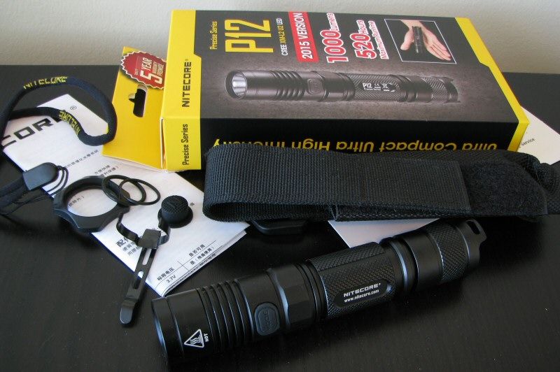

    • Accessories: Quality holster, clip, tactical ring, lanyard, spare tail cap, spare O-ring

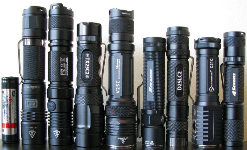

    From left to right: AW Protected 18650 2200mAh; Fenix PD35; Nitecore P12; Eagletac TX25C2; Sunwayman V25C; Olight S20 2014; Eagletac D25LC2; Sunwayman C21C; Foursevens Quark Q123-2.
    Nitecore P12 2015: Weight: 88.7g, Length: 139.5mm, Width (bezel): 25.5mm
    Nitecore P12 2014: Weight: 89.7g, Length: 139.4mm, Width (bezel): 25.4mm
    Nitecore P10: Weight 82.0g, Length: 135.1mm, Width (bezel): 25.5mm
    Nitecore EC20: Weight: 77.1g, Length: 129.2mm, Width (bezel): 25.4mm
    Eagletac D25LC2: Weight: 50.0g, Length: 116.3mm, Width (bezel): 22.5mm
    Fenix PD35: Weight: 82.7g, Length: 138.1mm, Width (bezel): 25.4mm
    Thrunite TN12-2014: Weight: 80.0g, Length: 140.5mm, Width (bezel): 25.4mm
    Skilhunt DS20: Weight: 53.8g, Length: 110.0mm, Width (bezel): 24.0mm
    Zebralight SC600 II: Weight 79.3g, Length: 101.8mm, Width (bezel) 29.7mm
    There is some very minor fluctuation is dimensions between my samples, but I expect that is just normal natural variation.
    Again, the 2015 edition is physically indistinguishable from the 2014 version. As such, my comments below apply to both versions.

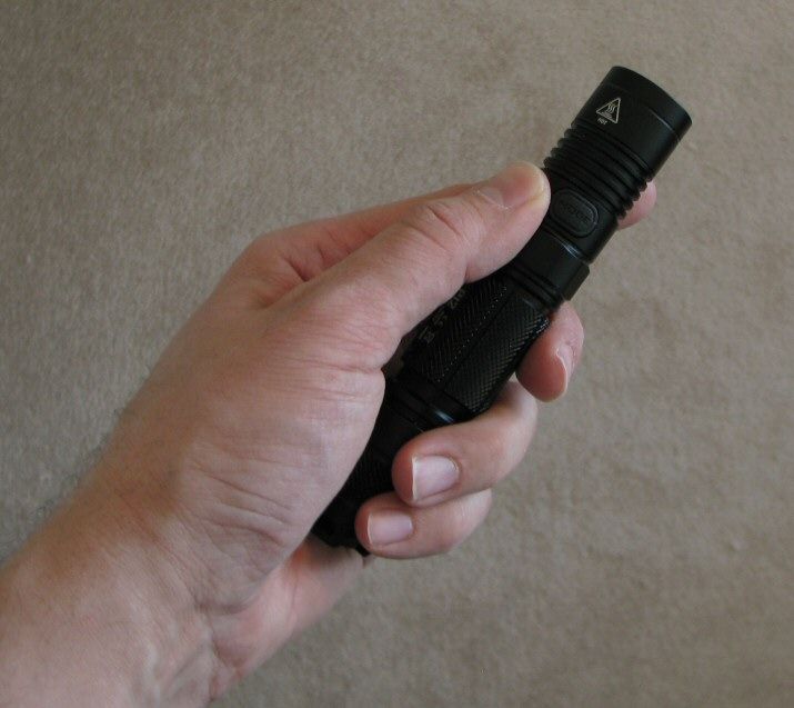

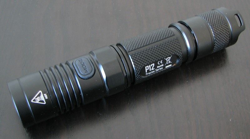

    The P12 is a compact, yet solid little light. Anodizing is a shiny black finish, hard anodized, with no chips or damage on my sample. Body labels are bright white and clear against the black background. Knurling is of moderate aggressiveness on the body tube and tailcap. But when combined all the other grip elements (e.g., side switch cover, fins in the head, pocket clip, etc.), I would describe overall grip as very good.
    The light has decent anti-roll indentations on the body, but the clip is even more helpful in that regard. Clip is supposedly titanium-plated stainless steel, and feels reasonably sturdy. There is also a bundled grip ring in the package, for cigar-grip style carry (also very effective for anti-roll).

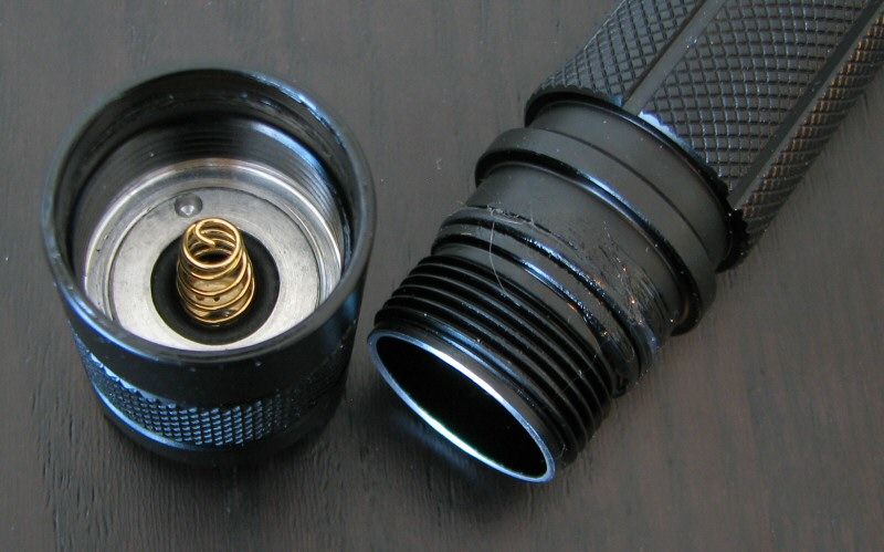

    Tailcap screw threads are standard triangular cut and anodized for lock-out at either end of the body tube.

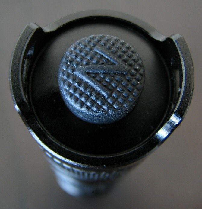

    The P12 uses a forward clicky switch, but with very good tailstanding ability due to the raised side edges (suitable for lanyard attachement). Switch access by finger or thumb is good.

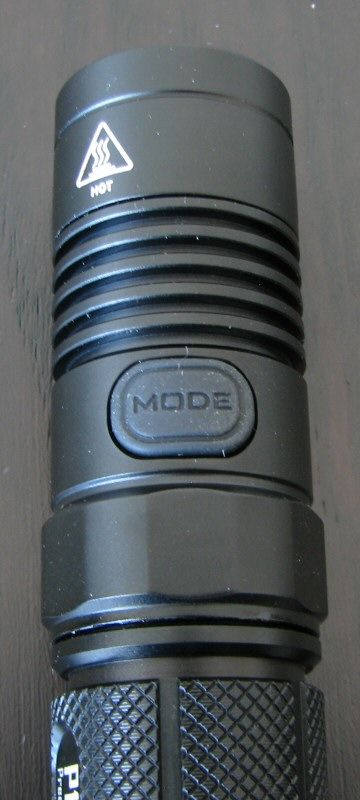

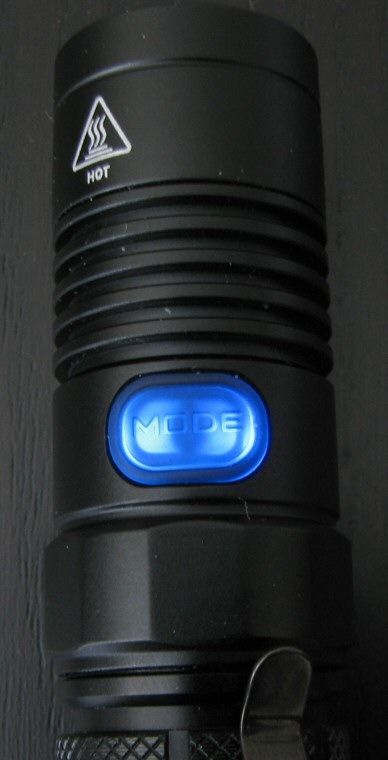

    On/off is controlled by the physical tailcap clicky switch, but all mode switching is done by the electronic side switch in the head. The mode-changing switch in the head has pretty good feel for an electronic switch, with typical traverse. It is relatively easy to locate by feel (although could be grippier, with more visual distinctiveness).
    Note that like many other Nitecore models, there is a blue LED under the mode-changing side-switch that will glow blue when the batteries are running low. It also serves as a voltage read-out function. Please see my User Interface section for a discussion.
    There is a physical reverse polarity feature in the head. However, this has been updated from earlier Nitecore models and now allows "wide button top" cells to work in the light. True flat-tops (where the positive contact is below the wrapper) won't work, but all my cells with a slightly raised contact worked fine.
    The body tube is wide enough to accommodate all size 18650 cells, and there seems to be plenty of room of longer cells as well.
    The P12 comes with a flat black aluminum bezel. The overall head is typical for this class - not very large. Reflector is smooth, and fairly deep given this size head. Coupled with the XM-L2 cool white emitter (which were well centered on my samples), I would expect a fairly typical beam pattern, but with slightly greater throw than many in this class. Scroll down for beamshots.
    There is no change to interface on the 2015 edition. As before, the P12 uses a dual-switch interface, similar to the Fenix PD35 or Thrunite TN12-2014.
    Turn the light on/off by the forward tailcap switch. Lightly press and hold for momentary, click (press and release) for constant on. Click again to turn off.
    To change modes, click the electronic switch in the head, while the light on. Mode sequence is Lower > Lo > Med > Hi, in repeating sequence. The light has mode memory, and returns the last level set after turning the tail switch off/on.
    Press and hold the electronic switch to access a tactical Strobe mode. Press and hold again to select the next blinking mode. Mode sequence is: Strobe > Locator Beacon > SOS, in a repeating loop. A single click exits you from the blinking modes and puts you back into constant output.
    Note that there is mode memory for the Strobe mode (but not the other two blinking modes). This is convenient if you are someone who likes immediate access to Strobe from Off.
    The P12 also has a blue LED under the side mode-changing switch to serve as a low voltage indicator when the flashlight is On. Once the cells are below 50% power (according to Nitecore), this indicator will flash blue every 2 seconds. It will flash faster as the power capacity drops down further.
    With the light turned Off, you can get a battery voltage readout by pressing and holding the side switch while simultaneously activating the tailcap switch. The blue LED will then read out the voltage in a series of flashes (e.g., Four flashes, followed by a short pause, with two more flashes would indicate a full charge of 4.2V). Note that if you click the tailswitch on (as opposed to press-hold), the light will actually turn itself on after the voltage read-out finishes.

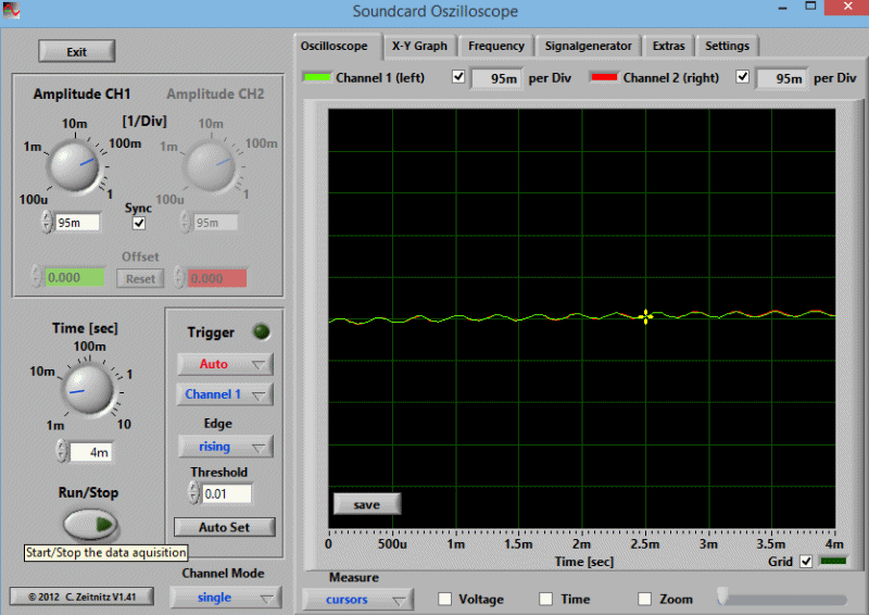

    The P12 is fully current-controlled, as before. There is no PWM, on any level.
    Please note that I have updated my oscilloscope software since the earlier 2014 edition review. As such, some of the patterns may look a little different below.
    As with 2014 edition, I did detect some circuit noise on my oscilloscope at the Lo and Med levels specifically, but this was completely invisible in actual use.
    Lo Noise
    Med Noise:
    Hi:
    Again, consistent with my standard review policy, I report on any oscilloscope signals that I can detect in the output of a light. But I can assure you that the above patterns produce no visible effect – even when shining on a fan. The P12 remains fully "flicker-free" at all levels.

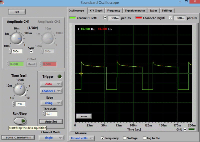

    Strobe
    The strobe remains a very fast "tactical" strobe, at the same 16.3Hz frequency as before. Also as before, the strobe duty cycle is a little unusual, as it is only "on" a portion of the total time of each strobe cycle (i.e., most strobes are an even 50:50 on/off). But it doesn't change how disorienting it is in general terms.

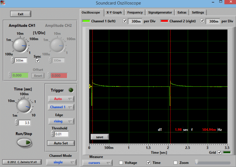

    Beacon
    Beacon was a quick high-output flash, once every 2 secs or so.

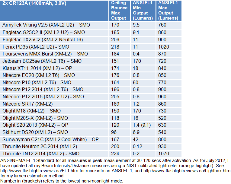

    Consistent with a single output bin step, my P12 2015 sample is ~6% brighter on max than my P12 2014 sample.

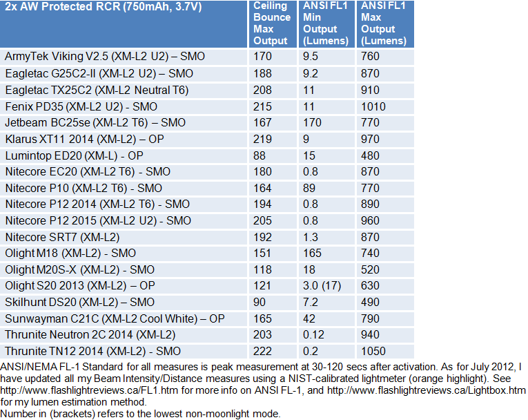

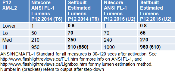

    Let's see how all the levels compare to the official specs, on 1x18650 in my lightbox:
    As before, I get very good concordance between my estimated lumens and Nitecore's published specs. There is not a major difference between any of the output modes of these two models, frankly. As before, I appreciate the <1 lumen "Lower" mode on the P12, as I personally like having low-level options in a general purpose light.
    The mode spacing remains pretty good, although most lights of this this class would typically have an additional Hi level between the current Med and Hi outputs. On that front, note that (as before), the Hi mode of the P12 steps eventually down to an intermediate Hi level (i.e., something between the defined Med and Hi modes). See my Runtimes below for more info.

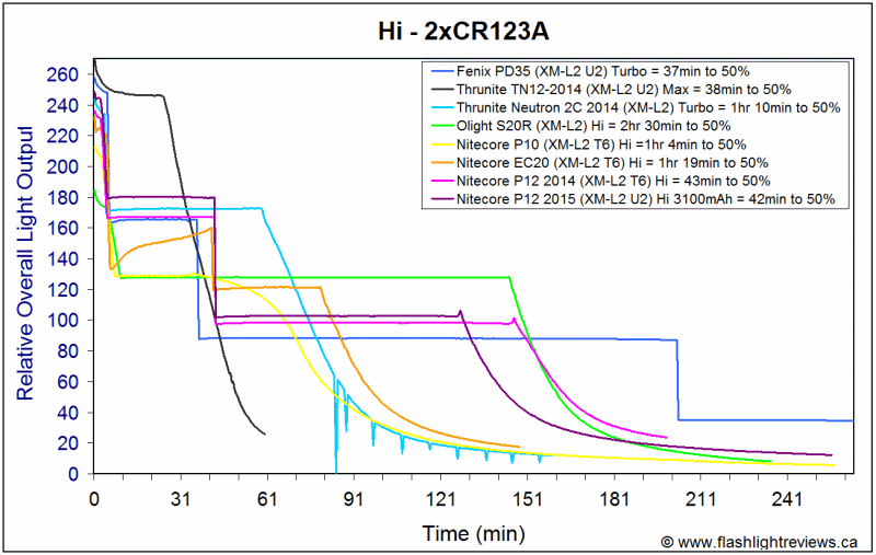

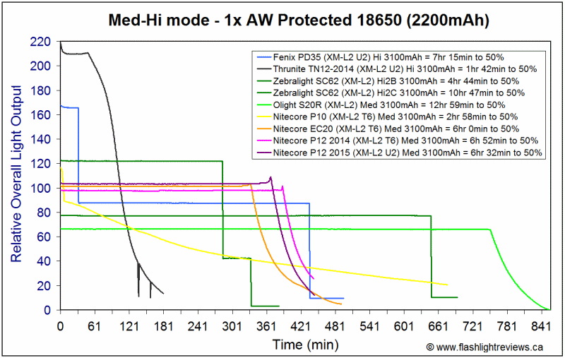

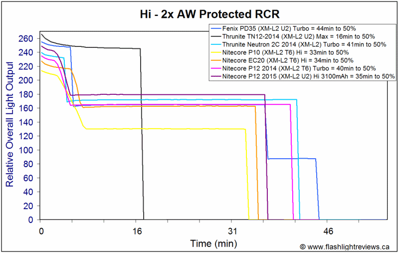

    Output/Runtime Graphs:
    All runtimes are done under a cooling fan. 18650 runtimes done using protected batteries based on the Panasonic NCR18650A core.
    There is no real difference in runtimes above – basically, performance of the two versions is the same (except for the marginally higher output on the 2015 edition).
    As before, the P12 shows very good efficiency and regulation at all levels, although there are some competing products that are even more efficient.
    As before, there are a series of step-downs from "Hi" on the P12, on all batteries (i.e., rapid step-down initially to an intermediate Med-Hi level, and then a subsequent step down to Med).
    Mode spacing is good, although I would think adding the intermediate Med-Hi level into the regular sequence would be good idea (i.e. as a fifth selectable mode).
