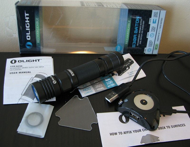

    Main obvious differences to the S20R are the addition of a new Turbo mode now, and a higher capacity 3400mAh 18650 cell.
    The packaging is similar to the S20R. Inside the clear plastic container is the S30R (with Olight 18650 3400mAh battery installed in this case), extra o-rings, split ring, product insert, manual, charging dock base, micro-USB cable for dock, adhesive gel-pad for dock, gel-pad installation manual. As before, there is also an overview of specs on the bottom and back of the packaging.

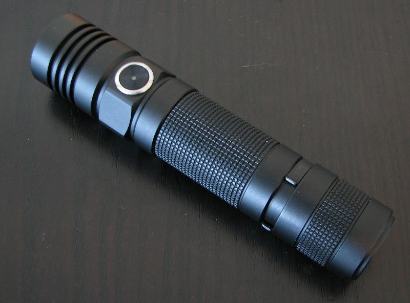

    While still quite compact for the class, the S30R is definitely more substantial than the S20R. The tailcap and head regions seem particularly reinforced.

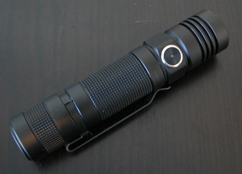

    As with the other members of the "R" series lights, the S30R comes with black anodizing (matte finish) and bright white labels. Although still without typical knurling, the raised checkered patterns on the body helps with grip. With the pocket clip attached, I'd say grip is good.
    The pocket clip has changed from the S20R, and is no longer reversible. It seems to hold onto the light fairly securely, as do the clips on the other lights.
    In the head, the S30R has a spring on the positive contact, just like the S20R (so flat-top 18650 should also work just fine).
    The R-series tailcaps have been designed to support a charging dock – and the S30R tailcap seems a bit more substantial (likely to support the higher current, see below). The S30R uses square-cut screw threads – but there are more of them (and they are deeper) than the S20R. Threads are still anodized for tail lock-out. Light can tailstand as before – but there is no longer a split-ring/lanyard attachment hole on the side of the tail cap.
    As always, the tailcap still has a strong magnet, to allow the light to stand horizontally off any vertical metal surface. That said, I don't find the magnet on these R-series lights as powerful as the regular Baton light. This means you may not be able to get the S30R to hold as stably off a vertical piece of metal (i.e., you will need a pretty flat and solid metal surface).

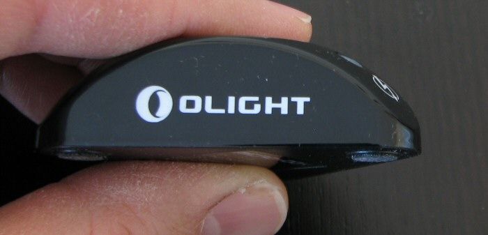

    As before on the earlier models, there two exposed metal areas – an outside ring, and a recessed inner circular contact. These connect magnetically to the charging dock. I am happy to report that there is no open voltage at the tailcap, so there is no risk of accidentally shorting the 18650 battery inside the light. Scroll down for discussions of the dock and charging process.
    As with the other models, the S30R uses an electronic switch in the head for on/off and mode changing. The button design is the same as the S20R – but it is larger on the S30R. As with other R-series lights, the hard plastic switch is slightly recessed behind a raised metal surround. This means that the risk of accidental activation is reduced.
    As with the S20R, there is still a low voltage warning sensor under the switch (visible through the clear pinhole opening in the middle). The red LED below the switch will light up and flash as the battery nears exhaustion.

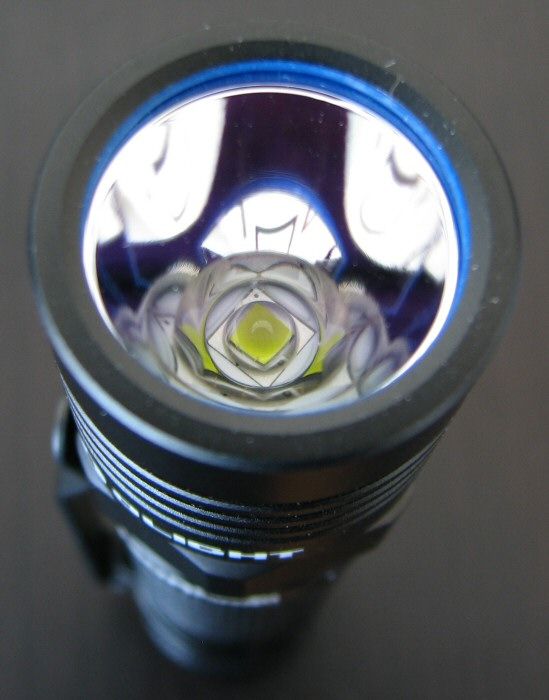

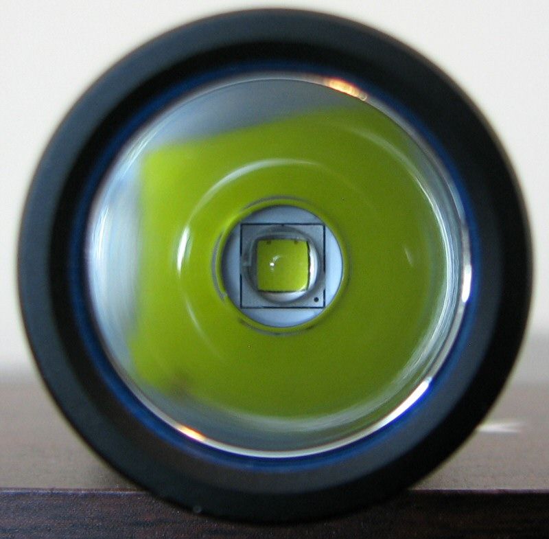

    The head of the S30R shows some heatsinking fins, with an integrated flat bezel (i.e., the screw-in stainless bezel is gone). The now standard GITD blue o-ring is present, along with a smooth reflector.
    The S30R uses the same XM-L2 Cool White emitter as the previous S20R. The emitter was well centered on my sample. Please scroll down for beamshots.

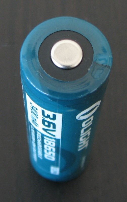

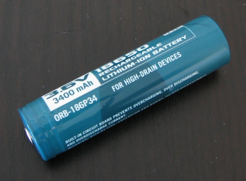

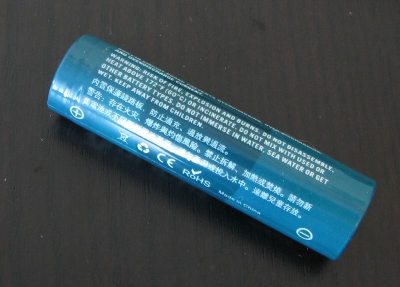

    Olight Battery
    All the new R-version models come with an appropriately-sized Olight-branded battery (3.7V Li-ion). Rated capacity of the 18650 included with the S30R is 3400mAh (up from the 2600mAh one on the S20R) . Scroll down for actual testing results.

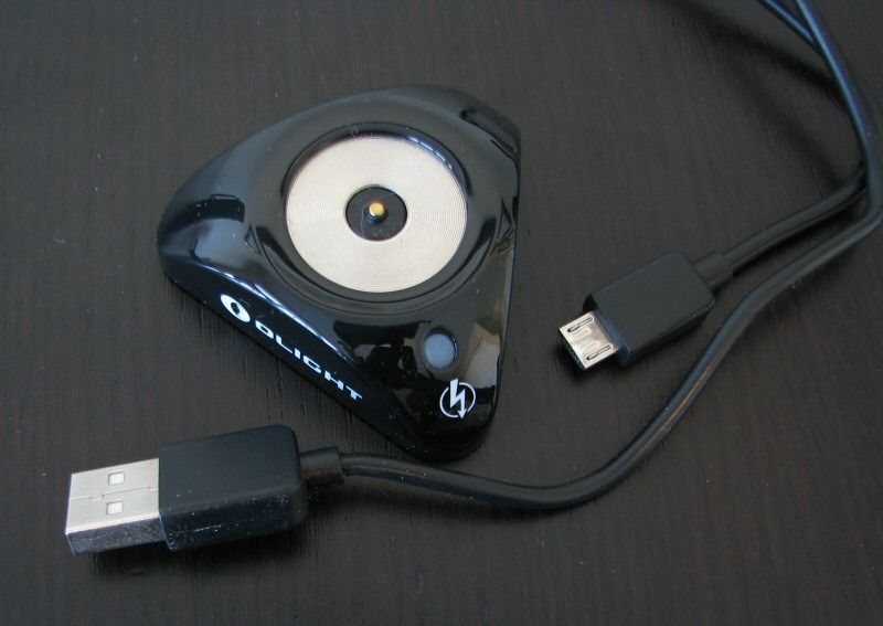

    Charging Dock

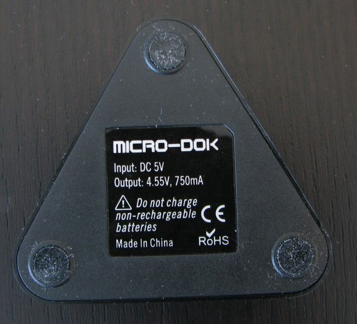

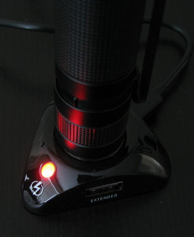

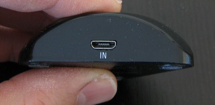

    The charging dock for the S30R is similar to the other R-series – except it uses a higher charging current of 750mA (according to the printed specs). This should be useful for the higher capacity cell provided by Olight on the S30R. See a charging analysis later in this review.
    As before, the desktop dock connects by a supplied micro-USB 2.0 cable for a standard USB port (no AC adapter supplied, but you can easily find an after-market one). The is an adhesive gel pad supplied with the dock, in case you want to semi-permanently mount the dock on your desk.
    Charging contact is made through those two metal areas on the base of the light's tailcap. Thanks to the magnetic attraction, this firmly holds the light in place, and allows charging to commence.
    A LED on the dock illuminates constant red during charging (slowly flashing red when no light is present, or if an error is detected). The dock terminates the charge and goes green once the battery is fully charged (~4.2V). Note that I had previously observed that the initial batch of R-series lights wouldn't fully charge (i.e., a resting voltage of ~4.14V on my S20R when it went green). I understood that Olight was planning to fix this on subsequent batches – and they appear to have, judging from my S30R. My S30R charges to a resting voltage of ~4.23V (which is definitely as high as you would want a standard charger to go).
    The "Extended" USB port on the dock is a secondary output port. Basically, with the dock plugged into a power source, this provides a pass-through to charge other USB-based devices (e.g., cell phone, tablet, etc.), up to a reported 2A charging current. Of course, for that kind of charging, you are better off using an AC adapter for the input source, with good quality cables (i.e., I wouldn't want to to push a standard USB port too hard).

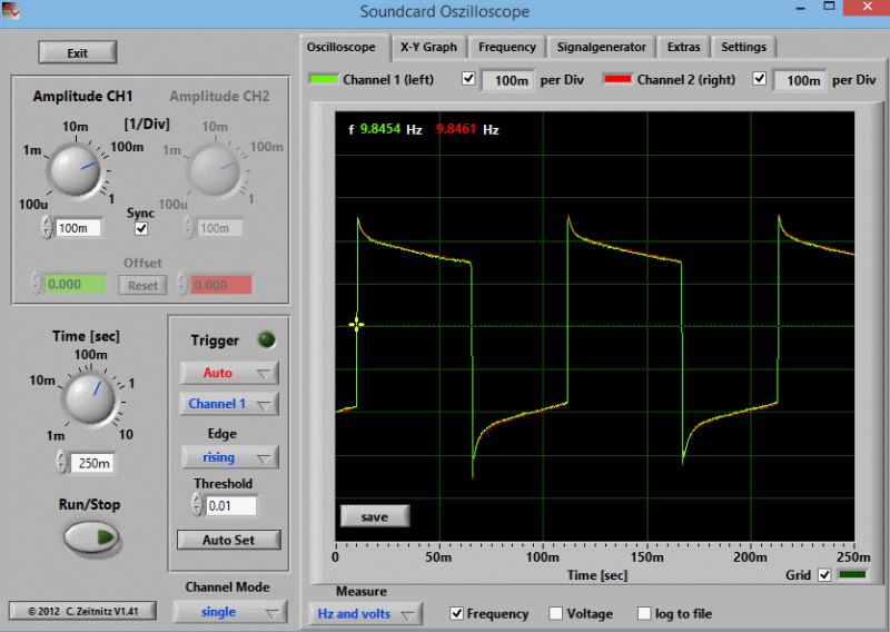

    PWM/Strobe
    As always, there is no sign of PWM at any output level – the S30R appears to be current-controlled, just like its predecessors.
    Strobe
    The S30R strobe is a fairly typical fast "tactical" strobe, of 9.8Hz frequency (same as the S20R).

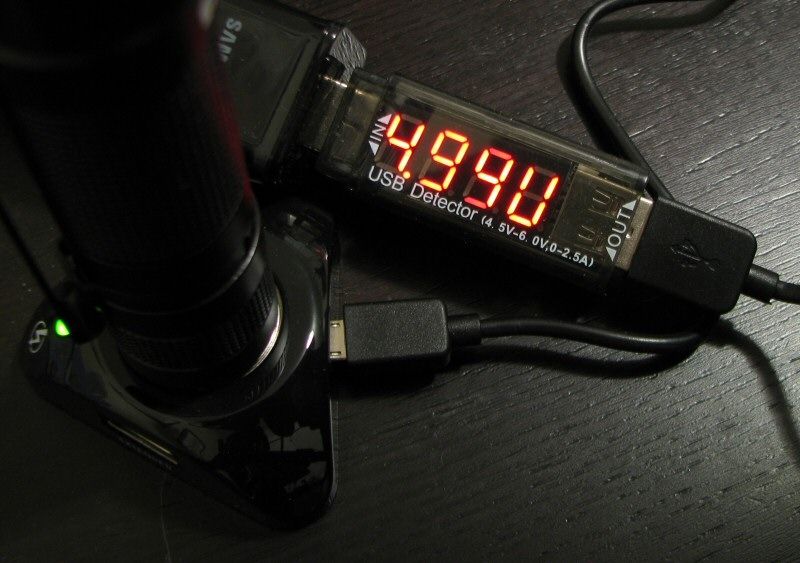

    In-Light Charging

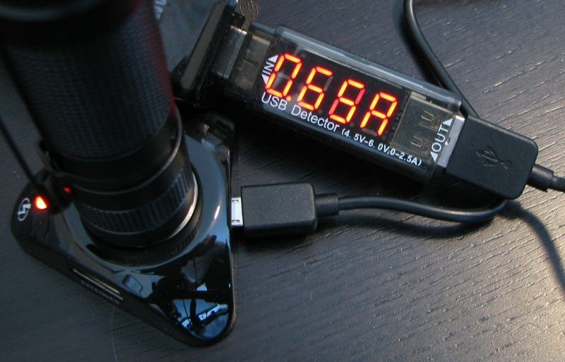

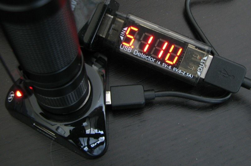

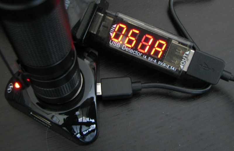

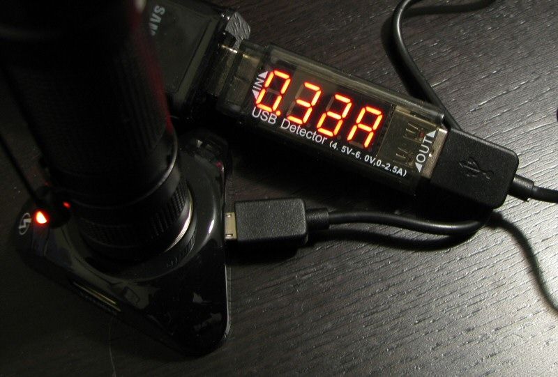

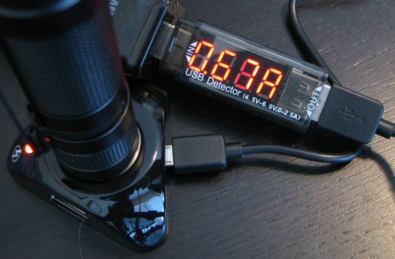

    Because the AC charger uses a USB connector to the charging cable, I was able to take direct measures of the charging parameters using my Xtar VI01 "USB Detector" (basically a specialized USB current/voltage meter). There are many of these on the market now, and this early model was favorably reviewed by HKJ here.
    For charging tests, I started with a discharged Olight 18650 battery. The USB detector was left in place in place for all readings. Note that the voltage reading on this device refers to the input voltage (i.e., from the USB port).
    Initial charging current and input voltage:
    It's a little hard to see due to fluctuating reading, but charging started at ~0.61A with a typical USB ~5.1V input voltage ("U" is meant to represent Volts on the top display above). This is fully consistent with the USB 2.0 specs.
    After 30 mins, the charging was up to ~0.65A.
    After 1 hr, charging was up to ~0.67A.
    After 2 hrs, charging was up to ~70A.
    After 3 hrs, charging was up to ~0.71A.
    Peak charging current was ~0.73A (5.19V) at 3hr 45 mins into the charge.
    By 4 hrs, charging had begun to drop to ~0.68A.
    After 5 hours, charging had dropped to ~0.32A.

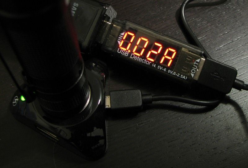

    By 6 hours, the indicator had gone green:
    Oddly, there was still a small current being drawn when the dock indicator light was green (0.02A above). If I removed the light, this dropped to zero on the detector – and stayed there, even when the light was re-docked. I therefore recommend you remove the light once the dock goes green.
    Note that the resting voltage of the 18650 battery was ~4.23V at this point – indicating a very full charge.
    As before, all the Olight R-series lights seem to be using a good CC/CV algorithm. This pattern and time is quite reasonable for a 0.75A max charger.

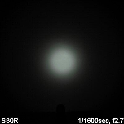

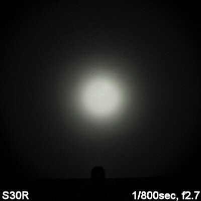

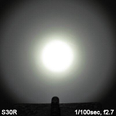

    For white-wall beamshots below, all lights are on Max output on an 3.7V Li-ion (18650) battery. Lights are about ~0.75 meter from a white wall (with the camera ~1.25 meters back from the wall). Automatic white balance on the camera, to minimize tint differences.
    Beam pattern is generally similar to the other members of the R-series lights – although the S30R does have some differences.
    Thanks to the larger (and deeper) reflector, spillbeam width is narrower on the S30R, compared to the S20R. The hotspot is also smaller – although with a greater corona. And of course, max output of the S30R is quite a bit higher than the S20R. Scroll down for detailed beam output and throw measures.
    As shown in the beamshots, the S30R on max definitely has more overall output and throw than the S20R.

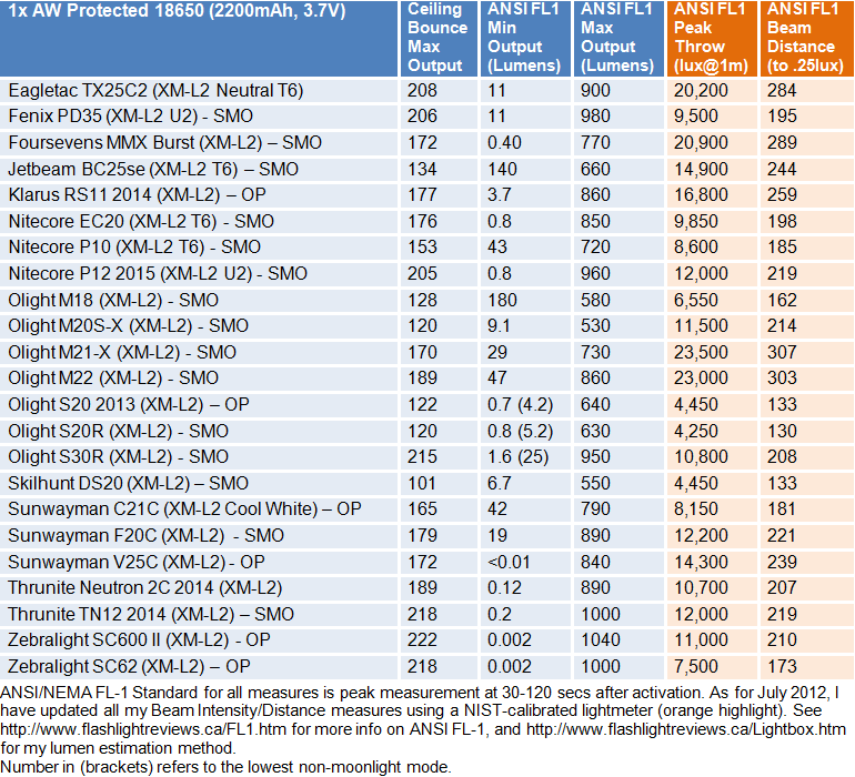

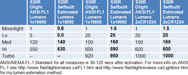

    Here is a detailed output comparison between the lights.
    As usual, I get very good concordance between Olight's specs and my output measures. Note that the S30R moonlight mode was about twice as bright as the S20R (although still quite low).

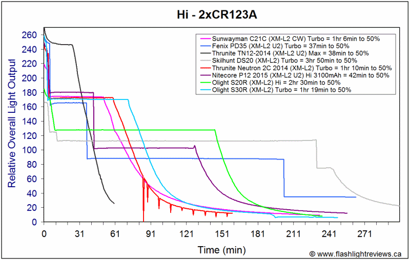

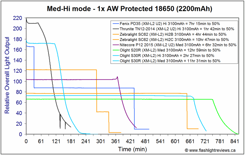

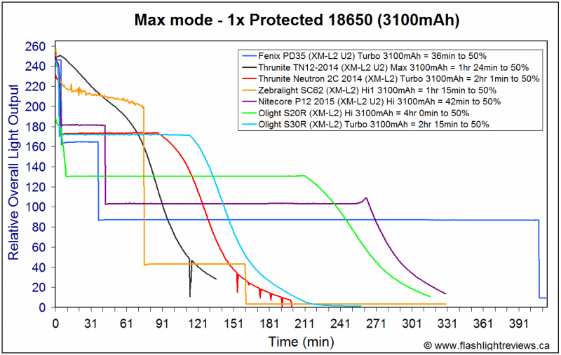

    Output/Runtime Graphs:
    Let's compare the S30R's stock 3400mAh Olight battery against my current test bed of 3100mAh 18650s.
    First thing you will notice is that the Turbo mode rapidly drops down to the Hi level. Although hard to see above, the S30R maintains Turbo for a little over ~2 mins, and the drops down over the next ~1 min or so.
    The included 3400mAh cell provides a marginal benefit over my stock 3100mAh cells.
    Let's see how it compares to other lights in this class (all 18650 runtimes shown on 3100mAh cells below)
    The S30R is very competitive for this compact 1x18650 class, with overall efficiency at least good as the Zebralight SC62 and Thrunite Neutron 2C 2014.
    All Baton lights use an electronic switch, and therefore require a small stand-by current when fully connected. However, the standby drain on S30R is negligible at 15uA, which would theoretically translate into decades before the supplied 18650 would be drained. Accidental activation is always a potential concern with electronic switches though, so I recommend you "soft" lock out the switch electronically, or physically lock out the light at the tailcap when not in use.
    The S30R steps down fairly rapidly on Turbo, dropping to the Hi level within ~3-3.5 mins after activation.

    Thanks for the review. Did you experience any trouble with charging? There is a thread with reports of trouble charging in the LED Z FLASHLIGHT section
    http://www.candlepowerforums.com/vb/...t-s30r-trouble
    6,936
    Default Re: Olight S30R (XM-L2, 1x18650/2xCR123A) Rechargeable Dock Review: BEAMSHOTS, RUNTIM
    Quote Originally Posted by Tac Gunner View Post
    From that thread, it sounds like the problem most users are experiencing is due to contact issues inside the light. There are always additional contact paths in lights that can be charged in situ. If anything increases the resistance between contact surfaces (i.e., as some lubricants will do), then the light can behave like a cell is nearly fully drained when it isn't. I usually find a thorough cleaning of all contact surfaces often resolves these sorts of problems. Remains to be seen if there is anything else more serious going on.
    I haven't experienced any problems with any of my R-series lights to date, and they have all gone through a reasonable amount of testing for the review (i.e., at least half a dozen battery changes and multiple charge cycles each).

    Am I right when I look at the graphs that the s30r will hold the high 600lm setting and stay at that level without dropping for about 2 hours solid?
    6,936
    Quote Originally Posted by KelDG View Post
    Yes, that's right, for any battery with at least a 3100mAh (true) rated capacity.

    The one that I just received came with a 1000 mAh output on the charging dock; not the 750 mAh. Label says it is a MICRO-DOK2.
    On the downside the one I received has the old style black switch button. No low battery indicator .
    I charged it and used it overnight. I really like it, but I feel shortchanged. So it is on its way back. Got it thru Amazon... shipped by Amamzon for EdisonBright. I'm trying again from another vendor.
    Aug 2006
    Houston TX
    243
    Quote Originally Posted by MtnDon View Post

    6,936
    Quote Originally Posted by billcushman View Post
    I just went to the Olight USA web site and looked at the pictures of the S30R typeII. It appears to have a flat black switch with no low battery indicator.
    What you have is the new version of the S30R ("S30R-II"). It typically comes with a custom 3600mAh cell and the new 1000mA charger.
    Although the button is black, there is a low voltage red LED visible underneath. I am currently testing one now, and you can clearly see the red light as the battery is running low.
