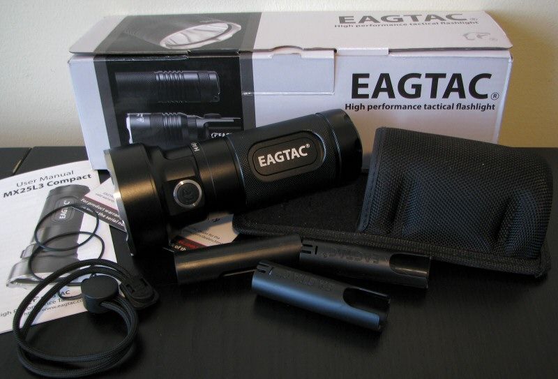

    As with other recent Eagletac models, the MX25L3C comes securely packaged in an Eagletac cardboard box. Included accessories are a paracord wrist lanyard, extra o-rings, three CR123A anti-rattle magazine holders, tailcap with secondary switch (kit version only), rigid belt holster (kit version only), manual, and warranty card.
    Although mine is the basic kit form, I didn't get the diffuser or colored filter set to review.

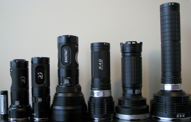

    From left to right: Keeppower protected 18650 3100mAh; Eagletac MX25L3C Compact, SX25L3, MX25L4 Turbo; L3 Illumination X40; Fenix TK75; Supbeam X60.
    All dimensions are directly measured, and given with no batteries installed:
    Eagletac MX25L3C 3x18650: Weight: 345.9g, 352.0g with kit tailcap (485-491g with 4x18650), Length: 141.9mm, 143.6mm with kit tailcap, Width (bezel): 61.9mm
    Eagletac MX25L4 Turbo 4x18650: Weight: 741.0g (926g with 4x18650), Length: 203mm, Width (bezel): 92.7mm
    Eagletac MX25L2 2x18650: Weight: 468.7g (with battery pack: 744g), Length: 266mm, Width (bezel): 62.0mm
    Eagletac SX25L3 3x18650: Weight: 315.9g, Length: 150.2mm, Weight (bezel): 47.0mm
    Fenix TK61: Weight: 605.7g (791g with 4x18650), Length: 218mm, Width (bezel): 96.0mm
    Fenix TK75: Weight: 516.0g (701g with 4x18650), Length: 184mm, Width (bezel): 87.5mm
    Nitecore TM06: Weight: 276.4g (464g with 4x18650), Length 123.9mm, Width (bezel): 50.0mm
    Nitecore TM15: Weight: 450.6g (639g with 4x18650). Length 158mm, Width (bezel): 59.5mm
    Niwalker BK-FA01: Weight: 682.3g (865g with 4x18650), Length: 209mm, Width (bezel): 80.0mm, Width (tailcap): 50.3mm
    Thrunite TN36: Weight: 390.4g (578g with 4x18650), Length: 125.4mm, Width (bezel): 64.0mm
    SupBeam K50: Weight: 645.0g (828g with 4x18650), Length: 230mm, Width (bezel): 90.1mm
    SupBeam X60: Weight: 920.7g (1201g with 6x18650) Length: 277mm, Width (bezel): 108.0mm

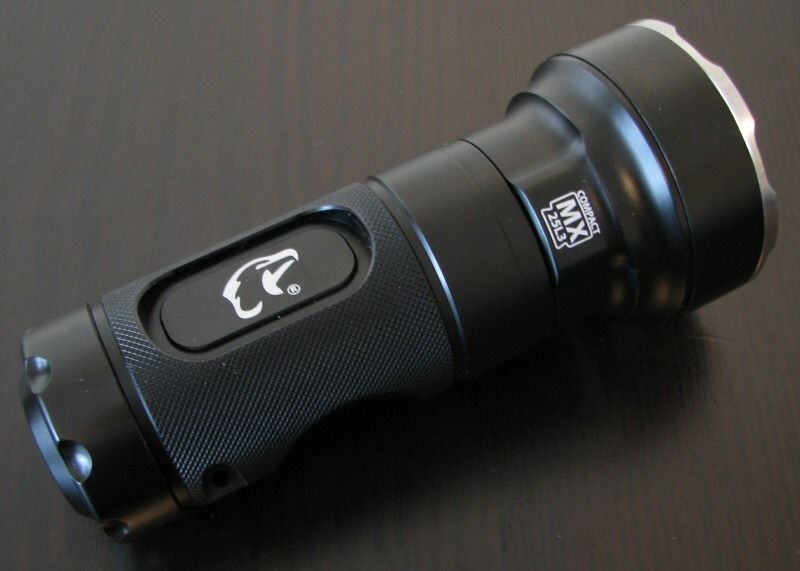

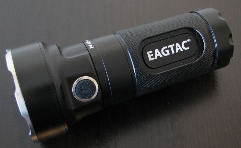

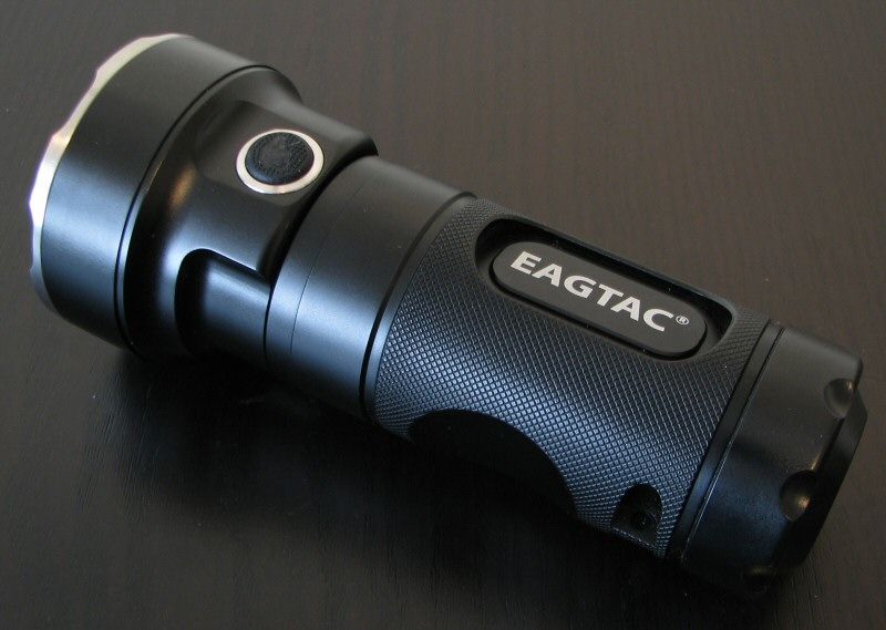

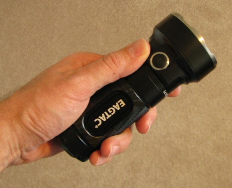

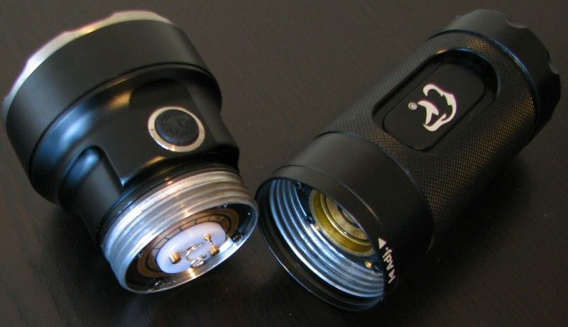

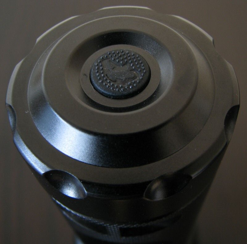

    The MX25L3C series carries on the robust tradition of the larger MX25 and SX25 series lights. The MX25L3C is a solid model, with good weight and decent hand ergonomics. The enlarged head of this "compact" version is still quite reasonable (i.e., not as unwieldy as the Turbo heads on some models).
    Unlike some of the other Eagletac lights I've handled, knurling is of mild aggressiveness on the MX25L3C. Anodizing is glossy black, hard anodized (i.e., type III). There were no chips in the anodizing on my sample (although that is not uncommon on find on some samples. There are a reasonable number of labels, and all are bright and clear (sharp white against the black background).
    As with other recent Eagletac lights that use a head switching mechanism, there are a series of spring-mounted pins in the head that are required to interpret the output state of the light. The thickness and quality of these pins looks similar to my MX25L4, which were improved compared to some of the earlier MX25L2 models I tested.
    The electronic switch in the head controls on-off when the tailcap is connected, with output mode selection and programming controlled by head twist. This is the same as the other recent SX25/MX25xx-series lights, although the design of the contact points in the head can vary somewhat (scroll down for a UI discussion). Side-switch feel is good for an electronic switch – there is a reasonable traverse, and the action is firm. Grip is good with the texturized rubber button cover.

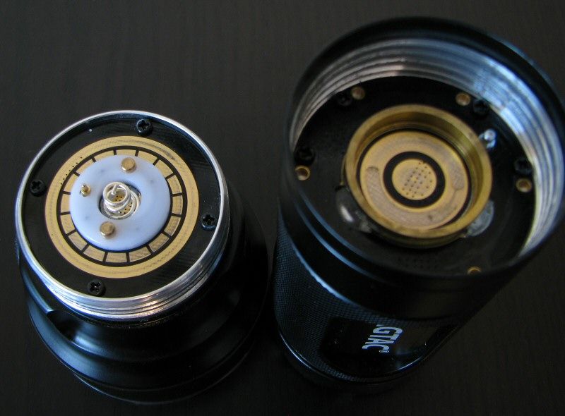

    Screw threads in the head region are square-cut (and thick). This is where mode switching occurs, as with the other recent Eagletac lights, so you need to keep the contact surfaces here scrupulously clean.

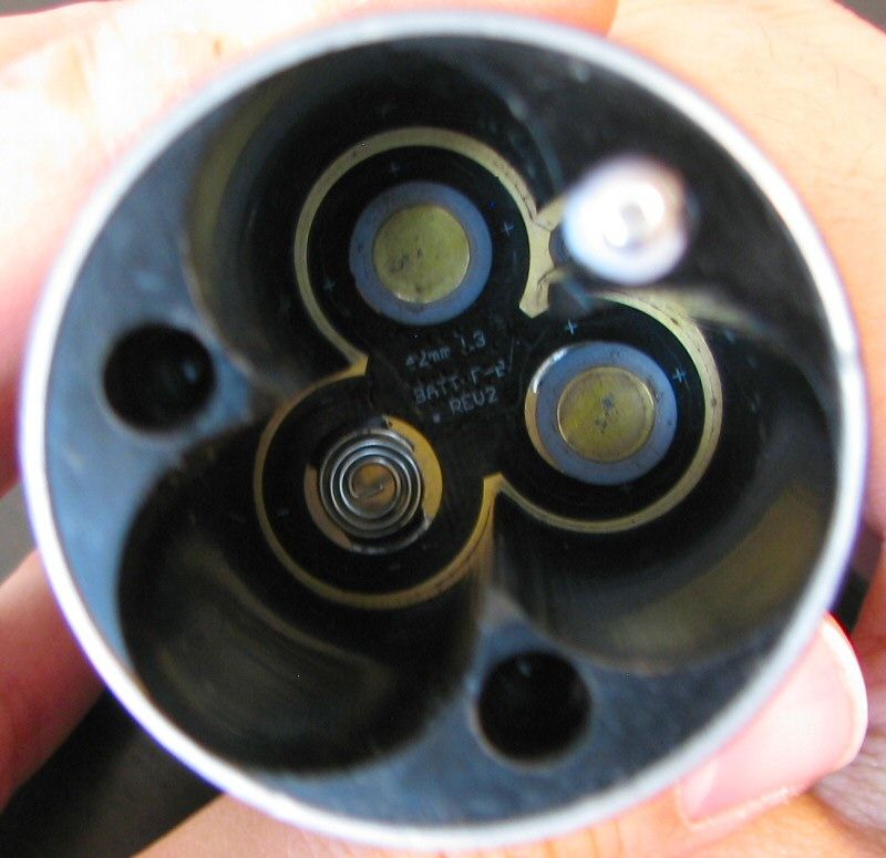

    Similar to the recent SX25L3, the MX25L3C doesn't use a battery carrier, but instead has cut-out wells for the cells. And like the SX25L3, the cells are arranged in continuous series (i.e. 1p3s). Connection is made by contacts on a connector piece in the tailcap. The tailcap connector can spin freely, and locks in place to a set of holes in the body that line up with rods in the tailcap. With the optional kit tailcap, you get a slightly raised base and a secondary switch that functions exactly the same as the main switch in the head (i.e., switch function is identical).
    The MX25L3C can tailstand with either tailcap, and there is a wrist lanyard strap attachment point on the side of the body.
    Screw threading on the tailcap is traditional triangular cut, and is anodized. Lock-out is possible, with a quick twist of the tailcap (works on both the regulator tailcap, and the kit version). Thread feel is very smooth on my sample.

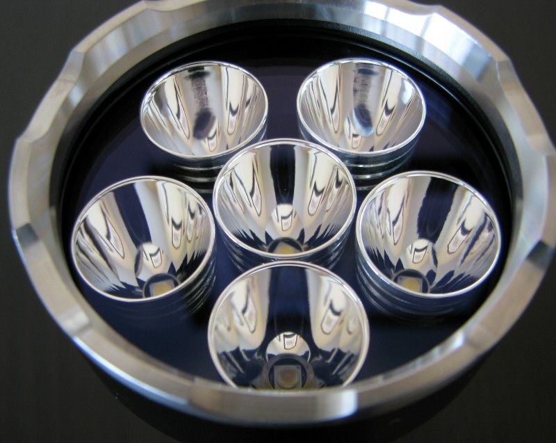

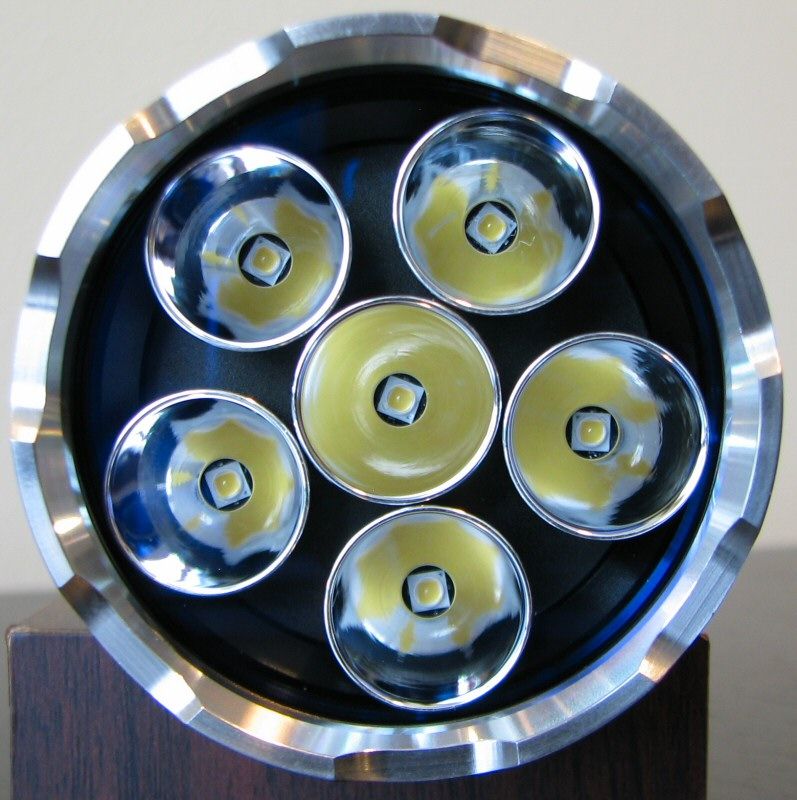

    The MX25L4 Turbo reflector is composed of six separate wells, each smooth and shiny (and relatively deep for the small size). At the base of each reflector is a Nichia 219 neutral white emitter (XP-G2 cool white also available).

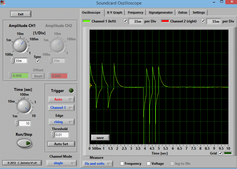

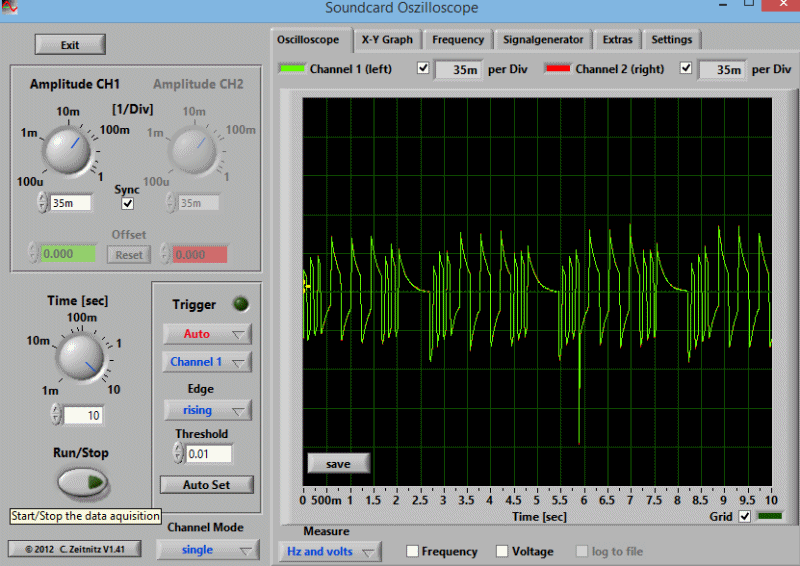

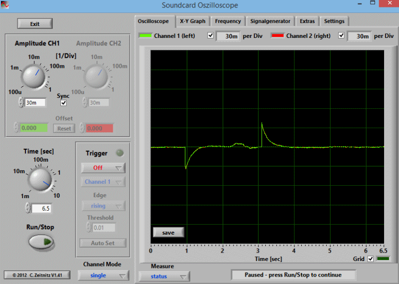

    Strobe
    As before, there is no sign of PWM at any output level on the MX25L3C – I presume all levels are current-controlled. Shown below are the auxillary modes of from my MX25L4T review, which are exactly the same as my MX25L3C sample.
    Strobe I:
    The main strobe is a high frequency strobe, measured at 13.7 Hz on my MX25L4.
    Strobe II:
    The second strobe mode is an alternating or "oscillating" strobe, switching between 8.3Hz and 15.9Hz every 2 seconds. Here is a blow-up of the two frequencies:

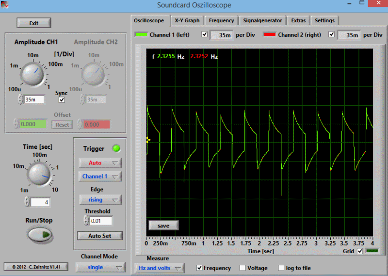

    Hi-Flash:
    Hi-Flash is basically a full power slow strobe/beacon mode. Frequency was a reasonable 2.3Hz in my testing.
    SOS I:
    The "fast" SOS signals the full SOS sequence (dot-dot-dot, dash-dash-dash, dot-dot-dot) in just over 2 secs. These seems unusually quick to me.
    SOS II:
    In contrast, the "slow" SOS takes just under 2 seconds just do the "S" (i.e. dot-dot-dot), and about 2.5 seconds to do the "O" (i.e., dash-dash-dash), with >5 secs in-between each sequence. Personally, this seems far more useful than the rather frenetic initial SOS mode.
    Beacon:
    Beacon is a slow full output burst that is 2 secs long, re-occurring every 20 secs (i.e., a very slow beacon).
    Lo-Flash:
    Lo-Flash is a lower output, slower frequency strobe/beacon than Hi-Flash. It's hard to see on the traces above (due to the relatively low output), but I measured a frequency of ~0.6 Hz.

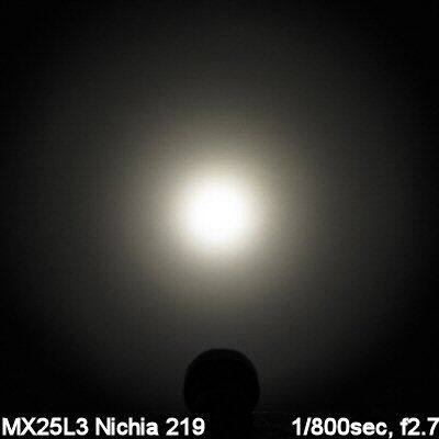

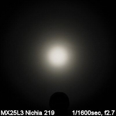

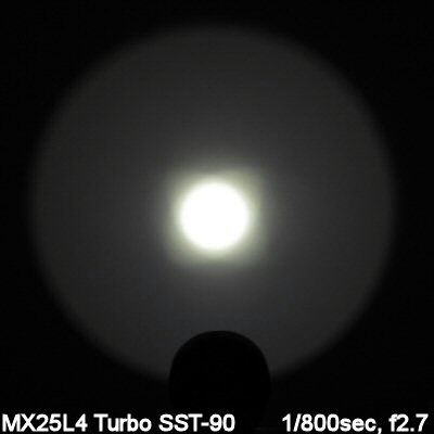

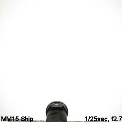

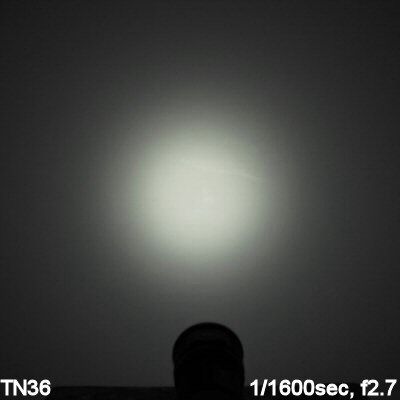

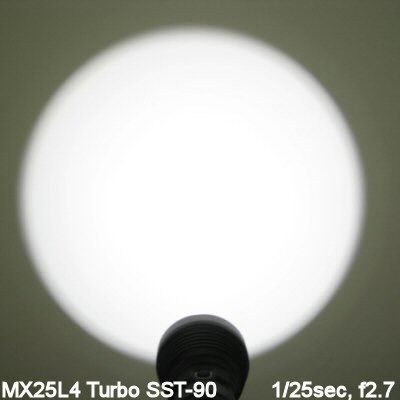

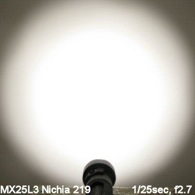

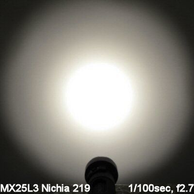

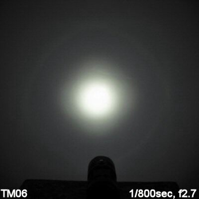

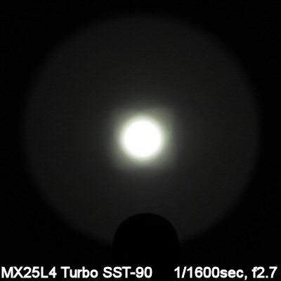

    And now, what you have all been waiting for. All lights are on their respective battery sources, about ~0.75 meter from a white wall (with the camera ~1.25 meters back from the wall). Automatic white balance used on the cool white lights (to minimize tint differences), and Daylight white balance used on the neutral white lights (i.e., MT-G2 and Nichia 219).
    Let's start with a comparison of the MX25L3C to some other recent high-output Eagletac lights.
    And now some competing lights in this class.
    As always, it's hard to tell much about peak intensity throw at such ridiculously close distances. But the above does give you an idea of the what the relative beam pattern looks like, compared to the competition (i.e., it is not as floody as the MT-G2 lights, with their wider hotspots and wider spillbeams).
    You also really can't say much about tint from a single white balance. However, you can see that while the Nichia 219 does produce a Neutral White tint, it "rosier" than the usual neutral white MT-G2s.
    Outdoors beam shots are not feasible with the mounds of snow everywhere here right now. So here are some shots from my basement. For your reference, the back of the couch is about 7 feet away (~2.3m) from the opening of the light, and the far wall is about 18 feet away (~5.9m). Below I am showing a couple of exposures, to allow you to better compare hotspot and spill. The camera is set to a Daylight white balance for all lights below. All lights on Turbo.

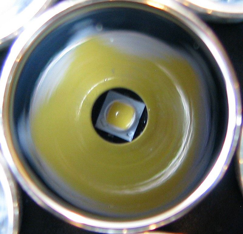

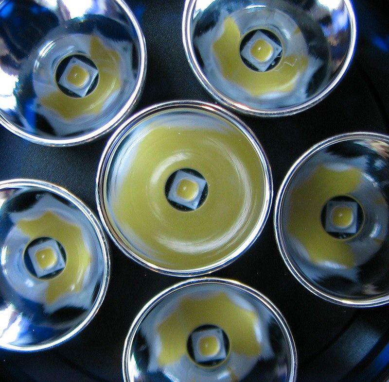

    Again, the Nicha 219 produces a "rosier" tint than a typical neutral white emitter, like the MT-G2. The multi-emitter MX25L3C is also a lot more "throwy" compared the the single/dual MT-G2 lights. Overall spillbeam with is about typical for a standard light (i.e., the MX25L3C is not a particularly "floody" specimen).
    Scroll down for direct beam measurements.

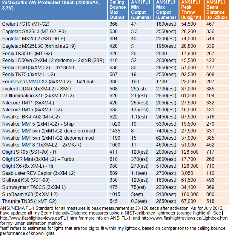

    To better compare output levels, here is a comparison table.
    My lumen estimates generally correlate pretty well with the Eagletac ANSI FL-1 specs.
    Note the step-down on Turbo shown above is for the default step-down (rated at 25%, which seems accurate in my testing). See runtimes for an example with this feature turned "off" (i.e., 10% step-down).

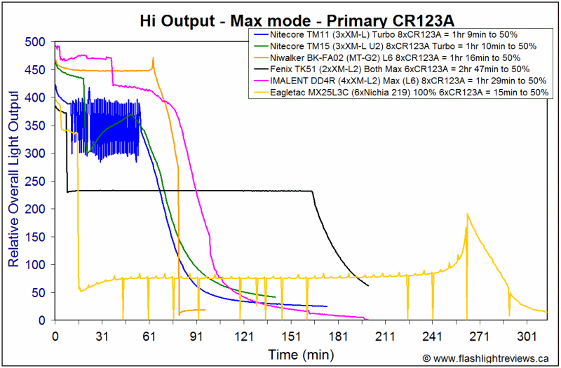

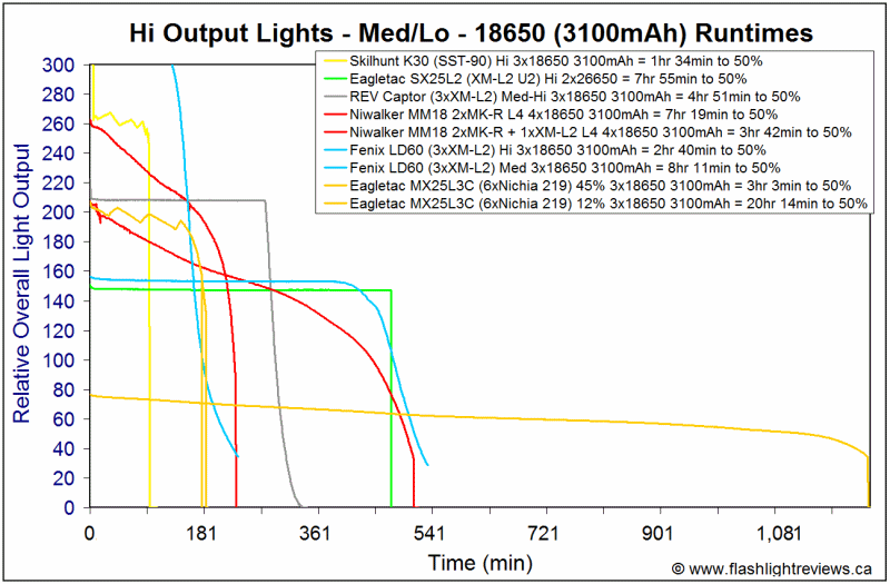

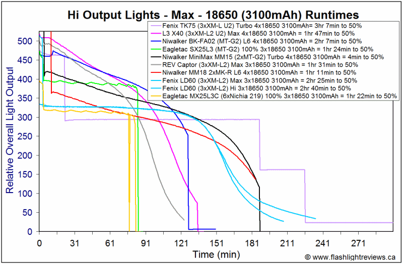

    Output/Runtime Comparison:
    All runtimes in my recent reviews are done with protected 3100mAh 18650 batteries, based on the NCR18650A core.

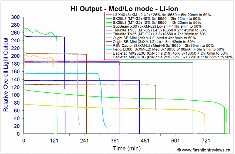

    Let's start with a comparison of the main levels:
    As previously mentioned, on most Eagletac lights you have the option to control the degree of step-down on Turbo (occurs after 200 secs of continuous runtime). By default the light steps down by 25%, but you can switch this to a 10% step down.
    Runtime patterns are about what you would expect. Note that are some subtle fluctuations in output over time (i.e., not perfectly flat-regulated). But these are too small and gradual for you to be able to notice by eye. In practice, the output will seem rock-solid flat.
    As the batteries near exhaustion, warning flashes will start in the main beam. You can see evidence of these in a couple of cases above. Since the flashes are quick, and my sampling rate is long (30 secs), you wouldn't expect to see to many obvious examples of it in the runtime graphs.
    Let's see how the MX25L3C compares to the competition.
    Overall regulation patterns are very similar to the SX25L3. However, as you can see, the 6x Nichia emitters are not as efficient as the 1xMT-G2 on the SX25L3. Basically, this means that you get the same runtime as the SX25L3, but somewhat less output for each level. I suspect the 6xXP-G2 S2 version would give noticeably higher output, and be quite competitive for this class (i.e., at least as good as the 1xMT-G2).
    Previously, I used to use AW 2200mAh protected cells in my 18650 testing – so data for many of my older lights are only available in this format. Here is a comparison of how the MX25L3C performs on 2200mAh cells. Note that I won't be providing these sorts of comparisons for new lights any more.
    Again, not to belabor the point, but you can expect reduced output on the 6x Nichia, compared to equivalent runtime with 3x/4x XM-L2 or 1x/2x MT-G2 emitters.
    The CR123A runtime above requires a bit of explaining. I used my standard Rayovac (made-in-the-USA) CR123As for this test. Judging from the pattern, it looks like the built-in PTC feature kicked in to limit output and heat. I've seen this on a number of heavily driven multi-cell lights. Please see my CR123A battery round-up thread for a discussion. It looks like the PTC current limitation triggered the low voltage feature early as well.
    As with other Eagletac models where output mode is set by the degree the head is tightened, you need to keep all contact surfaces in the head scrupulously clean. Otherwise, you may experience mode switching problems due to contact surface issues.
    Output/runtime efficiency of the Nichia 219 version is not as high as competing as cool white XP-G2/XM-L2/MK-R-based lights, or the neutral white MT-G2 based lights. Basically, with the Nichia 219 you get less output – but equivalent runtime – compared to other Eagletac offerings. However, the Nichia 219 emitters do have a higher color rendition index (Hi CRI) than other emitter types.
    The MX25L3C is heavily-driven on max, so primary CR123As are not recommended for extended runs (i.e., you may trip the built-in PTC thermal safety feature on made-in-the-USA brands).

    When you had the cr123A PTC issue, that was only using the 10% step down [circa 350 ROLO], right?
    So it is possible that the 25% step down [circa 300 ROLO] could avoid that.
    6,936
    Default Re: Eagletac MX25L3C Compact (6xNichia 219 3x18650/6xCR123A) Review: BEAMSHOTS, RUNTI
    Quote Originally Posted by MichaelW View Post
    That's true - I always do my CR123A runtimes on the max setting of every light (so, 10% step-down in this case). It's possible the default 25% step-down would have prevented the PTC engagement on my Rayovacs.
    The main factor to keep in mind is the threshold set limit of the various PTCs out there. The made-in-the-USA brands consistently trigger much earlier in my testing - I doubt any of the popular made-in-China brands would have tripped, even at the 10% step-down level. But given the expense of getting everything in Canada, I tend to limit CR123A runtimes to just the one run ...

    Thank you as always for the review selfbuilt. Based on the picture, seems like Eagletac had changed the Nichia 219A emitter B11 bin I have in my light to the 219B D220 bin emitter in selfbuilt's sample. However, it didn't seem like Eagletac increased the lumen on the spec like they did for XP-G to XP-G2 or XM-L to XM-L2.
    Jul 2009
    Illinois
    2,327
    Yes, those appear to be the newer 219B and not the 219A in my earlier model. That would explain the difference in output on turbo since the 219B is more efficient. Thanks for another great review, I am a big fan of the high CRI Nichia emitters.
    6,936
    Quote Originally Posted by ragnarok164 View Post
    Quote Originally Posted by Mr. Tone View Post
    Yes, I'm not an expert on Nichia bins, but it does seem like these are the newer 219B D220 emitters (as specified in the current ET spec sheet online for this model).
    In any case, I know what I like, and I really like this tint. There is just something so much more satisfying with the "rose-tinted" neutral white of the Nichias, compared to the more common "green-tinted" neutral whites. Hard to say how much of that preference is the actual higher CRI rating. But it's a very uncommon thing to find such a great tint at this level of output.
    I have quite a few hi CRI 4500K Nichia flashlights and I find the tint and color rendering very satisfying. The MX25L3C had both the great tint and color rendering plus plenty of output. The hi CRI Nichia has caused me to be very unsatisfied with my other neutral white lights with XM-L2 in them. Maybe someday Nichia will offer a hi CRI 4500K emitter with the same footprint as the XM-L2 to get closer to it's output.

    Hi Selfbuilt and thanks for the review!
    A bit late, but at the time of this review I was away from flashlights for a while. Because I have a few Nichia 219 dropins I really like the thought of such a bright light as MX25L3 with high CRI LED!
    I wonder about what you inform: "As with other Eagletac models where output mode is set by the degree the head is tightened, you need to keep all contact surfaces in the head scrupulously clean. Otherwise, you may experience mode switching problems due to contact surface issues."
    As long as you keep the contact surfaces clean, does this light work without annoying problem as jumping over mode? And is the resistance enough to avoid changing mode by it self? I understand other owners can give their input as well.
    Thanks, Patric
    I never had problems with any Eagletacs using the head-twist UI. Then again, they don't see any hardcore outdoor use. The resistance is enough to keep it from switching accidentally. There is also a decent amount of distance between the switching, except turbo>high which is a bit quicker.

    Quote Originally Posted by markr6 View Post
    Thanks. Good to know!
    6,936
    Yes, I would agree with this. The point is that if the contacts are not kept clean, you may have difficulty with accurate mode switching. But I've never had any problems with the light not staying in any given mode.
