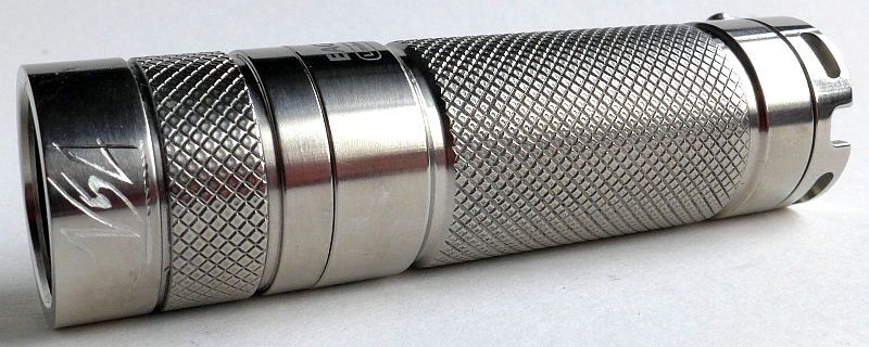

    On test in this review is one of CPF's own Vinhnguyen54's V54 custom modified lights. In this case it is the Eagletac D25Cvn Ti V3 with PDTc XP-G2 emitter, dark pocket clip, polished, solder filled and engraved. The driver is the EDC version which starts on moon mode. This light is also known as the 'The Micro Searchlight'.

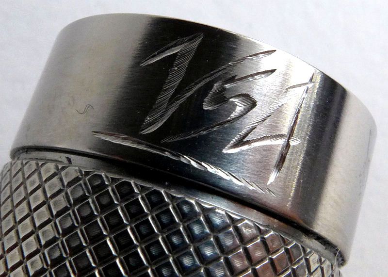

    This light came engraved on the side of the bezel ring.
    A closer look at the engraving

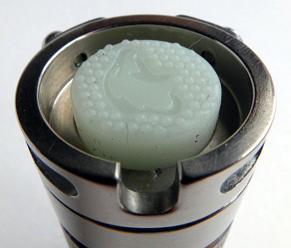

    The switch boot is Glow-In-The-Dark material which is very bright when charged.

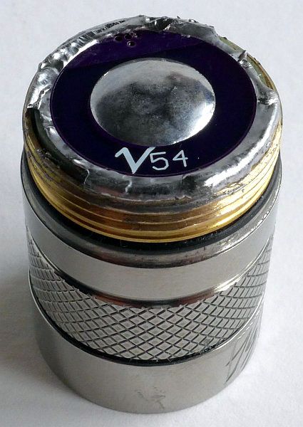

    The head has been filled with solder for better heat transfer.

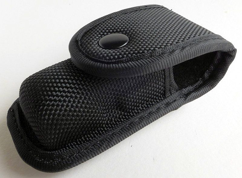

    A very tidy holster comes with this light.
    The belt loop is Velcro fastened so can be fitted without removing the belt.

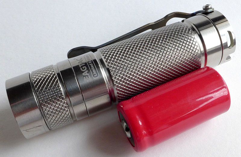

    In case you were wondering about size, here is the light next to a 16340 IMR cell. This is a 'Micro' Searchlight.

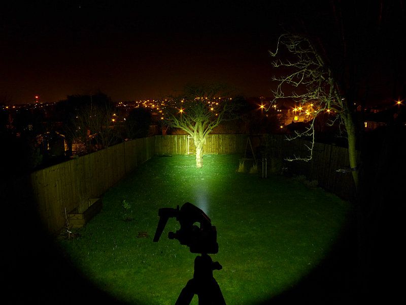

    The beam
    Despite the textured reflector, here you can see the very bright hotspot but with enough spill to be useful. The photo is taken with daylight white balance to try to show any colour shift. There is some yellowing, but with Vinh's PDTc this is more along the lines of having a warm tint rather than any bad colour shift.
    And moving outdoors you can see why this is a Micro Searchlight!
    An admittedly unfair comparison, being significantly bigger light, with more power and big reflector, here is the Fenix TK41 on Turbo. The diminutive D25Cvn stands up well against this competition.

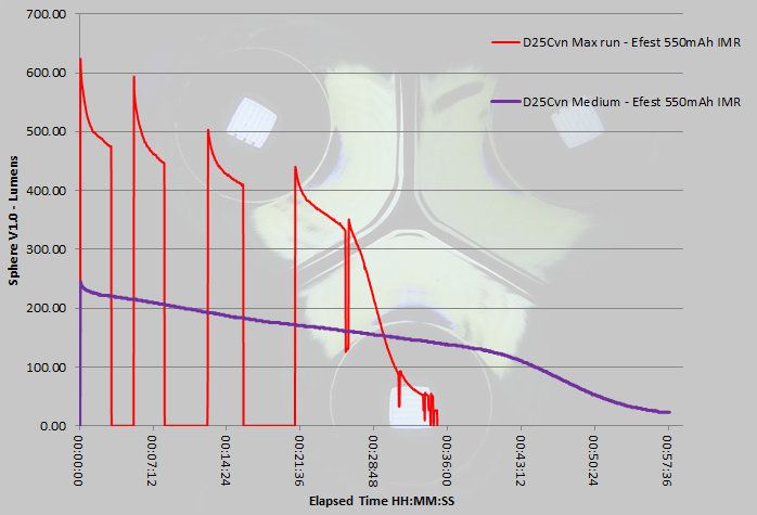

    The runtime trace shows two different runs. The lower output is using the Medium setting and allowing it to run uninterrupted. This might be considered its 'normal' use setting (not going to Max).
    Then you have the main runtime trace which shows running it on Max until it was too hot to touch (you feel it heating up within seconds). Then cooling it with a fan until it gets back to room temperature and repeating. As you can see on the fourth run of Max output it did not get too hot to touch (nearly, but not quite). After five minutes it dropped to Medium output which I reset to Max and continued. At the cut-off of the runtime test, the IMR cell was at 2.9V.
