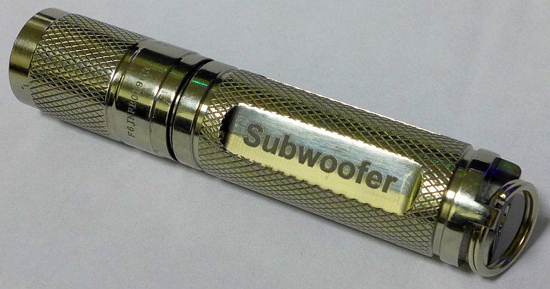

    Some of the machining and the neat knurling

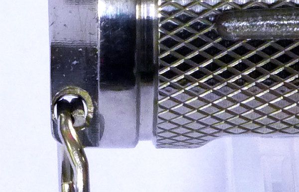

    The lanyard hole is drilled very close to the edge.

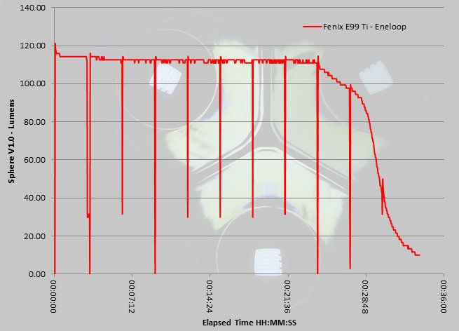

    The E99 Ti runtime trace was carried out using 1x AAA Eneloop cell, and started on High.
    After every three minutes the output drops to Medium, but can be reset to High immediately.
    If time permits further information and beam shots will be added to this Performance Review in post 2.

    so approx. 115 lumens for 25 mins?
    Hove, UK
    2,449
    Default Re: Performance Review: Fenix E99 Ti (1xAAA)
    Quote Originally Posted by bladesmith3 View Post
    Remember that ANSI output ratings cut off at 10% of the ANSI peak output figure (at 30s). When you see the actual output graph you can see for how long the highest output is maintained for. In this case the 115lm is maintained for about 25 minutes (with manual resets every 3 minutes).
