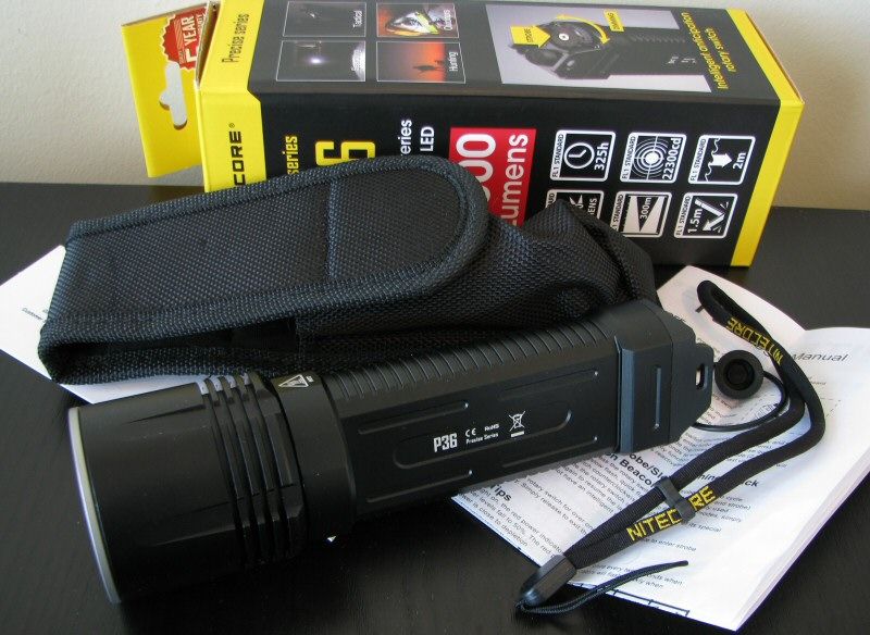

    Packaging is the Nitecore's standard colorful cardboard display box. As before, detailed specs and information are printed right on the box. Inside, included with the light are a spare o-ring, spare tailswitch boot cover, wrist lanyard, holster with Velcro closing flap, warranty card, and manual.

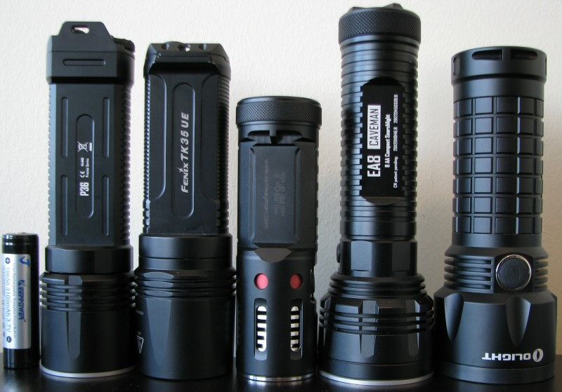

    From left to right: Keeppower protected 18650 3100mAh; Nitecore P36; Fenix TK35UE; Sunwayman T45C; Nitecore EA8; Olight SR52.
    Nitecore P36: Weight 255.6g, Length 173mm, Width (bezel): 50.0mm
    Eagletac SX25L3: Weight: 315.9g, Length: 150.2mm, Weight (bezel): 47.0mm
    Fenix TK35UE: Weight 270g, Length 164mm, Width (bezel): 48.6mm
    Niwalker BK-FA02: Weight: 687.6g (870g with 4x18650), Length: 209mm, Width (bezel): 80.0mm, Width (tailcap): 50.3mm
    MiniMax Nova MM15 Shipping: Weight: 333.7g (without handle), 355.9g (with handle), (539g with 4x18650 and handle), Length: 114.6mm, Weight (bezel): 63.7mm
    Sunwayman T45C: Weight: 216.6g, Length: 136.0mm, Width (bezel) 40.4mm, Width (widest part): 40.8mm
    Thrunite TN35 (MT-G2): Weight: 571.4g (723g with 3x18650), Length: 201mm, Width (bezel): 78.9mm

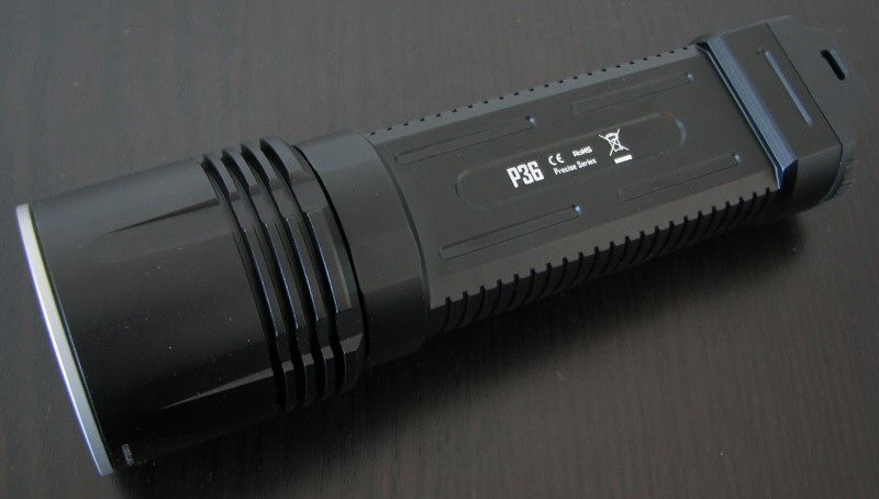

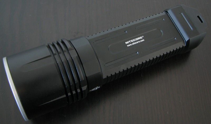

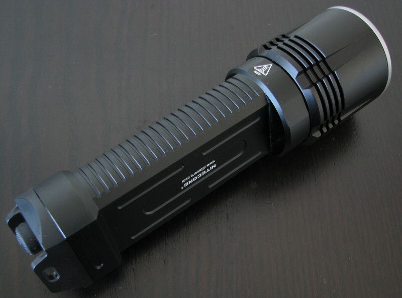

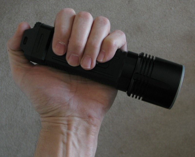

    The overall body design of the P36 is generally similar to the Fenix TK35UE. The light uses a side-by-side 2x18650 arrangement, with a battery carrier. Like the TK35UE, the P36 is streamlined, and quite comfortable to hold and handle (although it is a bit longer than the TK35UE).
    Anodizing is a matte black (hard anodized), and with no obvious blemishes on my sample. Lettering is clear, bright white against the dark background. Labels are fairly small.
    The light lacks knurling as such, but the ridge detail along both sides of the battery handle (and head fins) provide reasonable grip.
    Screw threads are square-cut and anodized, but connection is controlled by the tension on the battery carrier springs. On my sample, you need to turn the head at least one full revolution loose (from tight) to lock it out.

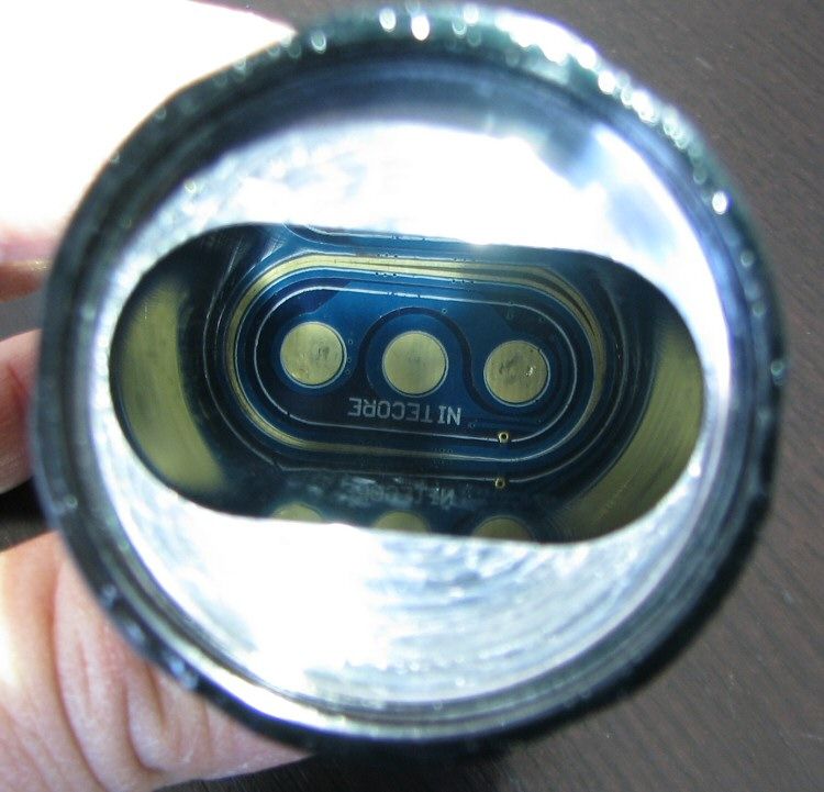

    The tailcap area is distinctive, as a feature both a physical clicky off/on switch and an electronic mode-changing rotary dial/switch. Switch feel is good, if a bit on the firm side. I will describe the user interface and function below. The light can tailstand, thanks to the raised side ridges.

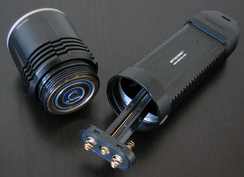

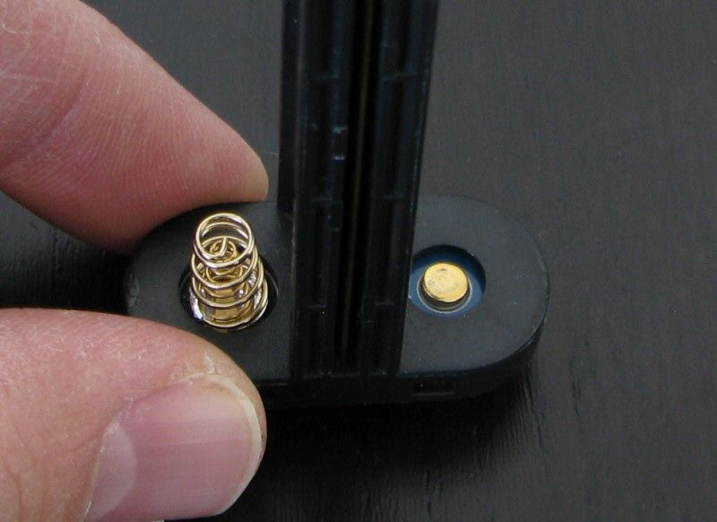

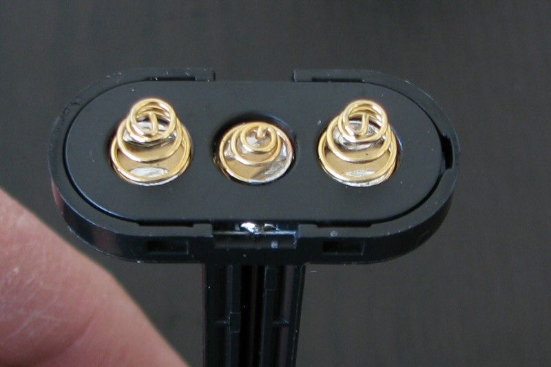

    Let's take a look at the carrier:
    The carrier is bi-directional, fitting and working in the light in either orientation. It is made entirely of plastic. The carrier chambers hold all my protected 18650 cells very snugly, so you may have issues with some of the longest high-capacity ones. There is a recessed button at the positive terminal in each chamber, so flat-top cells work not work in this light (i.e., need to use small button top only).
    Note that there was a strong acrid smell coming off the inside of the light. I suspect this is due to outgassing of plasticizers in the carrier (which then get trapped inside the air-tight sealed battery compartment). While harmless, this may be offensive to you – if so, I recommend you air the light and carrier out in a well ventilated area when not in use.

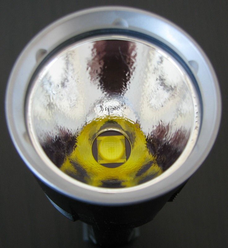

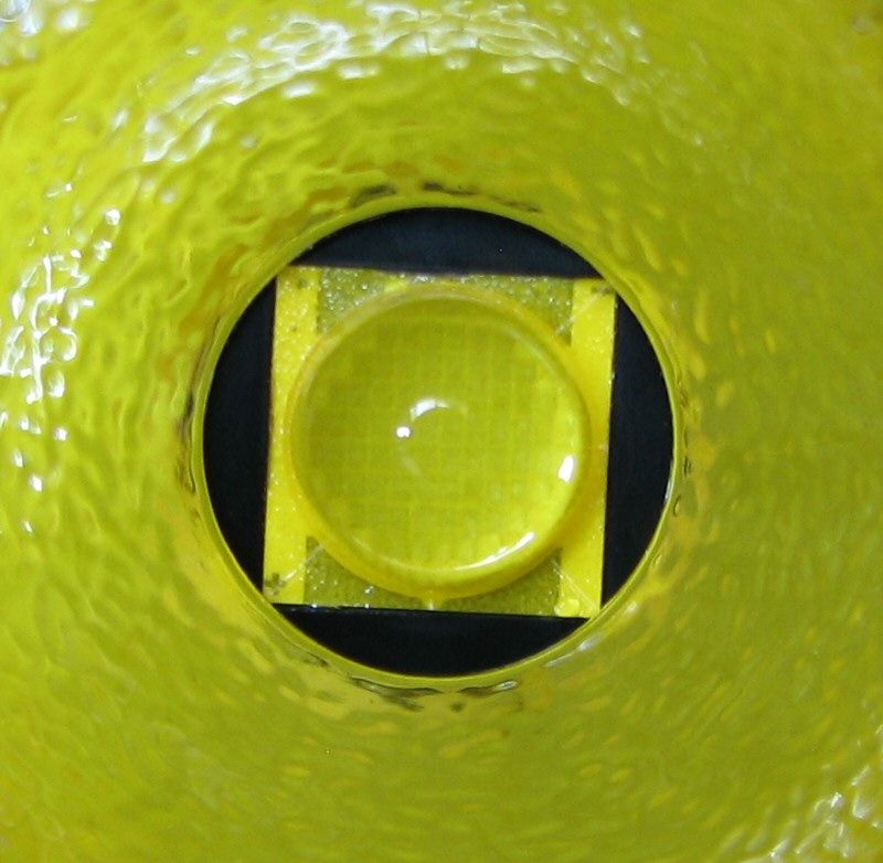

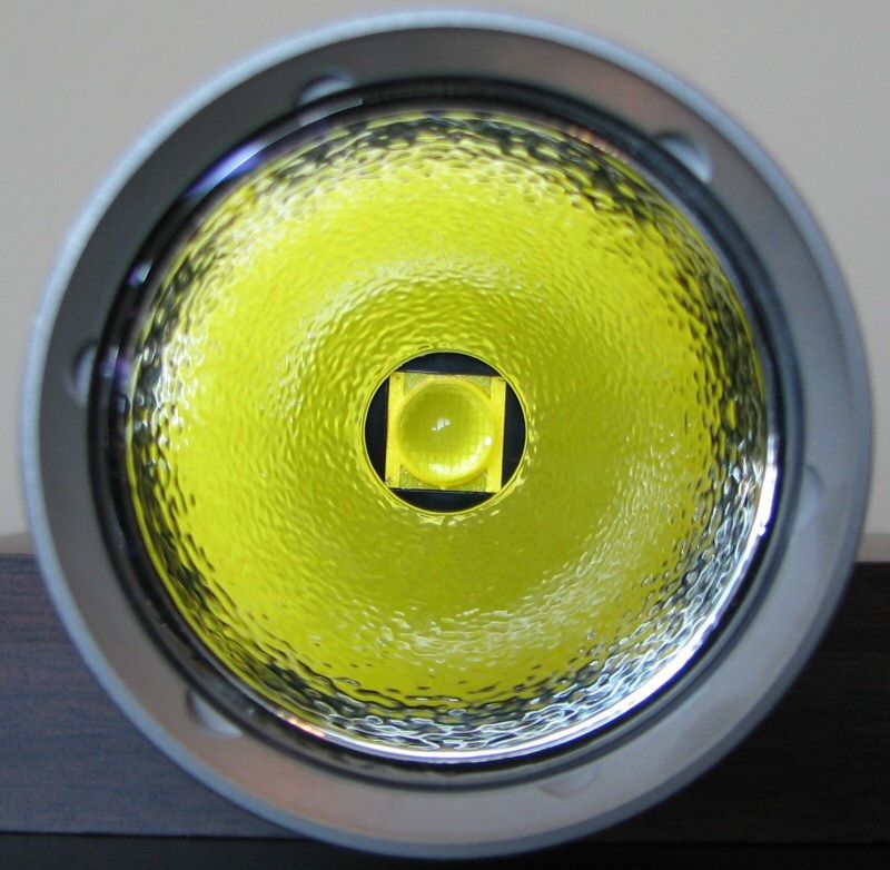

    The Cree MT-G2 is a large neutral white emitter, composed of a grid of 72 distinct segments on it (under a large dome). Due to the large die size, don’t expect great throw from a MT-G2 light, even with the reasonably deep reflector included here. The reflector is moderately textured, to help smooth out the beam. This should produce a relatively balanced beam, similar to the Eagletac SX25L3. Scroll down for beamshot comparisons.

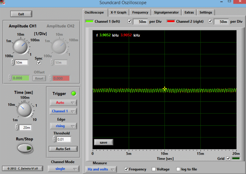

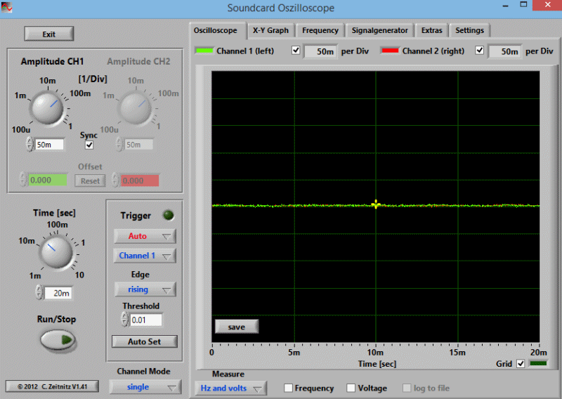

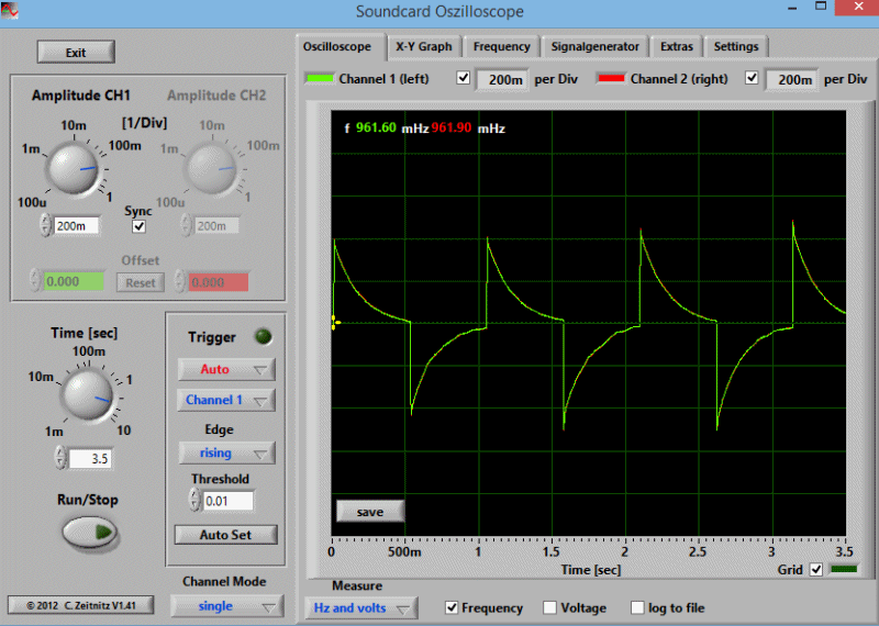

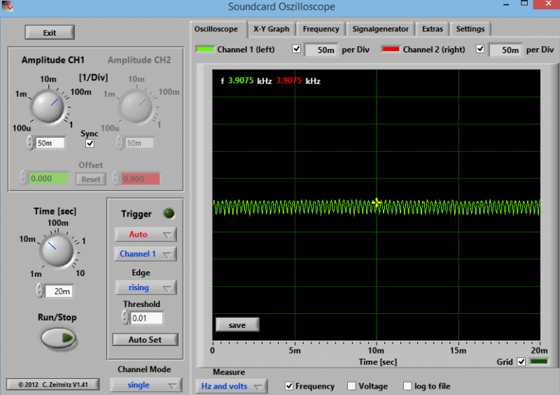

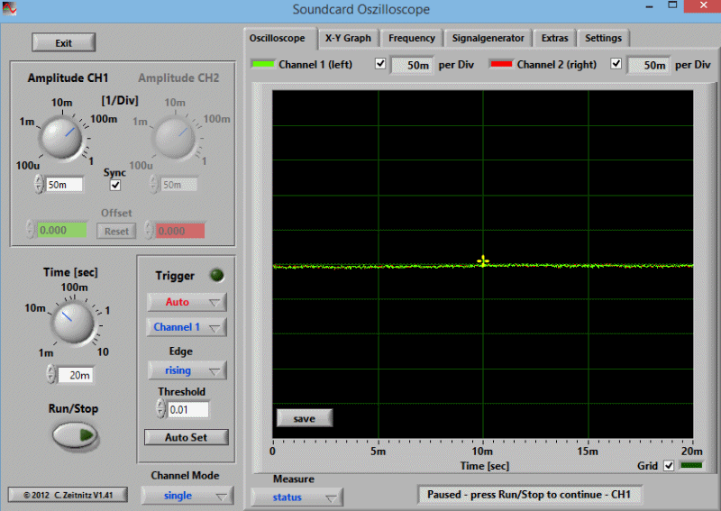

    PWM/Strobe
    There is no sign of pulse width modulation (PWM) on any mode. I believe the P36 is current-controlled.
    Note that was some very minor circuit noise detectable by my oscilloscope on some levels (levels 3-9). Examples are shown below.
    Level 1:
    Level 3:
    Level 7:
    Level 10:
    These are not visible in any way – the output is perfectly constant with no hint of flickering. But consistent with my standard review methodology, I report on anything that I can detect.
    The P36 has more flashing modes than typical in most lights (accessed sequentially from the rotary dial when in flashing modes).
    Strobe:
    Strobe is a high-frequency strobe, with a slightly variable pulse duration (i.e., frequency varied from ~16.5 to ~17.3 Hz in my sampling). Certainly very distracting.
    When turning the dial counter-clockwise, in sequence you get:
    Slow Flash:
    Slow flash mode was a half on/half off flash of 0.96Hz duration, Roughly speaking, each on-pulse was on for half a second, off for half a second. A very good signaling strobe frequency.
    Fast Flash:
    Fast flash mode was a half on/half off flash of 1.9Hz duration (i.e., almost twice per second). So each on-pulse was a quarter of a second long (followed by a quarter second pause). Still a relatively good signaling strobe frequency.

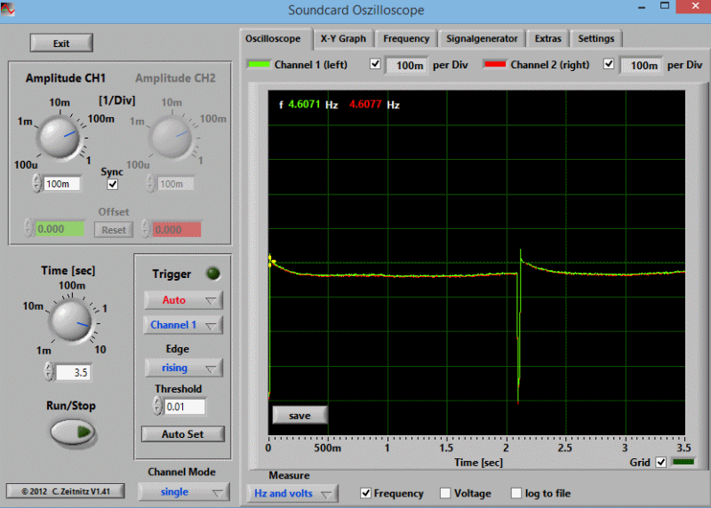

    Location Beacon:
    Beacon is a quick flash, roughly every 2 seconds.

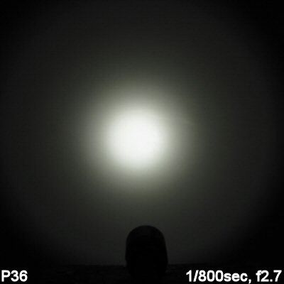

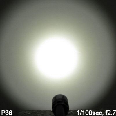

    For white-wall beamshots below, all lights are on Max output on an AW protected 18650 battery. Lights are about ~0.75 meter from a white wall (with the camera ~1.25 meters back from the wall). Daylight white balance is used on my Canon for all neutral white tints.
    The P36 has a very similar beam pattern to the Fenix TK35UE, with just a bit more throw. It is certainly more of a relatively "throwy" light compared to the Eagletac SX25L3 (although the SX25L3 has more output overall, so peak intensity throw is similar). See my direct beam measures below for more info.
    These results are certainly consistent with what you see in the beamshots, for the various MT-G2 equipped lights.

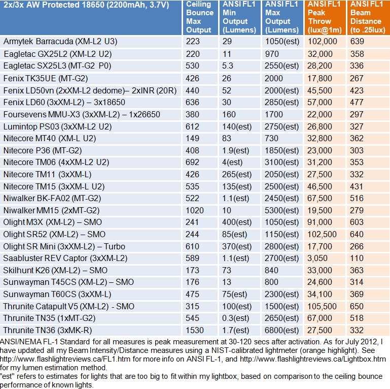

    Let's see how all 10 levels compare to the official specs, on 2x18650 in my lightbox:
    I get very good concordance between my estimated lumens and Nitecore's published specs. There is certainly a good range of output levels here (although there is not much of a visual difference between the higher ones).

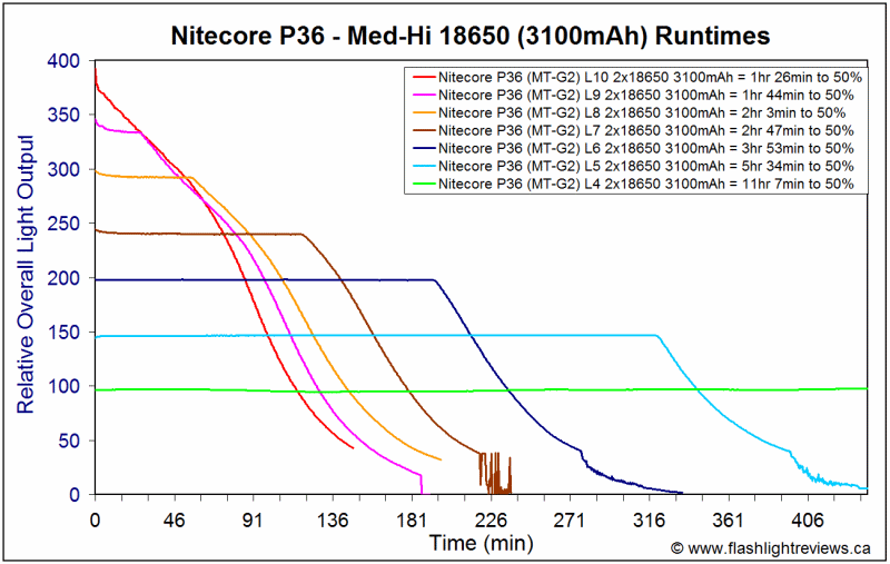

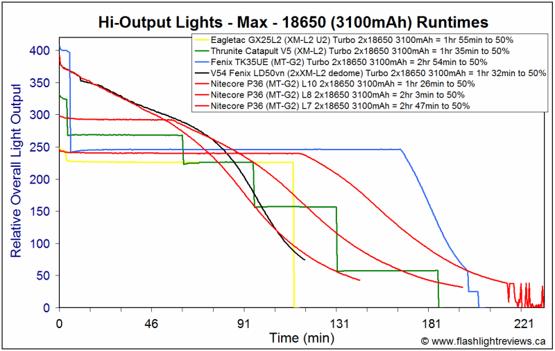

    Output/Runtime Graphs:
    All runtimes are done under a cooling fan. 18650 runtimes done using protected batteries based on the Panasonic NCR18650A core.
    Let's start with a comparison of the main levels (down to L4).
    There is relatively little difference in runtimes between L8, L9 and L10. Basically, you just get a short regulated period on L8 and L9, and then the light drops to direct-drive at the same point as the L10 mode. This is not very surprising, since direct-drive is more efficient than flat-regulation. As you go down to the lower modes, the regulated runtime portion continues to increase.

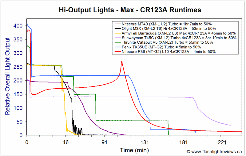

    Let's see how the P36 compares to some competing 2x18650 lights:
    The P36 is at least as efficient as the Thrunite Catapult V5, at all levels. It also approaches the overall efficiency of the Fenix TK35UE (although that light does still maintain a slight advantage, as is common for Fenix's circuits).
    The CR123A runtime above requires a bit of explaining. I used my standard Rayovac (made-in-the-USA) CR123As for this test. Judging from the pattern, it looks like the built-in PTC feature kicked in to limit output and heat. I've seen this on a number of heavily driven multi-cell lights. Please see my CR123A battery round-up thread for a discussion.

    The P36 uses a plastic battery carrier, and one which has a very strong acrid smell in my case (likely due to out-gassing of plasticizers). Given the sealed body, this means these odors can concentrate. Not a safety concern, but it does make battery changes a smelly affair.

    There is no apparent step-down from the max levels. As such, primary CR123As are not recommended for these levels (i.e., the P36 generates a fair amount of heat). As you can see on my max mode run, the PTC safety circuits engaged on my made-in-the-USA cells fairly quickly.
