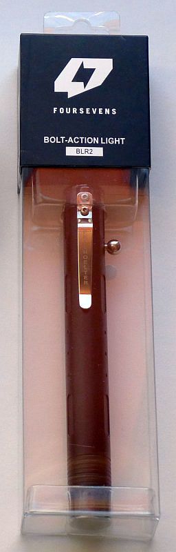

    The nice clean looking FOURSEVEN packaging allows you to see all round the light.

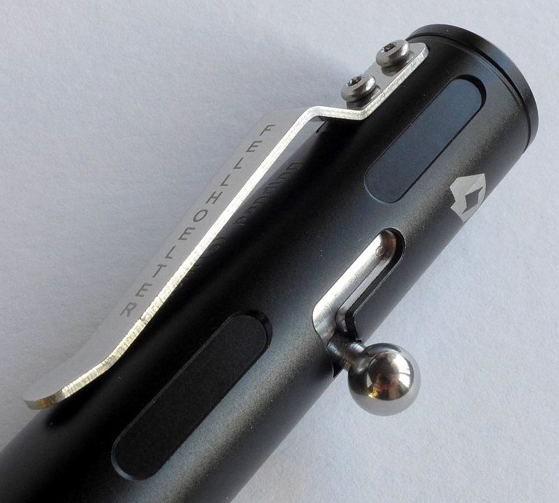

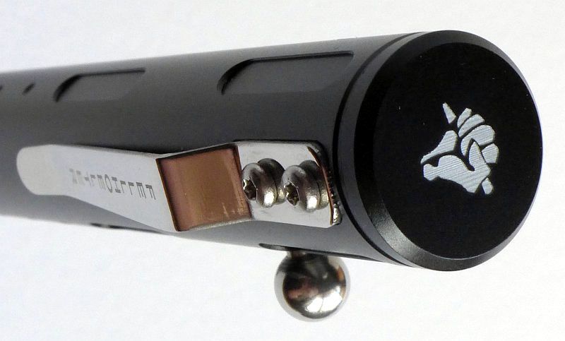

    The pocket clip proudly displays the Fellhoelter name.
    And the end cap has the Tuff-Writer logo engraved.

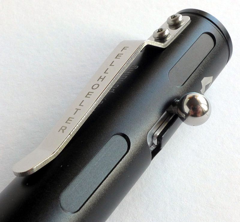

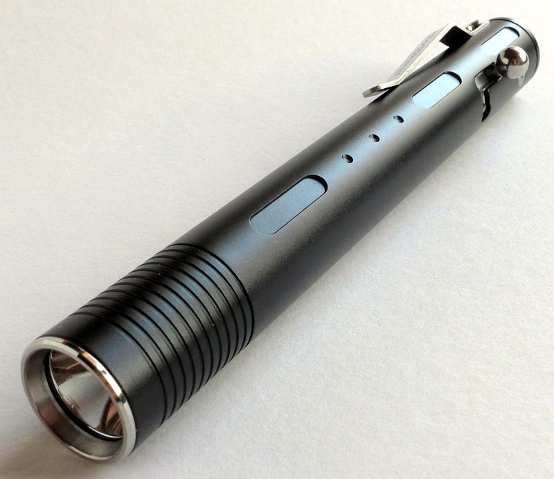

    And here is that special feature, the Bolt. The L-shaped channel allows the bolt to be rotated to lock it in the on position, just like a rifle bolt would lock in place.
    The FOURSEVENS logo is engraved on the body next to the bolt.
    The Bolt in the off position…
    …and then latched on.

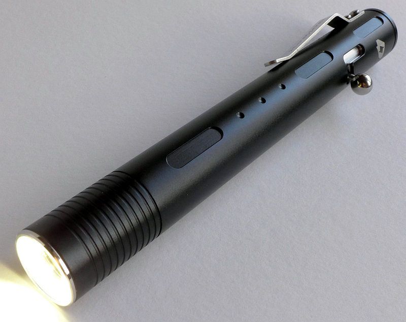

    The BLR2 next to a Preon P2 (2xAAA) to give an idea of size.

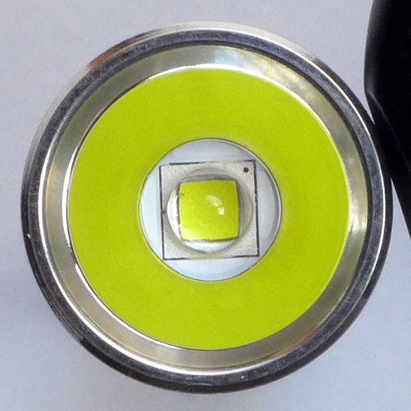

    Fitted with a CREE XM-L2 LED in a smooth reflector.
    A view of the reflector to show its depth, and the coated lens.

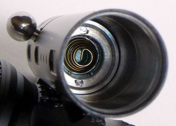

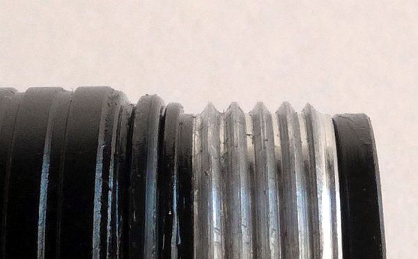

    The head unscrews and you can see the positive contact with physical reverse polarity protection.
    The negative contact is a spring, and despite is close proximity to the Bolt, this is fixed and does not move.
    The threads are cleanly cut.

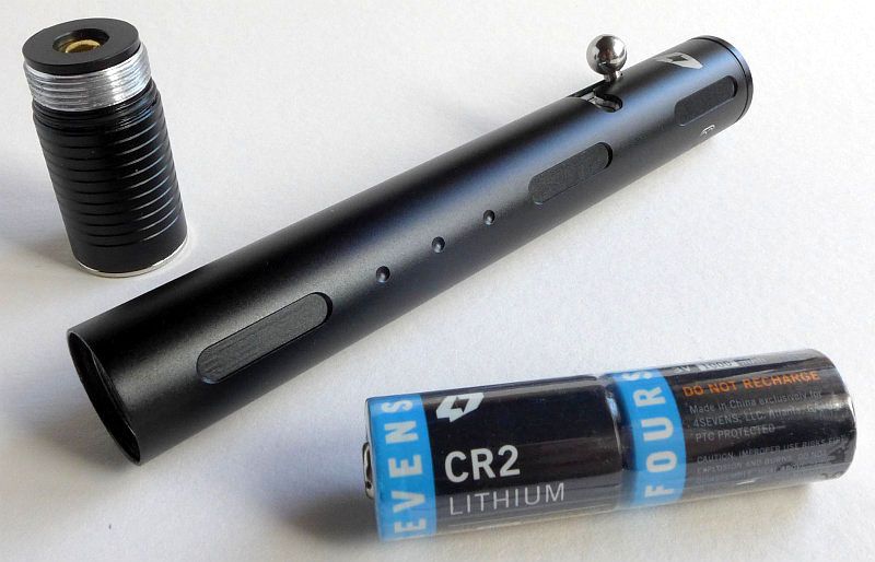

    The disassembled Bolt-Action with its 2xCR2 battery pack.

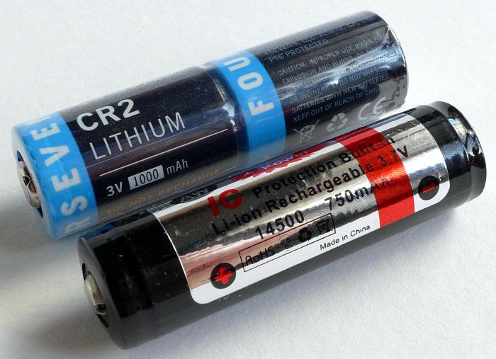

    FOURSEVENS official specification is that the BLR2 must be powered by 2xCR2 cells (or 2x RCR2). However with an operating range of 2.7V-8.4V, see how these two CR2 cells look in comparison with an AW protected 14500 cell…..interesting… ;-)

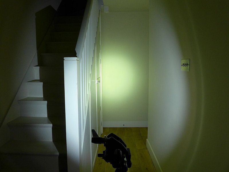

    The beam
    Let's get the 'action' going.
    The Bolt-Action has a soft hotspot and nice wide beam thanks to the small reflector and XM-L2 LED. A really good all-rounder beam, not too much of a hotspot for indoors, but with some reach if needed.
    So as not to overstate the beam strength, the exposure here is set to give a fair idea of the range of the BLR2, and despite the lights small size it works well in outdoor spaces too.

    So it is all about this – the Bolt
    Operation is simple. Slide the bolt forward and near the end of the travel the light comes on. Quickly releasing and sliding the bolt changes mode, and once you have the output you want, you simply rotate the bolt to lock it on.
    Flicking the spring loaded handle sideways knocks it out of the locked position and turns it off.

    FOURSEVENS state an input voltage range of 2.7-8.4V and only allow 2xCR2 or 2xRCR2. However, as I hinted at earlier, that 2.7V and similarity in size of 2xCR2 to an AA sized cell, means the 14500 could actually be an option. Let's look at that in further detail.

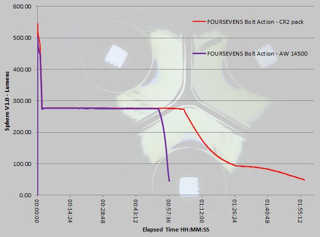

    FOURSEVENS Bolt-Action BLR2 using 2xCR2 I.S. measured ANSI output Lumens PWM frequency or Strobe frequency (Hz)
    Burst 515 0
    High (following Burst ramp down) 286 0
    Low 103 0
    Moon 3 0
    Output values on 14500 are similar, but slightly lower, so the tested output values shown are only those for 2xCR2.
    However, on the runtime trace I've included the official CR2 powered run and the run when using an AW 14500 protected cell.
    You can see the higher maximum output during burst mode, but this then settles into a very similar output until the 14500 runs out of power. At just under an hour of runtime, and the 14500's output drops sharply until the protection shuts it off suddenly.
    So running on 14500 works very well, but the Bolt-Action will push it until the protection activates and you will suddenly find yourself in the dark.
    The officially supported CR2 cells maintain a longer runtime and the output then tapers off much more predictably. The end of the run is terminated at the ANSI cut-off, but the CR2 powered output continues to trail off without suddenly cutting out.

    Quote Originally Posted by shrike2222 View Post
    Nice review!
    I didn't think it can accept 14500 battery. It is good point.
    However it's tint is too greenish.
    The beam is not green at all. Please be careful not to judge tint based on images you see on a computer screen. I actually run 4 screens from my computer and each one (despite tweaking settings) makes an image look slightly different. Camera (and its White balance), post processing of the image, and the screen it is viewed on all change its appearance.
    If you are basing this on my indoor beamshot, look at the woodwork (stairs and skirting) as these are white. The walls are a light sandy colour (a paint colour called 'String' by Farrow and Ball). I don't actually have a 'white wall' in the house to use for this, and the beamshot is intended more to give an idea of the beam shape/quality rather than tint.
    EDIT: a note has now been added in the main review to reflect this
